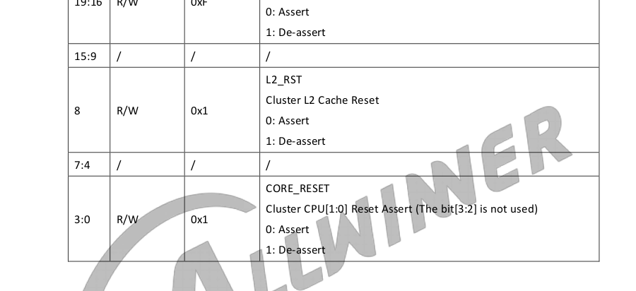

启动第二个CPU驱动 源码
static DEFINE_SPINLOCK(cpu_lock);
static int sun8i_smp_boot_secondary(unsigned int cpu,
                    struct task_struct *idle)
    u32 reg;
    void __iomem *cpucfg_membase = ioremap(0x09010000, 0x10);
    void __iomem *cpuexec_membase[] = {ioremap(0x070005C4, 0x10),ioremap(0x070005C8, 0x10)};
//    pr_info("%s %d cpu %x\n",__FILE__,__LINE__,(u32)idle);
    spin_lock(&cpu_lock);
    if(cpu != 1)return 0;
    /* Set CPU boot address */
    writel(__pa_symbol(secondary_startup),  cpuexec_membase[cpu]);
//  writel((u32)idle,   cpuexec_membase[cpu]);  /* do not work */
    /* Deassert the CPU core reset */
    reg = readl(cpucfg_membase);
    writel(reg | BIT(cpu), cpucfg_membase);
    spin_unlock(&cpu_lock);
static const struct smp_operations sun8i_smp_ops __initconst = {
    .smp_boot_secondary = sun8i_smp_boot_secondary,
CPU_METHOD_OF_DECLARE(sun8i_t113_smp, "allwinner,sun8iw20p1", &sun8i_smp_ops);
最近编辑记录 Cadence (2022-04-26 09:15:45)
