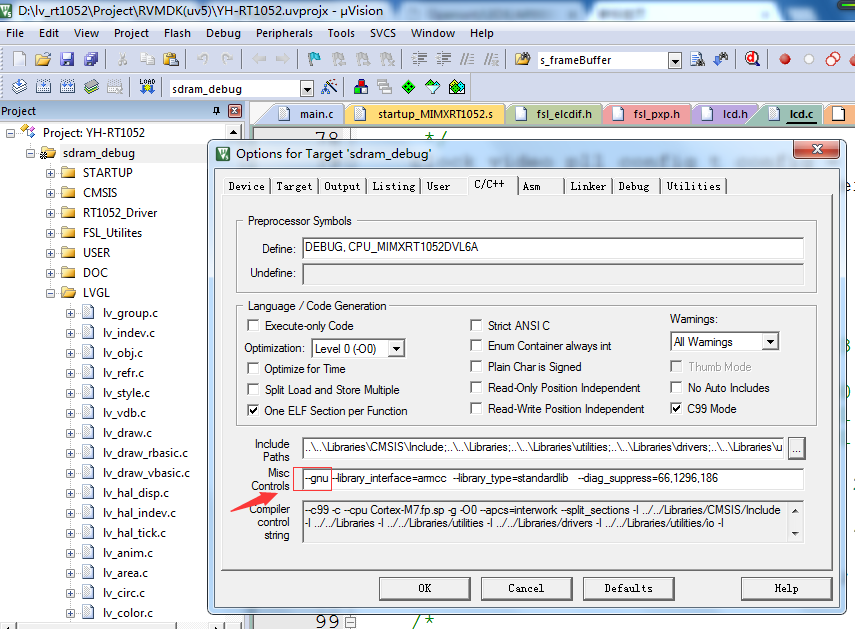

分享解决littlevgl移植到keil 5.24版本出现的编译错误的办法
littlevgl 大量用到 gnu扩展和 C99语法,
如果编译器不支持就要对代码大动干戈,
还好 MDK 5.24a 已经对C99和GNU支持很好了,
只需要轻轻设置一下 C/C++ 编译参数即可.
否则,你将会遇到以下恼人的编译错误:

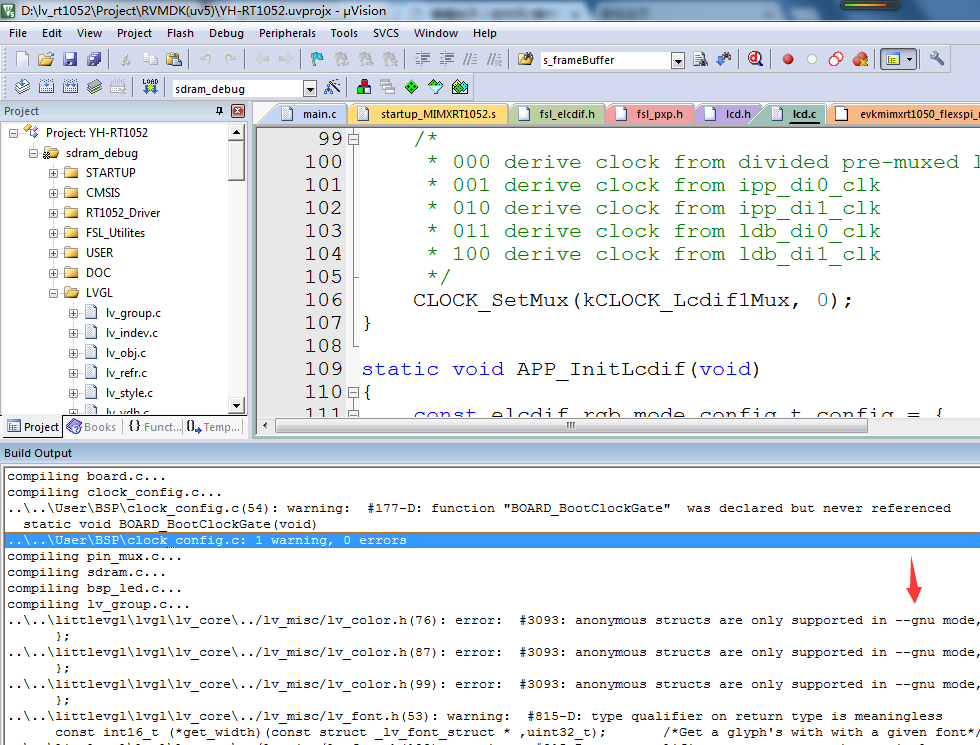

..\..\littlevgl\lvgl\lv_core\../lv_misc/lv_color.h(76): error: #3093: anonymous structs are only supported in --gnu mode, or when enabled with #pragma anon_unions
..\..\littlevgl\lvgl\lv_core\../lv_misc/lv_color.h(87): error: #3093: anonymous structs are only supported in --gnu mode, or when enabled with #pragma anon_unions
..\..\littlevgl\lvgl\lv_core\../lv_misc/lv_color.h(99): error: #3093: anonymous structs are only supported in --gnu mode, or when enabled with #pragma anon_unions
..\..\littlevgl\lvgl\lv_core\../lv_misc/lv_font.h(53): warning: #815-D: type qualifier on return type is meaningless
const int16_t (get_width)(const struct _lv_font_struct ,uint32_t); /Get a glyph's with with a given font/
..\..\littlevgl\lvgl\lv_core\../lv_misc/lv_font.h(129): warning: #815-D: type qualifier on return type is meaningless
const int16_t lv_font_get_width_continuous(const lv_font_t * font, uint32_t unicode_letter);
..\..\littlevgl\lvgl\lv_core\../lv_misc/lv_font.h(137): warning: #815-D: type qualifier on return type is meaningless
const int16_t lv_font_get_width_sparse(const lv_font_t * font, uint32_t unicode_letter);
..\..\littlevgl\lvgl\lv_core\lv_group.c: 3 warnings, 3 errors

..\..\littlevgl\lvgl\lv_misc\lv_color.h(76): error: #3093: anonymous structs are only supported in --gnu mode, or when enabled with #pragma anon_unions
..\..\littlevgl\lvgl\lv_misc\lv_color.h(87): error: #3093: anonymous structs are only supported in --gnu mode, or when enabled with #pragma anon_unions
..\..\littlevgl\lvgl\lv_misc\lv_color.h(99): error: #3093: anonymous structs are only supported in --gnu mode, or when enabled with #pragma anon_unions
..\..\littlevgl\lvgl\lv_misc\lv_color.c: 0 warnings, 3 errors

Project build/rebuild aborted.

不用修改一行代码, 添加 --gnu 支持, 即可编译成功 littlevgl.
