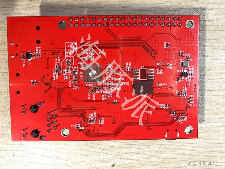

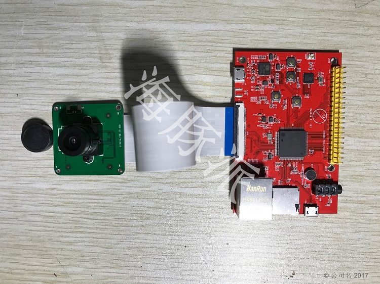

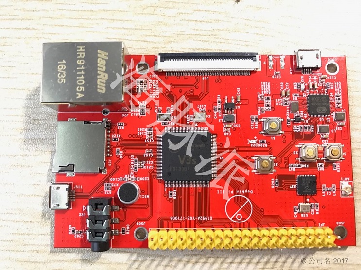

海豚派淘宝店配图:

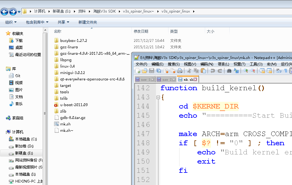

楼主 #2 2018-03-17 21:29:50
已发帖子: 9,445
Re: 【海豚派】海豚派 V3s 开发板资料预览
截图

楼主 #15 2018-03-21 19:57:14
已发帖子: 9,445
checking that generated files are newer than configure... done
configure: creating ./config.status
config.status: creating Makefile
config.status: creating etc/Makefile
config.status: creating plugins/Makefile
config.status: creating src/Makefile
config.status: creating tests/Makefile
config.status: creating tslib.pc
config.status: creating tslib-1.0.pc
config.status: creating config.h
config.status: config.h is unchanged
config.status: executing depfiles commands
config.status: executing libtool commands
cd . && /bin/bash /disk5/v3s_spinor_linux/tslib/missing automake-1.15 --gnu
/disk5/v3s_spinor_linux/tslib/missing: line 81: automake-1.15: command not found
WARNING: 'automake-1.15' is missing on your system.
         You should only need it if you modified 'Makefile.am' or
         'configure.ac' or m4 files included by 'configure.ac'.
         The 'automake' program is part of the GNU Automake package:
         <http://www.gnu.org/software/automake>
         It also requires GNU Autoconf, GNU m4 and Perl in order to run:
         <http://www.gnu.org/software/autoconf>
         <http://www.gnu.org/software/m4/>
         <http://www.perl.org/>
make: *** [Makefile.in] Error 1
CDPATH="${ZSH_VERSION+.}:" && cd . && /bin/bash /disk5/v3s_spinor_linux/tslib/missing autoconf
make: *** Waiting for unfinished jobs....
Build ts lib error!!
./mk.sh: line 195: exit: 1tools: numeric argument required
hexing@ubuntu:/disk5/v3s_spinor_linux$
参考: https://github.com/satoken/centroid-rna-package/issues/4
sudo apt-get install autotools-dev
sudo apt-get install automake
sudo apt-get install boost libboost-all-dev
楼主 #16 2018-03-21 20:08:53
已发帖子: 9,445
‘chips/sun8iw8p1/configs/dophin_pi/boot-resource/logo/shutdown_logo.JPG’ -> ‘out/shutdown_logo.fex’
do_common
/disk5/v3s_spinor_linux/tools/pack/out
Create sys_partition_nor.fex
LINUXQT_IMAGE_OUT=
packing for linux qt
do_finish
Start merge_package
input file : boot0_spinor.fex
file len=16384
input file : u-boot-spinor.fex
input file : sunxi_mbr.fex
file len=16384
input file : boot.fex
input file : rootfs.fex
input file : cfg.fex
input file : boot_logo.fex
input file : shutdown_logo.fex
input file : env.fex
this is not a partition key
sys parition end
End merge_package
/disk5/v3s_spinor_linux/tools/pack/pctools/linux/eDragonEx/
Begin Parse sys_partion.fex
Add partion boot.fex BOOT_FEX00000000
Add partion very boot.fex BOOT_FEX00000000
FilePath: boot.fex
FileLength=27e638Add partion rootfs.fex ROOTFS_FEX000000
Add partion very rootfs.fex ROOTFS_FEX000000
FilePath: rootfs.fex
FileLength=88ce34Add partion cfg.fex CFG_FEX000000000
Add partion very cfg.fex CFG_FEX000000000
FilePath: cfg.fex
FileLength=10000Add partion boot_logo.fex BOOT_LOGO_FEX000
Add partion very boot_logo.fex BOOT_LOGO_FEX000
FilePath: boot_logo.fex
FileLength=8378Add partion shutdown_logo.fex SHUTDOWN_LOGO_FEX
Add partion very shutdown_logo.fex SHUTDOWN_LOGO_FEX
FilePath: shutdown_logo.fex
FileLength=5948Add partion env.fex ENV_FEX000000000
Add partion very env.fex ENV_FEX000000000
FilePath: env.fex
FileLength=10000sys_config.fex Len: 0xd6c0
config.fex Len: 0x8000
split_xxxx.fex Len: 0x200
sys_partition.fex Len: 0xa6a
boot0_spinor.fex Len: 0x4000
boot0_sdcard.fex Len: 0x6000
u-boot.fex Len: 0x80000
fes1.fex Len: 0x25a0
full_img.fex Len: 0xec0000
usbtool.fex Len: 0x23000
aultools.fex Len: 0x26ead
aultls32.fex Len: 0x238dd
cardtool.fex Len: 0x14000
cardscript.fex Len: 0x6ea
sunxi_mbr.fex Len: 0x4000
dlinfo.fex Len: 0x4000
boot.fex Len: 0x27e638
Vboot.fex Len: 0x4
rootfs.fex Len: 0x88ce34
Vrootfs.fex Len: 0x4
cfg.fex Len: 0x10000
Vcfg.fex Len: 0x4
boot_logo.fex Len: 0x8378
Vboot_logo.fex Len: 0x4
shutdown_logo.fex Len: 0x5948
Vshutdown_logo.fex Len: 0x4
env.fex Len: 0x10000
Venv.fex Len: 0x4
BuildImg 0
Dragon execute image.cfg SUCCESS !
/disk5/v3s_spinor_linux/tools/pack/sun8iw8p1_linux_qt_dophin_pi_uart0_none.img
pack finish
基本没怎么操心, 编译完成了。

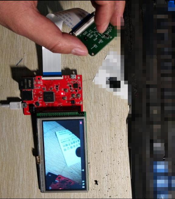

楼主 #17 2018-03-23 21:20:45
已发帖子: 9,445
