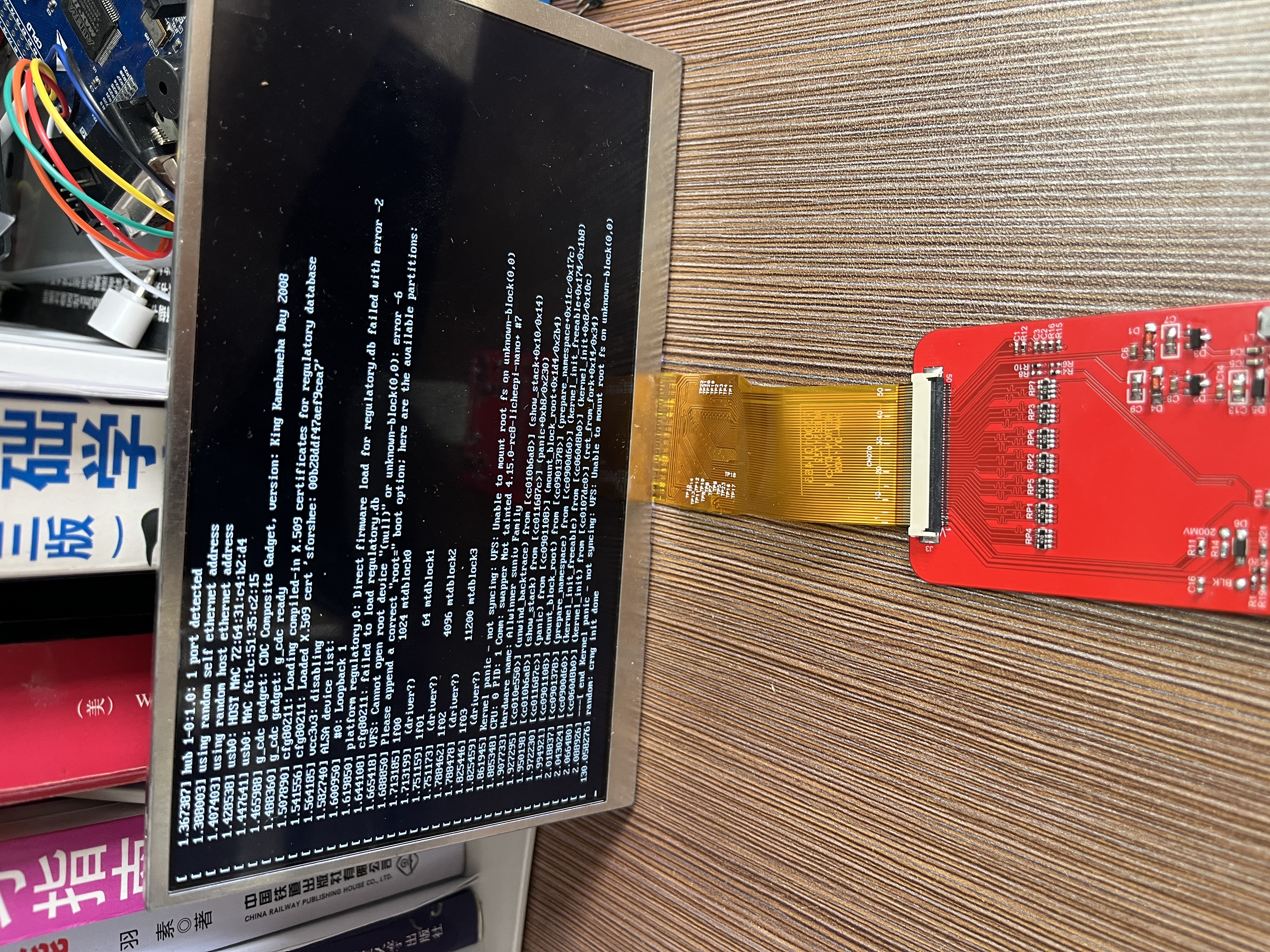

更换正点原子7寸RGB LCD(1024*600),启动失败
U-boot配置(生成.config文件):
CONFIG_VIDEO_SUNXI=y
CONFIG_VIDEO_LCD_MODE="x:1024,y:600,depth:24,pclk_khz:33000,le:140,ri:160,up:20,lo:12,hs:20,vs:3,sync:3,vmode:0"
设备树修改(suniv-f1c100s-licheepi-nano.dts):
	panel: panel {
		compatible = "ab,ab7_inch", "simple-panel";    //原compatible = "lg,lb070wv8", "simple-panel";
		#address-cells = <1>;
		#size-cells = <0>;
		enable-gpios = <&pio 4 6 GPIO_ACTIVE_HIGH>;
		port@0 {
			reg = <0>;
			#size-cells = <0>;
			panel_input: endpoint@0 {
				reg = <0>;
panel-simple.c添加:
static const struct of_device_id platform_of_match[] = {
		.compatible = "ampire,am-480272h3tmqw-t01h",
		.data = &ampire_am_480272h3tmqw_t01h,
		.compatible = "urt,umsh-8596md-19t",
		.data = &urt_umsh_8596md_lvds,
		.compatible = "ab,ab7_inch",     //添加部分
		.data = &ab7_inch                    //添加部分
		/* sentinel */
static const struct drm_display_mode ab7_inch_mode = {
	.clock = 51000,
	.hdisplay = 1024,
	.hsync_start = 1024 + 160,
	.hsync_end = 1024 + 160 + 20,
	.htotal = 1024 + 160 + 20 + 140,
	.vdisplay = 600,
	.vsync_start = 600 + 12,
	.vsync_end = 600 + 12 + 3,
	.vtotal = 600 + 12 + 3 + 20,
	.vrefresh = 60,
static const struct panel_desc ab7_inch = {
	.modes = &ab7_inch_mode,
	.num_modes = 1,
	.bpc = 6,
	.size = {
		.width = 154,
		.height = 85,
	.bus_format = MEDIA_BUS_FMT_RGB888_1X7X4_SPWG,
启动打印信息:
U-Boot 2018.01-05688-ga9729b3241-dirty (Aug 11 2022 - 09:50:01 +0800) Allwinner Technology
Model: Lichee Pi Nano
DRAM:  32 MiB
MMC:   SUNXI SD/MMC: 0
SF: Detected xt25f128b with page size 256 Bytes, erase size 4 KiB, total 16 MiB
Setting up a 1024x600 lcd console (overscan 0x0)
In:    serial@1c25000
Out:   serial@1c25000
Err:   serial@1c25000
Net:   No ethernet found.
starting USB...
No controllers found
   Loading Device Tree to 816fb000, end 816fffab ... OK

[    1.093849] sun4i-drm display-engine: bound 1e60000.display-backend (ops 0xc0736c38)
[    1.102542] sun4i-drm display-engine: bound 1c0c000.lcd-controller (ops 0xc0735f1c)
[    1.110334] [drm] Supports vblank timestamp caching Rev 2 (21.10.2013).
[    1.116986] [drm] No driver support for vblank timestamp query.
[    1.125324] sun4i-drm display-engine: Failed to set initial hw configuration.
[    1.132594] sun4i-drm display-engine: Couldn't create our framebuffer
[    1.139578] sun4i-drm display-engine: master bind failed: -12
[    1.145800] sun4i-tcon: probe of 1c0c000.lcd-controller failed with error -12
[    1.154286] usb_phy_generic usb_phy_generic.0.auto: usb_phy_generic.0.auto supply vcc not found, using dummy regulator
[    1.165940] musb-hdrc musb-hdrc.1.auto: MUSB HDRC host driver
[    1.171836] musb-hdrc musb-hdrc.1.auto: new USB bus registered, assigned bus number 1
[    1.182654] hub 1-0:1.0: USB hub found
[    1.186657] hub 1-0:1.0: 1 port detected
[    1.191726] using random self ethernet address
[    1.196180] using random host ethernet address
[    1.202046] usb0: HOST MAC 5a:68:2a:fe:d5:eb
[    1.206401] usb0: MAC c2:16:41:d1:5d:8a
[    1.210413] g_cdc gadget: CDC Composite Gadget, version: King Kamehameha Day 2008
[    1.217941] g_cdc gadget: g_cdc ready
[    1.222334] cfg80211: Loading compiled-in X.509 certificates for regulatory database
[    1.236123] cfg80211: Loaded X.509 cert 'sforshee: 00b28ddf47aef9cea7'
[    1.242897] Internal error: Oops - undefined instruction: 0 [#1] ARM

修改1024*600屏,串口打印:
[    1.122378] sun4i-drm display-engine: bound 1e60000.display-backend (ops 0xc0736c38)
[    1.131387] sun4i-drm display-engine: bound 1c0c000.lcd-controller (ops 0xc0735f1c)
[    1.139285] [drm] Supports vblank timestamp caching Rev 2 (21.10.2013).
[    1.145948] [drm] No driver support for vblank timestamp query.
[    1.154931] sun4i-drm display-engine: Failed to set initial hw configuration.
[    1.162310] sun4i-drm display-engine: Couldn't create our framebuffer
[    1.169467] sun4i-drm display-engine: master bind failed: -12
[    1.175841] sun4i-tcon: probe of 1c0c000.lcd-controller failed with error -12
查询问题后,应该是存储空间太小引起,参考:
https://whycan.com/t_7527.html
skliu wrote:
CONFIG_FORCE_MAX_ZONEORDER=12
暂时修改这个搞定。
修改CONFIG_FORCE_MAX_ZONEORDER=12,解决问题!
