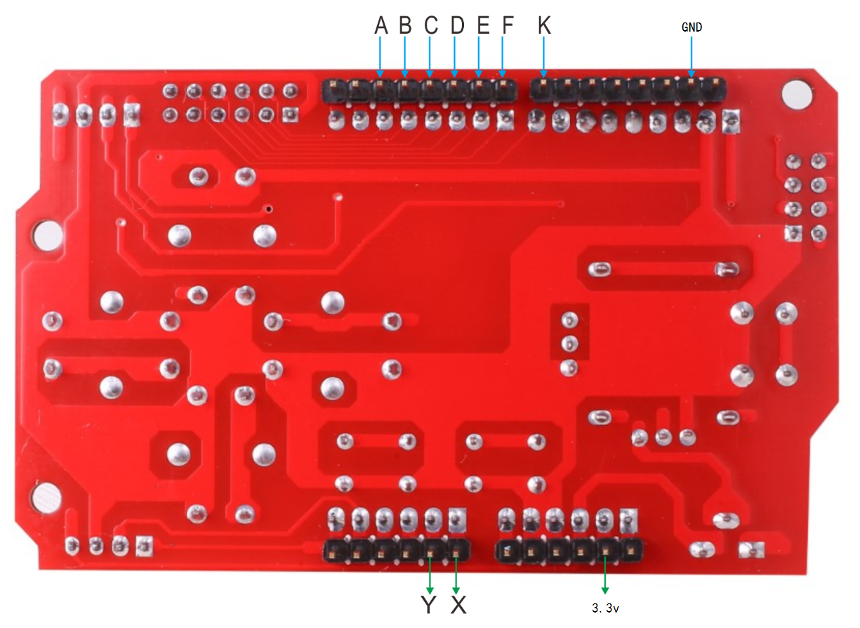

joystick接线方法如下:

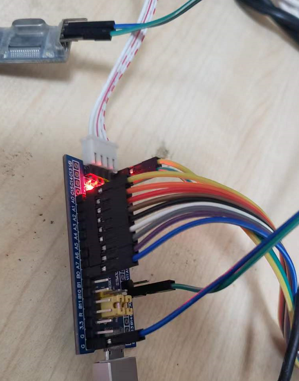

stm32接线方法:
//Funduino joystick 所用到的所有IO定义如下
	PA0 Y (模拟)  2路ADC
	PA1 X (模拟)
	PA2 A  6个按钮
	PA3 B
	PA4 C
	PA5 D
	PA6 E
	PA7 F
	PB0 K  1个按钮当Z轴
#define BTN1_Pin 					GPIO_PIN_2
#define BTN1_GPIO_Port 		GPIOA
#define BTN2_Pin 					GPIO_PIN_3
#define BTN2_GPIO_Port 		GPIOA
#define BTN3_Pin 					GPIO_PIN_4
#define BTN3_GPIO_Port 		GPIOA
#define BTN4_Pin 					GPIO_PIN_5
#define BTN4_GPIO_Port 		GPIOA
#define BTN5_Pin				 	GPIO_PIN_6
#define BTN5_GPIO_Port 		GPIOA
#define BTN6_Pin 					GPIO_PIN_7
#define BTN6_GPIO_Port 		GPIOA
//6个按钮定义完成
//K键=Z
#define BTNK_Pin 					GPIO_PIN_0
#define BTNK_GPIO_Port 		GPIOB

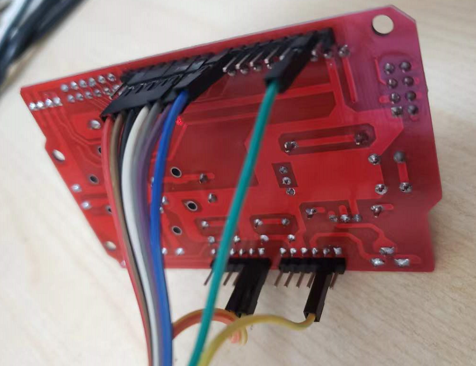

接线实物
joystick端:
stm32端:
