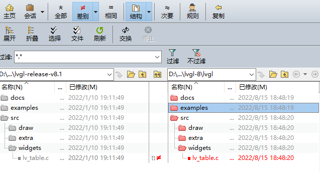

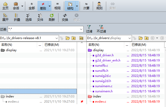

全志SDK里面V853 lvgl项目的适配.
最近编辑记录 ubuntu (2022-12-07 10:50:32)

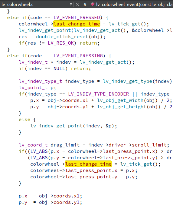

    else if(code == LV_EVENT_PRESSED) {
        colorwheel->last_change_time = lv_tick_get();
        lv_indev_get_point(lv_indev_get_act(), &colorwheel->last_press_point);
        res = double_click_reset(obj);
        if(res != LV_RES_OK) return;
    else if(code == LV_EVENT_PRESSING) {
        lv_indev_t * indev = lv_indev_get_act();
        if(indev == NULL) return;
        lv_indev_type_t indev_type = lv_indev_get_type(indev);
        lv_point_t p;
        if(indev_type == LV_INDEV_TYPE_ENCODER || indev_type == LV_INDEV_TYPE_KEYPAD) {
            p.x = obj->coords.x1 + lv_obj_get_width(obj) / 2;
            p.y = obj->coords.y1 + lv_obj_get_height(obj) / 2;
        else {
            lv_indev_get_point(indev, &p);
        lv_coord_t drag_limit = indev->driver->scroll_limit;
        if((LV_ABS(p.x - colorwheel->last_press_point.x) > drag_limit) ||
           (LV_ABS(p.y - colorwheel->last_press_point.y) > drag_limit)) {
            colorwheel->last_press_point.x = p.x;
            colorwheel->last_press_point.y = p.y;
        p.x -= obj->coords.x1;
        p.y -= obj->coords.y1;
        /*Ignore pressing in the inner area*/
        uint16_t w = lv_obj_get_width(obj);
        int16_t angle = 0;
        lv_coord_t cir_w = lv_obj_get_style_arc_width(obj, LV_PART_MAIN);
LVGL双击实现 double click
最近编辑记录 ubuntu (2022-12-23 19:35:49)
