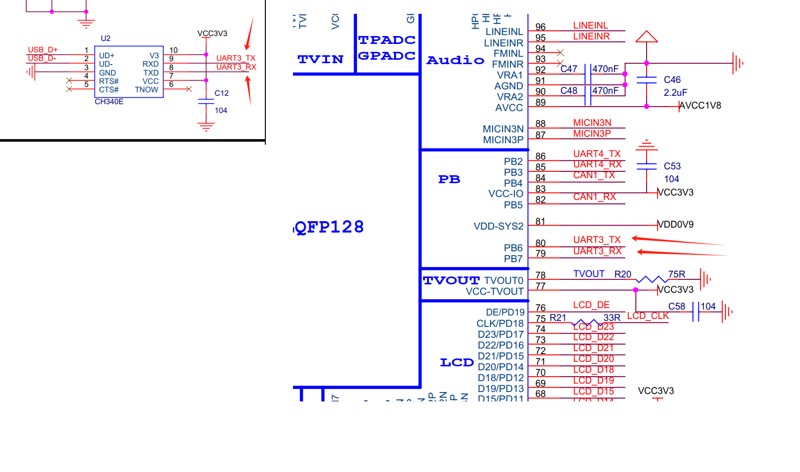

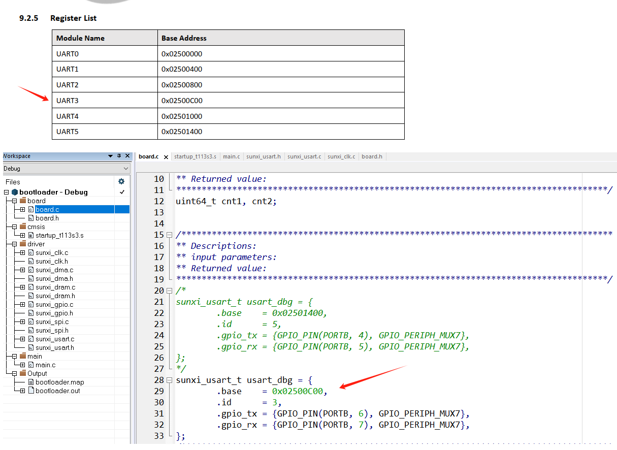

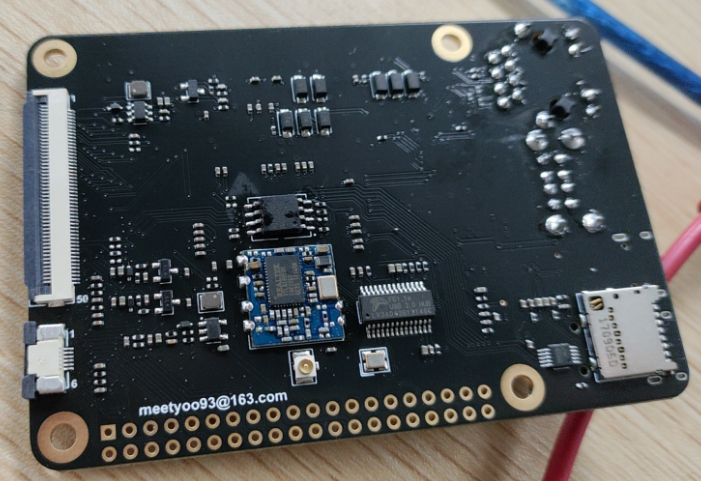

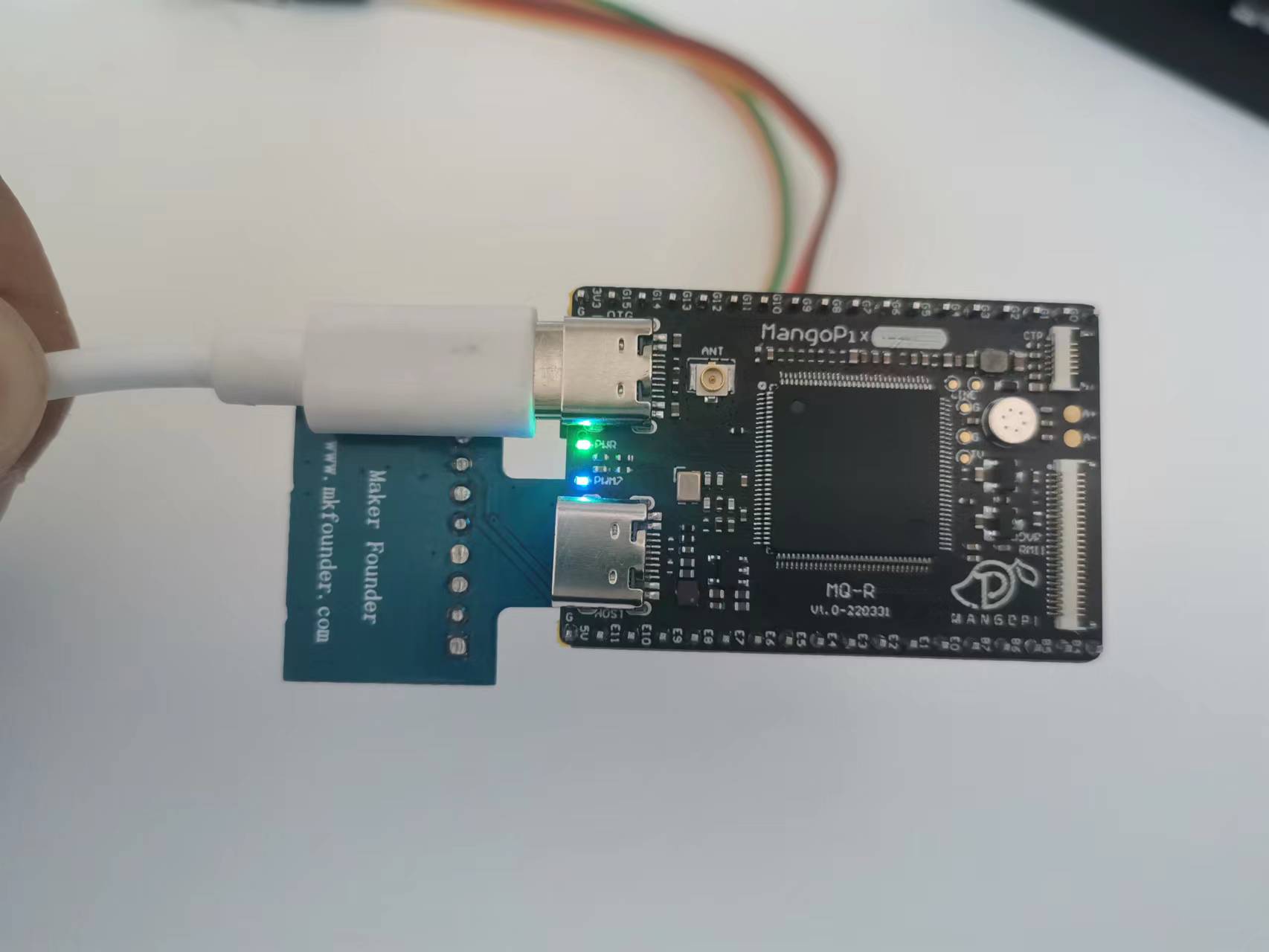

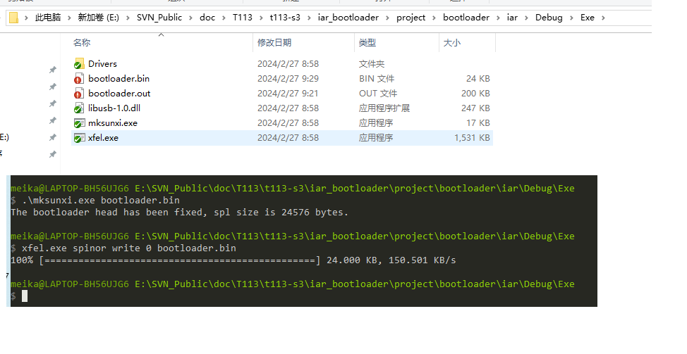

Re: 分享一个自己做的T113-S3裸机IAR工程,有bootloader和led闪烁demo
我是买的开发板,板载SPI Nand,已经修改为SPI nor。
板子用的是uart3,所以修改了一下代码。
编译,处理头部,烧录
结果,灯亮了,但是串口没信息。

@LinjieGuo
看看串口3的时钟打开了没
串口3的时钟应该是开了,工程里面根据id作为偏移量开启时钟的。
void sunxi_usart_init(sunxi_usart_t *usart)
  uint32_t addr;
  uint32_t val;
  /* Config usart TXD and RXD pins */
  sunxi_gpio_init(usart->gpio_tx.pin, usart->gpio_tx.mux);
  sunxi_gpio_init(usart->gpio_rx.pin, usart->gpio_rx.mux);
  /* Open the clock gate for usart */
  addr = T113_CCU_BASE + CCU_USART_BGR_REG;
  val	 = read32(addr);
  val |= 1 << usart->id;
  write32(addr, val);
  /* Deassert USART reset */
  val	 = read32(addr);
  val |= 1 << (16 + usart->id);
  write32(addr, val);
  /* Config USART to 115200-8-1-0 */
  addr = usart->base;
  write32(addr + 0x04, 0x0);
  write32(addr + 0x08, 0xf7);
  write32(addr + 0x10, 0x0);
  val = read32(addr + 0x0c);
  val |= (1 << 7);
  write32(addr + 0x0c, val);
  write32(addr + 0x00, 0xd & 0xff);
  write32(addr + 0x04, (0xd >> 8) & 0xff);
  val &= ~(1 << 7);
  val &= ~0x1f;
  val |= (0x3 << 0) | (0 << 2) | (0x0 << 3);
时钟相关代码应该是这几行。
  val     = read32(addr);
  write32(addr, val);
  val     = read32(addr);
  write32(addr, val);
最近编辑记录 LinjieGuo (2024-02-27 13:40:32)
#43 2024-02-28 10:04:46
506826164@qq.com
注册时间: 2022-08-07
已发帖子: 67
积分: 82
@LinjieGuo
我手上只有D1s,测试了下PB6 PB7上uart3,打印正常,两个芯片pin to pin,t113s3应该问题不大,参考下xboot中t113s3 uart代码

mksunxi.exe bootloader.bin 出错
The bootloader head has been fixed, spl size is -455278592 bytes
