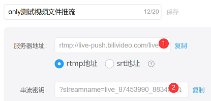

3. 去 bilibili开直播
推流地址是 ① + ②

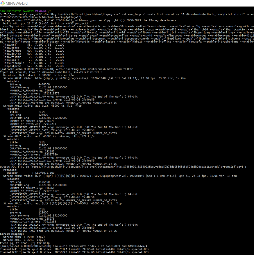

4. 命令行执行:
"D:\Downloads\ffmpeg-2023-05-08-git-2d43c23b81-full_build\bin\ffmpeg.exe" \
-stream_loop -1 -safe 0 -f concat -i "E:\Downloads\bilbili_live\filelist.txt" \
-vcodec copy -acodec copy -f flv \
"rtmp://live-push.bilivideo.com/live-bvc/?streamname=live_87453990_8834092&key=d6ce52b73db05365c5d529c5b0dec8c1&schedule=rtmp&pflag=1"
楼主 #1 2023-05-21 18:47:59
已发帖子: 3,393
Re: windows 平台FFMPEG 直接推流,哔哩哔哩(bilibili)开视频直播
推流成功:
51633@DESKTOP-8AVNF99 MINGW64 /d
$ "D:\Downloads\ffmpeg-2023-05-08-git-2d43c23b81-full_build\bin\ffmpeg.exe" -stream_loop -1 -safe 0 -f concat -i "E:\Downloads\bilbili_live\filelist.txt" -vcodec copy -acodec copy -f flv "rtmp://live-push.bilivideo.com/live-bvc/?streamname=live_87453990_8834092&key=d6ce52b73db05365c5d529c5b0dec8c1&schedule=rtmp&pflag=1"

Stream mapping:
  Stream #0:0 -> #0:0 (copy)
  Stream #0:1 -> #0:1 (copy)
Press [q] to stop, [?] for help
[in#0/concat @ 000002b016c8e800] New audio stream with index 2 at pos:15039 and DTS:0sed=N/A
frame= 2100 fps=120 q=-1.0 size=   39773kB time=00:01:27.80 bitrate=3710.6kbits/s speed=5.03x

frame=1369038 fps= 63 q=-1.0 size=39847858kB time=15:51:41.31 bitrate=frame=1369040 fps= 63 q=-1.0 size=39847955kB time=15:51:41.33 bitrate=frame=1369045 fps= 63 q=-1.0 size=39848268kB time=15:51:41.68 bitrate=frame=1369051 fps= 63 q=-1.0 size=39848583kB time=15:51:41.78 bitrate=frame=1369071 fps= 63 q=-1.0 size=39848903kB time=15:51:42.79 bitrate=frame=1369088 fps= 63 q=-1.0 size=39849110kB time=15:51:43.49 bitrate=frame=1369129 fps= 63 q=-1.0 size=39849465kB time=15:51:45.03 bitrate=frame=1369155 fps= 63 q=-1.0 size=39849907kB time=15:51:46.20 bitrate=frame=1369182 fps= 63 q=-1.0 size=39850172kB time=15:51:47.46 bitrate=frame=1369205 fps= 63 q=-1.0 size=39850575kB time=15:51:48.20 bitrate=frame=1369207 fps= 63 q=-1.0 size=39850600kB time=15:51:48.35 bitrate=frame=1369223 fps= 63 q=-1.0 size=39850762kB time=15:51:49.04 bitrate=frame=1369236 fps= 63 q=-1.0 size=39850868kB time=15:51:49.57 bitrate=frame=1369245 fps= 63 q=-1.0 size=39850966kB time=15:51:49.91 bitrate=av_interleaved_write_frame(): Error number -10054 occurred
[out#0/flv @ 000001c997a6be00] Error muxing a packet
frame=1369257 fps= 63 q=-1.0 size=39851059kB time=15:51:50.42 bitrate=[flv @ 000001c998015440] Failed to update header with correct duration.
[flv @ 000001c998015440] Failed to update header with correct filesize.
[out#0/flv @ 000001c997a6be00] Error writing trailer: Error number -10054 occurred
[out#0/flv @ 000001c997a6be00] Error closing file: Error number -10054 occurred
[out#0/flv @ 000001c997a6be00] video:38887853kB audio:892194kB subtitle:0kB other streams:0kB global headers:0kB muxing overhead: 0.178915%
frame=1369257 fps= 63 q=-1.0 Lsize=39851220kB time=15:51:50.45 bitrate=5716.3kbits/s speed=2.64x
Conversion failed!
ffmpeg直接推rtmp流到bilibili服务器,如果碰到网络10054 问题会退出进程,所以上面的脚本需要优化一下,或者配合nginx推流。
