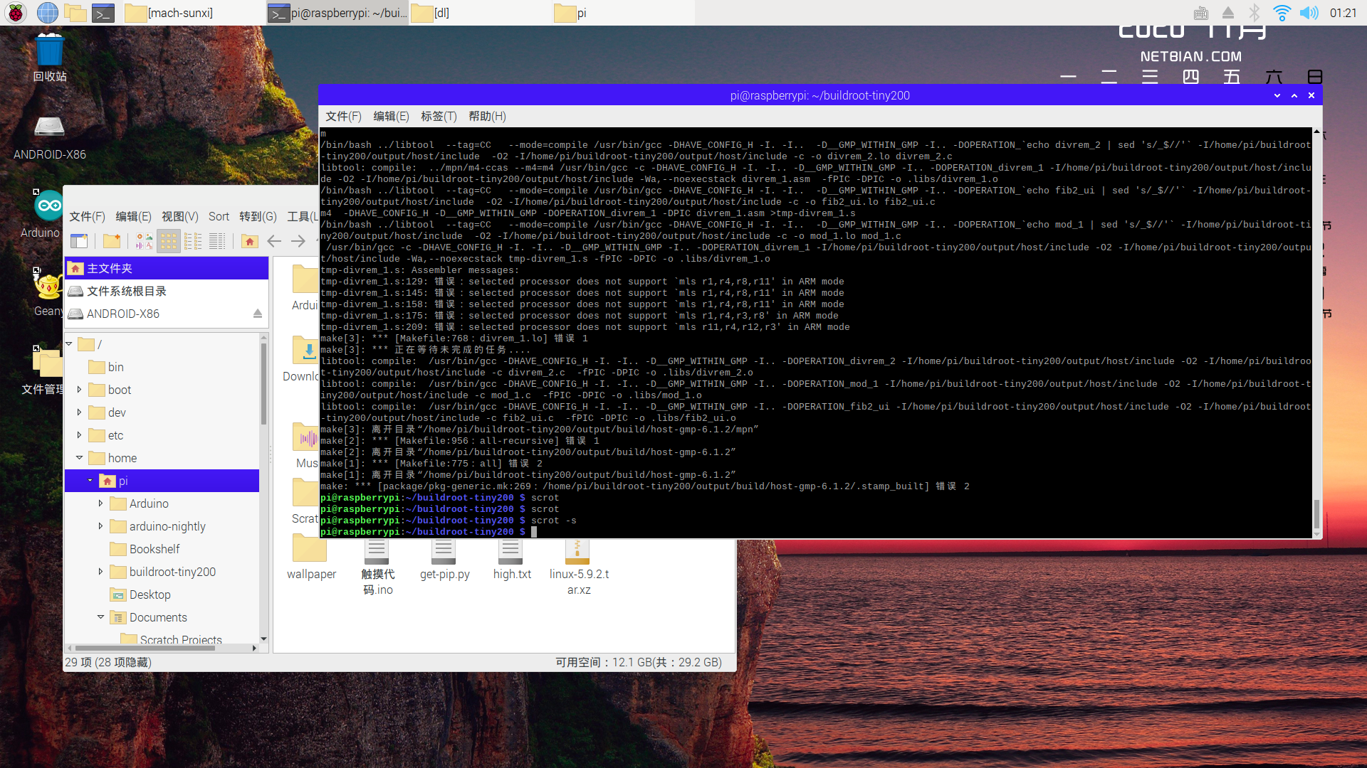

编译Buildroot-tiny200时出现错误,请大佬指教,急急!!!!!!!!!!!!!!!!!!!!!!!1 (平台: 树梅派)
最近想学习嵌入式Linux开发,本人接触了这一款F1c200s芯片。
  特地从GitHub下载了aodzip的buildroot-tiny200源代码,也下载了dl包,
在树梅派上进行编译,过程如下:
1) make widora_tiny200_defconfig
2) make -j4
出现以下错误:

tmp-divrem_1.s: Assembler messages:
tmp-divrem_1.s:129: 错误:selected processor does not support `mls r1,r4,r8,r11' in ARM mode
tmp-divrem_1.s:145: 错误:selected processor does not support `mls r1,r4,r8,r11' in ARM mode
tmp-divrem_1.s:158: 错误:selected processor does not support `mls r1,r4,r8,r11' in ARM mode
tmp-divrem_1.s:175: 错误:selected processor does not support `mls r1,r4,r3,r8' in ARM mode
tmp-divrem_1.s:209: 错误:selected processor does not support `mls r11,r4,r12,r3' in ARM mode
make[3]: *** [Makefile:768:divrem_1.lo] 错误 1
make[3]: *** 正在等待未完成的任务....
make[3]: 离开目录“/home/pi/buildroot-tiny200/output/build/host-gmp-6.1.2/mpn”
make[2]: *** [Makefile:956:all-recursive] 错误 1
make[2]: 离开目录“/home/pi/buildroot-tiny200/output/build/host-gmp-6.1.2”
make[1]: *** [Makefile:775:all] 错误 2
make[1]: 离开目录“/home/pi/buildroot-tiny200/output/build/host-gmp-6.1.2”
make: *** [package/pkg-generic.mk:269:/home/pi/buildroot-tiny200/output/build/host-gmp-6.1.2/.stamp_built] 错误 2
pi@raspberrypi:~/buildroot-tiny200 $
请指教。。
平台: 树梅派
交叉编译器:树梅派自带的gcc-arm-gnueabihf

我估计buildroot默认是在x86平台跑的,那些host工具默认使用x86汇编指令,如果你要整个buildroot都能在树莓派跑,可能要大改才行。

既然是用树莓派整,我99.9999%相信楼主是在玩(aka学习),那就不要“急急!!!!!!!!!!!!!!!!!!!!!!!1 ”
建议用树莓派跑个x86环境试试,
https://www.raspberrypi.org/forums/viewtopic.php?t=246886
