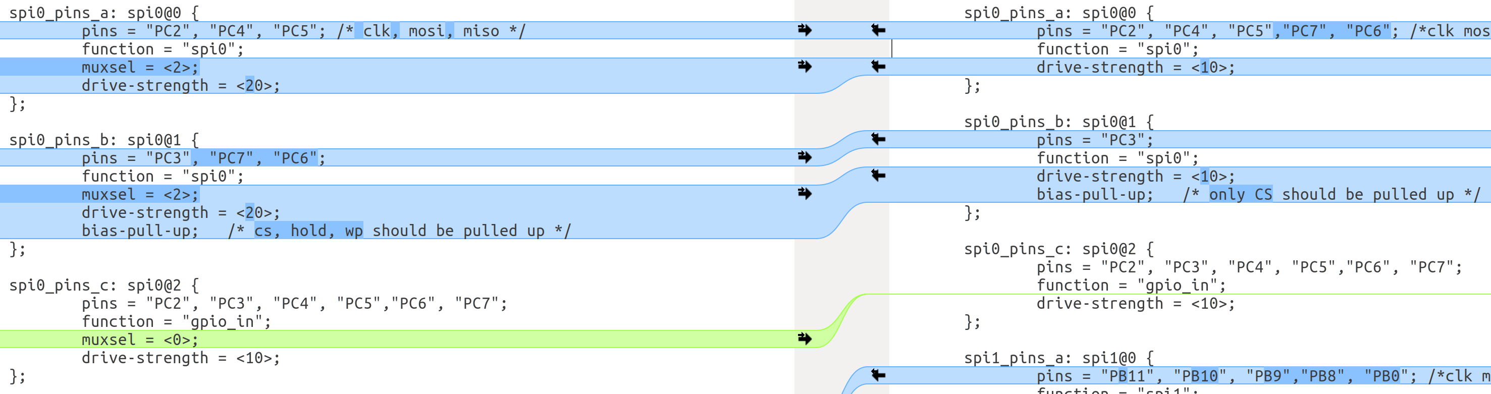

#5 2024-07-13 21:45:45
memory
注册时间: 2021-08-11
已发帖子: 705
积分: 680
Re: 200s spinand-ubifs文件系统无法挂载

#9 2024-07-15 09:43:10
memory
注册时间: 2021-08-11
已发帖子: 705
积分: 680
改dts搞定了,什么情况一脸懵逼???
由:
	spi0_pins_a: spi0@0 {
		pins = "PC2", "PC4", "PC5","PC7", "PC6"; /*clk mosi miso hold wp*/
		function = "spi0";
		drive-strength = <10>;
	spi0_pins_b: spi0@1 {
		pins = "PC3";
		function = "spi0";
		bias-pull-up;   /* only CS should be pulled up */
	spi0_pins_c: spi0@2 {
		pins = "PC2", "PC3", "PC4", "PC5","PC6", "PC7";
		function = "gpio_in";
改成:
		pins = "PC2", "PC4", "PC5"; /* clk, mosi, miso */
		function = "spi0";
		muxsel = <2>;
		drive-strength = <20>;
		pins = "PC3", "PC7", "PC6";
		function = "spi0";
		muxsel = <2>;
		bias-pull-up;   /* cs, hold, wp should be pulled up */
		muxsel = <0>;
