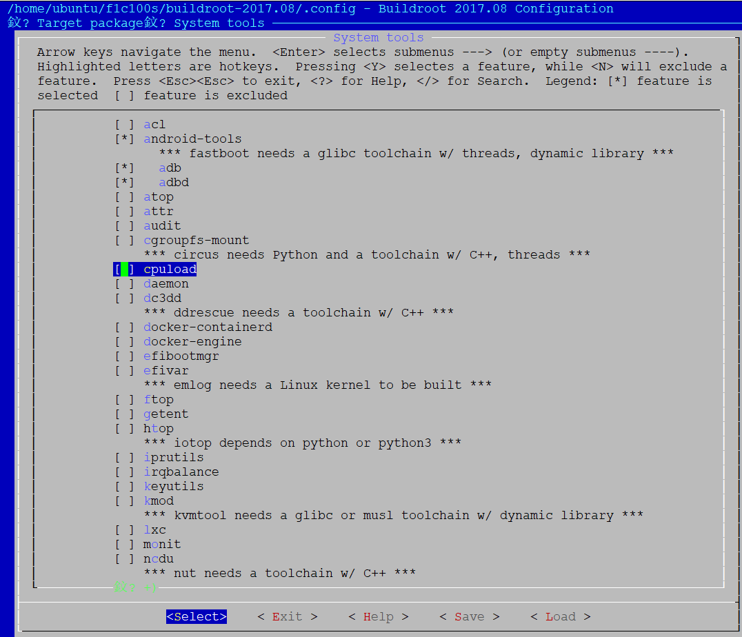

分享个licheepi nano镜像,支持adb调试
烧写参考这里:https://whycan.cn/t_2179.html
其中,boot.scr、zImage、xx.dtb放到第一分区(FAT16),解压rootfs.tar到第二分区(ext4)
启动到uboot,执行命令:run distro_bootcmd 加载内核
启动到shell,执行命令:sh run_adbd.sh 运行adbd
最后,插入电脑,会看到一个ADB Interface设备
nano-adbd4_14-exp.rar
楼主 #2 2019-08-22 21:48:26
checkout
注册时间: 2018-11-09
已发帖子: 173
积分: 168
Re: 分享个licheepi nano镜像,支持adb调试

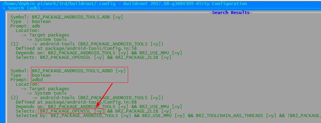

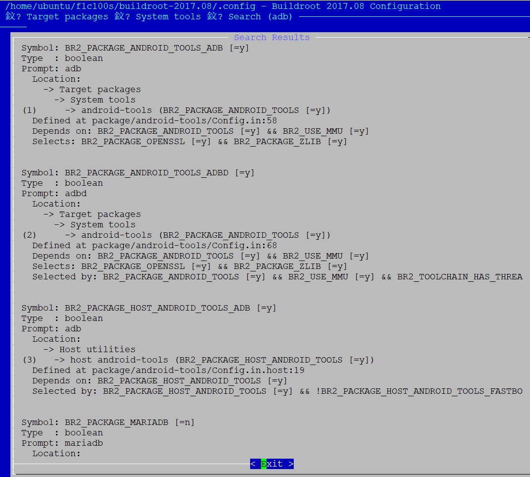

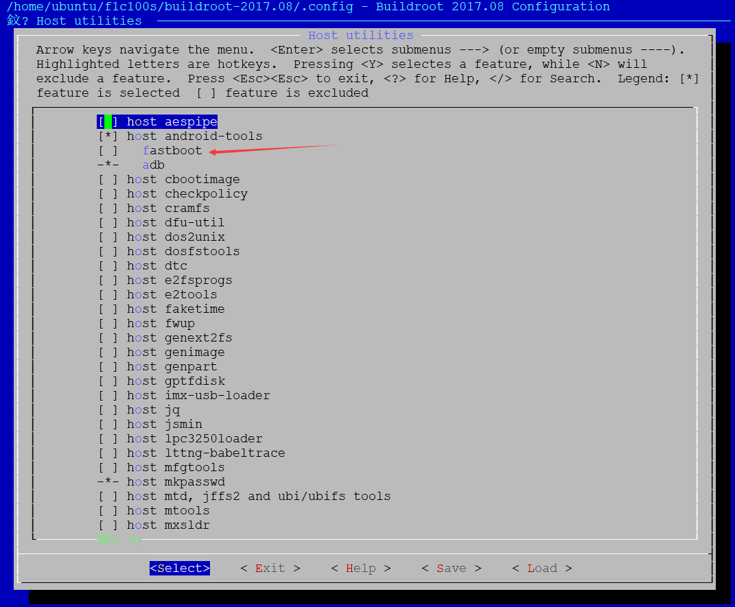

adbd的移植,buildroot配置adb-tools即可
内核配置文件nano_kernel_config.tgz(不是压缩文件,直接改名.config替换即可)

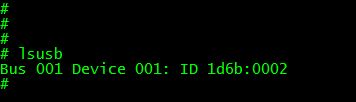

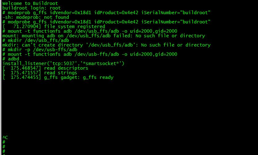

这个弄进去有问题,:
#  run_adbd.sh
mkdir: can't create directory '/sys/kernel/config/usb_gadget/g1': No such file or directory
/bin/run_adbd.sh: line 12: can't create /sys/kernel/config/usb_gadget/g1/idVendor: nonexistent directory
/bin/run_adbd.sh: line 13: can't create /sys/kernel/config/usb_gadget/g1/idProduct: nonexistent directory
mkdir: can't create directory '/sys/kernel/config/usb_gadget/g1/strings/0x409': No such file or directory
/bin/run_adbd.sh: line 19: can't create /sys/kernel/config/usb_gadget/g1/strings/0x409/serialnumber: nonexistent directory
/bin/run_adbd.sh: line 20: can't create /sys/kernel/config/usb_gadget/g1/strings/0x409/manufacturer: nonexistent directory
/bin/run_adbd.sh: line 21: can't create /sys/kernel/config/usb_gadget/g1/strings/0x409/product: nonexistent directory
mkdir: can't create directory '/sys/kernel/config/usb_gadget/g1/functions/ffs.adb': No such file or directory
mkdir: can't create directory '/sys/kernel/config/usb_gadget/g1/configs/b.1': No such file or directory
mkdir: can't create directory '/sys/kernel/config/usb_gadget/g1/configs/b.1/strings/0x409': No such file or directory
ln: /sys/kernel/config/usb_gadget/g1/configs/b.1: No such file or directory
/bin/run_adbd.sh: line 32: can't create /sys/kernel/config/usb_gadget/g1/configs/b.1/strings/0x409/configuration: nonexistent directory
[  952.353269] ------------[ cut here ]------------
[  952.357969] WARNING: CPU: 0 PID: 143 at fs/filesystems.c:282 get_fs_type+0xf8/0x110
[  952.365750] request_module fs-functionfs succeeded, but still no fs?
[  952.372147] Modules linked in: usb_f_fs libcomposite
[  952.377148] CPU: 0 PID: 143 Comm: mount Not tainted 4.14.0-licheepi-nano #7
[  952.384130] Hardware name: Allwinner suniv Family
[  952.388914] [<c010e8c0>] (unwind_backtrace) from [<c010ba10>] (show_stack+0x10/0x14)
[  952.396730] [<c010ba10>] (show_stack) from [<c0116a74>] (__warn+0xd4/0xfc)
[  952.403660] [<c0116a74>] (__warn) from [<c0116ad4>] (warn_slowpath_fmt+0x38/0x48)
[  952.411202] [<c0116ad4>] (warn_slowpath_fmt) from [<c01e618c>] (get_fs_type+0xf8/0x110)
[  952.419223] [<c01e618c>] (get_fs_type) from [<c01e9478>] (do_mount+0x1c0/0xb58)
[  952.426589] [<c01e9478>] (do_mount) from [<c01ea148>] (SyS_mount+0x54/0xc0)
[  952.433606] [<c01ea148>] (SyS_mount) from [<c0108060>] (ret_fast_syscall+0x0/0x44)
[  952.441201] ---[ end trace 803250e82eace444 ]---
mount: /dev/usb-ffs/adb: unknown filesystem type 'functionfs'.
# install_listener('tcp:5037','*smartsocket*')
Using USB

 mount -t configfs none /sys/kernel/config
#6 2019-08-23 10:29:49
firstman
注册时间: 2019-04-06
已发帖子: 279
积分: 279
加了, 但是电脑上仍然没有反应, 看来还是脚本不太对。

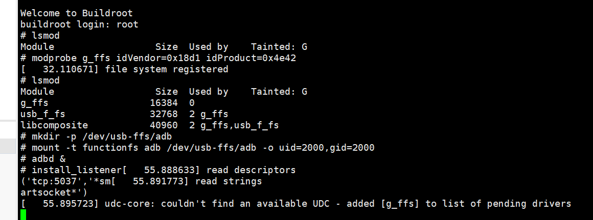

楼主 #7 2019-08-23 11:00:05
checkout
注册时间: 2018-11-09
已发帖子: 173
积分: 168
漏了,脚本如下:
#! /bin/sh
modprobe g_ffs idVendor=0x18d1 idProduct=0x4e42 iSerialNumber="buildroot"
mkdir -p /dev/usb-ffs/adb
mount -t functionfs adb /dev/usb-ffs/adb -o uid=2000,gid=2000
adbd &
firstman 说:
最近编辑记录 checkout (2019-08-23 11:01:03)

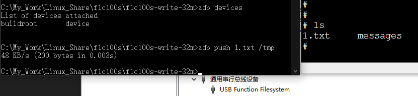

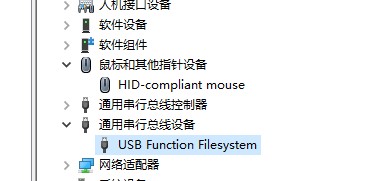

#8 2019-08-23 11:12:55
firstman
注册时间: 2019-04-06
已发帖子: 279
积分: 279
真可以了, 奔走相告 ^_^
adb shell/push/pull 都可以了
妈妈再也不用为我收发文件操心了。
感谢各位大神!
最近编辑记录 firstman (2019-08-23 11:16:23)
#9 2019-08-23 13:49:47
已发帖子: 9,436
我把楼主的文件写到TF卡, 然后 dump 出来一个 bin 文件, 大家可以测试下载: f1c100s_4_14_128M_tfcard_dump_bin.7z
解压后 dd 到 TF 卡即可:
sudo dd if=f1c100s_4.14_128M_tfcard_dump.bin of=/dev/sdX
1. 添加了可执行文件 etc/init.d/S50adbd
#! /bin/sh
adbd &
2. 免输入密码登录,  修改 etc/inittab
console::respawn:/sbin/getty -L  console 0 vt100 # GENERIC_SERIAL
改为:
console::respawn:-/bin/sh
这样处理之后, 插入USB就能自动进入ADB, 什么命令都不用输入了。

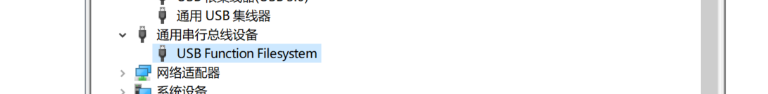

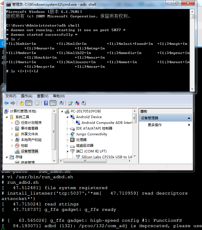

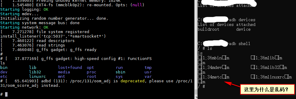

请教晕哥,用你提供的bin,进去之后是这个样子。adb这里显示乱码,正常吗
没玩过adb,可以干啥用,有简单的教程没...
最近编辑记录 Jmhh247 (2019-08-25 14:18:53)
#13 2019-08-25 14:52:18
已发帖子: 9,436
这个是正常的,因为 windows 自带的终端显示不支持 *nix 这种颜色终端显示,你下载一个 adb 版本的 putty 是没有问题的
换了个putty果然好了!

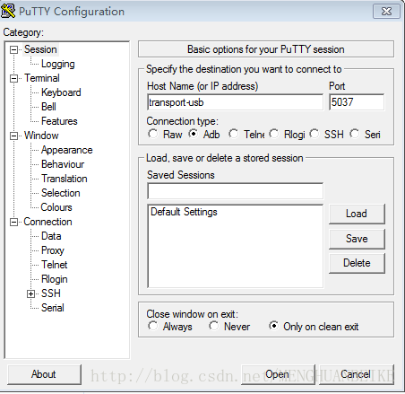

-连接方式选择 adb
-host上填"transport-usb"  引号不要(或者是别的连接字符串 具体查看 adb sockey interface 的文档)
-端口填 5037
配置如下:
adb版本 putty 下载地址: https://github.com/sztupy/adbputty/downloads

#19 2019-08-28 13:40:45
晕哥小弟
注册时间: 2019-04-04
已发帖子: 311
积分: 301.5

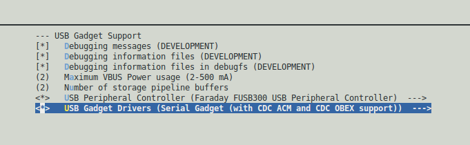

#20 2019-08-28 13:53:02
已发帖子: 9,436

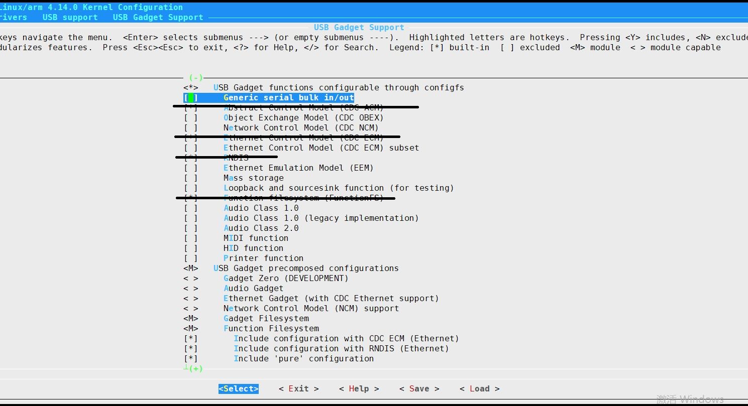

晕哥小弟 说:
没有用过, 方便传一个上来吗?

#22 2019-08-29 09:36:45
晕哥小弟
注册时间: 2019-04-04
已发帖子: 311
积分: 301.5

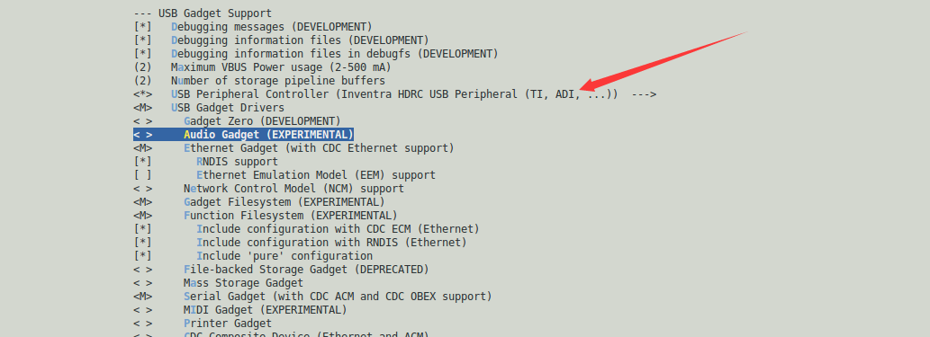

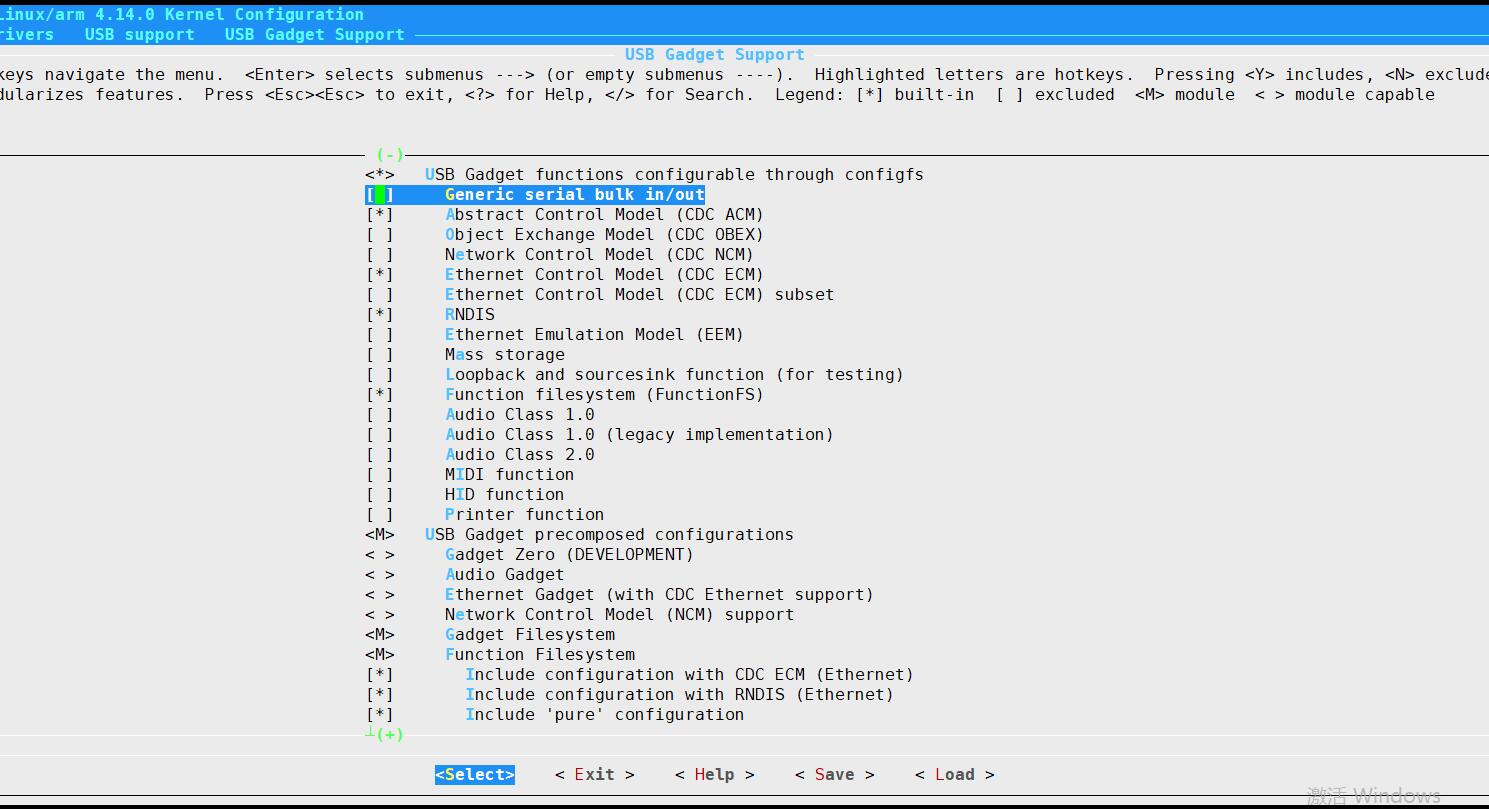

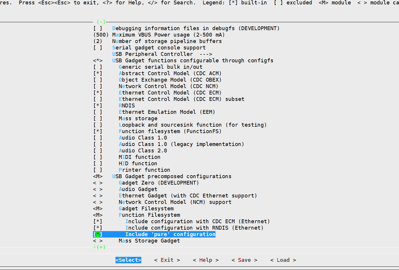

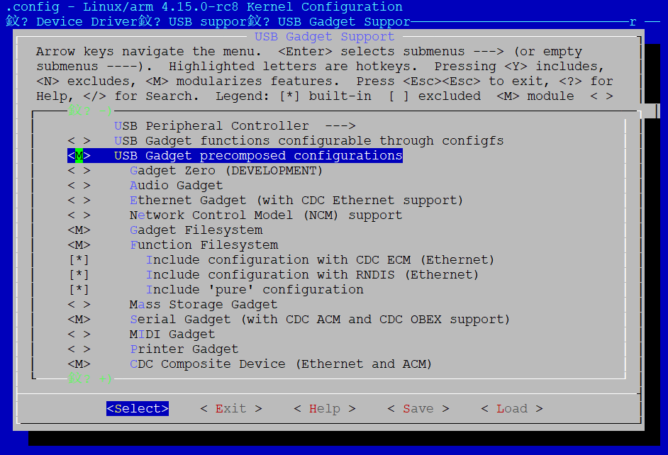

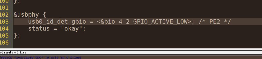

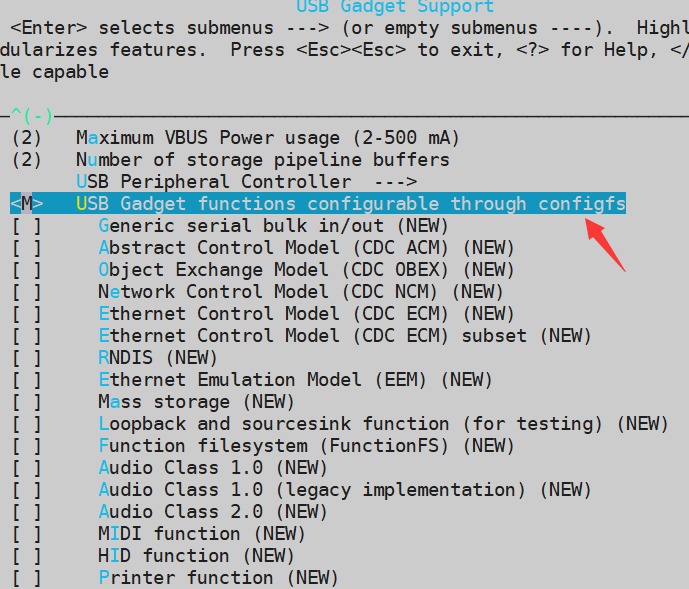

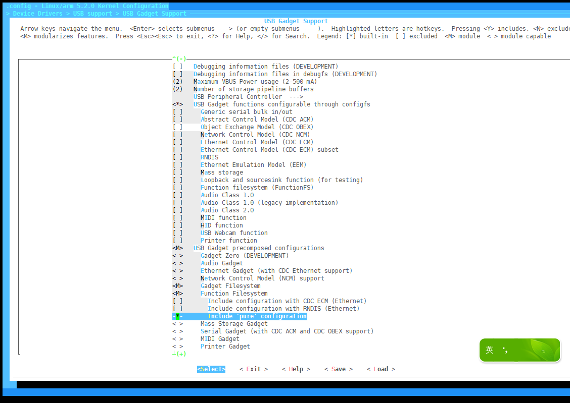

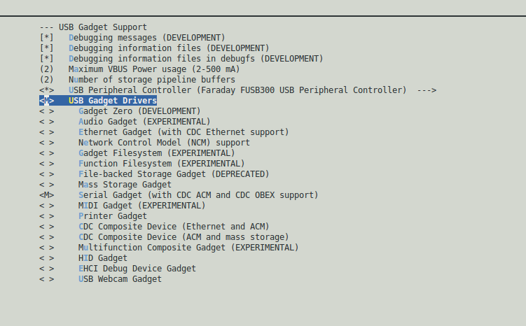

v3s 的gadget的配置部分,和楼上的配置不一样。找不到几个选项。
#23 2019-08-29 09:55:45
已发帖子: 9,436
你选中这个改成模块方式编译: M
晕哥小弟 说:
谢谢
#24 2019-08-29 09:59:43
晕哥小弟
注册时间: 2019-04-04
已发帖子: 311
积分: 301.5

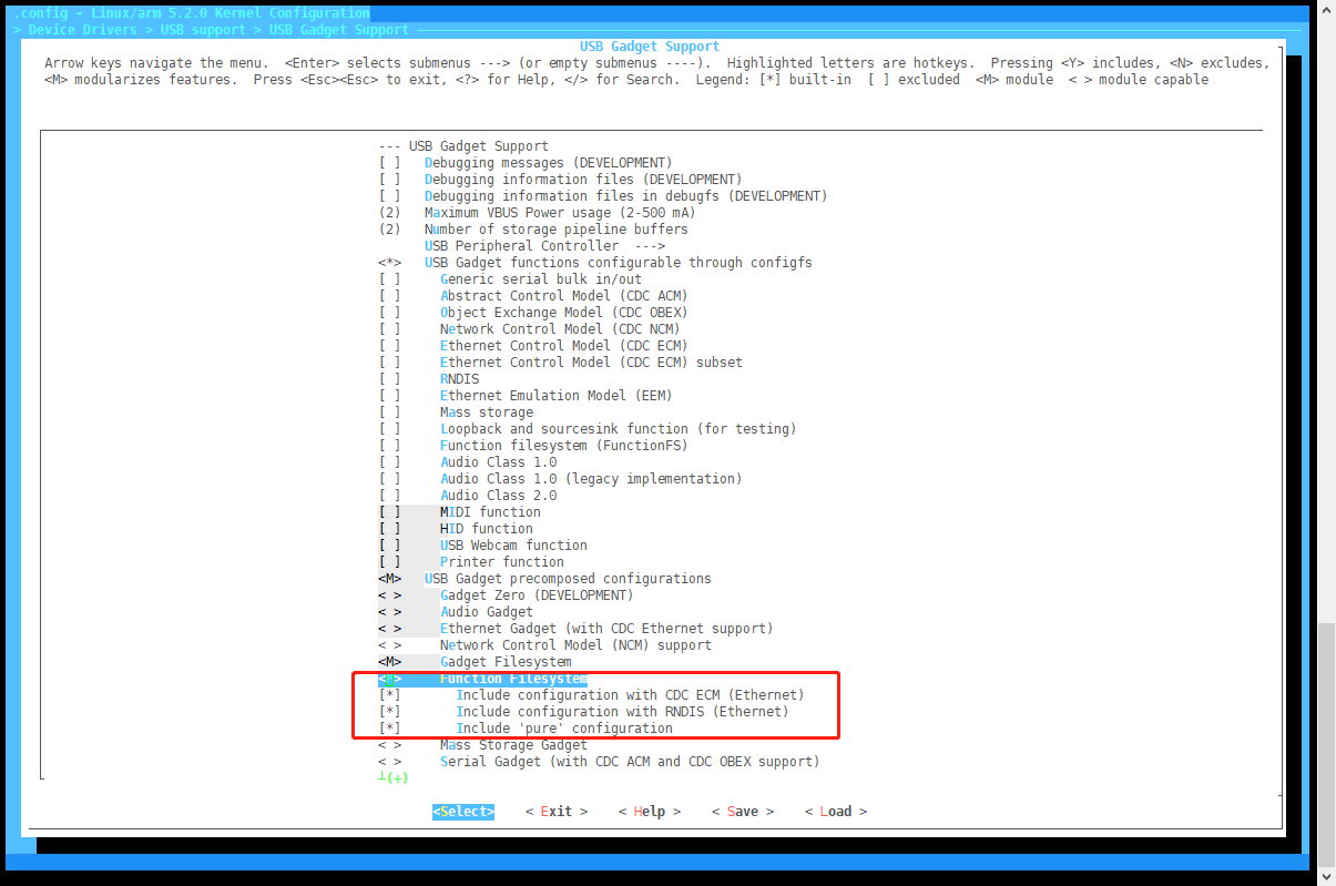

其实M和*都是一样,只是M可以看到其他选项而已。就是和你 https://whycan.cn/t_2179.html
配置Gadget不一样。
楼主 #25 2019-08-29 10:06:19
checkout
注册时间: 2018-11-09
已发帖子: 173
积分: 168

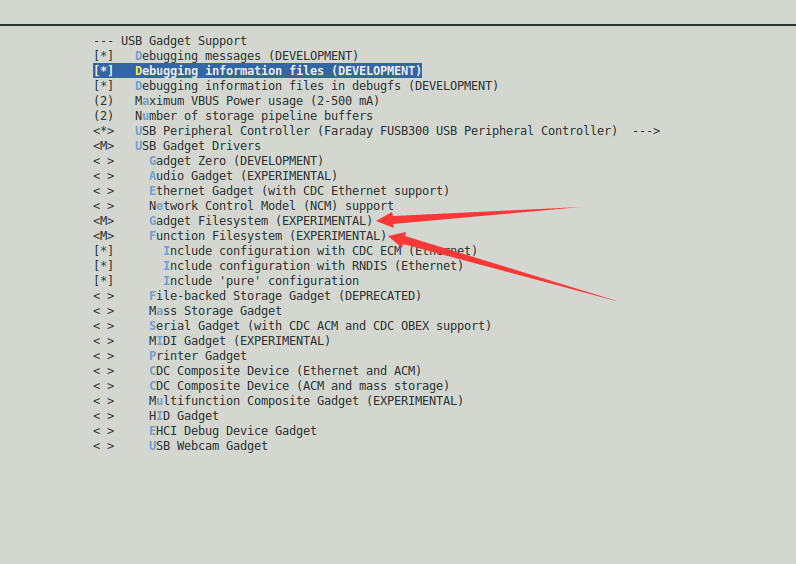

选gadgetfs,fuctionfs
晕哥小弟 说:
https://whycan.cn/files/members/1569/20190829093543.png

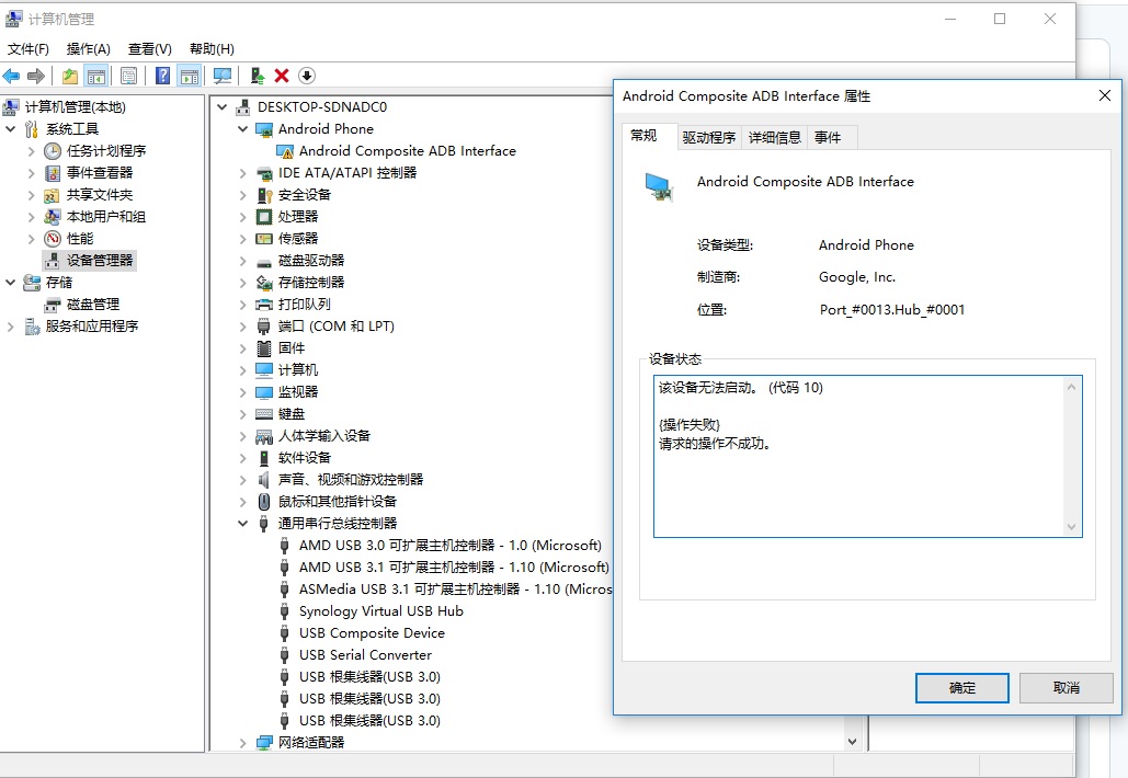

#26 2019-08-29 10:17:24
晕哥小弟
注册时间: 2019-04-04
已发帖子: 311
积分: 301.5
这样对么?
#27 2019-08-29 10:55:16
已发帖子: 9,436
对, 没有问题, 先试一试。
然后7楼的脚本用上 https://whycan.cn/t_2794.html#p22752

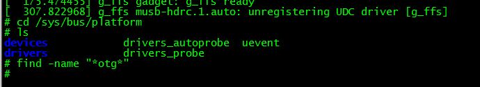

#28 2019-08-29 11:07:29
晕哥小弟
注册时间: 2019-04-04
已发帖子: 311
积分: 301.5

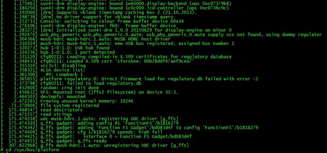

运行了脚本:
#! /bin/sh
adbd &
#29 2019-08-29 11:10:04
晕哥小弟
注册时间: 2019-04-04
已发帖子: 311
积分: 301.5

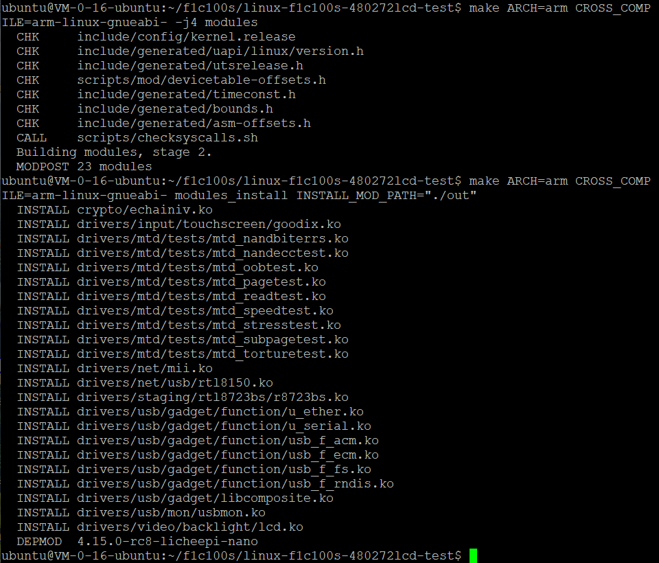

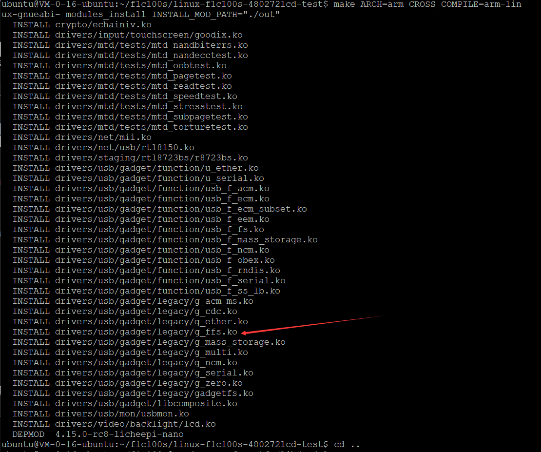

发现kernel目录下有个out。里面是别人编译的。如何生成属于我自己的out?
ARCH=arm CROSS_COMPILE=arm-linux- INSTALL_MOD_PATH=/opt/f1c100s/buildroot-2019.02.2/output/target/ make modules_install
得把你的 ko 文件用上面的命令安装到你的根文件系统(根据具体情况调整参数)

按照晕哥的提示,调整了。但是运行脚本后。一直打印。PC端一点反应也没有?
#32 2019-08-29 11:20:55
已发帖子: 9,436
你的 Linux 是什么版本, USB Gadget 本身有没有问题?也就是说默认那个USB串口是否OK ?
看log好像 USB 一直在复位??? 换一条手机原装的USB线试一试, 或者换一台电脑试一试。
#33 2019-08-29 11:23:05
晕哥小弟
注册时间: 2019-04-04
已发帖子: 311
积分: 301.5
1、数据线和电脑没有问题,电脑可以通过adb访问手机。
2、bsp 内核 3.4
3、默认的USB串口怎么查?
#34 2019-08-29 11:27:58
已发帖子: 9,436
晕哥小弟 说:
2、bsp 内核 3.4
3、默认的USB串口怎么查?
默认的USB串口是荔枝派主线Linux的默认配置
那你试一试 gadget usb serial 是否正常吧.
配置,编译,安装
modprobe g_serial
然后电脑应该有一个 USB 串口.
#35 2019-08-29 11:35:40
晕哥小弟
注册时间: 2019-04-04
已发帖子: 311
积分: 301.5
modprobe: can't load module g_serial.ko (/lib/modules/3.4.39/kernel/drivers/usb/gadget/g_serial.ko): No such device
#36 2019-08-29 11:36:47
晕哥小弟
注册时间: 2019-04-04
已发帖子: 311
积分: 301.5
我改了下 modules.dep
# cat /lib/modules/3.4.39/modules.dep
kernel/fs/fatfs/fatfs.ko:
kernel/drivers/scsi/scsi_wait_scan.ko:
kernel/drivers/usb/gadget/g_ether.ko:
kernel/drivers/usb/gadget/gadgetfs.ko:
kernel/drivers/usb/gadget/g_ffs.ko:
/lib/modules/3.4.39/kernel/drivers/usb/gadget/g_serial.ko:
kernel/drivers/input/sw-device.ko:
kernel/drivers/hwmon/da380/da380.ko:
#37 2019-08-29 11:40:25
晕哥小弟
注册时间: 2019-04-04
已发帖子: 311
积分: 301.5
会不会是这里选择错误了?
楼主 #38 2019-08-29 13:36:19
checkout
注册时间: 2018-11-09
已发帖子: 173
积分: 168
你看看相关的.ko有没有存在
晕哥小弟 说:
最近编辑记录 checkout (2019-08-29 13:36:58)
#39 2019-08-29 13:39:22
晕哥小弟
注册时间: 2019-04-04
已发帖子: 311
积分: 301.5
g_serial.ko  是存在的。
楼主 #40 2019-08-29 14:00:44
checkout
注册时间: 2018-11-09
已发帖子: 173
积分: 168
insmod试试,或者depmod -a搞搞
你没有用buildroot??
晕哥小弟 说:
g_serial.ko  是存在的。
最近编辑记录 checkout (2019-08-29 14:02:08)
#41 2019-08-29 14:12:56
晕哥小弟
注册时间: 2019-04-04
已发帖子: 311
积分: 301.5
我瞎配置了内核。把所有的gadget的选型都选择了M。
现在可以运行g_serial.ko了。
但是运行了,PC端没有任何反应。
#42 2019-08-29 14:18:57
已发帖子: 9,436
看下 sys_config.fex, 通过配置 决定是手动切换/GPIO检测自动切换 usb device /host

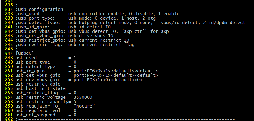

#43 2019-08-29 14:27:31
晕哥小弟
注册时间: 2019-04-04
已发帖子: 311
积分: 301.5
改了fex文件,但是还是没有任何反应。
dmesg有个
[   20.036504] gadget_is_softwinner_otg is not -int
[   20.036511] gadget_is_softwinner_otg is not -int
[   20.036531] g_serial gadget: Gadget Serial v2.4
[   20.042744] g_serial gadget: g_serial ready
#44 2019-08-29 14:46:23

试一试这个:
http://git.linux-sunxi.cn/?file=001-OrangePi/04-%E8%BF%9B%E9%98%B6/07-%E4%BF%AE%E6%94%B9OTG%E5%8F%A3%E6%A8%A1%E5%BC%8F%E4%B8%BAdevice
修改OTG口模式为device
执行
echo "2" > /sys/bus/platform/devices/sunxi_usb_udc/otg_role
你得先看看有没有这个文件,没有的话,那就试试这个路径
echo "2" > /sys/devices/platform/sunxi_otg/otg_role

我发现板卡中出现了  /dev/ttyGS0
楼主 #46 2019-08-29 17:52:53
checkout
注册时间: 2018-11-09
已发帖子: 173
积分: 168

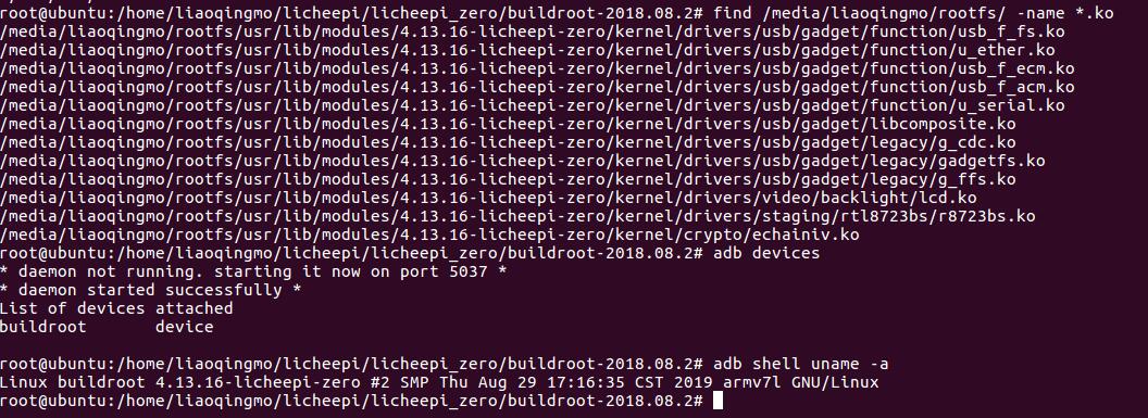

4.13-y版本完全没问题
启动log:

#48 2019-08-31 17:34:37
阿黄
注册时间: 2018-10-03
已发帖子: 299
积分: 134
我遇到个奇怪的问题,在家里的win10下就不行
启动日志
U-Boot 2018.01-05679-g013ca45-dirty (Aug 29 2019 - 17:55:54 -0700) Allwinner Technology
Model: Lichee Pi Nano
DRAM:  64 MiB
MMC:   SUNXI SD/MMC: 0
In:    serial@1c25000
Out:   serial@1c25000
Err:   serial@1c25000
Net:   No ethernet found.
starting USB...
No controllers found
device 0 offset 0x70000, size 0x10000
SF: 65536 bytes @ 0x70000 Read: OK
device 0 offset 0x80000, size 0x400000
SF: 4194304 bytes @ 0x80000 Read: OK
   Loading Device Tree to 816fa000, end 816ff40a ... OK
[    0.000000] Linux version 4.15.0-rc8-licheepi-nano+ (ubuntu@ubuntu) (gcc version 7.2.1 20171011 (Linaro GCC 7.2-2017.11)) #58 Sat Aug 31 07:23:27 CST 2019
[    0.000000] Kernel command line: console=ttyS0,115200 panic=5 rootwait root=/dev/mtdblock3 rw rootfstype=jffs2
[    0.000000] Memory: 56236K/65536K available (5120K kernel code, 214K rwdata, 1020K rodata, 1024K init, 221K bss, 9300K reserved, 0K cma-reserved, 0K highmem)
[    0.000000]       .text : 0x(ptrval) - 0x(ptrval)   (6112 kB)
[    0.000000]       .data : 0x(ptrval) - 0x(ptrval)   ( 215 kB)
[    0.000000]        .bss : 0x(ptrval) - 0x(ptrval)   ( 222 kB)
[    0.000044] sched_clock: 32 bits at 24MHz, resolution 41ns, wraps every 89478484971ns
[    0.000109] clocksource: timer: mask: 0xffffffff max_cycles: 0xffffffff, max_idle_ns: 79635851949 ns
[    0.000639] Console: colour dummy device 80x30
[    0.000729] Calibrating delay loop... 203.16 BogoMIPS (lpj=1015808)
[    0.070228] pid_max: default: 32768 minimum: 301
[    0.070541] Mount-cache hash table entries: 1024 (order: 0, 4096 bytes)
[    0.070582] Mountpoint-cache hash table entries: 1024 (order: 0, 4096 bytes)
[    0.071965] CPU: Testing write buffer coherency: ok
[    0.073559] Setting up static identity map for 0x80100000 - 0x80100058
[    0.076050] devtmpfs: initialized
[    0.082908] clocksource: jiffies: mask: 0xffffffff max_cycles: 0xffffffff, max_idle_ns: 19112604462750000 ns
[    0.082970] futex hash table entries: 256 (order: -1, 3072 bytes)
[    0.083222] pinctrl core: initialized pinctrl subsystem
[    0.085141] NET: Registered protocol family 16
[    0.086341] DMA: preallocated 256 KiB pool for atomic coherent allocations
[    0.088034] cpuidle: using governor menu
[    0.107083] SCSI subsystem initialized
[    0.107395] usbcore: registered new interface driver usbfs
[    0.107543] usbcore: registered new interface driver hub
[    0.107722] usbcore: registered new device driver usb
[    0.108133] pps_core: LinuxPPS API ver. 1 registered
[    0.108163] pps_core: Software ver. 5.3.6 - Copyright 2005-2007 Rodolfo Giometti <giometti@linux.it>
[    0.108226] PTP clock support registered
[    0.109638] clocksource: Switched to clocksource timer
[    0.134228] NET: Registered protocol family 2
[    0.135605] TCP established hash table entries: 1024 (order: 0, 4096 bytes)
[    0.135680] TCP bind hash table entries: 1024 (order: 0, 4096 bytes)
[    0.135731] TCP: Hash tables configured (established 1024 bind 1024)
[    0.135980] UDP hash table entries: 256 (order: 0, 4096 bytes)
[    0.136041] UDP-Lite hash table entries: 256 (order: 0, 4096 bytes)
[    0.136506] NET: Registered protocol family 1
[    0.138764] NetWinder Floating Point Emulator V0.97 (double precision)
[    0.140651] Initialise system trusted keyrings
[    0.141184] workingset: timestamp_bits=30 max_order=14 bucket_order=0
[    0.156226] squashfs: version 4.0 (2009/01/31) Phillip Lougher
[    0.156808] jffs2: version 2.2. (NAND) © 2001-2006 Red Hat, Inc.
[    0.171191] Key type asymmetric registered
[    0.171230] Asymmetric key parser 'x509' registered
[    0.171430] Block layer SCSI generic (bsg) driver version 0.4 loaded (major 250)
[    0.171463] io scheduler noop registered
[    0.171483] io scheduler deadline registered
[    0.172244] io scheduler cfq registered (default)
[    0.172279] io scheduler mq-deadline registered
[    0.172298] io scheduler kyber registered
[    0.173397] sun4i-usb-phy 1c13400.phy: Couldn't request ID GPIO
[    0.183229] suniv-pinctrl 1c20800.pinctrl: initialized sunXi PIO driver
[    0.341042] Serial: 8250/16550 driver, 8 ports, IRQ sharing disabled
[    0.347340] console [ttyS0] disabled
[    0.367589] 1c25000.serial: ttyS0 at MMIO 0x1c25000 (irq = 22, base_baud = 6250000) is a 16550A
[    0.806314] console [ttyS0] enabled
[    0.832283] 1c25400.serial: ttyS1 at MMIO 0x1c25400 (irq = 23, base_baud = 6250000) is a 16550A
[    0.841925] suniv-pinctrl 1c20800.pinctrl: unsupported function uart2 on pin PD14
[    0.871149] 1c25800.serial: ttyS2 at MMIO 0x1c25800 (irq = 24, base_baud = 6250000) is a 16550A
[    0.881947] SCSI Media Changer driver v0.25
[    0.889746] m25p80 spi0.0: w25q128 (16384 Kbytes)
[    0.894527] 4 ofpart partitions found on MTD device spi0.0
[    0.900074] Creating 4 MTD partitions on "spi0.0":
[    0.904908] 0x000000000000-0x000000070000 : "u-boot"
[    0.912312] 0x000000070000-0x000000080000 : "dtb"
[    0.919317] 0x000000080000-0x000000480000 : "kernel"
[    0.926780] 0x000000480000-0x000001000000 : "rootfs"
[    0.936907] ehci_hcd: USB 2.0 'Enhanced' Host Controller (EHCI) Driver
[    0.943571] ehci-platform: EHCI generic platform driver
[    0.949063] ohci_hcd: USB 1.1 'Open' Host Controller (OHCI) Driver
[    0.955365] ohci-platform: OHCI generic platform driver
[    0.961030] usbcore: registered new interface driver usb-storage
[    0.967844] i2c /dev entries driver
[    0.976503] NET: Registered protocol family 17
[    0.981183] Key type dns_resolver registered
[    0.987291] Loading compiled-in X.509 certificates
[    1.000376] usb_phy_generic usb_phy_generic.0.auto: usb_phy_generic.0.auto supply vcc not found, using dummy regulator
[    1.012157] musb-hdrc musb-hdrc.1.auto: MUSB HDRC host driver
[    1.017950] musb-hdrc musb-hdrc.1.auto: new USB bus registered, assigned bus number 1
[    1.026445] usb usb1: New USB device found, idVendor=1d6b, idProduct=0002
[    1.033331] usb usb1: New USB device strings: Mfr=3, Product=2, SerialNumber=1
[    1.040592] usb usb1: Product: MUSB HDRC host driver
[    1.045556] usb usb1: Manufacturer: Linux 4.15.0-rc8-licheepi-nano+ musb-hcd
[    1.052639] usb usb1: SerialNumber: musb-hdrc.1.auto
[    1.059118] hub 1-0:1.0: USB hub found
[    1.063150] hub 1-0:1.0: 1 port detected
[    1.068805] hctosys: unable to open rtc device (rtc0)
[    1.074437] cfg80211: Loading compiled-in X.509 certificates for regulatory database
[    1.091945] cfg80211: Loaded X.509 cert 'sforshee: 00b28ddf47aef9cea7'
[    1.098690] vcc3v3: disabling
[    1.102594] platform regulatory.0: Direct firmware load for regulatory.db failed with error -2
[    1.111302] cfg80211: failed to load regulatory.db
[    1.212105] random: crng init done
[    2.880061] VFS: Mounted root (jffs2 filesystem) on device 31:3.
[    2.888776] devtmpfs: mounted
[    2.896262] Freeing unused kernel memory: 1024K
Starting syslogd: OK
Starting klogd: OK
Starting ntpd: /etc/init.d/S39ntpd: line 9: /usr/sbin/ntpd: not found
FAIL
Starting udhcpd: /etc/init.d/S39udhcpd: line 9: /usr/sbin/udhcpd: not found
FAIL
Starting network: /bin/sh: wpa_supplicant: not found
FAIL
Starting wpa_cli: /etc/init.d/S41wpa_cli: line 9: /usr/sbin/wpa_cli: not found
FAIL
[   10.350506] file system registered
[   15.598118] read descriptors
[   15.601558] read strings
[   15.604359] g_ffs gadget: g_ffs ready
[   15.887494] musb_g_ep0_irq 687: SetupEnd came in a wrong ep0stage out/status
[   15.934514] g_ffs gadget: high-speed config #1: FunctionFS
[   52.145089] musb_g_ep0_irq 687: SetupEnd came in a wrong ep0stage out/status
[   52.161146] g_ffs gadget: high-speed config #1: FunctionFS
[   52.167815] read descriptors
[   52.172418] read strings
[   52.175193] g_ffs gadget: g_ffs ready
[   52.425135] musb_g_ep0_irq 687: SetupEnd came in a wrong ep0stage out/status
[   53.102215] musb_g_ep0_irq 687: SetupEnd came in a wrong ep0stage out/status
[   53.297238] musb_g_ep0_irq 687: SetupEnd came in a wrong ep0stage out/status
[   53.308229] musb_g_ep0_irq 687: SetupEnd came in a wrong ep0stage out/status
[   53.316262] musb_g_ep0_irq 687: SetupEnd came in a wrong ep0stage out/status
[   53.323326] musb_g_ep0_irq 779: SETUP packet len 0 != 8 ?
[   53.357234] musb_g_ep0_irq 687: SetupEnd came in a wrong ep0stage out/status
# [  456.763383] musb_g_ep0_irq 687: SetupEnd came in a wrong ep0stage out/status
[  456.773412] g_ffs gadget: high-speed config #1: FunctionFS
[  457.713994] musb_g_ep0_irq 687: SetupEnd came in a wrong ep0stage in/status
[  458.396588] musb_g_ep0_irq 687: SetupEnd came in a wrong ep0stage out/status
[  459.274700] musb_g_ep0_irq 687: SetupEnd came in a wrong ep0stage out/status
[  459.314707] g_ffs gadget: high-speed config #1: FunctionFS
[  459.321355] read descriptors
[  459.324291] read strings
[  459.327026] g_ffs gadget: g_ffs ready
[  459.598764] musb_g_ep0_irq 687: SetupEnd came in a wrong ep0stage out/status

               以下这样操作之后,再打包zImage就行了吗?这个ADB的modules好像没有看到?
ubuntu@VM-0-16-ubuntu:~/f1c100s/linux-f1c100s-480272lcd-test$ make ARCH=arm CROS      S_COMPILE=arm-linux-gnueabi- -j4 modules
  CHK     include/config/kernel.release
  CHK     include/generated/uapi/linux/version.h
  CHK     scripts/mod/devicetable-offsets.h
  CHK     include/generated/utsrelease.h
  CHK     include/generated/timeconst.h
  CHK     include/generated/bounds.h
  CHK     include/generated/asm-offsets.h
  CALL    scripts/checksyscalls.sh
  Building modules, stage 2.
  MODPOST 16 modules
ubuntu@VM-0-16-ubuntu:~/f1c100s/linux-f1c100s-480272lcd-test$ make ARCH=arm CROS      S_COMPILE=arm-linux-gnueabi- modules_install INSTALL_MOD_PATH="./out"
  INSTALL crypto/echainiv.ko
  INSTALL drivers/input/touchscreen/goodix.ko
  INSTALL drivers/mtd/tests/mtd_nandbiterrs.ko
  INSTALL drivers/mtd/tests/mtd_nandecctest.ko
  INSTALL drivers/mtd/tests/mtd_oobtest.ko
  INSTALL drivers/mtd/tests/mtd_pagetest.ko
  INSTALL drivers/mtd/tests/mtd_readtest.ko
  INSTALL drivers/mtd/tests/mtd_speedtest.ko
  INSTALL drivers/mtd/tests/mtd_stresstest.ko
  INSTALL drivers/mtd/tests/mtd_subpagetest.ko
  INSTALL drivers/mtd/tests/mtd_torturetest.ko
  INSTALL drivers/net/mii.ko
  INSTALL drivers/net/usb/rtl8150.ko
  INSTALL drivers/staging/rtl8723bs/r8723bs.ko
  INSTALL drivers/usb/mon/usbmon.ko
  INSTALL drivers/video/backlight/lcd.ko
  DEPMOD  4.15.0-rc8-licheepi-nano
#56 2019-11-28 11:18:02
已发帖子: 9,436
你下载@路漫漫的固件就知道了,要勾选usb gadget相关模块
#57 2019-11-28 15:48:03

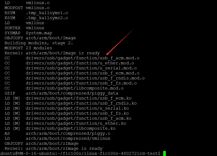

内核usb gadget模块应该是有编译出来了:
buildroot里面这个fastboot需要打开吗?
#58 2019-11-28 16:03:47
已发帖子: 9,436
看下有没有 g_ffs.ko
#59 2019-11-28 16:17:14
aaayao
注册时间: 2019-10-30
已发帖子: 85
积分: 55
晕哥,没找到这个 g_ffs.ko,应该怎么样产生这个文件的?
#60 2019-11-28 16:29:27
已发帖子: 9,436
aaayao 说:
57楼第一个图里面, 有选项没有勾上。
#61 2019-11-28 17:04:45
aaayao
注册时间: 2019-10-30
已发帖子: 85
积分: 55
g_ffs.ko编译出来了
可以加载g_ffs驱动了,但是提示line 5: adbd: not found,这个是什么意思呢?

#62 2019-11-28 17:25:45
已发帖子: 9,436
buildroot勾选adb服务器,重新生成根文件系统。
#63 2019-11-28 17:30:18
aaayao
注册时间: 2019-10-30
已发帖子: 85
积分: 55
这个一直都已经是勾选了的啊
#64 2019-11-28 17:34:27
aaayao
注册时间: 2019-10-30
已发帖子: 85
积分: 55
搜索ADB相关的选项如下,还有什么需要打开的吗?
#65 2019-11-28 17:41:49
已发帖子: 9,436
可以了
#66 2019-11-28 17:42:47
aaayao
注册时间: 2019-10-30
已发帖子: 85
积分: 55
那这个adbd &启动不了哦?什么是什么问题?

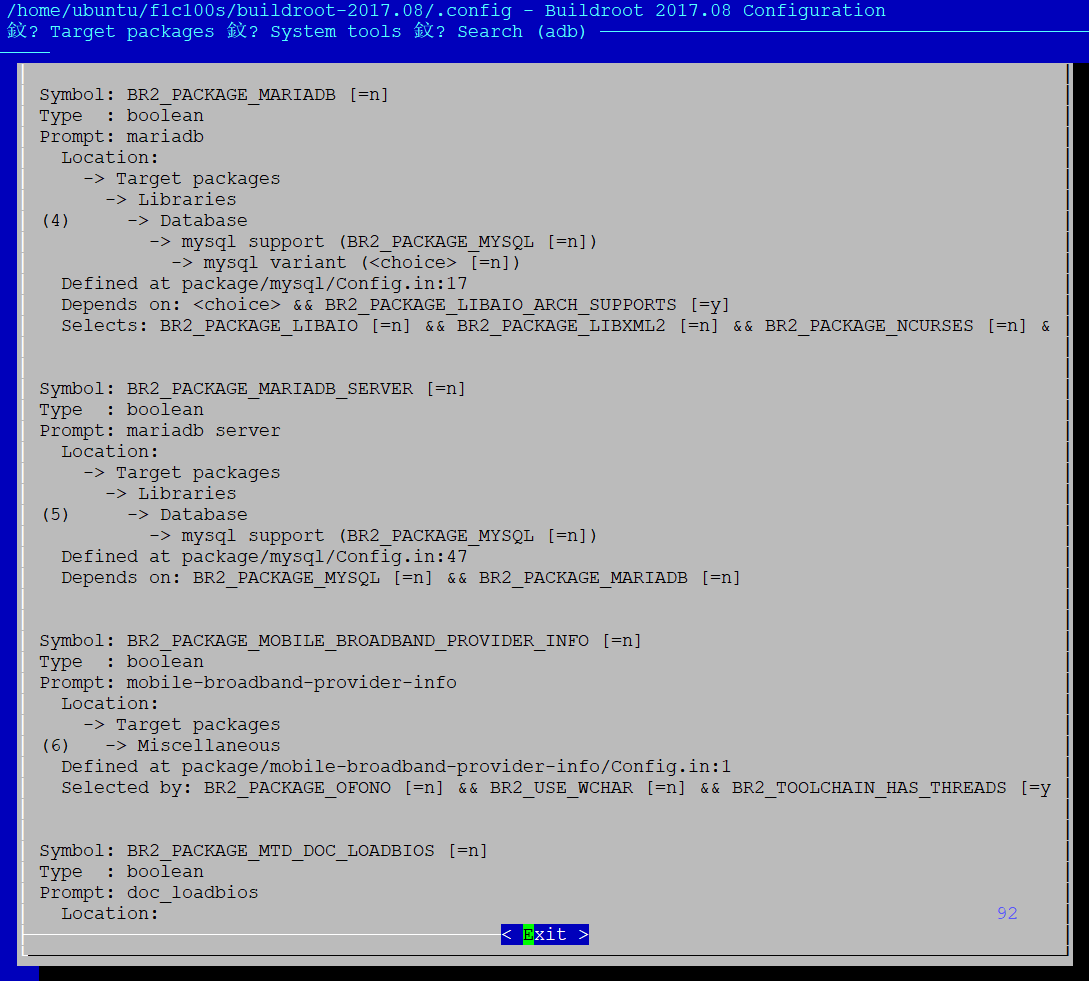

#67 2019-11-28 18:07:01
已发帖子: 9,436
找一下 adbd 有没有拷贝到文件系统
#68 2019-11-28 19:47:33
aaayao
注册时间: 2019-10-30
已发帖子: 85
积分: 55
adbd这个文件没有找到呢,内核目录里也没有,怎么产生这个文件呢?

#73 2019-11-29 16:07:15
aaayao
注册时间: 2019-10-30
已发帖子: 85
积分: 55
晕哥,你好:
               终于把ADB给调通了,感谢各位大神的帮忙!另外,电脑设备上显示的为什么会是USB Function Filesystem呢?而不是显示ADB Interface设备?
#74 2019-11-29 16:29:19
已发帖子: 9,436
看起来有点是驱动错了的意思, 你现在用的是不是 libusb 的驱动?通用串行总线?
想办法换成 adb 的驱动就好了。
#75 2019-11-29 16:38:58
aaayao
注册时间: 2019-10-30
已发帖子: 85
积分: 55
用的是libusb 的驱动,可能是这个原因。那还是现在这样用好啦!万一改了驱动可能烧录又有问题。

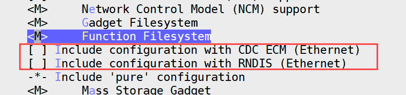

<M>     Function Filesystem
[ ] Include configuration with CDC ECM (Ethernet)
[ ] Include configuration with RNDIS (Ethernet)
发现如果勾上这两项, windows死活用串口驱动,可能需要手动设置安卓驱动,但是我不会弄.
如果挂载到 ubuntu, 那么USB口会不停复位.
特此记录, 如果有问题,请大家指正.

你好,我这样配置有问题吗?启动adbd的时候报错
adbd &
[1]-  Terminated                 adbd
# install_listener[   99.342029] read descriptors
('tcp:5037','*sm[   99.345182] read strings
artsocket*')
[   99.349252] udc-core: couldn't find an available UDC - added [g_ffs] to list of pending drivers
#82 2020-01-03 19:52:50
win32prog
注册时间: 2019-11-28
已发帖子: 138
积分: 138
看下用的是不是 micro usb线, usb id 有没有上拉/下拉.
楼主 #83 2020-01-03 20:40:27
checkout
注册时间: 2018-11-09
已发帖子: 173
积分: 168
参考50楼
wenfengtou 说:
https://whycan.cn/files/members/2789/usb.jpg
adbd &
artsocket*')

50楼,我应该没有装两个garget呀,怎么看有没有装两个?
#87 2020-01-05 13:00:10
wenfengtou
注册时间: 2019-12-28
已发帖子: 25
积分: 25
如上图,lsmod第一次看的时候是空的,后面执行modprobe g_ffs idVendor=0x18d1 idProduct=0x4e42后,出现三个module
g_ffs                  16384  0
usb_f_fs               32768  2 g_ffs
libcomposite           40960  2 g_ffs,usb_f_fs
这样是正常的吗?最后报错[   55.895723] udc-core: couldn't find an available UDC - added [g_ffs] to list of pending drivers
是按照这样子配置了,但是还是一样的报错
#90 2020-01-05 13:52:31
wenfengtou
注册时间: 2019-12-28
已发帖子: 25
积分: 25
/sys/class/udc/下面是空的是正常的吗?

checkout 说:
这几个选项https://whycan.cn/files/members/1237/usb.jpg
大佬,可以发下.config文件给我看看吗?我们的内核版本是一样的

神奇了,使用二楼的内核配置文件也报一样的错
#93 2020-01-05 14:48:01
wenfengtou
注册时间: 2019-12-28
已发帖子: 25
积分: 25
二楼的配置文件加7楼的脚本还是报一样的错,udc-core: couldn't find an available UDC - added [g_ffs] to list of pending drivers
楼主 #94 2020-01-05 18:40:27
checkout
注册时间: 2018-11-09
已发帖子: 173
积分: 168
你用的是v3s还是f1c?可以把启动log贴上来
lichee zero的内核配置,你可以参考参考
linux-4-13-config.tgz
最近编辑记录 checkout (2020-01-05 18:42:00)

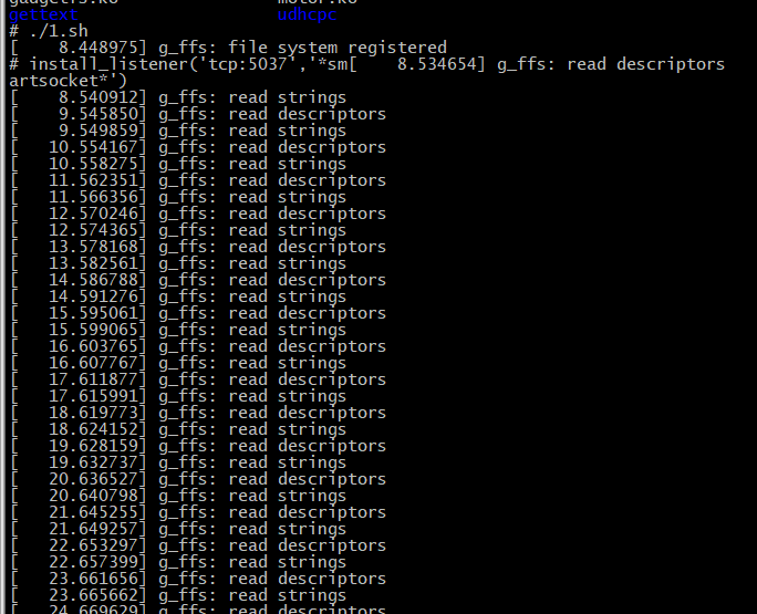

按照红白机大神的做法,修改drivers/usb/musb/sunxi.c:742行后,启动adbd看上去是正常了,但是电脑一点反应都没有,识别不到adb设备
# adbd
install_listener('tcp:5037','*sm[  409.934107] read descriptors
artsocket*')
[  409.938587] read strings
[  409.942409] g_ffs gadget: g_ffs ready
#99 2020-01-06 01:54:37
wenfengtou
注册时间: 2019-12-28
已发帖子: 25
积分: 25
adb要配置usb为host模式还是device模式呢?参照链接 https://whycan.cn/t_1672.html#p22720 进行修改
Michael 说:
设备树文件里有个PE2的gpio电平设置,补丁里面设置的是active high为device模式,改为low就是host模式
电脑可以识别出一个叫做USB Function的设备,不知道是否正常?
而这个USB Function设备居然可以用adb连接了。这算是正常的了吗?按照理解adb不是应该属于usb device模式吗???
#100 2020-01-06 08:27:42
红白机
注册时间: 2020-01-02
已发帖子: 133
积分: 133
@wenfengtou 显示只是一个名字而已,估计最终还是用 adb 驱动的, 详情可以点进去设备看具体是哪些驱动文件起做作用的。
#101 2020-01-06 08:32:35
wenfengtou
注册时间: 2019-12-28
已发帖子: 25
积分: 25
99楼最后一个图发错了,adb可以正常连接了。但为什么是配置usb为host模式呢?不是应该是device模式吗
#102 2020-01-06 09:00:02
红白机
注册时间: 2020-01-02
已发帖子: 133
积分: 133
在哪里配置成了 host 模式?
#103 2020-01-06 09:13:51
wenfengtou
注册时间: 2019-12-28
已发帖子: 25
积分: 25
Michael 说:
这里默认是GPIO_ACTIVE_HIGH,改成GPIO_ACTIVE_LOW才能识别到usb adb。但GPIO_ACTIVE_LOW是host模式,不太理解为什么adb要用host模式

这个配置是荔枝派nano的,估计的PE2逻辑电平和荔枝派的刚好相反而已。

多谢各位大神指导,现在总结一下我这边荔枝派nano ,kernel版本4.14出现udc-core: couldn't find an available UDC - added [g_ffs] to list of pending drivers问题解决:
1.按照89楼进行配置
2.buildroot配置adbd
3.按照97楼修改usb开机启动报错问题
4.按照99楼配置dts的PE2的gpio电平为GPIO_ACTIVE_LOW

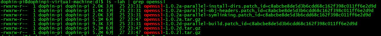

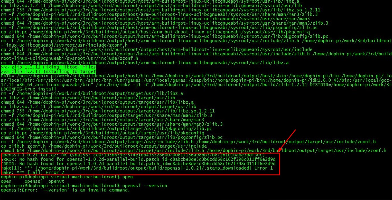

麻烦问下,我在尝试给f1c200s添加adb功能,使用的是nanoPi,Linux3.14内核,在添加了buildroot的adb选项后,被强制引入了OpenSSL(如下图一),重新编译后发现OpenSSL有故障,无法编译通过。提示"No hash found for openssl-1.0.2d-parallel-build.patch_……"如下图二。在百度、Google上所搜了很长时间都未能解决,麻烦楼主、晕哥给出出主意,分外感谢。1_20200627-2157.jpg
#118 2020-06-27 22:50:48
已发帖子: 3,394
#119 2020-06-28 00:01:51
willX
注册时间: 2019-09-06
已发帖子: 48
积分: 28
多谢指导,不知道你说的“手动下载”是什么意思?
不过我确实是在buildroot的dl目录里发现OpenSSL的一些文件,暂时不知道这些文件是干什么的。
该怎么处理这些带有后缀的文件?
我在openssl官网上下载了openssl1.0.2a以及openssl1.0.2l.tar.gz 直接放到dl文件夹里了。重新编译后,发现还是同样的报错。直接手工下载放进dl的方法,是有问题的吗?
#120 2020-06-28 00:09:16
已发帖子: 3,394
可能不是直接放dl目录,或许是下一级目录,具体可以追踪脚本源码。
https://whycan.cn/files/members/2789/usbfunction.png
https://whycan.cn/files/members/2789/usbadb.png
问下这位同学,麻烦问下,为什么要把PE2引脚置高或者置低电平呢?

willX
注册时间: 2019-09-06
已发帖子: 48
积分: 28
确实,直接将未下载完的openssl文件包,放到dl文件夹中。再把对应的openssl的临时文件删除才能行。
多谢帮助。

麻烦问下,g_ffs.ko 以及adbd都正常生成了。但是启动adbd之后,f1c200s的USB一直没有任何动静,哪位大神能给指点下迷津?
1. lsusb命令,在系统中只能看到一个设备:Bus 001 Device 001: ID 1d6b:0002。下有截图。
2. 系统中没有otg相关节点,所以没办法手动调整USB的host模式。
3. dmesg命令中,有g_ffs musb-hdrc.1.auto: unregistering UDC driver [g_ffs]。下有截图。
4. 已经将PE2改成ACTIVE_LOW了,但是看原理图上PE2 和 USB没有任何联系,不知道为什么要这样改。
最近编辑记录 willX (2020-06-30 00:01:29)

modprobe时候出现了这些错,请问哪位知道是漏选了什么么?没找到对策还。
 modprobe g_ffs idVendor=0x18d1 idProduct=0x4e42 iSerialNumber="buildroot" 和insmod都如下错误。

#128 2020-10-19 20:09:13
天马行空
注册时间: 2019-11-12
已发帖子: 57
积分: 57

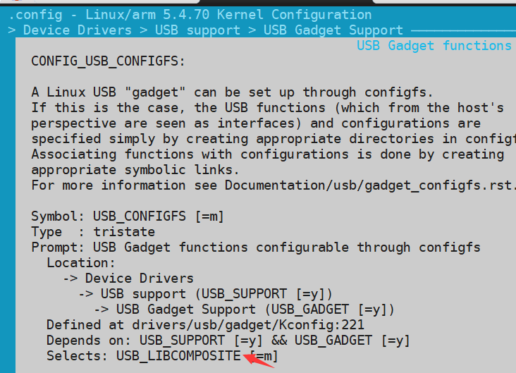

linux_5.4.70$ grep usb_remove_function  -r .
./include/linux/usb/composite.h:void usb_remove_function(struct usb_configuration *c, struct usb_function *f);
./drivers/usb/gadget/composite.c:void usb_remove_function(struct usb_configuration *c, struct usb_function *f)
./drivers/usb/gadget/composite.c:EXPORT_SYMBOL_GPL(usb_remove_function);
obj-$(CONFIG_USB_LIBCOMPOSITE)  += libcomposite.o
# USB Gadget Drivers
# composite based drivers
config USB_LIBCOMPOSITE
        tristate
        select CONFIGFS_FS
        depends on USB_GADGET
#129 2020-10-19 20:30:58
gubaoyl
注册时间: 2020-10-17
已发帖子: 20
积分: 20
谢谢回复。
这些我都有选上了。
/opt/lichee/linux# grep -rn CONFIG_USB_LIBCOMPOSITE ./
./drivers/usb/gadget/Makefile:9:obj-$(CONFIG_USB_LIBCOMPOSITE)    += libcomposite.o
./.config:2414:CONFIG_USB_LIBCOMPOSITE=m
启动kernel段的usb相关日志:

[  152.128696] g_ffs: Unknown symbol gether_set_qmult (err -2)
[  152.147872] g_ffs: Unknown symbol usb_otg_descriptor_alloc (err -2)
[  152.167743] g_ffs: Unknown symbol gether_set_gadget (err -2)
[  152.186967] g_ffs: Unknown symbol usb_put_function_instance (err -2)
[  152.207059] g_ffs: Unknown symbol gether_set_host_addr (err -2)
[  152.227009] g_ffs: Unknown symbol usb_otg_descriptor_init (err -2)
[  152.247226] g_ffs: Unknown symbol ffs_name_dev (err -2)
[  152.259657] g_ffs: Unknown symbol usb_add_config (err -2)
modprobe: can't load module g_ffs (g_ffs.ko): unknown symbol in module, or unknown parameter

你的 ko 是怎么安装的, 目录结构是怎样的, zImage和ko是不是同一个编译器编译的?
#131 2020-10-19 20:45:18
gubaoyl
注册时间: 2020-10-17
已发帖子: 20
积分: 20
你好,是同一个编译器出来的。
目录:
# ls -lah /lib/modules/5.2.0-licheepi-nano\+/
total 17
drwxr-xr-x    2 root     root        1.0K Jan  1 00:01 .
drwxr-xr-x    4 root     root        1.0K Jan  1 00:01 ..
-rw-r--r--    1 root     root       13.6K Oct 19  2020 g_ffs.ko
-rw-r--r--    1 root     root           0 Jan  1 00:01 modules.alias
-rw-r--r--    1 root     root          10 Jan  1 00:01 modules.dep
-rw-r--r--    1 root     root           0 Jan  1 00:01 modules.symbols
天马行空 说:
#132 2020-10-19 21:20:20
天马行空
注册时间: 2019-11-12
已发帖子: 57
积分: 57
用这个命令安装ko文件:
ARCH=arm CROSS_COMPILE=arm-linux-gnueabihf- -j16 INSTALL_MOD_PATH=/根文件系统目录/ make modules_install
参考:
V3S荔枝派zero uboot 和 linux 使用 ethernet 步骤总结
http://whycan.com/t_336.html
#133 2020-10-19 21:50:20
gubaoyl
注册时间: 2020-10-17
已发帖子: 20
积分: 20
perfect:
make ARCH=arm CROSS_COMPILE=arm-linux-gnueabi- modules_install INSTALL_MOD_PATH="../buildroot-2017.08/output/target/"
adbd之前都已经ok,这种方式可以加模块了,非常感谢。
# adbd&
cannot bind 'tcp:5037'
这个我之前也是搜索一圈,其他地方介绍的都是找到占用这个端口的进程kill,但是在nano上没人用网络呀。请问是否遇到这样的问题。
天马行空 说:
用这个命令安装ko文件:
参考:

#140 2022-03-22 13:44:58
bigbat
注册时间: 2022-01-30
已发帖子: 71
积分: 21
@qqluohao1234
能说说怎么解决的吗?
#141 2022-03-22 19:47:50
bigbat
注册时间: 2022-01-30
已发帖子: 71
积分: 21
# #! /bin/sh
# modprobe g_ffs idVendor=0x18d1 idProduct=0x4e42 iSerialNumber="buildroot"
[   16.131986] file system registered
# mkdir -p /dev/usb-ffs/adb
# mount -t functionfs adb /dev/usb-ffs/adb -o uid=2000,gid=2000
# adbd &
[   19.849665] read descriptors
[   19.852638] read strings
[   19.855577] g_ffs gadget: g_ffs ready
[   20.163733] g_ffs gadget: high-speed config #1: FunctionFS
windows 10 系统显示为funcionfs设备
&usb_otg {
    dr_mode = "peripheral";
&usbphy {
/*    usb0_id_det-gpios = <&pio 5 6 GPIO_ACTIVE_HIGH>; */
#144 2023-02-14 20:09:15
vigour1000
注册时间: 2018-11-19
已发帖子: 103
USB ID去掉了,没有反应   couldn't find an available UDC - added

@daydayup
D:\ArmTools\sdk\platform-tools>adb shell
# ls
# ad[[[J
# exit
D:\ArmTools\sdk\platform-tools>adb devices
List of devices attached
buildroot       device
开始是选了这个一直是串品

我把晕哥 dump 出来的bin 文件, dd 到了 TF 卡,然后报这样的错误是为什么呢
DRAM:  32 MiB
In:    serial@1c25000
Out:   serial@1c25000
Err:   serial@1c25000
starting USB...
switch to partitions #0, OK
mmc0 is current device
Failed to mount ext2 filesystem...
** Unrecognized filesystem type **
starting USB...
USB is stopped. Please issue 'usb start' first.
starting USB...
No ethernet found.
missing environment variable: pxeuuid
No ethernet found.
No ethernet found.
Retrieving file: pxelinux.cfg/000000
No ethernet found.
No ethernet found.
No ethernet found.
No ethernet found.
No ethernet found.
No ethernet found.
Retrieving file: pxelinux.cfg/default-arm-sunxi
No ethernet found.
No ethernet found.
No ethernet found.
Config file not found
starting USB...
No ethernet found.
No ethernet found.
#149 2023-04-18 10:56:42
19chan19
注册时间: 2023-04-07
积分: 13
我的是v3s
电脑上能识别到adb,
但是命令行无法识别
最近编辑记录 19chan19 (2023-04-18 12:06:31)
#150 2023-04-18 14:20:20
19chan19
注册时间: 2023-04-07
积分: 13
上面配置,在电脑上卸载驱动,重新加载驱动依然是串口
现在解决了
配置如下图

vigour1000 说:
出现这个 是你usb相关选项有没有勾选上的
