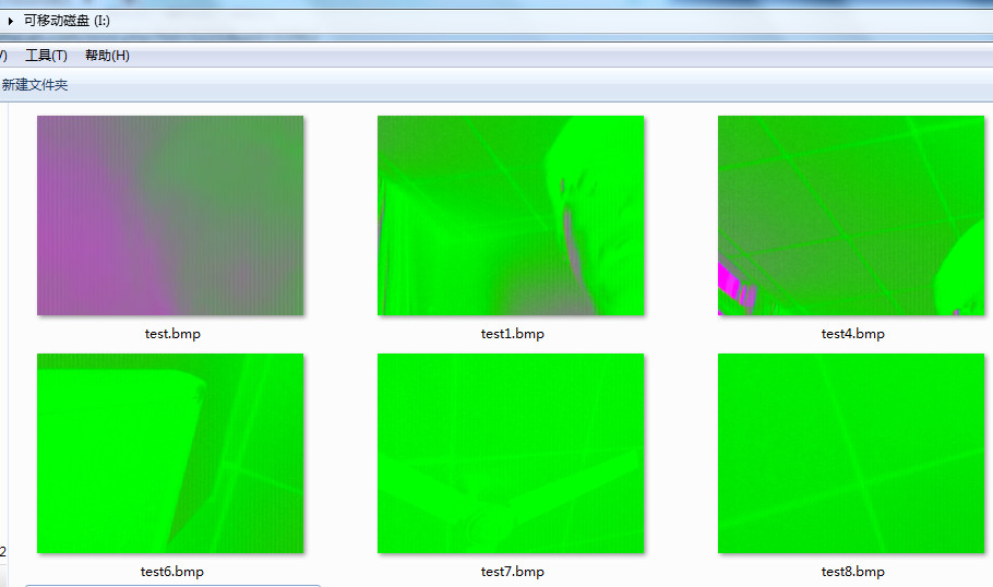

fswebcam -d /dev/video0 -S 3 test1.bmp
发现颜色有点不对劲 : (

我记得fswebcam要加一个-p UYVY参数

fswebcam -d /dev/video0 -S 3 -p UYVY test19.bmp
谢谢大佬, 搞定, 非常好用。

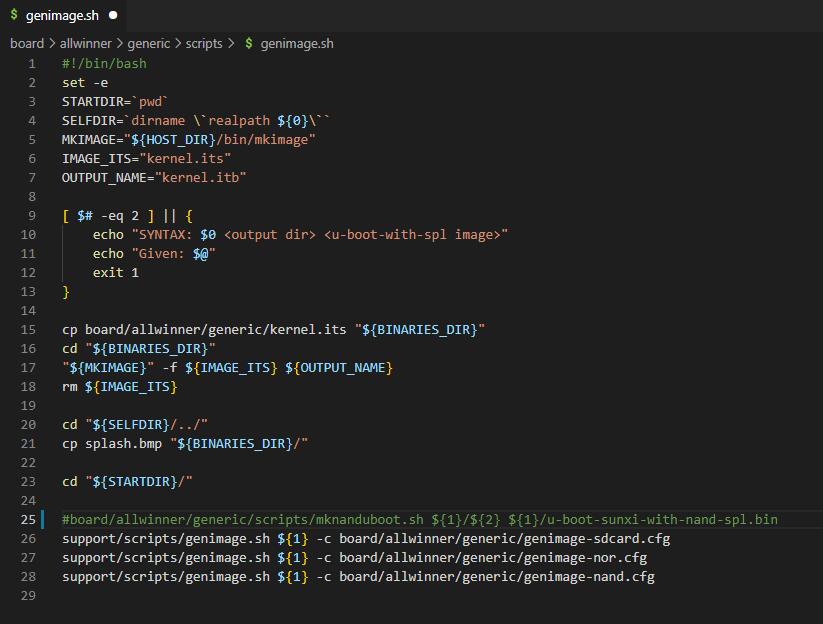

请问如果我添加了一个开机画面文件: board/widora/mangopi/r3/splash.png
应该如何拷贝到 output/images 呢?
修改 board/allwinner/suniv-f1c100s/scripts/genimage.sh 这个文件吗?
#34 2020-10-19 14:18:04
路人甲
注册时间: 2017-09-07
已发帖子: 202
积分: 199.5
Re: buildroot-tiny200 (F1C100/200s) 开发包近期更新内容 * 已支持DVP摄像头 *,支持SPI NAND
异乡是故乡 说:
可以的, 我就是这么干的
修改 board/allwinner/suniv-f1c100s/scripts/genimage.sh:
#!/bin/bash
set -e
SELFDIR=`dirname \`realpath ${0}\``
[ $# -eq 2 ] || {
    echo "SYNTAX: $0 <u-boot-with-spl image> <genimage.cfg>"
    echo "Given: $@"
    exit 1
cp ${SELFDIR}/../splash/splash.bmp ${1}/ -rf
${SELFDIR}/mknanduboot.sh ${1}/${2} ${1}/u-boot-sunxi-with-nand-spl.bin
support/scripts/genimage.sh ${1} -c board/allwinner/sun8i-v3s/genimage-sdcard.cfg
support/scripts/genimage.sh ${1} -c board/allwinner/sun8i-v3s/genimage-nor.cfg
support/scripts/genimage.sh ${1} -c board/allwinner/sun8i-v3s/genimage-nand.cfg
support/scripts/genimage.sh ${1} -c board/allwinner/sun8i-v3s/genimage-flasher.cfg
添加这一行: cp ${SELFDIR}/../splash/splash.bmp ${1}/ -rf
然后 board/allwinner/sun8i-v3s/genimage-sdcard.cfg 添加一行 splash.bmp 就可以了。

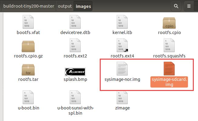

①windows平台用win32diskimager, ②linux平台用dd命令把 output/images/sysimage-sdcard.img 烧到tf卡即可.

谢谢,原来最终包都生成好了。

INFO: cmd: "mkdir -p "/home/xiang/linux/buildroot-tiny200/output/images"" (stderr):
INFO: flash(sysimage-nor.img): writing image partition 'u-boot' (0x80000@0x0)
INFO: flash(sysimage-nor.img): writing image partition 'splash' (0x80000@0x80000)
INFO: flash(sysimage-nor.img): writing image partition 'kernel' (0x500000@0x100000)
INFO: flash(sysimage-nor.img): writing image partition 'rom' (0xa00000@0x600000)
board/allwinner/generic/genimage-nand.cfg:33: no sub-section title/index for 'config'
INFO: cmd: "mkdir -p "/home/xiang/linux/buildroot-tiny200/output/build/genimage.tmp"" (stderr):
INFO: cmd: "rm -rf "/home/xiang/linux/buildroot-tiny200/output/build/genimage.tmp"/*" (stderr):
INFO: cmd: "cp -a "/tmp/tmp.tQn4VicX1u" "/home/xiang/linux/buildroot-tiny200/output/build/genimage.tmp/root"" (stderr):
INFO: cmd: "find '/home/xiang/linux/buildroot-tiny200/output/build/genimage.tmp/root' -depth -type d -printf '%P\0' | xargs -0 -I {} touch -r '/tmp/tmp.tQn4VicX1u/{}' '/home/xiang/linux/buildroot-tiny200/output/build/genimage.tmp/root/{}'" (stderr):
INFO: flash(sysimage-nand.img): writing image partition 'u-boot' (0x80000@0x0)
INFO: flash(sysimage-nand.img): writing image partition 'splash' (0x80000@0x80000)
INFO: flash(sysimage-nand.img): writing image partition 'kernel' (0x500000@0x100000)
INFO: flash(sysimage-nand.img): writing image partition 'rom' (0x7a00000@0x600000)
然后在output\images\生成的文件是啥意思,咋使用。
我烧录执行sudo sunxi-fel -p spiflash-write 0 ./output/images/u-boot.bin和sudo sunxi-fel -p spiflash-write 0 ./output/images/u-boot-sunxi-with-nand-spl.bin
后在串口上都没有输出
#106 2022-06-08 11:27:25

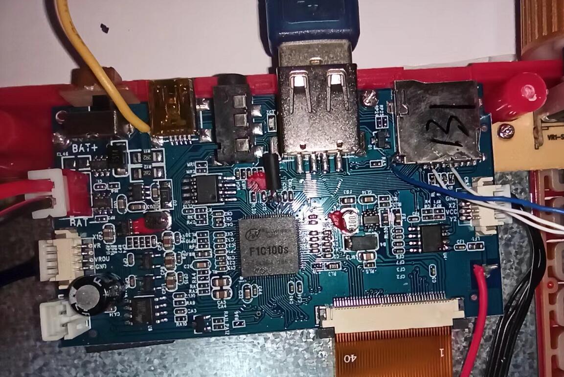

#108 2022-06-09 10:21:20
hameyou
注册时间: 2018-04-15
已发帖子: 210
积分: 2.5
@future
这个按钮加的好,方便了烧录哈

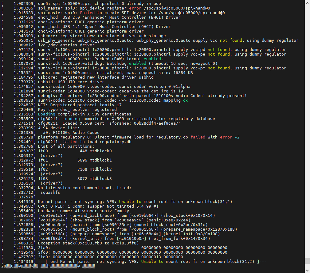

通过Win32DiskImager将编译出来的sysimage-sdcard.img写入sd卡后插上启动,不短接flash报错如下:
短接flash会卡在这里:
有大哥帮忙看看吗,从flash启动我已经放弃了,不知道咋下载,太难了

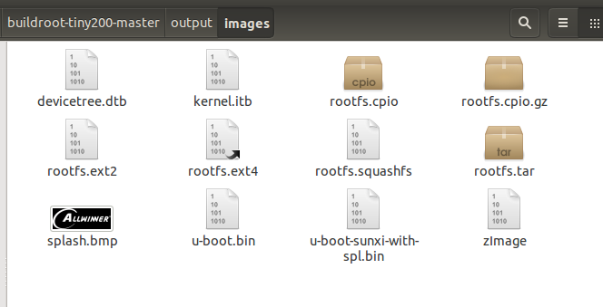

编译到最后提示出现如下错误,不知又是什么原因? 看output目录里面已经有一些生成的文件,有zImage,但没有uImage

output目录下的文件
.png
把  \buildroot-tiny200\board\allwinner\generic\scripts\genimage.sh 中生成 u-boot-sunxi-with-nand-spl.bin 的调用屏蔽掉后,
重新运行make,就能生成 sysimage-nor.img 和 sysimage-sdcard.img 文件,
虽然生成sysimage-nand.img还是提示失败,但板子没有用到nand,所以先不关心这个。
genimage.sh
.jpg
生成文件

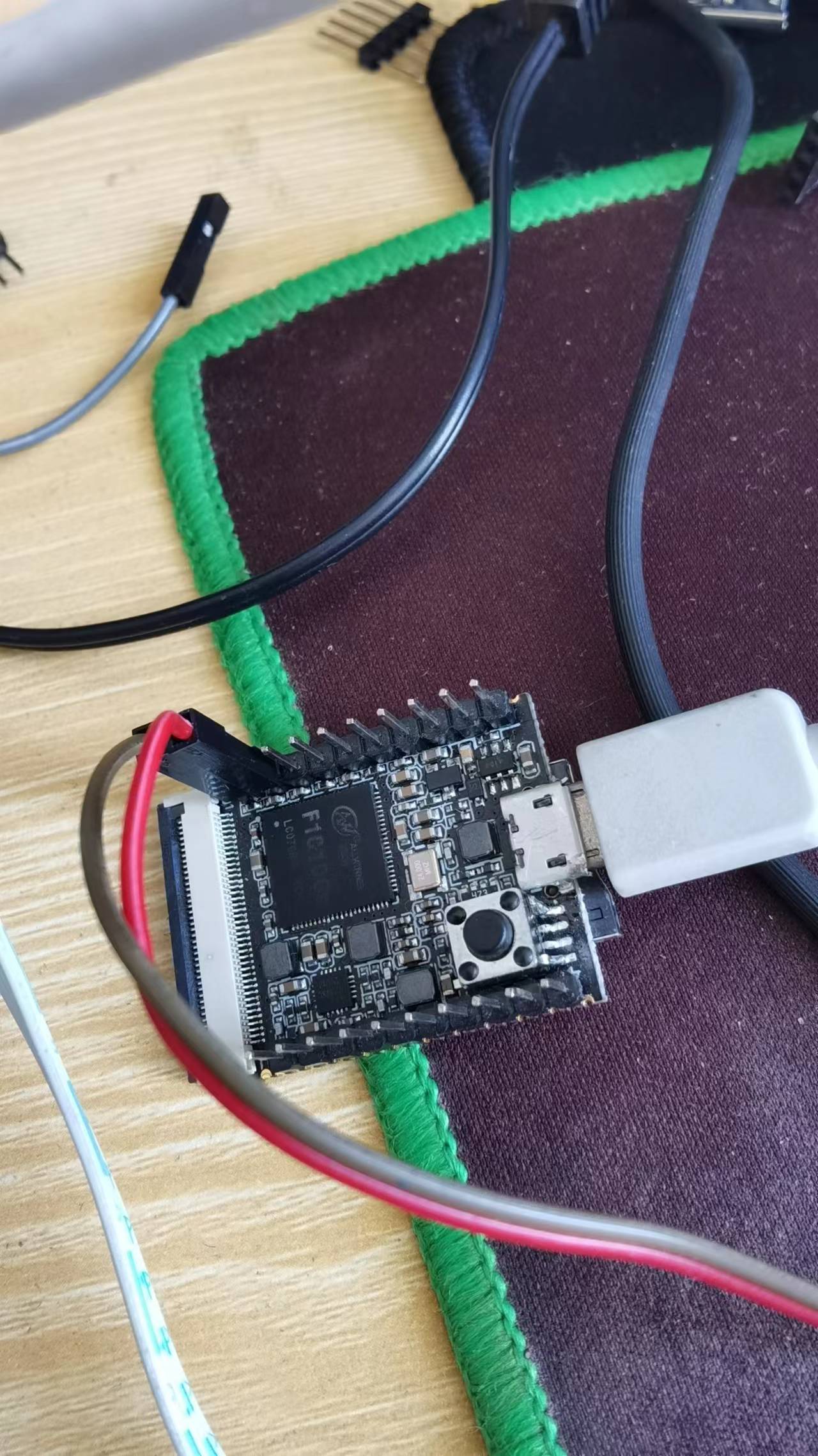

问题又来了, 用 dd 命令把 sysimage-sdcard.img 写到TF卡中,插到之前在淘宝买的老人唱戏机,感觉没什么反应。
UART0 和 SD卡 有部分端口共用, 所以也看不了串口是否有输出。
具体 dd 命令
 sudo dd if=sysimage-sdcard.img of=/dev/sdb
老人唱戏机
.jpg

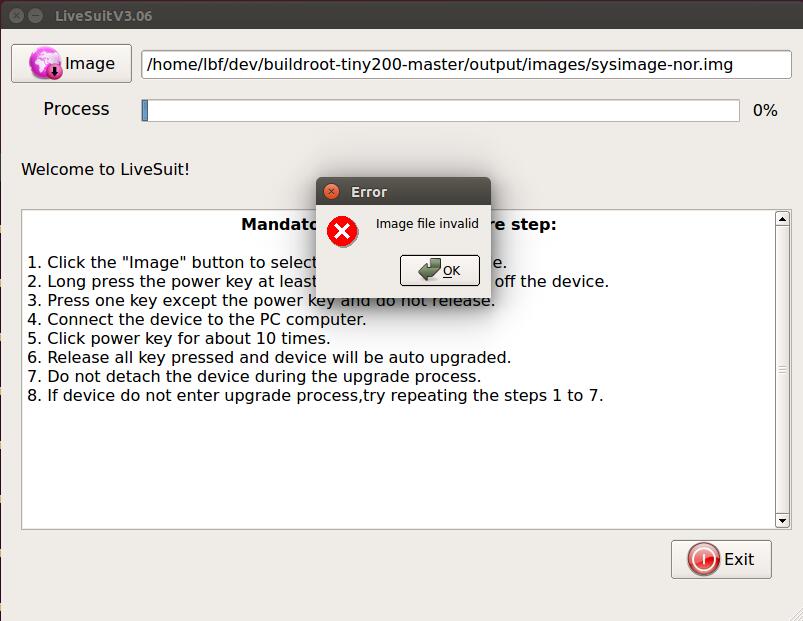

想着把 sysimage-nor.img 写到板子的SPI FLASH中,看是否有反应,谁知 LiveSuit 直接提示文件格式无效, 选择 sysimage-sdcard.img 也是同样提示,
不知道生成的文件是否有问题?

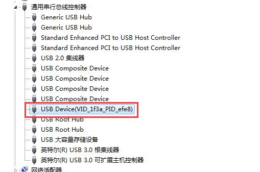

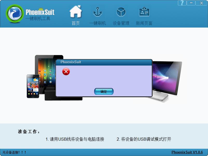

接上面,不插TF卡, 插入USB接到电脑,设备管理是能检测到新增的USB设备的,但是PhoenixSuit会自动弹出错误框。
大虾们,接下来该如何弄呢?脑瓜痛!
PhoenixSuit 提示错误

从楼主的git库,取最新的版本,build了一个sysimage-sdcard.img,烧到sd卡,在tiny200 R3上电启动,加载rootfs时出错。
[    1.776903] Kernel panic - not syncing: VFS: Unable to mount root fs on unkno                                                   wn-block(31,2)
[    1.785238] CPU: 0 PID: 1 Comm: swapper Not tainted 5.4.99 #1
[    1.790965] Hardware name: Allwinner suniv Family
[    1.795734] [<c010e1c8>] (unwind_backtrace) from [<c010b964>] (show_stack+0x1                                                   0/0x14)
[    1.803513] [<c010b964>] (show_stack) from [<c06eea9c>] (panic+0xe8/0x2e4)
[    1.810403] [<c06eea9c>] (panic) from [<c090135c>] (mount_block_root+0x2bc/0x                                                   31c)
[    1.817882] [<c090135c>] (mount_block_root) from [<c0901568>] (prepare_namesp                                                   ace+0x128/0x188)
[    1.826412] [<c0901568>] (prepare_namespace) from [<c06f68d4>] (kernel_init+0                                                   x8/0x108)
[    1.834326] [<c06f68d4>] (kernel_init) from [<c01010e0>] (ret_from_fork+0x14/                                                   0x34)
[    1.841873] Exception stack(0xc2839fb0 to 0xc2839ff8)
似乎kernel使用的bootargs参数错了,这个bootargs是从spi flash上加载rootfs,而我们是从tf卡启动的,rootfs也在tf卡上。
