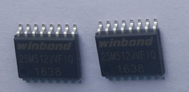

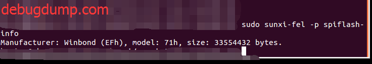

Re: 买两片 W25M512JVFIQ 测试一下
$ sudo sunxi-fel -p spiflash-info
Manufacturer: Winbond (EFh), model: 71h, size: 33554432 bytes
sunxi-fel 不能识别成 512.

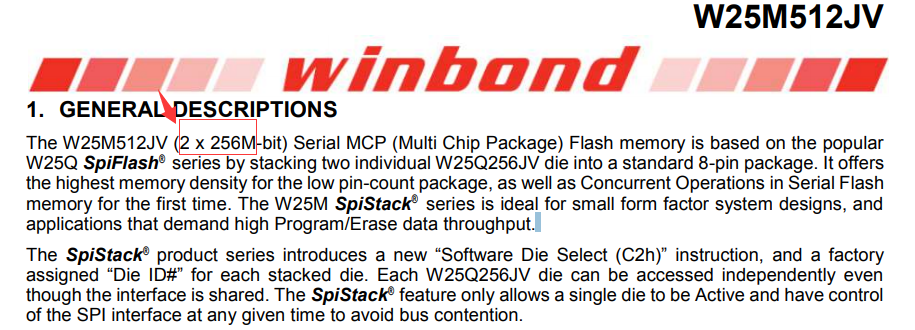

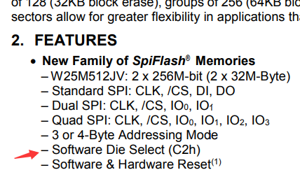

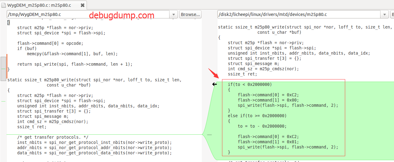

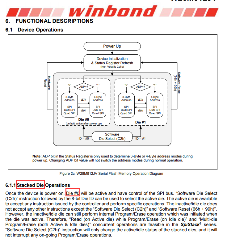

芯片手册: W25M512JV

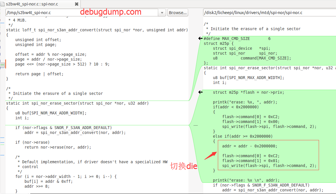

看起来这个芯片就是玩 Die 堆叠了, 叠了两个 W25Q256, 用 0xC2 命令来选则 Die.

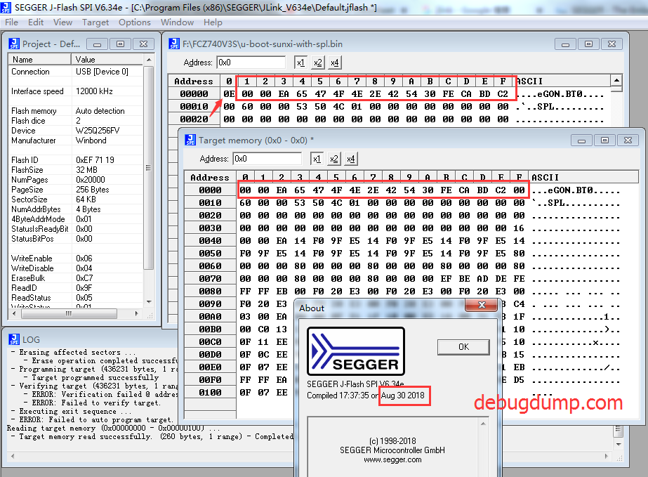

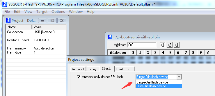

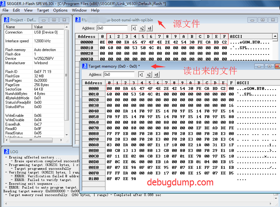

用各个版本的 JLINK 软件都没能烧写正常。
楼主 #8 2018-09-03 11:19:27
已发帖子: 9,440
即使设置了 双 Die 模式也一样不能通过校验.
楼主 #9 2018-09-03 11:21:16
已发帖子: 9,440
sunxi-fel 烧写正常。
楼主 #10 2018-09-03 16:37:00
已发帖子: 9,440
V3s u-boot 修改
licheepi/u-boot/drivers/mtd/spi/spi_flash_ids.c
添加一行:

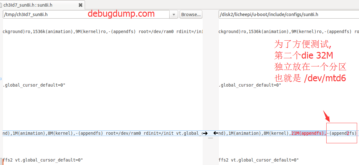

{"w25m512jv",        INFO(0xef7119, 0x0,    64 * 1024,  1024, RD_FULL | WR_QPP | SECT_4K) },

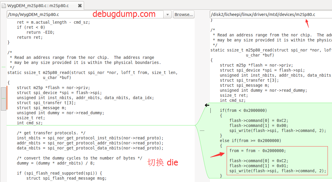

linux
licheepi/linux/drivers/mtd/devices/m25p80.c
添加
{"w25q80bl"},    {"w25q128"},    {"w25q256"}, {"w25m512jv"},
licheepi/linux/drivers/mtd/spi-nor/spi-nor.c
{ "w25m512jv", INFO(0xef7119, 0, 64 * 1024, 1024, SPI_NOR_QUAD_READ | SPI_NOR_DUAL_READ) },
改完之后重新编译烧录, 发现u-boot, Linux都可以启动,w25q256驱动不正常了:
[    0.624277] m25p80 spi32766.0: unrecognized JEDEC id bytes: 00, 00, 00
[    0.624352] m25p80: probe of spi32766.0 failed with error -2

楼主 #12 2018-09-03 18:36:36
已发帖子: 9,440

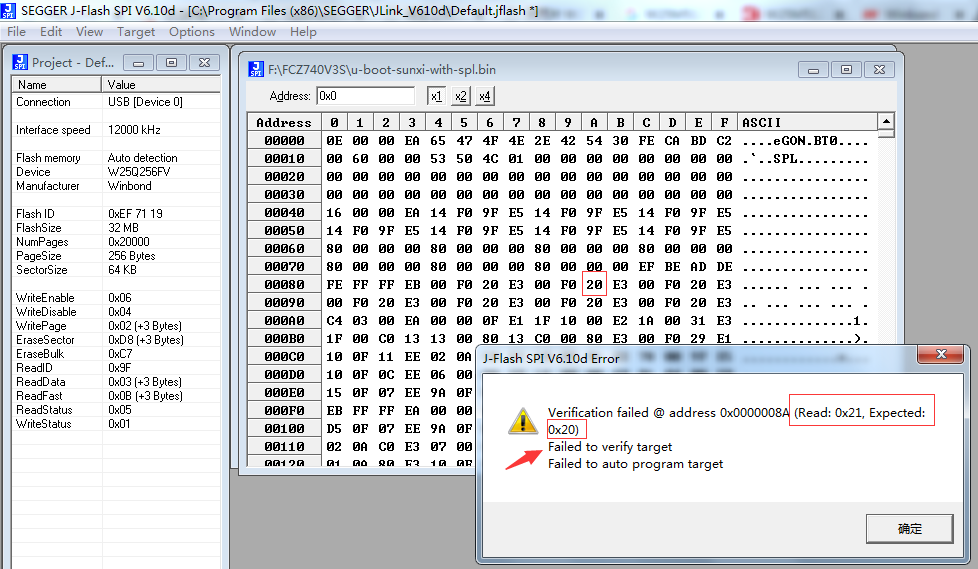

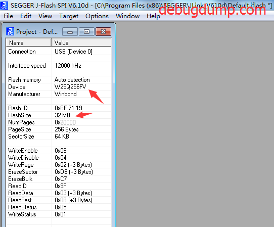

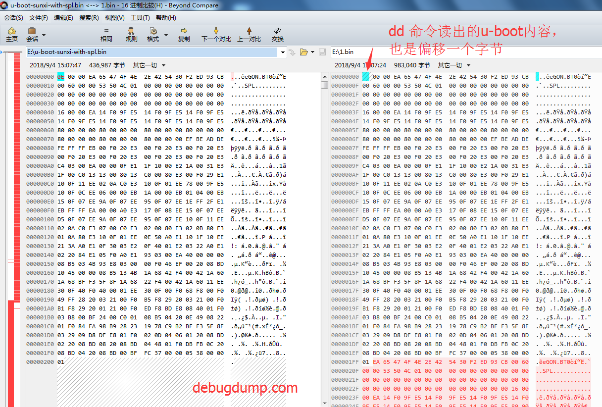

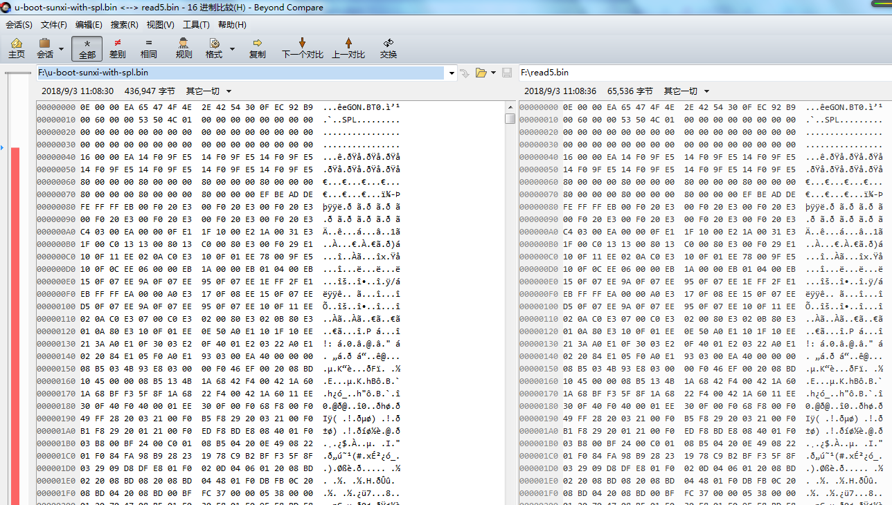

JLINK 6.30i 也是个扯淡的软件, 读出来和写进去偏移了一个字节.
6.10d 可以写一个 u-boot 进去,校验也正常,但是写32M文件在 0xF0000 处校验失败。

+int spi_generic_select_die(int bank, u8 die_num, struct spi_ctrl_driver *ctrl_drv)
+	int retval;
+	u8 command[2];
+	command[0] = CMD_WX25XX_CS;
+	command[1] = die_num;
+	/* Wait until finished previous command. */
+	if (wait_till_ready(bank,ctrl_drv))
+		return -1;
+	retval = ctrl_drv->spi_transfer(bank, command, 2, SPI_NONE, NULL, 0);
+	if (retval < 0)
+		printk ("Could not select die.\n");
+		return spi_error(retval);
+	return 0;

+	if (address32 == ADDRESS_DIE_LO3_HI4_BYTE) {
+		if(sect_addr>=ADDR_32MB){
+			spi_generic_select_die( bank, 1,ctrl_drv);
+			had_switch_die = 1;
+			sect_addr-=ADDR_32MB;
+    if (ractrends_spiflash_flash_id[bank] == 0x00EF1940)
+        u8 reg_data;
+        command[0] = 0x15; /* Read Status Register S23 ~ S16 */
+        cmd_size = 1;
+        retval = ctrl_drv->spi_transfer(bank,command, cmd_size ,SPI_READ, &reg_data, 1);
+        pwr_up_mode = (reg_data & 0x2)>>1; /* S17(ADP) field */

发现最新的 JLink_Windows_V634e.exe 也是一毛一样问题, 偏移了一个字节。

u-boot执行正常 说明: BROM 把 u-boot 读出来没问题
linux执行正常 说明: u-boot 读 flash也没问题
我现在用 flashcp 把 u-boot-sunxi-with-spl.bin 写入 /dev/mtd0,
出现校验错误:
# flash_eraseall /dev/mtd0
Erasing 4 Kibyte @ f0000 - 100% complete.
# flashcp -v u-boot-sunxi-with-spl.bin /dev/mtd0
Erasing block: 107/107 (100%)
Writing kb: 426/426 (100%)
Verifying kb: 0/426 (0%) flashcp: verification mismatch at 0x0
然后我把 /dev/mtd0 dump 出来
dd if=/dev/mtd0 of=5.bin
使用 beyond compare 比较, 完全一致, 说明一个问题:
spi flash 的读驱动有问题,写驱动问题不大, 而且是与JLINK读一毛一样的问题。
继续跟踪.

终于可以当32M用了
{ "w25m512jv", INFO(0xef7119, 0, 64 * 1024, 512, SPI_NOR_QUAD_READ | SPI_NOR_DUAL_READ | SPI_NOR_4B_OPCODES) },
特别感谢这位网友: https://whycan.cn/t_1108.html
明天继续搞64M 切换 DIE.
现在问题来了, 难道 JLINK 的 JFLashSPI.exe 读程序有 4B 地址的bug ?

为了简化问题,把第二个die 单独划分到一个 mtd 分区, 使用 flash_eraseall 格式化分区,
mount jffs2 文件系统,读写文件均正常了.
下一步要把后面的die(32M) 合并到前面来.
楼主 #19 2018-09-06 08:40:03
已发帖子: 9,440
同时操作多个文件会挂,感觉那个切换die整个函数要加锁.
楼主 #20 2018-09-06 08:43:20
已发帖子: 9,440
https://github.com/ya-mouse/openbmc-target/blob/master/aspeed/patches-3.18/0006-Add-various-MTD-SPI-chips.patch
down(&priv->chip_drv->lock);
up(&priv->chip_drv->lock);
看了一下别人切换die, 都要加锁。
