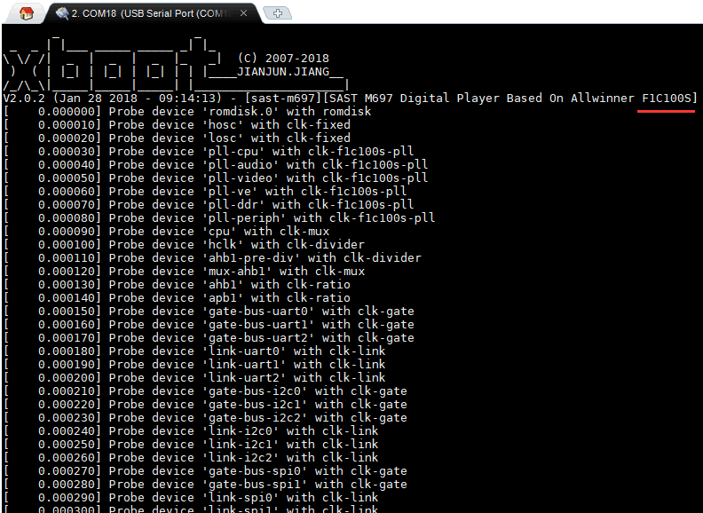

Re: F1C100s入坑记录(linux kernel失败!sunxi-fel, u-boot正常。)
_                   _
_  _ | |___ _____ _____ _| |_
\ \/ /|  _  |  _  |  _  |_   _|  (C) 2007-2018
)  ( | |_| | |_| | |_| | | |____JIANJUN.JIANG__
/_/\_\|_____|_____|_____| |_____________________|
V2.0.2 (Jan 28 2018 - 09:14:13) - [sast-m697][SAST M697 Digital Player Based On Allwinner F1C100S]
[    0.000000] Probe device 'romdisk.0' with romdisk
[    0.000010] Probe device 'hosc' with clk-fixed
[    0.000020] Probe device 'losc' with clk-fixed
[    0.000030] Probe device 'pll-cpu' with clk-f1c100s-pll
[    0.000040] Probe device 'pll-audio' with clk-f1c100s-pll
[    0.000050] Probe device 'pll-video' with clk-f1c100s-pll
[    0.000060] Probe device 'pll-ve' with clk-f1c100s-pll
[    0.000070] Probe device 'pll-ddr' with clk-f1c100s-pll
[    0.000080] Probe device 'pll-periph' with clk-f1c100s-pll
[    0.000090] Probe device 'cpu' with clk-mux
[    0.000100] Probe device 'hclk' with clk-divider
[    0.000110] Probe device 'ahb1-pre-div' with clk-divider
[    0.000120] Probe device 'mux-ahb1' with clk-mux
[    0.000130] Probe device 'ahb1' with clk-ratio
[    0.000140] Probe device 'apb1' with clk-ratio
[    0.000150] Probe device 'gate-bus-uart0' with clk-gate
[    0.000160] Probe device 'gate-bus-uart1' with clk-gate
[    0.000170] Probe device 'gate-bus-uart2' with clk-gate
[    0.000180] Probe device 'link-uart0' with clk-link
[    0.000190] Probe device 'link-uart1' with clk-link
[    0.000200] Probe device 'link-uart2' with clk-link
[    0.000210] Probe device 'gate-bus-i2c0' with clk-gate
[    0.000220] Probe device 'gate-bus-i2c1' with clk-gate
[    0.000230] Probe device 'gate-bus-i2c2' with clk-gate
[    0.000240] Probe device 'link-i2c0' with clk-link
[    0.000250] Probe device 'link-i2c1' with clk-link
[    0.000260] Probe device 'link-i2c2' with clk-link
[    0.000270] Probe device 'gate-bus-spi0' with clk-gate
[    0.000280] Probe device 'gate-bus-spi1' with clk-gate
[    0.000290] Probe device 'link-spi0' with clk-link
[    0.000300] Probe device 'link-spi1' with clk-link
[    0.000310] Probe device 'mux-timer0' with clk-mux
[    0.000320] Probe device 'ratio-timer0' with clk-ratio
[    0.000330] Probe device 'link-timer0' with clk-link
[    0.000340] Probe device 'mux-timer1' with clk-mux
[    0.000350] Probe device 'ratio-timer1' with clk-ratio
[    0.000360] Probe device 'link-timer1' with clk-link
[    0.000370] Probe device 'mux-timer2' with clk-mux
[    0.000380] Probe device 'ratio-timer2' with clk-ratio
[    0.000390] Probe device 'link-timer2' with clk-link
[    0.000400] Probe device 'link-pwm' with clk-link
[    0.000410] Probe device 'link-wdt' with clk-link
[    0.000420] Probe device 'mux-defe' with clk-mux
[    0.000430] Probe device 'div-defe' with clk-divider
[    0.000440] Probe device 'gate-defe' with clk-gate
[    0.000450] Probe device 'gate-bus-defe' with clk-gate
[    0.000460] Probe device 'link-defe' with clk-link
[    0.000470] Probe device 'mux-debe' with clk-mux
[    0.000480] Probe device 'div-debe' with clk-divider
[    0.000490] Probe device 'gate-debe' with clk-gate
[    0.000500] Probe device 'gate-bus-debe' with clk-gate
[    0.000510] Probe device 'link-debe' with clk-link
[    0.000520] Probe device 'mux-tcon' with clk-mux
[    0.000530] Probe device 'gate-tcon' with clk-gate
[    0.000540] Probe device 'gate-bus-tcon' with clk-gate
[    0.000550] Probe device 'link-tcon' with clk-link
[    0.000560] Probe device 'reset-f1c100s.0' with reset-f1c100s
[    0.000570] Probe device 'reset-f1c100s.1' with reset-f1c100s
[    0.000580] Probe device 'reset-f1c100s.2' with reset-f1c100s
[    0.000590] Probe device 'irq-f1c100s.0' with irq-f1c100s
[    0.000600] Probe device 'irq-f1c100s-gpio.0' with irq-f1c100s-gpio
[    0.000610] Probe device 'irq-f1c100s-gpio.1' with irq-f1c100s-gpio
[    0.000620] Probe device 'irq-f1c100s-gpio.2' with irq-f1c100s-gpio
[    0.000630] Probe device 'gpio-f1c100s.0' with gpio-f1c100s
[    0.000640] Probe device 'gpio-f1c100s.1' with gpio-f1c100s
[    0.000650] Probe device 'gpio-f1c100s.2' with gpio-f1c100s
[    0.000660] Probe device 'gpio-f1c100s.3' with gpio-f1c100s
[    0.000670] Probe device 'gpio-f1c100s.4' with gpio-f1c100s
[    0.000680] Probe device 'pwm-f1c100s.0' with pwm-f1c100s
[    0.000690] Probe device 'pwm-f1c100s.1' with pwm-f1c100s
[    0.000700] Probe device 'ce-f1c100s-timer.0' with ce-f1c100s-timer
[    0.000052] Probe device 'cs-f1c100s-timer.0' with cs-f1c100s-timer
[    0.006456] Probe device 'i2c-f1c100s.0' with i2c-f1c100s
▒▒ځ   0.022901] Probe device 'uart-16550.0' with uart-16550s
[    0.028168] Probe device 'uart-16550.1' with uart-16550
[    0.033392] Probe device 'uart-16550.2' with uart-16550
[    0.038588] Probe device 'spi-f1c100s.0' with spi-f1c100s
[    0.043953] Probe device 'spi-f1c100s.1' with spi-f1c100s
[    0.049301] Fail to probe device with spi-flash
[    0.053790] Probe device 'wdog-f1c100s.0' with wdog-f1c100s
[    0.059338] Probe device 'key-f1c100s-lradc.0' with key-f1c100s-lradc
[    0.065736] Probe device 'led-gpio.0' with led-gpio
[    0.070569] Probe device 'ledtrig-heartbeat.0' with ledtrig-heartbeat
[    0.076962] Probe device 'led-pwm-bl.0' with led-pwm-bl
[    0.101522] Probe device 'fb-f1c100s.0' with fb-f1c100s
[    0.106722] Probe device 'console-uart.0' with console-uart
Press any key to stop autoboot:  0.000
xboot: /$
烧了xboot 的f1c100s 程序, 背光亮了,串口输出正常, 屏幕没有显示.
