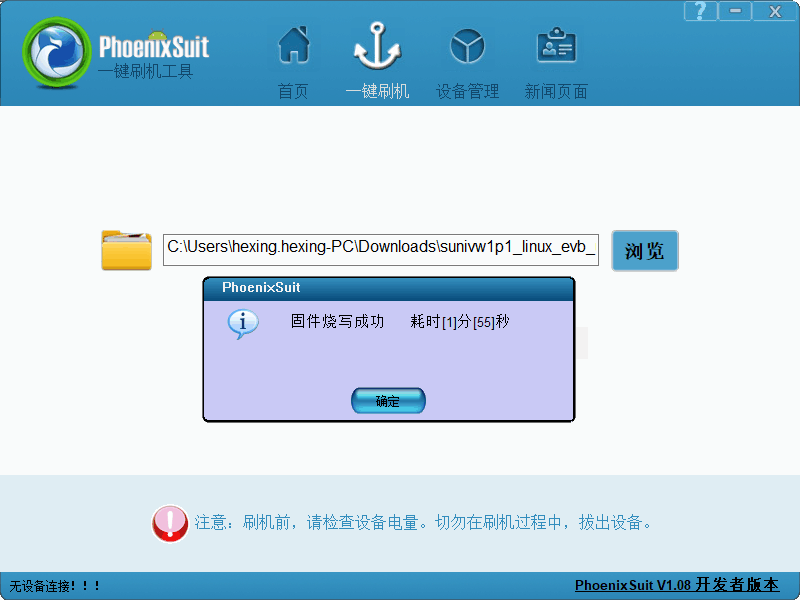

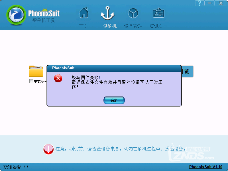

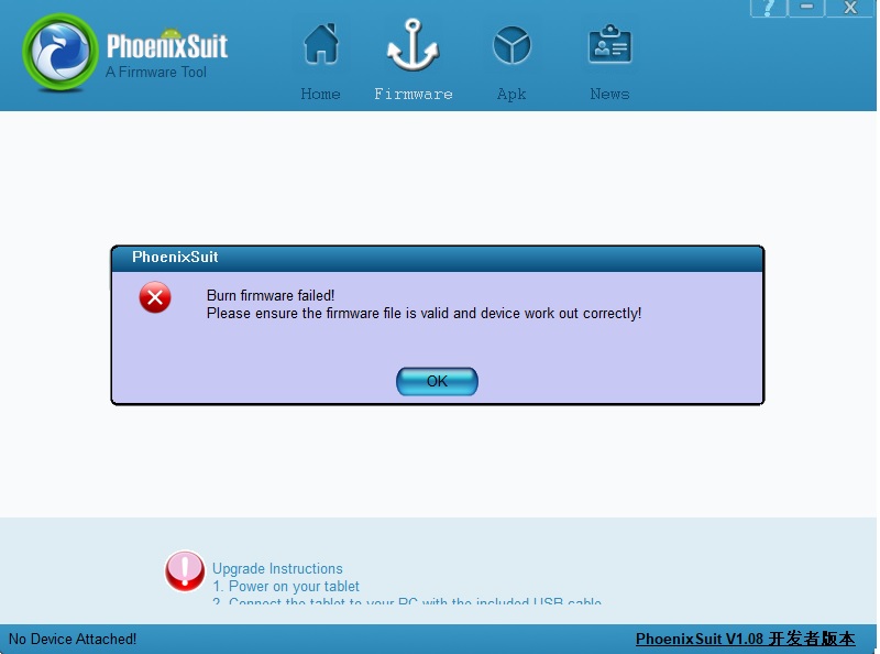

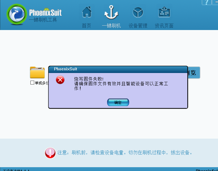

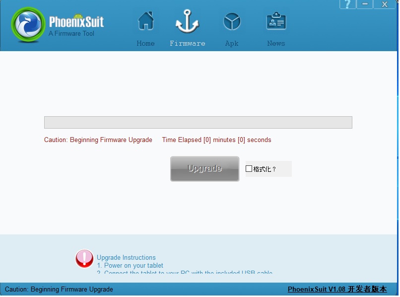

以下是2018-08-13 更新:
全志官方烧录软件: PhoenixSuit_CN_debug.msi
我编译的img: sunivw1p1_linux_evb_uart0.img.tar.gz

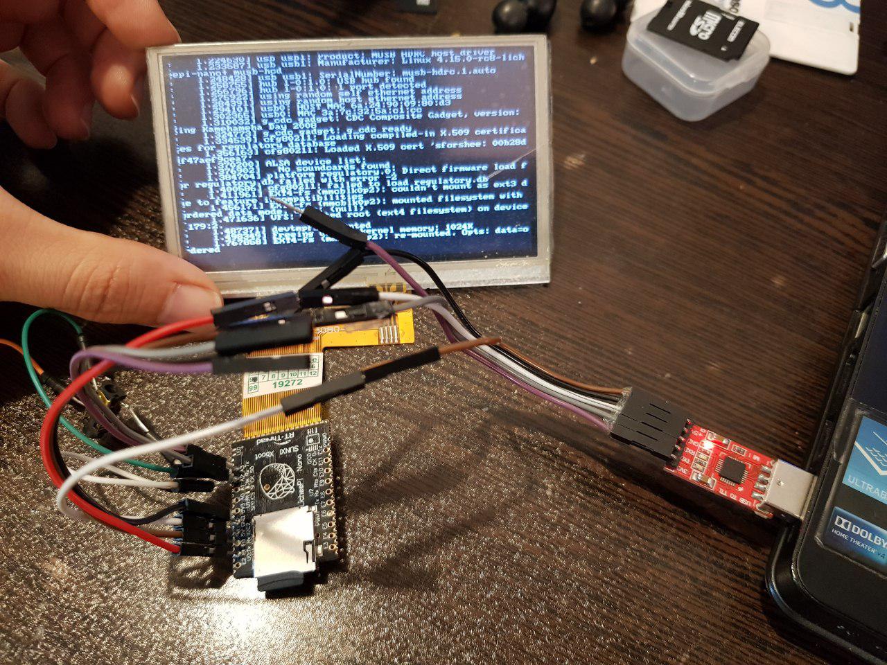

串口线接 A0, A1

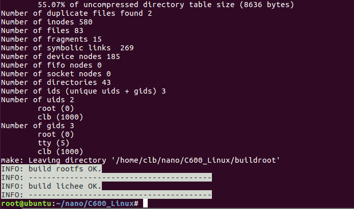

楼主 #4 2018-04-19 17:24:24
已发帖子: 9,413
Re: 【1】step by step 编译全志 f1c100s 官方linux bsp
test -z "/opt/c600/out/sunivw1p1/linux/common/buildroot/host/usr/bin" || /bin/mkdir -p "/opt/c600/out/sunivw1p1/linux/common/sr/bin"
  /bin/bash ./libtool   --mode=install /usr/bin/install -c 'faked' '/opt/c600/out/sunivw1p1/linux/common/buildroot/host/usr/b
libtool: install: /usr/bin/install -c faked /opt/c600/out/sunivw1p1/linux/common/buildroot/host/usr/bin/faked
make[3]: Nothing to be done for `install-data-am'.
make[3]: Leaving directory `/opt/c600/out/sunivw1p1/linux/common/buildroot/build/host-fakeroot-1.9.5'
make[2]: Leaving directory `/opt/c600/out/sunivw1p1/linux/common/buildroot/build/host-fakeroot-1.9.5'
make[1]: Leaving directory `/opt/c600/out/sunivw1p1/linux/common/buildroot/build/host-fakeroot-1.9.5'
rm -rf /opt/c600/out/sunivw1p1/linux/common/buildroot/build/host-makedevs
mkdir /opt/c600/out/sunivw1p1/linux/common/buildroot/build/host-makedevs
cp package/makedevs/makedevs.c /opt/c600/out/sunivw1p1/linux/common/buildroot/build/host-makedevs
cc -Wall -Werror -O2 /opt/c600/out/sunivw1p1/linux/common/buildroot/build/host-makedevs/makedevs.c -o /opt/c600/out/sunivw1p1ildroot/build/host-makedevs/makedevs
/opt/c600/out/sunivw1p1/linux/common/buildroot/build/host-makedevs/makedevs.c: In function ‘main’:
/opt/c600/out/sunivw1p1/linux/common/buildroot/build/host-makedevs/makedevs.c:374:6: error: variable ‘ret’ set but not used [ut-set-variable]
  int ret = EXIT_SUCCESS;
cc1: all warnings being treated as errors
make: *** [/opt/c600/out/sunivw1p1/linux/common/buildroot/build/host-makedevs/makedevs] Error 1
make: Leaving directory `/opt/c600/buildroot'
ERROR: build buildroot Failed
一个编译错误。
文件 /opt/c600/out/sunivw1p1/linux/common/buildroot/build/host-makedevs/makedevs.c 最末
改为
return ret;
即可。

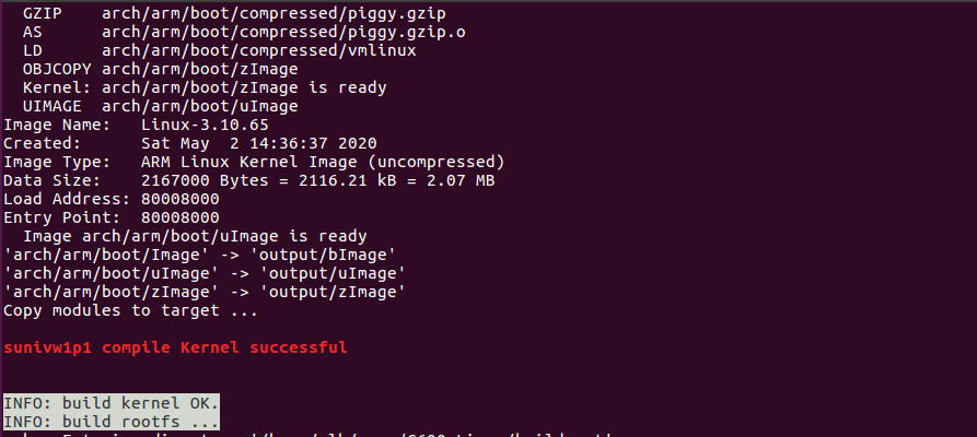

楼主 #6 2018-04-19 18:05:44
已发帖子: 9,413
In file included from drivers/soc/allwinner/pm-suniv/standby/standby_i.h:21:0,
                 from drivers/soc/allwinner/pm-suniv/standby/standby_clock.h:20,
                 from drivers/soc/allwinner/pm-suniv/standby/standby_clock.c:9:
include/linux/power/aw_pm.h:143:0: warning: "PLL_NUM" redefined
include/linux/power/aw_pm.h:92:0: note: this is the location of the previous definition
include/linux/power/aw_pm.h:153:0: warning: "BUS_NUM" redefined
include/linux/power/aw_pm.h:93:0: note: this is the location of the previous definition
rm -rf *.o drivers/soc/allwinner/pm-suniv/standby/./*.o
  AS      drivers/soc/allwinner/pm-suniv/standby.o
  LD      drivers/soc/allwinner/pm-suniv/built-in.o
  LD      drivers/soc/allwinner/built-in.o
  LD      drivers/soc/built-in.o
  LD      drivers/built-in.o
  LINK    vmlinux
  LD      vmlinux.o
  MODPOST vmlinux.o
WARNING: modpost: Found 3 section mismatch(es).
To see full details build your kernel with:
'make CONFIG_DEBUG_SECTION_MISMATCH=y'
  GEN     .version
  CHK     include/generated/compile.h
  UPD     include/generated/compile.h
  CC      init/version.o
  LD      init/built-in.o
  KSYM    .tmp_kallsyms1.o
  KSYM    .tmp_kallsyms2.o
  LD      vmlinux
  SORTEX  vmlinux
  SYSMAP  System.map
  OBJCOPY arch/arm/boot/Image
  Kernel: arch/arm/boot/Image is ready
  GZIP    arch/arm/boot/compressed/piggy.gzip
  AS      arch/arm/boot/compressed/piggy.gzip.o
  LD      arch/arm/boot/compressed/vmlinux
  OBJCOPY arch/arm/boot/zImage
  Kernel: arch/arm/boot/zImage is ready
  Building modules, stage 2.
  MODPOST 3 modules
make: Nothing to be done for `modules'.
  CHK     include/generated/uapi/linux/version.h
  CHK     include/generated/utsrelease.h
make[1]: `include/generated/mach-types.h' is up to date.
  CALL    scripts/checksyscalls.sh
  CC      scripts/mod/devicetable-offsets.s
  GEN     scripts/mod/devicetable-offsets.h
  HOSTCC  scripts/mod/file2alias.o
  HOSTLD  scripts/mod/modpost
  CC      drivers/soc/allwinner/pm-suniv/standby/main.o
                 from drivers/soc/allwinner/pm-suniv/standby/main.c:19:
  AS      drivers/soc/allwinner/pm-suniv/standby/suniv-standby.o
  CC      drivers/soc/allwinner/pm-suniv/standby/dram_sys.o
  CC      drivers/soc/allwinner/pm-suniv/standby/standby_clock.o
  LINK    vmlinux
  LD      vmlinux.o
  MODPOST vmlinux.o
  GEN     .version
  CC      init/version.o
  LD      init/built-in.o
  LD      vmlinux
  SORTEX  vmlinux
  SYSMAP  System.map
  UIMAGE  arch/arm/boot/uImage
Image Name:   Linux-3.10.65
Created:      Thu Apr 19 06:02:31 2018
Data Size:    2167008 Bytes = 2116.22 kB = 2.07 MB
Load Address: 80008000
Entry Point:  80008000
  Image arch/arm/boot/uImage is ready
‘arch/arm/boot/Image’ -> ‘output/bImage’
‘arch/arm/boot/uImage’ -> ‘output/uImage’
‘arch/arm/boot/zImage’ -> ‘output/zImage’
Copy modules to target ...
sunivw1p1 compile Kernel successful
INFO: build kernel OK.
INFO: build rootfs OK.
INFO: ----------------------------------------
INFO: build lichee OK.
root@localhost:/opt/c600#
编译成功,但是不知道生成的 img 在何处 .
-rw-r--r-- 1 root root  305770 Apr 19 04:55 ./linux-3.10/drivers/staging/ft1000/ft1000-pcmcia/ft1000.img
-rw-r--r-- 1 root root  280414 Apr 19 04:55 ./linux-3.10/drivers/staging/ft1000/ft1000-usb/ft3000.img
-rw-r--r-- 1 root root 7256064 Apr 19 06:02 ./linux-3.10/output/boot.img
-rw-r--r-- 1 root root 7256064 Apr 19 06:02 ./out/sunivw1p1/linux/common/boot.img

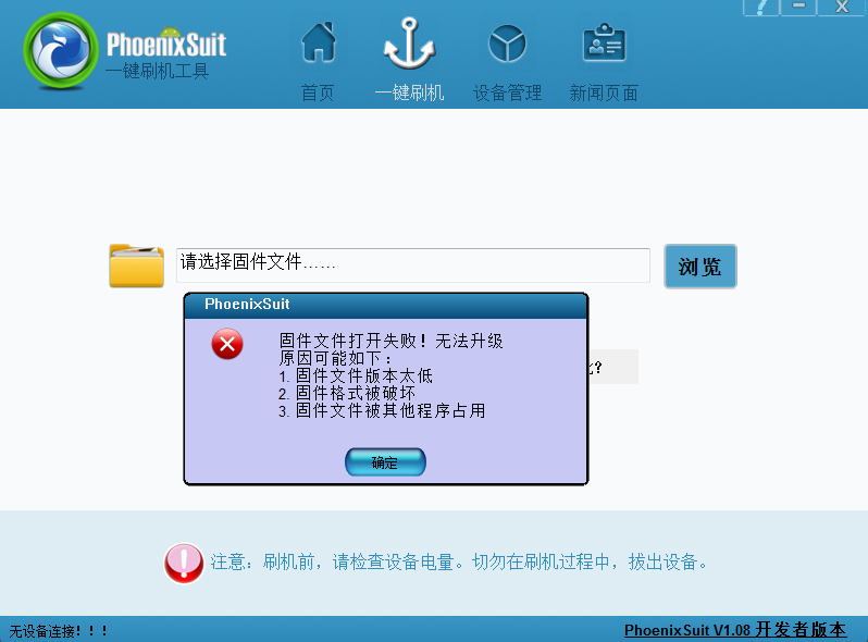

出师不利
估计和v3s不是同一个软件...
那么问题来了, 哪里有f1c100s的官方烧录软件?
楼主 #8 2018-04-19 18:06:13

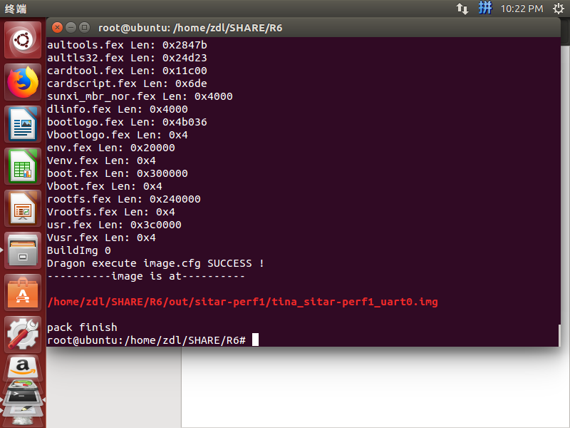

root@localhost:/opt/c600# ./build.sh pack
INFO: packing firmware ...
copying tools file
copying configs file
./out/aultls32.fex
./out/aultools.fex
./out/bootlogo.fex
./out/boot_package.cfg
./out/boot_package.fex
./out/boot_package_nor.cfg
./out/cardscript.fex
./out/cardtool.fex
./out/diskfs.fex
./out/env_burn.cfg
./out/env.cfg
./out/image.cfg
‘./out/image_linux.cfg’ -> ‘./out/image.cfg’
./out/recover_f.fex
./out/recover_k.fex
./out/split_xxxx.fex
./out/sunxi.fex
./out/sys_config.fex
./out/sys_partition_dragonboard.fex
./out/sys_partition_dump.fex
./out/sys_partition.fex
‘./out/sys_partition_linux.fex’ -> ‘./out/sys_partition.fex’
./out/sys_partition_nor.fex
./out/sys_partition_private.fex
./out/test_config.fex
./out/toc0.fex
./out/toc1.fex
./out/usbtool.fex
./out/usbtool_test.fex
copying boot resource
copying boot file
p=soc c=product state=0
p=soc c=platform state=0
p=soc c=target state=0
p=soc c=power_sply state=0
p=soc c=card_boot state=0
p=soc c=pm_para state=0
p=soc c=card0_boot_para state=0
p=soc c=card2_boot_para state=0
p=soc c=twi_para state=0
p=soc c=uart_para state=0
p=soc c=jtag_para state=0
p=soc c=dram state=0
p=soc c=twi0 state=0
p=soc c=twi1 state=0
p=soc c=twi2 state=0
p=soc c=uart0 state=0
p=soc c=uart1 state=0
p=soc c=spi0 state=0
p=soc c=rtp_para state=0
p=soc c=ctp_para state=0
p=soc c=tkey_para state=0
p=soc c=motor_para state=0
p=soc c=nand0 state=0
p=soc c=disp_init state=0
p=soc c=lcd0 state=0
p=soc c=pwm0_para state=0
p=soc c=pwm1_para state=0
p=soc c=vip0 state=0
p=soc c=tvout_para state=0
p=soc c=tvin_para state=0
p=soc c=di state=0
p=soc c=sdc0 state=0
p=soc c=sdc1 state=0
p=soc c=smc state=0
p=soc c=gsensor_para state=0
p=soc c=gps_para state=0
p=soc c=wifi_para state=0
p=soc c=gy_para state=0
p=soc c=ls_para state=0
p=soc c=compass_para state=0
p=soc c=bt_para state=0
p=soc c=audiospdif state=0
p=soc c=spdif_machine state=0
p=soc c=audiohdmi state=0
p=soc c=hdmi_machine state=0
p=soc c=pmu0 state=0
p=soc c=pmu0_regu state=0
p=soc c=dvfs_table state=0
p=soc c=Vdevice state=0
Conver script to dts ok.
./pack: line 439: busybox: command not found
./pack: line 440: busybox: command not found
./pack: line 436:  4466 Segmentation fault      script sys_partition.fex > /dev/null
update_fdt: u-boot-spinor.fex will merage sunxi.fex, generate u-boot-spinor.fex
---0xd0, 0xd
update_fdt: num 216204 randto1k
update_fdt: num 40289 randto1k
file1_len = 35000, file2_len = c000
----------i1111-217088
dtb offset 35000,size c000
update_fdt:genrate /opt/c600/tools/pack/out/u-boot-spinor.fex ok
./pack: line 462: busybox: command not found
pack boot package
./pack: line 469: busybox: command not found
GetPrivateProfileSection read to end
content_count=1
pack boot package
./pack: line 501: busybox: command not found
content_count=1
packing for linux
normal
load file: boot0_spinor.fex ok
load file: boot_package_nor.fex ok
load file: sunxi_mbr.fex ok
load file: sys_partition.bin ok
load file: kernel.fex ok
this is not a partition key
merge_package ok
/opt/c600/tools/pack/pctools/linux/eDragonEx/
Begin Parse sys_partion.fex
Add partion boot-resource.fex BOOT-RESOURCE_FEX
Add partion very boot-resource.fex BOOT-RESOURCE_FEX
FilePath: boot-resource.fex
FileLength=483400Add partion env.fex ENV_FEX000000000
Add partion very env.fex ENV_FEX000000000
FilePath: env.fex
FileLength=20000Add partion boot.fex BOOT_FEX00000000
Add partion very boot.fex BOOT_FEX00000000
FilePath: boot.fex
FileLength=6eb800sys_config.fex Len: 0xab09
config.fex Len: 0x6900
split_xxxx.fex Len: 0x200
sys_partition.fex Len: 0xb49
sunxi.fex Len: 0x9d61
boot0_nand.fex Len: 0x8000
boot0_sdcard.fex Len: 0x8000
u-boot.fex Len: 0x64000
toc1.fex Len: 0x8
toc0.fex Len: 0x8
fes1.fex Len: 0x2740
boot_package.fex Len: 0x68000
full_img.fex Len: 0x2c0000
usbtool.fex Len: 0x23000
aultools.fex Len: 0x26ead
aultls32.fex Len: 0x238dd
cardtool.fex Len: 0x18e00
cardscript.fex Len: 0x779
sunxi_mbr.fex Len: 0x4000
dlinfo.fex Len: 0x4000
arisc.fex Len: 0x6
boot-resource.fex Len: 0x483400
Vboot-resource.fex Len: 0x4
env.fex Len: 0x20000
Venv.fex Len: 0x4
boot.fex Len: 0x6eb800
Vboot.fex Len: 0x4
BuildImg 0
Dragon execute image.cfg SUCCESS !
/opt/c600/tools/pack/sunivw1p1_linux_evb_uart0.img
pack finish
楼主 #9 2018-04-19 18:06:19
已发帖子: 9,413

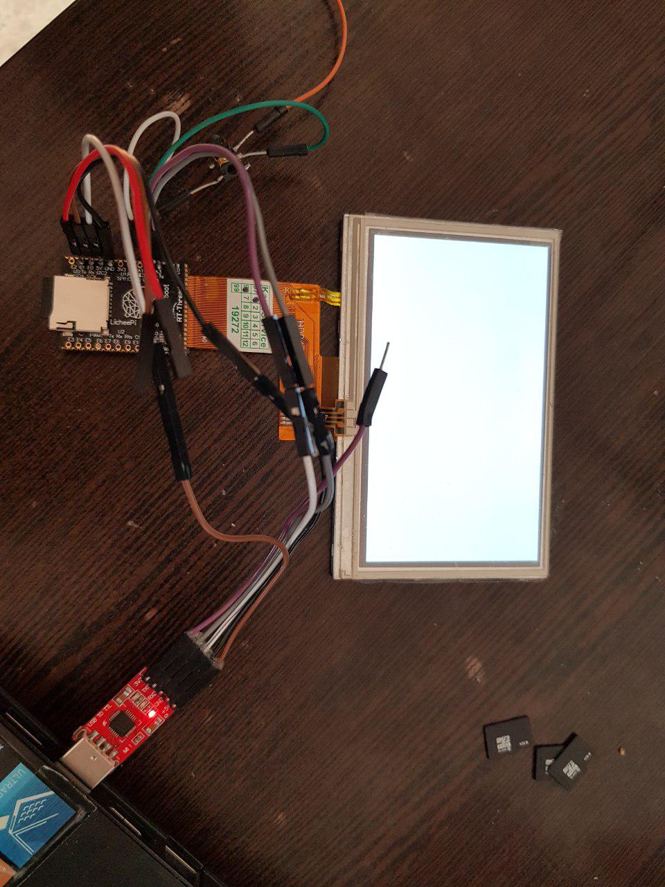

烧是烧完了, 两组UART0串口都没反应.

iki1120 说:
固件大小只有一半,不能正常启动kernel的原因可能是分区配置和产品配置的问题。
建议晕哥尝试:
    1,在linux-3.10上层目录执行./build.sh config进行产品配置
    2,在tools目录查找sys_partition.fex,使用nor的话,应该是sys_partition_nor.fex。
看看分区是否合理。
那个问题后来解决了。
现在是用全志官方软件根本烧不进去,
换几台电脑都不行,
一开始能烧进去的 img 现在换了5台都不行。
https://whycan.cn/files/members/3/165923gsascz2dhd2tadmv.png
现在改用开源的 sunxi-fel, 一点问题都没有。
自己处理烧写地址问题.
晕哥,请教一下,C600编译出来的是img镜像,如何使用sunxi-fel进行烧录呢?

#26 2018-06-29 14:39:42
heirun
注册时间: 2018-06-29
积分: 11
本帖九楼那个软件烧录。
我使用PhoenixSuit这个软件烧录的时候,一直卡住,界面显示开始烧写固件,进度条却一点没有,最后就超时了,这个是什么原因呀?

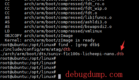

编译生成 dtb文件
make ARCH=arm CROSS_COMPILE=arm-linux-gnueabi- dtbs -j4
生成的 dtb文件 在 dts同级目录下 没有找到生成 dtb的文件
楼主 #48 2018-08-02 21:39:06
已发帖子: 9,413
dtb 文件在 arch/arm/boot/ 目录下面
也可以用这个命令找:
find . | grep XXX.dtb
find 是查找命令,  点号是当前目录, | 是管道输出, grep 是从查找字符串
比如 f1c100s bsp linux 的dtb 位置:
/opt/c600/linux-3.10/arch/arm/boot/dts/sunivw1p1-evb.dtb

Nano的设备树在源码的 linux ‣ arch ‣ arm ‣ boot ‣ dts ‣ suniv-f1c100s-licheepi-nano.dts
编译生成 dtb文件
但是我们找不到这个 dtb文件。

帮我看看Nano的设备树在源码的 linux ‣ arch ‣ arm ‣ boot ‣ dts目录下为啥没有DTB文件?
楼主 #60 2018-08-05 17:48:10
已发帖子: 9,413
egsen 说:
./arch/arm/boot/dts/suniv-f1c100s-licheepi-nano.dtb

我的在这个目录下找不到,是不是我下载的LINUX有问题?
楼主 #63 2018-08-05 19:45:22
已发帖子: 9,413
egsen 说:
http://nano.lichee.pro/build_sys/kernel.html
按这个一步一步走就可以了,我刚刚就是在干净的环境编译的。
我就是 按这个步骤来的
楼主 #67 2018-08-06 18:36:35
已发帖子: 9,413
egsen 说:
我就是 按这个步骤来的
然后还是没生成  arch/arm/boot/dts/suniv-f1c100s-licheepi-nano.dtb ?
#68 2018-08-06 19:00:48
egsen
注册时间: 2018-07-25
已发帖子: 31
积分: 31
是的,没有

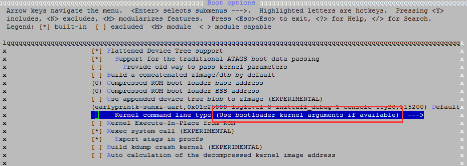

积分: 35
需要修改 配置才能从 UART0 输出 log。
* 确保可以使用uboot中的bootargs
* 采用UART0作为调试口
串口线接 A0, A1
麻烦请告知下调试串口是接的哪2个?我烧录了这个固件,串口没有打印。

#88 2019-01-11 18:02:48
monosail
注册时间: 2019-01-06
我这边是怎么着都显示“尚未检测到设备接入电脑”。请问正确的操作应该是怎样的?
我就是把SPI Flash的CS叫接地,然后接上USB,Windows的设备管理器里面会有设备,PhoenixSuit虽然会跳出来界面,但是一直都是“尚未检测到设备接入电脑)
https://whycan.cn/files/members/3/QQ20180419204822.png
楼主 #89 2019-01-11 18:09:37
已发帖子: 9,413
monosail 说:
接上串口线,可以看到log,会显示原因的
#90 2019-01-11 18:16:11
monosail
注册时间: 2019-01-06
串口没有任何输出啊。
我这个操作流程正确吗?
会跟操作系统有关吗?我是win10.
楼主 #91 2019-01-11 18:28:55
已发帖子: 9,413
说明USB通讯正常, 软件会把 u-boot 下进去跑, 你看下 sys_config.fex 配置的调试串口是哪一个,
然后接对应的串口看调试信息,
荔枝派nano的 PA 0 .. 3 丝印反了, 注意一下。

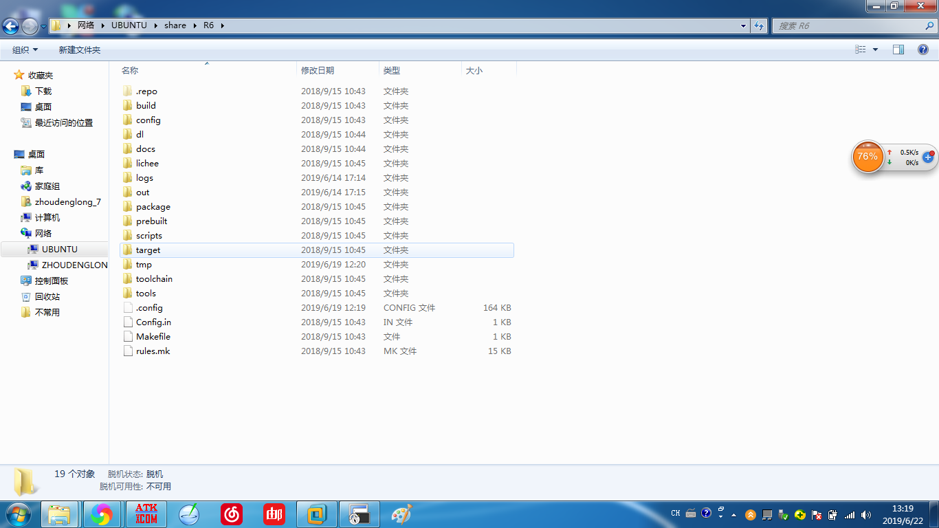

zdl229892205 说:
楼主你好,请问如何运行官方SDK中的示例程序
https://whycan.cn/t_1522.html#p8073
可以按照这个第5步,先编译,然后拷贝

#114 2019-11-27 17:55:40
Vivian
注册时间: 2019-11-27
那个问题后来解决了。
现在是用全志官方软件根本烧不进去,
换几台电脑都不行,
自己处理烧写地址问题.
你好,我现在出现一样的问题,请问 能否指点一下怎么处理?
盼复,谢谢。
楼主 #115 2019-11-27 17:59:59
已发帖子: 9,413
接上串口,u-boot有错误信息输出的。
#116 2019-11-27 18:17:16
Vivian
注册时间: 2019-11-27
只提示fes1 init end就没有别的log了……
楼主 #117 2019-11-27 18:31:05
已发帖子: 9,413
Vivian 说:
感觉 dram  没有初始化成功。
你的板子是荔枝派还是自己做的,要不烧个 路漫漫的固件看下硬件有没有问题。
I have compiled, but the lcd is not working
480*272
here is serial log, sys_config.fex, sunivw1p1-pinctrl.dtsi and sunivw1p1smp_defconfig
https://whycan.cn/files/members/2525/serial_log.txt
https://whycan.cn/files/members/2525/sunivw1p1_dtsi.txt
https://whycan.cn/files/members/2525/sunivw1p1-pinctrl_dtsi.txt
https://whycan.cn/files/members/2525/sys_config_fex.txt
please check it i am confused ...
最近编辑记录 Biftor (2019-12-14 18:09:28)
楼主 #120 2019-12-14 18:16:00
已发帖子: 9,413
改 sys_config.fex 的这部分:
lcd_x = 800
lcd_y = 480
改为:
lcd_x = 480
lcd_y = 272
#121 2019-12-14 18:26:14
Biftor
注册时间: 2019-11-28
已发帖子: 34
积分: 34
lcd_x = 800
lcd_y = 480
改为:
lcd_x = 480
lcd_y = 272
I did it,
but same result no lcd
also i did clean build too .
https://whycan.cn/files/members/2525/sys_config_fex_20191214-1828.txt
最近编辑记录 Biftor (2019-12-14 18:28:43)
楼主 #122 2019-12-14 18:31:16
已发帖子: 9,413
lcd_used = 1
lcd_used = 0
#123 2019-12-14 18:41:40
Biftor
注册时间: 2019-11-28
已发帖子: 34
积分: 34
lcd_used = 1
lcd_used = 0
still no lcd (it is only back light white)
./build clean
./build
./build pack
https://whycan.cn/files/members/2525/sys_config_fex_20191214-1840.txt
最近编辑记录 Biftor (2019-12-14 18:42:20)

Biftor
注册时间: 2019-11-28
已发帖子: 34
积分: 34
daydayup 说:
参考@晕哥另外一个帖子: https://whycan.cn/t_1522.html
I have tried that too, i got same result .
the lcd is working when i follow
nano.lichee.pro .
but that Kernel linux not support video/audio hardware driver.

#129 2019-12-15 15:05:37
Biftor
注册时间: 2019-11-28
已发帖子: 34
积分: 34
I tried it but failed.
git lfs clone https://github.com/qq516333132/c600.git
first i didn't touch just build
./build.sh config
./build.sh
./build.sh pack
no LCD .
i did
lcd_x = 480
lcd_y = 272
no LCD.
lcd_used = 0
no LCD.
and finally applied them
no LCD.
what should i do???
楼主 #130 2019-12-15 16:55:40
已发帖子: 9,413
@Biftor 不可能啊, 我的都可以, https://whycan.cn/t_1522.html#p8133
要不你先烧上面的固件试一试, 需要 spi nor flash
#131 2019-12-15 17:03:25
Biftor
注册时间: 2019-11-28
已发帖子: 34
积分: 34
tell me exactly which spi flash or nor flash i have to buy?
i have winbond 25064fvsig that is 8mb .

#135 2019-12-16 16:38:11
Biftor
注册时间: 2019-11-28
已发帖子: 34
积分: 34
应该可以, 不完全确定.
as what you said, I bought W25Q256JVEIQ and soldered.
I tried this https://whycan.cn/t_1008.html#p4839
sunxi-fel.exe -p spiflash-write 0 file.bin
It is working lcd is working and showing the
U-Boot SPL 2018.01-05676-g0018878-dirty (Apr 19 2018 - 20:06:23)
DRAM: 32 MiB
Trying to boot from sunxi SPI
U-Boot 2018.01-05676-g0018878-dirty (Apr 19 2018 - 20:06:23 +0800) Allwinner Technology
Model: Lichee Pi Nano
DRAM:  32 MiB
MMC:   SUNXI SD/MMC: 0
In:    serial@1c25000
Out:   serial@1c25000
Err:   serial@1c25000
Net:   No ethernet found.
starting USB...
No controllers found
device 0 offset 0x100000, size 0x250000
SF: 2424832 bytes @ 0x100000 Read: OK
device 0 offset 0x350000, size 0x7000
SF: 28672 bytes @ 0x350000 Read: OK
   Loading Device Tree to 80e5e000, end 80e679f0 ... OK
Read dt_phys 80e5e000

#137 2019-12-16 17:12:14
Biftor
注册时间: 2019-11-28
已发帖子: 34
积分: 34
那个 img 文件是全志sdk打包的,不能用sunxi-fel烧录,要用全志官方的烧录软件烧录。
Do you mean PhoenixSuit ?
if yes then
I have tried
but it doesn't working
Just installed it from here https://whycan.cn/t_1522.html#p8073
short circuit pin 4 with GND
plug usb automatically started,
but it didn't get progress after 1 min it gives error

#143 2019-12-17 14:18:15
Biftor
注册时间: 2019-11-28
已发帖子: 34
积分: 34
对,是这个问题,但是串口会显示更多错误信息。
Finally the PhoenixSuit worked and i have flashed this https://whycan.cn/t_1522.html#p8073 image, that you said
and again there is no lcd with this image too :-(
here is my flashing and boot log
https://whycan.cn/files/members/2525/serial_log_flash_startup.txt
also there is no sound driver with this image
[    1.672162] ALSA device list:
[    1.675575]   No soundcards found.
as what i said above in post number #135
https://whycan.cn/t_1014.html#p29941
that bin file,LCD worked well
最近编辑记录 Biftor (2019-12-17 14:20:42)

#145 2019-12-18 18:21:37
Biftor
注册时间: 2019-11-28
已发帖子: 34
积分: 34
notepad-- 说:
有没有 /dev/fb0 设备节点?
那试一试:
cat /dev/urandom > /dev/fb0
it shows nothing after while error
/ # cat /dev/urandom > /dev/fb0
cat: write error: No space left on device
I have no idea why this one is working (i mentioned above this in this bin file, LCD working well)
is there anybody has its sources?
最近编辑记录 Biftor (2019-12-18 18:38:28)

编译那个, linux 4 版本正常运行,
想编译这个, linux 3的版本,
提示如下错误,不知道怎么解决  ubuntu 版本是  18 64位的
Makefile:241: recipe for target 'autoconf.info' failed
make[3]: *** [autoconf.info] Error 1
make[3]: Leaving directory '/root/Documents/C600_Linux/out/sunivw1p1/linux/common/buildroot/build/host-autoconf-2.65/doc'
Makefile:338: recipe for target 'install-recursive' failed
make[2]: *** [install-recursive] Error 1
make[2]: Leaving directory '/root/Documents/C600_Linux/out/sunivw1p1/linux/common/buildroot/build/host-autoconf-2.65'
Makefile:653: recipe for target 'install' failed
make[1]: *** [install] Error 2
make[1]: Leaving directory '/root/Documents/C600_Linux/out/sunivw1p1/linux/common/buildroot/build/host-autoconf-2.65'
package/Makefile.package.in:296: recipe for target '/root/Documents/C600_Linux/out/sunivw1p1/linux/common/buildroot/build/host-autoconf-2.65/.stamp_host_installed' failed
make: *** [/root/Documents/C600_Linux/out/sunivw1p1/linux/common/buildroot/build/host-autoconf-2.65/.stamp_host_installed] Error 2
make: Leaving directory '/root/Documents/C600_Linux/buildroot'

#151 2020-05-02 13:57:25
已发帖子: 3,392
看提示应该是要安装autoconf这个工具
#152 2020-05-02 14:39:22
bubailong
注册时间: 2020-04-16
已发帖子: 104
积分: 74
终于编译完成了
out/sunivw1p1/linux/common/buildroot/build/host-autoconf-2.65/doc/autoconf.texi
这个文件按照网上的回答,前面加减号不管用,直接把后面的@c删除就好了,又一个坑

#153 2020-05-02 17:48:31
bubailong
注册时间: 2020-04-16
已发帖子: 104
积分: 74
那个问题后来解决了。
现在是用全志官方软件根本烧不进去,
换几台电脑都不行,
自己处理烧写地址问题.

您好,镜像最终烧录进去了么?我也遇到了同样的问题。用串口0烧录没问题,但是修改了以下sys_confug.fex文件中的串口
然后烧录就成了这样,我用的是串口2
