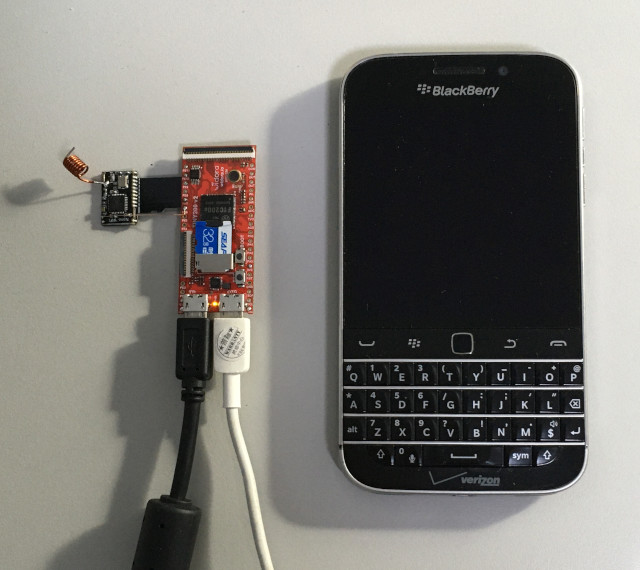

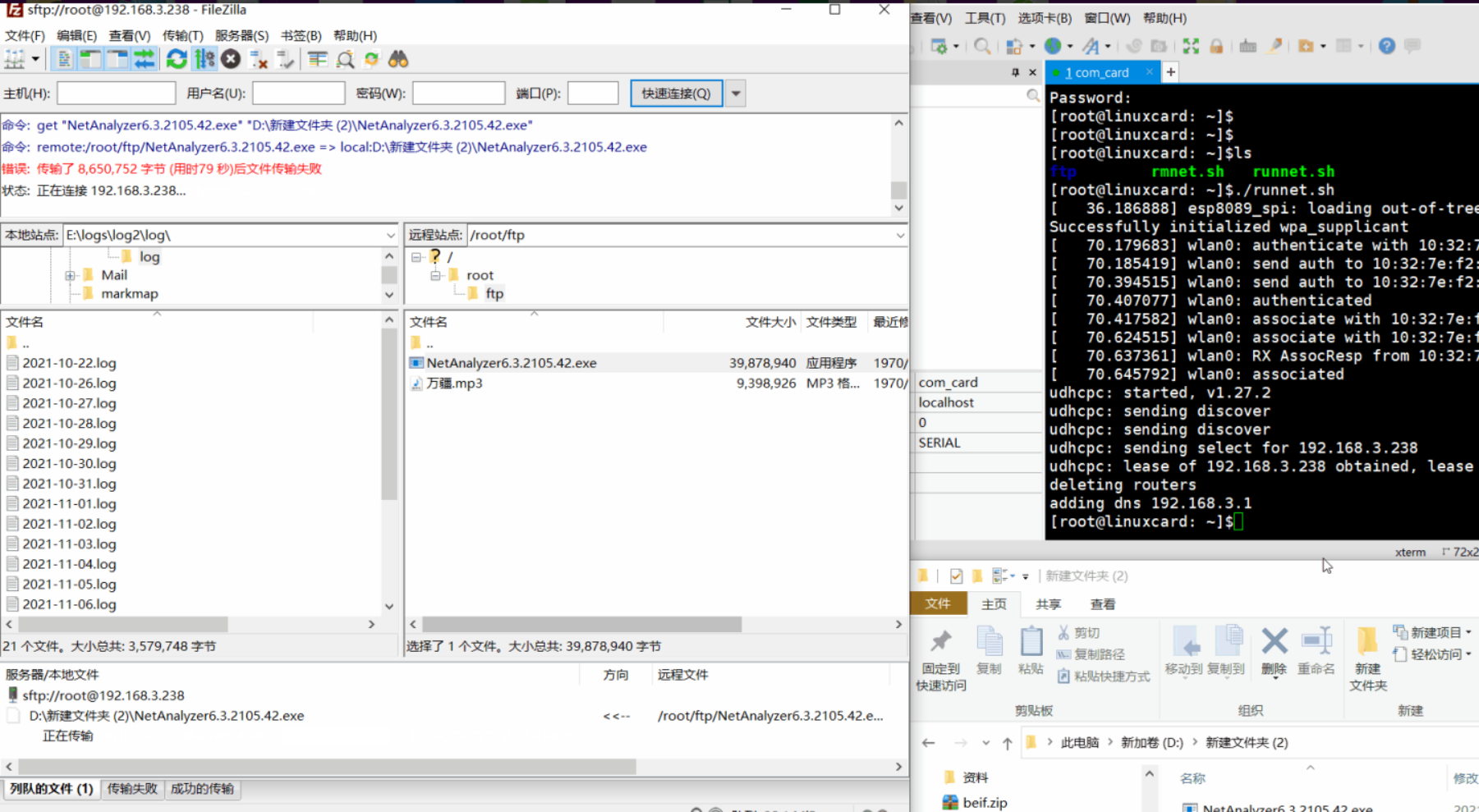

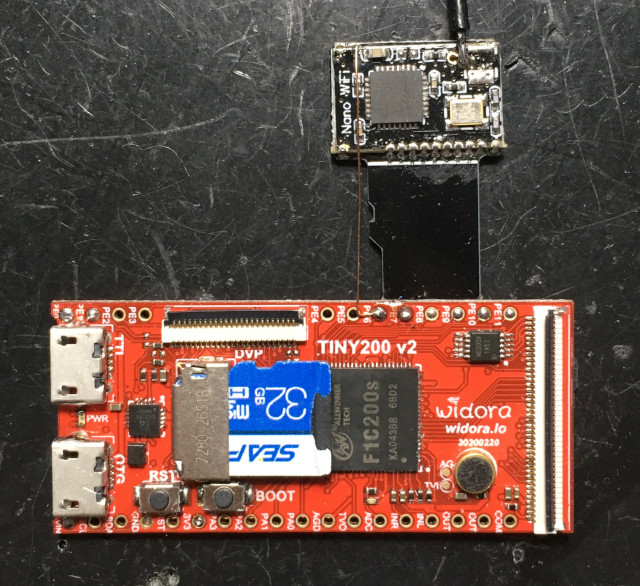

#5 2021-10-31 18:38:51
memory
注册时间: 2021-08-11
已发帖子: 487
积分: 464
Re: SDIO ESP8089开源Linux驱动现在可以直接编译通过了, 有没有朋友一起试一试
https://hackaday.io/project/9300/instructions
git clone https://github.com/al177/esp8089
PATH=../output/host/bin/:$PATH ARCH=arm CROSS_COMPILE=arm-linux-gnueabihf- make -C ../output/build/linux-5.4.70/ M=${PWD} modules
cp esp8089.ko lib/
etc/wpa_supplicant.conf
ap_scan=1
network={
        ssid="test"
        psk="13800138000"
搞定, 跑了一个小时, 运行正常:
# ping www.163.com
PING www.163.com (183.232.112.86): 56 data bytes
64 bytes from 183.232.112.86: seq=0 ttl=55 time=16.049 ms
64 bytes from 183.232.112.86: seq=1 ttl=55 time=19.129 ms
64 bytes from 183.232.112.86: seq=2 ttl=55 time=23.049 ms
64 bytes from 183.232.112.86: seq=3 ttl=55 time=31.148 ms
64 bytes from 183.232.112.86: seq=4 ttl=55 time=20.033 ms
64 bytes from 183.232.112.86: seq=5 ttl=55 time=21.376 ms
64 bytes from 183.232.112.86: seq=6 ttl=55 time=46.573 ms
64 bytes from 183.232.112.86: seq=7 ttl=55 time=19.451 ms

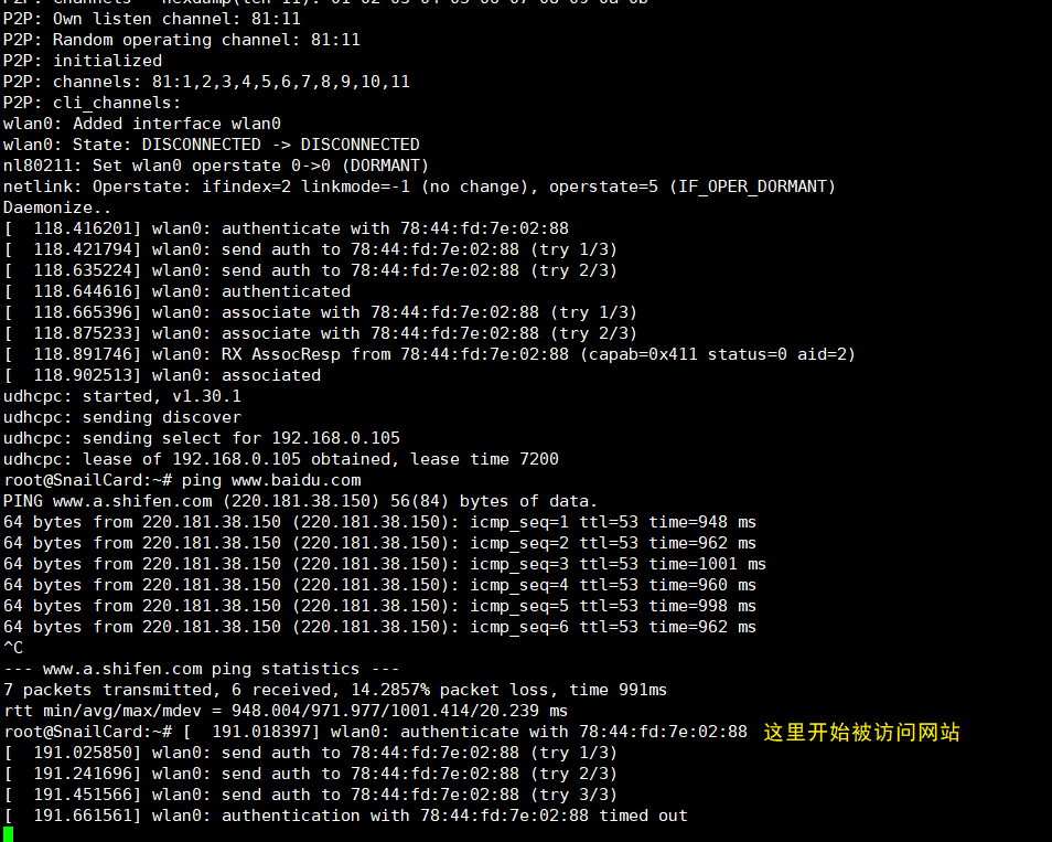

[  201.047609] wlan0: deauthenticating from e4:26:8b:89:a9:f8 by local choice (Reason: 3=DEAUTH_LEAVING)
[  201.157697] mmc0: card 0001 removed
[  201.222021] mmc0: queuing unknown CIS tuple 0x01 (3 bytes)
[  201.244789] mmc0: queuing unknown CIS tuple 0x1a (5 bytes)
[  201.259357] mmc0: queuing unknown CIS tuple 0x1b (8 bytes)
[  201.276554] mmc0: queuing unknown CIS tuple 0x80 (1 bytes)
[  201.296138] mmc0: queuing unknown CIS tuple 0x81 (1 bytes)
[  201.301764] mmc0: queuing unknown CIS tuple 0x82 (1 bytes)
[  201.311093] mmc0: new high speed SDIO card at address 0001

ping: sendto: Network is unreachable
悲剧,挂了。

[36024.858388] wlan0: authenticate with e4:26:8b:89:a9:f8
[36024.863840] wlan0: send auth to e4:26:8b:89:a9:f8 (try 1/3)
[36025.075400] wlan0: send auth to e4:26:8b:89:a9:f8 (try 2/3)
[36025.285360] wlan0: send auth to e4:26:8b:89:a9:f8 (try 3/3)
[36025.495337] wlan0: authentication with e4:26:8b:89:a9:f8 timed out

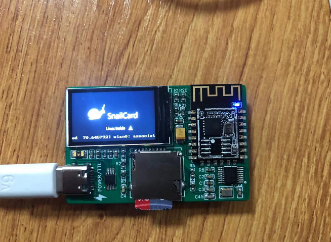

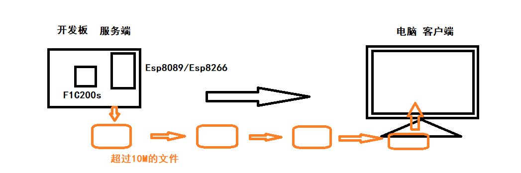

我用的是SPI方式,长时间下载东西问题好像不大,但是一旦作为服务器(如web ftp server) 传输一点数据后就直接挂了
root@SnailCard:~#
root@SnailCard:~#
root@SnailCard:~# dmesg |grep wlan0
[  241.525691] wlan0: authenticate with 78:44:fd:7e:02:88
[  241.531292] wlan0: send auth to 78:44:fd:7e:02:88 (try 1/3)
[  241.742250] wlan0: send auth to 78:44:fd:7e:02:88 (try 2/3)
[  241.755538] wlan0: authenticated
[  241.772270] wlan0: associate with 78:44:fd:7e:02:88 (try 1/3)
[  241.982257] wlan0: associate with 78:44:fd:7e:02:88 (try 2/3)
[  241.998657] wlan0: RX AssocResp from 78:44:fd:7e:02:88 (capab=0x1411 status=0 aid=1)
[  242.009522] wlan0: associated
[  242.014791] wlan0: Limiting TX power to 20 (20 - 0) dBm as advertised by 78:44:fd:7e:02:88
[  572.506851] wlan0: authenticate with 78:44:fd:7e:02:88
[  572.514157] wlan0: send auth to 78:44:fd:7e:02:88 (try 1/3)
[  572.725587] wlan0: send auth to 78:44:fd:7e:02:88 (try 2/3)
[  572.935684] wlan0: send auth to 78:44:fd:7e:02:88 (try 3/3)
[  573.145784] wlan0: authentication with 78:44:fd:7e:02:88 timed out
找点可用的调试信息都没有,怀疑是不是固件里面有问题了

发现一个有意思的问题,当我把日志都打开,也就是司徒大佬提到的把esp_msg_level屏蔽了,界面疯狂的刷日志,作为web服务被访问,竟然不掉线……
然后屏蔽日志后降频到10Mhz
还是不行
最近编辑记录 twzy (2021-11-07 00:58:10)

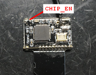

第2次insmod失敗的原因是沒有做RESET的動作, 雖然可能可以透過命令做RESET, 不過, ESP8089的使用手冊似乎抓不到, 因此, 司徒最後飛線解決第2次insmod失敗的問題
CHIP_EN腳位如下:
CHIP_EN連接到PE6
接著多次測試後, 驅動都可以正確執行, wlan0也可以正常運作

1 我在开发板上面部署了nignx,并配置了网页服务,当我通过pc访问这个网页的时候,就崩溃了。
2 我是通过sftp方式下载开发板中一个大文件做测试的时候也会崩溃。

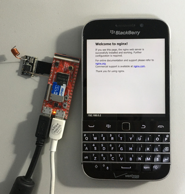

司徒目前部屬Nginx後,還是無法重現斷線問題
Welcome to VeganOS
vegan login: root
# cd /boot/
# insmod esp8089-spi.ko
[   13.652674] esp8089_spi: loading out-of-tree module taints kernel.
[   22.848024] random: crng init done
# ifconfig wlan0 up
# wpa_supplicant -B -i wlan0 -c /etc/wpa_supplicant.conf
rfkill: Cannot open RFKILL control device
# [   60.611010] wlan0: authenticate with a4:e4:b8:70:01:7b
[   60.616609] wlan0: send auth to a4:e4:b8:70:01:7b (try 1/3)
[   60.831775] wlan0: send auth to a4:e4:b8:70:01:7b (try 2/3)
[   60.841999] wlan0: authenticated
[   60.851734] wlan0: associate with a4:e4:b8:70:01:7b (try 1/3)
[   61.061740] wlan0: associate with a4:e4:b8:70:01:7b (try 2/3)
[   61.072413] wlan0: RX AssocResp from a4:e4:b8:70:01:7b (capab=0x431 status=0 aid=1)
[   61.080298] wlan0: AP has invalid WMM params (AIFSN=1 for ACI 2), will use 2
[   61.087501] wlan0: AP has invalid WMM params (AIFSN=1 for ACI 3), will use 2
[   61.094765] wlan0: associated
# udhcpc -i wlan0
udhcpc: started, v1.33.1
udhcpc: sending discover
udhcpc: sending select for 192.168.0.2
udhcpc: lease of 192.168.0.2 obtained, lease time 7200
deleting routers
adding dns 192.168.176.251
adding dns 192.168.176.252
adding dns 192.168.176.253
adding dns 192.168.176.254
# mkdir /tmp/logs
# /usr/nginx/sbin/nginx -c /usr/nginx/conf/nginx.conf -p /tmp
司徒目前也沒有多餘時間可以繼續花費在這個問題上,因此,司徒將最後的KernelESP8089-SPI驅動公開給大家參考~

連接腳位:
PE6: ESP8089 CHIP_EN
PE7: ESP8089 CS
PE8: ESP8089 DI
PE9: ESP8089 CLK
PE10: ESP8089 DO
PE11: ESP8089 INT

我推测大佬测试web服务正常可能有两点:
1. 这个问题在做驱动修改的时候,事实上已经已经得到了解决。
2. 我看图片中司徒大佬只用了nginx的默认页面,这个页面比较小,可能需要一大一点的文件,比如下载一个5~10MB的文件就会重现。

我刚才试着用司徒大佬的驱动,使用sftp方式下载一个8MB的文件,很稳定,不掉线了,但是当我下载一个38M的数据的时候,又掉线了,当然不排除我这边网络的问题,我明天再多测试几次看看
总之比原来稳定多了。
今天早上重新开始验证,发现传输超过10MB后就有很大的概率会掉线

我看司徒大佬的日志是从ftp.gnu.org 下载文件到开发板,这部分是没问题的,可能是我前期描述有问题,我说的场景如下图所示,文件传输方式是有开发板传输到pc或其他终端。
