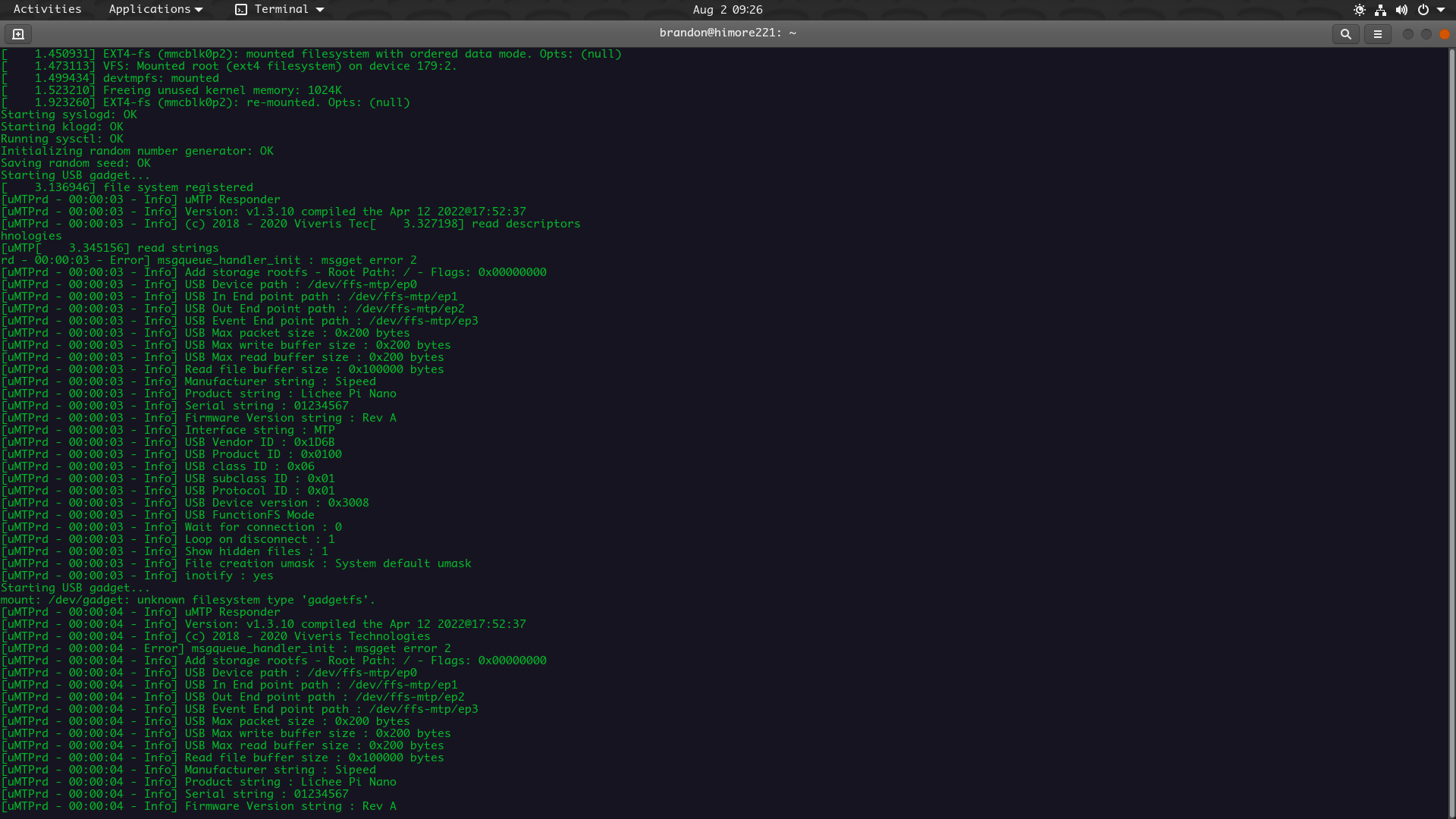

I've been unsuccessfully trying to expose the Lichee Nano as an MTP device to  a Linux Host using https://github.com/viveris/uMTP-Responder. First tried using GadgetFS and then FunctionFS. I'm using Icenowy's 4.15 kernel.
uMTPrd config
umtprd.conf.txt
Startup script
umtprd.conf.txt
Linux .config config.txt
Has anyone had similar issues or gotten this to work?? Any help would be much appreciated

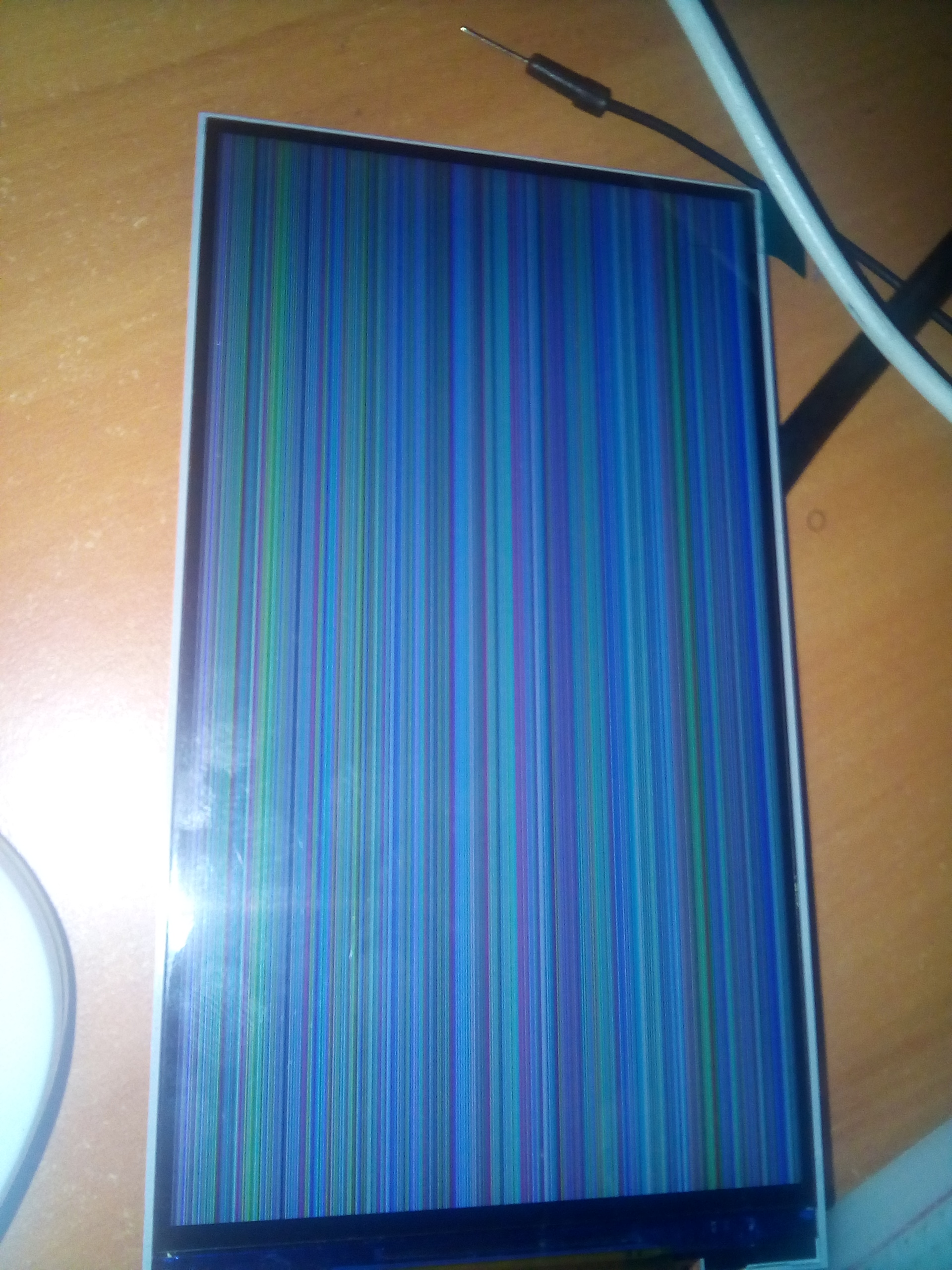

Hi everyone,
Has anyone been able to get this LCD module to run on a Linux system? I trying to integrate it into Linux 4.5.
I've created a new panel_desc in panel-simple.c driver and added timings information from the datasheet. All I get is a screen with vertical lines of multiple colors. I suspect I've entered some of the timing data wrongly.
Attached are the module's datasheet, a diff of panel-simple.c showing my additions, and the screen output I'm getting. Any suggestions would be greatly appreciated.
Sincerely
