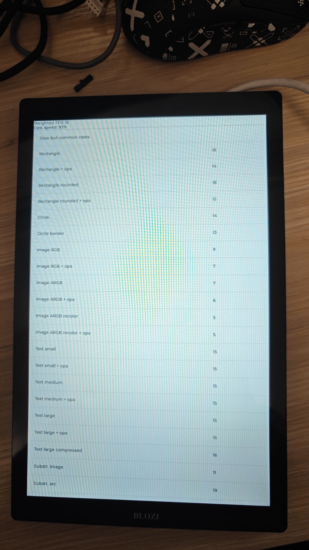

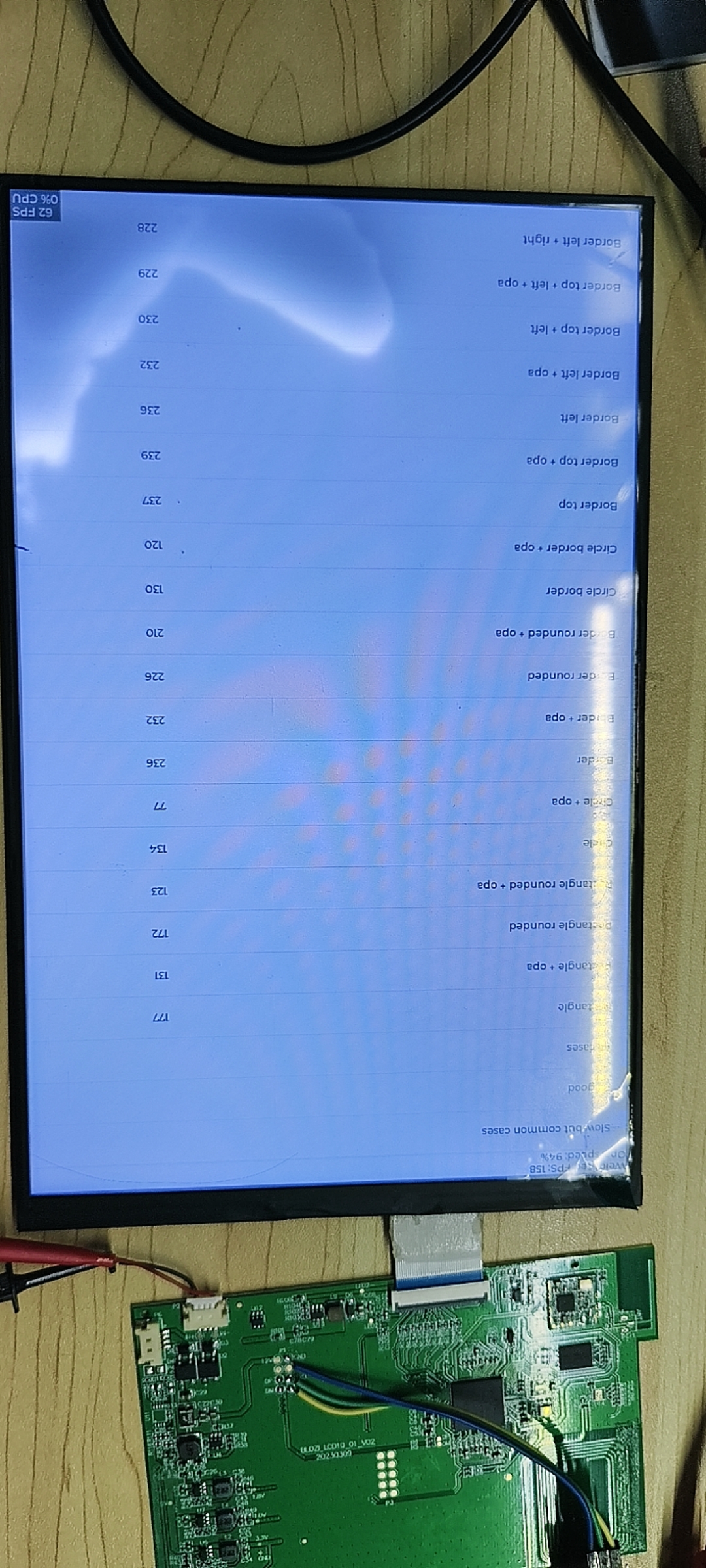

Re: 45块顺丰包邮买到的10.1寸保资LCD价签F1C200S 值不值
18578292200 wrote:
/files/members/2995/微信图片_20240921210652.jpg
可以跑自己的应用了,只是帧率低的可怜
我去f1c200性能差这么多,新版的保资用ssd201也可以直接进系统,编了个lvgl性能测试,能到150帧,10倍性能,就是可用ram不大,连网后就只有9m

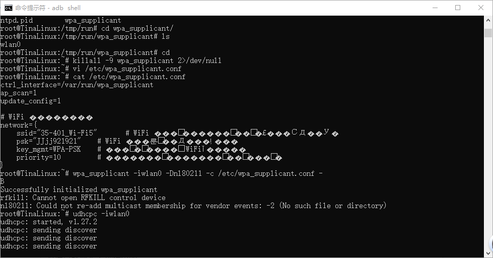

#231 2026-02-13 17:26:54
aaaccc2000
注册时间: 2024-04-29
@18578292200
可以添加图片和视频到/mnt/UDISK/bloziplayer 文件夹,配置/mnt/UDISK/bloziplayer/bloziplayer.json来控制播放内容
默认是这个:
{"code":0,"data":[{"type":"video","label":"video","time":0,"area":{"left":0,"top":0,"width":800,"height":800},"files":[{"name":"blozi-800-800.mp4","md5":"9746fc6bc53e0cf5f1c475905e193b15"}]},{"type":"img","label":"tag","time":0,"area":{"left":0,"top":800,"width":800,"height":480},"files":[{"name":"tag-5000001054-1629347081.png","md5":"b9441367c35d85189d5e2c23cf377453"}]}],"type":"2"}
修改/etc/wifi/wpa_supplicant.conf里面的热点名称和密码连接WIFI
wpa_supplicant.conf文件我看了/etc目录里面,wifi里面没有,
#232 2026-02-13 21:01:07
aaaccc2000
注册时间: 2024-04-29
JiangLin wrote:
本来/etc/wifi/wpa_supplicant.conf中是没有network字段的,我自己添加的:
network={
    ssid="troyself-wifi"
    psk="xxx"  //已经更改为自己的wifi密码
    key_mgmt=WPA-PSK
    priority=1
搞定了吗?我没有搞出来
#233 2026-02-13 21:40:21
aaaccc2000
注册时间: 2024-04-29
热点连接不上,那位大佬看看
修改了以下2个文件,还是无法连接网络
/etc/prole.d/bloziplayer.sh
/etc/wpa_supplicant.conf
