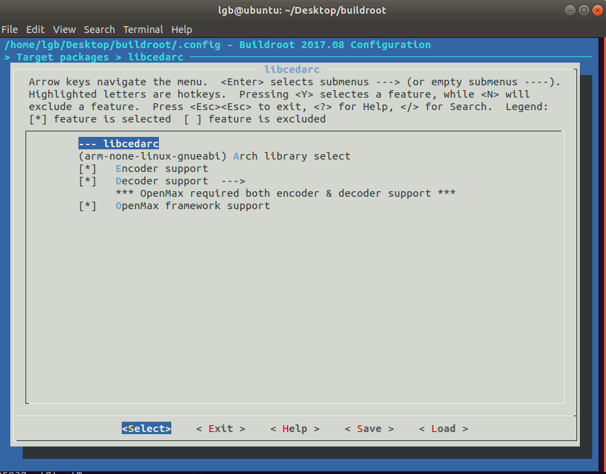

使用主线5.2,按照这个教程成功安装了cedar,dev出现了cedar和ion设备,下面的cedarx也装一下,这样就不用拷so库了
https://github.com/aodzip/cedar/
编译链要用这个:
https://pan.baidu.com/s/1-WXlwxLoQNzKGDdIJ5JDpw
buildroot里的cedarc要改一下
主要看lindenis-v536-package里面的
tina_multimedia和tina_multimedia_demo两个文件夹,
先编译tina_multimedia/cedarc,按照里面的readme说明编译,平台选arm-none-linux-gnueabi,注意编译的时候统一编译链,configure和make都带上CC=/...你的编译链路径
jpeg和.264硬编码的demo在/tina_multimedia_demo/encodertest/src,修改makefile文件如下:
Target = demo
SourceIncludePath := -I/work/tina_multimedia/libcedarx/libcore/base/include -I/work/tina_multimedia/libcedarc/include -L/work/libcedarc/lib -L/work/tina_multimedia/libcedarc/library/arm-none-linux-gnueabi
CompileFlags = $(CFLAGS) $(SourceIncludePath)
LoadFlags +=  -lvencoder -lMemAdapter -lpthread -ldl -lm
CC=/work/arm-2014.05/bin/arm-none-linux-gnueabi-gcc
LDFLAGS= -Wl,-rpath-link /work/tina_multimedia/libcedarc/library/arm-none-linux-gnueabi -Wl,-rpath-link /work/tina_multimedia/libcedarc/base/.libs
$(Target): encodertest.c
    $(CC) -o $@ $^ $(CompileFlags) $(LDFLAGS) $(LoadFlags)
路径名字对应改就行,其中/work/libcedarc/lib路径是编译tina_multimedia时的输出安装路径
然后make就生成程序了,直接拷到板子就能运行(前面buildroot已经安装了库所以不用拷)
测试程序,支持jpg和.264编码,前面的1表示编码成jpg,后面的1表示1帧
./demo 1 YUV420 800 480 800 480 1 ./123.yuv /root

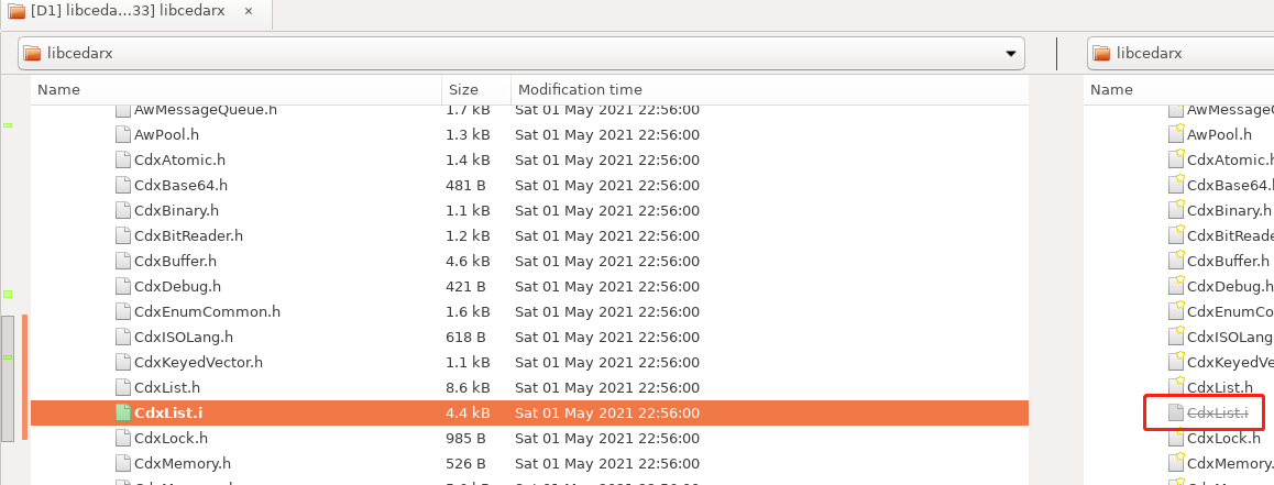

#14 2022-02-17 21:52:11
X3
注册时间: 2020-04-08
已发帖子: 85
积分: 68.5
Re: f1c100s调用cedar 实现硬编码jpeg h.264
make[4]: Entering directory '/opt/a133/tina/out/mr813-a3/compile_dir/target/libcedarx/libcedarx'
Making install in libcore
make[5]: Entering directory '/opt/a133/tina/out/mr813-a3/compile_dir/target/libcedarx/libcedarx/libcore'
Making install in base
make[6]: Entering directory '/opt/a133/tina/out/mr813-a3/compile_dir/target/libcedarx/libcedarx/libcore/base'
  CC       libcdx_base_la-AwPool.lo
In file included from ./AwPool.c:13:0:
./include/CdxList.h:153:21: fatal error: CdxList.i: No such file or directory
 #include <CdxList.i>
compilation terminated.
Makefile:551: recipe for target 'libcdx_base_la-AwPool.lo' failed
make[6]: *** [libcdx_base_la-AwPool.lo] Error 1
make[6]: Leaving directory '/opt/a133/tina/out/mr813-a3/compile_dir/target/libcedarx/libcedarx/libcore/base'
Makefile:353: recipe for target 'install-recursive' failed
make[5]: *** [install-recursive] Error 1
make[5]: Leaving directory '/opt/a133/tina/out/mr813-a3/compile_dir/target/libcedarx/libcedarx/libcore'
Makefile:398: recipe for target 'install-recursive' failed
make[4]: *** [install-recursive] Error 1
make[4]: Leaving directory '/opt/a133/tina/out/mr813-a3/compile_dir/target/libcedarx/libcedarx'
Makefile:724: recipe for target '/opt/a133/tina/out/mr813-a3/compile_dir/target/libcedarx/.built' failed
make[3]: *** [/opt/a133/tina/out/mr813-a3/compile_dir/target/libcedarx/.built] Error 2
make[3]: Leaving directory '/opt/a133/tina/package/allwinner/tina_multimedia'
package/Makefile:192: recipe for target 'package/allwinner/tina_multimedia/compile' failed
make[2]: *** [package/allwinner/tina_multimedia/compile] Error 2
make[2]: Leaving directory '/opt/a133/tina'
package/Makefile:189: recipe for target '/opt/a133/tina/out/mr813-a3/staging_dir/target/stamp/.package_compile' failed
make[1]: *** [/opt/a133/tina/out/mr813-a3/staging_dir/target/stamp/.package_compile] Error 2
make[1]: Leaving directory '/opt/a133/tina'
/opt/a133/tina/build/toplevel.mk:304: recipe for target 'world' failed
make: *** [world] Error 2
#### make failed to build some targets (22 seconds) ####
这个错误 。。。
#15 2022-02-17 22:05:10
X3
注册时间: 2020-04-08
已发帖子: 85
积分: 68.5
故意删掉一个文件?
#16 2022-02-17 23:30:16
X3
注册时间: 2020-04-08
已发帖子: 85
积分: 68.5
cp /opt/D1/tina_d1_open/package/allwinner/tina_multimedia/libcedarx/libcore/base/include/CdxList.i package/allwinner/tina_multimedia/libcedarx/libcore/base/include/
去D1 SDK 里面借一个用用。
#18 2023-06-12 17:05:28
rocklee
注册时间: 2023-04-25
X3 说:
去D1 SDK 里面借一个用用。
这个能用吗?全志的bsp都会报这个错。。。。
