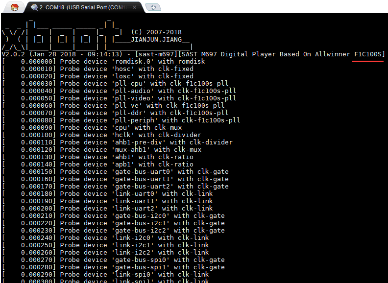

楼主 #7 2018-01-28 18:08:27
已发帖子: 9,511
Re: F1C100s入坑记录(linux kernel失败!sunxi-fel, u-boot正常。)
_ _
_ _ | |___ _____ _____ _| |_
\ \/ /| _ | _ | _ |_ _| (C) 2007-2018
) ( | |_| | |_| | |_| | | |____JIANJUN.JIANG__
/_/\_\|_____|_____|_____| |_____________________|
V2.0.2 (Jan 28 2018 - 09:14:13) - [sast-m697][SAST M697 Digital Player Based On Allwinner F1C100S]

[ 0.000660] Probe device 'gpio-f1c100s.3' with gpio-f1c100s
[ 0.000670] Probe device 'gpio-f1c100s.4' with gpio-f1c100s
[ 0.000680] Probe device 'pwm-f1c100s.0' with pwm-f1c100s
[ 0.000690] Probe device 'pwm-f1c100s.1' with pwm-f1c100s
[ 0.000700] Probe device 'ce-f1c100s-timer.0' with ce-f1c100s-timer
[ 0.000052] Probe device 'cs-f1c100s-timer.0' with cs-f1c100s-timer
[ 0.006456] Probe device 'i2c-f1c100s.0' with i2c-f1c100s
▒▒ځ 0.022901] Probe device 'uart-16550.0' with uart-16550s
[ 0.028168] Probe device 'uart-16550.1' with uart-16550
[ 0.033392] Probe device 'uart-16550.2' with uart-16550
[ 0.038588] Probe device 'spi-f1c100s.0' with spi-f1c100s
[ 0.043953] Probe device 'spi-f1c100s.1' with spi-f1c100s
[ 0.049301] Fail to probe device with spi-flash
[ 0.053790] Probe device 'wdog-f1c100s.0' with wdog-f1c100s
[ 0.059338] Probe device 'key-f1c100s-lradc.0' with key-f1c100s-lradc
[ 0.065736] Probe device 'led-gpio.0' with led-gpio
[ 0.070569] Probe device 'ledtrig-heartbeat.0' with ledtrig-heartbeat
[ 0.076962] Probe device 'led-pwm-bl.0' with led-pwm-bl
[ 0.101522] Probe device 'fb-f1c100s.0' with fb-f1c100s
[ 0.106722] Probe device 'console-uart.0' with console-uart
Press any key to stop autoboot: 0.000
xboot: /$
烧了xboot 的f1c100s 程序, 背光亮了,串口输出正常, 屏幕没有显示.
