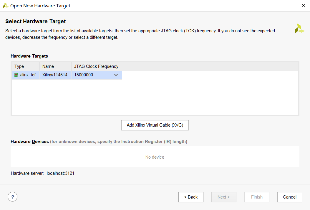

使用方法很简单,亲测可行。支持FT232H/FT2232H/FT4232H。

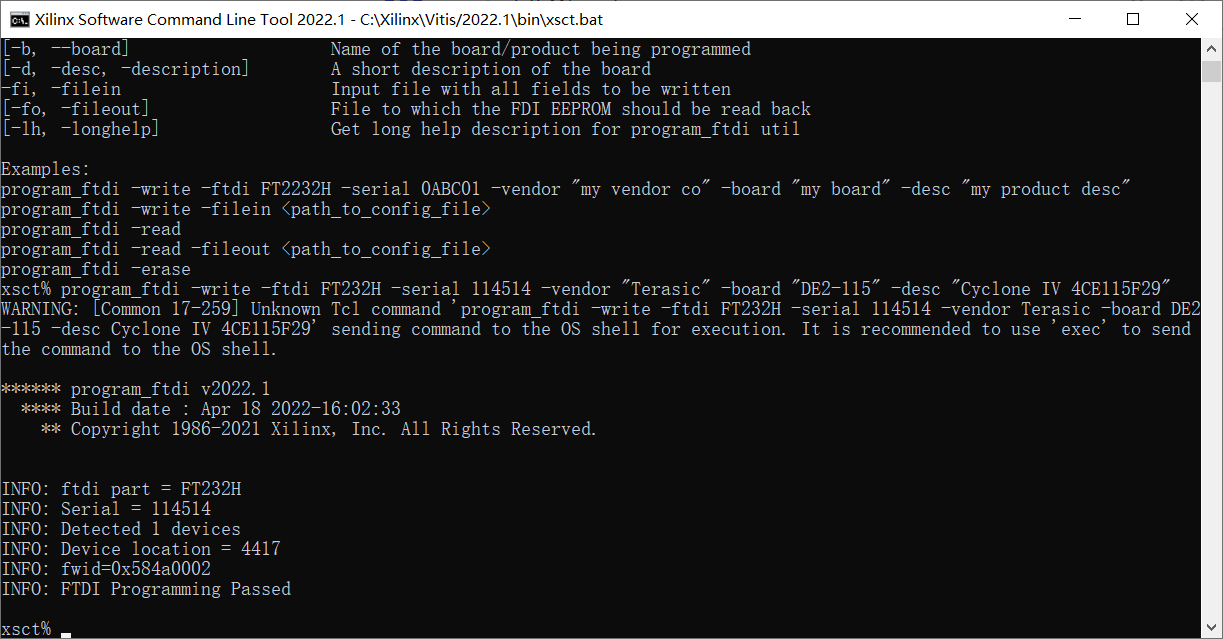

最后贴一下命令的使用方法:
program_ftdi
Short Description
Write/Read to FTDI EEPROM for Xilinx JTAG Tools support
Syntax:
program_ftdi {-write -ftdi=<ftdi_part> -serial=<serial_number> [-vendor=<vendor_name>][-board=<board_name>][-m=<manufacturer>][-desc=<description>] |
              -write -filein=<cfg_filein> |
              -read [-fileout=<cfg_fileout>]} [-help][-longhelp]
Usage:
Name            Description
-ftdi           Specify the ftdi device to be programmed <FT232H | FT2232H | FT4232H>
-serial         Serial number to be written into the EEPROM
[-vendor]       Vendor information
[-board ]       Name of the board being programmed
[-mfg    ]      Manufacturer information
[-desc   ]      A short description of the board
-file_in        Input file with all fields to be written
[-file_out]     File to which the FDI EEPROM should be read back
Description:
program_ftdi writes/reads the fdti part according to the option specified.
When called with write, either -ftdi and -serial must be used or -filein with -ftdi must be specified. The Xilinx supported configuration for the part specified using -ftdi flag is written into the EEPROM.
-vendor, --board, -m and -desc are optional arguments which can be used to specify more details to be written. All strings must be specified within inverted commas ("").
When used with read, the command reads back the content of FTDI EEPROM to standard out. if -fileout option is used, the read back information is written to the file specified.
If no arguments are passed, FTDI communication is skipped and help menu is printed.

program_ftdi命令敲在Vivado的TCL命令行里?
只要敲program_ftdi -write 这一条命令就可以,不需要-filein?

invalid command name "program_fdti"

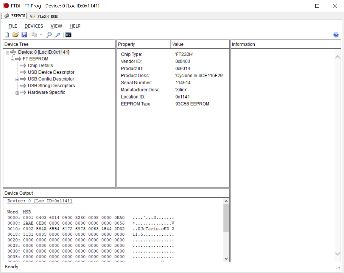

具体是流程是什么,在vivado 2023.1的tcl中输入program_ftdi -write -ftdi FT2232H -serial 0ABC01 -vendor "my vendor co" -board "my board" -desc "my product desc"能够显示成功,但是在FT Prog中还是默认的FTDI的4个串口
