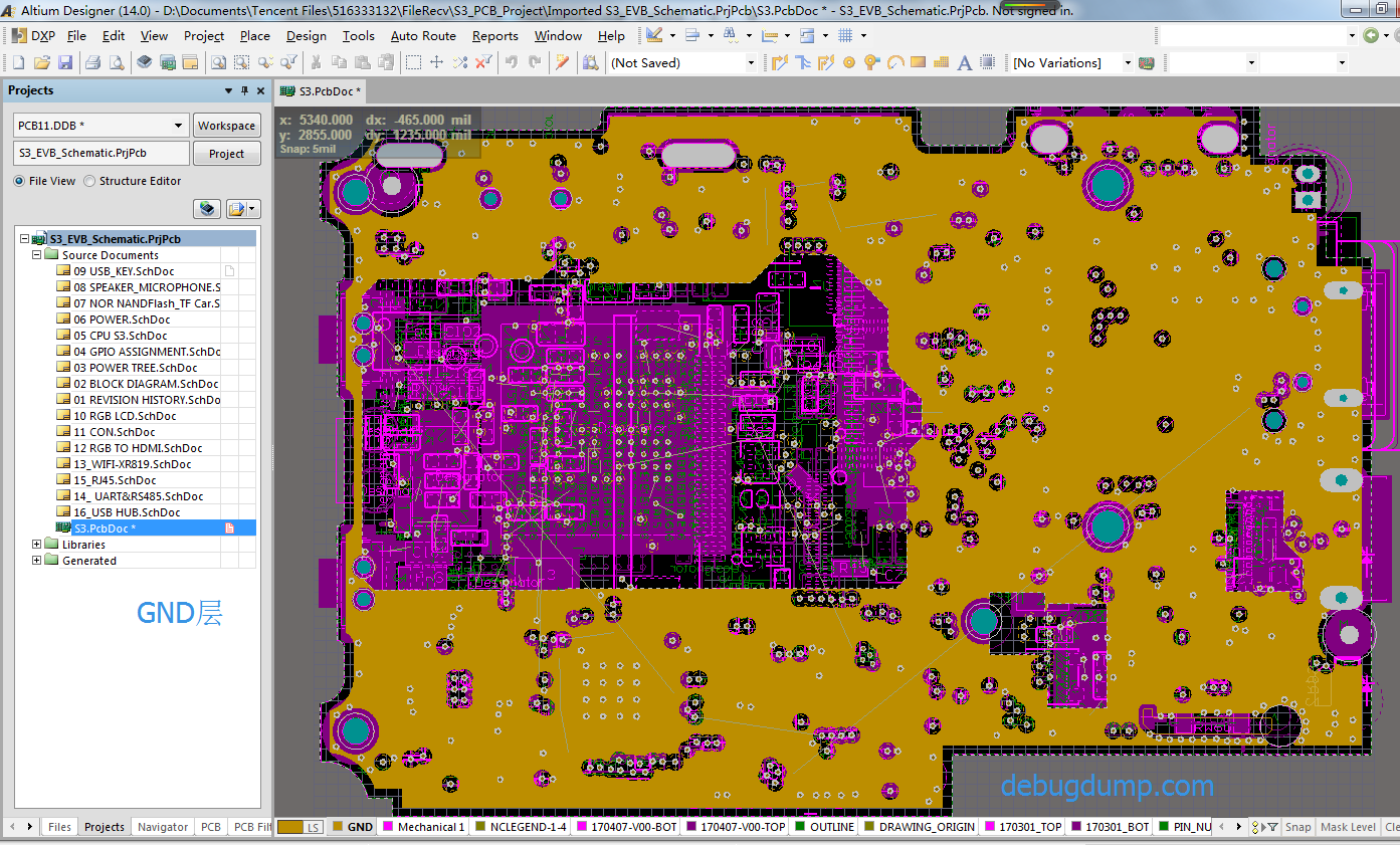

编译索智(Sochip) S3 SDK (zeta) 【提供DXP格式原理图与PCB,感谢 @playflash】
SDK结构和 V3s camdroid SDK 基本相同.
社区逆向出来的编解码器资料: https://github.com/allwinner-zh/media-codec
S3原理图: S3_EVB_Schematic.pdf
S3 贴片图: S3_EVB_SMT.pdf
PMU手册: Allwinner_AXP203_Datasheet_V1_0.pdf
PMU程序:axp20x_19x_17x-driver-20140320.rar
全志S3手册V1.0: http://www.sochip.com.cn/s3/S3_Datasheet_V1.0.pdf
S3 系统配置手册: S3_System_Configuration_Manual.pdf
S3 开发板规格书: SC1615S_Development_board_specifications_20171031.pdf
S3 硬件资料(原理图,PCB)下载: S3_Hardware.7z

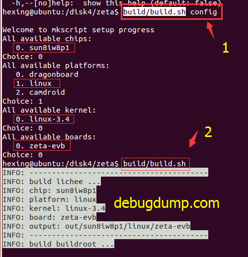

1. 初始化环境:
sudo apt-get update
sudo apt-get install -y git-core gnupg flex bison gperf build-essential \
zip curl zlib1g-dev gcc-multilib g++-multilib libc6-dev-i386 \
lib32ncurses5-dev x11proto-core-dev libx11-dev lib32z1-dev ccache \
libgl1-mesa-dev libxml2-utils xsltproc unzip u-boot-tools gawk

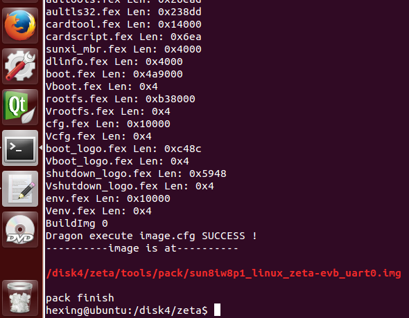

2. 解压, 编译
tar xvf zeta.tar.gz
cd workspace
source build/envsetup.sh
zmake all
楼主 #3 2018-10-12 15:51:35

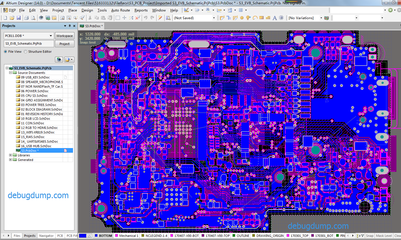

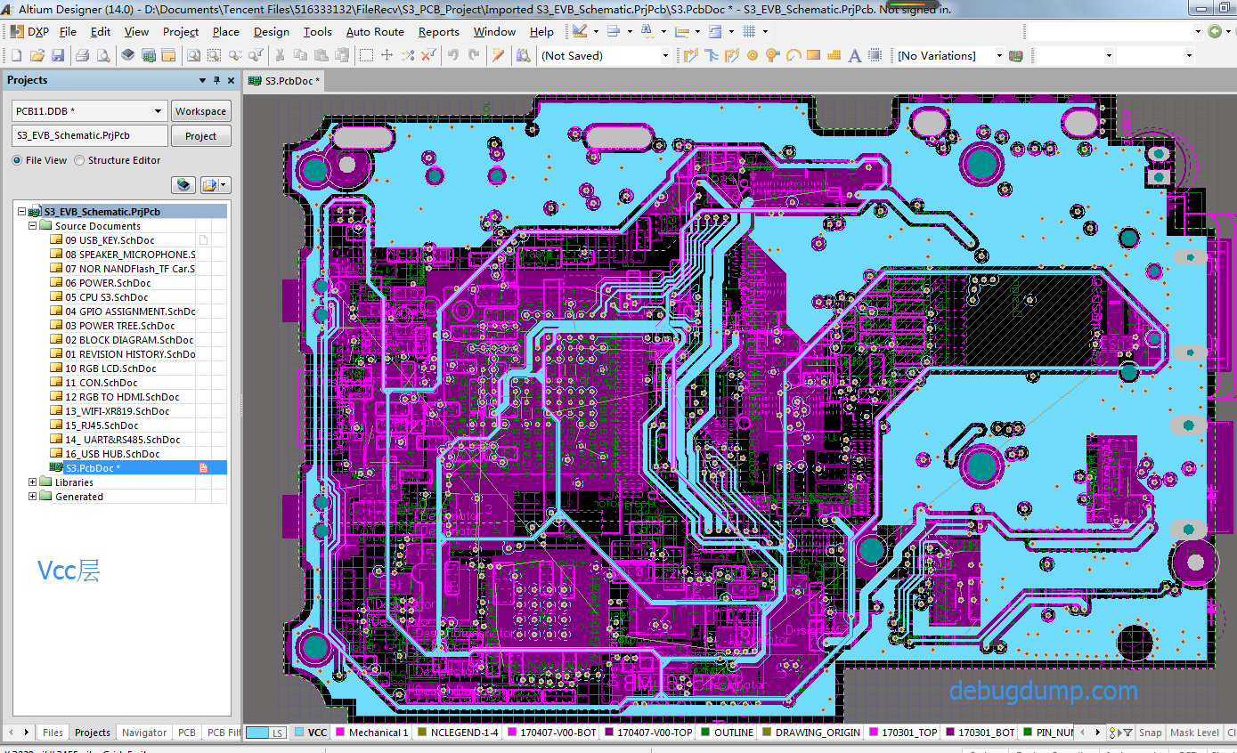

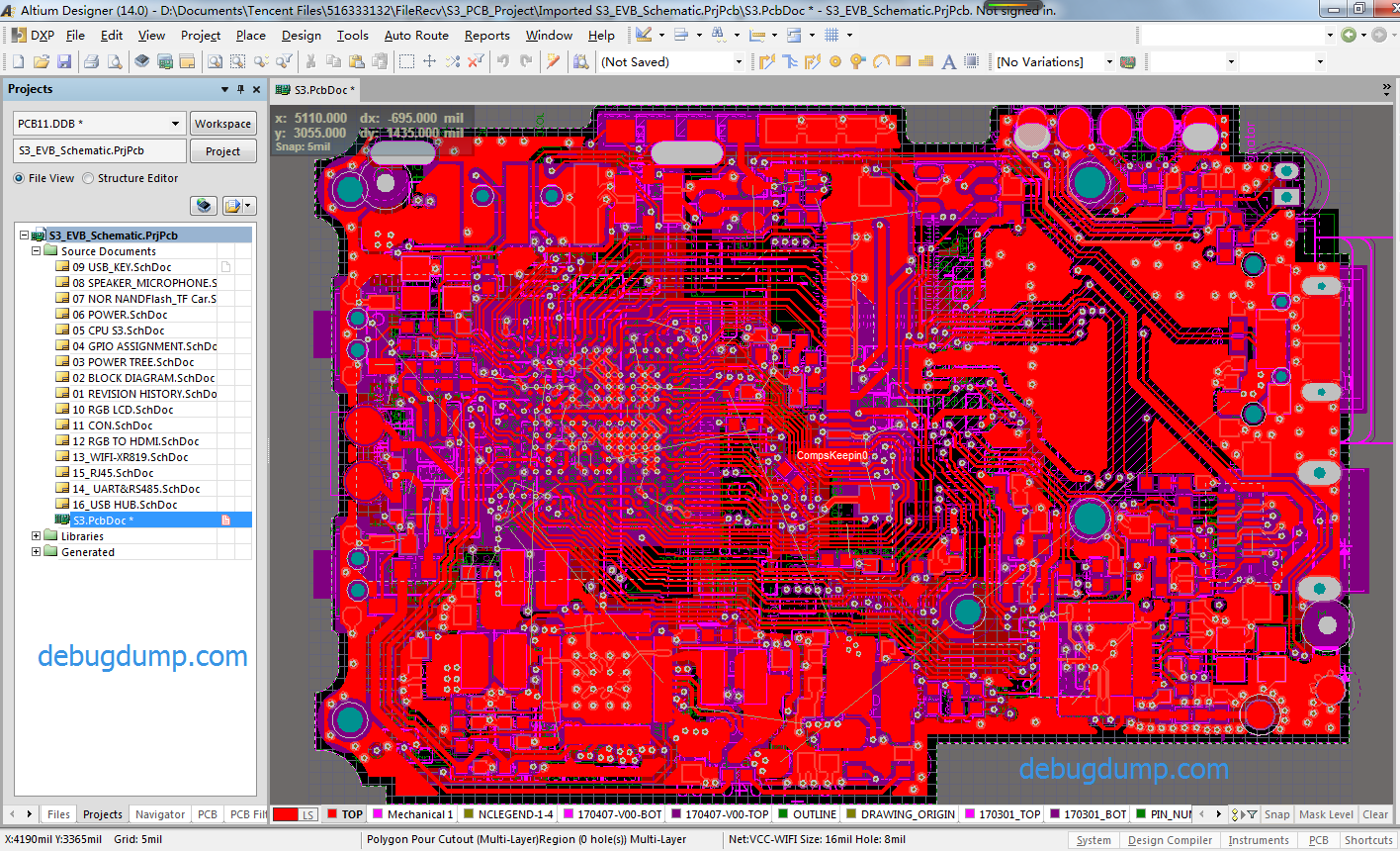

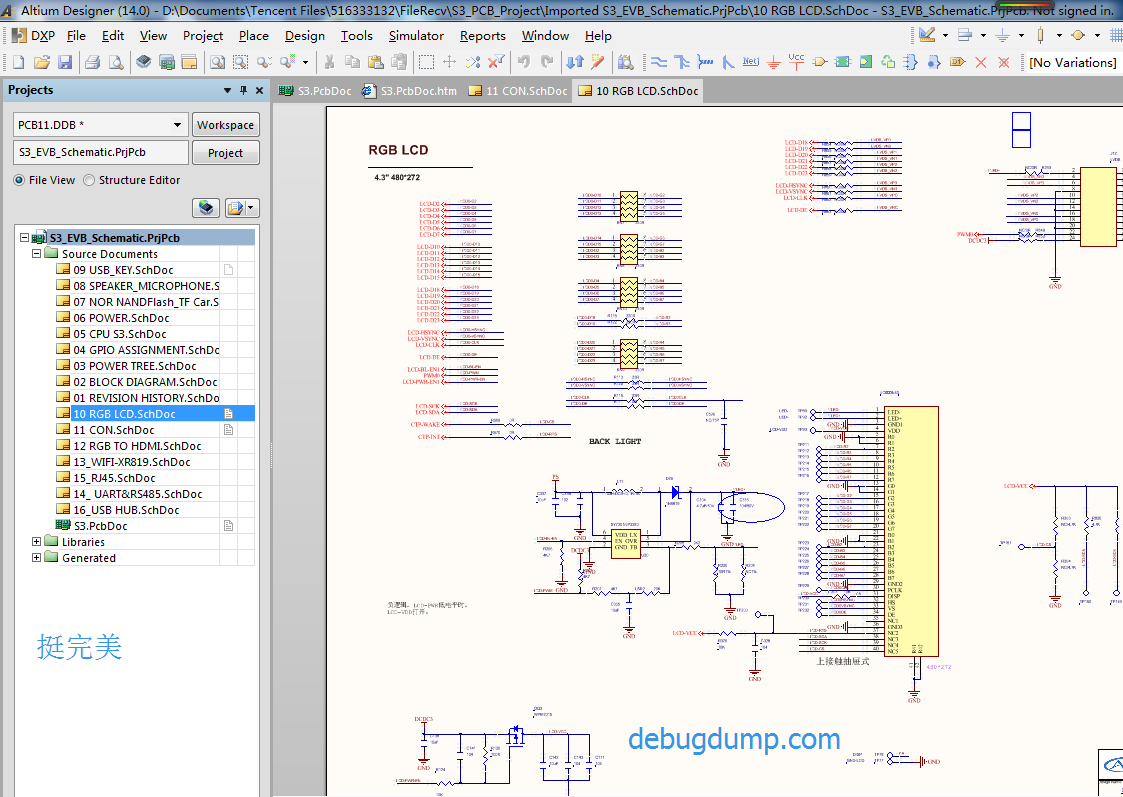

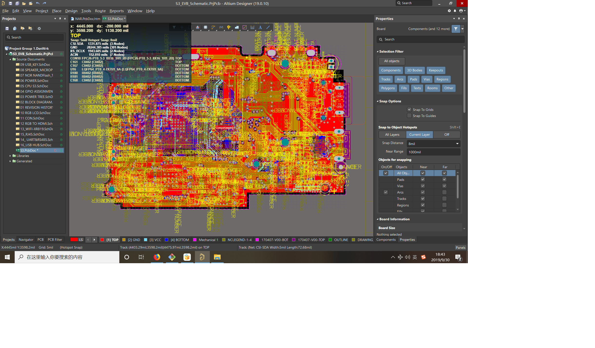

DXP格式原理图与PCB下载: S3_PCB_Project.7z
感谢debugdump网友 @playflash !!!

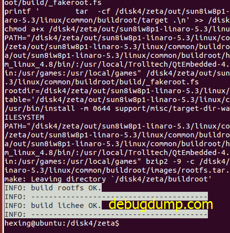

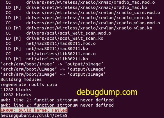

楼主 #9 2018-10-12 16:58:57
已发帖子: 9,433
Re: 编译索智(Sochip) S3 SDK (zeta) 【提供DXP格式原理图与PCB,感谢 @playflash】
LD [M]  net/wireless/lib80211.ko
‘arch/arm/boot/Image’ -> ‘output/bImage’
‘arch/arm/boot/uImage’ -> ‘output/uImage’
‘arch/arm/boot/zImage’ -> ‘output/zImage’
Building modules
regenerate rootfs cpio
11282 blocks
11282 blocks
awk: line 2: function strtonum never defined
ERROR: build kernel Failed
嗯嗯,只有一个小错误.
找到解决方案:
https://blog.csdn.net/dpppppp/article/details/53018132
sudo apt-get install gawk
楼主 #10 2018-10-12 17:05:35
已发帖子: 9,433

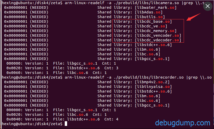

S3 SDK编译完成, 接下来看看怎么到 V3s 板子上跑跑.

[zeta] Build squashfs rootfs ...
rootdir=/disk4/zeta/out/sun8iw8p1-linaro-5.3/linux/common/buildroot//target/
table='/disk4/zeta/build/rootfs_tar/_device_table.txt'
Parallel mksquashfs: Using 1 processor
Creating 4.0 filesystem on /disk4/zeta/out/sun8iw8p1-linaro-5.3/linux/common/buildroot//images/rootfs.squashfs, block size 131072.
[======================================================================================================================================-] 703/703 100%
Exportable Squashfs 4.0 filesystem, xz compressed, data block size 131072
	compressed data, compressed metadata, compressed fragments, compressed xattrs
	duplicates are removed
Filesystem size 11484.92 Kbytes (11.22 Mbytes)
	34.19% of uncompressed filesystem size (33587.94 Kbytes)
Inode table size 7978 bytes (7.79 Kbytes)
	23.30% of uncompressed inode table size (34247 bytes)
Directory table size 9058 bytes (8.85 Kbytes)
	49.91% of uncompressed directory table size (18148 bytes)
Number of duplicate files found 10
Number of inodes 976
Number of files 513
Number of fragments 63
Number of symbolic links  350
Number of device nodes 3
Number of fifo nodes 0
Number of socket nodes 0
Number of directories 110
Number of ids (unique uids + gids) 2
Number of uids 2
	root (0)
	www-data (33)
Number of gids 2
	root (0)
	www-data (33)
INFO: packing firmware ...
copying tools file
copying configs file
copying multiple configs file
copying boot resource
copying boot file
‘chips/sun8iw8p1/configs/zeta-evb/boot-resource/logo/boot_logo.JPG’ -> ‘out/boot_logo.fex’
‘chips/sun8iw8p1/configs/zeta-evb/boot-resource/logo/shutdown_logo.JPG’ -> ‘out/shutdown_logo.fex’
script file Path=/disk4/zeta/tools/pack/out/sys_config.bin
not used muti config
no used multi config
CAMLINUX_IMAGE_OUT=
packing for linux
normal
input file : boot0_spinor.fex
file len=16384
input file : u-boot-spinor.fex
input file : sunxi_mbr.fex
file len=16384
input file : boot.fex
input file : rootfs.fex
input file : cfg.fex
input file : boot_logo.fex
input file : shutdown_logo.fex
input file : env.fex
this is not a partition key
sys parition end
/disk4/zeta/tools/pack/pctools/linux/eDragonEx/
Begin Parse sys_partion.fex
Add partion boot.fex BOOT_FEX00000000
Add partion very boot.fex BOOT_FEX00000000
FilePath: boot.fex
FileLength=4a9000Add partion rootfs.fex ROOTFS_FEX000000
Add partion very rootfs.fex ROOTFS_FEX000000
FilePath: rootfs.fex
FileLength=b38000Add partion cfg.fex CFG_FEX000000000
Add partion very cfg.fex CFG_FEX000000000
FilePath: cfg.fex
FileLength=10000Add partion boot_logo.fex BOOT_LOGO_FEX000
Add partion very boot_logo.fex BOOT_LOGO_FEX000
FilePath: boot_logo.fex
FileLength=c48cAdd partion shutdown_logo.fex SHUTDOWN_LOGO_FEX
Add partion very shutdown_logo.fex SHUTDOWN_LOGO_FEX
FilePath: shutdown_logo.fex
FileLength=5948Add partion env.fex ENV_FEX000000000
Add partion very env.fex ENV_FEX000000000
FilePath: env.fex
FileLength=10000sys_config.fex Len: 0xe405
config.fex Len: 0x8af4
split_xxxx.fex Len: 0x200
sys_partition.fex Len: 0xa0c
boot0_spinor.fex Len: 0x4000
boot0_sdcard.fex Len: 0x8000
boot0_spinand.fex Len: 0x6000
u-boot.fex Len: 0xac000
fes1.fex Len: 0x31c0
full_img.fex Len: 0xfd3000
usbtool.fex Len: 0x23000
aultools.fex Len: 0x26ead
aultls32.fex Len: 0x238dd
cardtool.fex Len: 0x14000
cardscript.fex Len: 0x6ea
sunxi_mbr.fex Len: 0x4000
dlinfo.fex Len: 0x4000
boot.fex Len: 0x4a9000
Vboot.fex Len: 0x4
rootfs.fex Len: 0xb38000
Vrootfs.fex Len: 0x4
cfg.fex Len: 0x10000
Vcfg.fex Len: 0x4
boot_logo.fex Len: 0xc48c
Vboot_logo.fex Len: 0x4
shutdown_logo.fex Len: 0x5948
Vshutdown_logo.fex Len: 0x4
env.fex Len: 0x10000
Venv.fex Len: 0x4
BuildImg 0
Dragon execute image.cfg SUCCESS !
/disk4/zeta/tools/pack/sun8iw8p1_linux_zeta-evb_uart0.img
pack finish
hexing@ubuntu:/disk4/zeta$
zmake all
按芒果 @mango 的提示,
终于编译成功了.

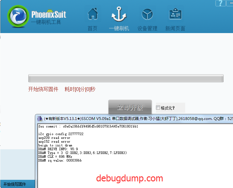

fes commit : c8e0a19bbff4496d5c9810791b445e7061801bb1
i2c gpio config 22777722
axp209 read error
axp152 read error

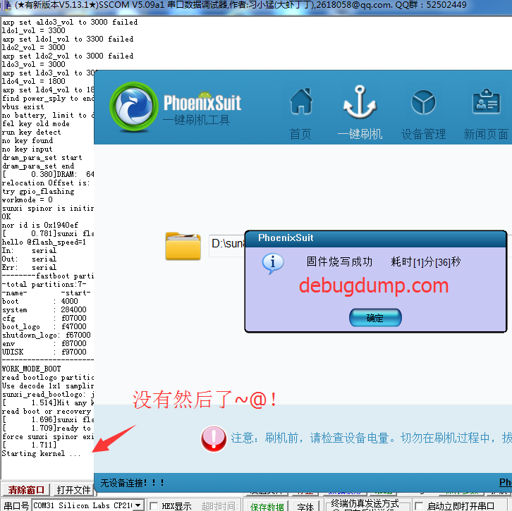

beign to init dram
DRAM DRIVE INFO: V0.9
DRAM Type = 3 (2:DDR2,3:DDR3,6:LPDDR2,7:LPDDR3)
DRAM CLK = 696 MHz
DRAM zq value: 000039bb

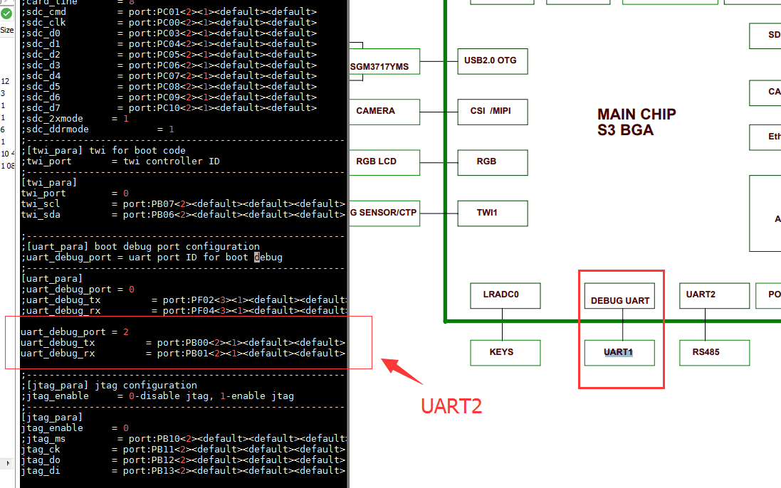

试一试荔枝派zero开发板,
串口接上 UART2(PB0,PB1),用官方软件PhoenixSuit烧录, 进度条始终是0.
估计是 S3的DRAM参数与 S3还是有不同的。

一番折腾之后荔枝派zero(V3s)终于可以烧写了, 但是 Starting kernel ... 就挂了...
断电重启后酱紫的:
\0HELLO! BOOT0 is starting!
boot0 version : 4.0.0
boot0 commit : 767a43563eb0783ad441489d022e0e21781eafcd
fel flag  = 0x00000000
rtc[0] value = 0x00000000
rtc[1] value = 0x00000000
rtc[2] value = 0x00000000
rtc[3] value = 0x00000000
rtc[4] value = 0x00000000
rtc[5] value = 0x00000000
rtc[6] value = 0x00000000
rtc[7] value = 0x00000000
axp read fail, maybe no pmu
DRAM DRIVE INFO: V0.7
DRAM CLK = 408 MHz
DRAM size = 64 MB
dram size =64
The size of uboot is 00038000.
Ready to disable icache.
Jump to secend Boot.
[      0.159]
U-Boot 2011.09-rc1-00000-gc8e0a19-dirty (Dec 01 2017 - 15:08:10) Allwinner Technology
[      0.168]version: 1.1.0
[      0.170]uboot commit : c8e0a19bbff4496d5c9810791b445e7061801bb1
[      0.181]pmbus:   ready
not set main pmu id
axp read error
probe axp20x failed
axp152 read error
probe axp15 failed
axp_probe error
[      0.307]PMU: pll1 408 Mhz,PLL6=600 Mhz
AXI=204 Mhz,AHB=204 Mhz, APB1=102 Mhz
set power on vol to default
dcdc2_vol = 1200
dcdc3_vol = 3300
aldo2_vol = 2500
aldo3_vol = 3000
ldo1_vol = 3300
ldo2_vol = 3000
ldo3_vol = 3000
ldo4_vol = 1800
axp set ldo4_vol to 1800 failed
find power_sply to end
vbus exist
no battery, limit to dc
fel key old mode
run key detect
no key found
no key input
dram_para_set start
dram_para_set end
[      0.380]DRAM:  64 MiB
relocation Offset is: 036c1000
try gpio_flashing
workmode = 0
sunxi spinor is initing...[debug_jaosn]:use the clock in sys_config
OK
nor id is 0x1940ef
[      0.781]sunxi flash init ok
hello @flash_speed=1
In:    serial
Out:   serial
Err:   serial
-total partitions:7-
boot        : 4000          280000
system      : 284000        c83000
cfg         : f07000        40000
boot_logo   : f47000        20000
shutdown_logo: f67000        20000
env         : f87000        10000
UDISK       : f97000        0
WORK_MODE_BOOT
read bootlogo partition successful,start_block=0x7a38,rblock=0x100 ,ret=256
Use decode 1x1 sampling
[      1.514]Hit any key to stop autoboot:  0
read boot or recovery all
[      1.696]sunxi flash read :offset 4000, 2621951 bytes OK
[      1.709]ready to boot
force sunxi spinor exit
[      1.711]

有个问题没有搞明白, 索智开发板用的是 UART1 作为调试串口, 而 sys_config.fex 却使用 UART2 作为调试串口.

现在是把 camdroid 里面的 sys_config.fex 覆盖 索智 SDK里面的 sys_config.fex,
编译出 img, 能烧录到 V3s, 但是卡住在 staring kernel ...
真是一个悲伤的消息.

hexing@ubuntu:/disk4/zeta$ arm-linux-readelf -a ./prebuild/libs/libcamera.so |grep \\.so
0x00000001 (NEEDED)                     Shared library: [libwater_mark.so]
0x00000001 (NEEDED)                     Shared library: [libAdas.so]
0x00000001 (NEEDED)                     Shared library: [libutils.so]
0x00000001 (NEEDED)                     Shared library: [libcdc_base.so]
0x00000001 (NEEDED)                     Shared library: [libcdc_ve.so]
0x00000001 (NEEDED)                     Shared library: [libcdc_memory.so]
0x00000001 (NEEDED)                     Shared library: [libcdc_vencoder.so]
0x00000001 (NEEDED)                     Shared library: [libcdc_vdecoder.so]
0x00000001 (NEEDED)                     Shared library: [libstdc++.so.6]
0x00000001 (NEEDED)                     Shared library: [libm.so.6]
0x00000001 (NEEDED)                     Shared library: [libc.so.6]
0x00000001 (NEEDED)                     Shared library: [libgcc_s.so.1]
  000000: Version: 1  File: libgcc_s.so.1  Cnt: 1
  0x0020: Version: 1  File: libstdc++.so.6  Cnt: 3
  0x0060: Version: 1  File: libc.so.6  Cnt: 1
hexing@ubuntu:/disk4/zeta$ arm-linux-readelf -a ./prebuild/libs/librecorder.so |grep \\.so
0x00000001 (NEEDED)                     Shared library: [libmp4v2.so.2]
0x00000001 (NEEDED)                     Shared library: [libtinyalsa.so]
  0x0020: Version: 1  File: libc.so.6  Cnt: 1
  0x0040: Version: 1  File: libstdc++.so.6  Cnt: 4
由此可见,zeta 弄了个 libcamera.so 封装了全志的库 libcdc*.so

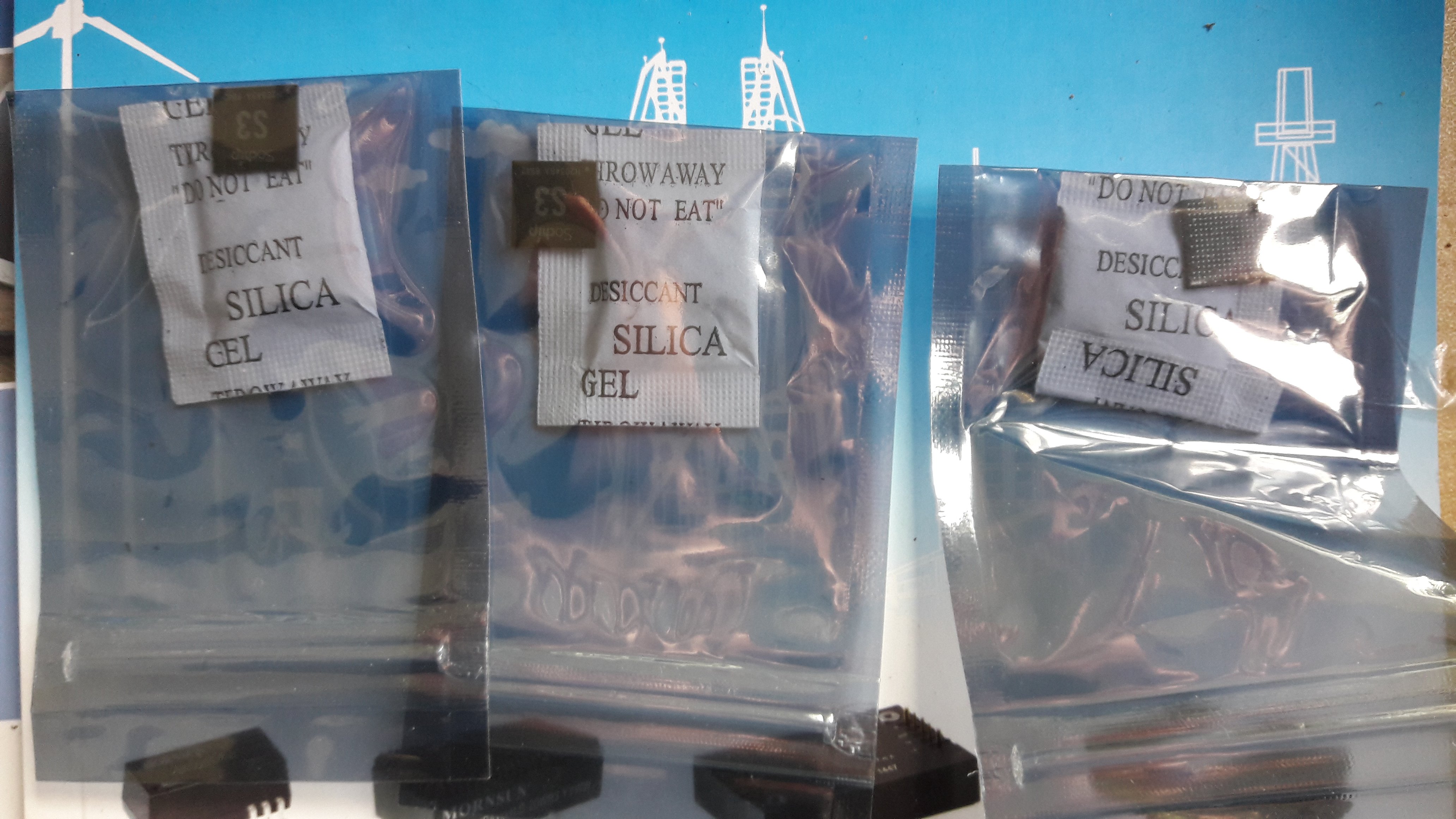

掏了三片https://whycan.cn/files/members/1257/20181127_080112.jpg
看起来是翻新?多少钱买的?
#62 2018-11-27 10:37:21
vigour1000
注册时间: 2018-11-19
已发帖子: 103
30多呢,现在画板试一看

#87 2019-09-30 18:44:24
晕哥小弟
注册时间: 2019-04-04
已发帖子: 311
积分: 301.5
楼主 #88 2019-09-30 19:53:44
已发帖子: 9,433
可能某些层的显示被我disable了
#89 2019-09-30 20:33:49
晕哥小弟
注册时间: 2019-04-04
已发帖子: 311
积分: 301.5
要不重新上传一份呗.
楼主 #90 2019-09-30 20:51:00
已发帖子: 9,433
图层设置一下就好了
#91 2019-09-30 21:12:56
晕哥小弟
注册时间: 2019-04-04
已发帖子: 311
积分: 301.5
不明白你中间层GND,为什么不整个铺满 ?
楼主 #92 2019-09-30 21:36:34
已发帖子: 9,433
或许设计就是这样,或许转换的时候丢了
ERROR: board dir or path do not exist.
All avaiable chips, platforms and boards:
Chip            Board
sun8iw8p1
                zeta-v3s
                zeta-s3l
                zeta-s3
                zeta-v3
                default
For Usage:
     pack -h
zmake image 的时候 提示这个

折腾好久终于编译成功,补充一些资料。
荔枝派板子上焊的是 mx25l12835f spi nor flash 芯片
1、编译之前先替换boot0*.bin 初始化ddr, 这里面用彩虹派资料里面的boot0*.bin 直接替换。
彩虹派源码地址: https://github.com/qq516333132/rainbow-pi-sdk
路径 ./tools/pack/chips/sun8iw8p1/bin/
2、替换sys_config.fex  这里用晕哥说的 camdroid 的sys_config.fex
地址 https://github.com/qq516333132/camdroid/tree/master/lichee/tools/pack/chips/sun8iw8p1/configs/tiger-ipc
3、添加flash型号的支持
vi /home/qihua/S3/linux-3.4/drivers/mtd/devices/m25p80.c
+ 729 { "mx25l12835f", INFO(0xc22618, 0, 64 * 1024, 256, 0) },
4、修改 sys_config.fex
[spi_board0]
modalias      = "mx25l12835f"
max_speed_hz  = 50000000
bus_num       = 0
chip_select   = 0
mode          = 0
sflash_size   = 16
5、修改 linux-3.4/.config
CONFIG_ION=y
CONFIG_ION_SUNXI=y
CONFIG_ION_SUNXI_RESERVE_LIST="80m,85m"
改成
CONFIG_ION=y
CONFIG_ION_SUNXI=y
CONFIG_ION_SUNXI_RESERVE_LIST="28m,28m"
6、编译
编译之后img大小为32M。
使用全志烧写工具
PhoenixSuit.exe  或者 PhoenixUSBPro.exe
