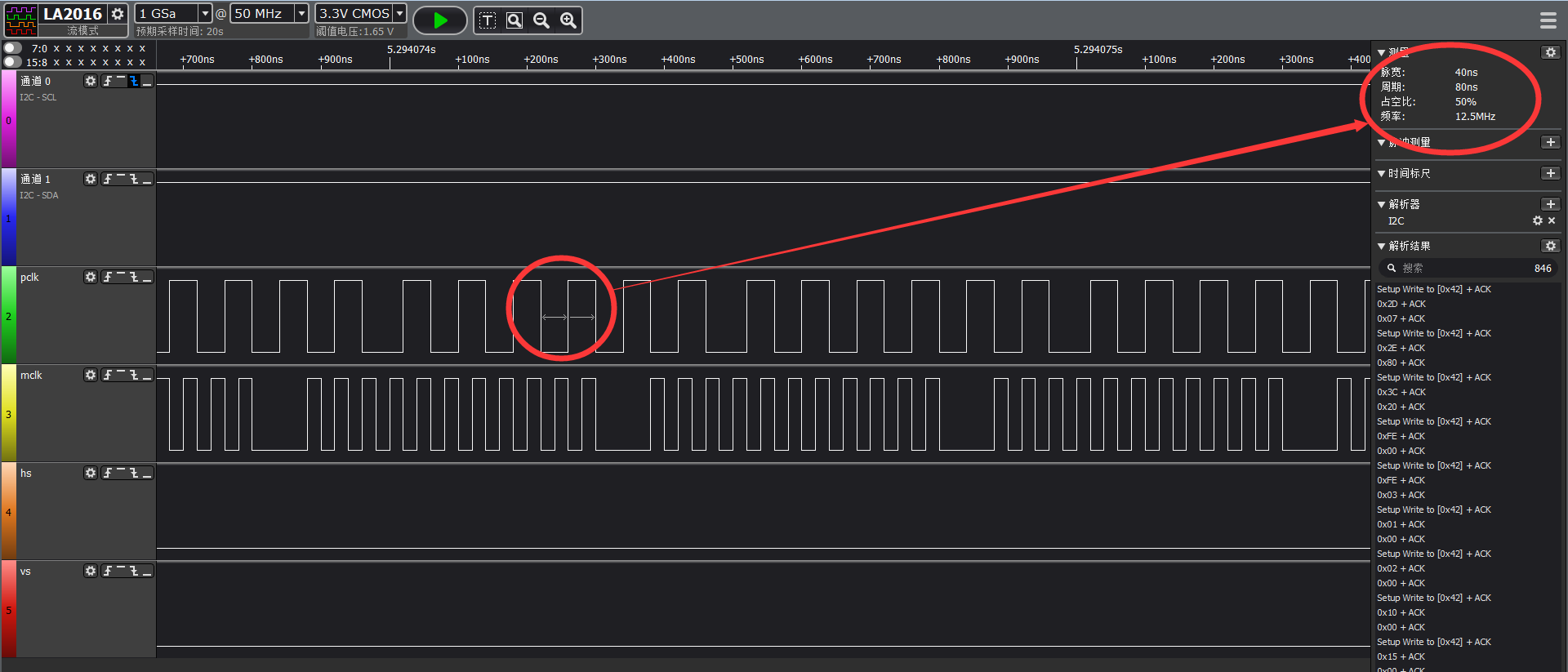

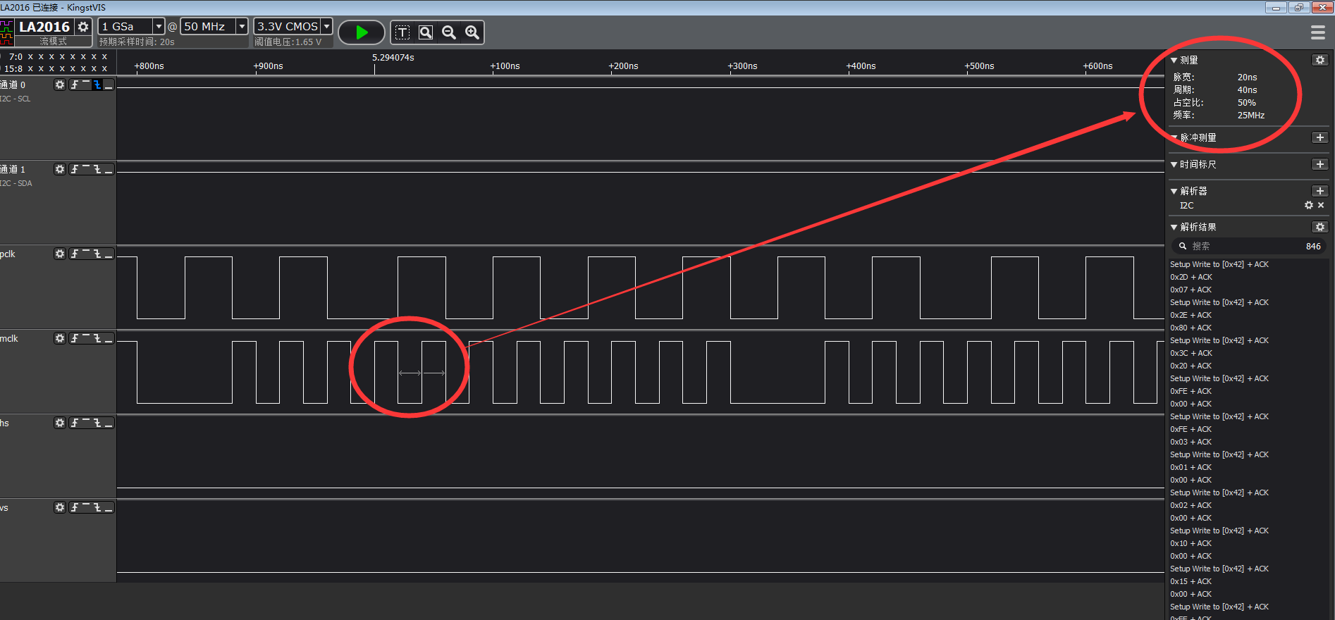

以下是用逻辑分析仪,抓取的,在执行fswebcam时,的iic的数据。

以上是我的启动过程,感觉gc0312注册成功了。但是在我执行fswebcam的时候,提示超时:
 #  fswebcam --no-banner  -d /dev/video1 -r 640x480 image3.jpg
[  779.011808] [VFE]vfe_open
--- Opening /dev/video1...
[  779.014854] [VFE]..........................vfe clk open!.......................
Trying source module v4l2...[  779.026607] [VFE]vfe_open ok
/dev/video1 opened.
[  779.032374] [VFE]Set vfe core clk = 108000000, after Set vfe core clk = 99000000
[  779.101325] [VFE]mclk on
[  779.221044] [VFE_WARN]v4l2 sub device queryctrl (null) unsuccess!
[  779.228071] [VFE]buffer_setup, buffer count=4, size=307200
--- Capturing frame...
[  789.258406] [VFE]vfe_close
Timed out waiting for frame!
[  789.285782] [VFE]mclk off
[  789.336852] [VFE]..........................vfe clk close!.......................
