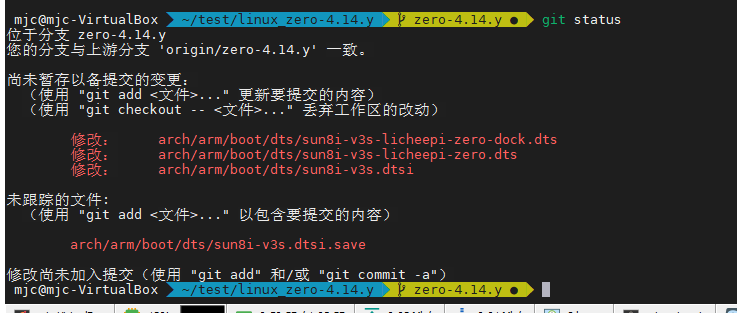

有进展,起码有数据了,改了spi设备树的interrupts,感觉哪里还没配置好,板子是荔枝zero

#28 全志 SOC » 修改linux内核文件导致的version不一致问题 » 2019-12-31 17:43:41
ma6254
回复: 3
我修改了tds,屏蔽了设备树里的mmc1,然后再编译
当尝试加载r8723be的ko文件时,发生了错误
应该是makefile里根据git的commit生成了新的kernel-release
该如何操作修改,让r8723bs.ko的modinfo跟commit走,或者修改内核强制release version为licheepi-zero+
# ls
r8723bs.ko
# insmod ./
.ash_history  .config/      r8723bs.ko
# insmod ./r8723bs.ko
[  320.810509] r8723bs: version magic '4.14.14-licheepi-zero+ SMP mod_unload ARMv7 p2v8 ' should be '4.14.14-gcda44c14-dirty SMP mod_unload ARMv7 p2v8 '
insmod: ERROR: could not insert module ./r8723bs.ko: Invalid module format
# uname -a
Linux buildroot 4.14.14-gcda44c14-dirty #3 SMP Sat Dec 28 13:57:47 CST 2019 armv7l GNU/Linux
# ^C
# modinfo ./
# modinfo ./r8723bs.ko
