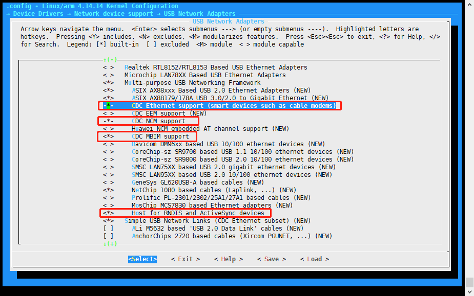

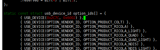

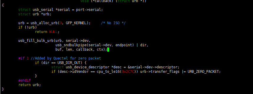

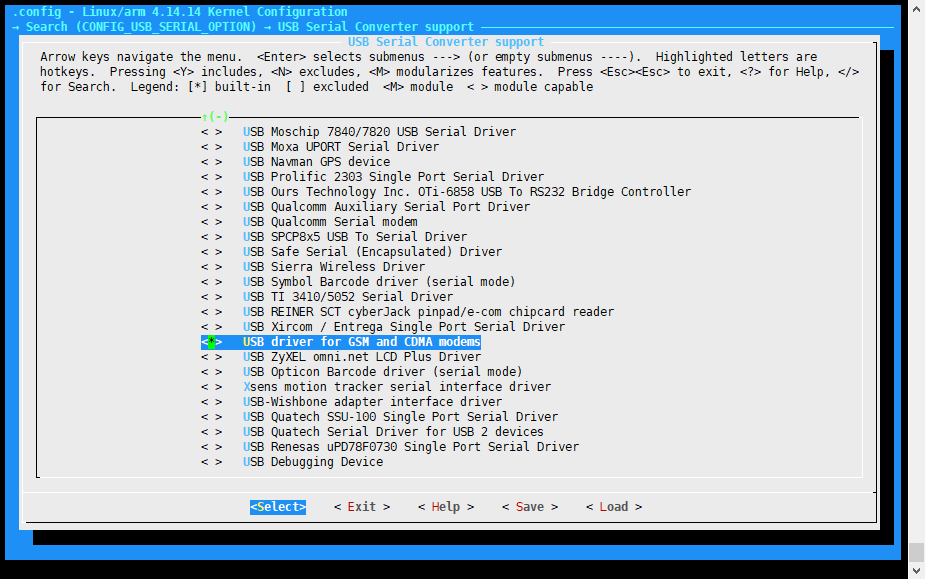

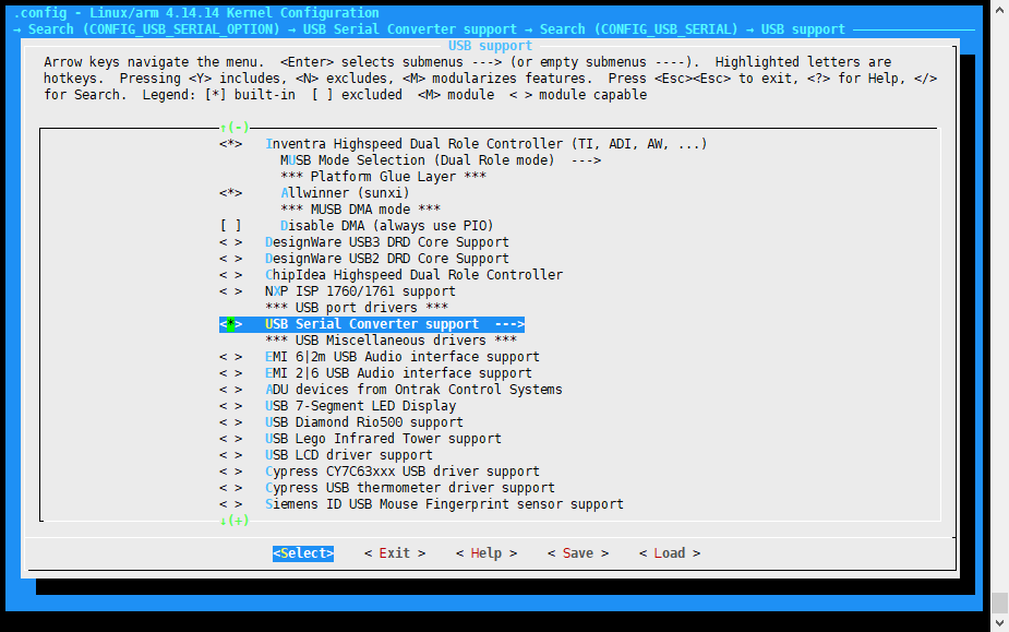

#6 Re: 全志 SOC » 全志V3S移植移远EC200S » 2022-11-15 22:24:48
编辑不了了,补一下上面的内核配置

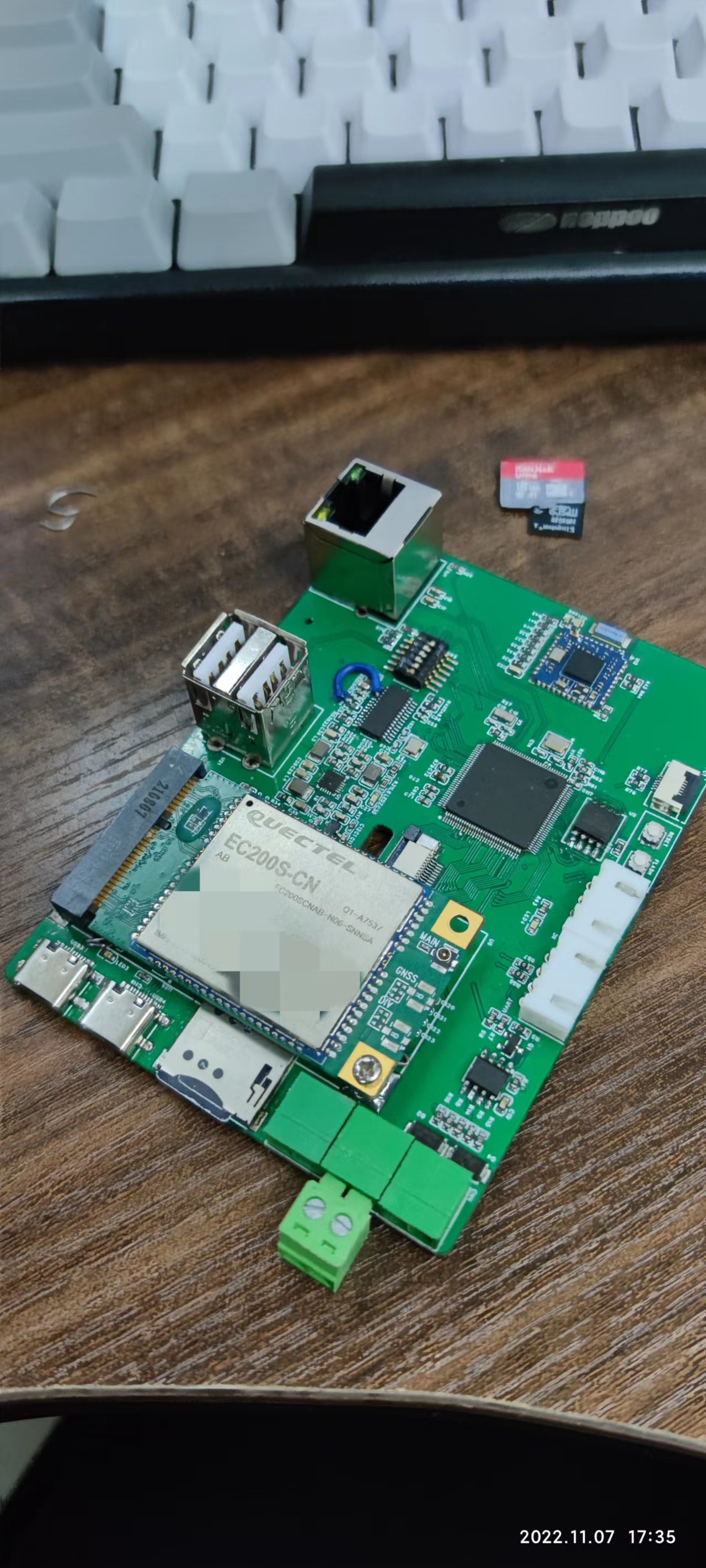

#14 全志 SOC » 全志V3S移植移远EC200S » 2022-11-07 17:37:53
tocurd
回复: 6
附文档
Quectel_EC200S_Linux_USB_Driver_User_Guide_V1.0.pdf
  1. 添加 VID 和 PID
    在文件[KERNEL]/drivers/usb/serial/option.c 中添加模块的 VID 和 PID 信息,如下所示:
static const struct usb_device_id option_ids[] = {
#if 1 //Added by Quectel
{ USB_DEVICE(0x2C7C, 0x6002) }, /* Quectel EC200S */
2.添加USB零包
[KERNEL]/drivers/usb/serial/usb_wwan.c.
static struct urb *usb_wwan_setup_urb(struct usb_serial *serial, int endpoint,
 int dir, void *ctx, char *buf, int len,void (*callback) (struct urb *))
usb_fill_bulk_urb(urb, serial->dev,
 usb_sndbulkpipe(serial->dev, endpoint) | dir,
 buf, len, callback, ctx);
#if 1 //Added by Quectel for zero packet
if (dir == USB_DIR_OUT) {
struct usb_device_descriptor *desc = &serial->dev->descriptor;
if (desc->idVendor == cpu_to_le16(0x2C7C))
urb->transfer_flags |= URB_ZERO_PACKET;
return urb;

.reset_resume = usb_wwan_resume,
接下来使能一些内核配置项
TODO......
