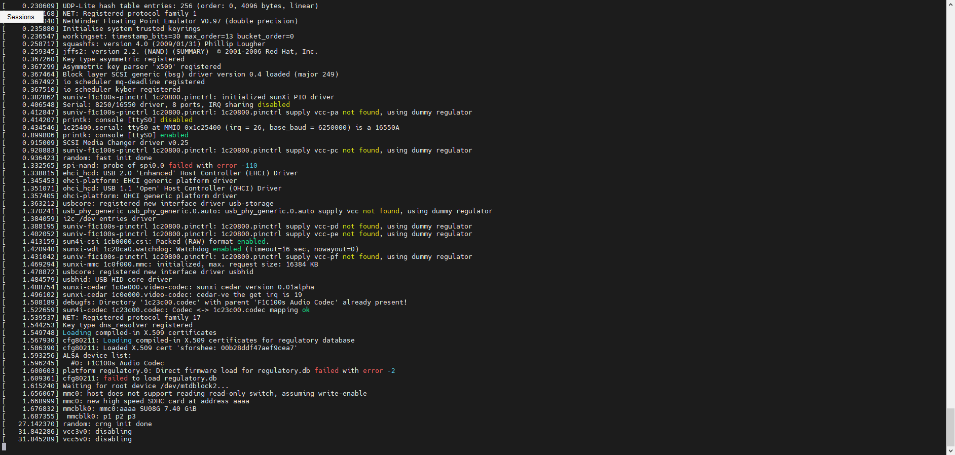

楼主你好,你用的是什么芯片阿,这个ft6336的驱动是那里获取的,内核好像没有。我找了个驱动Focaltech_Touch_FT5436_Driver_for_Qualcomm_V2.2_20180321,将文件夹整个复制进内核编译后打开报错,日志如下:
[    1.028443] [FTS]fts_ts_init: Enter
[    1.032049] [FTS]fts_ts_init: Exit(1679)
[    1.035968] i2c /dev entries driver
[    1.040274] suniv-f1c100s-pinctrl 1c20800.pinctrl: 1c20800.pinctrl supply vcc-pe not found, using dummy regulator
[    1.053051] [FTS]fts_ts_probe: Enter
[    1.056651] [FTS]fts_parse_dt: Enter
[    1.060371] [FTS][Info]display x(0 480) y(0 480)
[    1.065093] [FTS][Info]max touch number:5, irq gpio:128, reset gpio:0
[    1.071587] [FTS]fts_parse_dt: Exit(1194)
[    1.076026] [FTS]fts_input_init: Enter
[    1.080544] input: fts_ts as /devices/platform/soc/1c27000.i2c/i2c-0/0-0038/input/input0
[    1.089444] [FTS]fts_input_init: Exit(997)
[    1.093549] [FTS]fts_gpio_configure: Enter
[    1.097857] [FTS]fts_gpio_configure: Exit(1058)
[    1.102385] [FTS]fts_reset_proc: Enter
[    1.357761] [FTS]fts_reset_proc: Exit(254)
[    1.362810] [FTS]verify id:0x6426
[    1.366132] [FTS]TP not ready, read:0x6426
[    1.488676] [FTS]verify id:0x6426
[    1.492000] [FTS]TP not ready, read:0x6426
[    1.608670] [FTS]verify id:0x6426
[    1.611986] [FTS]TP not ready, read:0x6426
[    1.728663] [FTS]verify id:0x6426
[    1.731982] [FTS]TP not ready, read:0x6426
[    1.848644] [FTS]verify id:0x6426
[    1.851964] [FTS]TP not ready, read:0x6426
[    1.968657] [FTS]verify id:0x6426
[    1.971976] [FTS]TP not ready, read:0x6426
[    2.088656] [FTS]verify id:0x6426
[    2.091978] [FTS]TP not ready, read:0x6426
[    2.208663] [FTS]verify id:0x6426
[    2.211980] [FTS]TP not ready, read:0x6426
[    2.328658] [FTS]verify id:0x6426
[    2.331978] [FTS]TP not ready, read:0x6426
[    2.448227] random: fast init done
[    2.451990] [FTS]verify id:0x6426
[    2.455304] [FTS]TP not ready, read:0x6426
[    2.577746] [FTS][Info]fw is invalid, need read boot id
[    2.608580] [FTS][Error]read boot id fail
[    2.612593] [FTS][Error]not focal IC, unregister driver
[    2.619293] [FTS]fts_ts_probe: Exit(1452)
[    2.623385] fts_ts: probe of 0-0038 failed with error -5
[    2.630924] sunxi-wdt 1c20ca0.watchdog: Watchdog enabled (timeout=16 sec, nowayout=0)

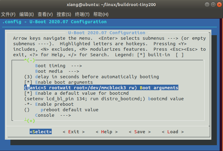

#9 Re: 全志 SOC » f1c100s 跑linux液晶屏不显示,请问是哪里有问题,(Uboot可以显示) » 2024-03-24 22:30:46
使用这个buildroot-tiny200 SDK,只需在uboot里面配置一下自己的屏幕参数即可自动点亮。
#10 Re: 全志 SOC » f1c100s驱动rgb屏求助 » 2024-03-24 22:29:50

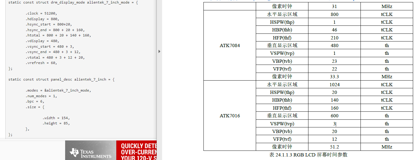

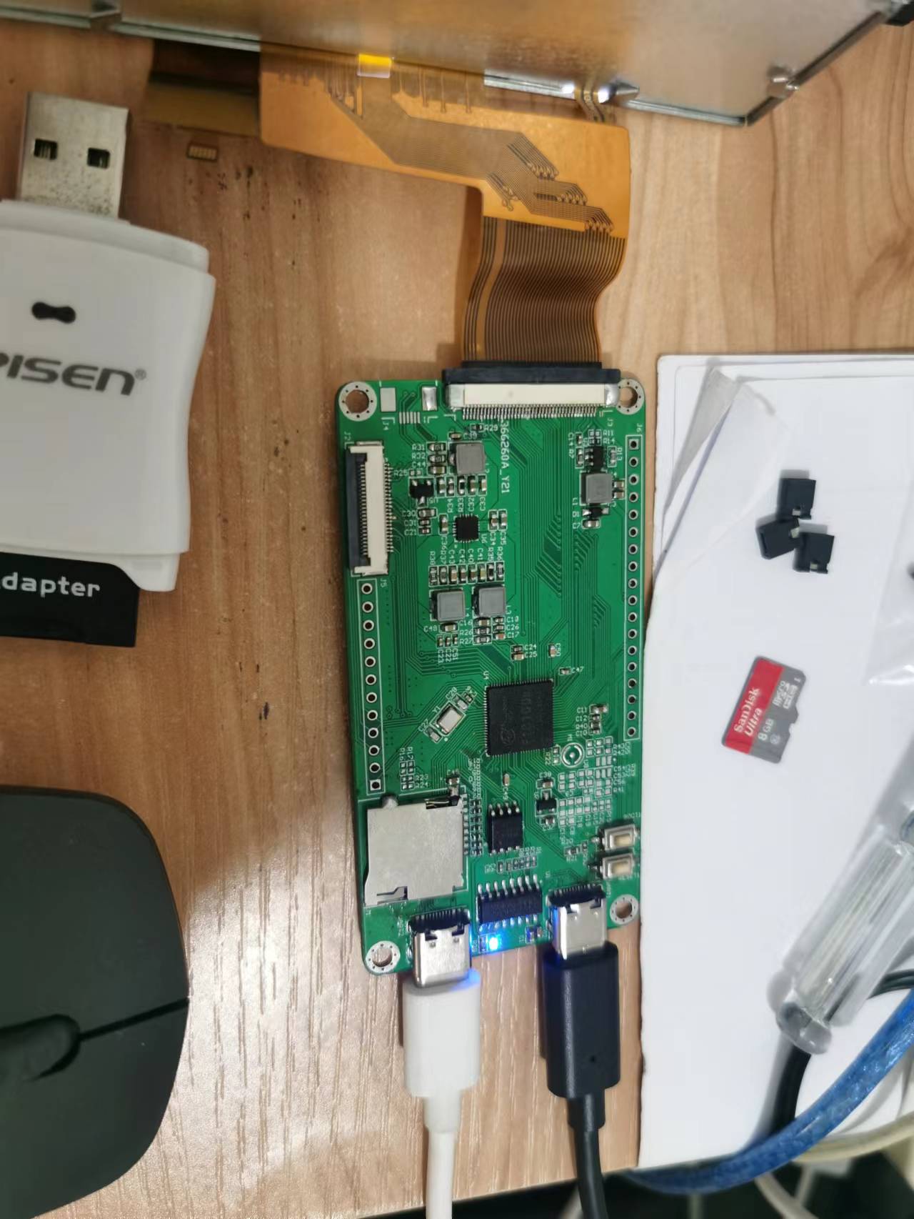

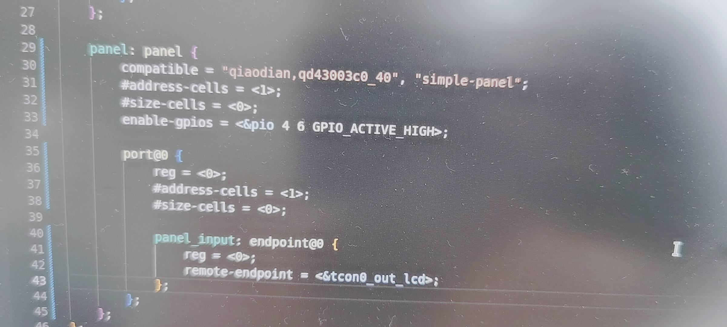

Symbol: DRM_PANEL_SIMPLE [=y]                                                                                                         │
  │ Type  : tristate                                                                                                                      │
  │ Prompt: support for simple panels                                                                                                     │
  │   Location:                                                                                                                           │
  │     -> Device Drivers                                                                                                                 │
  │       -> Graphics support                                                                                                             │
  │ (7)     -> Display Panels                                                                                                             │
  │   Defined at drivers/gpu/drm/panel/Kconfig:31                                                                                         │
  │   Depends on: HAS_IOMEM [=y] && DRM [=y] && DRM_PANEL [=y] && OF [=y] && BACKLIGHT_CLASS_DEVICE [=y]                                  │
  │   Selects: VIDEOMODE_HELPERS [=y]
找到了,应该是这个,但是已经打开了,屏幕还是没有亮,这个板子以前我点亮过的,时间长了,忘记原先怎么设置的了。

晕哥,请教下,我使用荔枝派用tiny200驱动480*272的屏,显示演示不对,偏灰,然后有很多条纹,这个是啥情况,是引脚不对还是屏参不对啊
显示效果:
设备树配置:
屏参:
网友的配置例子:
我是没有明白那个hsync_start和hsync_end这些参数后面为什么要用800+20这样的写法,不知道代表什么样的意思。
上面那个显示灰色的已经是我测试显示最好的效果了,荔枝派这个板子,i2c0是复用为lcd的引脚了,不知道这个有咩有影响,我再设备树里屏蔽I2c0也是一样显示灰色。
#33 Re: 全志 SOC » 关于F1C100无法启动,卡在Waiting for root device /dev/mtdblock2... » 2022-06-16 17:07:47

我记得 uboot那个脚本实现了自动检测启动介质,实现了不同的bootargs。
下面那个问题检查一下dts设备树,可能默认是spi nand,而不是spi nor。
我尝试过再配置中使能bootargs,但是好像没有生效,那我想从tf卡启动应该怎么设置,将设备树flash的status都改为disable?
从flash启动我看有同学改过设备树,我尝试过修改nor的 status = "okay";将nand    的status = "disabled";还是一样的效果,这个是linux设备树,uboot的设备树也要改嘛?
