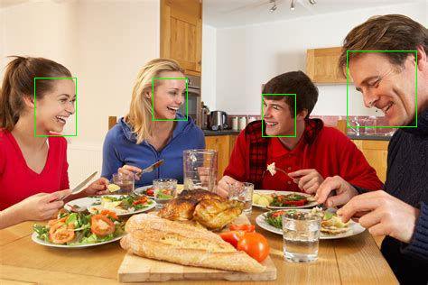

话接上文,官方SDK中的人形检测只能判断是否有人,没办法用红框标记出来,实在很不得劲。于是一顿搜索,果然找到几个可以在嵌入式上跑的开源项目,
于是在128M内存,256M Flash小身板上,都跑了一下最简单的人脸检测,记录如下:
原图size 474*316

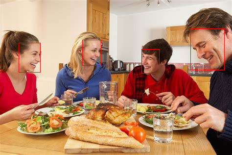

Tengine 之 ultraface
参考 https://github.com/OAID/Tengine
使用 Tengine 的 ultraface例程进行处理,用时275.6ms,速度最佳,准确率略输retinaface
/tengine # ./tm_ultraface  -i images/selfie_960.jpg -m models/rfb-320.tmfile
tengine-lite library version: 1.5-dev
Repeat 1 times, thread 1, avg time 275.66 ms, max_time 275.66 ms, min_time 275.66 ms
detected face num: 4
BOX 0.97:(389.72, 58.97),(458.94, 142.53)
BOX 0.91:(38.55, 87.36),(82.94, 147.53)
BOX 0.91:(289.84, 100.03),(325.86, 149.08)
BOX 0.94:(168.73, 81.97),(206.14, 133.12)
[DETECTED IMAGE SAVED]:
Tengine 之 retinaface
参考相同git ,使用不同例子,用时686.3ms,速度第二,用时间换来了准确率。可以看到还标出5个关键点。
~/tengine # ./tm_retinaface -i images/mtcnn_face4.jpg
img_h, img_w : 316, 474
Repeat 1 times, thread 1, avg time 686.30 ms, max_time 686.30 ms, min_time 686.30 ms
BOX 1.00:( 38.4053 , 86.142 ),( 46.3009 , 64.0174 )
BOX 0.99:( 384.076 , 56.9844 ),( 76.968 , 83.9609 )
BOX 0.99:( 169.196 , 87.1324 ),( 38.4133 , 46.8504 )
BOX 0.98:( 290.004 , 104.453 ),( 37.6345 , 46.7777 )

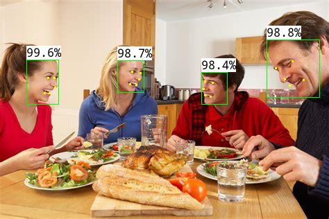

腾讯开源的ncnn
参考 https://github.com/Tencent/ncnn.git
用时0.99s,速度第三
/tengine/images # time ./retinaface selfie_960.jpg
dlopen failed File not found
load vulkan driver failed
0.99604 at 38.39 86.17 46.31 x 64.00
0.98804 at 384.06 57.02 76.96 x 83.92
0.98677 at 169.21 87.12 38.40 x 46.85
0.98447 at 290.00 104.45 37.62 x 46.79
waitKey stub
real    0m 0.99s
user    0m 0.90s
sys     0m 0.09s
dlib 之frontal_face_detector
参考https://github.com/david8862/dlib_on_arm
这个交叉编译又复杂,依赖又多,差点放弃,居然耗时最多,准确率也最低,漏检测一个人脸,运行结果图就不上了
/tengine/dlib # time ./sl_face_detect ../images/selfie_960.jpg
processing image ../images/selfie_960.jpg
Number of faces detected: 3
faces detected: [(352, 179) (438, 265)]
faces detected: [(102, 188) (188, 275)]
faces detected: [(563, 208) (649, 294)]
real    0m 34.48s
user    0m 34.43s
sys     0m 0.00s
