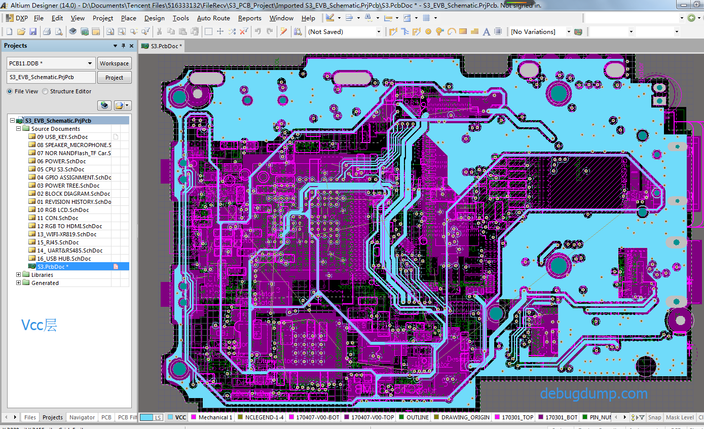

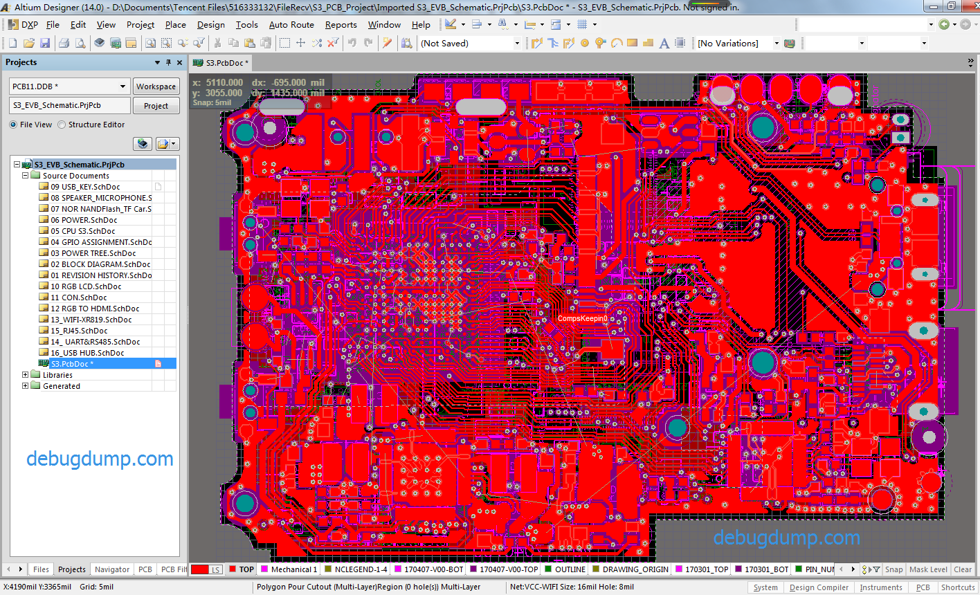

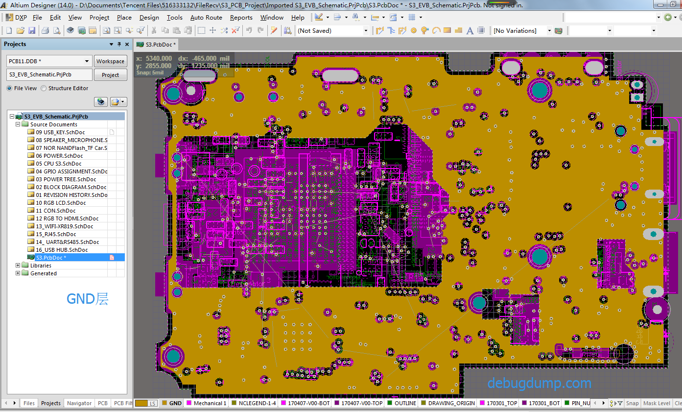

楼主 #3 2018-10-12 15:51:35
已发帖子: 9,440
Re: 编译索智(Sochip) S3 SDK (zeta) 【提供DXP格式原理图与PCB,感谢 @playflash】

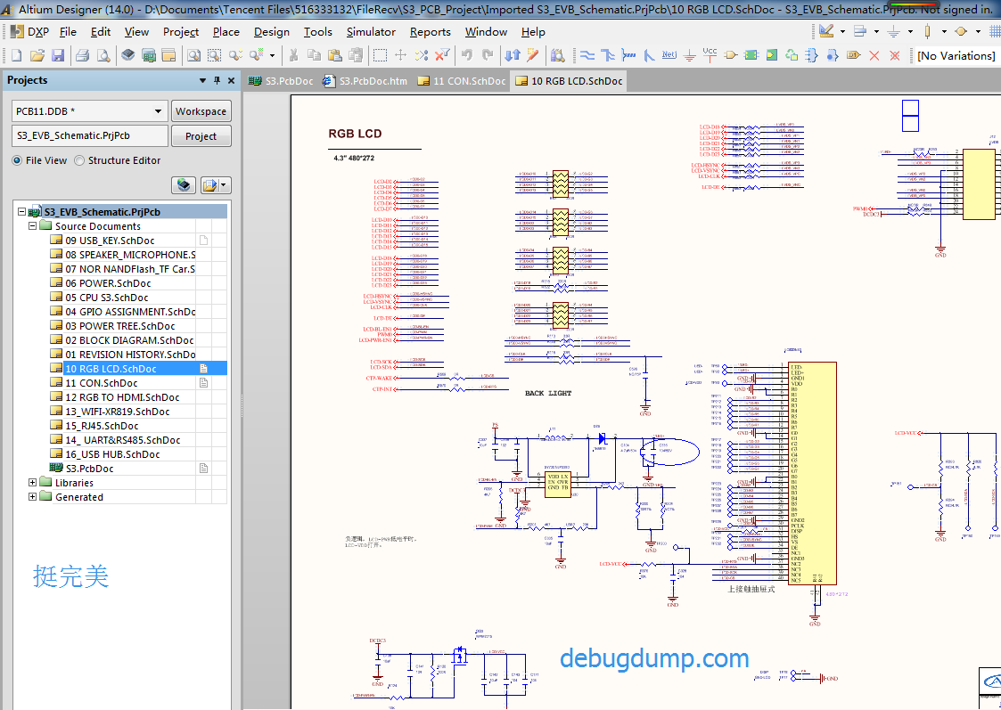

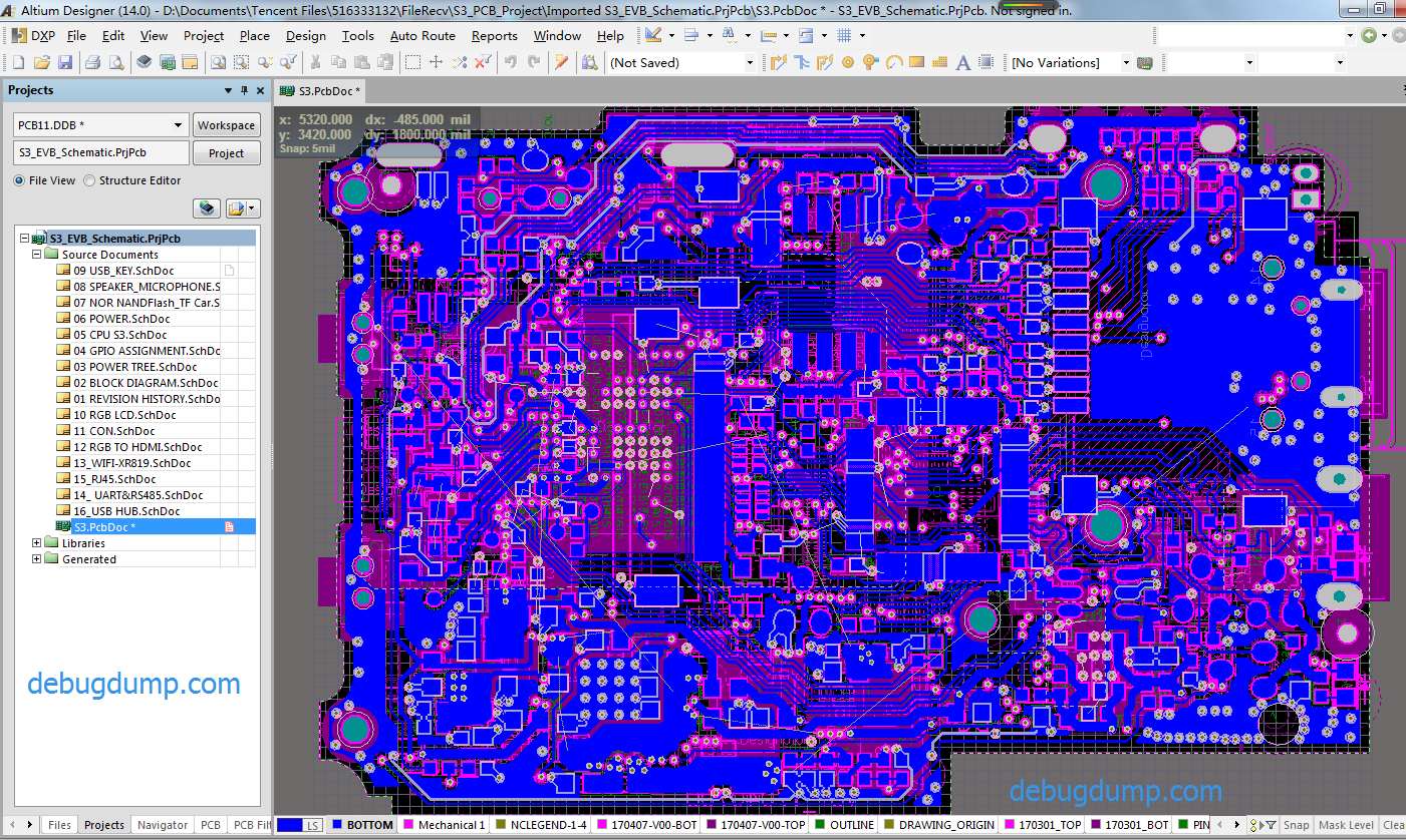

DXP格式原理图与PCB下载: S3_PCB_Project.7z
感谢debugdump网友 @playflash !!!

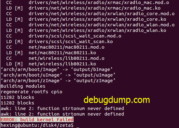

楼主 #9 2018-10-12 16:58:57
已发帖子: 9,440
LD [M]  net/wireless/lib80211.ko
‘arch/arm/boot/Image’ -> ‘output/bImage’
‘arch/arm/boot/uImage’ -> ‘output/uImage’
‘arch/arm/boot/zImage’ -> ‘output/zImage’
Building modules
regenerate rootfs cpio
11282 blocks
11282 blocks
awk: line 2: function strtonum never defined
ERROR: build kernel Failed
嗯嗯,只有一个小错误.
找到解决方案:
https://blog.csdn.net/dpppppp/article/details/53018132
sudo apt-get install gawk

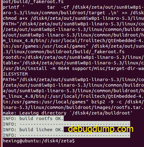

楼主 #10 2018-10-12 17:05:35
已发帖子: 9,440
S3 SDK编译完成, 接下来看看怎么到 V3s 板子上跑跑.

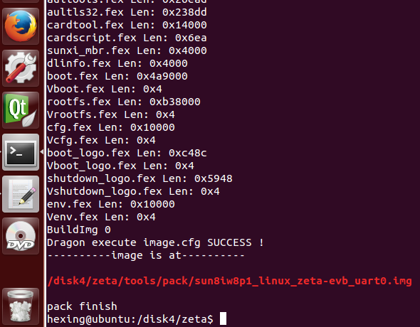

FileLength=10000sys_config.fex Len: 0xe405
config.fex Len: 0x8af4
split_xxxx.fex Len: 0x200
sys_partition.fex Len: 0xa0c
boot0_spinor.fex Len: 0x4000
boot0_sdcard.fex Len: 0x8000
boot0_spinand.fex Len: 0x6000
u-boot.fex Len: 0xac000
fes1.fex Len: 0x31c0
full_img.fex Len: 0xfd3000
usbtool.fex Len: 0x23000
aultools.fex Len: 0x26ead
aultls32.fex Len: 0x238dd
cardtool.fex Len: 0x14000
cardscript.fex Len: 0x6ea
sunxi_mbr.fex Len: 0x4000
dlinfo.fex Len: 0x4000
boot.fex Len: 0x4a9000
Vboot.fex Len: 0x4
rootfs.fex Len: 0xb38000
Vrootfs.fex Len: 0x4
cfg.fex Len: 0x10000
Vcfg.fex Len: 0x4
boot_logo.fex Len: 0xc48c
Vboot_logo.fex Len: 0x4
shutdown_logo.fex Len: 0x5948
Vshutdown_logo.fex Len: 0x4
env.fex Len: 0x10000
Venv.fex Len: 0x4
BuildImg 0
Dragon execute image.cfg SUCCESS !
/disk4/zeta/tools/pack/sun8iw8p1_linux_zeta-evb_uart0.img
pack finish
hexing@ubuntu:/disk4/zeta$
source build/envsetup.sh
zmake all
按芒果 @mango 的提示,
终于编译成功了.

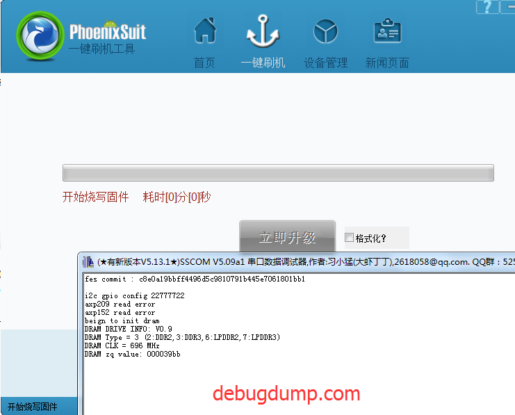

fes commit : c8e0a19bbff4496d5c9810791b445e7061801bb1
i2c gpio config 22777722
axp209 read error
axp152 read error
beign to init dram
DRAM DRIVE INFO: V0.9
DRAM Type = 3 (2:DDR2,3:DDR3,6:LPDDR2,7:LPDDR3)
DRAM CLK = 696 MHz
DRAM zq value: 000039bb

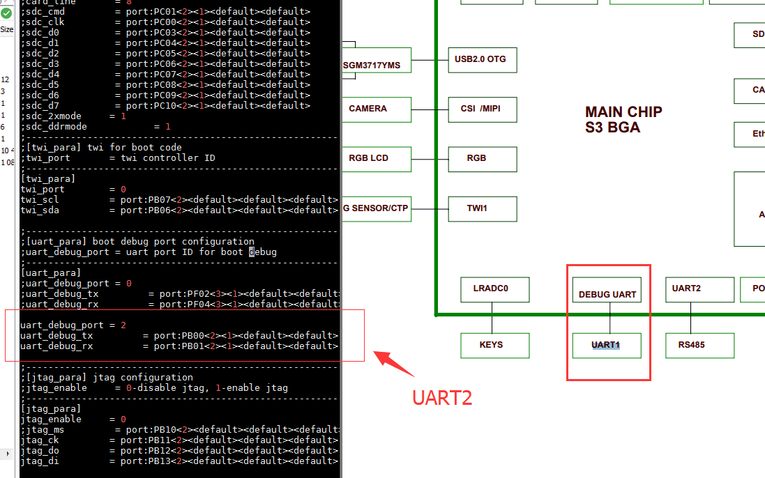

试一试荔枝派zero开发板,
串口接上 UART2(PB0,PB1),用官方软件PhoenixSuit烧录, 进度条始终是0.
估计是 S3的DRAM参数与 S3还是有不同的。

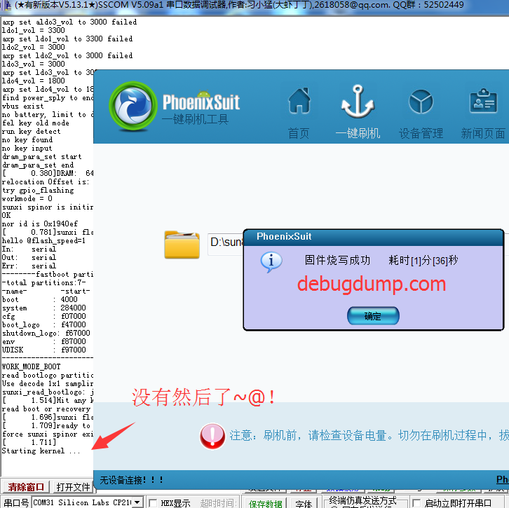

一番折腾之后荔枝派zero(V3s)终于可以烧写了, 但是 Starting kernel ... 就挂了...
断电重启后酱紫的:

有个问题没有搞明白, 索智开发板用的是 UART1 作为调试串口, 而 sys_config.fex 却使用 UART2 作为调试串口.

现在是把 camdroid 里面的 sys_config.fex 覆盖 索智 SDK里面的 sys_config.fex,
编译出 img, 能烧录到 V3s, 但是卡住在 staring kernel ...
真是一个悲伤的消息.

晕哥, 你搜索原来S3的linux-3.4/.config文件试试,关键字:80m,85m,更改为20m,25m,  按字面理解,这是预留内存给图像处理,之后zmake all
我不在linux电脑上, 具体这一项的名字, 我暂时查不到。
还不行的话, 我上传我的.config给你研究一下。

CONFIG_ION=y
CONFIG_ION_SUNXI=y
CONFIG_ION_SUNXI_RESERVE_LIST="80m,85m"
改成这样:
CONFIG_ION=y
CONFIG_ION_SUNXI=y
CONFIG_ION_SUNXI_RESERVE_LIST="28m,28m"
就可以了吗?
我试一试...

应该是这里。

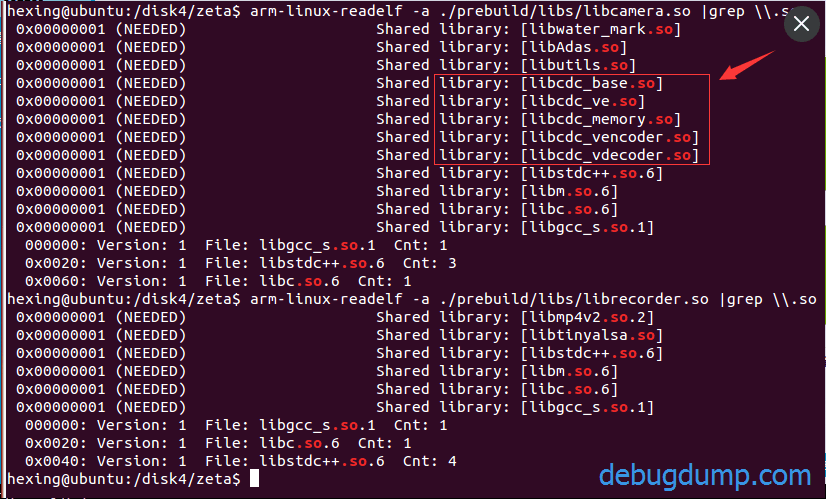

hexing@ubuntu:/disk4/zeta$ arm-linux-readelf -a ./prebuild/libs/libcamera.so |grep \\.so
0x00000001 (NEEDED)                     Shared library: [libwater_mark.so]
0x00000001 (NEEDED)                     Shared library: [libAdas.so]
0x00000001 (NEEDED)                     Shared library: [libutils.so]
0x00000001 (NEEDED)                     Shared library: [libcdc_base.so]
0x00000001 (NEEDED)                     Shared library: [libcdc_ve.so]
0x00000001 (NEEDED)                     Shared library: [libcdc_memory.so]
0x00000001 (NEEDED)                     Shared library: [libcdc_vencoder.so]
0x00000001 (NEEDED)                     Shared library: [libcdc_vdecoder.so]
0x00000001 (NEEDED)                     Shared library: [libstdc++.so.6]
0x00000001 (NEEDED)                     Shared library: [libm.so.6]
0x00000001 (NEEDED)                     Shared library: [libc.so.6]
0x00000001 (NEEDED)                     Shared library: [libgcc_s.so.1]
  000000: Version: 1  File: libgcc_s.so.1  Cnt: 1
  0x0020: Version: 1  File: libstdc++.so.6  Cnt: 3
  0x0060: Version: 1  File: libc.so.6  Cnt: 1
hexing@ubuntu:/disk4/zeta$ arm-linux-readelf -a ./prebuild/libs/librecorder.so |grep \\.so
0x00000001 (NEEDED)                     Shared library: [libmp4v2.so.2]
0x00000001 (NEEDED)                     Shared library: [libtinyalsa.so]
  0x0020: Version: 1  File: libc.so.6  Cnt: 1
  0x0040: Version: 1  File: libstdc++.so.6  Cnt: 4
由此可见,zeta 弄了个 libcamera.so 封装了全志的库 libcdc*.so

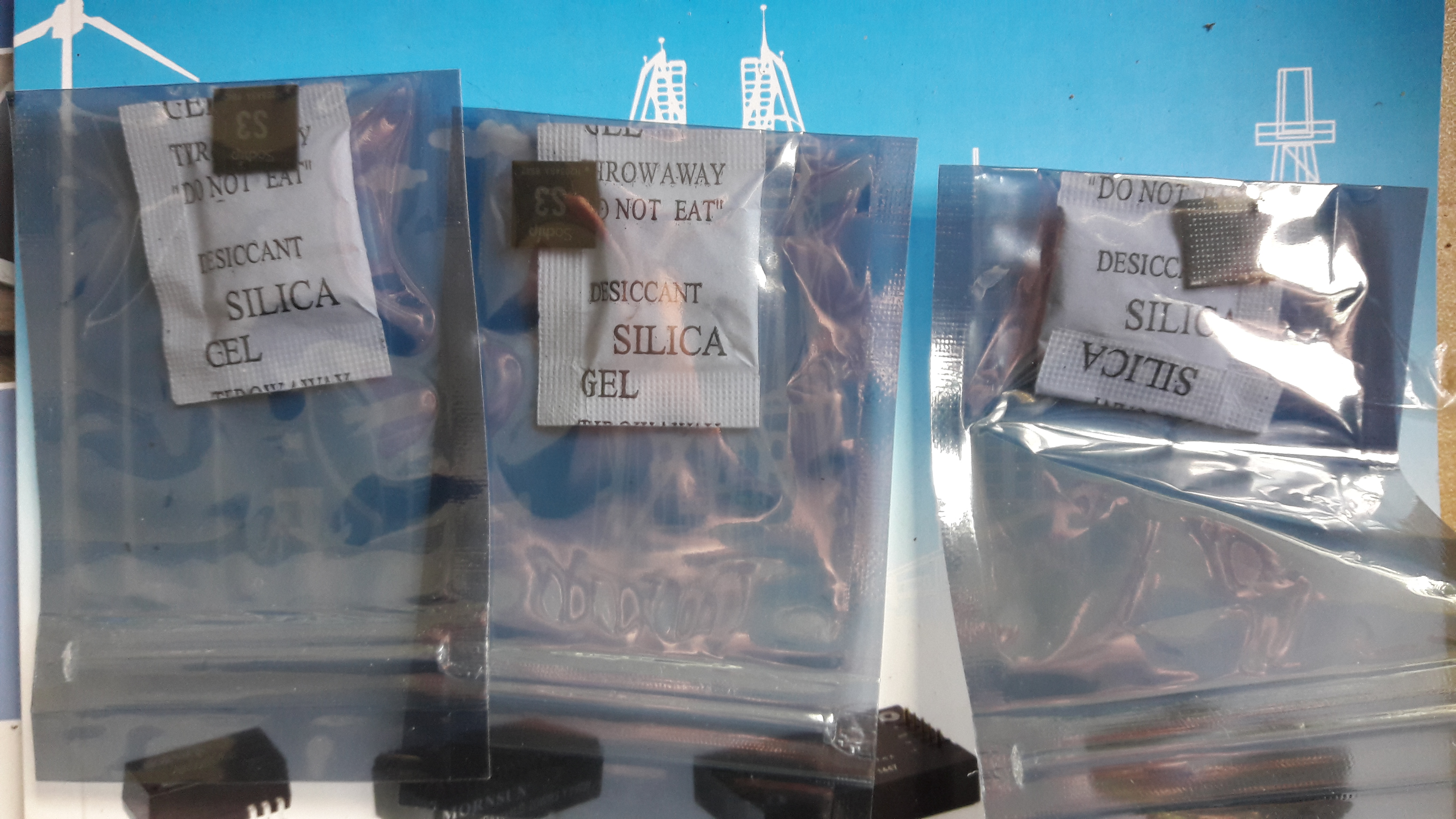

vigour1000 说:
掏了三片https://whycan.cn/files/members/1257/20181127_080112.jpg
看起来是翻新?多少钱买的?
在线
#62 2018-11-27 10:37:21
vigour1000
注册时间: 2018-11-19
已发帖子: 103
30多呢,现在画板试一看

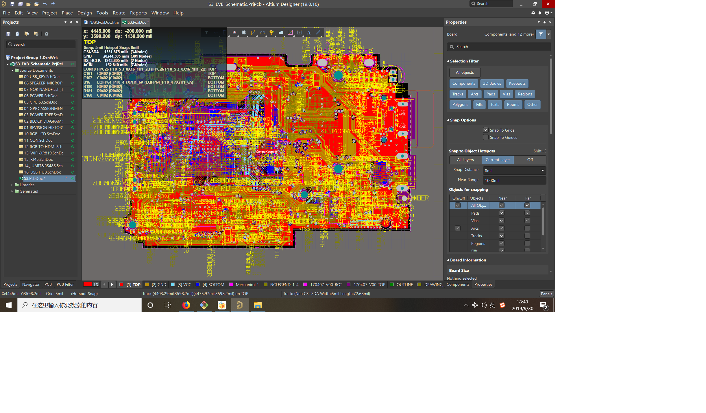

楼主 #88 2019-09-30 19:53:44
已发帖子: 9,440
可能某些层的显示被我disable了
在线
#89 2019-09-30 20:33:49
晕哥小弟
注册时间: 2019-04-04
已发帖子: 311
积分: 301.5
要不重新上传一份呗.
楼主 #90 2019-09-30 20:51:00
已发帖子: 9,440
图层设置一下就好了
在线
#91 2019-09-30 21:12:56
晕哥小弟
注册时间: 2019-04-04
已发帖子: 311
积分: 301.5
不明白你中间层GND,为什么不整个铺满 ?
楼主 #92 2019-09-30 21:36:34
已发帖子: 9,440
或许设计就是这样,或许转换的时候丢了

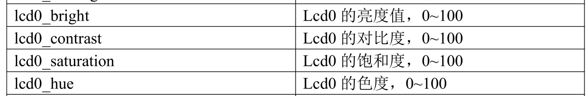

应该如何调用底层LCD屏的对比度,饱和度,色度来控制显示屏的参数。

Sk吴 说:
首先要看你的屏幕是什么型号。

raspberryman 说:
首先要看你的屏幕是什么型号。
屏:YH080MH0K1;IC:GT911。
或者怎么调用摄像头的。
最近编辑记录 Sk吴 (2020-01-16 12:01:59)

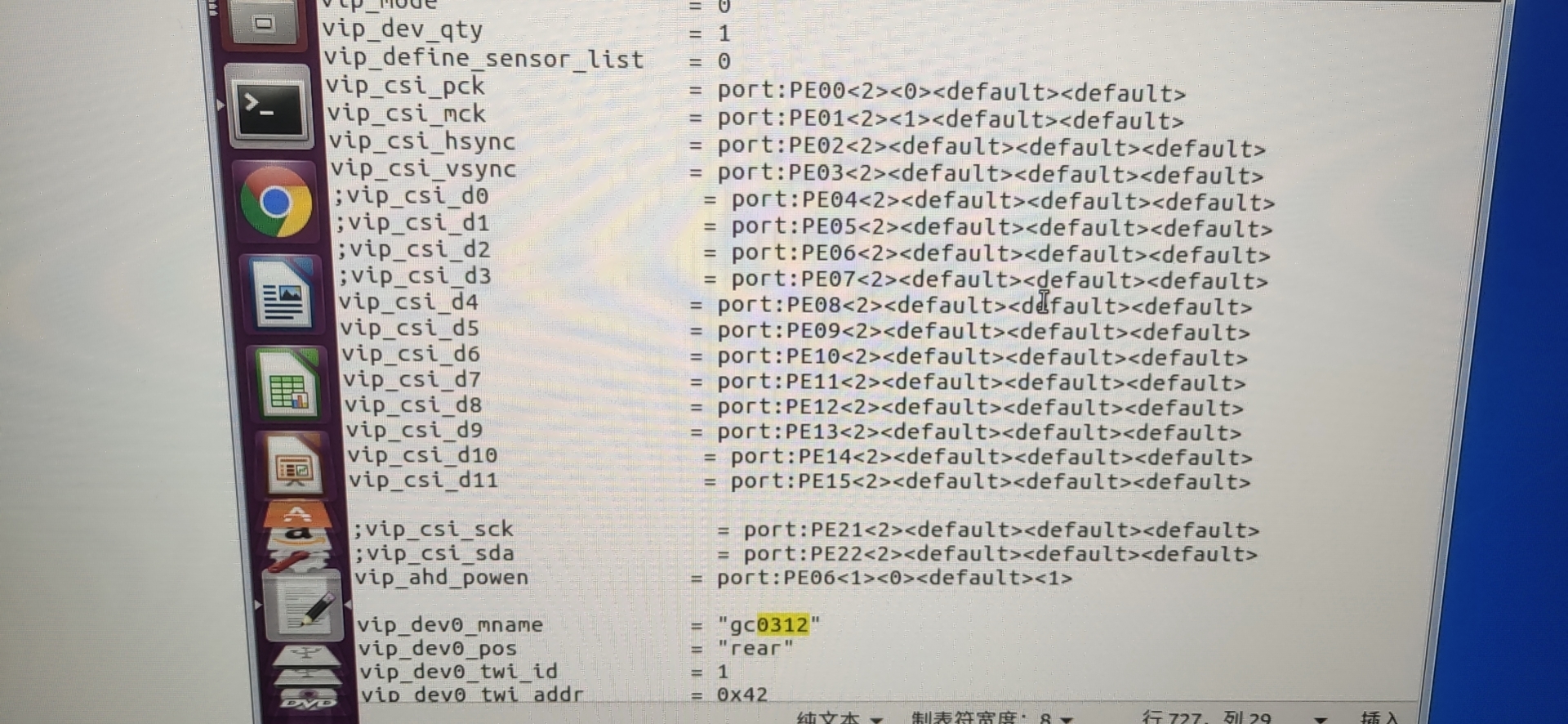

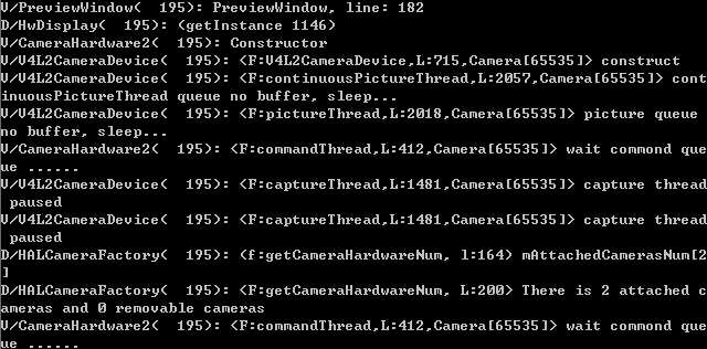

同sensor:gc0312 配置也一样。  8寸的可以。4.3寸的会出现这个情况。
sensor:ov9732_mipi也会出现8寸的也会出现4.3寸这种情况。我好难呀。

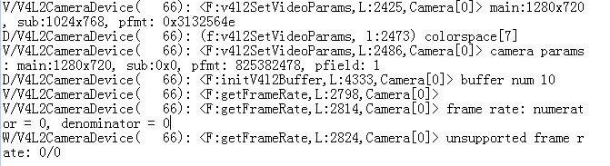

识别摄像头打印的log提示无缓冲区。应该修改哪些地方呢。
#118 2020-03-03 16:46:02
Sk吴
注册时间: 2020-01-15
积分: 17

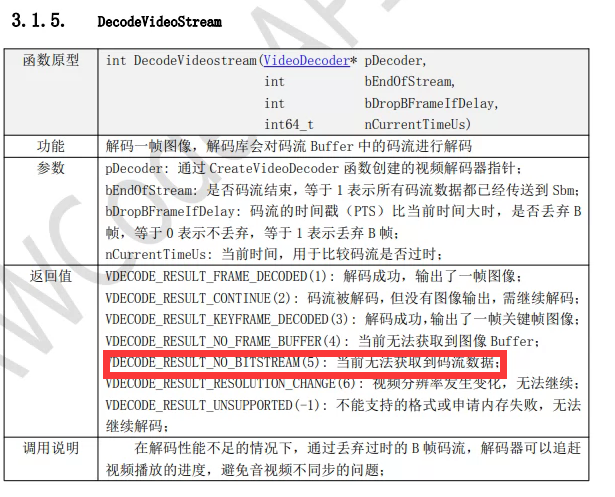

获取不了视频的分辨率是啥原因。大佬们。

楼主,按照你的方法改,烧写进度还是一直的 0 啊:)

@路人甲 你用的是不是Ubuntu18.04/20.04?
要不要试一试嘛14.04或16.04?

非常感谢, 还真是这个问题, 用 ubuntu14.04 就好了
先装以下软件: http://www.sochip.com.cn/s3/index.php?title=Initializing_the_Build_Environment
sudo apt-get install git-core gnupg flex bison gperf build-essential \
zip curl zlib1g-dev gcc-multilib g++-multilib libc6-dev-i386 \
lib32ncurses5-dev x11proto-core-dev libx11-dev lib32z1-dev ccache \
libgl1-mesa-dev libxml2-utils xsltproc unzip u-boot-tools gawk -y
然后执行
source build/envsetup.sh; zmake all
就可以了。

填坑中, 下了晕哥的SDK, 整体能编译. 想结合Zeta_Linux_Samples
在V3s上来测测H264解码, 发现缺了一些库和目录. 希望大佬分享, 最好解释一下作用.
  1. prebuild/libs/libmediaplayer.so
  2. prebuild/libs/libAdas.so
另外问:libaw_net.so是做什么的?
之后的简化demo代码想跑一下V3s纯粹的硬解(基于社区逆向出来的编解码器)...未果,
卡在了DecodeVideoStream()总返回5或者-1, 送进去的视频是已经格式工厂二次编码的纯正H264文件, 疯狂调参未果:(
转tina填坑中...
