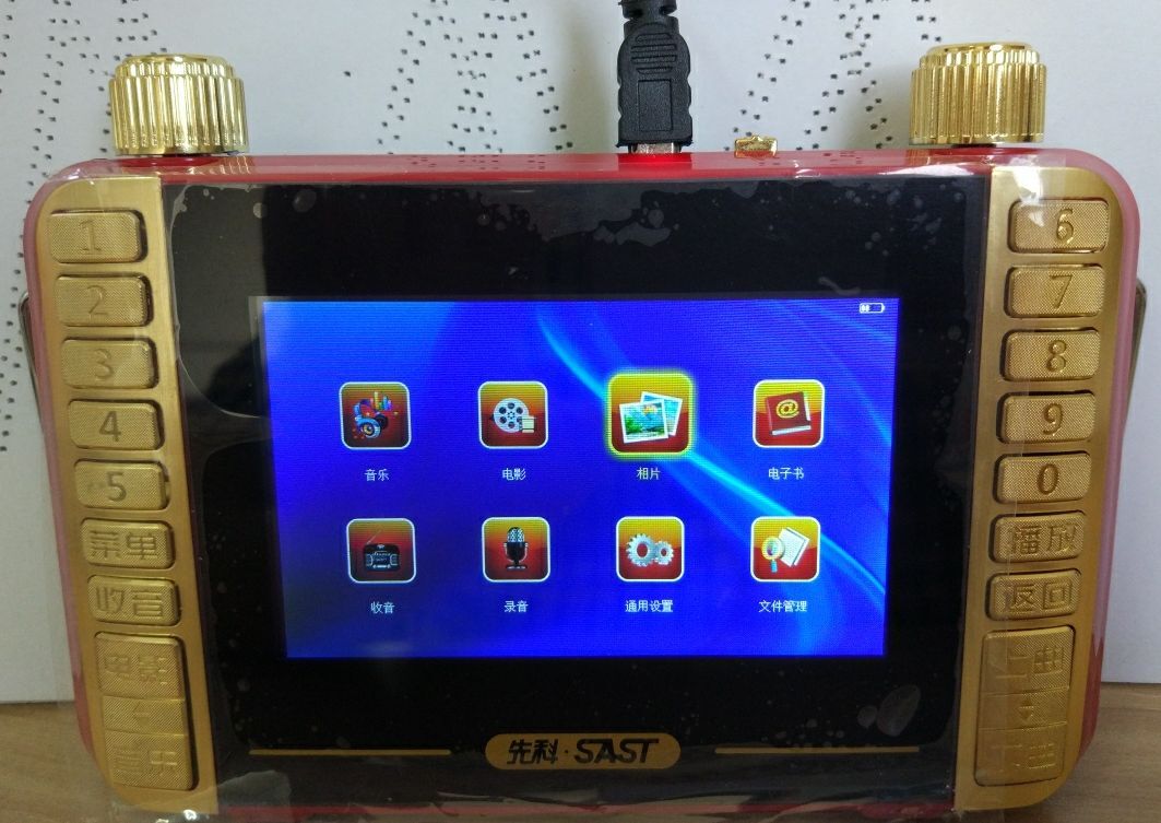

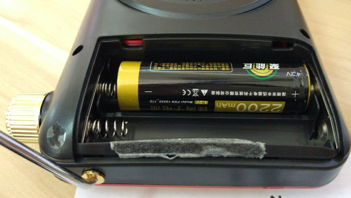

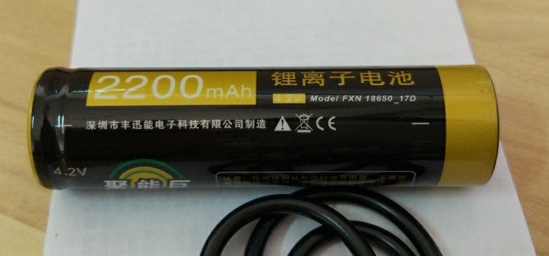

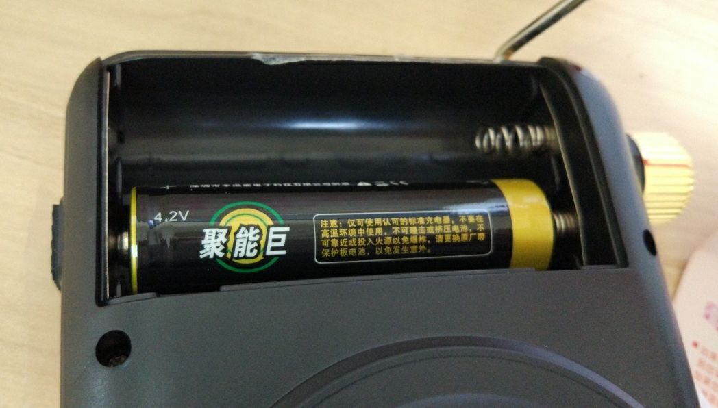

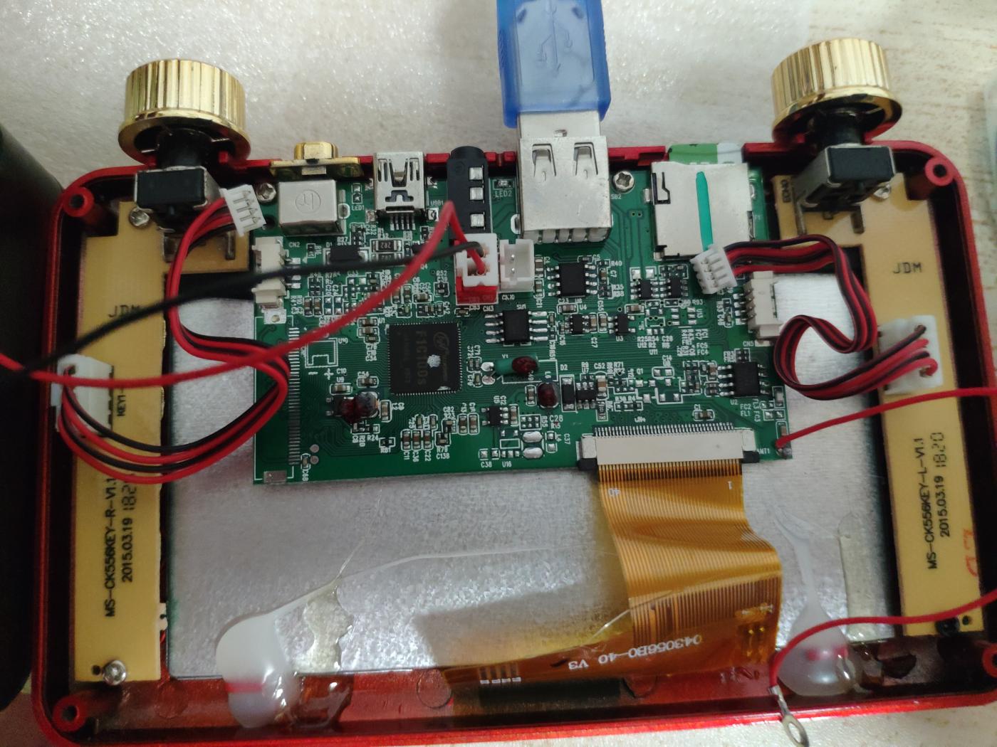

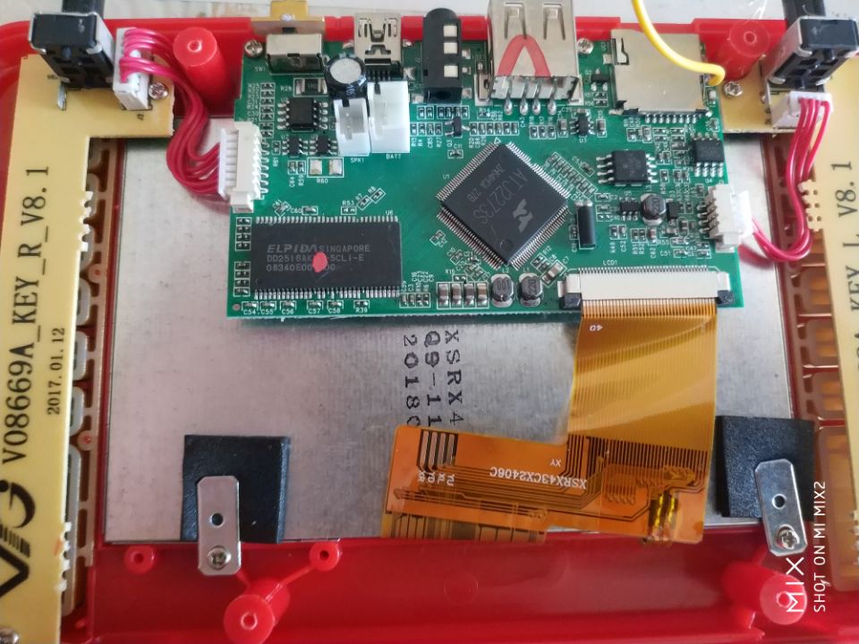

Re: 买个全志arm9 F1C100s 方案的唱戏机回来拆一拆
等了四天,刚刚收到的全志F1C100s唱戏机

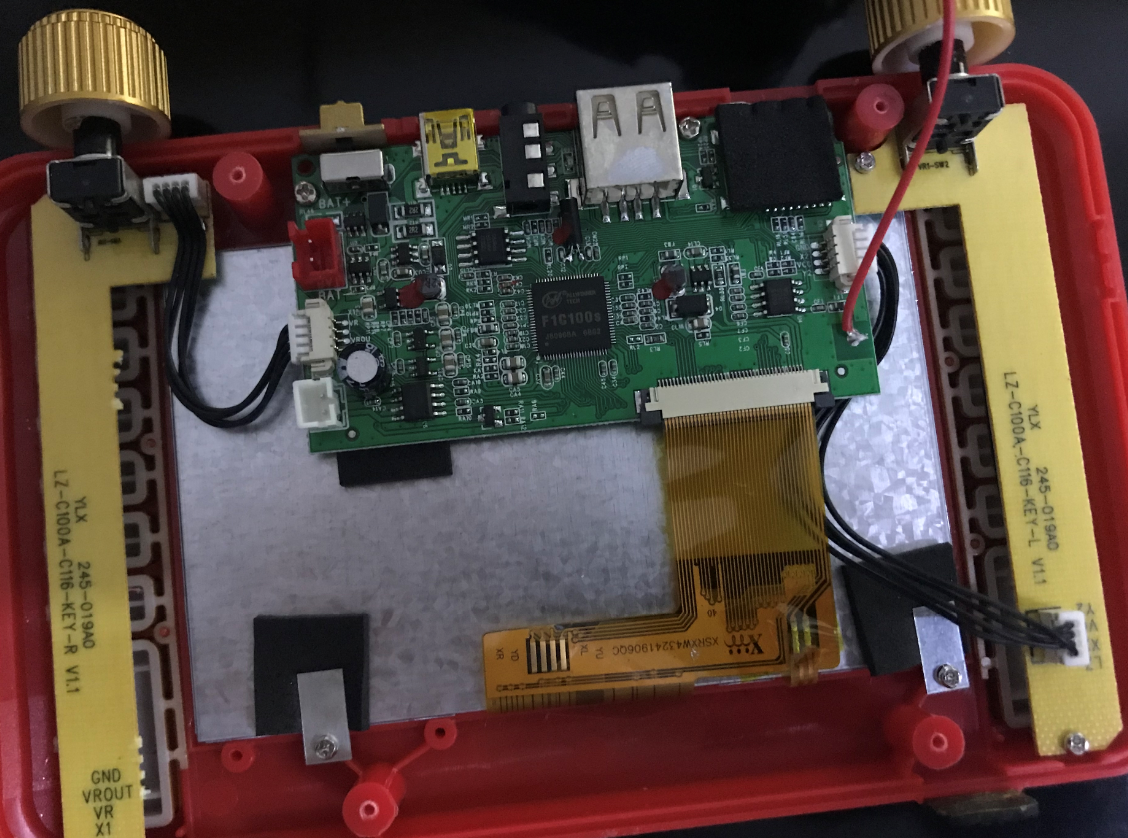

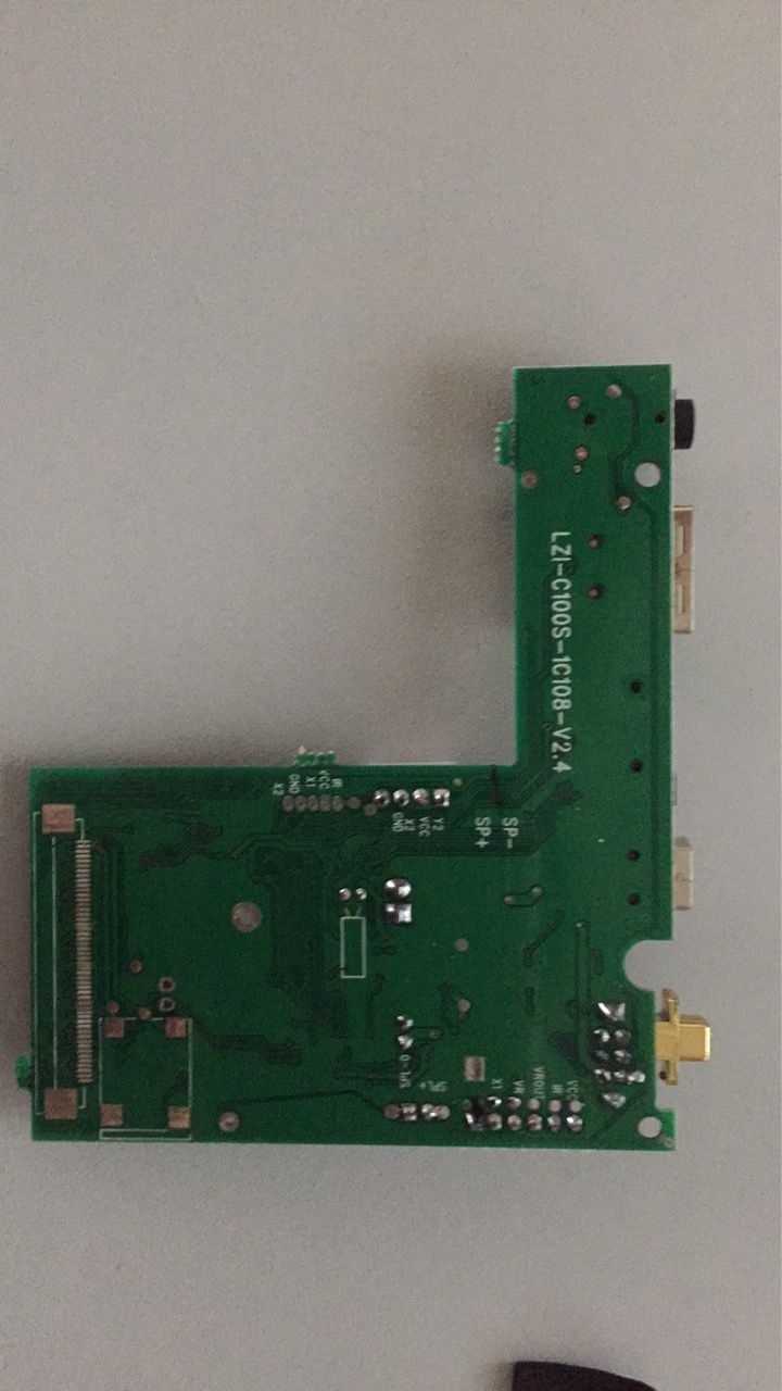

楼主 #3 2017-10-27 08:47:42
已发帖子: 9,444
继续

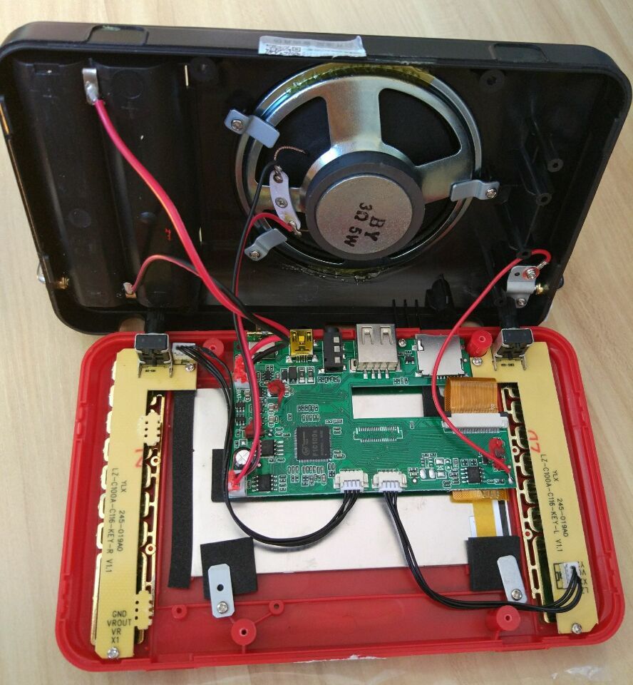

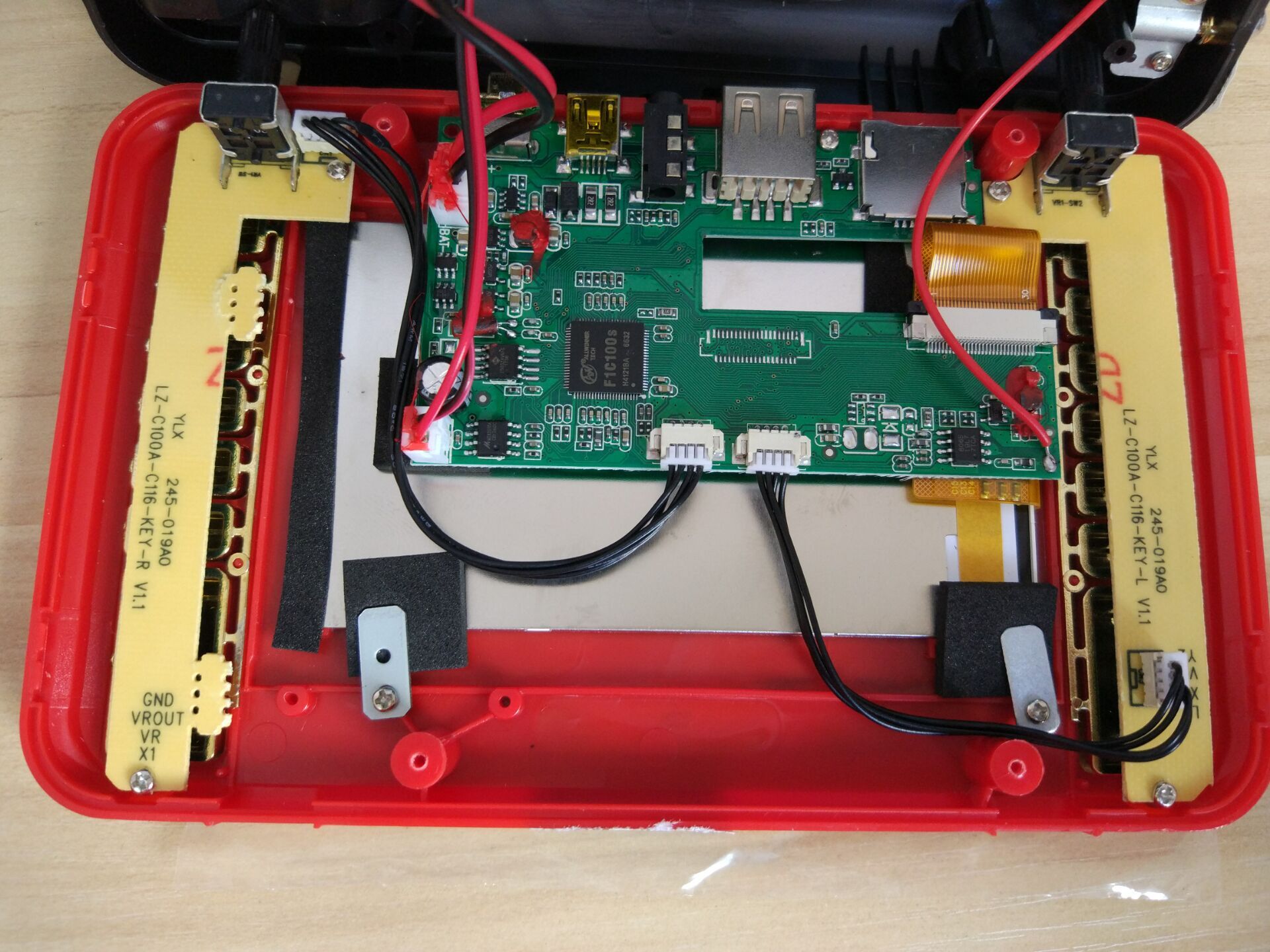

楼主 #4 2017-10-27 13:56:46
已发帖子: 9,444

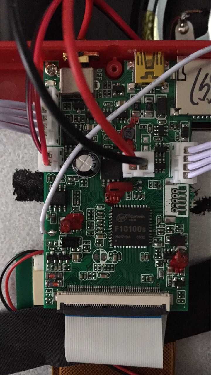

继续拆:

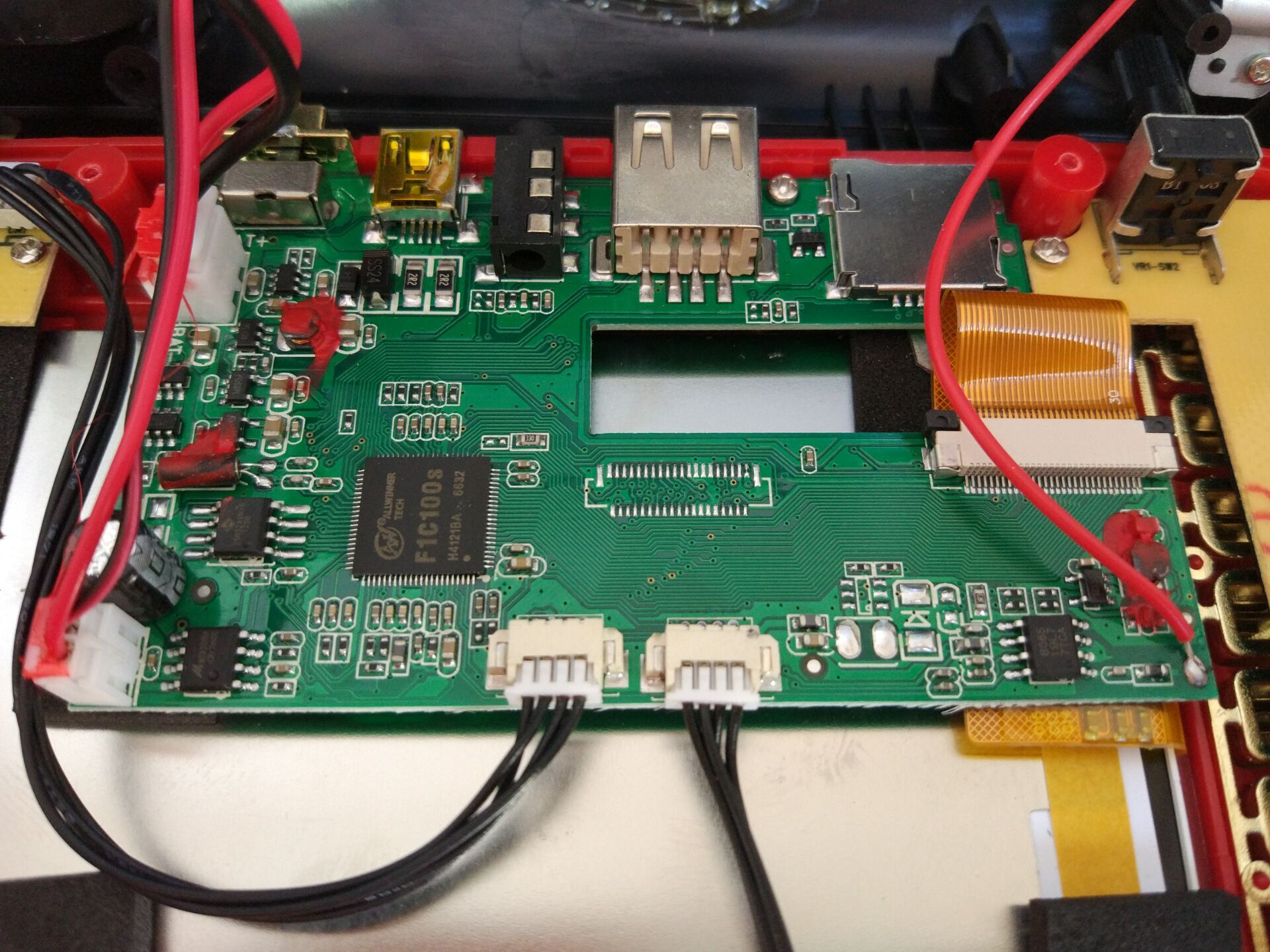

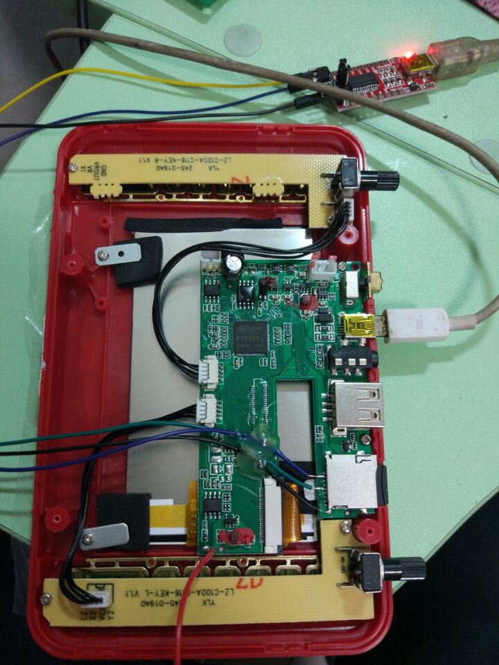

楼主 #5 2017-10-29 07:27:48
已发帖子: 9,444
接串口线:
BOOT0 is starting
DBG: init jtag OK
init dram , base        is 0x80000000
init dram , clk         is 156
init dram , access_mode is 1
init dram , cs_num      is 1
init dram , ddr8_remap  is 0
init dram , sdr_ddr     is 1
init dram , bwidth      is 16
init dram , col_width   is 10
init dram , row_width   is 13
init dram , bank_size   is 4
init dram , cas         is 3
init dram , size        is 0
dram init successed,size is 32
DBG: init heap OK, base address is 0x80000000, size is 0x00100000
DBG: load boot1 from spinor
DBG: init spinor OK
DBG: the size of BOOT1 is 71168
DBG: src_sum = 0x0x4dd22bba
DBG: sum = 0x0x4dd22bba
succeed in loading BOOT1
jump to BOOT1
DBG: boot1 starting!
DBG: init heap OK, base address is 0x80800000, size is 0x00100000
begin to init file system
DBG: init block device OK
DBG: init mini file system OK
DBG: mount c partition OK
0
jump to kernal
Mount Parts Thread running.....
\0partition [D] plug in..
\0Mount Parts Thread work now.....
\0.Start Shell from partion 'c'..................................................................................
\0Mount Parts Thread work end....
\0Execute startup script begin..............
\0Esh Error: \0OpenConfigFile y:\config\config.bin failed.
\01
\02
\03
\0.orange Installed and Openned!........................................................................................
\04
\0partition [E] plug in..
\05
\0.Desktop Installed and Openned!........................................................................................
\0...............Execute startup script end
\0Esh msg: \0shell main thread: Bye Bye!
\0pend event sem overtime!
\0*divider=7
\0b_interlace=0
\022212222 22222222 00222222
\0

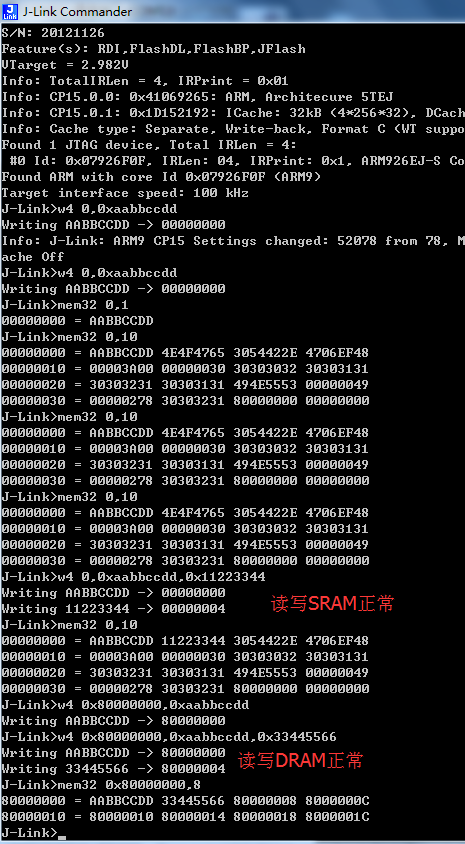

楼主 #6 2018-01-09 10:14:35
已发帖子: 9,444

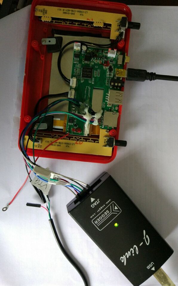

SEGGER J-Link Commander V4.96l ('?' for help)
Compiled Feb 25 2015 10:24:24
DLL version V4.96l, compiled Feb 25 2015 10:24:11
Firmware: J-Link ARM V8 compiled Nov 28 2014 13:44:46
Hardware: V8.00
S/N: 20121126
Feature(s): RDI,FlashDL,FlashBP,JFlash
VTarget = 2.982V
Info: TotalIRLen = 4, IRPrint = 0x01
Info: CP15.0.0: 0x41069265: ARM, Architecure 5TEJ
Info: CP15.0.1: 0x1D152192: ICache: 32kB (4*256*32), DCache: 16kB (4*128*32)
Info: Cache type: Separate, Write-back, Format C (WT supported)
Found 1 JTAG device, Total IRLen = 4:
#0 Id: 0x07926F0F, IRLen: 04, IRPrint: 0x1, ARM926EJ-S Core
Found ARM with core Id 0x07926F0F (ARM9)
Target interface speed: 100 kHz
J-Link>
JLINK连接成功!
楼主 #7 2018-01-09 12:02:16
已发帖子: 9,444
读写 SRAM, DRAM都正常。

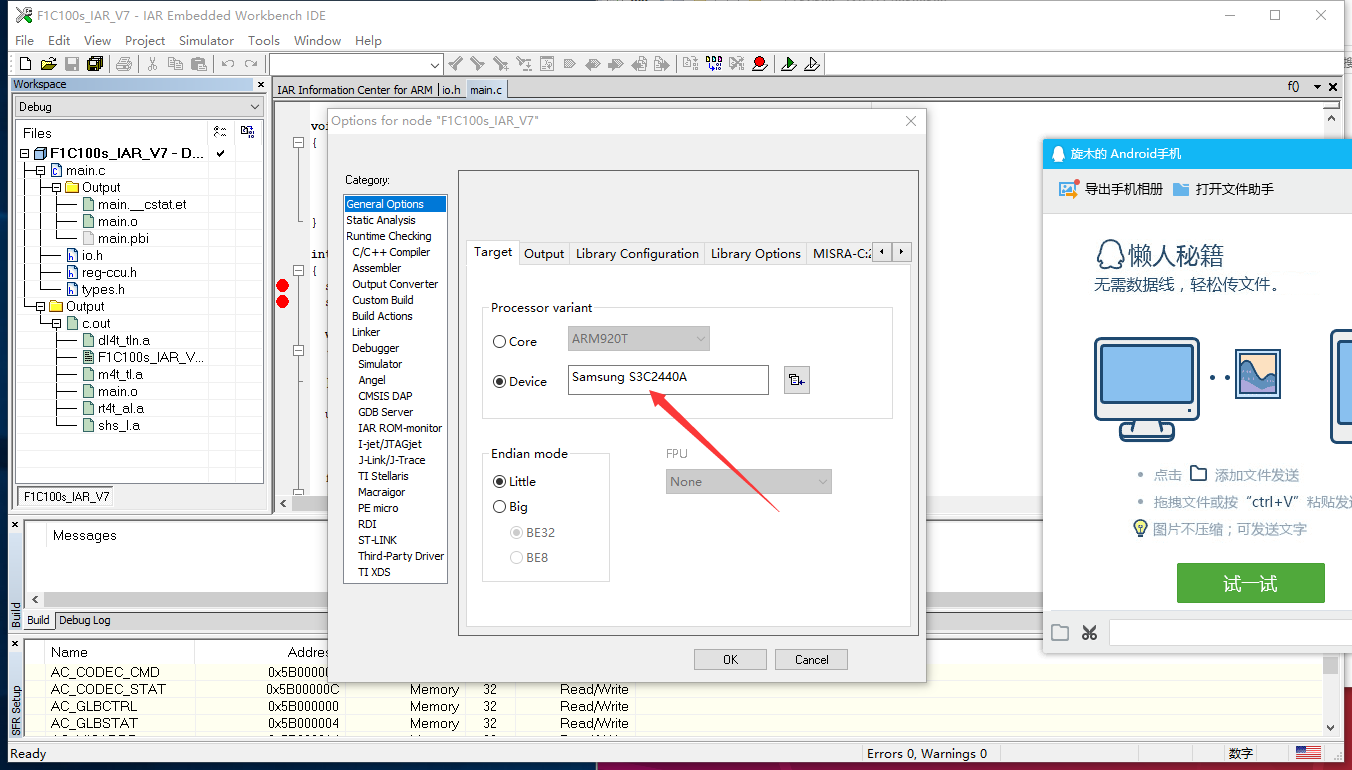

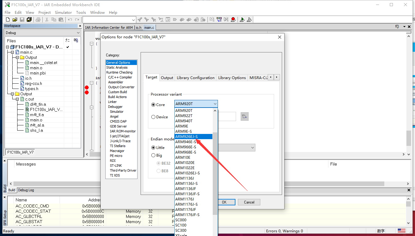

下载EWARM-CD-8201-14188.exe
再到csdn下载了 IAR7.x破解文件.rar 破解工具,
根据 IAR for ARM介绍、下载、安装与注册终于把IAR破解了。
IAR 7.4下载链接:EWARM-CD-7401-8472.exe
楼主 #9 2018-01-09 20:10:56
已发帖子: 9,444
f1c100s JLINK 单步调试OK
IAR7工程下载: F1C100s_IAR_V7_20180109.zip

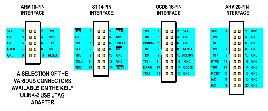

串口线和jlink的线接到板子哪里的?有标记吗?
楼主 #13 2018-01-17 11:05:17
已发帖子: 9,444
kgp0213 说:
参考链接: http://linux-sunxi.org/MicroSD_Breakout
Mapping
Pin    MicroSD    JTAG Connection    14-pin ARM JTAG Header    UART Connection    5-pin UART Header
1    Data2    TCK    9    nc    nc
2    CD/Data3    nc    nc    RX    2
3    Cmd    TDO    11    nc    nc
4    VDD    VTG    1,13    VDD    3
5    CLK    nc    nc    TX    1
6    VSS    GND     2,4,6,8,10,14    GND    4, 5
7    Data0    TDI    5    nc    nc
8    Data1    TMS    7    nc    nc
nc    nc    nTRST    3    nc    nc
nc    nc    nRESET    12    nc    nc
然后再谷歌找一张带引脚序号的TF卡封装图,对照标出UART和JTAG, 然后用杜邦线引出贴上标签纸。

大神,请教一个小问题啊,从你的jlink接线图片,看起来。SD的第三脚(白色线,JTAG定义是TDO)貌似是对应到jlink的13脚(JTAG定义是VDD)上去了呀,而按照资料来看,这根白色线应该是接到11脚的呢,
现在我碰到的问题是,SD的第三脚接到jlink的11脚,jlink.exe无法读取到任何设备啊。。。是应该按照 你的接法去连接吗?
楼主 #19 2018-01-22 14:31:32
已发帖子: 9,444
没错, 13p就是 TDO

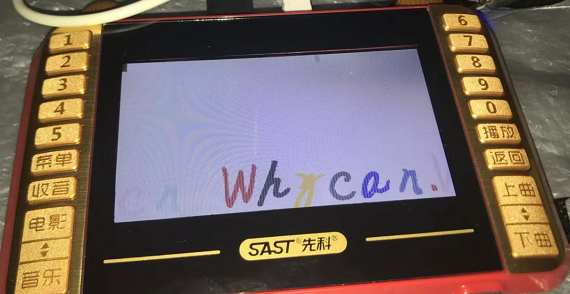

楼主 #24 2018-02-01 20:37:38
已发帖子: 9,444

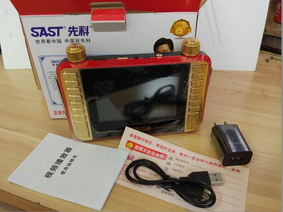

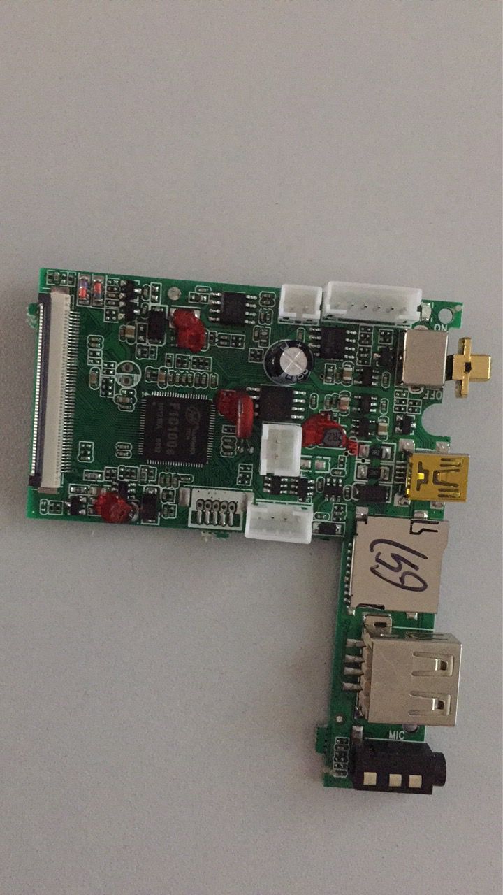

这是挖坑网网友 @www220 买到的炬力方案唱戏机,
下面是 @www220 在Q群的聊天记录:
都是一个牌子,一批和一批芯片用的不一样,仅有的兴趣折腾没了,不玩了.
能找到外包装的话,记录一个型号,我买的KK-131不行
#26 2018-03-26 13:40:56
www220
注册时间: 2018-02-09
已发帖子: 46
积分: 46
希望晕神,找到外包装,给一个能用的版本
楼主 #27 2018-04-23 17:39:39
已发帖子: 9,444
这是xboot的设备树文件: sast-kk131.c
也是 kk-131型号,说明这家公司产品型号命名是比较混乱的。

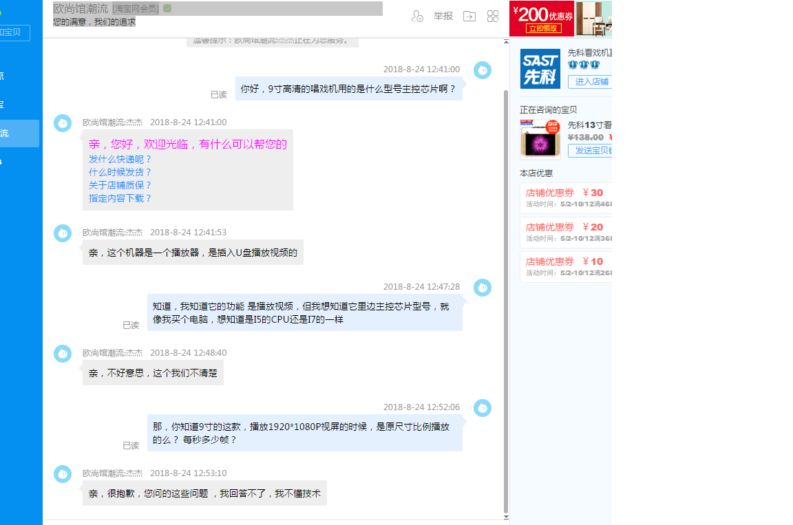

晕哥,发现坑越来越深哦,从网上查唱戏机方案,貌似除了炬力的,还有瑞芯微的。。。
我把这个工程下载下来了,为什么使用的是S3C2440A(926T),不应该使用的是926的内核么
楼主 #63 2019-04-09 13:46:01
已发帖子: 9,444
因为内核接近,指令集兼容,所以这样也不会出错,最好还是按你上面的选择。

折腾了20天,终于摸到门边了,用 https://whycan.cn/t_2689.html   的 suniv_f1c100s_w25q128_usb_lcd_ok_20190722.7z 能看到显示屏有显示 但分辨率不对,还有就是终端好像输出错误,串口是用UART0 PE0 PE1脚,即是收音机芯片的那两个数据管脚。

老哥们 唱戏机的屏幕背光用的是哪个引脚,用nano的固件改成480*272的分辨率,nano点唱戏机的屏,是可以显示的。现在换回唱戏机主板点唱戏机,屏幕不亮,不知道背光是哪个脚?4.3寸唱戏机,跟晕哥这个是一样的。
#72 2019-09-25 09:31:31
我思故我在
注册时间: 2019-09-03
已发帖子: 244
积分: 243.5
找到背光芯片, 顺藤摸瓜找到背光芯片的控制引脚, 这时有两个选择:
1. 用万用表量出与 f1c100s 连接的引脚.
2. 直接飞线上拉或者下拉引脚控制引脚。
#73 2019-09-25 12:02:22

背光芯片找到了,没找到资料,万用表也没量出引脚,
夏新唱戏机,4.3寸,rgb 40PIN。没人玩吗?
@明月心惜 最近买的吗?求购买链接
背光芯片就那么几个, 看下是什么封装的, 帮你猜一下

firstman 说:
@明月心惜 最近买的吗?求购买链接
【夏新M-185 4.3寸看戏机老人唱戏机听戏收音机老年高清视频播放器】 https://m.tb.cn/h.eNYNskN?sm=04b88c  点击链接,再选择浏览器咑閞;或椱ァ製这段描述$p6sWYnIdSuC$后到?◇綯℡寳?
18年11月买的,现在还在卖。40PIN最近那个sot-23-6就是驱动,丝印BIBHF6,引脚找到了,PE12,但是使能逻辑可能和nano(低电平)不一样,所以点不亮,我再试试。

MT9284?

明月心惜 说:
https://whycan.cn/files/members/1082/IMG_20190925_214430.jpeg
唱戏机的背光控制 一般是PWM  因为要控制背光的亮度   C100S PWM 只有两个 PE6   PE12        分辨对应的是 PIN 37   PIN43
Jin劲 说:
agnd 说:
晕啊,买了拆了还能退么?
据说热风枪 吹保修标签可以完整撕下     (逃
可以在tf卡位置怼一下jlink看一下芯片么
http://linux-sunxi.org/images/thumb/0/05/JTAG_MicroSD_UART-front.jpeg/180px-JTAG_MicroSD_UART-front.jpeg
哪里可以搞到这个tf转接板
myxiaonia 说:
Jin劲 说:
哪里可以搞到这个tf转接板
设计一片 SD NAND + JTAG(全志soc) 转接板
http://whycan.com/t_2025.html
