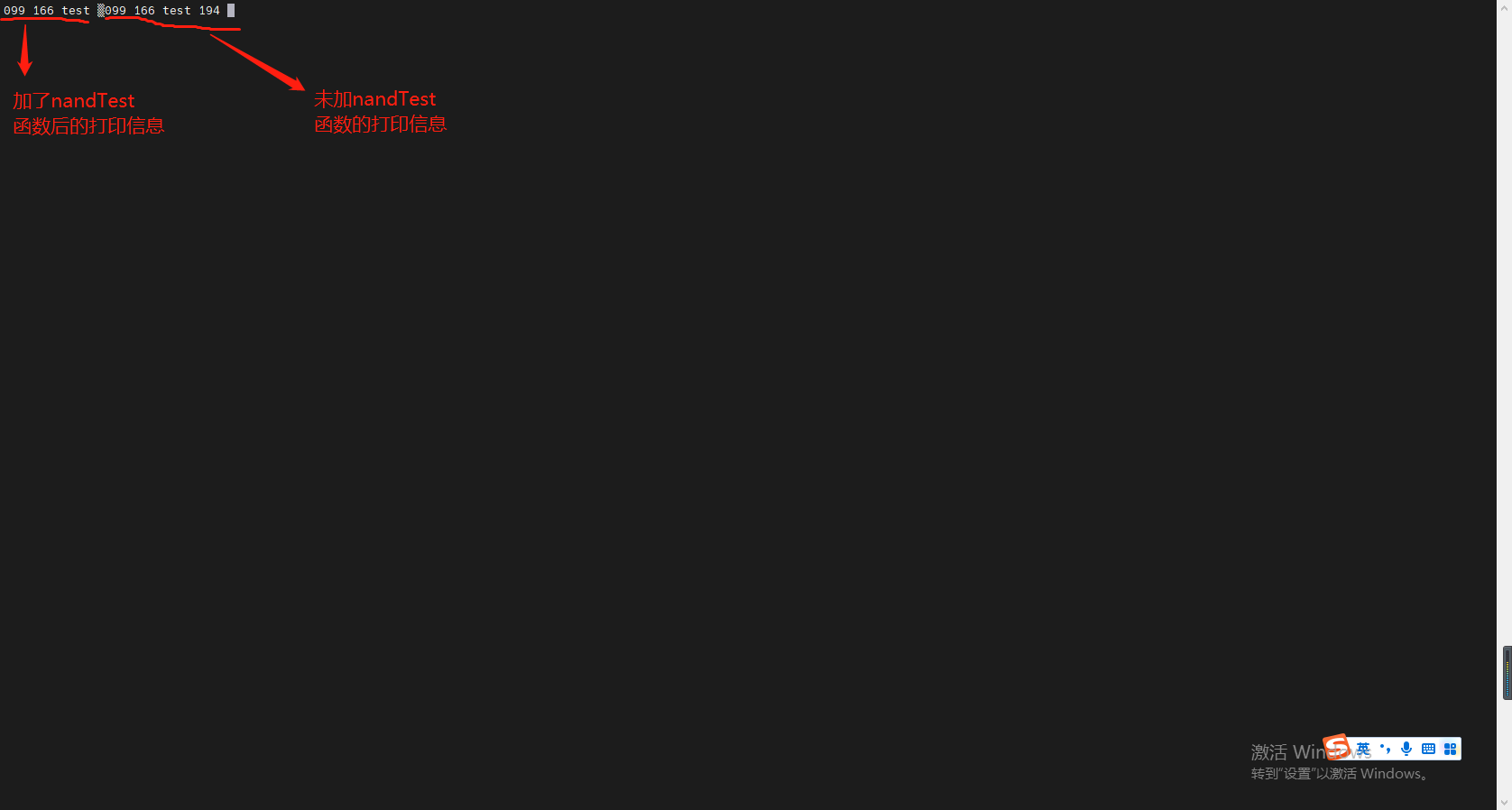

Re: XFEL已支持spi nand flash烧写
@xboot
大佬,用sudo xfel spinand write 0 xboot.bin命令和sudo xfel spinand splwrite 2048 1048576 xboot.bin烧程序进nand flash,
烧成功了,但是都没有启动起来,都是直接进了fel下载模式,用sunxi-fel -p spiflash-write 0 xboot.bin命令也是一样的;用xfel spinand命令也检测到了nand flash的型号和容量,读bin数据出来对比也是完全一样,是还有哪里没操作对吗?
用的nand是华邦的W25N01GV,soc是f1c100s;
最近编辑记录 岁月快快快 (2022-01-14 20:06:16)
#36 2022-01-14 17:17:29
岁月快快快
注册时间: 2021-12-25
已发帖子: 61
积分: 67
编译bin文件出来的log提示:The bootloader head has been fixed, spl size is 16384 bytes, 我把split-size改成16384也还是不行:
sudo xfel spinand splwrite 16384 1048576 xboot.bin

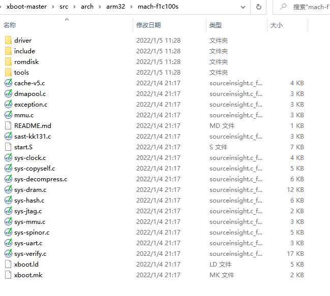

f1c100s目录里面没有sys-spinand.c,感觉可能跟这个有关,加上去再试一下

2048 改成1024,就不进fel下载模式了,但是遇到了个奇怪的问题:
sys-copyself.c:
void test(void)
    sys_uart_putc('t');
    sys_uart_putc('e');
    sys_uart_putc('s');
    sys_uart_putc('t');
    sys_uart_putc(' ');
else if(d == BOOT_DEVICE_SPINAND)
	struct zdesc_t * z = (struct zdesc_t *)__heap_start;
	void * mem = (void *)__image_start;
	void * tmp = (void *)z + sizeof(struct zdesc_t);
	uint32_t size = __image_end - __image_start;
        //mprintf("enter BOOT_DEVICE_SPINAND !");
        sys_uart_putc('1');
        sys_uart_putc('6');
        sys_uart_putc('6');
        sys_uart_putc(' ');
        #if 0
	sys_spinand_init();
	sys_spinand_read(1048576 + 65536, z, sizeof(struct zdesc_t));
	sys_spinand_exit();
	if((z->magic[0] == 'Z') && (z->magic[1] == 'B') && (z->magic[2] == 'L') && (z->magic[3] == '!'))
		//if(sys_verify((char *)z->pubkey, (char *)z->sha256, (char *)z->signature))
			uint32_t csize = (z->csize[0] << 24) | (z->csize[1] << 16) | (z->csize[2] << 8) | (z->csize[3] << 0);
			uint32_t dsize = (z->dsize[0] << 24) | (z->dsize[1] << 16) | (z->dsize[2] << 8) | (z->dsize[3] << 0);
			sys_spinand_init();
			sys_spinand_read(1048576 + 65536 + sizeof(struct zdesc_t), tmp, csize);
			sys_spinand_exit();
			//if(sys_hash((char *)(&z->majoy), (sizeof(struct zdesc_t) - 100) + csize, (char *)z->sha256))
				sys_decompress(tmp, csize, mem, dsize);
	else
	    //mprintf("enter line180 !");
	    test();
            nandTest();
            sys_uart_putc('1');
            sys_uart_putc('9');
            sys_uart_putc('4');
            sys_uart_putc(' ');
            nandTest();
	    sys_spinand_init();
	    spinand_read(1048576, mem, size);
	    spinand_exit();
else if(d == BOOT_DEVICE_SDCARD)
sys-spinand.c:
void nandTest(void)
sys-copyself.c自拷贝函数中如果调用了sys-spinand.c中的函数就会导致程序像挂掉一样;
测试代码中test()函数之后调用sys-spinand.c中的空函数nandTest(),后面的打印信息“194”就打不出来了,如果不调用nandTest(),就可以正常的打印出
“194”;把测试代码去掉,在sys_spinand_init()函数最开始的地方加上的打印信息,也没有打印出来,所以我推断调了sys-spinand.c中的函数之后程序就挂掉了,没有拷贝成功;
打印信息:
把spi部分的代码全部搬到sys-copyself.c中,就可以正常启动了
lol
不过启动速度有点慢,用了将近5秒才起来,有什么优化办法吗,还是说nand启动就是这么慢的

贴一段之前的总结:
不是对齐问题,这种sys-开头的文件,是需要用特别的编程手段的,因为这些程序的链接地址都是在DDR中,而实际运行地址是在SRAM中,需要实现成地址无关的程序,而系统刚启动,什么环境都不具备,C执行环境,更是不完整的,所以只能用特别编程手段。
一般有一下注意点:
1,不要使用已初始化数据段
2,不要使用未初始化数据段
3,不要使用switch case语句,可以用if elseif 代替
4,不要使用全局变量,仅使用局部变量
5,局部变量的初始化,用代码实现,会编译成立即数赋值
6,只能使用栈空间,其他什么都不可以使用
7,不要调用任何外部库,比如工具链里的C库等。
只要按这种要求,编程,编译出来的代码,都是地址无关的,SPL代码是很特殊的,谨记运行地址不是链接地址,就明白为何需要这样处理了。
当然,这种限制,也导致编程要求较高,如果不想挑战自己,就链接两次,做两个程序吧,BL1->BL2,这种,你看某些芯片的引导链,那么长,就是因为这种原因。
独立的一个程序,支持引导,自举,换到DDR空间,要求是很高的。这种编程技巧,算挑战性编程。

你的代码需要拷贝到sys-copyself.c里,大概率是链接脚本没修改正确。添加一下就可以解决你的问题了。
	.text :
		PROVIDE(__image_start = .);
		PROVIDE(__text_start = .);
		PROVIDE(__spl_start = .);
		.obj/arch/arm32/mach-f1c100s/start.o (.text*)
		.obj/arch/arm32/lib/memcpy.o (.text*)
		.obj/arch/arm32/lib/memset.o (.text*)
		.obj/arch/arm32/mach-f1c100s/sys-jtag.o (.text*)
		.obj/arch/arm32/mach-f1c100s/sys-uart.o (.text*)
		.obj/arch/arm32/mach-f1c100s/sys-clock.o (.text*)
		.obj/arch/arm32/mach-f1c100s/sys-dram.o (.text*)
		.obj/arch/arm32/mach-f1c100s/sys-mmu.o (.text*)
		.obj/arch/arm32/mach-f1c100s/sys-decompress.o (.text*)
		.obj/arch/arm32/mach-f1c100s/sys-hash.o (.text*)
		.obj/arch/arm32/mach-f1c100s/sys-verify.o (.text*)
		.obj/arch/arm32/mach-f1c100s/sys-spinor.o (.text*)
		.obj/arch/arm32/mach-f1c100s/sys-copyself.o (.text*)
		PROVIDE(__spl_end = .);
		*(.text*)
		*(.init.text)
		*(.exit.text)
		*(.glue*)
		*(.note.gnu.build-id)
		PROVIDE(__text_end = .);
	} > ram
