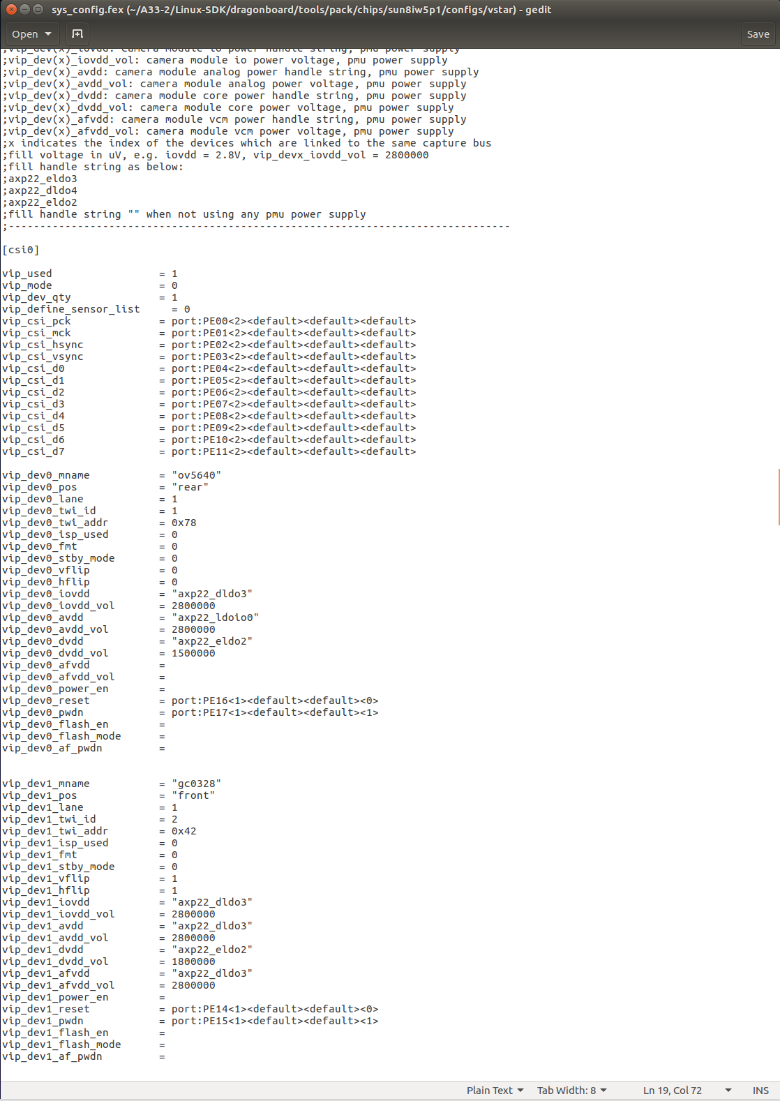

晕哥,使用BSP内核,选通了ov5640。然后也更改了fex。
[csi1]
vip_used                 = 1
vip_mode                 = 0
vip_dev_qty              = 1
vip_define_sensor_list   = 0
vip_csi_pck              = port:PE00<2><default><default><default>
vip_csi_mck              = port:PE01<2><default><default><default>
vip_csi_hsync            = port:PE02<2><default><default><default>
vip_csi_vsync            = port:PE03<2><default><default><default>
vip_csi_d0               = port:PE04<2><default><default><default>
vip_csi_d1               = port:PE05<2><default><default><default>
vip_csi_d2               = port:PE06<2><default><default><default>
vip_csi_d3               = port:PE07<2><default><default><default>
vip_csi_d4               = port:PE08<2><default><default><default>
vip_csi_d5               = port:PE09<2><default><default><default>
vip_csi_d6               = port:PE10<2><default><default><default>
vip_csi_d7               = port:PE11<2><default><default><default>
vip_csi_d8               = port:PE12<2><default><default><default>
;vip_csi_d9               = port:PE13<2><default><default><default>
vip_csi_d10               = port:PE14<2><default><default><default>
vip_csi_d11               = port:PE15<2><default><default><default>
vip_csi_sck               = port:PE21<2><default><default><default>
vip_csi_sda               = port:PE22<2><default><default><default>
vip_dev0_mname           = "ov5640"
vip_dev0_pos             = "front"
vip_dev0_twi_id          = 4
vip_dev0_twi_addr        = 0x78
vip_dev0_isp_used        = 0
vip_dev0_fmt             = 0
vip_dev0_stby_mode       = 0
vip_dev0_vflip           = 0
vip_dev0_hflip           = 0
vip_dev0_iovdd           = ""
vip_dev0_iovdd_vol       = 2800000
vip_dev0_avdd            = ""
vip_dev0_avdd_vol        = 2800000
vip_dev0_dvdd            = ""
vip_dev0_dvdd_vol        = 1500000
vip_dev0_afvdd           = ""
vip_dev0_afvdd_vol       = 2800000
vip_dev0_power_en        =
vip_dev0_reset           = port:PE23<1><default><default><default>
vip_dev0_pwdn            = port:PE24<1><default><default><default>
vip_dev0_flash_en        =
vip_dev0_flash_mode      =
vip_dev0_af_pwdn         =
vip_dev0_act_used        = 0
vip_dev0_act_name        = "ad5820_act"
vip_dev0_act_slave       = 0x18
vip_dev1_mname           = "gc2035"
vip_dev1_pos                 = "front"
vip_dev1_lane            = 1
vip_dev1_twi_id          = 4
vip_dev1_twi_addr        = 0x78
vip_dev1_isp_used        = 0
vip_dev1_fmt             = 1
vip_dev1_stby_mode       = 0
vip_dev1_vflip           = 0
vip_dev1_hflip           = 0
vip_dev1_iovdd           = ""
vip_dev1_iovdd_vol       = 2800000
vip_dev1_avdd            = ""
vip_dev1_avdd_vol        = 2800000
vip_dev1_dvdd            = ""
vip_dev1_dvdd_vol        = 1500000
vip_dev1_afvdd           = ""
vip_dev1_afvdd_vol       = 2800000
vip_dev1_power_en        =
vip_dev1_reset           =
vip_dev1_pwdn            =
vip_dev1_flash_en        =
vip_dev1_flash_mode      =
vip_dev1_af_pwdn         =

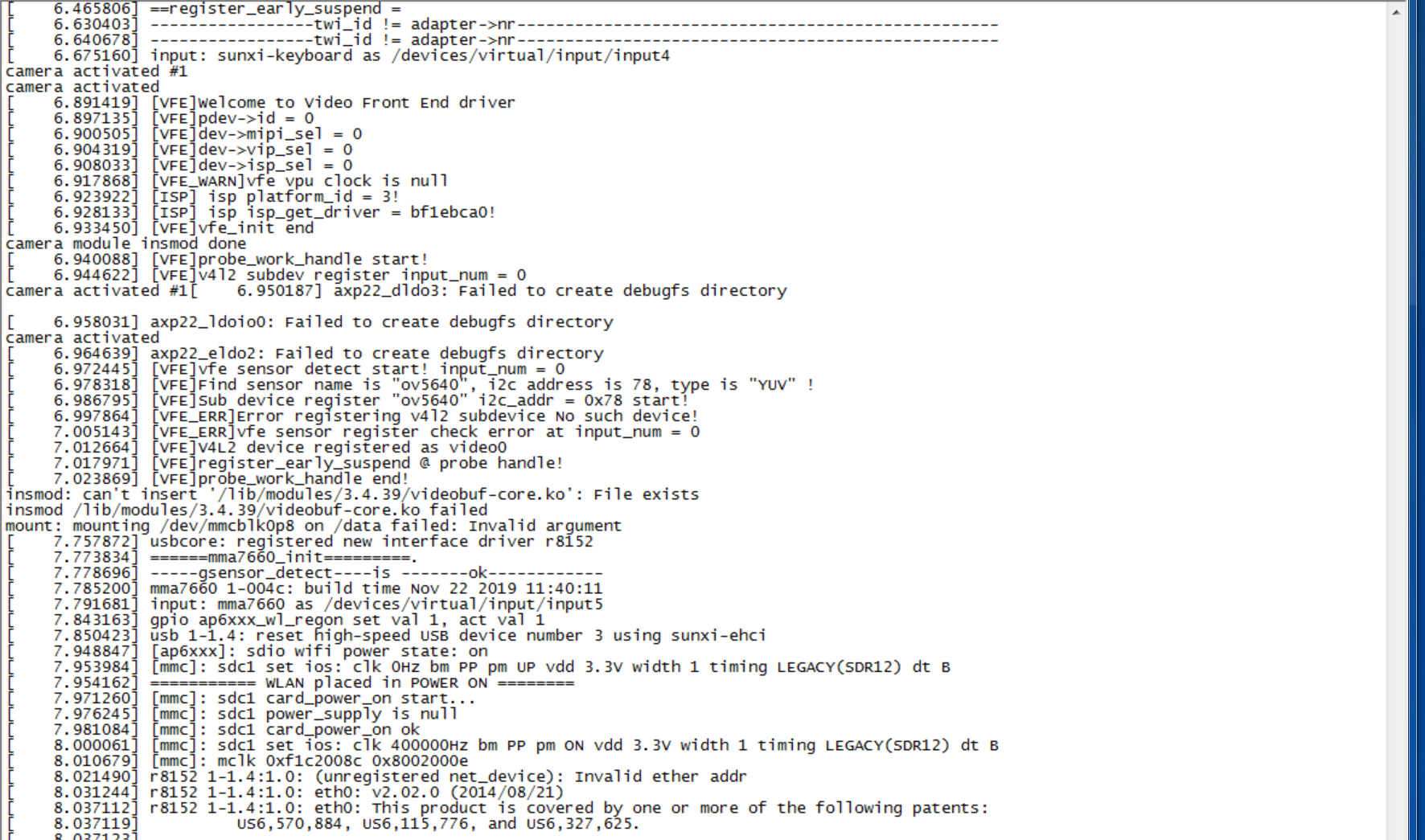

可是在用fswebcam拍照时
# fswebcam -S 10 -d /dev/video1 -p YUV420P -r 640x480 test21.jpg
[   26.003939] [VFE]vfe_open
--- Opening /dev/video1...
[   26.007092] [VFE]..........................vfe clk open!.......................
Trying source module v4l2...[   26.018941] [VFE]vfe_open ok
/dev/video1 opened.
[   26.024950] [VFE_ERR]input index(0) > dev->dev_qty(1)-1 invalid!, device_valid_flag[0] = 0
No input was specified, usin[   26.037247] [VFE]vfe_close
g the first.
Unable to[   26.042806] [VFE]vfe select input flag = 0, s_input have not be used .
 query input 0.
VIDIOC[   26.053040] [VFE]..........................vfe clk close!.......................
_ENUMINPUT: Invalid argument
   26.064499] [VFE]vfe_close end
0m#
# i2cd
i2cdetect  i2cdump
# i2cd
i2cdetect  i2cdump
# i2cdetect -l
i2cdetect: can't open '/sys/class/i2c-dev': No such file or directory
# i2cdetect -y 1
i2cdetect: can't open '/dev/i2c/1': No such file or directory
# ls
这是什么原因呢

主要是这个错误
[ 33.650171] [VFE]vfe_open
Trying source module v4l2...[ 33.656150] [VFE]..........................vfe clk open!.......................
[ 33.667840] [VFE]vfe_open ok
[ 33.671467] [VFE_ERR]input index(0) > dev->dev_qty(1)-1 invalid!, device_valid_flag[0] = 0
/dev/video1 opened.
No [ 33.681675] [VFE]vfe_close
input was specified, using the f[ 33.686958] [VFE]vfe select input flag = 0, s_input have not be used .
irst.
Unable to query [ 33.697235] [VFE]..........................vfe clk close!.......................
input 0.
VIDIOC_ENUMIN[ 33.708530] [VFE]vfe_close end
不知道这个是什么造成的

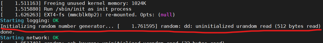

折腾了两天,终于能显示png了。。。
确实在buildroot里面勾上 png相关支持就可以了,然后要删除掉qt5目录内的.stamp_built .stamp_configured 。
刚开始我没删掉这些,生成的根文件系统还是不支持显示png
感觉自己蠢哭了。。。

大家好!!請教各位大佬!! 本人用A33-Vstar開發板,想选通ov5640,但出現以下問題.
同sys_config.fex setting
開啟
--- I2C support
[x] I2C device interface
#262 2019-11-22 15:49:13
已发帖子: 9,505
Re: 荔枝派Zero V3s开发板入坑记录 (TF/SD卡启动)(主线Linux,主线u-boot)
最前面 axp22_dldo3 创建 debugfs 出错了, 有没有影响?

改為以下. 但都出現問題
vip_dev0_iovdd = ""
vip_dev0_avdd = ""
vip_dev0_dvdd = ""

超级萌新 wrote:
用逻辑分析仪抓 i2c 和 camera 的数据,看有什么情况
我發現 DOVDD-CSI 無 2.8V, AVDD-CSI 無 2.8V, DVDD18V-CSI 無1.8V, 是什麼原因?
#266 2019-11-25 17:33:36
已发帖子: 9,505
电源有问题

是否關 axp22_dldo3 创建 debugfs 出错了問題?
#268 2019-11-25 18:14:00
已发帖子: 9,505
不排除, 有可能的.

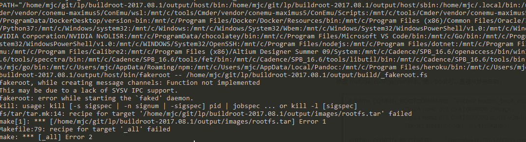

我用win10的subsystem编译出现了这个错误,似乎是wsl内部IPC实现的问题
一会儿换用doker编译看看,可以的话我上传个编译用的docker镜像
fakeroot, while creating message channels: Function not implemented This may be due to a lack of SYSV IPC support. fakeroot: error while starting the `faked' daemon.

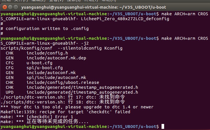

编译uboot出现上面的错误,在下小白,刚入手荔枝派ZERO,请教晕哥
#287 2020-03-09 08:31:23
已发帖子: 9,505
sudo apt-get install device-tree-compiler
提示缺啥装啥就行
提示缺啥装啥就行
@mcu1234mcu
搞定了,谢谢
