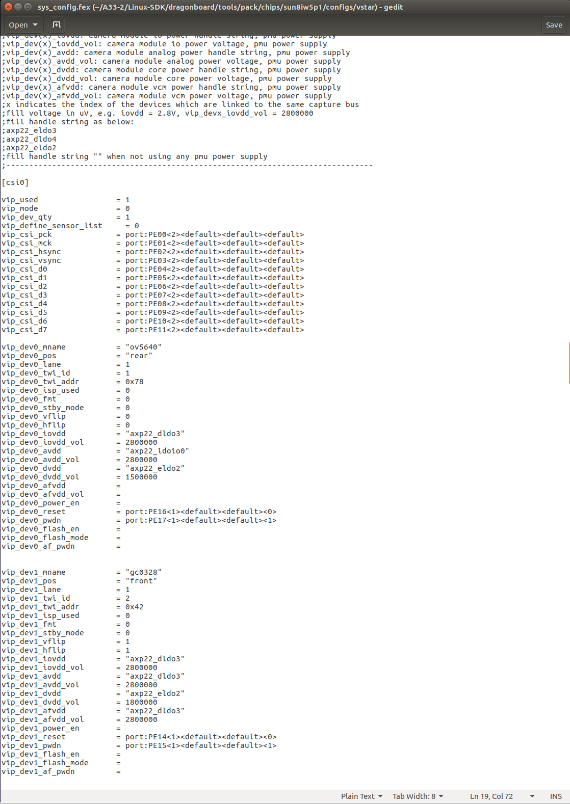

晕哥,使用BSP内核,选通了ov5640。然后也更改了fex。
[csi1]
vip_used                 = 1
vip_mode                 = 0
vip_dev_qty              = 1
vip_define_sensor_list   = 0
vip_csi_pck              = port:PE00<2><default><default><default>
vip_csi_mck              = port:PE01<2><default><default><default>
vip_csi_hsync            = port:PE02<2><default><default><default>
vip_csi_vsync            = port:PE03<2><default><default><default>
vip_csi_d0               = port:PE04<2><default><default><default>
vip_csi_d1               = port:PE05<2><default><default><default>
vip_csi_d2               = port:PE06<2><default><default><default>
vip_csi_d3               = port:PE07<2><default><default><default>
vip_csi_d4               = port:PE08<2><default><default><default>
vip_csi_d5               = port:PE09<2><default><default><default>
vip_csi_d6               = port:PE10<2><default><default><default>
vip_csi_d7               = port:PE11<2><default><default><default>
vip_csi_d8               = port:PE12<2><default><default><default>
;vip_csi_d9               = port:PE13<2><default><default><default>
vip_csi_d10               = port:PE14<2><default><default><default>
vip_csi_d11               = port:PE15<2><default><default><default>
vip_csi_sck               = port:PE21<2><default><default><default>
vip_csi_sda               = port:PE22<2><default><default><default>
vip_dev0_mname           = "ov5640"
vip_dev0_pos             = "front"
vip_dev0_twi_id          = 4
vip_dev0_twi_addr        = 0x78
vip_dev0_isp_used        = 0
vip_dev0_fmt             = 0
vip_dev0_stby_mode       = 0
vip_dev0_vflip           = 0
vip_dev0_hflip           = 0
vip_dev0_iovdd           = ""
vip_dev0_iovdd_vol       = 2800000
vip_dev0_avdd            = ""
vip_dev0_avdd_vol        = 2800000
vip_dev0_dvdd            = ""
vip_dev0_dvdd_vol        = 1500000
vip_dev0_afvdd           = ""
vip_dev0_afvdd_vol       = 2800000
vip_dev0_power_en        =
vip_dev0_reset           = port:PE23<1><default><default><default>
vip_dev0_pwdn            = port:PE24<1><default><default><default>
vip_dev0_flash_en        =
vip_dev0_flash_mode      =
vip_dev0_af_pwdn         =
vip_dev0_act_used        = 0
vip_dev0_act_name        = "ad5820_act"
vip_dev0_act_slave       = 0x18
vip_dev1_mname           = "gc2035"
vip_dev1_pos                 = "front"
vip_dev1_lane            = 1
vip_dev1_twi_id          = 4
vip_dev1_twi_addr        = 0x78
vip_dev1_isp_used        = 0
vip_dev1_fmt             = 1
vip_dev1_stby_mode       = 0
vip_dev1_vflip           = 0
vip_dev1_hflip           = 0
vip_dev1_iovdd           = ""
vip_dev1_iovdd_vol       = 2800000
vip_dev1_avdd            = ""
vip_dev1_avdd_vol        = 2800000
vip_dev1_dvdd            = ""
vip_dev1_dvdd_vol        = 1500000
vip_dev1_afvdd           = ""
vip_dev1_afvdd_vol       = 2800000
vip_dev1_power_en        =
vip_dev1_reset           =
vip_dev1_pwdn            =
vip_dev1_flash_en        =
vip_dev1_flash_mode      =
vip_dev1_af_pwdn         =

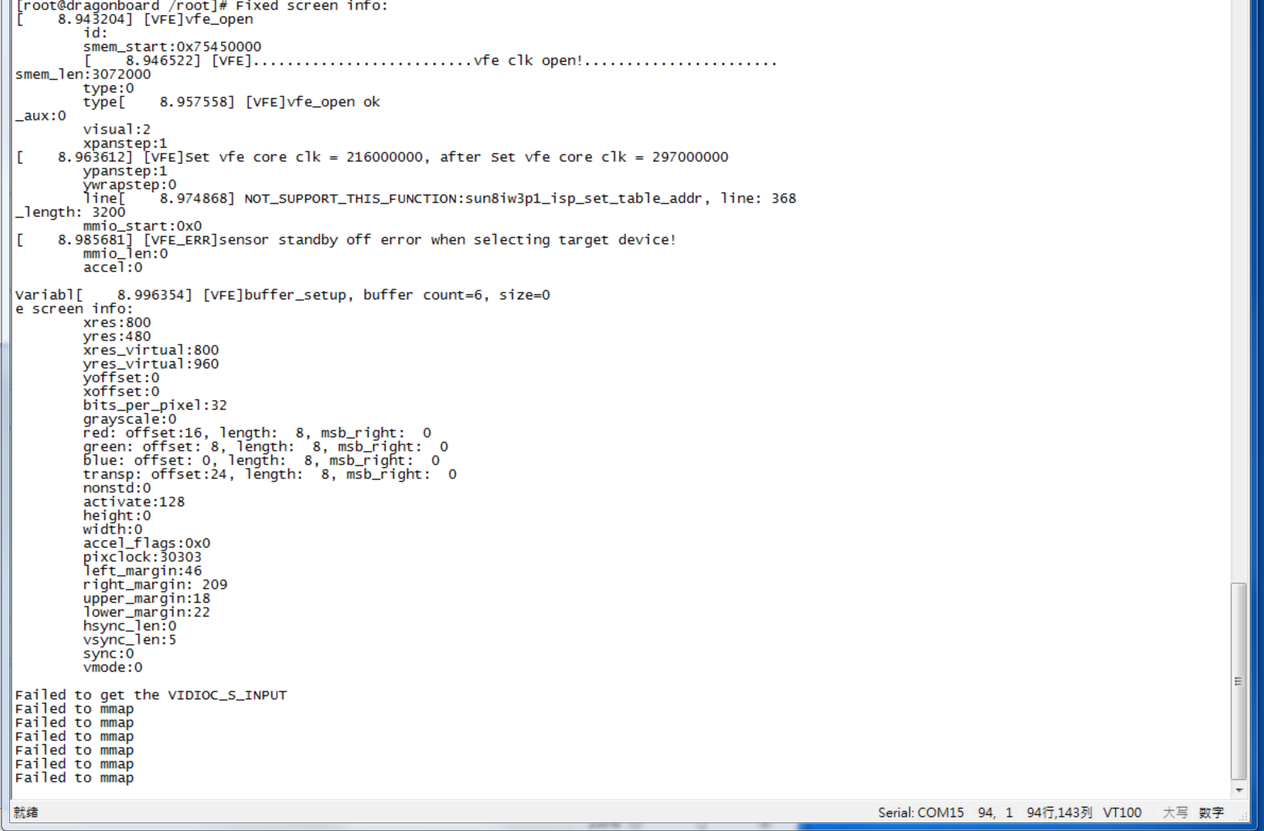

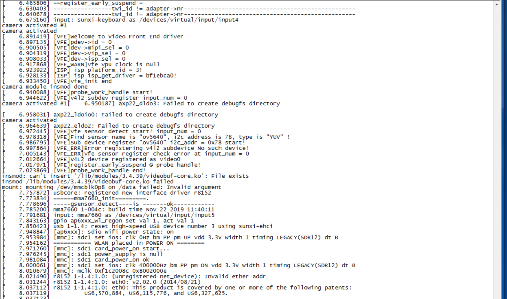

可是在用fswebcam拍照时
# fswebcam -S 10 -d /dev/video1 -p YUV420P -r 640x480 test21.jpg
[   26.003939] [VFE]vfe_open
--- Opening /dev/video1...
[   26.007092] [VFE]..........................vfe clk open!.......................
Trying source module v4l2...[   26.018941] [VFE]vfe_open ok
/dev/video1 opened.
[   26.024950] [VFE_ERR]input index(0) > dev->dev_qty(1)-1 invalid!, device_valid_flag[0] = 0
No input was specified, usin[   26.037247] [VFE]vfe_close
g the first.
Unable to[   26.042806] [VFE]vfe select input flag = 0, s_input have not be used .
 query input 0.
VIDIOC[   26.053040] [VFE]..........................vfe clk close!.......................
_ENUMINPUT: Invalid argument
   26.064499] [VFE]vfe_close end
0m#
# i2cd
i2cdetect  i2cdump
# i2cd
i2cdetect  i2cdump
# i2cdetect -l
i2cdetect: can't open '/sys/class/i2c-dev': No such file or directory
# i2cdetect -y 1
i2cdetect: can't open '/dev/i2c/1': No such file or directory
# ls
这是什么原因呢

主要是这个错误
[ 33.650171] [VFE]vfe_open
Trying source module v4l2...[ 33.656150] [VFE]..........................vfe clk open!.......................
[ 33.667840] [VFE]vfe_open ok
[ 33.671467] [VFE_ERR]input index(0) > dev->dev_qty(1)-1 invalid!, device_valid_flag[0] = 0
/dev/video1 opened.
No [ 33.681675] [VFE]vfe_close
input was specified, using the f[ 33.686958] [VFE]vfe select input flag = 0, s_input have not be used .
irst.
Unable to query [ 33.697235] [VFE]..........................vfe clk close!.......................
input 0.
VIDIOC_ENUMIN[ 33.708530] [VFE]vfe_close end
不知道这个是什么造成的

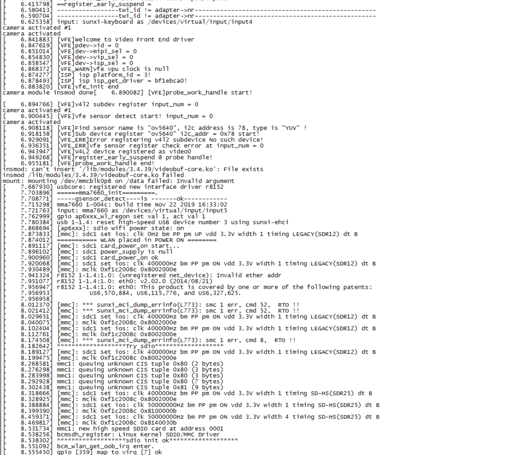

[    0.000000] Linux version 3.4.39 (he@he) (gcc version 4.8.3 20140320 (prerelease) (Sourcery CodeBench Lite 2014.05-29) ) #37 Wed May 15 11:39:13 CST 2019
[    0.000000] Kernel command line: console=ttyS0,115200 panic=5 rootwait root=/dev/mmcblk0p2 earlyprintk rw
[    0.000000] Memory: 29176k/29176k available, 36360k reserved, 0K highmem
[    0.000000]       .text : 0xc0008000 - 0xc052b000   (5260 kB)
[    0.000000]       .init : 0xc052b000 - 0xc054f000   ( 144 kB)
[    0.000000]       .data : 0xc0550000 - 0xc05cd490   ( 502 kB)
[    0.000000]        .bss : 0xc05cd4b4 - 0xc06ae354   ( 900 kB)
[    0.000000] NR_IRQS:544
[    0.000148] Calibrating delay loop (skipped), value calculated using timer frequency.. 4800.00 BogoMIPS (lpj=24000000)
[    0.000168] pid_max: default: 32768 minimum: 301
[    0.000312] Mount-cache hash table entries: 512
[    0.000870] CPU: Testing write buffer coherency: ok
[    0.001132] Setting up static identity map for 0x403aa208 - 0x403aa260
[    0.001816] devtmpfs: initialized
[    0.003522] pinctrl core: initialized pinctrl subsystem
[    0.004012] NET: Registered protocol family 16
[    0.004320] DMA: preallocated 128 KiB pool for atomic coherent allocations
[    0.004380] script_sysfs_init success
[    0.005154] gpiochip_add: registered GPIOs 0 to 223 on device: sunxi-pinctrl
[    0.006059] sunxi-pinctrl sunxi-pinctrl: initialized sunXi PIO driver
[    0.006427] gpiochip_add: registered GPIOs 1024 to 1031 on device: axp-pinctrl
[    0.007202] persistent_ram: found existing buffer, size 21180, start 21180
[    0.101129] console [ram-1] enabled
[    0.102061] Not Found clk pll_isp in script
[    0.102194] Not Found clk pll_video in script
[    0.102422] Not Found clk pll_ve in script
[    0.102544] Not Found clk pll_periph0 in script
[    0.102665] Not Found clk pll_de in script
[    0.107130] bio: create slab <bio-0> at 0
[    0.107512] pwm module init!
[    0.109723] SCSI subsystem initialized
[    0.110225] usbcore: registered new interface driver usbfs
[    0.110433] usbcore: registered new interface driver hub
[    0.110801] usbcore: registered new device driver usb
[    0.111097] twi_chan_cfg()340 - [twi0] has no twi_regulator.
[    0.111227] twi_chan_cfg()340 - [twi1] has no twi_regulator.
[    0.111456] Linux video capture interface: v2.00
[    0.111650] gpiochip_add: gpios 1024..1028 (axp_pin) failed to register
[    0.112215] Advanced Linux Sound Architecture Driver Version 1.0.25.
[    0.113108] Switching to clocksource arch_sys_counter
[    0.119984] NET: Registered protocol family 2
[    0.119984] IP route cache hash table entries: 1024 (order: 0, 4096 bytes)
[    0.119984] TCP established hash table entries: 2048 (order: 2, 16384 bytes)
[    0.119984] TCP bind hash table entries: 2048 (order: 1, 8192 bytes)
[    0.119984] TCP: Hash tables configured (established 2048 bind 2048)
[    0.120225] TCP: reno registered
[    0.120355] UDP hash table entries: 256 (order: 0, 4096 bytes)
[    0.120593] UDP-Lite hash table entries: 256 (order: 0, 4096 bytes)
[    0.120985] NET: Registered protocol family 1
[    0.121452] standby_mode = 1.
[    0.121680] wakeup src cnt is : 3.
[    0.121820] pmu1_enable = 0x1.
[    0.121940] pmux_id = 0x1.
[    0.122172] config_pmux_para: script_parser_fetch err.
[    0.122296] pmu2_enable = 0x0.
[    0.122423] add_sys_pwr_dm: get ldo name failed
[    0.122651] add_sys_pwr_dm: get ldo name failed
[    0.122774] add_sys_pwr_dm: get ldo name failed
[    0.122897] add_sys_pwr_dm: get ldo name failed
[    0.123125] add_sys_pwr_dm: get ldo name failed
[    0.123248] add_sys_pwr_dm: get ldo name failed
[    0.123474] add_sys_pwr_dm: get ldo name failed
[    0.123598] add_sys_pwr_dm: get ldo name failed
[    0.123720] add_sys_pwr_dm: get ldo name failed
[    0.123947] add_sys_pwr_dm: get ldo name failed
[    0.124068] after inited: sys_mask config = 0x0.
[    0.124291] dynamic_standby enalbe = 0x0.
[    0.124462] sunxi_reg_init enter
[    0.126525] squashfs: version 4.0 (2009/01/31) Phillip Lougher
[    0.126818] jffs2: version 2.2. (NAND) (SUMMARY)  © 2001-2006 Red Hat, Inc.
[    0.127135] msgmni has been set to 56
[    0.128317] io scheduler noop registered
[    0.128454] io scheduler deadline registered
[    0.128654] io scheduler cfq registered (default)
[    0.129271] [DISP]disp_module_init
[    0.129786] cmdline,disp=
[    0.130184] [DISP] disp_get_rotation_sw,line:68:disp 0 out of range? g_rot_sw=0
[    0.130534] [DISP] disp_init_connections,line:289:NULL pointer: 0, 0
[    0.131503] [DISP] lcd_clk_config,line:886:disp 0, clk: pll(0),clk(0),dclk(0) dsi_rate(0)
[    0.132966] [DISP]disp_module_init finish
[    0.133477] sw_uart_get_devinfo()1503 - uart0 has no uart_regulator.
[    0.133936] uart0: ttyS0 at MMIO 0x1c28000 (irq = 32) is a SUNXI
[    0.134173] sw_uart_pm()890 - uart0 clk is already enable
[    0.134307] sw_console_setup()1233 - console setup baud 115200 parity n bits 8, flow n
[    0.247778] console [ttyS0] enabled
/dev/video1 opened.
irst.
input 0.
不知道这个是什么造成的

大家好!!請教各位大佬!! 本人用A33-Vstar開發板,想选通ov5640,但出現以下問題.
同sys_config.fex setting
開啟
--- I2C support
[x] I2C device interface
#262 2019-11-22 15:49:13
Re: 荔枝派Zero V3s开发板入坑记录 (TF/SD卡启动)(主线Linux,主线u-boot)
最前面 axp22_dldo3 创建 debugfs 出错了, 有没有影响?
改為以下. 但都出現問題
vip_dev0_iovdd = ""
vip_dev0_avdd = ""
vip_dev0_dvdd = ""
#264 2019-11-22 18:43:56
用逻辑分析仪抓 i2c 和 camera 的数据,看有什么情况
我發現 DOVDD-CSI 無 2.8V, AVDD-CSI 無 2.8V, DVDD18V-CSI 無1.8V, 是什麼原因?
#266 2019-11-25 17:33:36
电源有问题

电源有问题
是否關 axp22_dldo3 创建 debugfs 出错了問題?
#268 2019-11-25 18:14:00
不排除, 有可能的.

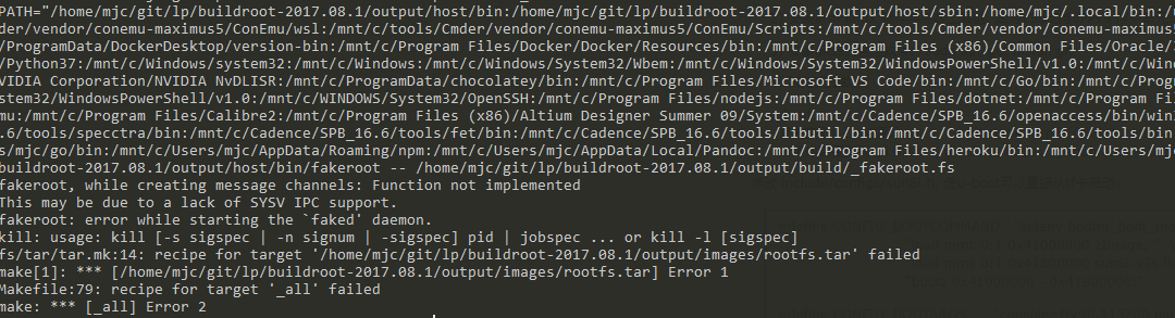

我用win10的subsystem编译出现了这个错误,似乎是wsl内部IPC实现的问题
一会儿换用doker编译看看,可以的话我上传个编译用的docker镜像
fakeroot, while creating message channels: Function not implemented This may be due to a lack of SYSV IPC support. fakeroot: error while starting the `faked' daemon.

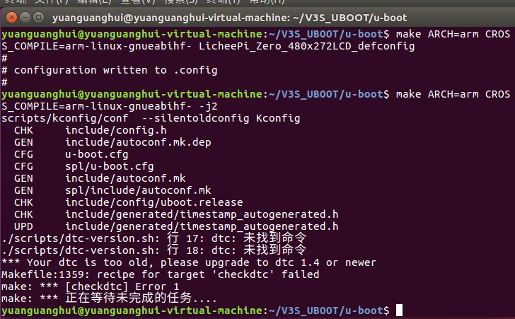

编译uboot出现上面的错误,在下小白,刚入手荔枝派ZERO,请教晕哥
#287 2020-03-09 08:31:23
sudo apt-get install device-tree-compiler
提示缺啥装啥就行
@mcu1234mcu
#288 2020-03-11 09:11:08
mcu1234mcu
注册时间: 2020-02-22
积分: 18
提示缺啥装啥就行
@mcu1234mcu
搞定了,谢谢

I compile buildroot it error why
freadahead.c: In function 'freadahead':
freadahead.c:92:3: error: #error "Please port gnulib freadahead.c to your platform! Look at the definition of fflush, fread, ungetc on your system, then report this to bug-gnulib."
make[5]: *** [Makefile:1915: freadahead.o] Error 1
make[5]: *** Waiting for unfinished jobs....
fseeko.c: In function 'rpl_fseeko':
fseeko.c:110:4: error: #error "Please port gnulib fseeko.c to your platform! Look at the code in fseeko.c, then report this to bug-gnulib."
make[5]: *** [Makefile:1915: fseeko.o] Error 1
make[4]: *** [Makefile:1674: all] Error 2
make[3]: *** [Makefile:1572: all-recursive] Error 1
make[2]: *** [Makefile:1528: all] Error 2
