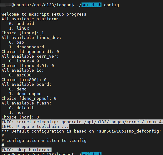

#8 Re: 全志 SOC » 全志A133/T509/AIC800 编译 longan SDK 出现这个错误 » 2022-03-17 10:04:06
X3
gpu清除:
make package/libs/libgpu/clean
gpu编译:
make package/libs/libgpu/compile
gpu安装:
make package/libs/libgpu/install

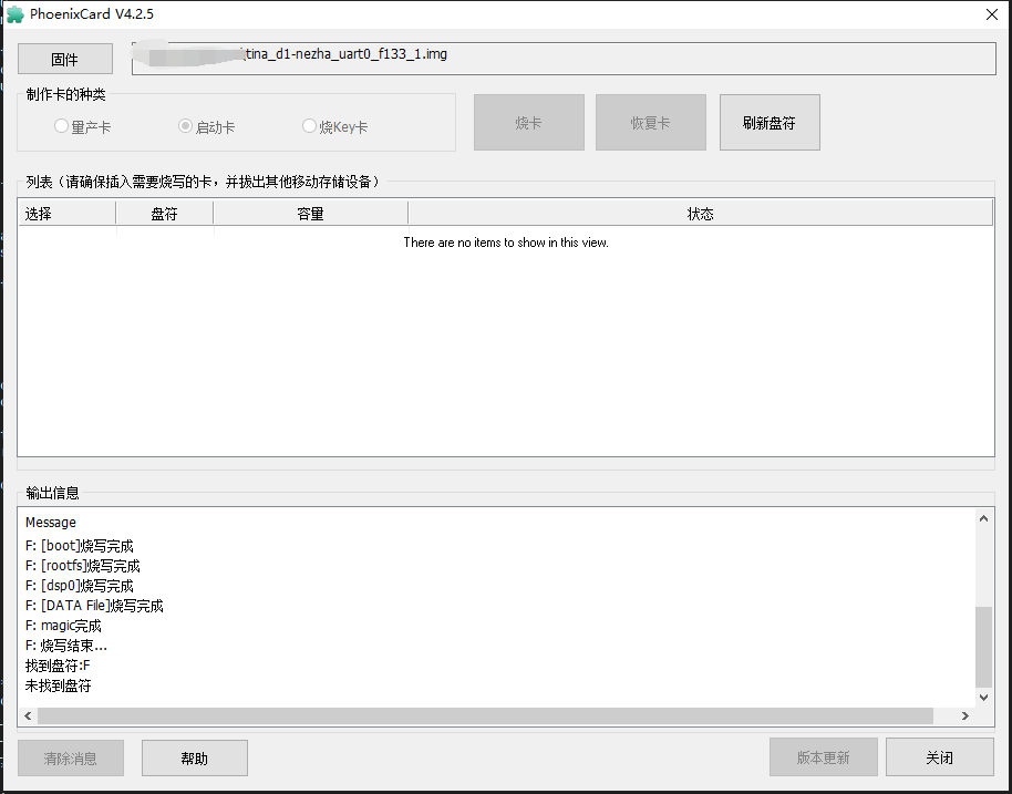

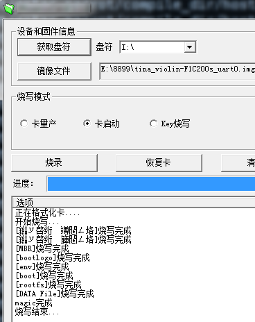

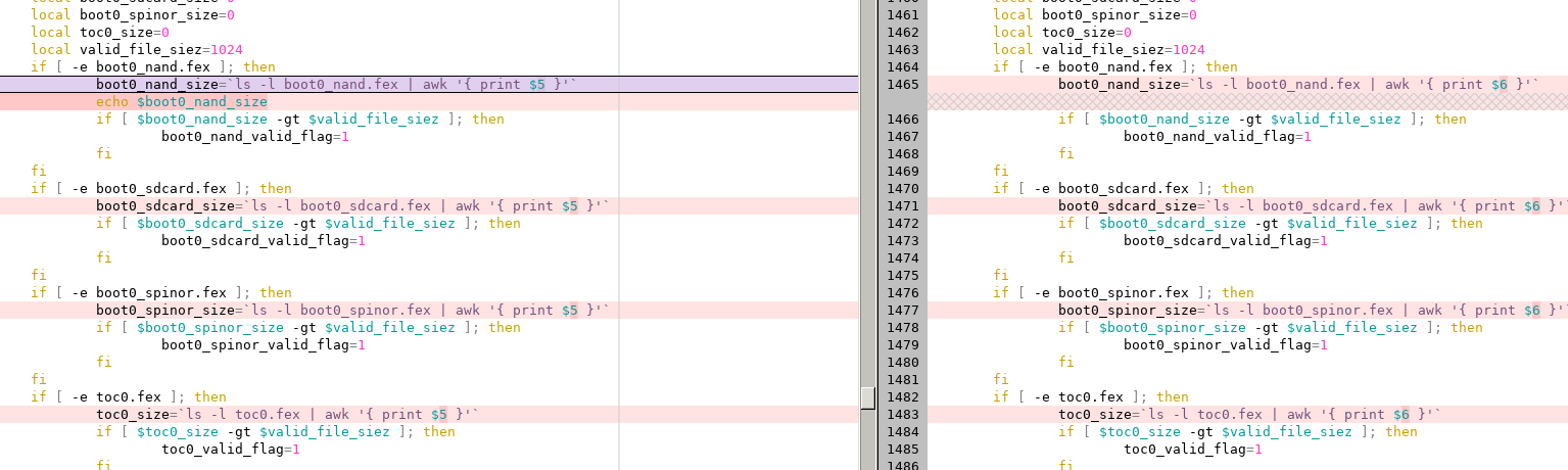

#14 Re: 全志 SOC » 刚刚收到的全志AIC800开发板,接个串口打印LOG 试一试 » 2022-02-18 15:42:26
X3
[ctp_para]
ctp_used = 1
ctp_name = "ft5x_ts"
ctp_twi_id = 0
ctp_twi_addr = 0x38
ctp_screen_max_x = 800
ctp_screen_max_y = 480
ctp_revert_x_flag = 0
ctp_revert_y_flag = 0
ctp_exchange_x_y_flag = 0
ctp_int_port = port:PB03<5><default><default><default>
ctp_wakeup = port:PB04<1><default><default><1>
ctp_io_port = port:PB03<0><default><default><default>
[ctp_list_para]
ctp_det_used = 1
ft5x_ts = 1
gt82x = 0
gslX680 = 0
gt9xx_ts = 0
FT6336 驱动不了,无法中断,尴尬。
#15 Re: 全志 SOC » 刚刚收到的全志AIC800开发板,接个串口打印LOG 试一试 » 2022-02-18 00:04:13
X3
  partition_name  : private
  partition_size  : 1024
  partition_name  : recovery
  partition_size  : 32768
  downloadfile  : recovery.fex
  recovery.fex size : 24 byte
  partition_name  : UDISK
/opt/sw509/tina/scripts/pack_img.sh: line 1466: [: Feb: integer expression expected
/opt/sw509/tina/scripts/pack_img.sh: line 1472: [: Feb: integer expression expected
/opt/sw509/tina/scripts/pack_img.sh: line 1484: [: Feb: integer expression expected
ERROR: boot0 files are all invalid files, now exit

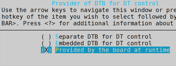

./build.sh brandy 之后,devicetree居然是这个配置:
CONFIG_OF_BOARD:                                                                                           │
  │ If this option is enabled, the device tree will be provided by                                             │
  │ the board at runtime if the board supports it, instead of being                                            │
  │ bundled with the image.                                                                                    │
  │ Symbol: OF_BOARD [=y]                                                                                      │
  │ Type  : boolean                                                                                            │
  │ Prompt: Provided by the board at runtime                                                                   │
  │   Location:                                                                                                │
  │     -> Device Tree Control                                                                                 │
  │       -> Provider of DTB for DT control (<choice> [=y])                                                    │
  │   Defined at dts/Kconfig:88                                                                                │
  │   Depends on: <choice> && !SANDBOX [=n]
http://www.wowotech.net/x_project/bubblegum_uboot_device_tree.html
@wowo:谢谢wowo的解答,这样理解也是很有道理。
我考虑的是对于arm soc,boot和kernel看到的设备其实是一样的,而且本来boot就会去修改kernel的dtb(cmdline、ram/initramfs start&sizee),并传递给kernel,分成两份有点重复。
我自己对这个问题的进展:
如果定义了CONFIG_OF_SEPARATE,uboot会去编译CONFIG_DEFAULT_DEVICE_TREE,倒是可以把这个路径指向内核的dts文件,就是目录跨得有点多;
另外还有一个CONFIG_OF_BOARD选项,可以在代码里去指定dtb文件内存地址,不过搜索了uboot目录,几乎没有厂家用这个选项。
当然也听说uboot解析和修改dtb文件效率并不高,分成一大一小不知道会不会更快一些了。
看起来, uboot 和 kernel 应该是共用设备树 。

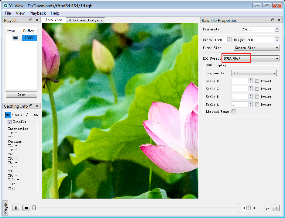

#30 Re: 全志 SOC » 刚刚收到的全志AIC800开发板,接个串口打印LOG 试一试 » 2022-02-13 19:37:55
X3
cat /dev/fb1 > fb1.rgb
电脑用 yuview 显示framebuffer图像,颜色格式 BGRA。

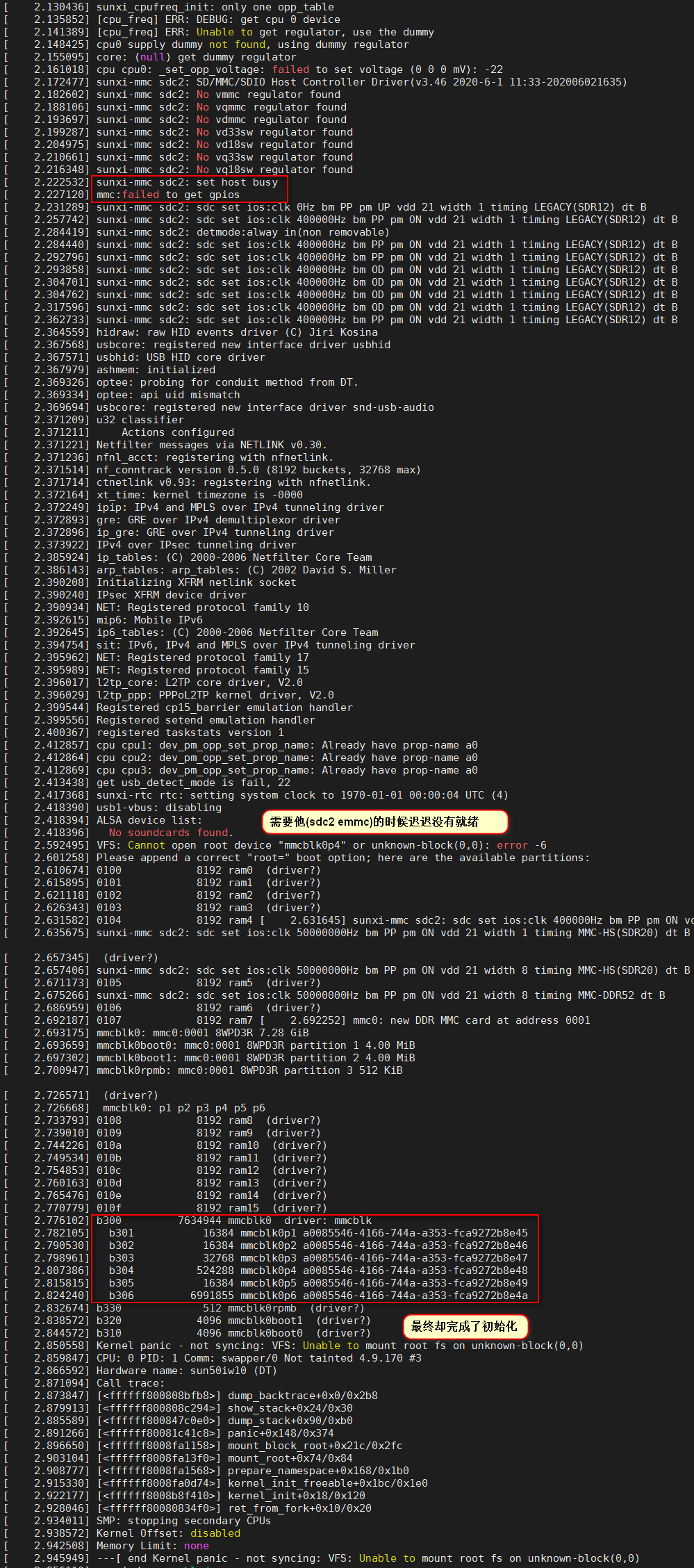

继续跟踪, 执行 ./build.sh 之后,是根据 longan/kernel/linux-4.9/rootfs.cpio.gz 为基础,再把 ko 文件打包到里面去,建立新的 longan/kernel/linux-4.9/output/rootfs.cpio.gz  。

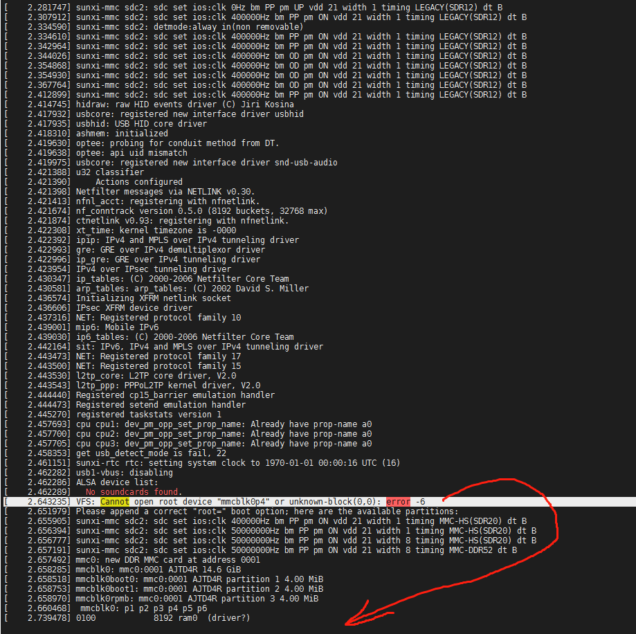

#35 Re: 全志 SOC » 刚刚收到的全志AIC800开发板,接个串口打印LOG 试一试 » 2022-02-12 20:46:42
X3
挂载文件系统延迟一点点,移到后面去就好了,
不知道怎么改。
#36 Re: 全志 SOC » 刚刚收到的全志AIC800开发板,接个串口打印LOG 试一试 » 2022-02-12 20:21:43

[    2.368442] nf_conntrack version 0.5.0 (8192 buckets, 32768 max)
[    2.368649] ctnetlink v0.93: registering with nfnetlink.
[    2.369104] xt_time: kernel timezone is -0000
[    2.369192] ipip: IPv4 and MPLS over IPv4 tunneling driver
[    2.369786] gre: GRE over IPv4 demultiplexor driver
[    2.369790] ip_gre: GRE over IPv4 tunneling driver
[    2.370771] IPv4 over IPsec tunneling driver
[    2.382389] ip_tables: (C) 2000-2006 Netfilter Core Team
[    2.382616] arp_tables: arp_tables: (C) 2002 David S. Miller
[    2.386681] Initializing XFRM netlink socket
[    2.386713] IPsec XFRM device driver
[    2.387400] NET: Registered protocol family 10
[    2.389329] mip6: Mobile IPv6
[    2.389358] ip6_tables: (C) 2000-2006 Netfilter Core Team
[    2.391214] sit: IPv6, IPv4 and MPLS over IPv4 tunneling driver
[    2.392529] NET: Registered protocol family 17
[    2.392555] NET: Registered protocol family 15
[    2.392584] l2tp_core: L2TP core driver, V2.0
[    2.392596] l2tp_ppp: PPPoL2TP kernel driver, V2.0
[    2.396018] Registered cp15_barrier emulation handler
[    2.396030] Registered setend emulation handler
[    2.396805] registered taskstats version 1
[    2.409204] cpu cpu1: dev_pm_opp_set_prop_name: Already have prop-name a0
[    2.409211] cpu cpu2: dev_pm_opp_set_prop_name: Already have prop-name a0
[    2.409216] cpu cpu3: dev_pm_opp_set_prop_name: Already have prop-name a0
[    2.409798] get usb_detect_mode is fail, 22
[    2.413847] sunxi-rtc rtc: setting system clock to 1970-01-01 00:00:19 UTC (19)
[    2.414926] usb1-vbus: disabling
[    2.414931] ALSA device list:
[    2.414933]   No soundcards found.
[    2.589139] VFS: Cannot open root device "mmcblk0p4" or unknown-block(0,0): error -6
[    2.597912] Please append a correct "root=" boot option; here are the available partitions:
[    2.607329] 0100            8192 ram0  (driver?)
[    2.612552] 0101            8192 ram1  (driver?)
[    2.617776] 0102            8192 ram2  (driver?)
[    2.623002] 0103            8192 ram3  (driver?)
[    2.628238] 0104            8192 ram4 [    2.628301] sunxi-mmc sdc2: sdc set ios:clk 400000Hz bm PP pm ON vdd 21 width 1 timing MMC-HS(SDR20) dt B
[    2.632332] sunxi-mmc sdc2: sdc set ios:clk 50000000Hz bm PP pm ON vdd 21 width 1 timing MMC-HS(SDR20) dt B
[    2.654012]  (driver?)
[    2.654069] sunxi-mmc sdc2: sdc set ios:clk 50000000Hz bm PP pm ON vdd 21 width 8 timing MMC-HS(SDR20) dt B
[    2.667849] 0105            8192 ram5  (driver?)
[    2.671944] sunxi-mmc sdc2: sdc set ios:clk 50000000Hz bm PP pm ON vdd 21 width 8 timing MMC-DDR52 dt B
[    2.683648] 0106            8192 ram6  (driver?)
[    2.688870] 0107            8192 ram7 [    2.688934] mmc0: new DDR MMC card at address 0001
[    2.689656] mmcblk0: mmc0:0001 8WPD3R 7.28 GiB
[    2.689956] mmcblk0boot0: mmc0:0001 8WPD3R partition 1 4.00 MiB
[    2.693658] mmcblk0boot1: mmc0:0001 8WPD3R partition 2 4.00 MiB
[    2.697293] mmcblk0rpmb: mmc0:0001 8WPD3R partition 3 512 KiB
[    2.723282]  (driver?)
[    2.723378]  mmcblk0: p1 p2 p3 p4 p5 p6
[    2.730501] 0108            8192 ram8  (driver?)
[    2.735716] 0109            8192 ram9  (driver?)
[    2.740936] 010a            8192 ram10  (driver?)
[    2.746248] 010b            8192 ram11  (driver?)
[    2.751565] 010c            8192 ram12  (driver?)
[    2.756871] 010d            8192 ram13  (driver?)
[    2.762182] 010e            8192 ram14  (driver?)
[    2.767504] 010f            8192 ram15  (driver?)
[    2.772830] b300         7634944 mmcblk0  driver: mmcblk
[    2.778836]   b301           16384 mmcblk0p1 a0085546-4166-744a-a353-fca9272b8e45
[    2.787265]   b302           16384 mmcblk0p2 a0085546-4166-744a-a353-fca9272b8e46
[    2.795700]   b303           32768 mmcblk0p3 a0085546-4166-744a-a353-fca9272b8e47
[    2.804130]   b304          524288 mmcblk0p4 a0085546-4166-744a-a353-fca9272b8e48
[    2.812565]   b305           16384 mmcblk0p5 a0085546-4166-744a-a353-fca9272b8e49
[    2.821005]   b306         6991855 mmcblk0p6 a0085546-4166-744a-a353-fca9272b8e4a
[    2.829443] b330             512 mmcblk0rpmb  (driver?)
[    2.835340] b320            4096 mmcblk0boot1  (driver?)
[    2.841338] b310            4096 mmcblk0boot0  (driver?)
[    2.847331] Kernel panic - not syncing: VFS: Unable to mount root fs on unknown-block(0,0)
[    2.856626] CPU: 0 PID: 1 Comm: swapper/0 Not tainted 4.9.170 #3
[    2.863375] Hardware name: sun50iw10 (DT)
[    2.867879] Call trace:
[    2.870633] [<ffffff800808bfb8>] dump_backtrace+0x0/0x2b8
[    2.876702] [<ffffff800808c294>] show_stack+0x24/0x30
[    2.882382] [<ffffff800847c0e0>] dump_stack+0x90/0xb0
[    2.888062] [<ffffff80081c41c8>] panic+0x148/0x374
[    2.893448] [<ffffff8008fa1158>] mount_block_root+0x21c/0x2fc
[    2.899906] [<ffffff8008fa13f0>] mount_root+0x74/0x84
[    2.905583] [<ffffff8008fa1568>] prepare_namespace+0x168/0x1b0
[    2.912140] [<ffffff8008fa0d74>] kernel_init_freeable+0x1bc/0x1e0
[    2.918991] [<ffffff8008b8f410>] kernel_init+0x18/0x120
[    2.924864] [<ffffff80080834f0>] ret_from_fork+0x10/0x20
[    2.930831] SMP: stopping secondary CPUs
[    2.935248] Kernel Offset: disabled
[    2.939180] Memory Limit: none
[    2.942627] ---[ end Kernel panic - not syncing: VFS: Unable to mount root fs on unknown-block(0,0)
[    2.952794] sunxi dump enabled
[    2.956222] dump regs done
[    2.959312] flush cache done
[    2.962560] crashdump enter
NOTICE:  sunxi_usb_dev_register
NOTICE:  sunxi_usb_main_loop
感觉这个AIC800的 SDC2 有问题,但是不确定是硬件问题,还是软件问题,需要文件系统的时候eMMC却没有就绪,但是最终挂载成功,系统却宕机了。
怪不得出厂的 rootfs 用 initramfs了。

编译根文件系统:
./build.sh rootfs
编译 Linux:
./build.sh kernel

#41 Re: 全志 SOC » 刚刚收到的全志AIC800开发板,接个串口打印LOG 试一试 » 2022-02-07 22:10:25
X3
配置:
./build.sh config
编译uboot:
./build.sh brandy
或:
./build.sh bootloader
编译 dts:
./build.sh dts
编译 Linux:
./build.sh kernel
#42 Re: 全志 SOC » 刚刚收到的全志AIC800开发板,接个串口打印LOG 试一试 » 2022-02-06 17:54:28

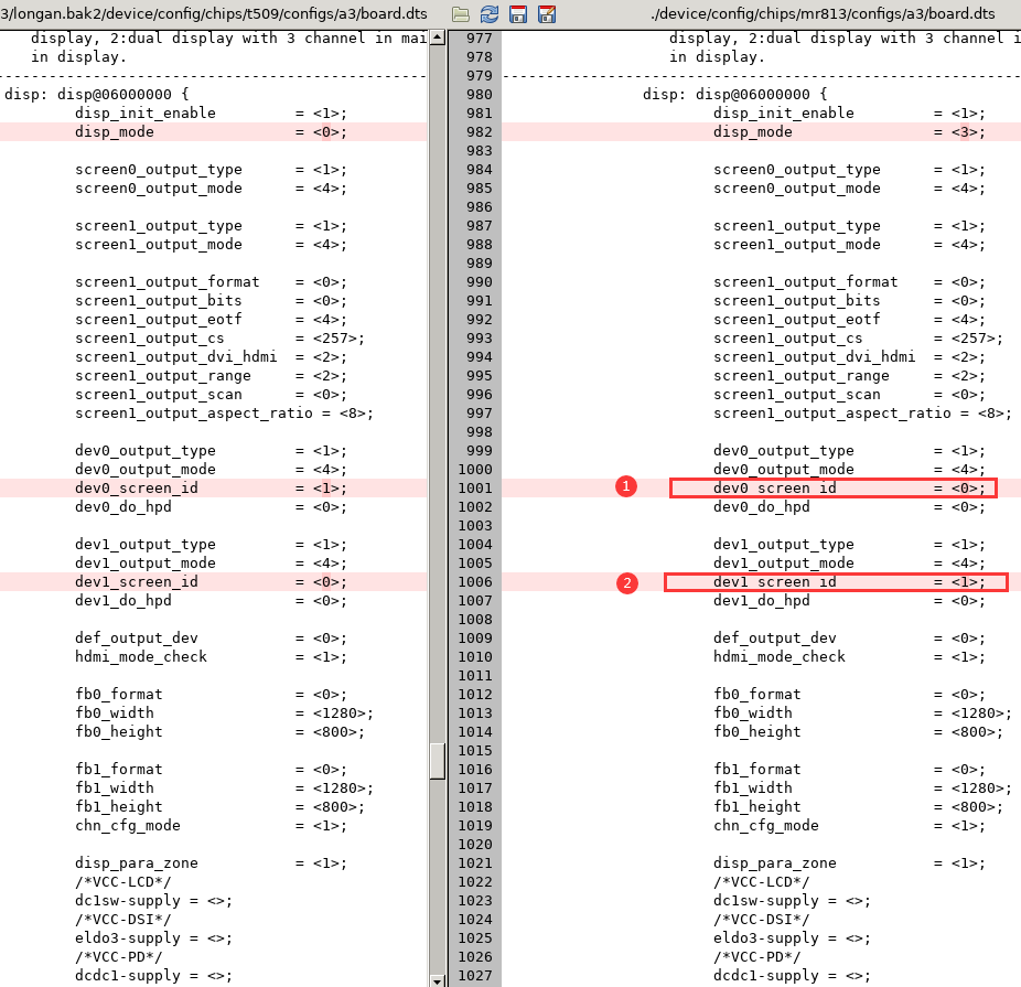

① ② 这个地方是对应 /dev/fb0  /dev/fb1 的
左边这个配置,lcd0,lcd1 对应 /dev/fb1,/dev/fb0
右边这个配置,lcd0,lcd1 对应 /dev/fb0,/dev/fb1
但是改成这样之后,
			dev0_screen_id           = <0>;
			dev1_screen_id           = <1>;
就变这样了:
root@TinaLinux:/# cat /sys/class/disp/disp/attr/disp
0

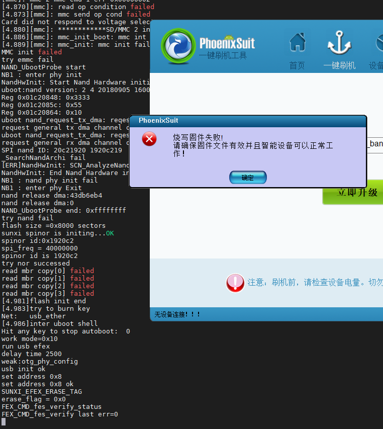

[8158]key pressed value=0x00000009
[8202]key pressed value=0x00000009
[8246]key pressed value=0x00000009
[8290]key pressed value=0x00000009
[8334]key pressed value=0x00000009
[8378]key pressed value=0x00000009
[8422]key pressed value=0x00000009
[8466]key pressed value=0x00000009
[8510]key pressed value=0x00000009
[8554]key pressed value=0x00000009
[8598]key pressed value=0x00000009
[8642]key pressed value=0x00000009
[8686]key pressed value=0x00000009
[8730]key pressed value=0x00000009
[8774]key pressed value=0x00000009
[8818]key pressed value=0x00000009
[8862]key pressed value=0x00000009
[8906]key pressed value=0x00000009
[8950]key pressed value=0x00000009
[8994]key pressed value=0x00000009
[9038]key pressed value=0x00000009
[9082]time out
[9083]DRAM DRIVE INFO: V0.9
[9086]DRAM Type = 3 (2:DDR2,3:DDR3,6:LPDDR2,7:LPDDR3)
[9091]DRAM CLK = 408 MHz
[9093]DRAM zq value: 000039bb
[9119]DRAM size = 128 MB
[9127]dram size =128
[9130]Succeed in reading toc file head.
[9133]The size of toc is 00064000.
[9218]Entry_name        = u-boot
[9226]Entry_name        = soc-cfg
[9230]Entry_name        = dtb
[9233]Ready to disable icache.
[9236]Jump to secend Boot.
U-Boot 2014.07 (Oct 07 2021 - 23:16:17) Allwinner Technology
uboot commit : f1592db8c49aaedd6895f7e0f90caa123f0a3d5a
normal mode
i2c_init: by cpux
i2c_init ok
[9.250]pmbus:   ready
axp read error
probe axp failed
axp_probe error
[9.361]PMU: pll1 912 Mhz,PLL6=600 Mhz
AXI=304 Mhz,AHB=200 Mhz, APB1=100 Mhz
fel key detected
initcall sequence 409455e8 failed at call 40904878
set next system status
reset cpu
[169]HELLO! BOOT0 is starting!
[173]boot0 commit : 95d7802c6274b07ba59a9e01ec45aaf4b81687cb
[211]rtc[0] value = 0x00000000
[214]rtc[1] value = 0x00000000
[217]rtc[2] value = 0x5aa5a55a
[220]rtc[3] value = 0x00000000
[223]rtc[4] value = 0x00000000
[226]rtc[5] value = 0x00000000
[228]rtc[6] value = 0x00000000
[231]rtc[7] value = 0x00000000
[234]eraly jump fel

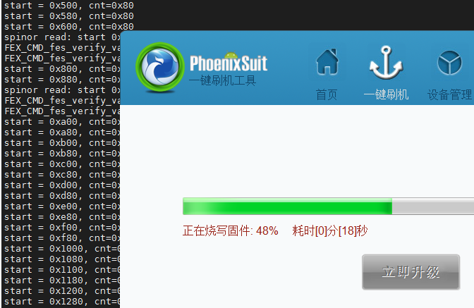

bangu-h300 可以烧完,但是烧完启动就是上面的模样。

我要烧到 SPI NOR, 芯片确认是焊好的,能跑主线Linux
#46 全志 SOC » V3s tina 3.5 编译了一个固件,烧录不进去,请问是怎么回事呢? » 2021-10-08 10:31:38
X3
回复: 10
[1243]beign to init dram
[1245]DRAM DRIVE INFO: V0.9
[1248]DRAM Type = 3 (2:DDR2,3:DDR3,6:LPDDR2,7:LPDDR3)
[1253]DRAM CLK = 408 MHz
[1255]DRAM zq value: 000039bb
[1281]DRAM size = 128 MB
[1290]init dram ok
U-Boot 2014.07 (Oct 10 2018 - 17:15:36) Allwinner Technology
uboot commit : dd6d22b2a20bd0db1e5f9932edb94a81127900aa
normal mode
i2c_init: by cpux
i2c_init ok
[4.550]pmbus:   ready
axp read error
probe axp failed
axp_probe error
[4.661]PMU: pll1 912 Mhz,PLL6=600 Mhz
DRAM:  64 MiB
[4.669]fdt addr: 0x429e8128
[4.670]gd->fdt_size: 0xbea0
Relocation Offset is: 033ff000
gic: normal mode
[4.718]flash init start
workmode = 16,storage type = 0
try card 1
[4.720][mmc]: mmc driver ver 2018-8-11 15:15:00
[4.724][mmc]: sdc_on error, 1
[4.727][mmc]: MMC Device 1 not found
try card 2
[4.731][mmc]: mmc driver ver 2018-8-11 15:15:00
[4.736][mmc]: get card0 para fail
[4.738][mmc]: mmc_update_timing_para: error sdc_no 2
SUNXI SD/MMC: 2
[4.750][mmc]: ************Try SD card 2************
[mmc]: mmc 2 cmd 8 timeout, err 2
[mmc]: smc 2 err, cmd 8,  RE
[mmc]: mmc 2 close bus gating and reset
[mmc]: mmc 2 mmc cmd 8 err 0x00000002
[4.762][mmc]: mmc send if cond failed
[mmc]: mmc 2 cmd 55 timeout, err 2
[mmc]: smc 2 err, cmd 55,  RE
[mmc]: mmc 2 mmc cmd 55 err 0x00000002
[4.778][mmc]: send app cmd failed
[4.781][mmc]: ************Try MMC card 2************
[mmc]: mmc 2 cmd 1 timeout, err 2
[mmc]: smc 2 err, cmd 1,  RE
[mmc]: mmc 2 mmc cmd 1 err 0x00000002
[4.798][mmc]: read op condition failed
[4.802][mmc]: mmc send op cond failed
[4.809][mmc]: ************SD/MMC 2 init error!!!************
[4.814][mmc]: mmc_init_boot: mmc int fail
[4.818][mmc]: mmc_init: mmc init fail, err -17
MMC init failed
try emmc fail
NAND_UbootProbe start
NB1 : enter phy init
NandHwInit: Start Nand Hardware initializing .....
uboot:nand version: 2 4 20180905 1600
Reg 0x01c20848: 0x3333
Reg 0x01c2085c: 0x55
Reg 0x01c20864: 0x10
uboot nand_request_tx_dma: reqest genernal dma for nand success, 0x43db6eb4
request general tx dma channel ok!
uboot nand_request_tx_dma: reqest genernal dma for nand success, 0x43db6ed0
request general rx dma channel ok!
SPI nand ID: 20c21920 1920c219
_SearchNandArchi fail
[ERR]NandHwInit: SCN_AnalyzeNandSystem() failed!
NandHwInit: End Nand Hardware initializing ..... FAIL!
NB1 : nand phy init fail
NB1 : enter phy Exit
nand release dma:43db6eb4
nand release dma:0
NAND_UbootProbe end: 0xffffffff
try nand fail
flash size =0x8000 sectors
sunxi spinor is initing...OK
spinor id:0x1920c2
spi_freq = 40000000
spinor id is 1920c2
try nor successed
read mbr copy[0] failed
read mbr copy[1] failed
read mbr copy[2] failed
read mbr copy[3] failed
[4.909]flash init end
[4.911]try to burn key
Net:   usb_ether
[4.915]inter uboot shell
work mode=0x10
run usb efex
delay time 2500
weak:otg_phy_config
usb init ok
set address 0x6
set address 0x6 ok
SUNXI_EFEX_ERASE_TAG
erase_flag = 0x0
FEX_CMD_fes_verify_status
FEX_CMD_fes_verify last err=0

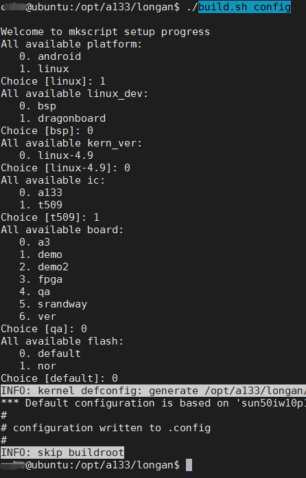

build/mkcmd.sh 里面定义了 kernel版本 / 系统结构 / gcc版本 / rootfs版本:
cross_compiler=(
'linux-3.4      arm      gcc-linaro.tar.bz2      target_arm.tar.bz2'
'linux-3.4      arm64   gcc-linaro-aarch64.tar.xz       target_arm64.tar.bz2'
'linux-3.10     arm      gcc-linaro-arm.tar.xz   target_arm.tar.bz2'
'linux-3.10     arm64   gcc-linaro-aarch64.tar.xz       target_arm64.tar.bz2'
'linux-4.4      arm       gcc-linaro-5.3.1-2016.05-x86_64_arm-linux-gnueabi.tar.xz        target-arm-linaro-5.3.tar.bz2'
