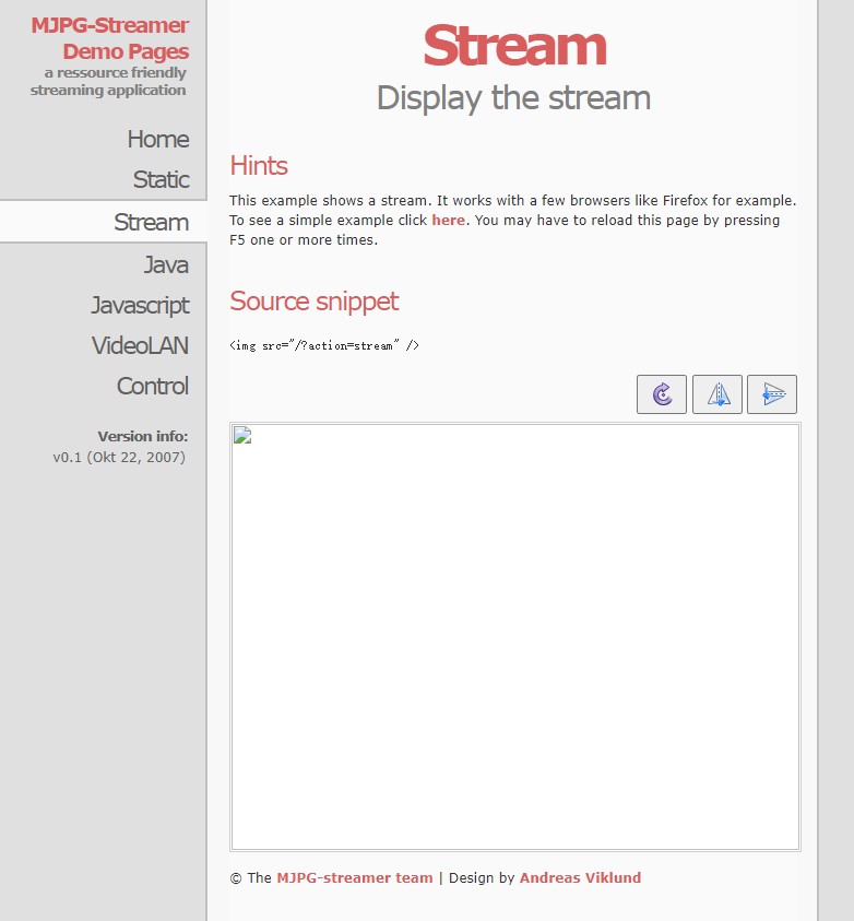

#6 Re: 全志 SOC » V3S 启用UVC摄像头,用mjpg_streamer无法显示图像 » 2023-10-08 17:17:15
目前使用
mjpg_streamer -i "input_uvc.so -d /dev/video0 -n -f 10 -r 1280x720 -yuv" -o "output_http.so -p 8080 -w /opt/www"
图像出来了,但是很卡,关键是在 -yuv 这里,为什么使用mjpg格式不行?
#7 Re: 全志 SOC » V3S 启用UVC摄像头,用mjpg_streamer无法显示图像 » 2023-10-08 10:50:27
哇酷小二 wrote:
[ 808.670992] uvcvideo: Failed to query (GET_CUR) UVC control 3 on unit 1: -32 (exp. 1).
看下这个错误
我更换了不同牌子的摄像头,这个错误没有了,但是依旧不显示图像
[  448.346048] usb 1-1: new high-speed USB device number 3 using ehci-platform
[  448.616951] usb 1-1: New USB device found, idVendor=046d, idProduct=0891
[  448.623677] usb 1-1: New USB device strings: Mfr=0, Product=2, SerialNumber=1
[  448.630859] usb 1-1: Product: 罗技高清网络摄像机 C930c
[  448.636798] usb 1-1: SerialNumber: DC35527E
[  448.642846] uvcvideo: Found UVC 1.00 device 罗技高清网络摄像机 C930c (046d:0891)
[  448.666278] uvcvideo 1-1:1.0: Entity type for entity Processing 3 was not initialized!
[  448.674233] uvcvideo 1-1:1.0: Entity type for entity Extension 6 was not initialized!
[  448.682167] uvcvideo 1-1:1.0: Entity type for entity Extension 8 was not initialized!
[  448.690020] uvcvideo 1-1:1.0: Entity type for entity Extension 9 was not initialized!
[  448.697876] uvcvideo 1-1:1.0: Entity type for entity Extension 10 was not initialized!
[  448.705786] uvcvideo 1-1:1.0: Entity type for entity Extension 11 was not initialized!
[  448.713708] uvcvideo 1-1:1.0: Entity type for entity Extension 12 was not initialized!
[  448.721626] uvcvideo 1-1:1.0: Entity type for entity Extension 13 was not initialized!
[  448.729541] uvcvideo 1-1:1.0: Entity type for entity Camera 1 was not initialized!
[  448.745205] input: 罗技高清网络摄像机 C93 as /devices/platform/soc/1c1a000.usb/usb1/1-1/1-1:1.0/input/input3
# ls /dev/video*
/dev/video0
# mjpg_streamer -i "input_uvc.so -d /dev/video0 -n -f 10 -r 1280x720" -o "output
MJPG Streamer Version: svn rev:
 i: Using V4L2 device.: /dev/video0
 i: Desired Resolution: 1280 x 720
 i: Frames Per Second.: 10
 i: Format............: MJPEG
[  522.546056] usb 1-1: reset high-speed USB device number 3 using ehci-platform
 o: www-folder-path...: /opt/www/
 o: HTTP TCP port.....: 8080
 o: username:password.: disabled
 o: commands..........: enabled
是否需要http://www.ideasonboard.org/uvc/这里面支持的ID才可以免驱?
#8 Re: 全志 SOC » V3S 启用UVC摄像头,用mjpg_streamer无法显示图像 » 2023-10-08 09:45:09
另外我在树莓派4B上面测试的时候,插入一个UVC摄像头好像都会出现2个/dev/video0和/dev/video1,在V3S上只出现了/dev/video0,问题是不是出在这里?
#9 全志 SOC » V3S 启用UVC摄像头,用mjpg_streamer无法显示图像 » 2023-10-08 09:39:15
Meekdai
回复: 4
参考晕哥编译的buildroot https://whycan.com/t_2169.html,目前系统正常启动

使用 ls /dev/video* 可以找到 /dev/video0,但是通过mjpg_streamer图像没有显示:
mjpg_streamer -i "input_uvc.so -d /dev/video0 -n -f 10 -r 1280x720" -o "output_http.so -p 8080 -w /opt/www"
不知道是哪里有问题,请大神赐教。
