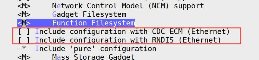

#8 Re: 全志 SOC » 基于f1c200s运行linux的学习记录. » 2023-02-06 17:46:05
adb参考
分享个licheepi nano镜像,支持adb调试
https://whycan.com/t_2794.html#p22739
原linux的config文件按帖子配置出错
# install_listener('tcp:5037','*smartsocket*')
[   62.563118] read descriptors
[   62.566072] read strings
[   62.568693] udc-core: couldn't find an available UDC - added [g_ffs] to list of pending drivers
参考链接:https://www.jianshu.com/p/d341022167b4
发现没有musb_hdrc
参考下贴的config(修改后的config文件使用,出现提示类似(N/m/y)时,直接回车用默认的)
终于搞好了荔枝派nano linux uboot瘦身 + usb gadget hid + gt911触控 + littlevgl demo
https://whycan.com/t_2688.html#p21453
对比log
发现启动缺少musb-hdrc.1.auto
修改.config
出错变成
# sh adb.sh
[   17.357434] file system registered
[   21.803710] read descriptors
[   21.806665] read strings
[   21.809611] using random self ethernet address
[   21.814076] using random host ethernet address
[   21.818608] using random self ethernet address
[   21.823135] using random host ethernet address
[   21.828983] usb0: HOST MAC de:ce:81:cb:df:5c
[   21.833560] usb0: MAC 32:c6:c7:a5:db:e1
[   21.837708] g_ffs gadget: g_ffs ready
[   38.085937] g_ffs gadget: high-speed config #1: FunctionFS + RNDIS
电脑识别成com口,继续找原因
https://whycan.com/t_2794.html#p30104

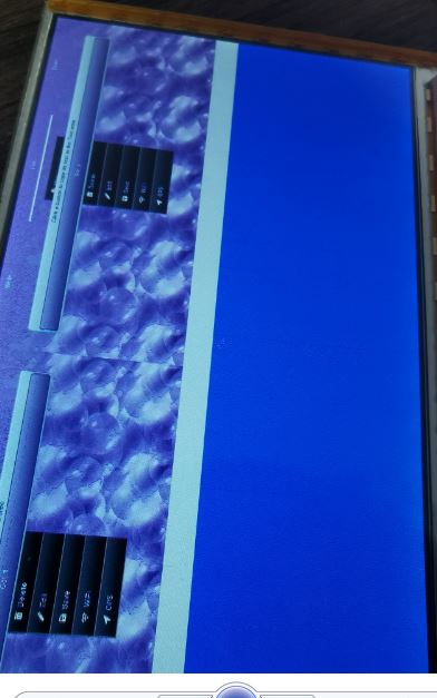

linux屏幕反色修改
From adbe5b4615ed355fdd76465b0e6b89de2e9f19a4 Mon Sep 17 00:00:00 2001
From: jiangming1399 <jiangming1399@163.com>
Date: Tue, 7 Apr 2020 16:51:31 +0800
Subject: [PATCH] [drm] sun4i: add swap red and blue on tcon0
 drivers/gpu/drm/sun4i/sun4i_tcon.c | 13 +++++++++++++
 drivers/gpu/drm/sun4i/sun4i_tcon.h |  3 +++
 2 files changed, 16 insertions(+)
diff --git a/drivers/gpu/drm/sun4i/sun4i_tcon.c b/drivers/gpu/drm/sun4i/sun4i_tcon.c
index ce9846c91..b024312b3 100644
--- a/drivers/gpu/drm/sun4i/sun4i_tcon.c
+++ b/drivers/gpu/drm/sun4i/sun4i_tcon.c
@@ -419,6 +419,12 @@ static void sun4i_tcon0_mode_set_lvds(struct sun4i_tcon *tcon,
 			   SUN4I_TCON0_CTL_CLK_DELAY_MASK,
 			   SUN4I_TCON0_CTL_CLK_DELAY(clk_delay));
+	if (tcon->swap_red_blue) {
+		regmap_update_bits(tcon->regs, SUN4I_TCON0_CTL_REG,
+				SUN4I_TCON0_CTL_SWAP,
+				SUN4I_TCON0_CTL_SWAP);
 	 * This is called a backporch in the register documentation,
 	 * but it really is the back porch + hsync
@@ -498,6 +504,12 @@ static void sun4i_tcon0_mode_set_rgb(struct sun4i_tcon *tcon,
@@ -1103,6 +1115,7 @@ static int sun4i_tcon_bind(struct device *dev, struct device *master,
 	tcon->dev = dev;
 	tcon->id = engine->id;
 	tcon->quirks = of_device_get_match_data(dev);
+	tcon->swap_red_blue = of_property_read_bool(dev->of_node, "swap-red-blue");
 	tcon->lcd_rst = devm_reset_control_get(dev, "lcd");

还不行,怎么回事,通过对比发现.clk_divider_set_rate中参数clk_divider_set_rate(0x01c2010c, 4, 0, true, /*24000000* /f1c100s_tcon_clk_get_rate(), 312000000);
千万另用24M,要用:f1c100s_tcon_clk_get_rate()
static void f1c100s_clk_debe_init(void)
    clk_mux_set_parent(0x01c20104, 3, 24, 0);
    clk_divider_set_rate(0x01c20104, 4, 0, true, f1c100s_tcon_clk_get_rate(), 312000000);
static void f1c100s_clk_defe_init(void)
    clk_mux_set_parent(0x01c2010c, 3, 24, 0);
    clk_divider_set_rate(0x01c2010c, 4, 0, true, f1c100s_tcon_clk_get_rate(), 312000000);

        write32((uint32_t)&debe->layer0_attr1_ctrl+4*LayerNum, 0x09 << 8);
        write32((uint32_t)&debe->layer0_stride+4*LayerNum, pdat->width*32);
#29 Re: 全志 SOC » XBOOT能通过JLINK调试吗? » 2022-07-04 17:13:13

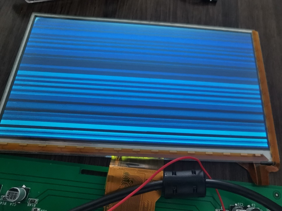

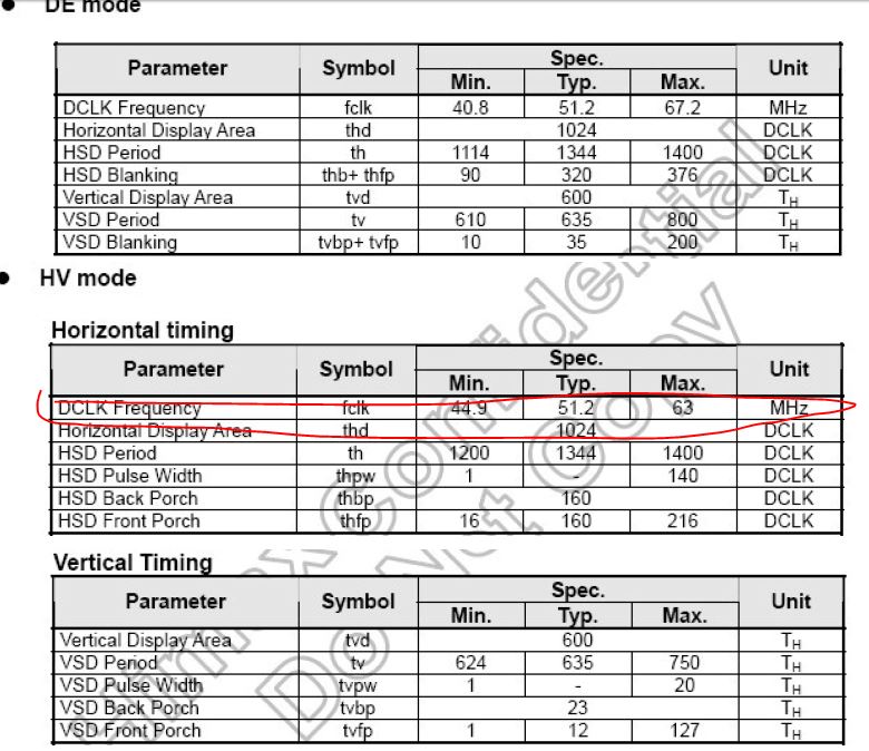

.pixel_clock_hz=52M设置方法:
52*6=312M
时钟24*x/y=312M  ->x/y=13
若y=4,x=52,  ->  0x03  ,0x33  ->24000000*(0x33+1)/(0x03+1) ->0x81003303

3.jpg找到频的dclk,对应pixel_clock_hz改之/
void sys_clock_init(void)
->write32(F1C100S_CCU_BASE + CCU_PLL_VIDEO_CTRL, 0x81003b03);
void rt_hw_board_init(void)
->video_set_pll_clk(360000000);//(198000000);
时钟输出=24000000*(0x3b+1)/(0x03+1)=360Mhz

->lcd_cfg_Struct lcd_cfg={
    .pixel_clock_hz=60000000, //9210200,
#32 Re: 全志 SOC » 基于f1c200s运行th_thread的学习记录. » 2022-06-16 17:33:10

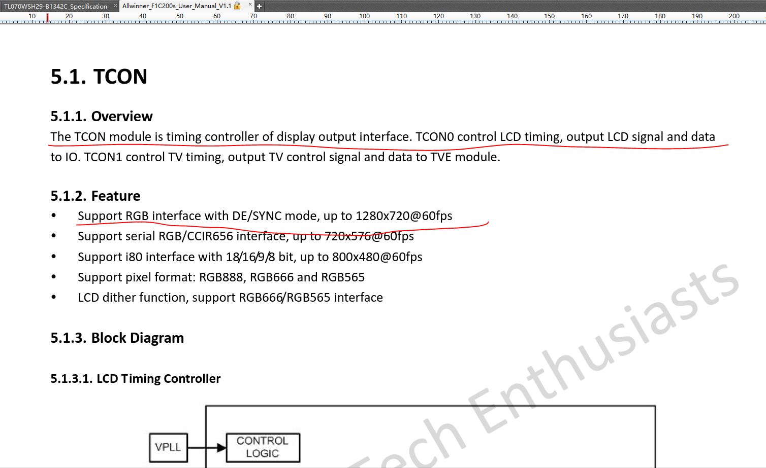

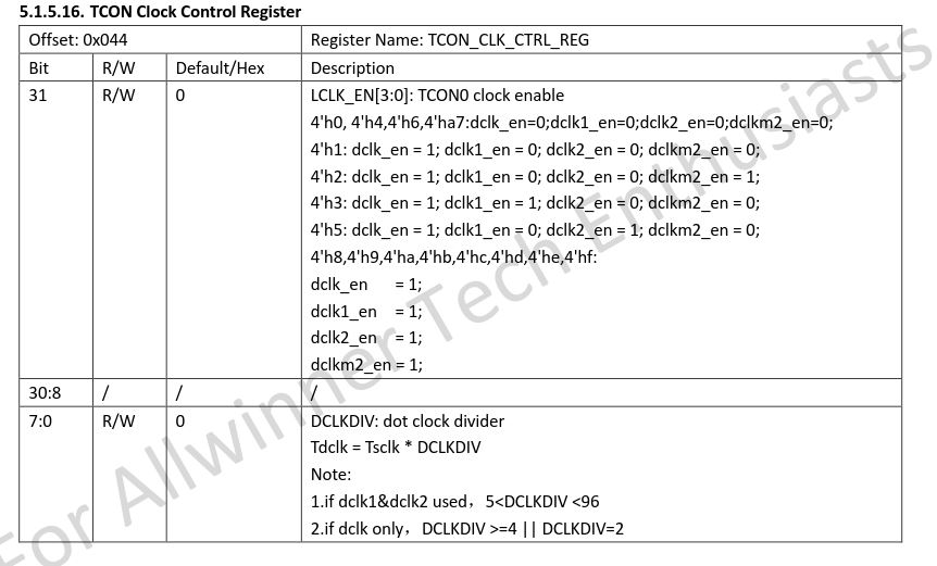

uint32_t tcon0_dclk;            /* 0x44 */
根据:  write32((uint32_t)&tcon->tcon0_dclk, (0xf << 28) | (val << 0));
lclk_en:4'hf
DCLKDIV: dot clock divider
Tdclk = Tsclk * DCLKDIV
Note:
1.if dclk1&dclk2 used,5<DCLKDIV <96
2.if dclk only,DCLKDIV >=4 || DCLKDIV=2
->  video_get_pll_clk()
->  PLL_VIDEO_CTRL_REG    0x0010  PLL_VIDEO Control Register 查看倍频情况.
这边是获取了,查一下,设置部分找到:
    video_set_pll_clk(198000000);

static void f1c100s_tcon_set_mode(lcd_cfg_Struct * pdat)
   val = f1c100s_tcon_clk_get_rate() / pdat->pixel_clock_hz;
    struct f1c100s_tcon_reg_t * tcon = (struct f1c100s_tcon_reg_t *)F1C100S_TCON_BASE;
    #define F1C100S_TCON_BASE        (0x01c0c000)
