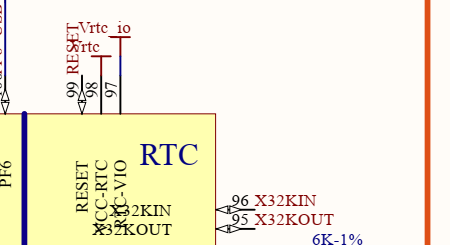

终于解决V3s自带的RTC不准问题,
电阻电容调大又调小,始终解决不了时间不准问题,
淘宝买一片PCF8563, 外挂上去解决这个问题。dts修改:
&i2c0 {
status = "okay";ns2009: ns2009@48 {
compatible = "nsiway,ns2009";
reg = <0x48>;
rtc@51 {
compatible = "nxp,pcf8563";
reg = <0x51>;
};PCF8563驱动加入内核:
CONFIG_RTC_DRV_PCF8563=y
我通用选择外接pcf8563芯片用作外部rtc,但是我从打印信息中看到,系统使用的依旧是内部RTC?设备节点有2个RTC,分别是sun6i-rtc和rtc-pcf8563,我想问一下需要在设备树在禁止sun6i-rtc?我认为我的v3s现在并没有使用外接的pcf8563-rtc
还有一个问题就是,我在查看pcf8563-rtc时间时hwclock -f /dev/rtc1 提示
rtc-pcf8563 0-0051: low voltage detected, date/time is not reliable.
hwclock: RTC_RD_TIME: Invalid argument
有人外接时候碰到过吗?这是pcf8563-rtc没有用上?

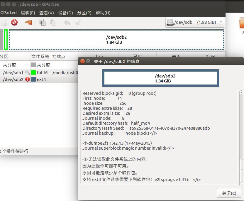

我在解决的时候发现是ext4文件系统功能引起的无法挂载,has_journal日志功能存在的时候,ext4分区无法挂载,我尝试吧这个文件系统功能去掉后,是可以成功挂载的,但是我使用晕哥提供的文件系统以及我以往成功运行的文件系统都是无法正确启动。
[ 1.440383] EXT4-fs (mmcblk0p2): couldn't mount as ext3 due to feature incompatibilities
[ 1.449630] EXT4-fs (mmcblk0p2): couldn't mount as ext2 due to feature incompatibilities
[ 1.473268] EXT4-fs (mmcblk0p2): warning: mounting unchecked fs, running e2fsck is recommended
[ 1.484155] EXT4-fs (mmcblk0p2): mounted filesystem without journal. Opts: (null)
[ 1.491827] VFS: Mounted root (ext4 filesystem) on device 179:2.
[ 1.501335] devtmpfs: mounted
[ 1.505605] Freeing unused kernel memory: 1024K
[ 1.514607] Starting init: /sbin/init exists but couldn't execute it (error -8)
[ 1.523472] Starting init: /bin/sh exists but couldn't execute it (error -8)
[ 1.530648] Kernel panic - not syncing: No working init found. Try passing init= option to kernel. See Linux Documentation/admin-guide/init.rst for guidance.
[ 1.544807] CPU: 0 PID: 1 Comm: swapper/0 Not tainted 4.13.16-licheepi-zero+ #13
[ 1.552190] Hardware name: Allwinner sun8i Family
[ 1.556931] [<c010e4c4>] (unwind_backtrace) from [<c010b218>] (show_stack+0x10/0x14)
[ 1.564677] [<c010b218>] (show_stack) from [<c06664dc>] (dump_stack+0x84/0x98)
[ 1.571901] [<c06664dc>] (dump_stack) from [<c011b544>] (panic+0xdc/0x248)
[ 1.578778] [<c011b544>] (panic) from [<c0678ef0>] (kernel_init+0x100/0x110)
[ 1.585825] [<c0678ef0>] (kernel_init) from [<c0107578>] (ret_from_fork+0x14/0x3c)
[ 1.593398] Rebooting in 5 seconds..还有一种情况就是当我解压文件系统并在ext4分区重新添加has_journal功能时,开发板启动信息显示无法找到ext4分区,难道是tf卡的问题?我已经用2张tf卡试过

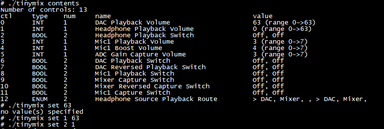

见错改错,应该只会有很少错.设置好声卡参数, 然后调用 play_sample() 播放内存数据即可。
https://github.com/tinyalsa/tinyalsa/blob/master/utils/tinyplay.c
我现在tinyplay可以加进去进行完成编译,但是有一个问题是,我每次使用tinyplay前都需要用tinymix将通道口打开才有声音,但是tinymix和tinyplay是2个程序,怎么去掉tinymix这一步?
605364021 说:晕哥 说:tinyalsa可以加入 你的项目一起编译,我就是这么干的

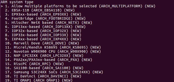

但是我在buildroot里面的busybox里面没找到mdev选项.....
https://www.cnblogs.com/rain-blog/p/rtl8723bs-driver-test.html
CONFIG_PLATFORM_ARM_SUNxI = n
CONFIG_PLATFORM_ARM_SUN6I = n
CONFIG_PLATFORM_ARM_SUN7I = n
CONFIG_PLATFORM_ARM_SUN8I = n我想问下,licheepi zero选哪个平台架构?

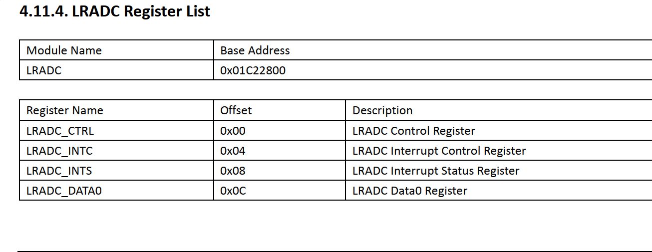

-sh: can't open /dev/lradc: Invalid argument我在驱动程序open函数中使用request_irq进行申请中断,其中62我是在v3s芯片手册中查到的lradc中断号,知道会是什么原因导致注册中断失败?
static int adc_open(struct inode * inode,struct file * file) //打开设备函数
//注册中断
int ret;
ret=request_irq(62,adc_interrupt,IRQF_SHARED,ADC_NAME,1);//注册中断 IRQ_ADC在 mach/irqs.h中定义
if(ret<0)
printk("IRQ %d can not request/n",IRQ_ADC);
return ret;

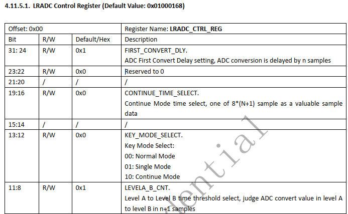

adc_con=(unsigned long)ioremap(0x01C22800,4);
adc_dat0=(volatile unsigned long)ioremap(0x01C2280C,4);
if( !(adc_con & adc_dat0) )

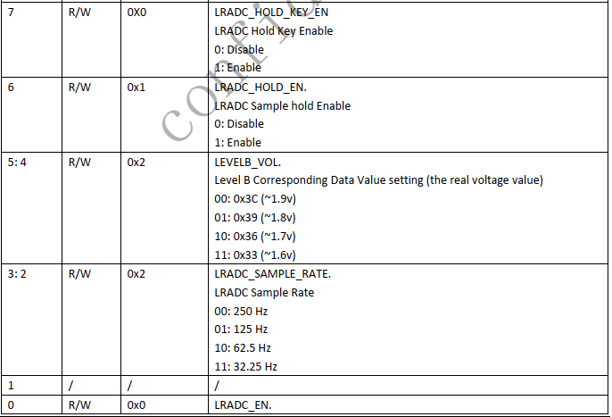

writel(FIRST_CONVERT_DLY(2) | LEVELA_B_CNT(1) | HOLD_EN(1) |
SAMPLE_RATE(0) | ENABLE(1), adc_con); //设置ADCCON writew (unsigned char data , unsigned short addr )写16位数据 2字节

Segmentation fault605364021 说:晕哥 说:V3s 的 lradc 驱动已经写好,用户层只要访问 /dev/input/eventX 就可以了, 自己编译一个 evtest.c 就可以测试按键输入了。
我知道有自带的sun4i-lradc-keys驱动,但是我刚刚开始学写驱动,希望自己写个简单的lradc驱动来实现相关功能,但我没搞懂怎么如何去检测是哪个按键按下...网上大部分都是1个gpio对应1个按键,但是V3S用的是ADC按键
https://github.com/Lichee-Pi/linux/blob/zero-4.13.y/drivers/input/keyboard/sun4i-lradc-keys.c
注册成为输入设备,按后利用adc中断输出自定义的key值给用户层。
你也可以写一个最简单的驱动程序,利用这个adc,从轮询开始,先别用中断。

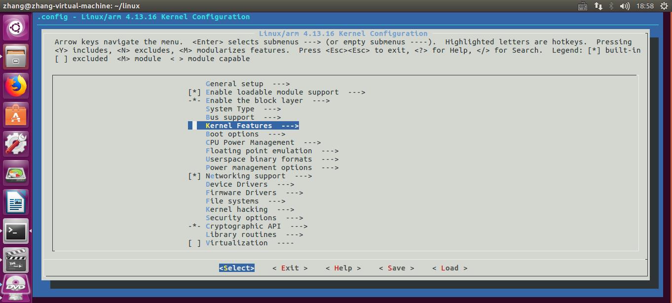

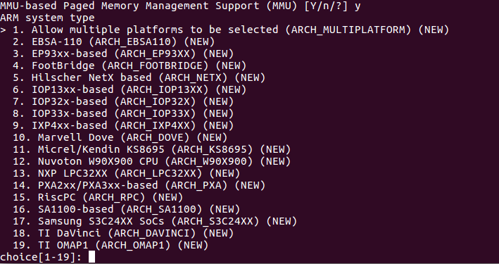

CONFIG_ARCH_WANT_OPTIONAL_GPIOLIB=y
CONFIG_ARCH_REQUIRE_GPIOLIB=y
CONFIG_GPIOLIB=y
前两个在内核.config文件下不存在,只有第三个有。是要将新建的内核加载到zimge上去运行?只移植.ko模块到板子上运行可以?

#include <linux/init.h>
#include <linux/module.h>
#include <linux/kernel.h>
static int hello_init(void)
printk(KERN_INFO "Hello world enter\n");
static void hello_exit(void)
printk(KERN_INFO "Hello world exit\n");
module_init(hello_init);
module_exit(hello_exit);
MODULE_LICENSE("Dual BSD/GPL");
MODULE_DESCRIPTION("A simple hello worild Module");
MODULE_ALIAS("a simplest module");KERNELDIR:=/home/zhang/linux
obj-m += hello.o
default:
$(MAKE) -C $(KERNELDIR) M=$(shell pwd) modules
clean:
$(MAKE) -C $(KERNELDIR) M=$(shell pwd) modules clean 我用的编译命令是make ARCH=arm CROSS_COMPILE=arm-linux-gnueabihf-
我进行编译是出现的大量的warning和error,能帮忙看下代码,是不是Makefile写得有问题?

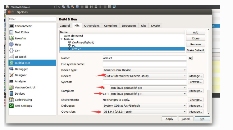

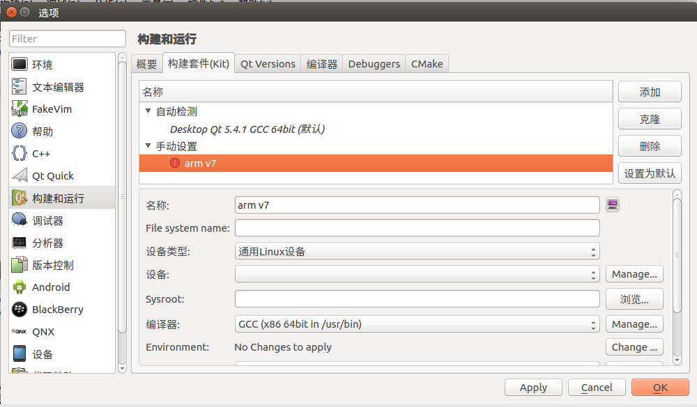

我直接用的.run装的qt,为什么构建kit里面找不到ARM v7?是qt-creator-opensource才行?

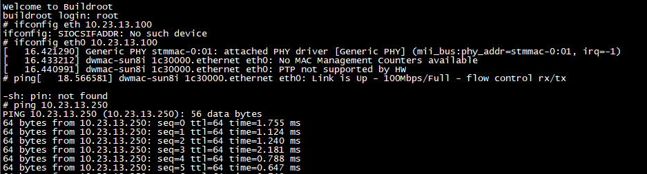

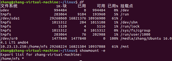

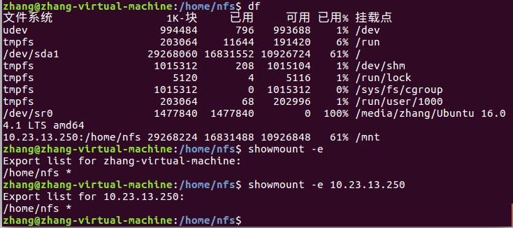

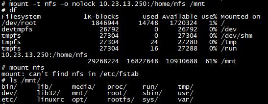

在tf卡启动情况下,挂载nfs服务器是成功的,可以在/mmt目录下看到服务器的文件,可以ping通nfs服务器,但是u-boot命令行ping不通nfs服务器你的 bootargs 是什么?
setenv bootargs root=/dev/nfs nfsroot=10.23.13.250:/home/nfs ip=10.23.13.100:10.23.13.250:10.23.13.1:255.255.252.0::ens33:off init=/linuxrc console=ttyS0,115200 其中10.23.13.250是ubuntu ip地址(nfs服务器地址),10.23.13.100是我在u-boot命令行中的ip地址,10.23.13.1是gatewayip地址,255.255.252.0是netmask,ens33是网卡名字,
可以看下有没有设置错误,
晕哥 说:这是我编译好的带以太网的u-boot: u-boot-sunxi-with-splethernet.7z
能不能用都可以到本帖反馈。
跟着教程走了一遍,也用了你提供的u-boot试了下
都不能使用以太网都是这样的
https://whycan.cn/files/members/449/QQ20180206112609.png
我安装流程走,在编译u-boot的时候dts文件出现警告,不知道有没有影响,也是u-boot ping不通,kernel可以ping通
首先,能ping通那台nfs服务器吗?
[ 13.852036] #0: V3s Audio Codec
[ 109.926782] VFS: Unable to mount root fs via NFS, trying floppy.
[ 109.933356] VFS: Cannot open root device "nfs" or unknown-block(2,0): error -6
[ 109.940677] Please append a correct "root=" boot option; here are the available partitions:
[ 109.949050] b300 1932288 mmcblk0
[ 109.949056] driver: mmcblk
[ 109.955851] b301 20480 mmcblk0p1 adb9da71-01
[ 109.955854]
[ 109.962669] b302 1909760 mmcblk0p2 adb9da71-02
[ 109.962672]
[ 109.969478] Kernel panic - not syncing: VFS: Unable to mount root fs on unknown-block(2,0)
[ 109.977734] CPU: 0 PID: 1 Comm: swapper/0 Not tainted 4.13.16-licheepi-zero+ #6
[ 109.985030] Hardware name: Allwinner sun8i Family上面的启动信息显示挂载nfs没成功,ping通nfs服务器是在u-boot命令行下进行ping?下面是nfs服务器的挂载情况

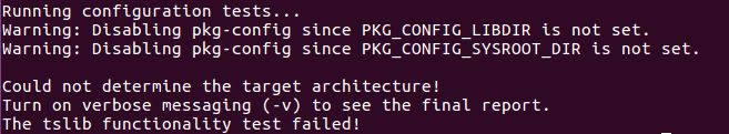

但是在进行./configure --host=arm-linux-gnueabihf --cache-file=tmp.cache --prefix=/opt/tslib CC=/opt/gcc-linaro-6.3.1-2017.05-x86_64_arm-linux-gnueabihf/bin/arm-linux-gnueabihf-gcc
make时出现以下错误
zhang@zhang-virtual-machine:~/tslib$ ./configure --host=arm-linux-gnueabihf --cache-file=tmp.cache --prefix=/opt/tslib CC=/opt/gcc-linaro-6.3.1-2017.05-x86_64_arm-linux-gnueabihf/bin/arm-linux-gnueabihf-gcc
configure: loading cache tmp.cache
checking for a BSD-compatible install... /usr/bin/install -c
checking whether build environment is sane... yes
checking for arm-linux-gnueabihf-strip... arm-linux-gnueabihf-strip
checking for a thread-safe mkdir -p... /bin/mkdir -p
checking for gawk... no
checking for mawk... mawk
checking whether make sets $(MAKE)... yes
checking whether make supports nested variables... yes
checking whether make supports nested variables... (cached) yes
checking build system type... x86_64-pc-linux-gnu
checking host system type... arm-unknown-linux-gnueabihf
checking for arm-linux-gnueabihf-gcc... /opt/gcc-linaro-6.3.1-2017.05-x86_64_arm-linux-gnueabihf/bin/arm-linux-gnueabihf-gcc
checking whether the C compiler works... no
configure: error: in `/home/zhang/tslib':
configure: error: C compiler cannot create executables
See `config.log' for more details
zhang@zhang-virtual-machine:~/tslib$ make
make: *** 没有指明目标并且找不到 makefile。 停止。是需要修改./configure --host=arm-linux-gnueabihf --cache-file=tmp.cache --prefix=/opt/tslib CC=/opt/gcc-linaro-6.3.1-2017.05-x86_64_arm-linux-gnueabihf/bin/arm-linux-gnueabihf-gcc编译命令?

zhang@zhang-virtual-machine:/home/share$ arm-linux-gnueabihf-gcc -o test rectangles.c -I/usr/include/cairo -lcairo -lts
rectangles.c:24:19: fatal error: tslib.h: 没有那个文件或目录
compilation terminated.是需要先移植tslib?http://zero.lichee.pro/%E5%BA%94%E7%94%A8/QT_doc1.html

# ls -l
total 216
-rwxr-xr-x 1 root root 28296 Jan 1 1970 tinymix
-rw-r--r-- 1 root root 33920 Jan 1 00:14 tinyplay
-rw-r--r-- 1 root root 152044 Jan 1 1970 usersound.wav
# ./tinymix contents
./tinymix: line 1: syntax error: unexpected "("这是在板子上的文件,看文件大小应该是同一个文件,文件大小是和笔记本上一样的,
https://whycan.cn/files/members/3/QQ20171128142743.png
再次验证, 一点问题都没有。
这上面晕哥的操作不是从192.168.1.99中移植tinymix和tinyplay?.......然后运行?
chmod +x tinymix
记得找本 linux 入门书看一看哦
我是先将tinymix tinyplay通过winscp移到windows上,然后再通过tftp32.exe 把文件移植到板子上,这样的方法tinyplay可以在板子上运行吗?
-sh: ./tinymix: Permission denied
# chmod 777 tinymix
# ls
tinymix tinyplay usersound.wav
./tinymix: line 1: syntax error: unexpected "("......我感觉我移植方法有点问题

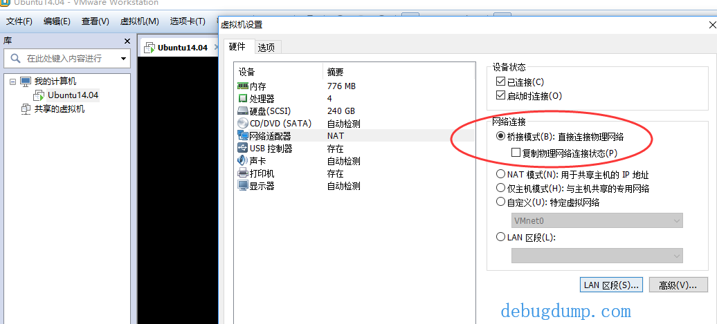

把网络设置为桥接模式, 然后再把Ubuntu IP 设置为 169.254.63.xxx
ifconfig
ens33 Link encap:以太网 硬件地址 00:0c:29:ac:39:d3
inet 地址:169.254.63.180 广播:169.254.255.255 掩码:255.255.0.0
inet6 地址: fe80::576f:3c2:f239:2785/64 Scope:Link
UP BROADCAST RUNNING MULTICAST MTU:1500 跃点数:1
接收数据包:4453 错误:0 丢弃:0 过载:0 帧数:0
发送数据包:210 错误:0 丢弃:0 过载:0 载波:0
碰撞:0 发送队列长度:1000
接收字节:396682 (396.6 KB) 发送字节:32760 (32.7 KB)
lo Link encap:本地环回
inet 地址:127.0.0.1 掩码:255.0.0.0
inet6 地址: ::1/128 Scope:Host
UP LOOPBACK RUNNING MTU:65536 跃点数:1
接收数据包:260 错误:0 丢弃:0 过载:0 帧数:0
发送数据包:260 错误:0 丢弃:0 过载:0 载波:0
碰撞:0 发送队列长度:1
接收字节:21472 (21.4 KB) 发送字节:21472 (21.4 KB)开发板还是只能跟笔记本ping通,而且ubuntu和笔记本的ping不通 笔记本ip地址为169.254.63.187 开发板IP地址169.254.63.160

25 INT 2 Playback Channel Map 0, 0 (range 0->36)605364021 说:晕哥 说:参考这个帖子: https://whycan.cn/t_490.html
或者论坛搜 tinyplay, tinymix 找别的帖子.
./tiny contents 里面不存在headphone选项怎么办..?我看好多帖子都是说要将headphone寄存器打开
那就是版本不对,确认是否 4.13分支
https://whycan.cn/files/members/1205/_20181026185947.jpg
我git clone 的是4.13分支......

linux下设置网关有专门的命令:
route add default gw 192.168.0.xxx
还有就是进行ping操作的时候 v3s板子需要接上网线?
我接上路由器网线就
# route
Kernel IP routing table
Destination Gateway Genmask Flags Metric Ref Use Iface
192.168.1.0 * 255.255.255.0 U 0 0 0 eth0
# [ 257.926361] dwmac-sun8i 1c30000.ethernet eth0: Link is Up - 100Mbps/Full - flow control rx/txV3s地址:192.168.1.100
子网掩码:255.255.255.0如果你不设置网关的情况下,是不能ping通 ping 10.23.14.63
只能ping通: 192.168.1.1 - 192.168.1.254

# ifconfig eth0 up
[ 32.627544] Generic PHY stmmac-0:01: attached PHY driver [Generic PHY] (mii_bus:phy_addr=stmmac-0:01, irq=-1)
[ 32.639435] dwmac-sun8i 1c30000.ethernet eth0: No MAC Management Counters available
[ 32.647233] dwmac-sun8i 1c30000.ethernet eth0: PTP not supported by HW
# ifup eth0
ifup: ignoring unknown interface eth0
# [ 97.666629] random: crng init done
# ifconfig eth0 192.168.1.100
# ifconfig
eth0 Link encap:Ethernet HWaddr 02:00:91:F6:8D:99
inet addr:192.168.1.100 Bcast:192.168.1.255 Mask:255.255.255.0
UP BROADCAST MULTICAST MTU:1500 Metric:1
collisions:0 txqueuelen:1000
RX bytes:0 (0.0 B) TX bytes:0 (0.0 B)
Interrupt:38
lo Link encap:Local Loopback
inet addr:127.0.0.1 Mask:255.0.0.0
UP LOOPBACK RUNNING MTU:65536 Metric:1
# ping 10.23.14.63
PING 10.23.14.63 (10.23.14.63): 56 data bytes
ping: sendto: Network is unreachable我在串口助手上进行ping操作,请问怎么才知道v3s的网卡是正常工作?ping的地址应该是ping什么地址,v3s需要接网线吗?

荔枝派Zero 开发板网卡确认没有问题:
https://whycan.cn/files/members/3/QQ20171215150950.jpg你试一试, 有什么问题在后面跟帖。

# ifconfig eth0 up
ifconfig: SIOCGIFFLAGS: No such devicesetenv ipaddr 192.168.126.100
