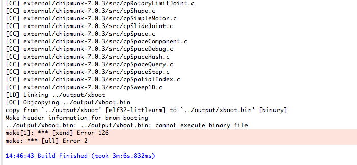

解决了第一个问题,我在macos上,所以我添加了mksunxi,但是仍然存在MKZ问题,提供的版本仅在linux上有效,无法在macos上执行,并且未提供源文件。 应该提供MKZ的源文件和makefile,以便我们至少可以在macOS上构建它
copy from `../output/xboot' [elf32-littlearm] to `../output/xboot.bin' [binary]
Make header information for brom booting
bootloader size= 2200
The bootloader head has been fixed
/bin/sh: arch/arm32/mach-f1c100s/tools/linux/mkz: cannot execute binary file
make[1]: *** [xend] Error 126
make: *** [all] Error 2

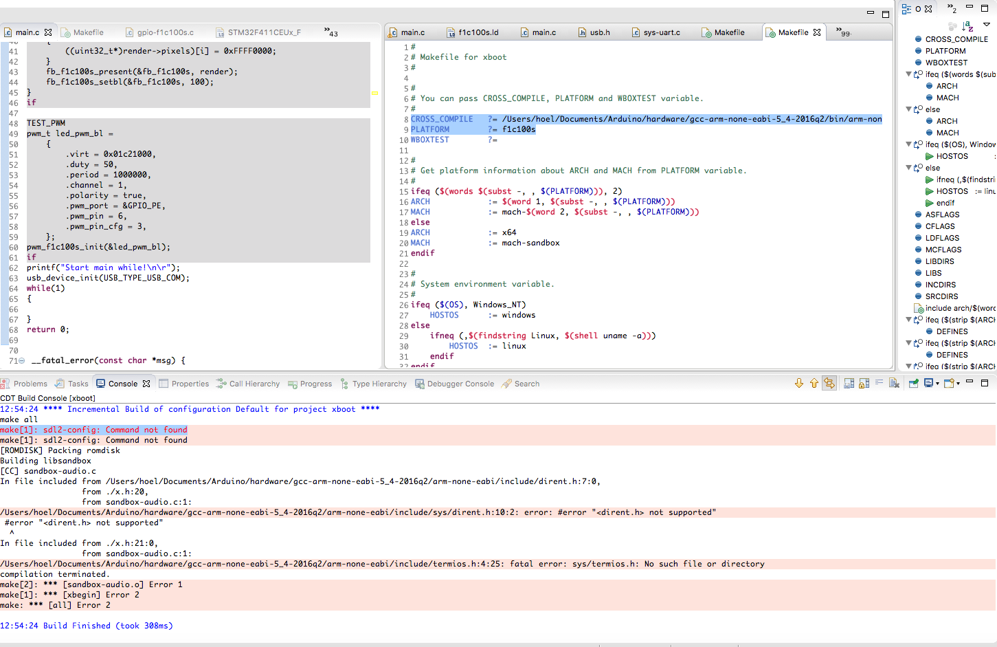

#62 Re: 全志 SOC » 裸机F1C100S,USB HOST + DMA,Eclipse,链接器和启动文件需要帮助 » 2020-05-29 21:09:09
改为:
PLATFORM ?=arm32-f1c100s
最终失败,我尝试了F1C100S上的二进制文件,它不起作用,UART上没有任何内容

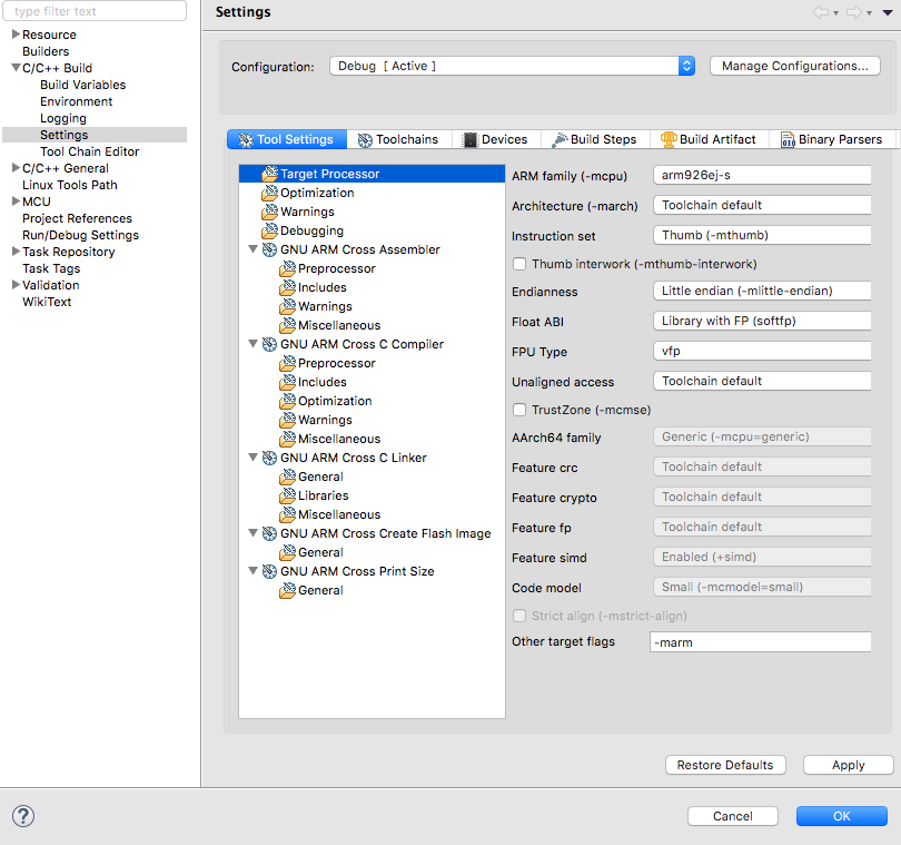

下载了官方文件,打开了Eclipse项目,设置PLATFORM和CROSS_COMPILE,甚至无法构建...

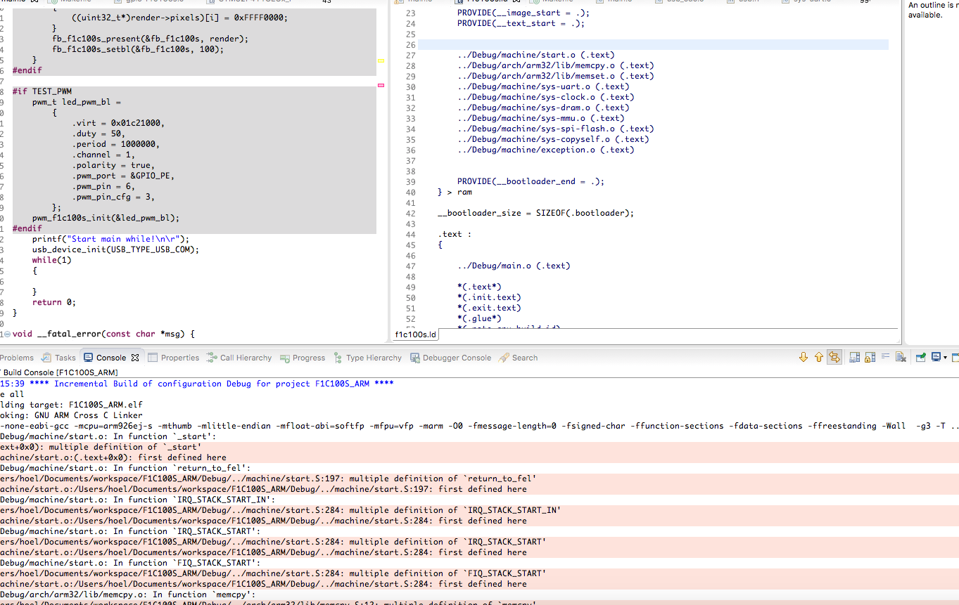

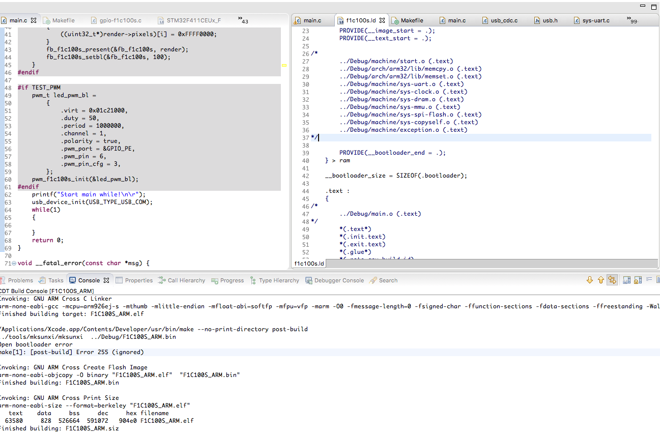

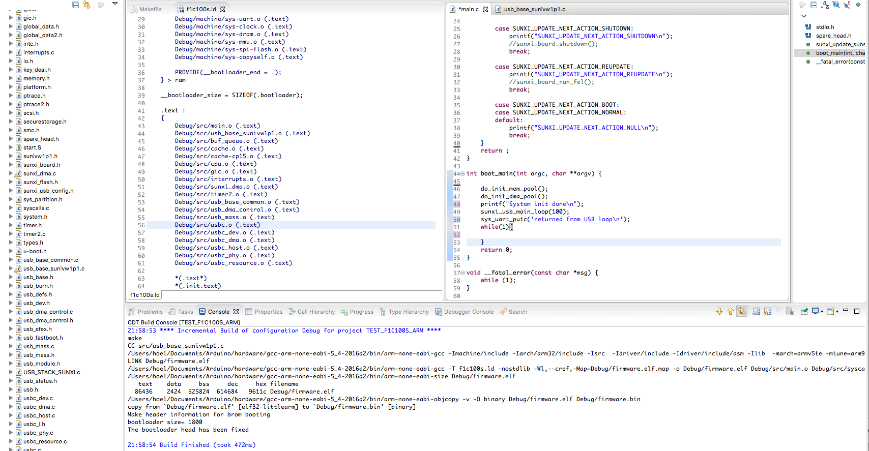

The USB stack already has the interrupt framework. I fear It will take a lot of efforts to adapt the USB stack to xboot, i want to avoid that, the stack is already working standalone, the only adaptation is the f1c100s.ld linker file. I made good progress yesterday, now the Eclipse project can compile and produce the .hex and .bin, the only remaining problem is to adapt the linker file f1c100s.ld, because currently it includes some object fils (.0) and Eclipse is not happy about it ("multiple definition of ..." error).

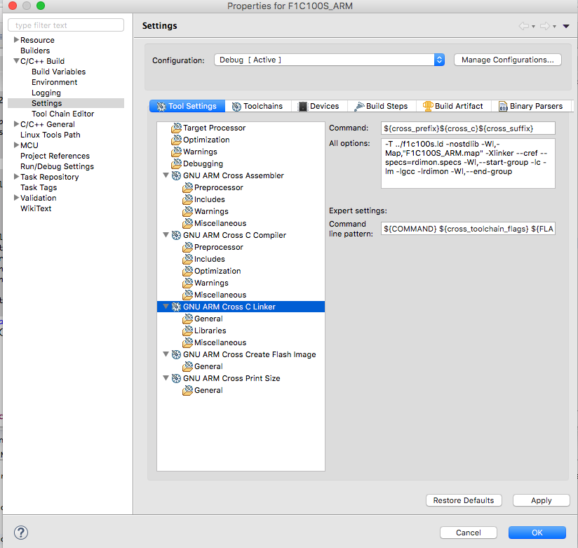

If i comment the included .o files in f1c100s.ld then the linking is successful.
USB堆栈已具有中断框架。 恐怕要使USB堆栈适应xboot会花费很多精力,我想避免这种情况,该堆栈已经可以独立工作,唯一的适应是f1c100s.ld链接器文件。 我昨天取得了良好的进展,现在Eclipse项目可以编译并生成.hex和.bin,唯一剩下的问题是改编链接器文件f1c100s.ld,因为当前它包含一些对象fils(.0),而Eclipse没有。 很高兴(“ ...的多个定义”错误)。
如果我注释了包含的.o文件,则链接成功。
原始的f1c100s.ld
带有.o的f1c100s.ld进行了评论
项目设置

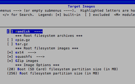

One concern is that there is no jffs2 option when i check in OpenWRT menuconfig:

Of course i also end-up with a working toolchain for F1C100S on OSX !
So I made a template for Eclipse to test it, and as expected it works perfectly.
当然,我最后也得到了一个在OSX上用于F1C100的工作工具链!
所以我为Eclipse制作了一个模板来测试它,正如预期的那样,它工作得很好。
04:25:22 **** Incremental Build of configuration Debug for project F1C100S_TEMPLATE ****
make all
Building target: F1C100S_TEMPLATE
Invoking: Cross GCC Linker
arm-openwrt-linux-muslgnueabi-gcc  -o "F1C100S_TEMPLATE"  ./src/termios_cdc_acm/epoll2.o  ./src/libs/gpio.o ./src/libs/gpiolib.o ./src/libs/spi.o ./src/libs/sqlite3.o  ./src/gsm_serial.o
Finished building target: F1C100S_TEMPLATE
04:25:23 Build Finished (took 509ms)
Big thanks to @Quotation, @Mango and @晕哥 for the help with this, it very nice to have a working toolchain on OSX for this target.

If anyone has some ideas about what i should do to adjust OpenWRT image generation for 16M flash or to build the official Lichee Pi Nano with the new toolchain, please let me know. Once everything is working fine i will make a new subject that give all the steps to :
-get working toolchain for F1C100S on OSX
-get working OpenWRT for F1C100S on OSX (with flash image)
-get working Lichee Pi Nano linux on OSX
-setup Eclipse or another IDE to build and debug applications on F1C100S for linux directly from OSX (debug via wifi)
Thank you.
如果有人对我应该做些什么来调整16M闪存的openwrt图像生成或者用新的工具链构建官方的lichee pi nano有什么想法,请告诉我。一旦一切正常,我将提出一个新的主题,给出所有步骤:
-在OSX上获取F1C100S的工作工具链
-在OSX上获取F1C100S的工作openwrt(带Flash图像)
-在OSX上运行Lichee Pi Nano Linux
-设置Eclipse或其他IDE,以便直接从OSX(通过WiFi进行调试)在F1C100S上为Linux构建和调试应用程序。
谢谢您。
