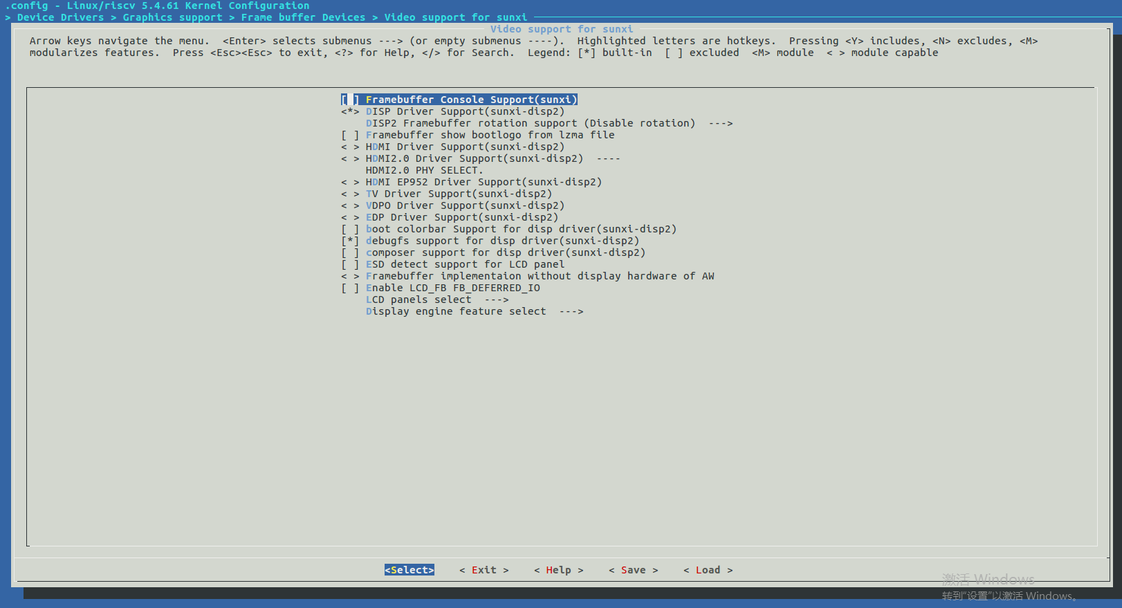

#6 Re: 全志 SOC » D1s/f133-B 跑tina linux,有fb0设备,但是未执行LCD初始化函数 » 2022-04-29 11:13:00
修改了uboot的屏驱动和设备树,就可以初始化了,这样的话不就是内核里面的屏驱动没起作用

#9 Re: 全志 SOC » D1s/f133-B 跑tina linux,有fb0设备,但是未执行LCD初始化函数 » 2022-04-28 16:25:58
根据log定位到drivers/video/fbdev/sunxi/disp2/disp/dev_disp_debugfs.c中:
int dispdbg_init(void)
	my_dispdbg_root = debugfs_create_dir("dispdbg", NULL);
        printk(KERN_INFO "[%s] %s: %d\n", __FILE__, __FUNCTION__, __LINE__);
	if (!debugfs_create_file
	    ("command", 0644, my_dispdbg_root, NULL, &command_ops))
		goto Fail;
	    ("name", 0644, my_dispdbg_root, NULL, &name_ops))
		goto Fail;
	    ("start", 0644, my_dispdbg_root, NULL, &start_ops))
		goto Fail;
	    ("param", 0644, my_dispdbg_root, NULL, &param_ops))
		goto Fail;
	    ("info", 0644, my_dispdbg_root, NULL, &info_ops))
		goto Fail;
		("dbglvl", 0644, my_dispdbg_root, NULL, &dbglvl_ops))
		goto Fail;
#if defined(CONFIG_SUNXI_MPP)
	if (debugfs_mpp_root) {
		if (!debugfs_create_file("vo", 0644, debugfs_mpp_root, NULL,
					 &vo_ops))
			goto Fail;
#endif /*endif CONFIG_SUNXI_MPP */
Fail:
	debugfs_remove_recursive(my_dispdbg_root);
	my_dispdbg_root = NULL;
	return -ENOENT;
static const struct file_operations start_ops = {
	.write = dispdbg_start_write,
	.read = dispdbg_start_read,
	.open = dispdbg_start_open,
	.release = dispdbg_start_release,
static ssize_t dispdbg_start_write(struct file *file, const char __user *buf,
				   size_t count, loff_t *ppos)
	if (count >= sizeof(dispdbg_priv.start))
	if (copy_from_user(dispdbg_priv.start, buf, count)) {
		pr_warn("copy_from_user fail\n");
	if (dispdbg_priv.start[count - 1] == 0x0A)
		dispdbg_priv.start[count - 1] = 0;
	else
		dispdbg_priv.start[count] = 0;
	dispdbg_process();
	return count;
static void dispdbg_process(void)
    if (!strncmp(dispdbg_priv.command, "enable", 6)) {
          lcd->enable(lcd);
调用的层次是
dispdbg_init()
        ("start", 0644, my_dispdbg_root, NULL, &start_ops));
            dispdbg_start_write();
                dispdbg_process();
                        lcd->enable(lcd);
在lcd->enable(lcd)中最后会调用到LCD_panel_init函数;
log看到的是只执行了:
start_ops里的.wrire函数dispdbg_start_write没有执行到,导致了LCD_panel_init函数没有被执行;
是要在应用程序里面操作fb0设备才会执行dispdbg_start_write 进行初始化?
但是用cat /dev/urandom > /dev/fb0 并没有看到dispdbg_start_write被执行到的log;
#11 全志 SOC » D1s/f133-B 跑tina linux,有fb0设备,但是未执行LCD初始化函数 » 2022-04-27 16:58:23
岁月快快快
回复: 8
如题,用d1s点一块4寸的720x720的spi屏,系统跑起来后,能看到fb0设备,但是用GPIO模拟spi发命令和数据的引脚上没有量到有波形,一直是高电平,log也没看到跑进过LCD_panel_init函数;

static void LCD_panel_init(u32 sel)
    printk(KERN_INFO "=====================LCD_panel_init\n");
LCD_panel_init函数里面有加了打印信息,但是log里面没看到有打印出来,模拟spi的IO口上也没有量到有波形,说明并未跑进LCD_panel_init函数;
打印log:

debug 串口用的是uart0 PE2 PE3;
量了RX脚,是通的;
在uboot里面配置bootargs变量,设置串口0为终端,也没有起作用;
有大佬知道是哪里没设置好吗?
