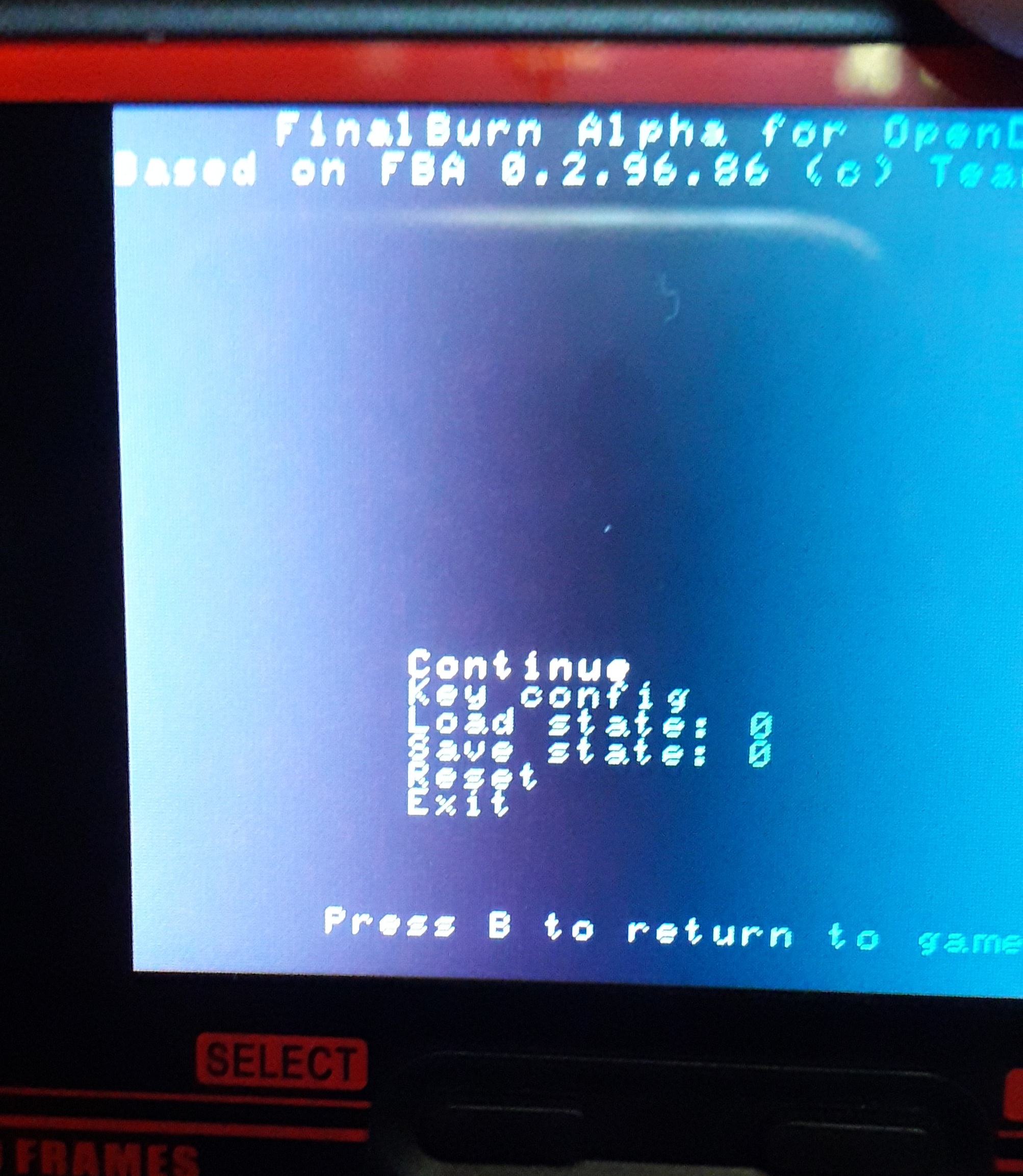

What? You mean fba? I was playing a game and wanted load another rom, but "I" menu key did nothing.
I compiled the kernel source from you via wget from your github

As I known, it should be "SELECT + START + L" for FBA menu.

I press START+SELECT and i got this menu, thank you for the hint.

You can try latest port of the FBA: https://github.com/Rezzy-dev/fba-miyoo-playable/releases/tag/release
It fixes some stuff and you can open Menu with RESET button. For recompiling use Miyoo toolchain from steward's repo.

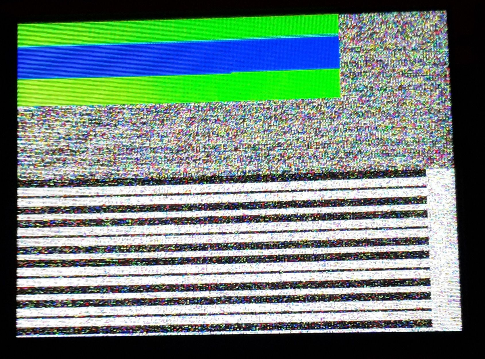

Yeah, me hahaha, i only need the display initial code as i learned.
I tried your lcd test image and i got garbage on screen, ips linux image shows nothing only backlight.
I must see how i can read the flash, in circuit or desolder it and try to solder pins on or something, as i do not have such adapter.

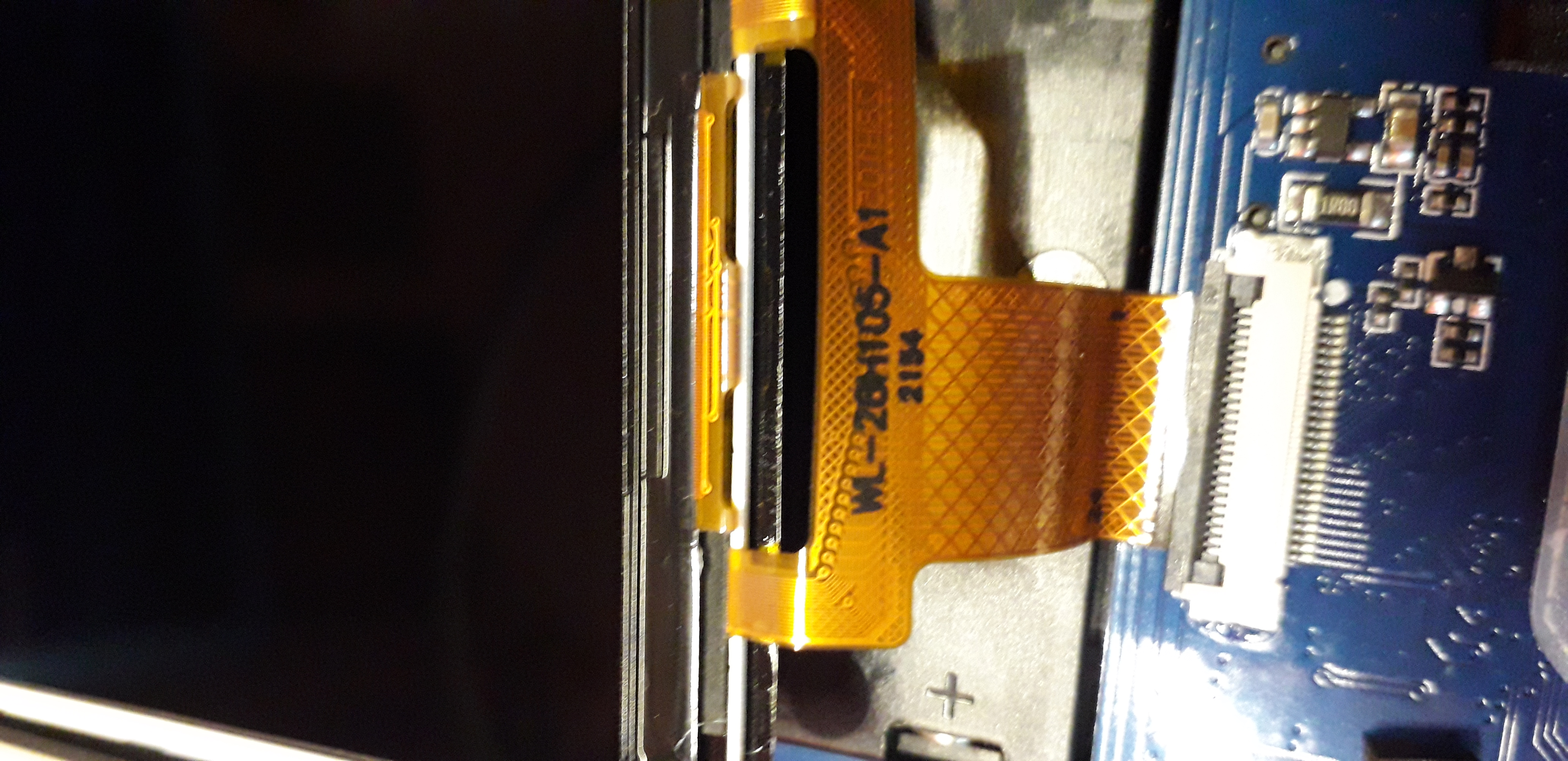

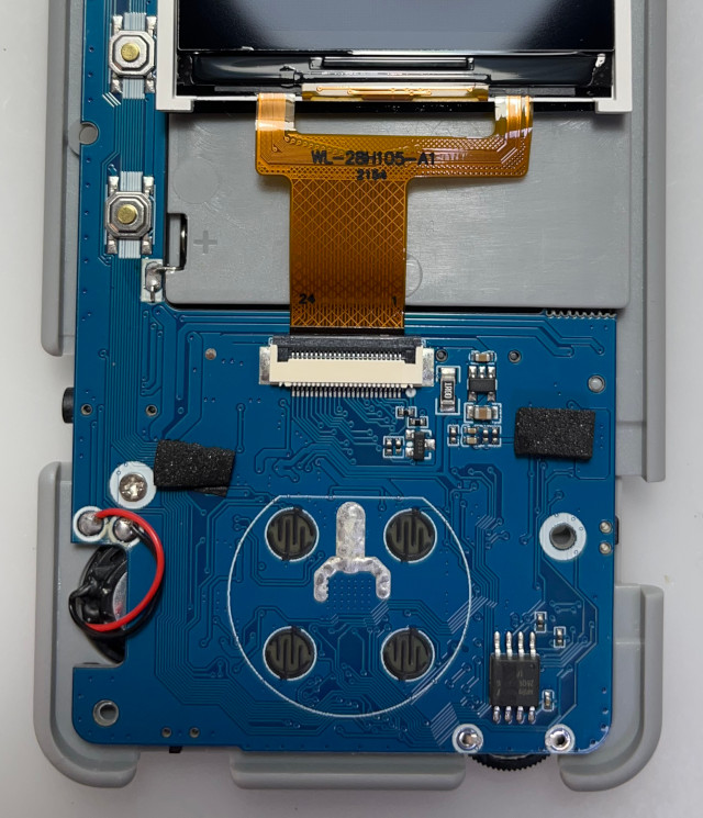

#1019 2022-09-05 22:44:16
neotendo
注册时间: 2022-08-19
已发帖子: 180
积分: 203
Re: 研究FC3000掌機的開源可行性

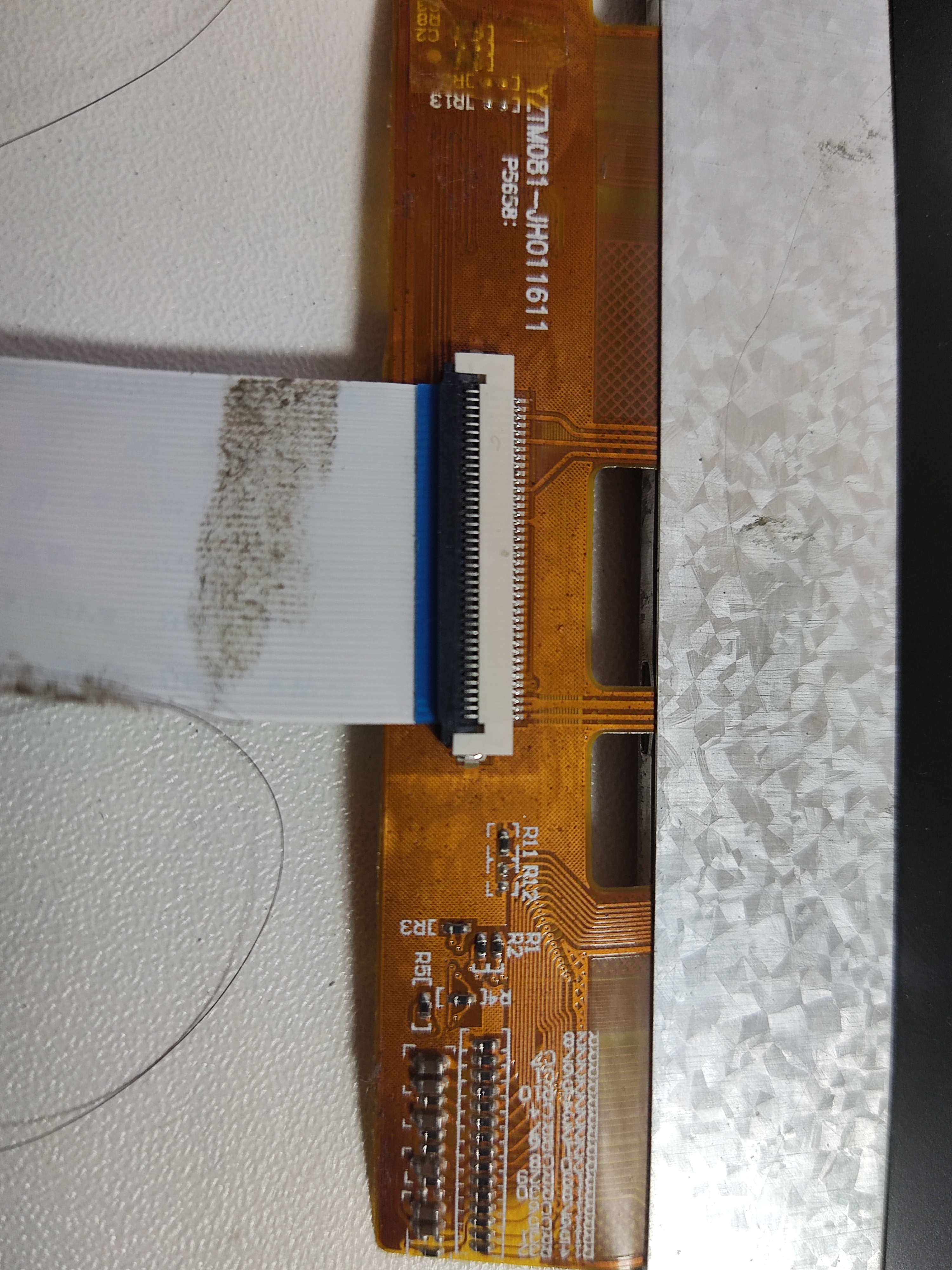

@Situ
I see it coming and i need your help at the end again 😄
Disasembled the FC3000, found nothing about the LCD (WL-26 or 28 H105-A1)
最近编辑记录 neotendo (2022-09-05 23:29:18)
#1020 2022-09-06 12:41:24
neotendo
注册时间: 2022-08-19
已发帖子: 180
积分: 203
Just saw you already have an wl-28h105-a1 stock dump on github. Only need to figure out what driver this display use

The possible way to initialize the LCD panel properly is to collect all of LCD models and then try each initial code on this device.

i tried already some init codes, only st7789 in swap RB order give me some garbage on screen and i can see that your test program tries to write data on the left side (the RGB stripes), but they are all Black and White

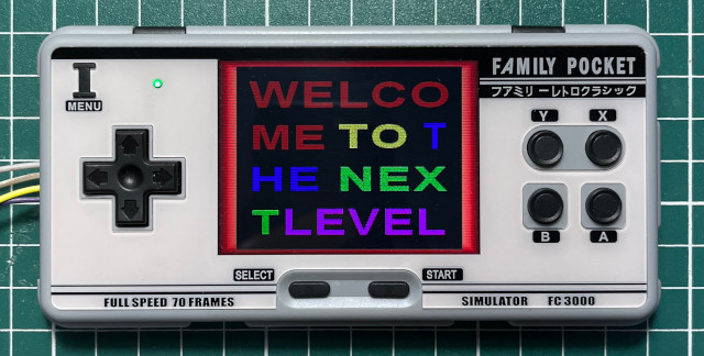

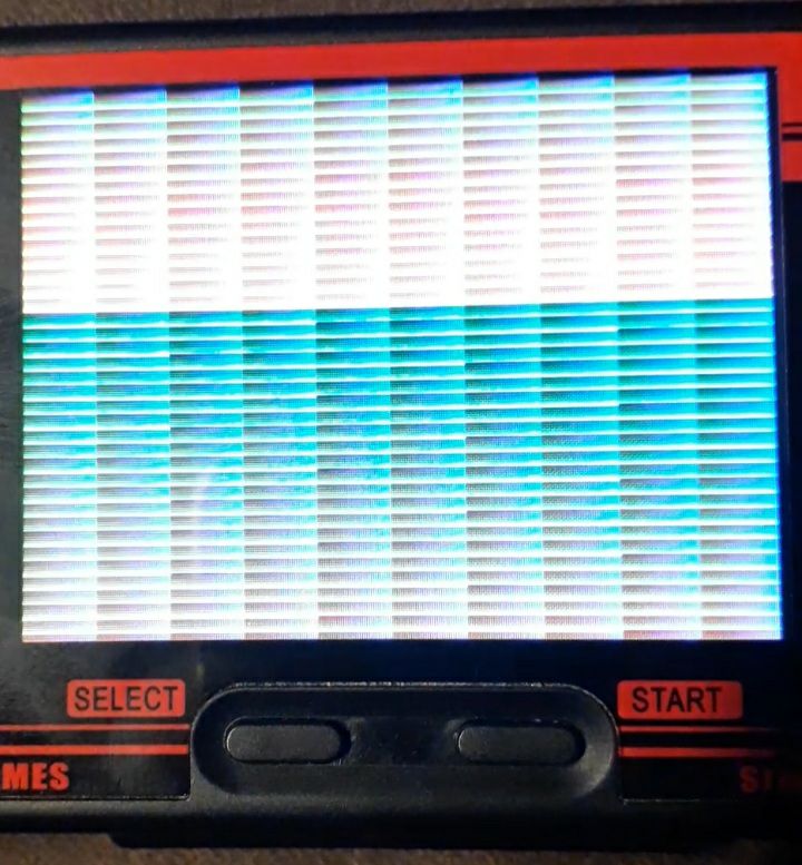

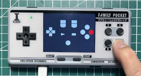

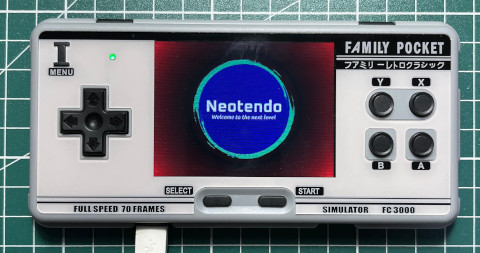

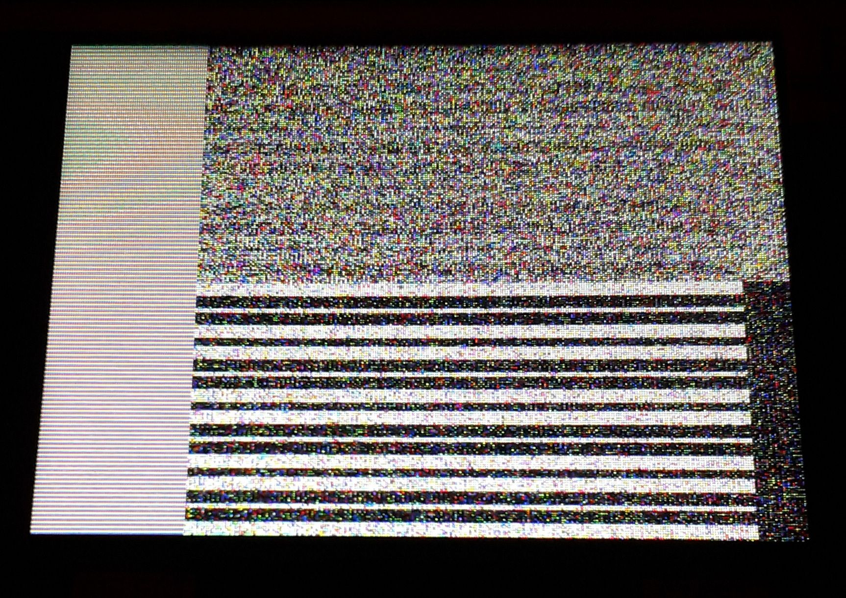

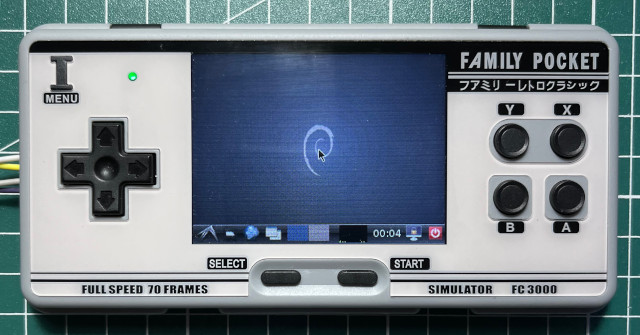

#1025 2022-09-06 17:20:09
neotendo
注册时间: 2022-08-19
已发帖子: 180
积分: 203

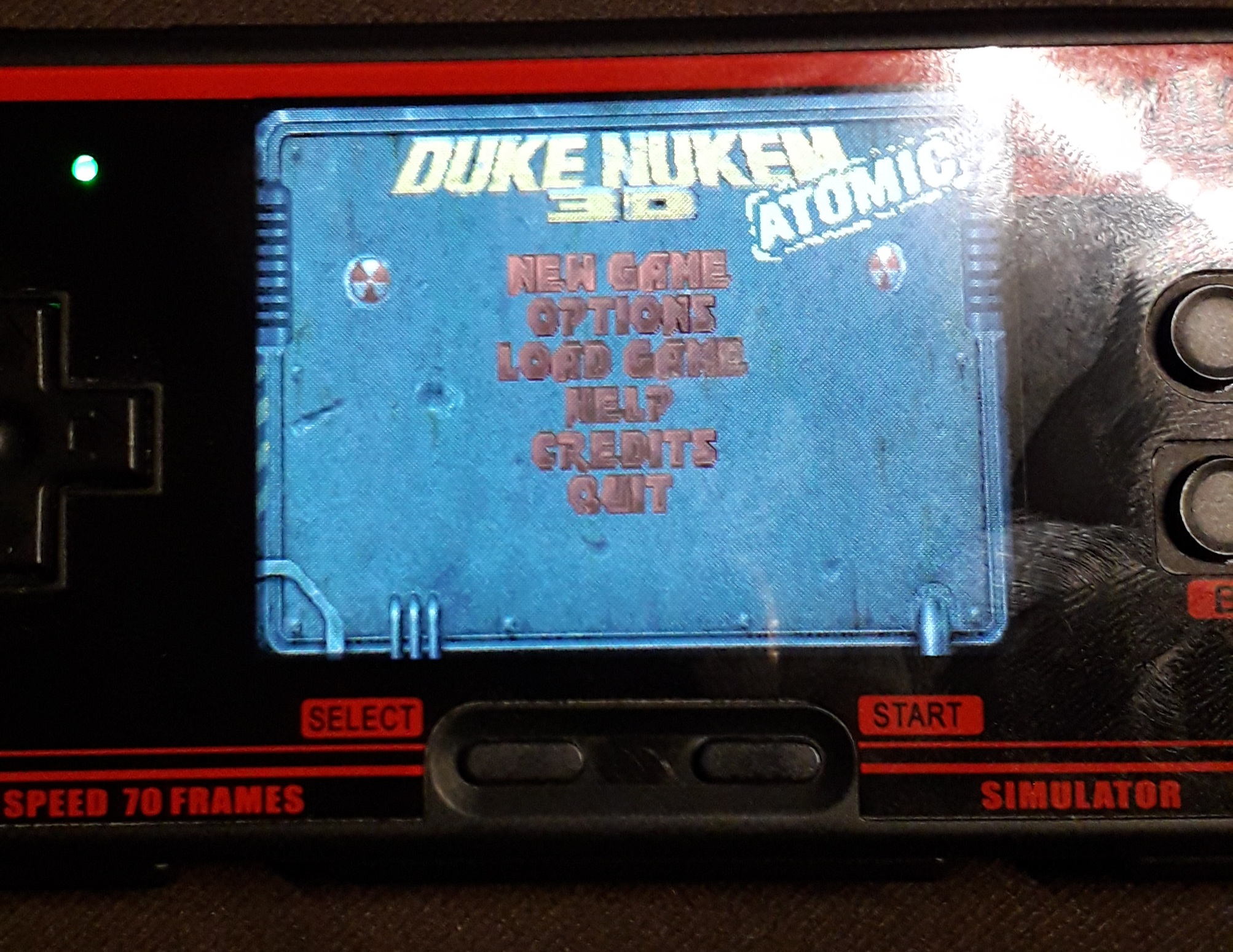

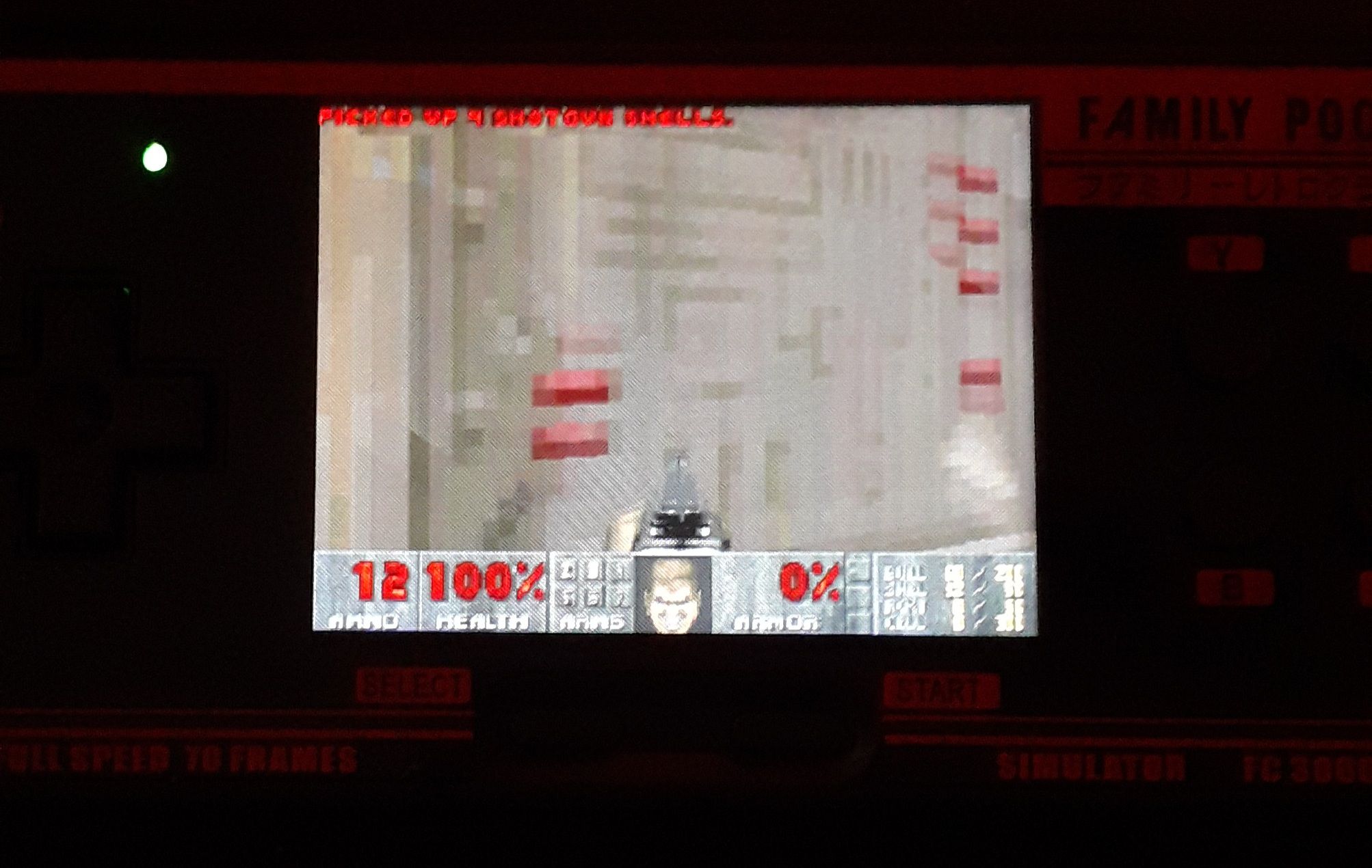

Update: Looks like a i am on the right track, shot was taken during RGB Stripes Drawing. I edit the ST7789 initial code in RB Swap order.
楼主 #1026 2022-09-06 17:47:52
司徒
注册时间: 2020-02-13
已发帖子: 547
积分: 157
Hero ~ cool

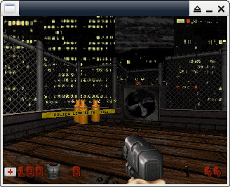

#1027 2022-09-06 18:13:53
neotendo
注册时间: 2022-08-19
已发帖子: 180
积分: 203
@Situ
Thank you very much <3
I present you..... DOOM runing on the FC3000 V2 IPS (WL-28H105-A1) but guess what, the buttons are mapped different or my keyboard.c code is messed up.
feels like L1 is strafe left and SELECT, R1 is strafe right and START at the same time in Doom.
START and SELECT do nothing in Doom.
and I noticed with both FC3000 that the image has tearing, as if no vsync is on or something. can we fix that?
最近编辑记录 neotendo (2022-09-06 18:51:13)
楼主 #1028 2022-09-06 19:44:59
司徒
注册时间: 2020-02-13
已发帖子: 547
积分: 157
Wow, amazing !
Since such LCD panel lacks of tearing signal, it is not possible to fix.
I think you have done the best thing that Linux OS can run on FC3000 handheld and you also extended their life, lol lol ~
#1029 2022-09-06 19:54:46
neotendo
注册时间: 2022-08-19
已发帖子: 180
积分: 203
司徒 wrote:
Wow, amazing !
the stock rom seems to run faster or something, there is less tearing (it seems to me atleast).
i love the aspect that linux is running on this device, you can run X11 or simething also in theory.
SNES emulation is a bit slow, whyever, but you can now play all other things on this device.
thank you so much for your help and warm words <3
i will upload a new linux image when i get the keypad working correctly
最近编辑记录 neotendo (2022-09-06 19:57:08)

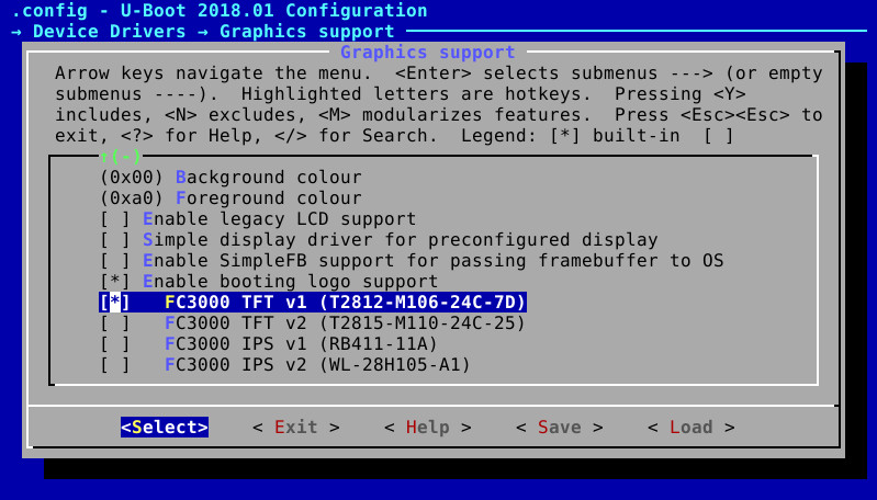

楼主 #1034 2022-09-08 07:29:07
司徒
注册时间: 2020-02-13
已发帖子: 547
积分: 157
@Aksenenkoav1990
Basically, you can build uboot and kernel from scratch.
These logos have been removed from source code.
Source: https://github.com/steward-fu/fc3000
#1035 2022-09-08 13:09:56

I tried to display a logo, but somehow it didn't work.
楼主 #1037 2022-09-08 13:26:42

As I remembered, this image is shown from kernel. It has been removed from kernel source already, hasn't it ?

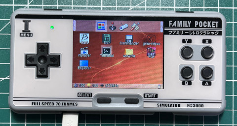

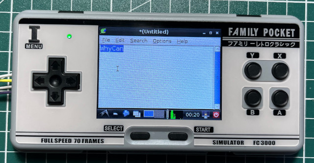

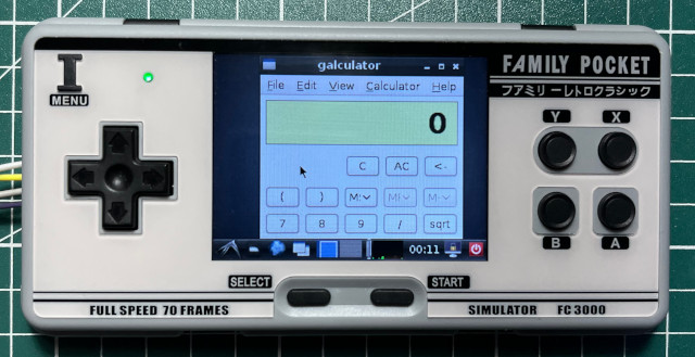

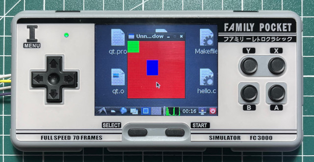

楼主 #1038 2022-09-08 13:36:40
司徒
注册时间: 2020-02-13
已发帖子: 547
积分: 157
run X11 ? it sounds very interesting !
Here is another project that use MT7688 processor: https://whycan.com/t_8714.html
I would like to run X11 (Debian OS) on that device.
So, it is worthy to study how to run X11 on framebuffer driver.
But in order to run X11, some kernel configurations need to be turned on, ex: network.
I think I can buy FC3000 IPS handheld again and try X11 on it. lol lol
@neotendo
I am curious about what kind of game/application needs X11 ? or why did you want X11 runs on FC3000 ?
#1039 2022-09-08 16:30:06
neotendo
注册时间: 2022-08-19
已发帖子: 180
积分: 203
@司徒
i do not want X11, it is an option for someone who is able to code linux. this device is allready open now and is running linux, in theory X11 on framebuffer should be doable, but i do not need it.
PS: just got the keypad working correctly now.
only thing i could need is how to enable boot logo again, i tried many things, but no logo was shown during boot
楼主 #1040 2022-09-08 18:05:05
司徒
注册时间: 2020-02-13
已发帖子: 547
积分: 157
@neotendo

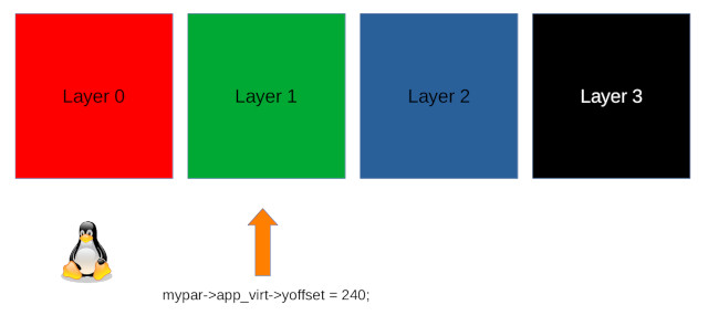

In framebuffer driver, I switched display layer from layer-0 to layer-1 as the following image shown:
Linux logo is always displayed on layer-0 when framebuffer driver is probed.
If you would like to show starting logo on LCD panel, here are the places you need to modify:
drivers/video/fbdev/sunivfb.c
954   mypar->app_virt->yoffset = 0;
1172   fb_prepare_logo(info, 0);
1173   fb_show_logo(info, 0);
P.S. You also need to turn Linux Logo on in kernel menu configuration.
#1041 2022-09-08 19:36:33
neotendo
注册时间: 2022-08-19
已发帖子: 180
积分: 203
@司徒
Unfortunately it doesn't work, the screen only gets light up shortly before the menu.
nano suniv_defconfig -> CONFIG_LOGO=y, menuconfig enabled logo.
sunivfb.c
static void lcd_delay_init( XX )
//memcpy((uint8_t)mypar->vram_virt + (320 240 2 1), hex_splash, 320 240 2);
// Enable Boot Logo
//mypar->app_virt->yoffset = 240; // Disable
mypar->app_virt->yoffset = 0; // Enable
static int myfb_probe( XXX )
// Boot Logo
setup_timer(&mytimer, lcd_delay_init, 0);
mod_timer(&mytimer, jiffies + HZ);
device_create_file(&device->dev, &dev_attr_variant);
最近编辑记录 neotendo (2022-09-08 19:37:54)
楼主 #1042 2022-09-09 13:34:49
司徒
注册时间: 2020-02-13
已发帖子: 547
积分: 157
@neotendo
There is another way to show boot logo.
Just uncomment "memcpy" line and then provide "hex_splash" data.
Here is the example to demonstrate how to convert png/jpg into pixel array (hex_splash):
https://github.com/steward-fu/q8/releases/download/v1.1/png2hex.c
How to use:
$ gcc png2hex.c -o test -I/usr/include/SDL -lSDL -lSDL_image
$ ./test xxx.jpg > hex_splash.h
#1043 2022-09-09 17:03:06

#1044 2022-09-09 19:01:43
neotendo
注册时间: 2022-08-19
已发帖子: 180
积分: 203
@Situ
yes, the boot logo is only displayed for a very short time when Gmenu starts, before that my background lighting is not on.
at which point in the source code is the backlight activated?
楼主 #1045 2022-09-09 19:20:40
司徒
注册时间: 2020-02-13
已发帖子: 547
积分: 157
@neotendo
Yes, in order to prevent flicking, which some LCD panels show white color when RESET is active, it is turned off in uboot and framebuffer initialization stages. So, you also need to set backlight level in device tree:
kernel/arch/arm/boot/dts/fc3000.dts
27     default-brightness-level = <0>;
#1046 2022-09-09 20:32:36
neotendo
注册时间: 2022-08-19
已发帖子: 180
积分: 203
@司徒
no, sadly did not work either.

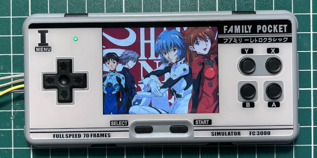

tft - screen flashes bright shortly, blackscreen/no backlight, logo flashes shortly before gmenu starts.
ips -screen flashes shortly but dimmed, blackscreen/no backlight, logo flashes shortly before gmenu starts.
i think there must be a (backlight on/off) command somewhere in the code.
ps: my logo seems a 24bit image, must create a 16bit.
https://youtu.be/mTNIlMzeqyE
最近编辑记录 neotendo (2022-09-09 20:35:51)

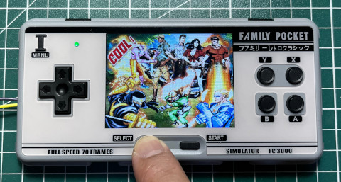

楼主 #1047 2022-09-09 21:45:28
司徒
注册时间: 2020-02-13
已发帖子: 547
积分: 157
@neotendo
Okay, thanks for your testing ~
I will check this issue when get my new FC3000, lol lol ~

楼主 #1049 2022-09-09 22:52:54
司徒
注册时间: 2020-02-13
已发帖子: 547
积分: 157
@neotendo
miyoo.h.zip

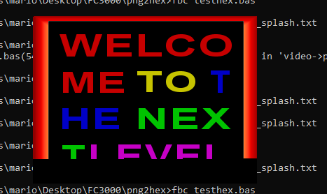

ok, i converted your png2hex program to FreeBASIC, but something went wrong, bugfixing time... again!
buggy source code and windows executeable
img2hex.7z
screenshot
最近编辑记录 neotendo (2022-09-10 03:21:08)
#1053 2022-09-10 06:11:18
neotendo
注册时间: 2022-08-19
已发帖子: 180
积分: 203
even reload the header file into the sdl surface went wrong, what the heck?!#

your png2hex tool is now working on windows. looks like the tool did not like my png file, i converted an bmp now correctly.
only thing is, win32 version outputs the data into stdout.txt
and your (p)++ seems wrong, i changed it to (p++)
changed your source code to win and linux version
img2hex_20220911-2008.7z
https://youtu.be/TysAPYiQlYI

I even got the bootlogo working now
https://youtu.be/C_okX7TBnH4

all right, i created all known variants.
./run.sh
echo "usage: run.sh /dev/sdX [pocketgo|trimui|fc3000]|[fc3000_ips1]|[fc3000_tft]|[fc3000_ips2]"
echo "fc3000_ips1 = RB411-11A -> V? IPS"
echo "fc3000_ips2 = WL-28H105-A1 -> V2 IPS"
echo "fc3000_tft = T2812-M106-24C-7D -> V1 TFT (old version)"
i did a ugly backlight patch, i added gpio_set_value( PE6, 1) in sunivfb.c
mykernel.tar.gz = your kernel source with my modifications
myuboot.tar.gz = your uboot (i think not modified but run.sh)
ready uboot image versions
normal = your normal fc3000 option
ips1 = ips patch from your github (LCD: RB411-11A)
ips2 = my v2 ips (LCD: WL-28H105-A1)
tft = my v1 tft (old version) (LCD: T2812-M106-24C-7D)
to change bootlogo create a hex_splash.h file
with 16Bit RGB565 raw datas
uint16_t hex_splash[]={
i used lcd-image-converter or png2hex/img2hex
hopefully i did not ruined the source code and you can use it,
thank you very much for your linux, effort and help <3
premade uboot images
https://drive.google.com/file/d/1ife8acluRxljk0O5hSw9CjgOqrbOFkVy/view?usp=sharing
uboot source code
https://drive.google.com/file/d/1CvxLPG-WMmwAezmEHv3-6AyqPO8zeeJM/view?usp=sharing
kernel source code
https://drive.google.com/file/d/1VkSLqAICzeq3SNva4Wh_2iZTD1xzID8O/view?usp=sharing
bootlogo tools
https://drive.google.com/file/d/1Zs9owQ_c6c-6_f7Fjq1x2UwIy6k_oasA/view?usp=sharing
!!! KEEP IN MIND, MYKERNEL AND MYUBOOT EXTRACTS TO
KERNEL/ AND UBOOT/. DO NOT OVERWRITE YOUR FILES !!!

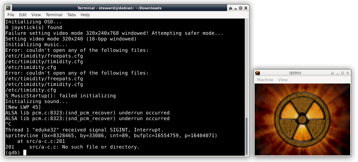

just found eduke32 on your website, i compiled it but on fc3000 init is failed cause no mouse found and libmi_sys.so not found.
is there a chance to get duke3d running on fc3000?

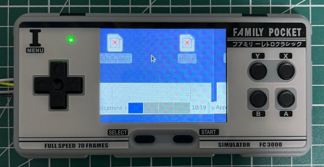

My new FC3000 arrived ~
#1069 2022-09-16 20:59:49
neotendo
注册时间: 2022-08-19
已发帖子: 180
积分: 203
司徒 wrote:
@neotendo
[Q1] is there a chance to get duke3d running on fc3000?
[Q2] i have the backlight problem in uboot aswell, no light.
I will check these issues soon.
/files/members/3145/1_20220916-1010.jpg
/files/members/3145/2_20220916-1010.jpg
ahhh very cool, another CPU but a known LCD, uboot_ips2.img should work out of the box

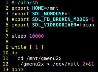

eduke32 is starting now...
created a duke3d.sh file
export SDL_MOUSEDEV="/dev/null"
export SDL_NOMOUSE="1"
eduke32
but now eduke is failing to init music/sound
最近编辑记录 neotendo (2022-09-17 19:49:28)
#1074 2022-09-18 01:06:11
neotendo
注册时间: 2022-08-19
已发帖子: 180
积分: 203
ok guys, eduke32 is starting now...
  • no music playing
  • sound is distorted
  • had to change in game.c var logoflags to (logoflags = LOGO_TITLESCREEN) in G_DisplayLogo() else eduke32 is exiting
  • no mouse of course, was able to control duke with dpad
最近编辑记录 neotendo (2022-09-18 05:49:14)
#1075 2022-09-19 12:10:40

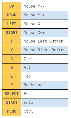

neotendo
注册时间: 2022-08-19
已发帖子: 180
积分: 203
@Apaczer
Yes, nearly the same on fc3000.
I had to hardcode the source to enter main menu directly.
Enemies are disappearing.
Sound is corrupted.
Music is not playing.

I copied over timidity.cfg, instruments/ and libSDL_mixer.so libs from miyoo rootfs and put it into the FC3000 rootfs.
todo...
  • sound is very curupted (cracking and seems to play every sound file in the grp file)
  • enemies deisappearing when duke looks at them or gets closer

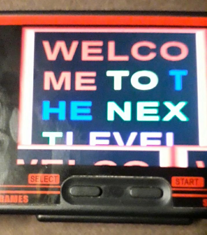

Anyone here familiar with the source code of eduke32?
I'm still having trouble with it.
The enemies or many sprites disappear into the ground, flicker or go through walls.
The sound also sounds broken, in a log I read something about "alsa pcm underrun".
I would appreciate information, thank you.

Eduke32 is running, i unpacked the FC3000 and MIYOO rootfs, copied over the libSDL_mixer.so , timidity.cfg and intruments to the FC3000 rootfs, repacked it and eduke32 has music now.
And i had to bypass the play_anim() routine to execute it, eduke32 cannot playabck the movie files.
最近编辑记录 neotendo (2022-09-23 02:55:15)

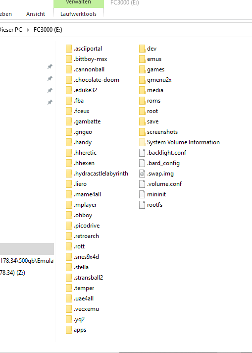

Hi there,
here is my IPS V2 (WL-28h105-A1) Linux image.
  • updated FBA
  • added RetroArch
  • added Duke3D Atomic Edition (but buggy as hell, sound and enemie issues)
  • added Bootlogo
  • Some little fixes
!! this time it has a new installation method in windows, watch my video !!
https://youtu.be/WzH5UnQ9kCs
https://mega.nz/file/mbQGHSBZ#MKj7x0QSqlqnXtuLDNwyUMAHtgTtl41zLdezMIIf5Io
FC3000 in action
https://youtu.be/BlkkFCp-XCE

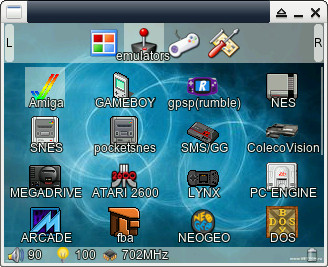

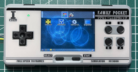

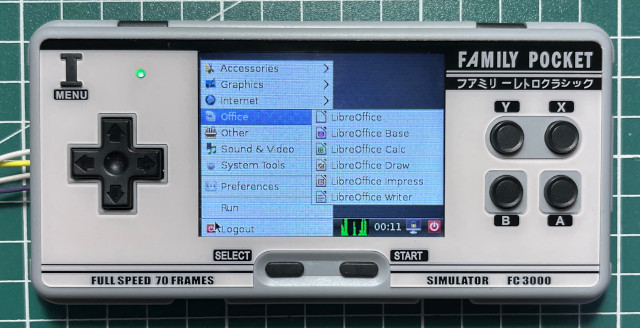

楼主 #1088 2022-09-24 18:30:24
司徒
注册时间: 2020-02-13
已发帖子: 547
积分: 157
@neotendo
Thanks for your sharing and contributions. we appreciate your help very much !

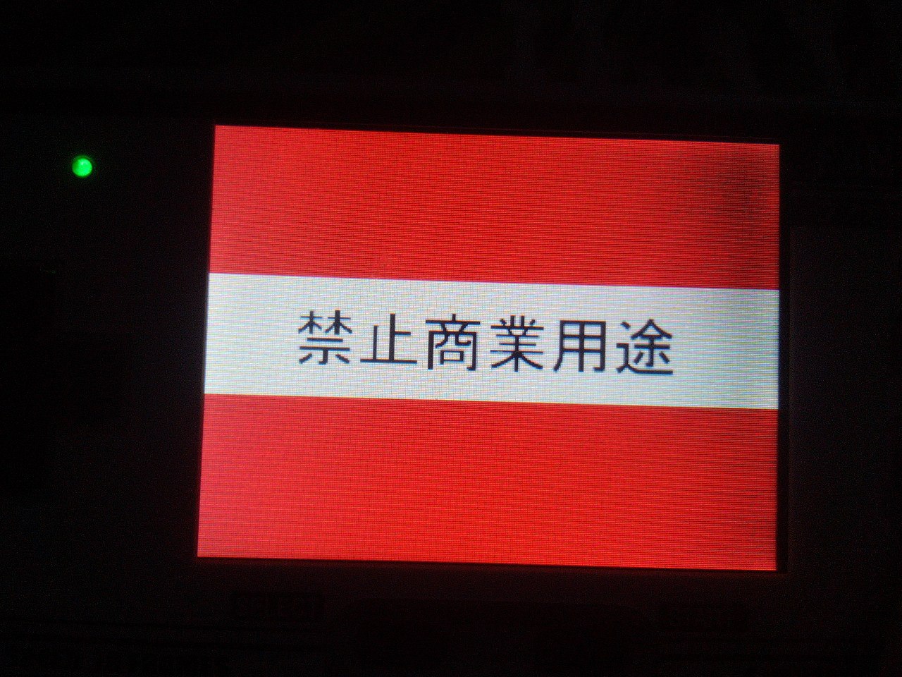

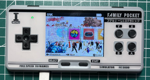

I have created 2 repos to host uboot and kernel source:
U-Boot: https://github.com/steward-fu/bootloader/tree/f1c100s_fc3000_uboot-2018.01
Kernel: https://github.com/steward-fu/kernel/tree/f1c100s_fc3000_linux-4.14.0
In U-Boot, you can use menuconfig to change your LCD panel
And run.sh has been renamed as tools/make_suniv.sh. For more detailed steps about how to build or flash into MicroSD, you can refer to the README page.
Here is the booting logo
And here is the kernel logo

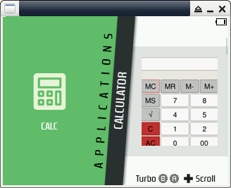

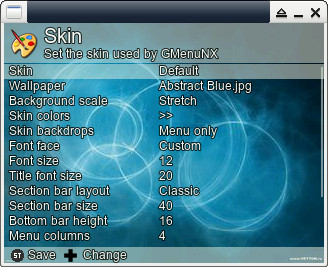

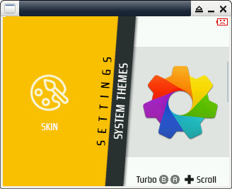

As I remembered, you have asked something about the following desktop GUI
How to change it as the following desktop GUI
The answer is from theme setting
For classical GMenu2X, you can change it to Default. But it may use Default setting if unexpected rebooting.
And I think it is time to check eduke32 issues, lol lol

For sound issue as the following logs, it isn't the key point caused eduke32 crash.
Initializing music...
Error: couldn't open any of the following files:
/etc/timidity/freepats.cfg
/etc/timidity/timidity.cfg
/etc/timidity.cfg
Although no any timidity.cfg found, it still works as well. Updating rootfs is an idea for this problem as you did. For more easy way to fix this warning, you can specify the timidity.cfg path as the following (in source/sdlmusic.c)
221    static char *s[] = { "/mnt/games/eduke32/timidity.cfg", "/etc/timidity.cfg", "/etc/timidity/timidity.cfg", "/etc/timidity/freepats.cfg" };
The main problem is at renderframe()
Thread 1 "eduke32" received signal SIGSEGV, Segmentation fault.
0xb6e25e68 in memset () from /lib//libc.so.0
(gdb) bt
#0  0xb6e25e68 in memset () from /lib//libc.so.0
#1  0x001e1e68 in decodeframe (
    srcP=0xb4df2bc6 "((\v\v\026!\342Ƴ\001\263\263\263\001\263\001\361\241_,,\017`\032\032!\026(",
    dstP=0x1d229bb <error: Cannot access memory at address 0x1d229bb>)
    at source/jmact/animlib.c:180
#2  0x001e212c in renderframe (framenumber=0, pagepointer=0xb4df0b78)
    at source/jmact/animlib.c:239
#3  0x001e2198 in drawframe (framenumber=0) at source/jmact/animlib.c:253
#4  0x001e2a98 in ANIM_DrawFrame (framenumber=1) at source/jmact/animlib.c:330
#5  0x000cf2d0 in G_PlayAnim (fn=0x26a658 "logo.anm", t=5 '\005')
    at source/anim.c:261
#6  0x0006bccc in G_DisplayLogo () at source/game.c:8668
#7  0x0007055c in app_main (argc=1, argv=0xbeedbdf4) at source/game.c:9960
#8  0x00250f20 in main (argc=1, argv=0xbeedbdf4) at src/sdlayer.c:208
I need to trace it deeply to see whether resolution is the problem
And it seems the sound driver has problem when loading MIDI sound format
Initializing sound...
ALSA lib pcm.c:8323:(snd_pcm_recover) underrun occurred
I also need to take a look at this problem

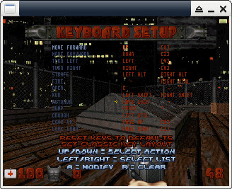

By the way, for the first time to run eduke32, you need to configure keyboard options as the following steps to make sure you can control it well

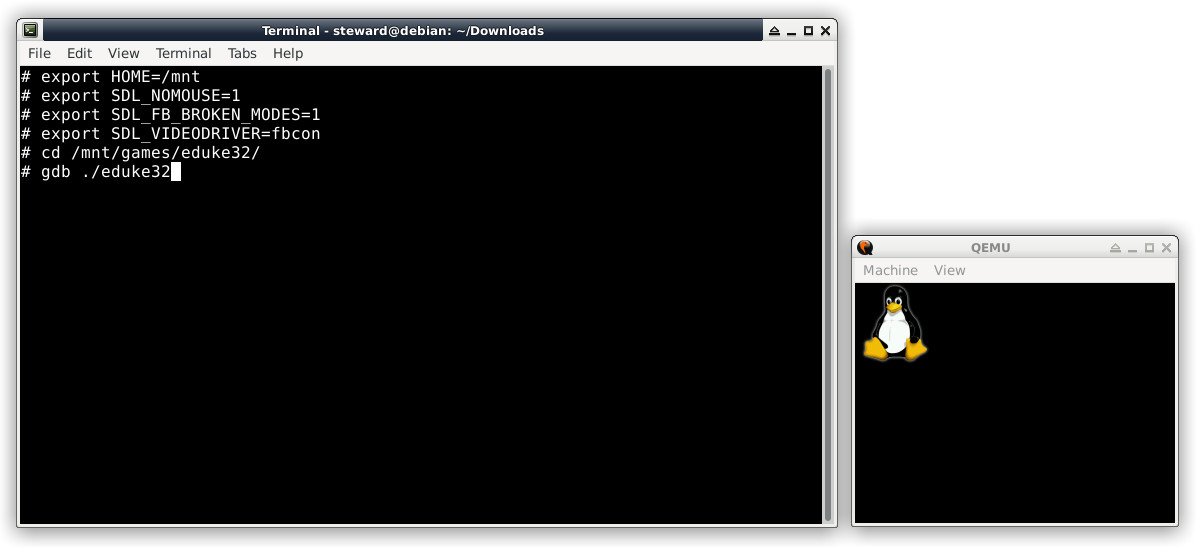

Could you advice us how to debug apps on this platform without UART? Do you have QEMU setup for ARM926EJ-S with "gdb" program as a help? I see you are pasting images from sort of windowed mode and though you might be using those.
I've tried to run my port with "gdb" through terminal app on Miyoo, but it didn't display anything (I think it might be due to SDL not liking drawing over another app).

积分: 203
@司徒

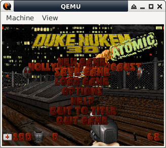

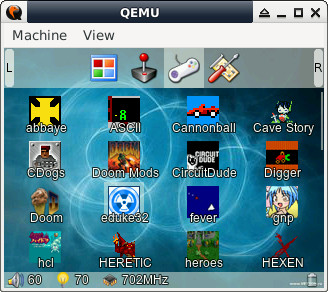

do you have an FC3000 emulator? why does the duke nukem screenshots have a window?

[Q1] Could you advice us how to debug apps on this platform without UART ?
[A1] No, you need to debug your app via UART because you need type command from UART.

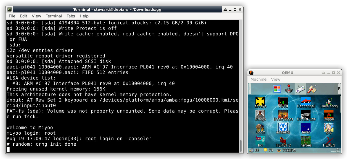

[Q2] Do you have QEMU setup for ARM926EJ-S with "gdb" program as a help ? I see you are pasting images from sort of windowed mode and though you might be using those.

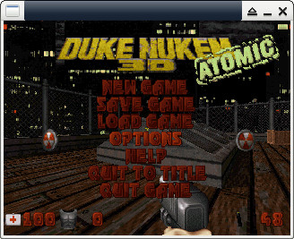

[A2] I wrote render tool to show image that obtained from /dev/fb0 node.
render tool: https://github.com/steward-fu/bootloader/blob/f1c100s_fc3000_uboot-2018.01/tools/show_320x240
How to use:
On FC3000:
# cat /dev/fb0 > xxx.raw
On PC:
$ show_320x240 xxx.raw
[Q3] I've tried to run my port with "gdb" through terminal app on Miyoo, but it didn't display anything.
[A3] You may need to redirect terminal output to framebuffer driver. So, you need enable "Framebuffer Console output" to show gdb result on your LCD panel. For more convenient way to debug your app without UART, you can try to port gdb client app on FC3000. Google is your friend !

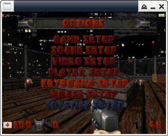

@neotendo

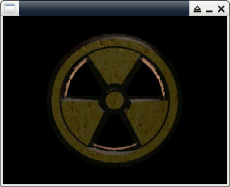

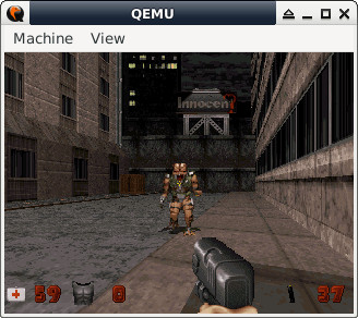

[Q1] do you have an FC3000 emulator ?
[A1] No.
[Q2] why does the duke nukem screenshots have a window ?
[A2] Refer to reply above.

count = B_LITTLE16(*(uint16_t *)srcP);
srcP += sizeof(int16_t);
It is just to get the content of memory at srcP and then put into count variable.
From GDB
count = B_LITTLE16(*((uint16_t *)((srcP += sizeof(int16_t)) - sizeof(int16_t))));
(gdb) p/x count
$2 = 0x9d80
(gdb) x/16x srcP-4
0xb4dc9b81:     0x8000  0xd99d  0x0000  0x2605  0x2d80  0x00c1  0x2605  0x2826
0xb4dc9b91:     0x280b  0x0600  0x0b0b  0x0b16  0x1a16  0x1a0b  0x0b1a  0x0b1a
srcP = 0xb4dc9b83

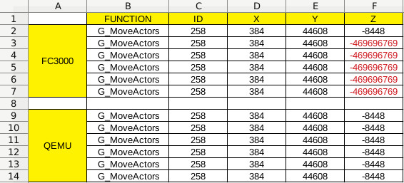

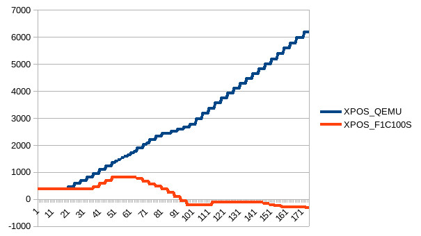

In general, it should be (uint_16_t)srcP = 0xd99d
But what we got is (uint_16_t)srcP = 0x9d80
GDB with instruction level
(gdb) stepi
   0x001e1f08 <+304>:   sub     r3, r3, #2
=> 0x001e1f0c <+308>:   ldrh    r3, [r3]
   0x001e1f10 <+312>:   str     r3, [r11, #-8]
   0x001e1f14 <+316>:   ldr     r3, [r11, #-8]
(gdb) info r
r3             0xb4dc9b83       3034356611
(gdb) stepi
=> 0x001e1f10 <+312>:   str     r3, [r11, #-8]
(gdb) info r
r3             0x9d80   40320
I'm getting crazy...
So, this is a workaround to fix this shit issue
172         //count = B_LITTLE16(*((uint16_t *)((srcP += sizeof(int16_t)) - sizeof(int16_t))));
173         count = B_LITTLE16(srcP[0] + (((uint16_t)srcP[1]) << 8));
174         srcP += sizeof(int16_t);

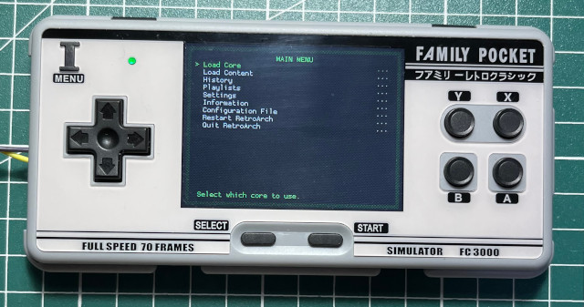

And now, animation works !
eduke32_fix.zip
Now, it is time to check MIDI issue...

we have no midi issue, look at my video above (after mod approved it)

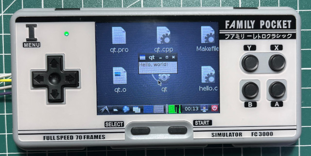

X11?
does your gdb show something while the enemies are disappearing? maybe thats another kind of memory problem.
楼主 #1101 2022-09-26 07:21:27
司徒
注册时间: 2020-02-13
已发帖子: 547
积分: 157
@neotendo

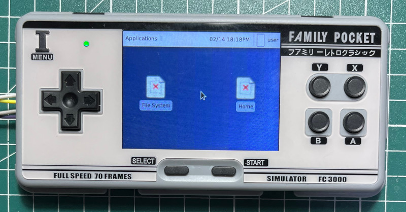

Yes, I would like to see X Window running on FC3000. This is why I bought new FC3000 again. Accroding to the terminal log (it is most same as eduke32.log), I cannot find useful information. Maybe, I am not familiar with this game.
EDuke32 2.0.0devel 20100727
Using /mnt/games/eduke32/ for game data
Using /mnt/.eduke32/ for game data
Initializing SDL system interface (compiled against SDL version 1.2.15, found version 1.2.15)
Using "fbcon" video driver
No fullscreen modes available!
Searching for game data...
Using 'duke3d.grp' as main game data file.
Compiling: GAME.CON (151133 bytes)
Including: DEFS.CON (35992 bytes)
Including: USER.CON (45449 bytes)
GAME.CON: In state `blimphitstate':
GAME.CON:476: warning: expected action, found define.
GAME.CON: In actor `ORGANTIC':
GAME.CON:3969: warning: found `else' with no `if'.
GAME.CON: In state `pigshootenemystate':
GAME.CON:5892: warning: found `else' with no `if'.
Found 3 warning(s), 0 error(s).
Resizing code buffer to 16189*4 bytes
Script compiled in 948ms, 16181*4b, version 1.4+
1917/11264 labels, 321/2048 variables
125 quotes, 207 actors
Initialized 24.0M cache
RTS file DUKE.RTS was not found
Initializing OSD...
0 joystick(s) found
Setting video mode 1024x768 (16-bpp windowed)
Unable to set video mode!
Failure setting video mode 1024x768x8 windowed! Attempting safer mode...
Setting video mode 800x600 (16-bpp windowed)
Failure setting video mode 800x600x8 windowed! Attempting safer mode...
Setting video mode 640x480 (16-bpp windowed)
Failure setting video mode 640x480x8 windowed! Attempting safer mode...
Setting video mode 320x240 (16-bpp windowed)
/etc/timidity.cfg
/etc/timidity.cfg
S_MusicStartup(): failed initializing
It is recommended to do CPU overclock for this issue. In general, "underrun occurred" means the running speed is very slow (CPU is very busy) so that sound buffer cannot be handled properly. To do overclock can fix this issue.

The battery range levels are hardcoded in latest gmenunx code, for current src you can adhere to miyoo_beta branch on my repo (specifically: https://github.com/Apaczer/gmenu2x/blob/miyoo_beta/src/platform/bittboy.h#L107). I've rewrote parts of deprecated miyoo code and brought new features from master branch.
For other types of batteries than BL-5C you might want to do battery log and check those values.
P.S. If you use GameShow skin or similar, then check NOTES in release tab.

Does it mean i can overclock the fc3000 now?
Everytime system hangs while starting an app when i set cpu over 702mhz.
Or is a resistor change mandatory?
楼主 #1110 2022-09-28 21:31:30
司徒
注册时间: 2020-02-13
已发帖子: 547
积分: 157
@neotendo
Yes, you can do overclock on your FC3000 handheld under GMenu2X setting. If you need high CPU speed, ex: 900MHz, you need to do hardware modding. If not, I think 702MHz is the best choice.

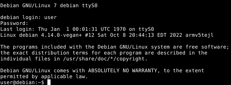

QEMU for FC3000 handheld
I spent some time on porting QEMU for FC3000 handheld. It is very useful for software development on QEMU environment because you can debug your application more easily. It is just a software level compatible, not hardware level, for example: you cannot access F1C100s registers in your application. This port is based on QEMU versatilepb (ARM926EJS) CPU and run FC3000's rootfs. So, you can test your app on this environment and then put it into your FC3000 after pass testing on QEMU environment.
Kernel Source: https://github.com/steward-fu/kernel/tree/f1c100s_fc3000_linux-4.14.0_qemu
Prebuilt QEMU: https://github.com/steward-fu/fc3000/releases/download/v1.0/fc3000-qemu_20220929.7z
You can type command via your terminal.
If you want to debug your app, add "sleep" in "/etc/main" and then repack rootfs.img
Remember to export SDL variables and then run gdb (I have put into rootfs.img already)
You can also put source code into sd.img for debugging
How to run QEMU for FC3000 handheld
$ cd
$ wget https://github.com/steward-fu/fc3000/releases/download/v1.0/fc3000-qemu_20220929.7z
$ 7za x fc3000-qemu_20220929.7z
$ ./run.sh
How to extract rootfs.img
$ zcat rootfs.img | cpio -idvm
How to repack rootfs.img
$ sudo find . | sudo cpio -o -H newc | gzip -9 > ../rootfs.img

#1116 2022-09-29 17:17:16
neotendo
注册时间: 2022-08-19
已发帖子: 180
积分: 203
@Situ

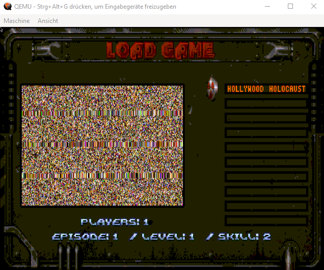

duke has no sound problems in qemu, still has underruns but sound is not currupt as on the FC3000 hardware, enemies do not disappear in qemu also.
whats the difference between FC3000 HW and QEMU?
eduke32 is running without issues on QEMU!

The enemies do in fact flicker sometimes, it is a mix of disappearing, flickering and going trough walls
#1119 2022-09-30 00:14:01
neotendo
注册时间: 2022-08-19
已发帖子: 180
积分: 203
@Situ
i try to change sounds from .grp file to wav/voc/ogg maybe that helps.
I play the same version on qemu and fc3000, on qemu eduke works fine but on fc3000 the enemies seems to fall trough the floor. (i saw 2 enemies in water but they had to be on the ground above).
enemies sometimes flicker or disappearing, very strange.
do you have any clue? i do not!

Try to "OR" SDL_DOUBLEBUF when call SDL_SetVideoMode() function.
SDL_SetVideoMode(1, 1, 8, SDL_NOFRAME | SURFACE_FLAGS | ((fs&1)?SDL_FULLSCREEN:0) | SDL_DOUBLEBUF);
P.S. Update all of SDL_SetVideoMode() functions.

Wow ! It is official support ~ Thanks for this information !
stable: https://buildbot.libretro.com/stable/1.10.3/dingux/miyoo-arm32/
nightly: https://buildbot.libretro.com/nightly/dingux/miyoo-arm32/
Run RetroArch on FC3000

Too sad, it was not the solution. That's so strange and makes me angry.
Still glitching and disappearing
https://youtu.be/m1EGq6mR0QM

Support dual boot function on FC3000 handheld
U-Boot source: https://github.com/steward-fu/bootloader/commit/e02c2adfa3eacbe93338df28d7b93c3bbb5f93d9
By default, it boots into Linux OS.
If press SELECT button and then power on, it boots into stock system.

楼主 #1131 2022-09-30 22:31:49
司徒
注册时间: 2020-02-13
已发帖子: 547
积分: 157
@neotendo
Yes, you need put needed files in MicroSD for stock system but it is more handy to switch system without removing MicroSD.
You can save state by using "save game" option and then provide the saved state to me.

/files/members/3145/1_20220930-2229.jpg

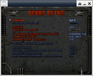

i saved it, but preview picture is currupt, can not load back the save game, errors or savegame currupt in log file.
regarding sound issues:
i created a EDUKE.CON file with
"definesound ID FILE 0 0 0 0 0"
entrys from ID 0 to ID 2500.
every sound was replaced with a dummy wav file(a door close sound), no more currupt sounds, confused!
SAVEGAME + LOG
egam0.7z
eduke32.log.txt
MY EDUKE.CON + WAV FILE
EDUKE.CON.txt
NULL.7z
最近编辑记录 neotendo (2022-09-30 23:05:49)
#1133 2022-10-01 00:05:52
neotendo
注册时间: 2022-08-19
已发帖子: 180
积分: 203
something went realy wrong on FC3000 hardware.
Savegame from eduke32 FC3000 Hardware on QEMU(looks same on FC3000)
#1134 2022-10-01 01:34:25
neotendo
注册时间: 2022-08-19
已发帖子: 180
积分: 203
@Situ
I solved the sound problem!
The FC3000 hardware doesn't seem to like the original VOC sound files.
I have now extracted all VOC files from duke3d.grp, converted them to WAV, renamed it to VOC and put it back into duke3d.grp.
no currupted sounds anymore!
duke3d.7z
@neotendo, @司徒
Thank you, It's accumulated work of MiyooCFW & RetroArch community, we try add new things every release (today is new one!). You can search "MIYOO" in changelog for full info. I've been lately occupied with new video filter for 320x240 screens, but it needs testing.
You can find usefull info for setting up RA for Miyoo in here: https://github.com/TriForceX/MiyooCFW/wiki/RetroArch-Setup
Big credits go to salvacam & jSTE0 - they did most of work in maintaining frontend and porting cores!.
BTW - if you want to test your own builds/cores or see smth changed just do "make -f Makefile.miyoo" after modding.

注册时间: 2022-08-19
已发帖子: 180
积分: 203

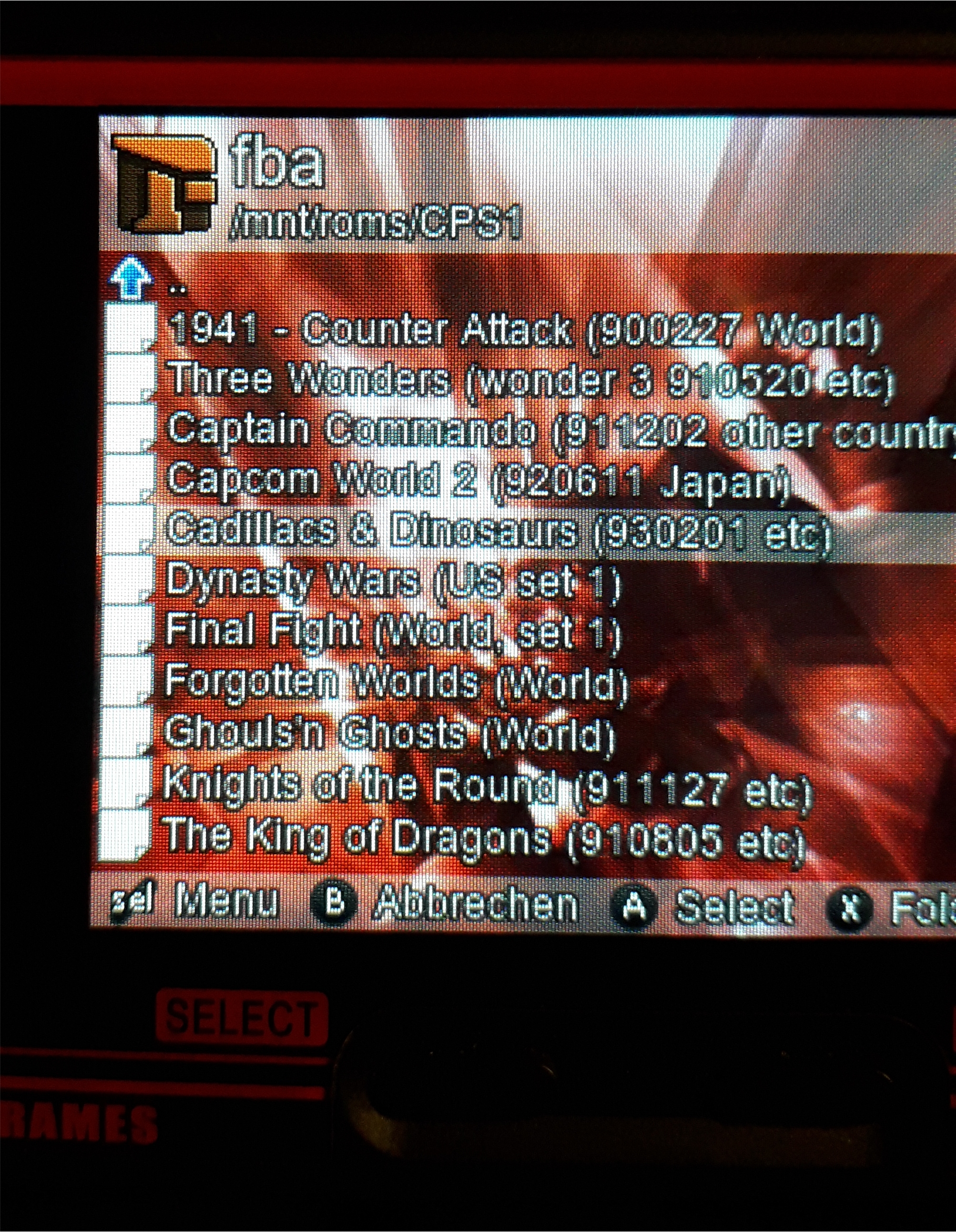

@Apaczer
I do not think that the FC3000 is powerfull enough for video filters, atleast without overclocking.
But we have now a fully emulation beast.
We can run linux, linux based emulators, retroarch and now the stock system, all with one big sd card.
I updated gmenu2x, fba
Added retroarch and eduke32(still buggy)
I will try to update some other emulators
Flashed the current kernel and uboot.

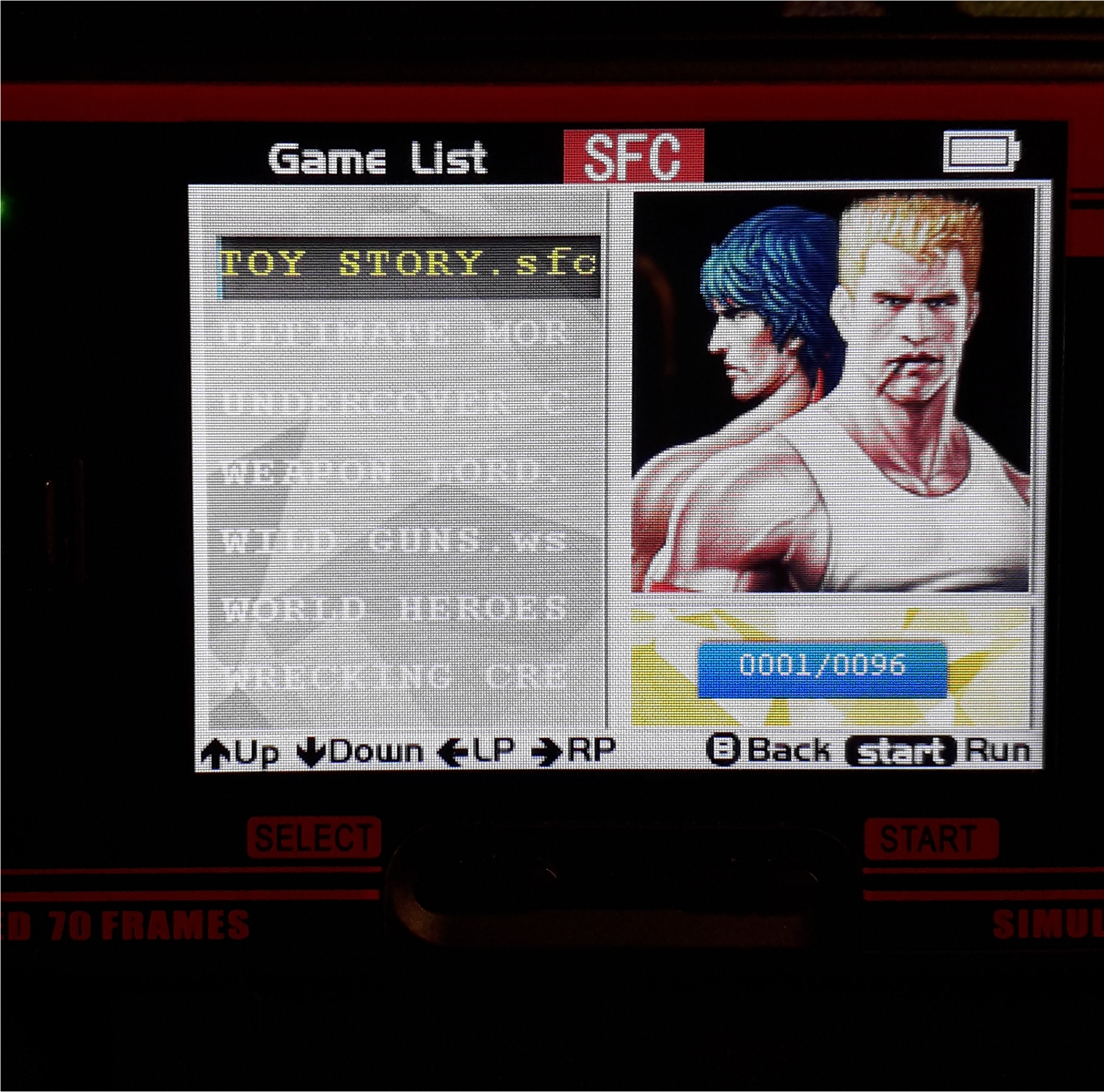

i tried your dual boot feature. we have the problem now, stock firmware search roms on the first partition (FC3000) where the rootfs is.
this partition has not enough space and our other roms are on the second partition (OD).
only solution that came in mind is to put all files in first partition and mount that as /mnt, so we have /roms folder in stock firmware and /mnt/roms in linux firmware.
or link the folders if possible, idk.

User need to resize the first partition in order to put all of needed files. For battery issue, we needs to take a look at GMenu2X to see what kind of value read from kernel driver. For eduke32, it seems this issue is related to chip issue rather than performance issue because the enemy's position is wrong when render sprite. Since eduke32's source code is very complicated, I think it is not easy to find root cause out in a short time. For RetroArch, it is worthy to run RetroArch on miyoo handheld even if the performance is not good. We need focus on software optimization rather than high performance chip, which this is what we need eventually. Also, we need to thanks all of contributors for open source ported on miyoo handheld.

but then you would have to have the roms twice on the sd card.

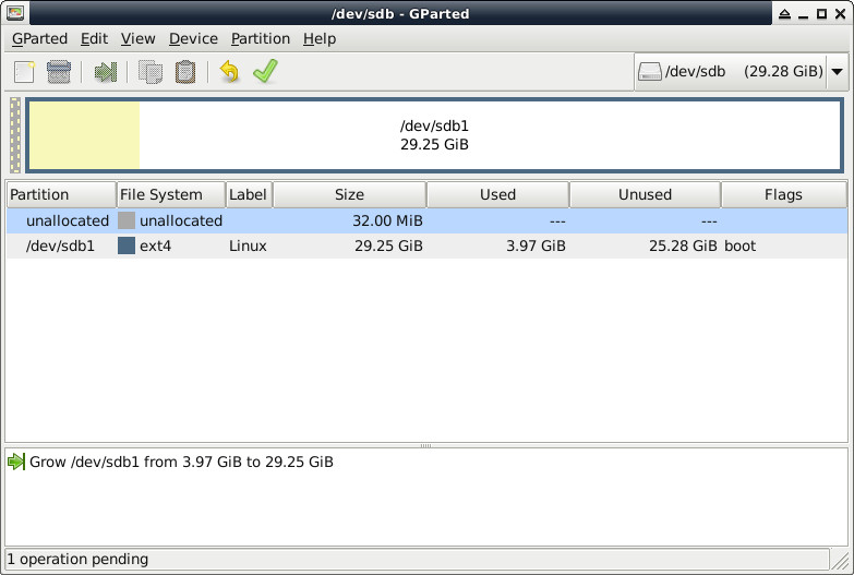

I'm trying to make the whole system on one partition, was able to mount /dev/mmcblk0p1 as rw and mounted partition 1 on /romdir.
have created /roms/sfc on partition 1, can access it with stock and linux.
in theory all contents from partition 2 can copy over to partition 1 and mounted on /mnt instead /romdir.
I also wrote a script which tests the fat partition for dirty bits and then runs fsck.vfat if the system was simply switched off (because of partition 1 rw mode).
updated snes9x4D and pocketSNES also.
最近编辑记录 neotendo (2022-10-02 01:55:45)

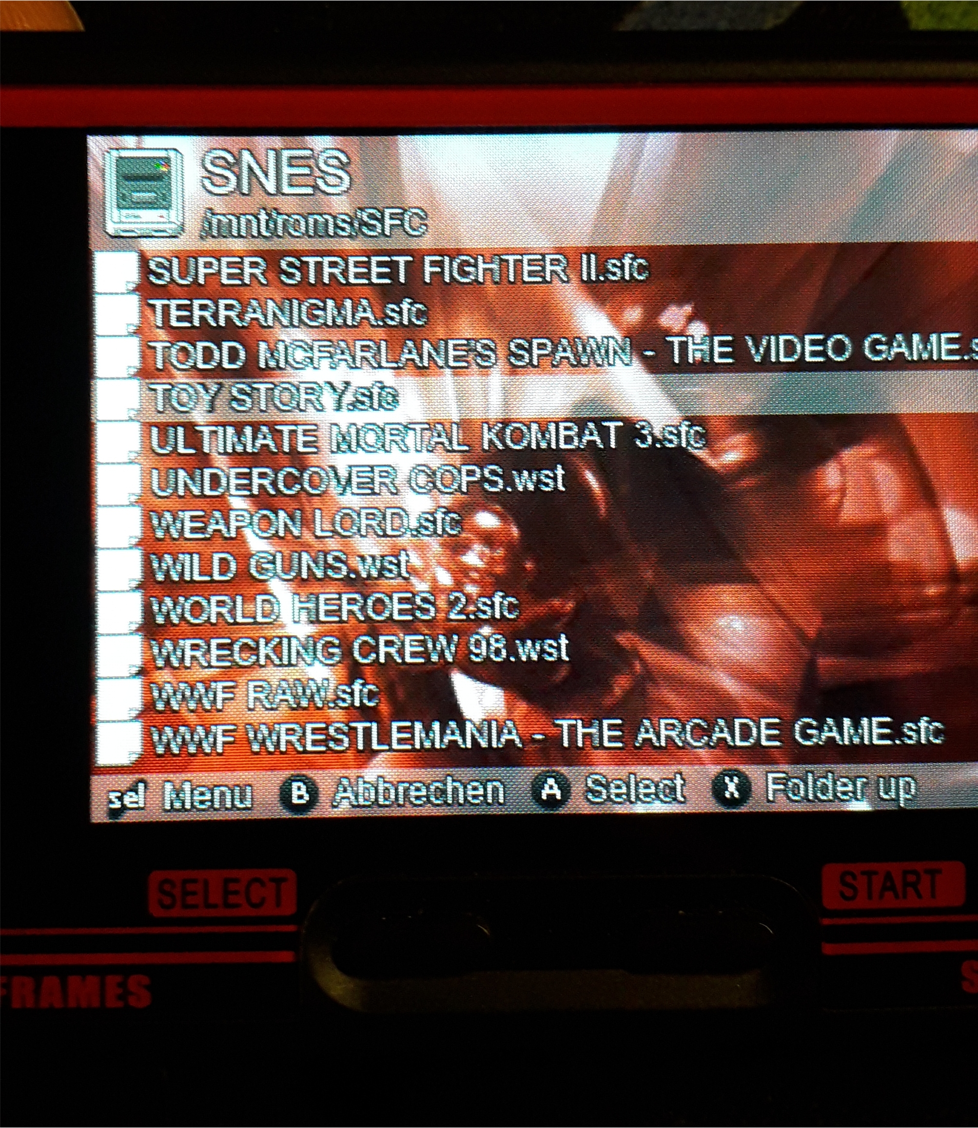

new system done!!
Created 2 partitions with minitool partition wizard, one 32MB and one with the rest of sdcard (win10 did not allow create fat32 partitions bigger than 32GB).
Deleted the first 32MB partition (32MB unalocated, 57GB Fat32).
dd uboot+kernel into the unallocated 32MB partition.
copied over my modded linux systemfiles to the big Fat32 partition, now the stock firmware and linux can access the /roms folder.
But looks like that the Stock NeoGeo emu accepts WST roms only.

EDUKE32
i think the error lies in drawsprite() function in engine.c, but i have not such a fast eye for buggy source code as you wink.
最近编辑记录 neotendo (2022-10-02 05:33:36)

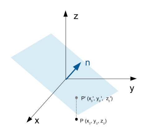

When the monster is walking towards the player, the value of X position should be in order of increasing.
XYZ mapping
According to the raw data got from QEMU and FC3000, the results show that it is correct in QEMU environment but incorrect in FC3000.
Raw Data

It seems there is a potential bug in F1C100S, which seems like we found before (LDRH instruction in odd address). I cannot make sure whether we can find root cause or not but it is very interesting for this issue. Here is the current finding for reference.
#1145 2022-10-04 06:08:06
neotendo
注册时间: 2022-08-19
已发帖子: 180
积分: 203
@司徒
you are soooo amazing man!!!! so it seems a math error on fc3000 hardware. i will take a look into G_MoveActors().
but I think that not only X is the problem, I think Y and Z are also affected.
PS: bypassing A_GetZLimits(int32_t iActor) in source/gameexec.c keeps the enemies on screen. they still have some bugs but did not disappear or flicker (i can fight against them).
finaly some results!!!!
thank you so much for your info <3
PPS: looks like the issue lies in getzrange() in build/src/engine.c, bypassing getzrange() in A_GetZLimits() has the same effekt as bypassing A_GetZLimits() complete.
最近编辑记录 neotendo (2022-10-04 09:26:31)

积分: 157
@neotendo
Thanks for your efforts to share this image to us !
Here are the backtrace logs
// #define ZOFFSET (1 << 8)
// vm.g_sp->z = actor[vm.g_i].floorz - ZOFFSET;  <= at source/gameexec.c:1160
(gdb) p vm.g_i
$13 = 448
(gdb) p vm.g_sp->z
$2 = -8448
(gdb) p actor[vm.g_i].floorz
$3 = -469696513
(gdb) n
1162    in source/gameexec.c
(gdb) p vm.g_sp->z
$4 = -469696769
#0  VM_Execute (once=0) at source/gameexec.c:1160
#0  VM_Execute (once=0) at source/gameexec.c:1402
#0  VM_Execute (once=0) at source/gameexec.c:695
#0  A_Execute (iActor=448, iPlayer=0, lDist=12586) at source/gameexec.c:4930
#0  G_MoveActors () at source/actors.c:4774
(gdb) p sprite[448]
$1 = {x = 384, y = 44608, z = -8448, cstat = 257, picnum = 1680,
  shade = 4 '\004', pal = 22 '\026', clipdist = 80 'P', filler = 0 '\000',
  xrepeat = 40 '(', yrepeat = 40 '(', xoffset = 0 '\000', yoffset = 0 '\000',
  sectnum = 258, statnum = 1, ang = 1920, owner = 448, xvel = 0, yvel = 0,
  zvel = 0, lotag = 0, hitag = 0, extra = 30}
#0  G_MoveActors () at source/actors.c:3415     <= trace from here (i == 448)
#0  G_MoveWorld () at source/actors.c:7901
#0  G_DoMoveThings () at source/game.c:10447
#0  G_MoveLoop () at source/game.c:10312
#0  app_main (argc=1, argv=0x7fffffffe128) at source/game.c:10229
#0  main (argc=1, argv=0x7fffffffe128) at src/sdlayer.c:235
I don't know when the variable "actor[vm.g_i].floorz" is set as 0xe400ffff (-469696513). So, after subtract, the value of Z position becomes as invalid (-469696769). As you mentioned before, besides Z, XY are also affected. This issue doesn't happen on QEMU and x64 PC environments but on FC3000 handheld. Interesting lol lol
Here is the table for reference
According to the testing, Z position is affected firstly and then X postion.

here is the "image" (!! FOR TESTING PURPOSE ONLY, NO FINAL IMAGE GUYS !!)
https://drive.google.com/file/d/1eEUu4_tPvH7hVs_U-Gwim441el1uvHnv/view?usp=sharing
  1. Create Partition 1 with 32MB in size (FS is not important)
  2. Create Partition 2 with the rest of your sdcard (fat32)
    (Windows does not allow bigger partitions than 32GB, only with third party tools like minitool partition wizard)
  3. Save Partition table to disk
  4. Delete Partition 1 so it is unallocated, save Partition table to disk
  5. DD your current/dualboot uboot.img to Partition 1
  6. Extract archive to the Fat32 Partition
  7. i added a fsck.vfat script when dirty bit is set (unclean shutdown), so it can take some time
    to boot if dirty bit is set.
    i do not know how important it is on an fat32 fs, but i added it because my solution is
    to remount /boot as RW and mount /boot on /mnt in inittab.
    maybe you can make it better (script is in /etc/vfatfsck.sh and is called in /etc/main).

looks like some datatypes are not compatible with f1c100s.
i can not load save game nor demos (demos are based on savegames/snapshots), it gives me error when loading savegame or a demo.
demo recorded in QEMU, FC3000 says wrong demo version, bypassing version check, same error as when loading savegame, eduke32 crashing, Demo and Savegames are ok in QEMU.
so i assume it is the same thing with the X,Y,Z issue (datatypes).
very confusing
eduke32.log before bypassing demo version
Incompatible demo version. Expected 0.2.196, found 0.2.50180
There were errors opening demo 1(code: 2).
eduke32.log after bypass version check
sv_loadsnapshot: size: 8106826 bytes.
ud: 343
sws: 3590660
script: 2103296
animisc: 2397343
ERROR: NULL weapon! WTF?!
Wrote eduke32.cfg
Wrote settings.cfg
hash_find(): table not initialized!
Wrote eduke32.cfg
Wrote settings.cfg
just wanted let you know that.

ok, just fixed eduke32....
compiled eduke32_20131102-4128 successfully and it is working without disappearing/flicker issues.
still savegame and demo not working. and playanim() function need to be fixed again.
decodeframe() function patched, animations playing back again.
maybe i will try to compile higher versions.

yeah, duke is runing good now, finaly.
thank you very much, i am curios about your X11 attempt or whatever you have in mind.
i will take a look into enabling TV out, or do you allready have a clue how to enable it?

i just found out that your dual boot uboot did not start on the tft1 (variant=3) version, nothing happens(or it starts the stock rom, cant really tell cause my stock rom is wiped).
i tried an older working uboot source code and copied over your patched start.s and uboot did not boot into linux.
the tft1 version has no multiplex lines, SELECT is on (4*32)+3 (PE3)
PS: I bypassed your dual boot function for the FC3000 V1 TFT T2812-M106-24C-7D until you maybe feel like fixing it

Thanks for your testing. It is different with other FC3000
660     // FC3000 V1 TFT (Old Version)
661     //
662     else if(suniv_variant == 3) {
663         I_UP    = ((32 * 5) + 0);
664         I_DOWN  = ((32 * 5) + 5);
665         I_LEFT  = ((32 * 5) + 4);
666         I_RIGHT = ((32 * 4) + 2);
667         //(32*4) 0,1,(2=RIGHT),(3=SELECT),(4=START),(5=A),(7=B),(8=Y),(9=X),(6=hangboot)
668         //(32*0) 1,2 = Shutdown menu!?, (3=MENU)
669         I_START = ((32 * 4) + 4);
670         I_SELECT = ((32 * 4) + 3);
TFT 1 => SELECT button, PE3
Others => SELECT button, (PE12=0) PA1
Here is the commit: https://github.com/steward-fu/bootloader/commit/123766b9e1b6639cfd9fe0fff16ae0a21d0172f6

zjzixuan
注册时间: 2022-04-04
积分: 15
@司徒 大佬我有个F1C100S主板刷了fc3000_ips_od_jutleys_no_roms.img这个固件 屏幕不支持一直闪 是不是屏的驱动不对啊
怎么修改啊
下面这个是我自己的屏
1 GND
2 GND
3 LEDA
4 GND
5 GND
6 VDD
7 GND
8 PD19
9 PD18
10 PD20
11 PD21
12 PD0
13 PD17
@zjzixuan
can you provide what is written on your LCD or LCD Ribbon cable?
ex: WL-28H105-A1 or T2812-M106-24C-7D

#1171 2022-10-08 18:04:21
zjzixuan
注册时间: 2022-04-04
积分: 15

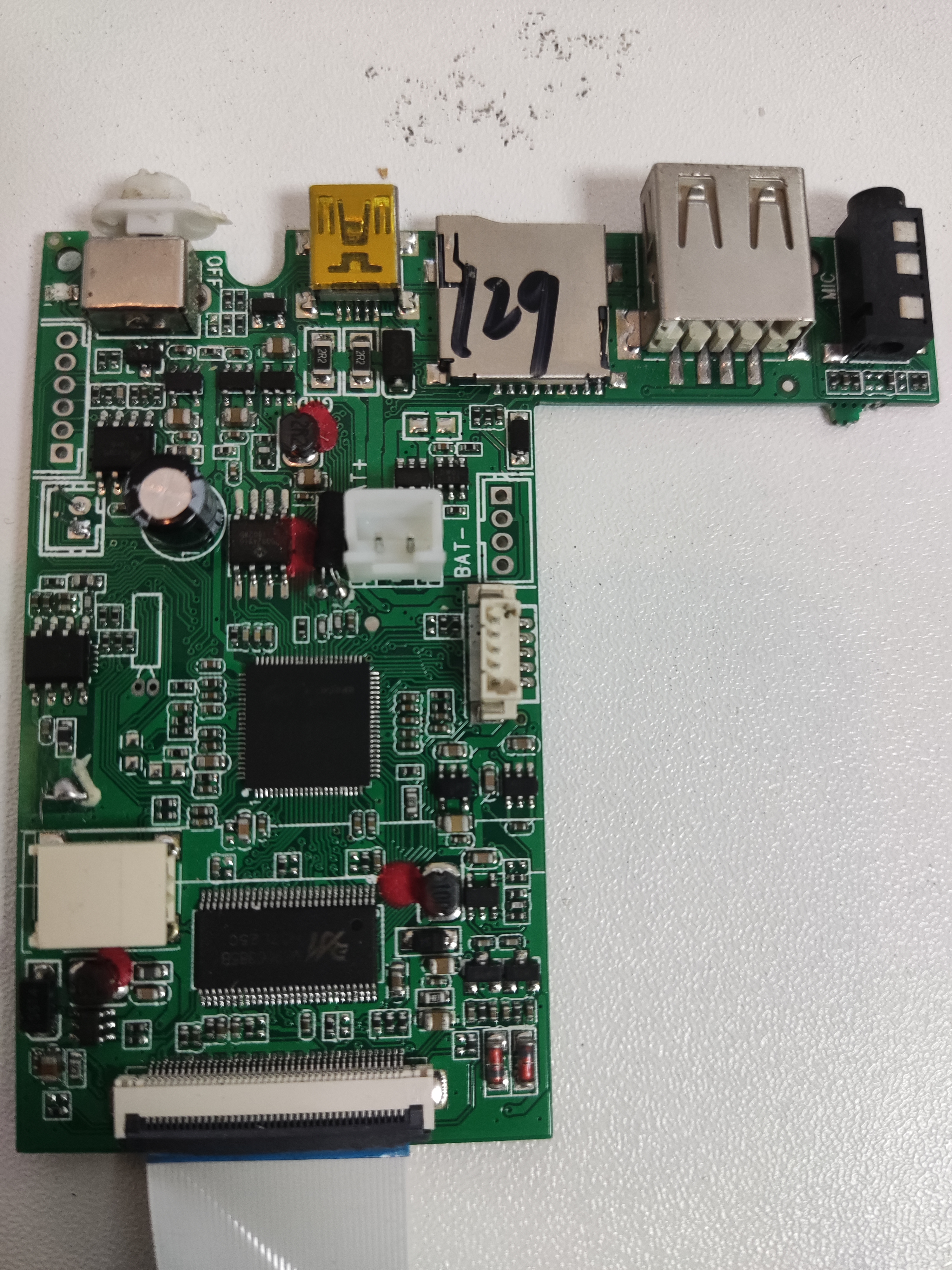

@neotendo 屏上的信息 YZTM081 JH011611
楼主 #1172 2022-10-08 19:24:17
司徒
注册时间: 2020-02-13
已发帖子: 547
积分: 157

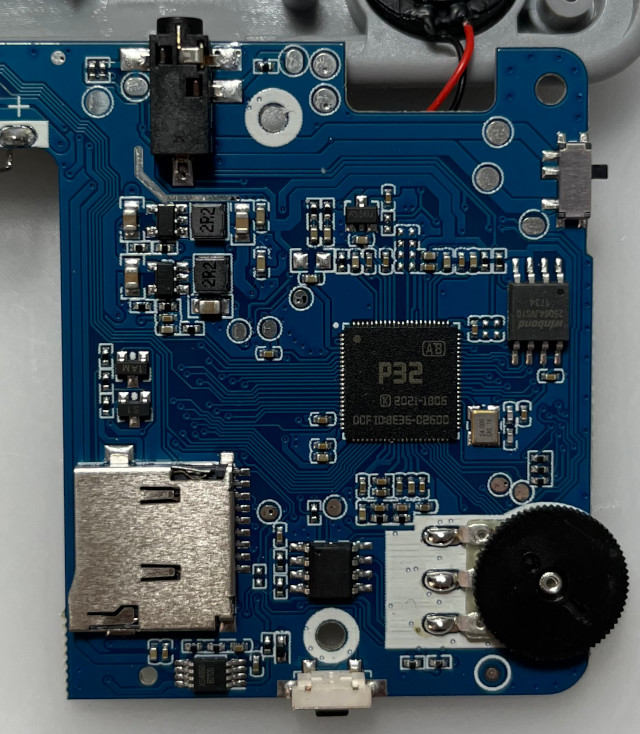

@zjzixuan
你的機器可以拍張照片嗎?然後屏的FPC排線也拍一下照片~
#1173 2022-10-08 19:58:18
neotendo
注册时间: 2022-08-19
已发帖子: 180
积分: 203
ok, another unknown display. do you tried different images?
if not, try the ips2 first please.
hint: if you look from an another angle onto your display and your images stays the the, you have an IPS display, if your image differs or inverts / change colors, you have an TFT display.
https://github.com/steward-fu/fc3000/releases/download/v1.0/fc3000_ips2_od_jutleys_no_roms.img.7z
https://github.com/steward-fu/fc3000/releases/download/v1.0/fc3000_old_tft_od_no_roms.7z
https://github.com/steward-fu/fc3000/releases/download/v1.0/fc3000_tft1_T2812_M106_24C_7D.7z

楼主 #1174 2022-10-08 22:48:06
司徒
注册时间: 2020-02-13
已发帖子: 547
积分: 157

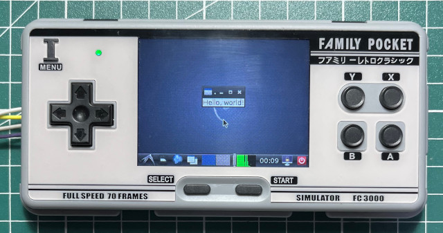

Debian 10 (Buster) with XFCE4 Desktop on FC3000 handheld (ARM9 486MHz)
#1176 2022-10-08 23:20:07
neotendo
注册时间: 2022-08-19
已发帖子: 180
积分: 203
/files/members/3145/2_20221008-2249.jpg
just amazing <3 , looks like bpp / pitch or something is wrong, but looking very good so far.
楼主 #1177 2022-10-09 00:06:42
司徒
注册时间: 2020-02-13
已发帖子: 547
积分: 157
CPU Usage is pretty well on Debian 10 xfce4 (F1C100S @486MHz) ~
#1178 2022-10-09 02:54:42
neotendo
注册时间: 2022-08-19
已发帖子: 180
积分: 203
/files/members/3145/2_20221009-0003.jpg
what a genius!!!

Debian 7 (Wheezy) on FC3000 Handheld
司徒最後決定使用 Debian 7 (Wheezy),因為跑在 F1C100S ARM9 CPU:486MHz, RAM:32MB, SWAP:512MB 下,速度算是可以接受,當然,如果更換成 F1C200S(RAM 64MB) 會更好,CPU超頻後,整體運作速度應該也會更順暢,司徒把製作步驟寫下來,如果玩家想更換成 Debian 10 (Buster) 系統就可以自己更換,當然,可以在 FC3000 掌機上編譯、執行程式,是司徒重新購買 FC3000 的主要目標,很高興這個目標可以達成,因此,在此分享成果給大家~
Kernel: https://github.com/steward-fu/kernel/tree/f1c100s_fc3000_linux-4.14.0_debian
Bootloader: https://github.com/steward-fu/bootloader/tree/f1c100s_fc3000_uboot-2018.01
製作好的燒錄檔案(root:root, user:user): https://github.com/steward-fu/fc3000/releases/download/v1.0/fc3000_ips2_debian7.img.7z
製作Debian系統:
$ cd
$ sudo apt-get install binfmt-support qemu qemu-user-static debootstrap
$ sudo debootstrap --arch armel --foreign wheezy wheezy http://archive.debian.org/debian/
$ sudo chroot wheezy /debootstrap/debootstrap --second-stage
$ sudo mount -o bind /dev wheezy/dev
$ sudo mount -o bind /sys wheezy/sys
$ sudo mount -o bind /proc wheezy/proc
# passwd
# adduser user
# nano /etc/apt/sources.list
    deb http://deb.debian.org/debian buster main contrib non-free
    deb http://deb.debian.org/debian buster-updates main contrib non-free
    deb http://deb.debian.org/debian buster-backports main contrib non-free
    deb http://deb.debian.org/debian-debug/ buster-debug main contrib non-free
# apt-get update
# apt-get install lxde obconf openbox lxdm lxde-common xbindkeys xdotool -y
# nano home/user/.xbindkeysrc
    "xdotool mousemove_relative 10 0"
        Right
    "xdotool mousemove_relative -- -10 0"
        Left
    "xdotool mousemove_relative 0 -10"
        Up
    "xdotool mousemove_relative 0 10"
        Down
    "xdotool click 1"
        m:0x0 + c:65
    "xdotool click 3"
        m:0x1 + c:50
# nano /etc/lightdm/lightdm.conf
    autologin-user=user
# nano /etc/inittab
    1:2345:respawn:/sbin/getty -L ttyS0 115200 vt100
# nano /etc/rc.local
    /usr/bin/xbindkeys -f /home/user/.xbindkeysrc
# nano /etc/fstab
    /swap.img none  swap  sw  0  0
# dd if=/dev/swap.img of=/swap.img bs=1M count=512
# mkswap /swap.img
# exit
$ sudo umount wheezy/dev
$ sudo umount wheezy/sys
$ sudo umount wheezy/proc
編譯Kernel
$ cd
$ wget https://github.com/steward-fu/miyoo/releases/download/v1.0/toolchain.7z
$ 7za x toolchain.7z
$ sudo mv miyoo /opt
$ git clone https://github.com/steward-fu/kernel
$ cd kernel
$ git checkout f1c100s_fc3000_linux-4.14.0_debian
$ ARCH=arm make suniv-debian_defconfig
$ ./tools/make_suniv.sh fc3000_ips2
準備一張MicroSD並分割成如下:
編譯Bootloader並且燒錄到MicroSD
$ cd
$ git clone https://github.com/steward-fu/bootloader
$ cd bootloader
$ git checkout f1c100s_fc3000_uboot-2018.01
$ ARCH=arm make suniv_defconfig
$ ./tools/make_suniv.sh /dev/sdX fc3000
P.S. 如果不想手動自己安裝,可以使用司徒打包好的燒錄檔案(fc3000_ips2_debian7.img.7z, root:root, user:user)
系統穩定時間大約需要三分鐘(F1C100S CPU:486MHz, RAM:32MB, SWAP:512MB)
記得連接FC3000 UART,這樣就可以有Terminal操作的功能
按鍵映射(滑鼠左、右鍵需要長按大約3秒再放開)
司徒打包的燒錄檔案有包含許多編譯器套件,這樣就可以直接在FC3000上面做開發的工作,首先,試試Hello, world!
$ cd
$ gcc hello.c -o hello
$ ./hello
    hello, world!

接著試試QT(qt.cpp)
#include <QApplication>
#include <QWidget>
#include <QLabel>
int main(int argc, char** argv)
    QApplication app(argc, argv);
    QWidget *win;
    QLabel *label;
    win = new QWidget;
    label = new QLabel("Hello, world!", win);
    win->show();
    return app.exec();
qt.pro
TARGET = qt
SOURCES = qt.cpp
編譯QT並且執行
$ export DISPLAY=:0
$ qmake
$ make
$ ./qt

@zjzixuan
I saw your lcd ribbon and pcb pictures, looks not like an FC3000 handheld.
So our FC3000 images are not for your hardware if i see it correct.

zjzixuan
注册时间: 2022-04-04
积分: 15
@司徒 原固件里有屏的驱动 不知道怎么提取http://ys-j.ysepan.com/144276938/419683995/j54535S3X84M6iTVSgXb2/f1c100s.img
in most cases you can not extract an driver and use it in other linux system, only if both are based on same code or so.
besides that, you can not do much with only the driver.
hope i am right with my hypothesis.

#1193 2022-10-12 01:36:10
neotendo
注册时间: 2022-08-19
已发帖子: 180
积分: 203
@EVERYONE smile
here we are!!!! the new FC3000 V2 IPS (WL-28H105-A1) Linux Firmware with Dualboot feature
You can dualboot the device with holding down SELECT button on poweron / reboot
  1. Flash image with dd or win32diskimager or other tool to your sdcard
  2. Resize partition to your max size of sdcard (keep the first 32MB untouched).
    (windows users can use the part tool in archive)
  3. Now you can add your favorite roms/isos into the /roms dir
  • added all stock roms by Steward
  • added reboot link in settings section/tab
  • added bootlogos (uboot by steward, kernel by neotendo)
  • added experimental usb hid host/otg support (testers welcome)
  • added retroarch
  • added 3 Duke Nukem 3D Links in Games section (with more gore/guts)
  • Standard Atomic Edition
  • XXX Nude patch
  • Experimental Voxel Graphics
  • updated snes9x4d
  • updated pocketsnes
  • updated fba
  • added picodrive SegaCD/MegaCD link
  • added regionfree sega/mega-CD bioses
  • added SonicMegamix.iso
  • added smsplus GameGear link
  • changed some emulator settings
  • added 2 new skins by TOX from 4pda forum
  • and some more i can't remember smile

司徒 wrote:
@neotendo
Thanks for updating download links. For SPI flash, may I know why do you need such tool or program ?
I want try to program a little logo display program or so.
My FC3000 v1 tft is wiped as i tried your images the first time (cause my device was not compatible, and flashed accidently the wrong file🤷🏻)
And as long i have no stock rom for it, i want something on the display instead a dead screen.
Just for fun

Here is a video of the new FC3000 firmware (crappy recording, looks much better in reallife)
https://youtu.be/C0NxH0gfZoY

@Situ
i have an user from spain, he has the RB411-11A display, he downloaded my RB411-11A linux image but his display stays black.
i tried to recompile the uboot and gave him the image, stil black screen.
can you please compile a IPS1 (RB411-11A) uboot for me or look into source code why his display stays black?
maybe compiling a new uboot.img is enough and the issue lies at me.
thank you very much
PS:
I saw in the ips kernel patch file the last 2 lcd init cmd/data are
Lcd_Cmd(0x1020)
Lcd_Dat(0x1020)
But in your new kernel and uboot code, there is only
Lcd_Cmd(0x1020)
Is that correct or can be that the fault?
最近编辑记录 neotendo (2022-10-13 06:55:33)

@Situ
i looked into your uboot/drivers/video/fc3000_ips1.c and fc3000_tft1.c source code, both initial codes are the same.
is it possible that something went wrong?
ips1 should be the RB411-11A initial code right?

Thanks for your information. Yes, the initial code of IPS v1 should be RB411-11A. You can provide PR to this repo for this issue.
#1202 2022-10-13 20:45:50
neotendo
注册时间: 2022-08-19
已发帖子: 180
积分: 203
司徒 wrote:
@neotendo
ok, i got the RB411-11A image working, it was the wrong initial code.
#1203 2022-10-13 23:06:20
neotendo
注册时间: 2022-08-19
已发帖子: 180
积分: 203
The v1 ips1 version is broken.
The lcd init code was wrong, uboot bootlogo has wrong colors and the L and R buttons do not work as it should.
I solved the init code and uboot bootlogo issue.
Now i need to get L and R buttons to work right.
I will upload any linux image updates to google drive, the download links keeps still the same when overwriting the file.
So my post with the download links are always uptodate.
Nice feature

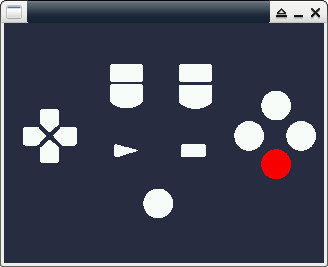

Tool for keypad testing
Source code: https://github.com/steward-fu/goodies
Run on PC
Run on FC3000
prebuilt binary: keytest_20221014.zip
