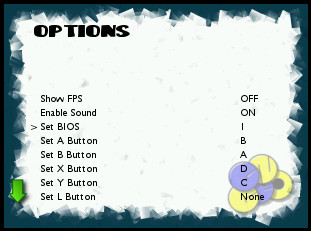

Make sure we are on the same page. How did you know this issue ?

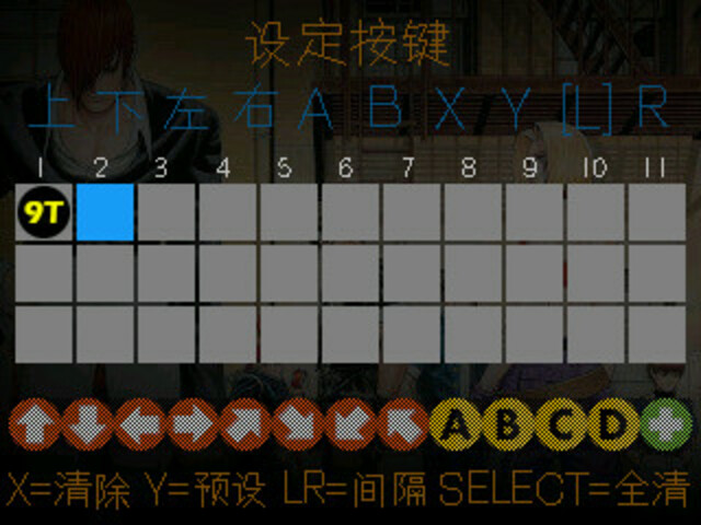

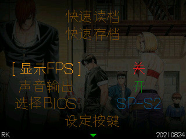

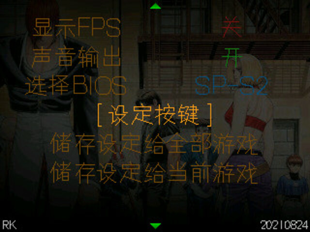

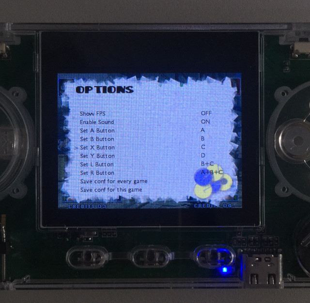

What? You mean fba?   I was playing a game and wanted load another rom, but "I" menu key did nothing.
I compiled the kernel source from you via wget from your github
楼主 #1011 2022-09-02 16:03:42
司徒
注册时间: 2020-02-13
已发帖子: 547
积分: 157
Re: 研究FC3000掌機的開源可行性
As I known, it should be "SELECT + START + L" for FBA menu.
#1012 2022-09-02 16:33:06
neotendo
注册时间: 2022-08-19
已发帖子: 180
积分: 203
司徒 说:
I press START+SELECT and i got this menu, thank you for the hint.

You can try latest port of the FBA: https://github.com/Rezzy-dev/fba-miyoo-playable/releases/tag/release
It fixes some stuff and you can open Menu with RESET button. For recompiling use Miyoo toolchain from steward's repo.

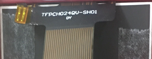

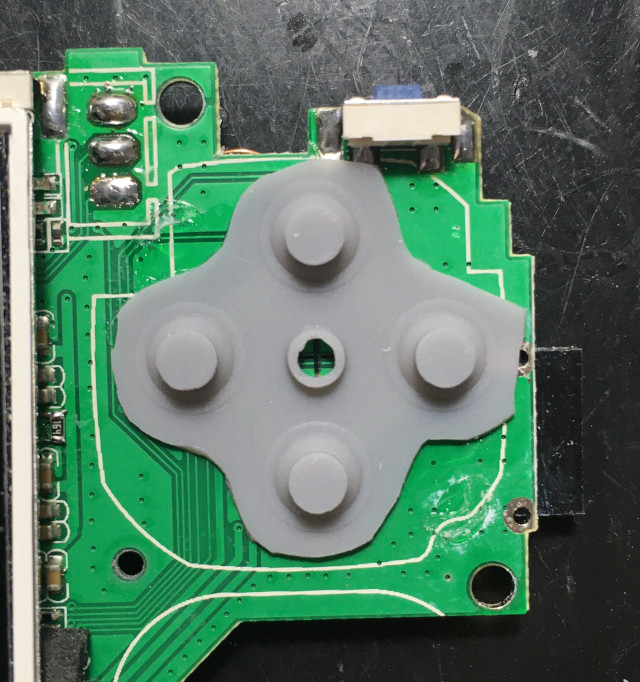

@Situ
I see it coming and i need your help at the end again 😄
Disasembled the FC3000, found nothing about the LCD (WL-26 or 28 H105-A1)
最近编辑记录 neotendo (2022-09-05 23:29:18)

Just saw you already have an wl-28h105-a1 stock dump on github.  Only need to figure out what driver this display use

lol Yes, the LCD panel is same as my IPS FC3000.
Unfortunately, it has been put into Taiwan garbage truck gracefully...
The possible way to initialize the LCD panel properly is to collect all of LCD models and then try each initial code on this device.
hahaha, farewell FC3000.
i tried already some init codes, only st7789 in swap RB order give me some garbage on screen and i can see that your test program tries to write data on the left side (the RGB stripes), but they are all Black and White
最近编辑记录 neotendo (2022-09-06 16:23:56)

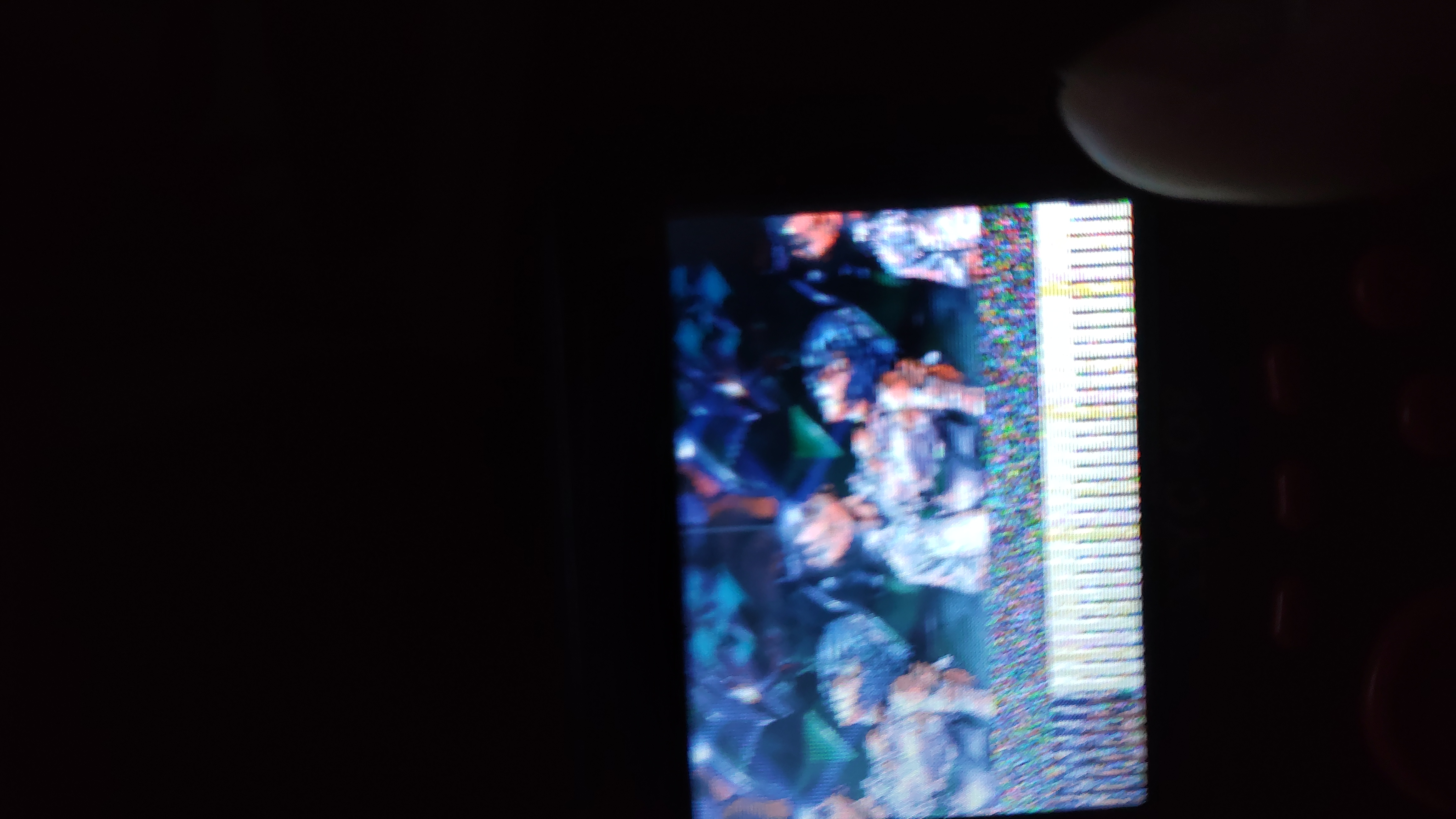

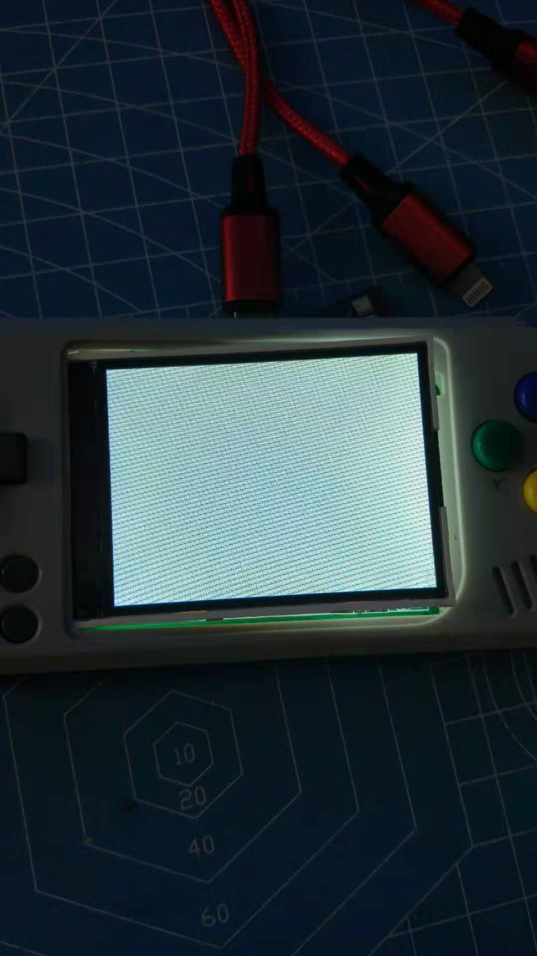

#1025 2022-09-06 17:20:09
neotendo
注册时间: 2022-08-19
已发帖子: 180
积分: 203

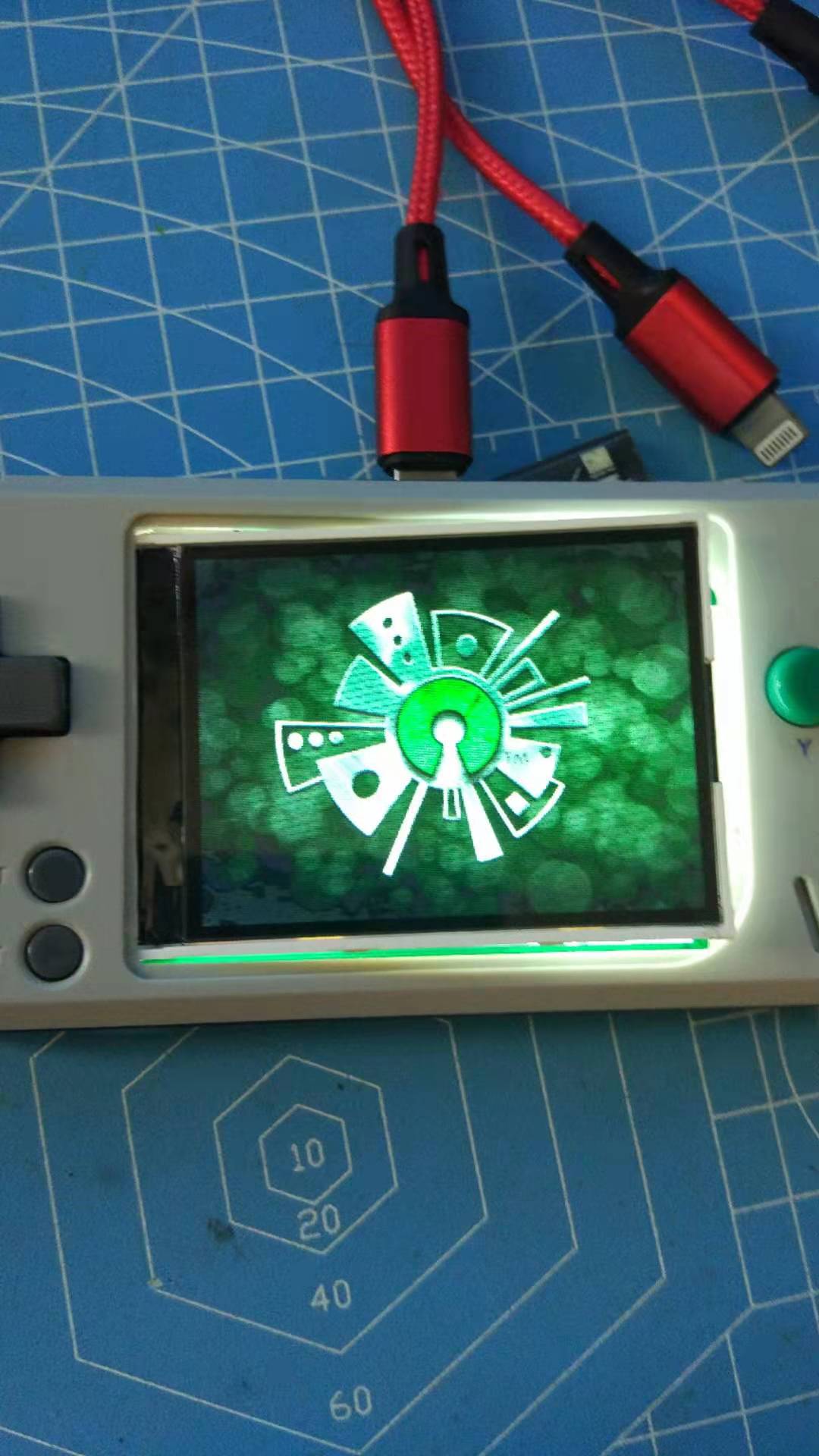

Update:  Looks like a i am on the right track, shot was taken during RGB Stripes Drawing. I edit the ST7789 initial code in RB Swap order.
楼主 #1026 2022-09-06 17:47:52
司徒
注册时间: 2020-02-13
已发帖子: 547
积分: 157
Hero ~ cool

楼主 #1045 2022-09-09 19:20:40
司徒
注册时间: 2020-02-13
已发帖子: 547
积分: 157
@neotendo
Yes, in order to prevent flicking, which some LCD panels show white color when RESET is active, it is turned off in uboot and framebuffer initialization stages. So, you also need to set backlight level in device tree:
kernel/arch/arm/boot/dts/fc3000.dts
27     default-brightness-level = <0>;
#1046 2022-09-09 20:32:36
neotendo
注册时间: 2022-08-19
已发帖子: 180
积分: 203
@司徒
no, sadly did not work either.
tft - screen flashes bright shortly, blackscreen/no backlight, logo flashes shortly before gmenu starts.
ips -screen flashes shortly but dimmed, blackscreen/no backlight, logo flashes shortly before gmenu starts.
i think there must be a (backlight on/off) command somewhere in the code.
ps: my logo seems a 24bit image, must create a 16bit.
https://youtu.be/mTNIlMzeqyE
最近编辑记录 neotendo (2022-09-09 20:35:51)

#1048 2022-09-09 21:57:40
neotendo
注册时间: 2022-08-19
已发帖子: 180
积分: 203
司徒 说:
@neotendo
Okay, thanks for your testing ~
I will check this issue when get my new FC3000, lol lol ~
hahahaha, really?  ok, i will be waiting
can you compile png2hex.c and convert this test logo for me please?
i only have linux subsystem in window 10, and it does not allow me to use hardware such GraphicSystem (SDL not working)
i even do not know how to create a 16bit png file.
最近编辑记录 neotendo (2022-09-09 22:00:25)

#1050 2022-09-10 01:25:05
neotendo
注册时间: 2022-08-19
已发帖子: 180
积分: 203
司徒 说:
@neotendo
miyoo.h.zip
Thank you
#1051 2022-09-10 01:48:38
neotendo
注册时间: 2022-08-19
已发帖子: 180
积分: 203
司徒 说:
@neotendo
miyoo.h.zip
your png2hex didn't work, it counts up, nothing more.
I saw this on my compiled png2hex test, it dumped a lot of ncurses garbage and some uint16 stuff in between, but all values just count up, just like your miyoo.h.
I don't have any developer toolchain or anything like that on Windows, only Freebasic, I use it to "script" something quickly, but my attempt with png2hex wasn't good enough, maybe because my PNG is 24-bit.
Cross Compile to windows in linux shell is pure hell.
*Bootlogo still shows only shortly before gmenu starts
最近编辑记录 neotendo (2022-09-10 01:53:38)

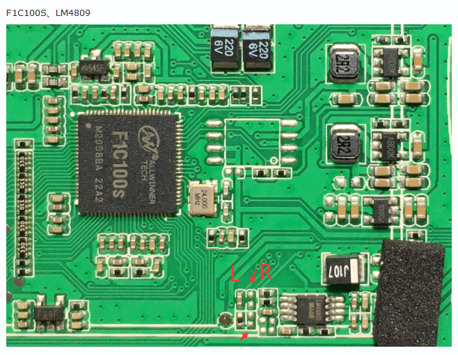

My new FC3000 arrived ~

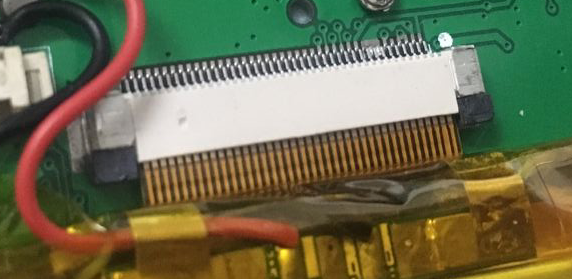

#1069 2022-09-16 20:59:49
neotendo
注册时间: 2022-08-19
已发帖子: 180
积分: 203
司徒 说:
@neotendo
[Q1] is there a chance to get duke3d running on fc3000?
[Q2] i have the backlight problem in uboot aswell, no light.
I will check these issues soon.
https://whycan.com/files/members/3145/1_20220916-1010.jpg
https://whycan.com/files/members/3145/2_20220916-1010.jpg
ahhh very cool, another CPU but a known LCD, uboot_ips2.img should work out of the box

Yes, it is running Linux OS with booting logo on my new FC3000 handheld now. I am creating 2 repos for bootloader and kernel source code. After complete, I will share it to you. For eduke32, as Apaczer mentioned, it is base on MIDI music format but it has some limitations on current rootfs because no any timidity configuration in system. Besides, eduke32 has another memory segmentation issue that happens on drawing animation. I think I will take a look at eduke32 soon.
Here are the ideas, maybe, we can use:
1. use WAV to replace MIDI
2. port SDL2 for eduke32
Does it mean i can overclock the fc3000 now?
Everytime system hangs while starting an app when i set cpu over 702mhz.
Or is a resistor change mandatory?
楼主 #1110 2022-09-28 21:31:30
司徒
注册时间: 2020-02-13
已发帖子: 547
积分: 157
@neotendo
Yes, you can do overclock on your FC3000 handheld under GMenu2X setting. If you need high CPU speed, ex: 900MHz, you need to do hardware modding. If not, I think 702MHz is the best choice.
#1111 2022-09-28 22:29:12
neotendo
注册时间: 2022-08-19
已发帖子: 180
积分: 203
司徒 说:
@neotendo
But i need to update gmenu2x right?
I tried deleting gmenu2x.conf too, but everytime when i set clock speed above 702mhz, fc3000 hangs.
最近编辑记录 neotendo (2022-09-28 22:30:55)
楼主 #1112 2022-09-28 23:08:33
司徒
注册时间: 2020-02-13
已发帖子: 547
积分: 157
@neotendo
The maximum CPU clock we can use on the FC3000 without hardware modding is around 702MHz. So, you cannot set the CPU clock that exceeds 702MHz.
#1113 2022-09-28 23:33:36
neotendo
注册时间: 2022-08-19
已发帖子: 180
积分: 203
司徒 说:
@neotendo
Ahh, ok, get it. So if i want above 702 i must change the resistors like on the first pages, ok

The enemies do in fact flicker sometimes, it is a mix of disappearing, flickering and going trough walls
#1119 2022-09-30 00:14:01
neotendo
注册时间: 2022-08-19
已发帖子: 180
积分: 203
@Situ
i try to change sounds from .grp file to wav/voc/ogg maybe that helps.
I play the same version on qemu and fc3000, on qemu eduke works fine but on fc3000 the enemies seems to fall trough the floor. (i saw 2 enemies in water but they had to be on the ground above).
enemies sometimes flicker or disappearing, very strange.
do you have any clue? i do not!

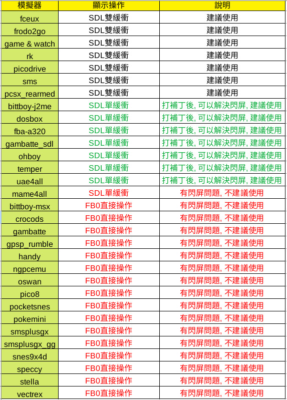

Try to "OR" SDL_DOUBLEBUF when call SDL_SetVideoMode() function.
SDL_SetVideoMode(1, 1, 8, SDL_NOFRAME | SURFACE_FLAGS | ((fs&1)?SDL_FULLSCREEN:0) | SDL_DOUBLEBUF);
P.S. Update all of SDL_SetVideoMode() functions.

楼主 #1125 2022-09-30 18:42:05
司徒
注册时间: 2020-02-13
已发帖子: 547
积分: 157
@neotendo @Apaczer
Wow ! It is official support ~ Thanks for this information !
stable: https://buildbot.libretro.com/stable/1.10.3/dingux/miyoo-arm32/
nightly: https://buildbot.libretro.com/nightly/dingux/miyoo-arm32/
Run RetroArch on FC3000
#1126 2022-09-30 20:24:57
neotendo
注册时间: 2022-08-19
已发帖子: 180
积分: 203
司徒 说:
@neotendo
@Apaczer
Thanks for your information.
Too sad, it was not the solution. That's so strange and makes me angry.
Still glitching and disappearing
https://youtu.be/m1EGq6mR0QM
最近编辑记录 neotendo (2022-09-30 20:25:30)

Please provide the save state to me.

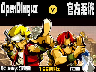

Support dual boot function on FC3000 handheld
U-Boot source: https://github.com/steward-fu/bootloader/commit/e02c2adfa3eacbe93338df28d7b93c3bbb5f93d9
By default, it boots into Linux OS.
If press SELECT button and then power on, it boots into stock system.

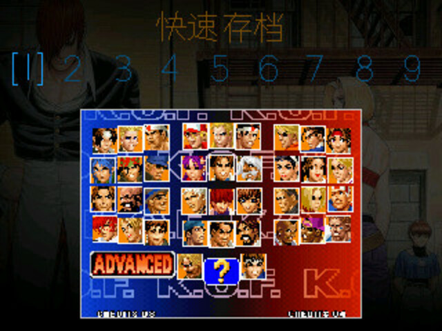

https://whycan.com/files/members/3145/1_20220930-2229.jpg
i saved it, but preview picture is currupt, can not load back the save game, errors or savegame currupt in log file.

something went realy wrong on FC3000 hardware.
Savegame from eduke32 FC3000 Hardware on QEMU(looks same on FC3000)

i tried your dual boot feature. we have the problem now, stock firmware search roms on the first partition (FC3000) where the rootfs is.
this partition has not enough space and our other roms are on the second partition (OD).
only solution that came in mind is to put all files in first partition and mount that as /mnt, so we have /roms folder in stock firmware and /mnt/roms in linux firmware.
or link the folders if possible, idk.
最近编辑记录 neotendo (2022-10-01 20:33:52)

User need to resize the first partition in order to put all of needed files. For battery issue, we needs to take a look at GMenu2X to see what kind of value read from kernel driver. For eduke32, it seems this issue is related to chip issue rather than performance issue because the enemy's position is wrong when render sprite. Since eduke32's source code is very complicated, I think it is not easy to find root cause out in a short time. For RetroArch, it is worthy to run RetroArch on miyoo handheld even if the performance is not good. We need focus on software optimization rather than high performance chip, which this is what we need eventually. Also, we need to thanks all of contributors for open source ported on miyoo handheld.

@司徒
I didn't say anything against retroarch, just that the video filters weren't that good for this hardware.
yes that's right, the eduke32 code is hard to understand.
even voxel based enemies are glitching, damn.
*user needs to resize...
but then you would have to have the roms twice on the sd card.
I'm trying to make the whole system on one partition, was able to mount /dev/mmcblk0p1 as rw and mounted partition 1 on /romdir.
have created /roms/sfc on partition 1, can access it with stock and linux.
in theory all contents from partition 2 can copy over to partition 1 and mounted on /mnt instead /romdir.
I also wrote a script which tests the fat partition for dirty bits and then runs fsck.vfat if the system was simply switched off (because of partition 1 rw mode).
updated snes9x4D and pocketSNES also.
最近编辑记录 neotendo (2022-10-02 01:55:45)

@Situ
new system done!!
Created 2 partitions with minitool partition wizard, one 32MB and one with the rest of sdcard (win10 did not allow create fat32 partitions bigger than 32GB).
Deleted the first 32MB partition (32MB unalocated, 57GB Fat32).
dd uboot+kernel into the unallocated 32MB partition.
copied over my modded linux systemfiles to the big Fat32 partition, now the stock firmware and linux can access the /roms folder.
But looks like that the Stock NeoGeo emu accepts WST roms only.
- updated gngeo
EDUKE32
i think the error lies in drawsprite() function in engine.c, but i have not such a fast eye for buggy source code as you wink.
最近编辑记录 neotendo (2022-10-02 05:33:36)

zjzixuan
注册时间: 2022-04-04
积分: 15
@司徒 大佬我有个F1C100S主板刷了fc3000_ips_od_jutleys_no_roms.img这个固件 屏幕不支持一直闪 是不是屏的驱动不对啊
怎么修改啊
下面这个是我自己的屏
1    GND
2    GND
3    LEDA
4    GND
5    GND
6    VDD
7    GND
8    PD19
9    PD18
10    PD20

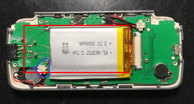

zjzixuan
注册时间: 2022-04-04
积分: 15
@neotendo  屏上的信息 YZTM081 JH011611

你的機器可以拍張照片嗎?然後屏的FPC排線也拍一下照片~

I saw your lcd ribbon and pcb pictures, looks not like an FC3000 handheld.
So our FC3000 images are not for your hardware if i see it correct.

司徒
注册时间: 2020-02-13
已发帖子: 547
积分: 157
司徒收到許多網友的來信,信中主要的問題,幾乎都是想要在舊版機器(8個模擬器)刷入新版的系統(10個模擬器),因此,發生許多變磚的情況,雖然事後幾乎都有補救回來,不過,這也讓司徒更加好奇並且想要一探官方系統的奧秘,雖然逆向破解需要花費很多時間跟精力,而且失敗機率很高,司徒也不確定是否可以勝任,因此,司徒訂了兩個逆向目標:
1. 找出LCD初始化的地方
2. 繞過加密IC,不需要加密IC也可以進入官方系統
司徒給自己的時間是三個月,三個月後,如果還是無法破解,則以失敗收場,當然,這應該是司徒幫FC3000進行的最後一個實驗項目了,司徒還是希望可以漂亮收場,這樣就可以讓新系統可以刷入舊版的機器!
司徒使用黑箱測試手法測試,發現加密IC有三個使用時機點,分別是:
1. 開機時檢查,如果沒有加密IC,則無限迴圈
2. 進入模擬器時檢查,如果沒有加密IC,則無限迴圈
3. 退出模擬器時檢查,如果沒有加密IC,則等待到加密IC出現
司徒使用黑箱測試後,發現最舊的TFT v1系統和最新的IPS v2系統都是使用同一種加密IC,因此,合理猜測全部的FC3000都是使用同一套加密算法,廠家真是相當貼心~
楼主 #1221 2022-10-22 00:11:13
司徒
注册时间: 2020-02-13
已发帖子: 547
积分: 157
由於FC3000的MicroSD控制方式是使用SPI介面,因此,缺少幾根JTAG腳位,不然就可以很方便的透過JTAG除錯
司徒在之前的測試當中,有把對應的JTAG腳位找出來
拉出一個專屬的JTAG排針
可惜,這樣的方式相當容易跑飛
司徒這次並沒有打算在FC3000上面做除錯的動作,而是想找一個完美軀體做借屍還魂測試,因此,首要任務就是需要把加密IC的腳位找出來,加密IC位置如下:
解焊後
查了一下電路,腳位如下:
可以看出,現今加密IC競爭激烈,連電池電量指示都需要包進去,真是一個相當辛苦的行業~
為了尋找完美的軀體,司徒再度來到芒果三兄弟的家裡,芒果三兄弟在上次超頻事件中,損失慘重,目前只剩下芒果大哥一人,大哥似乎知道司徒來訪的目的,輕聲細語跟司徒說:不要超頻,其餘都可以~
首先拆掉NAND Flash,換成FC3000的W25Q64
接著接上加密IC、喇叭、按鍵(PE2, 按鍵RIGHT),透過按鍵跟喇叭的測試,可以知道目前是否正常啟動官方系統
MicroSD就可以接上JTAG進行除錯
