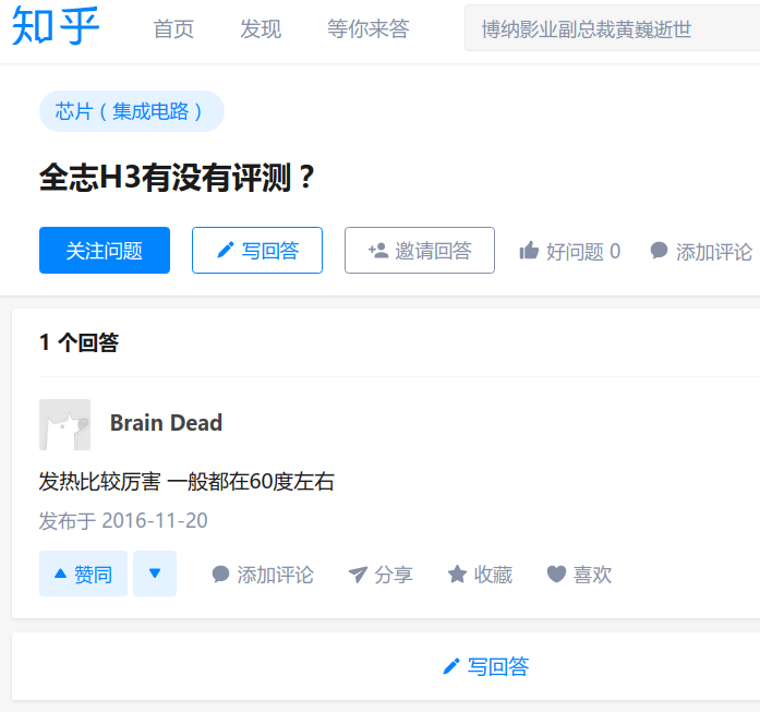

#28 全志 SOC » 请教: H3 发热问题,请教各位解决经验 » 2020-06-11 09:48:08
everlink
回复: 5
先后做了两款PCB,第一款贴H3,第二款贴H2+
感觉温度都不理想, 第二款(H2+) 更热,只是跑起来系统(空载)都烫手
各位有遇到吗,是如何解决的
全志系有没有 H3 运算力, F1C100S 工作温度的芯片?或者其他家?

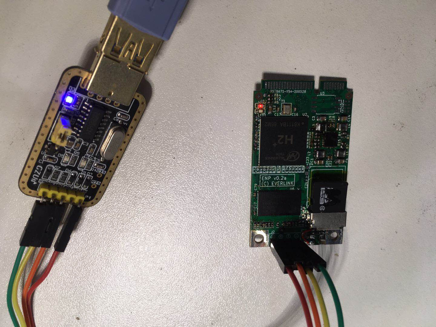

#29 Re: 全志 SOC » {水} 整好板子又整了两天固件,发一个 H3 KERNEL 5.7 (BIN) » 2020-06-10 23:50:22
checkout 说:
板子裸照发出来大家看看:)
之前有在一位大神的贴子跟帖发过,大概长这样
#30 Re: 全志 SOC » {水} 整好板子又整了两天固件,发一个 H3 KERNEL 5.7 (BIN) » 2020-06-10 23:08:06
checkout 说:
最近也在用H3,你自己画的板子?
en, 是的
#31 全志 SOC » {水} 整好板子又整了两天固件,发一个 H3 KERNEL 5.7 (BIN) » 2020-06-10 22:22:41
everlink
回复: 11
https://whycan.cn/files/members/3162/h3-spiflash8m_bin.gz

[    1.519404][    T1] ohci-platform 1c1c400.usb: irq 27, io mem 0x01c1c400
[    1.601075][    T1] hub 5-0:1.0: USB hub found
[    1.606004][    T1] hub 5-0:1.0: 1 port detected
[    1.612289][    T1] ohci-platform 1c1d400.usb: Generic Platform OHCI controller
[    1.619763][    T1] ohci-platform 1c1d400.usb: new USB bus registered, assigned bus number 6
[    1.628576][    T1] ohci-platform 1c1d400.usb: irq 29, io mem 0x01c1d400
[    1.711068][    T1] hub 6-0:1.0: USB hub found
[    1.715978][    T1] hub 6-0:1.0: 1 port detected
[    1.725875][    T1] sun6i-rtc 1f00000.rtc: registered as rtc0
[    1.731750][    T1] sun6i-rtc 1f00000.rtc: setting system clock to 1970-01-01T02:06:21 UTC (7581)
[    1.740710][    T1] sun6i-rtc 1f00000.rtc: RTC enabled
[    1.746227][    T1] i2c /dev entries driver
[    1.751075][    T1] IR NEC protocol handler initialized
[    1.756387][    T1] IR RC5(x/sz) protocol handler initialized
[    1.762150][    T1] IR RC6 protocol handler initialized
[    1.767427][    T1] IR JVC protocol handler initialized
[    1.772667][    T1] IR Sony protocol handler initialized
[    1.778038][    T1] IR SANYO protocol handler initialized
[    1.783454][    T1] IR Sharp protocol handler initialized
[    1.788902][    T1] IR MCE Keyboard/mouse protocol handler initialized
[    1.795487][    T1] IR XMP protocol handler initialized
[    1.802879][    T1] sunxi-wdt 1c20ca0.watchdog: Watchdog enabled (timeout=16 sec, nowayout=0)
[    1.811893][    T1] cpu cpu0: failed to get clock: -2
[    1.817072][    T1] cpufreq-dt: probe of cpufreq-dt failed with error -2
[    1.825434][    T1] sun8i-h3-pinctrl 1c20800.pinctrl: supply vcc-pf not found, using dummy regulator
[    1.836520][    T1] sunxi-mmc 1c0f000.mmc: Got CD GPIO
[    1.867612][    T1] sunxi-mmc 1c0f000.mmc: initialized, max. request size: 16384 KB
[    1.876396][    T1] sun8i-h3-r-pinctrl 1f02c00.pinctrl: supply vcc-pl not found, using dummy regulator
[    1.889069][    T1] usbcore: registered new interface driver usbhid
[    1.895444][    T1] usbhid: USB HID core driver
[    1.903590][    T1] NET: Registered protocol family 17
[    1.908916][    T1] can: controller area network core (rev 20170425 abi 9)
[    1.916116][    T1] NET: Registered protocol family 29
[    1.921286][    T1] can: raw protocol (rev 20170425)
[    1.926353][    T1] can: broadcast manager protocol (rev 20170425 t)
[    1.932748][    T1] can: netlink gateway (rev 20190810) max_hops=1
[    1.939532][    T1] Key type dns_resolver registered
[    1.944914][    T1] Registering SWP/SWPB emulation handler
[    1.980428][    T1] ALSA device list:
[    1.984154][    T1]   No soundcards found.
[    2.180169][    C0] random: crng init done
[    2.894074][    T1] VFS: Mounted root (jffs2 filesystem) on device 31:3.
[    2.902980][    T1] devtmpfs: mounted
[    2.911206][    T1] Freeing unused kernel memory: 1024K
[    2.917124][    T1] Run /sbin/init as init process
Starting logging: OK
Starting network: OK
Welcome to Buildroot
buildroot login: root
# uname -a
Linux buildroot 5.7.0-g8dcbf7e #2 SMP Wed Jun 10 21:19:56 CST 2020 armv7l GNU/Linux

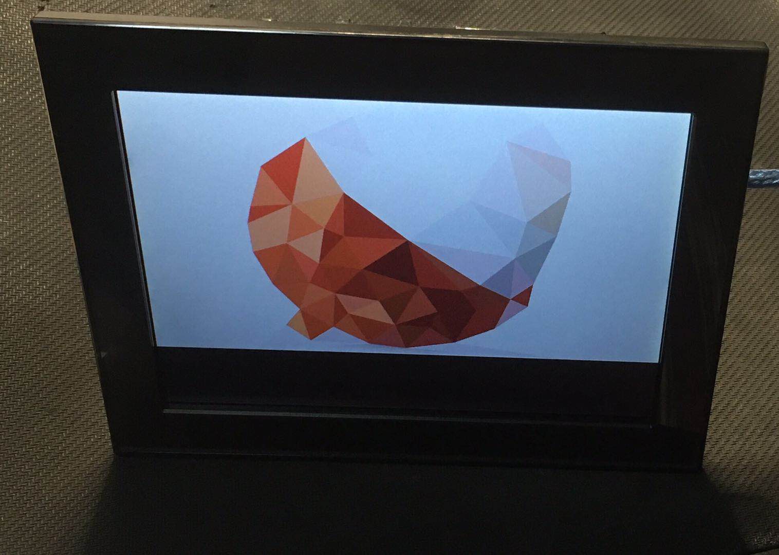

#34 Re: 全志 SOC » FC200S - 断断续续整了好久好久,今天终于点亮了 60PIN 的 屏幕,荔枝比较大~ » 2020-06-07 23:53:40
sungq 说:
60Pin和40pin的普通屏幕有啥区别,调试难度大吗?
如果你之前调过其它屏幕那是不难的,只是我第一次调RGB屏幕.主要区别是:硬件要造各种电压.要花时间试验各种电路
11.6V
15V
-7V
4.9V
10.97V
9.35V
8.63V
8.18V
7.21V
5.10V
4.13V
3.67V
2.92V
1.30V
http://www.yslcd.com.tw/docs/product/A070SN01%20V.3.pdf

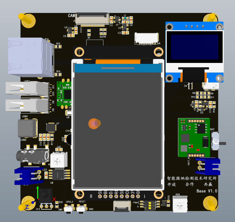

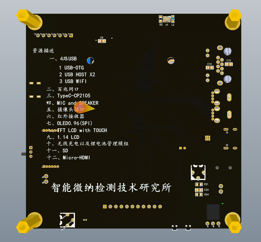

这个是全功能底板99X99mm
屏幕把BTB母座挡住了
这两个板子已经回来了  只是我还在返校隔离中 不能去取快递
我做的这些工作中有些地方参考借鉴了B站稚辉君的创意  我觉得他做的很棒
比如typeC 母座 两路USB分开 一路给了USB转双串口的CP2105  一路给了芯片的OTG
我买了一些了typec的公头  发现公头的数据接口其实只用了一面  所以可以通过正反插切换OTG和串口
https://whycan.cn/files/members/3465/basetop.png
https://whycan.cn/files/members/3465/basebottom.png
请教最上面的 CAM 是怎么接 H3 的?

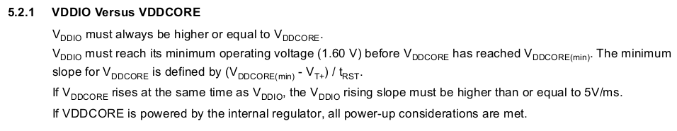

看19页的上电时序图, 可以同时上电。
谢谢你。从时序图看是“要求”同时上电。而不是“可以”对吗。看不出timing间隔/余量。
我相信在实验室随便搭都能跑,但是怕的是批量是部分不良。
