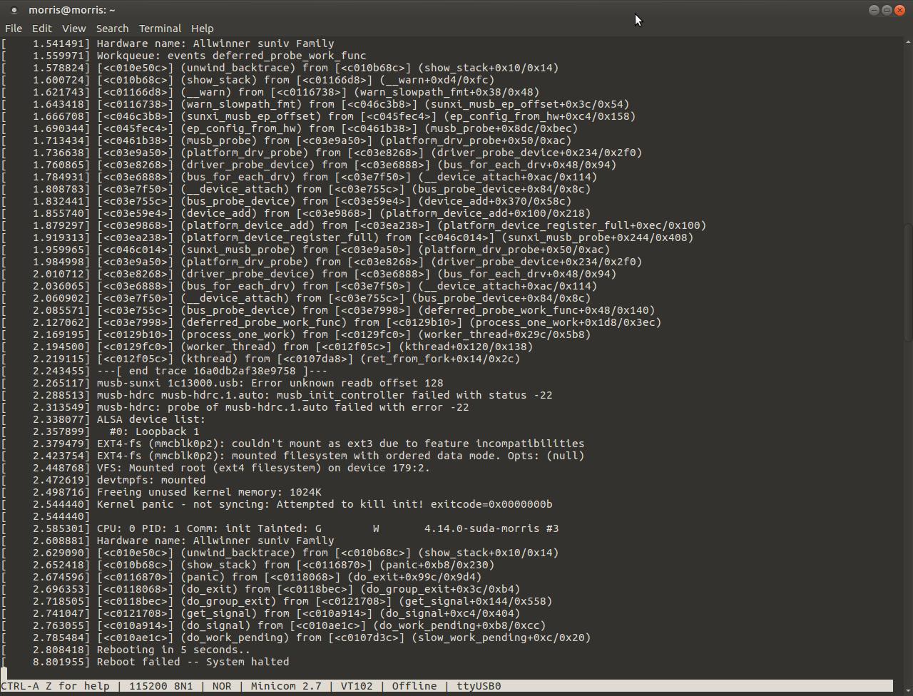

#134 全志 SOC » reboot不起作用 » 2018-10-06 01:27:12
msr06rr
回复: 2
登录到licheepi的终端,输入reboot后系统是停止了,但是并没有重新启动,需要怎么操作?
# reboot
# Stopping network: OK
Saving random seed... done.
Stopping logging: OK
umount: devtmpfs busy - remounted read-only
The system is going down NOW!
Sent SIGTERM to all processes
Sent SIGKILL to[   61.846497] reboot: Restarting system
[   62.846139] Reboot failed -- System halted
#135 Re: 全志 SOC » linux内核启动过程中没有看到分区标信息 » 2018-10-06 01:10:35
root=/dev/mtdblock3修改为root=31:03就可以了,有大神可以解释一下原因吗?
#136 Re: 全志 SOC » linux内核启动过程中没有看到分区标信息 » 2018-10-05 15:08:21

dts/dtsi 两个文件都贴上来看下
这是dtsi文件
#include <dt-bindings/clock/suniv-ccu.h>
#include <dt-bindings/reset/suniv-ccu.h>
	#address-cells = <1>;
	#size-cells = <1>;
	interrupt-parent = <&intc>;
	clocks {

这是dts文件
/dts-v1/;
#include "suniv-f1c100s.dtsi"
	model = "Lichee Pi Nano";
	compatible = "licheepi,licheepi-nano", "allwinner,suniv-f1c100s",
		     "allwinner,suniv";
	aliases {
		serial0 = &uart0;
		spi0 = &spi0;
	chosen {
	reg_vcc3v3: vcc3v3 {
		regulator-name = "vcc3v3";
&mmc0 {
	vmmc-supply = <&reg_vcc3v3>;
	bus-width = <4>;
	broken-cd;
&otg_sram {
&spi0 {
	pinctrl-names = "default";
	pinctrl-0 = <&spi0_pins_a>;
	flash: w25q128@0 {
		#size-cells = <1>;
		reg = <0>;
		partitions {
            #size-cells = <1>;
            partition@0 {
                label = "u-boot";
                reg = <0x000000 0x100000>;
                read-only;
            partition@100000 {
                label = "dtb";
                reg = <0x100000 0x10000>;
                read-only;
            partition@110000 {
                label = "kernel";
                reg = <0x110000 0x400000>;
                read-only;
            partition@510000 {
                label = "rootfs";
                reg = <0x510000 0xAF0000>;
&uart0 {
	pinctrl-0 = <&uart0_pins_a>;
&usb_otg {
	dr_mode = "otg";
&usbphy {
	usb0_id_det-gpio = <&pio 4 2 GPIO_ACTIVE_HIGH>; /* PE2 */
#138 全志 SOC » linux内核启动过程中没有看到分区标信息 » 2018-10-05 14:51:24
msr06rr
回复: 14
U-Boot 2018.01suda-05679-g013ca457fd-dirty (Oct 04 2018 - 14:10:48 +0800)
Model: Lichee Pi Nano
DRAM:  32 MiB
MMC:   SUNXI SD/MMC: 0
In:    serial@1c25000
Out:   serial@1c25000
Err:   serial@1c25000
Net:   No ethernet found.
starting USB...
No controllers found
   Loading Device Tree to 80e41000, end 80e4605b ... OK
[    0.000000] Linux version 4.14.0-suda-morris+ (wendy@wendy-PC) (gcc version 8.2.0 (morris)) #5 Fri Oct 5 14:25:26 CST 2018
[    0.000000] Kernel command line: console=ttyS0,115200 console=tty0 panic=5 rootwait root=/dev/mtdblock3 rw rootfstype=jffs2
[    0.000000] Memory: 22668K/32768K available (6144K kernel code, 212K rwdata, 1392K rodata, 1024K init, 250K bss, 10100K reserved, 0K cma-reserved, 0K highmem)
[    0.000000]       .data : 0xc0a00000 - 0xc0a35080   ( 213 kB)
[    0.000000]        .bss : 0xc0a3a444 - 0xc0a78e14   ( 251 kB)
[    0.000110] clocksource: timer: mask: 0xffffffff max_cycles: 0xffffffff, max_idle_ns: 79635851949 ns
[    0.000647] Console: colour dummy device 80x30
[    0.001616] console [tty0] enabled
[    0.001719] Calibrating delay loop... 203.16 BogoMIPS (lpj=1015808)
[    0.070283] pid_max: default: 32768 minimum: 301
[    0.070660] Mount-cache hash table entries: 1024 (order: 0, 4096 bytes)
[    0.070760] Mountpoint-cache hash table entries: 1024 (order: 0, 4096 bytes)
[    0.072247] CPU: Testing write buffer coherency: ok
[    0.073966] Setting up static identity map for 0x80100000 - 0x80100058
[    0.076512] devtmpfs: initialized
[    0.083520] clocksource: jiffies: mask: 0xffffffff max_cycles: 0xffffffff, max_idle_ns: 19112604462750000 ns
[    0.083688] futex hash table entries: 256 (order: -1, 3072 bytes)
[    0.084002] pinctrl core: initialized pinctrl subsystem
[    0.086086] NET: Registered protocol family 16
[    0.087707] DMA: preallocated 256 KiB pool for atomic coherent allocations
[    0.089590] cpuidle: using governor menu
[    0.115011] SCSI subsystem initialized
[    0.115421] usbcore: registered new interface driver usbfs
[    0.115640] usbcore: registered new interface driver hub
[    0.115906] usbcore: registered new device driver usb
[    0.116405] pps_core: LinuxPPS API ver. 1 registered
[    0.116494] pps_core: Software ver. 5.3.6 - Copyright 2005-2007 Rodolfo Giometti <giometti@linux.it>
[    0.116641] PTP clock support registered
[    0.117182] Advanced Linux Sound Architecture Driver Initialized.
[    0.120400] clocksource: Switched to clocksource timer
[    0.146603] NET: Registered protocol family 2
[    0.148148] TCP established hash table entries: 1024 (order: 0, 4096 bytes)
[    0.148303] TCP bind hash table entries: 1024 (order: 0, 4096 bytes)
[    0.148397] TCP: Hash tables configured (established 1024 bind 1024)
[    0.148722] UDP hash table entries: 256 (order: 0, 4096 bytes)
[    0.148830] UDP-Lite hash table entries: 256 (order: 0, 4096 bytes)
[    0.149347] NET: Registered protocol family 1
[    0.150530] RPC: Registered named UNIX socket transport module.
[    0.150647] RPC: Registered udp transport module.
[    0.150699] RPC: Registered tcp transport module.
[    0.150744] RPC: Registered tcp NFSv4.1 backchannel transport module.
[    0.151959] NetWinder Floating Point Emulator V0.97 (double precision)
[    0.153781] Initialise system trusted keyrings
[    0.154429] workingset: timestamp_bits=30 max_order=13 bucket_order=0
[    0.171477] NFS: Registering the id_resolver key type
[    0.171656] Key type id_resolver registered
[    0.171719] Key type id_legacy registered
[    0.171884] jffs2: version 2.2. (NAND) © 2001-2006 Red Hat, Inc.
[    0.185688] Key type asymmetric registered
[    0.185801] Asymmetric key parser 'x509' registered
[    0.186055] Block layer SCSI generic (bsg) driver version 0.4 loaded (major 251)
[    0.186158] io scheduler noop registered
[    0.186207] io scheduler deadline registered
[    0.187017] io scheduler cfq registered (default)
[    0.187117] io scheduler mq-deadline registered
[    0.187174] io scheduler kyber registered
[    0.188366] sun4i-usb-phy 1c13400.phy: Couldn't request ID GPIO
[    0.198104] suniv-pinctrl 1c20800.pinctrl: initialized sunXi PIO driver
[    0.366899] Serial: 8250/16550 driver, 8 ports, IRQ sharing disabled
[    0.373874] console [ttyS0] disabled
[    0.394212] 1c25000.serial: ttyS0 at MMIO 0x1c25000 (irq = 23, base_baud = 6250000) is a 16550A
[    0.875798] console [ttyS0] enabled
[    0.886320] panel-simple panel: panel supply power not found, using dummy regulator
[    0.895641] SCSI Media Changer driver v0.25
[    0.901430] ehci_hcd: USB 2.0 'Enhanced' Host Controller (EHCI) Driver
[    0.908043] ehci-platform: EHCI generic platform driver
[    0.913695] ohci_hcd: USB 1.1 'Open' Host Controller (OHCI) Driver
[    0.919979] ohci-platform: OHCI generic platform driver
[    0.925737] usbcore: registered new interface driver usb-storage
[    0.932826] udc-core: couldn't find an available UDC - added [g_cdc] to list of pending drivers
[    0.942013] i2c /dev entries driver
[    1.000538] sunxi-mmc 1c0f000.mmc: base:0xc28a4000 irq:19
[    1.008061] usbcore: registered new interface driver usbhid
[    1.013834] usbhid: USB HID core driver
[    1.035740] NET: Registered protocol family 17
[    1.040675] Key type dns_resolver registered
[    1.047301] Loading compiled-in X.509 certificates
[    1.061799] [drm] Supports vblank timestamp caching Rev 2 (21.10.2013).
[    1.068503] [drm] No driver support for vblank timestamp query.
[    1.075502] sun4i-drm display-engine: bound 1e60000.display-backend (ops 0xc0739508)
[    1.084470] sun4i-drm display-engine: bound 1c0c000.lcd-controller (ops 0xc07388bc)
[    1.224972] Console: switching to colour frame buffer device 100x30
[    1.272773] sun4i-drm display-engine: fb0:  frame buffer device
[    1.289137] [drm] Initialized sun4i-drm 1.0.0 20150629 for display-engine on minor 0
[    1.307923] usb_phy_generic usb_phy_generic.0.auto: usb_phy_generic.0.auto supply vcc not found, using dummy regulator
[    1.338673] ------------[ cut here ]------------
[    1.353156] WARNING: CPU: 0 PID: 3 at drivers/usb/musb/sunxi.c:411 sunxi_musb_ep_offset+0x3c/0x54
[    1.372120] sunxi_musb_ep_offset called with non 0 offset
[    1.387636] Modules linked in:
[    1.400642] CPU: 0 PID: 3 Comm: kworker/0:0 Not tainted 4.14.0-suda-morris+ #5
[    1.418208] Hardware name: Allwinner suniv Family
[    1.433215] Workqueue: events deferred_probe_work_func
[    1.448873] [<c010e7f0>] (unwind_backtrace) from [<c010b6d8>] (show_stack+0x10/0x14)
[    1.467562] [<c010b6d8>] (show_stack) from [<c01168f0>] (__warn+0xcc/0xfc)
[    1.485453] [<c01168f0>] (__warn) from [<c0116574>] (warn_slowpath_fmt+0x38/0x48)
[    1.504006] [<c0116574>] (warn_slowpath_fmt) from [<c0479a34>] (sunxi_musb_ep_offset+0x3c/0x54)
[    1.524096] [<c0479a34>] (sunxi_musb_ep_offset) from [<c046d43c>] (ep_config_from_hw+0x74/0x140)
[    1.544324] [<c046d43c>] (ep_config_from_hw) from [<c046f040>] (musb_probe+0x8fc/0xbec)
[    1.563579] [<c046f040>] (musb_probe) from [<c03f6fe8>] (platform_drv_probe+0x50/0xac)
[    1.582762] [<c03f6fe8>] (platform_drv_probe) from [<c03f5774>] (driver_probe_device+0x218/0x2ec)
[    1.603061] [<c03f5774>] (driver_probe_device) from [<c03f3dd8>] (bus_for_each_drv+0x70/0xa0)
[    1.623037] [<c03f3dd8>] (bus_for_each_drv) from [<c03f5478>] (__device_attach+0xac/0x114)
[    1.642819] [<c03f5478>] (__device_attach) from [<c03f4a84>] (bus_probe_device+0x84/0x8c)
[    1.662449] [<c03f4a84>] (bus_probe_device) from [<c03f2f10>] (device_add+0x388/0x594)
[    1.681757] [<c03f2f10>] (device_add) from [<c03f6e0c>] (platform_device_add+0x100/0x20c)
[    1.701119] [<c03f6e0c>] (platform_device_add) from [<c03f7738>] (platform_device_register_full+0xc0/0x108)
[    1.732855] [<c03f7738>] (platform_device_register_full) from [<c0479778>] (sunxi_musb_probe+0x340/0x41c)
[    1.764796] [<c0479778>] (sunxi_musb_probe) from [<c03f6fe8>] (platform_drv_probe+0x50/0xac)
[    1.785261] [<c03f6fe8>] (platform_drv_probe) from [<c03f5774>] (driver_probe_device+0x218/0x2ec)
[    1.806269] [<c03f5774>] (driver_probe_device) from [<c03f3dd8>] (bus_for_each_drv+0x70/0xa0)
[    1.827127] [<c03f3dd8>] (bus_for_each_drv) from [<c03f5478>] (__device_attach+0xac/0x114)
[    1.847541] [<c03f5478>] (__device_attach) from [<c03f4a84>] (bus_probe_device+0x84/0x8c)
[    1.867935] [<c03f4a84>] (bus_probe_device) from [<c03f51b8>] (deferred_probe_work_func+0x8c/0x140)
[    1.900826] [<c03f51b8>] (deferred_probe_work_func) from [<c01299d4>] (process_one_work+0x1d8/0x3e8)
[    1.934330] [<c01299d4>] (process_one_work) from [<c0129e80>] (worker_thread+0x29c/0x5b8)
[    1.955335] [<c0129e80>] (worker_thread) from [<c012ef38>] (kthread+0x120/0x138)
[    1.975432] [<c012ef38>] (kthread) from [<c0108028>] (ret_from_fork+0x14/0x2c)
[    1.995139] ---[ end trace 7c194ff9660c6f5c ]---
[    2.012021] musb-sunxi 1c13000.usb: Error unknown readb offset 128
[    2.030654] musb-hdrc musb-hdrc.1.auto: musb_init_controller failed with status -22
[    2.050934] musb-hdrc: probe of musb-hdrc.1.auto failed with error -22
[    2.070994] vcc3v3: disabling
[    2.085977] ALSA device list:
[    2.100339]   #0: Loopback 1
[    2.114778] Waiting for root device /dev/mtdblock3...
我参考的是http://nano.lichee.pro/build_sys/build_flash.html教程,使用dts来传递分区信息
之前好像看到过有人也遇到过这个问题,不知道是如何解决的?

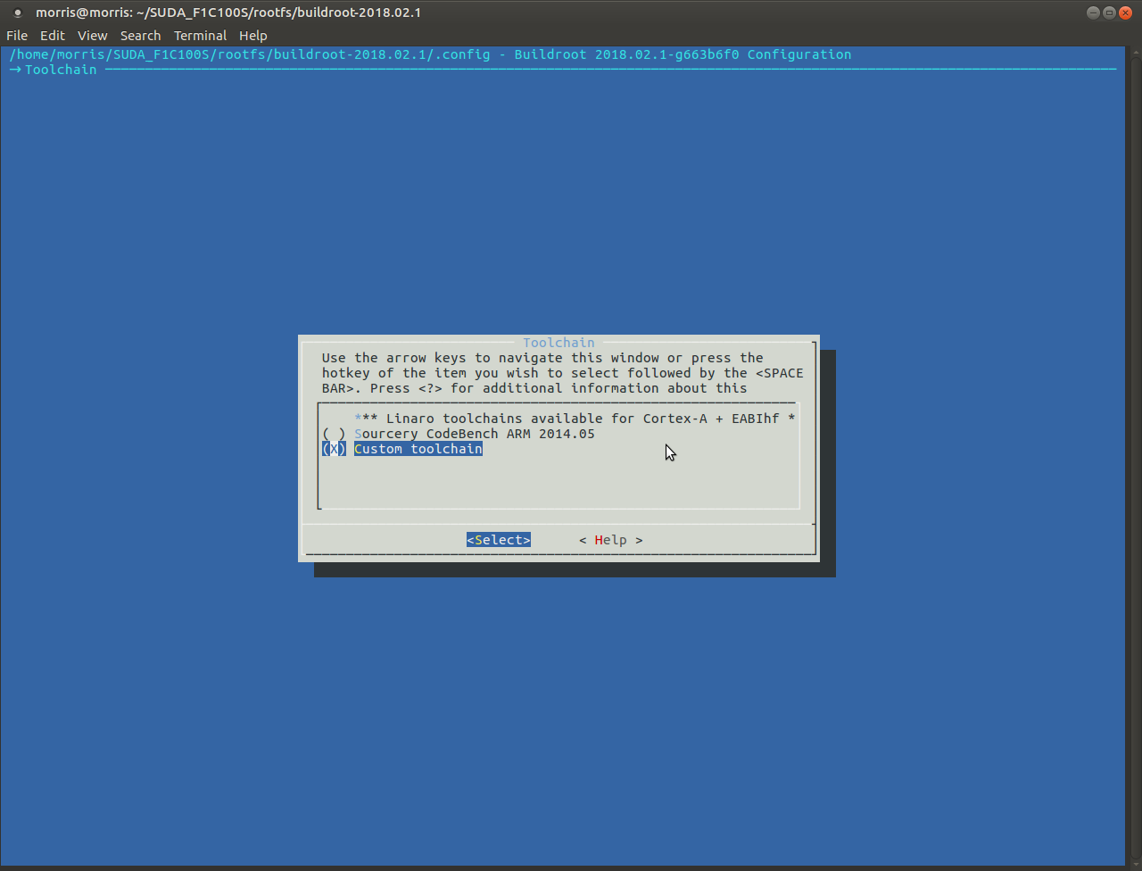

#159 全志 SOC » buildroot选择外部编译器的时候,貌似警告说linaro工具链只支持Cortex A的处理器。。。是这个意思吗? » 2018-04-20 12:27:04
msr06rr
回复: 14
如下图所示,当我配置外部工具链的时候最上面一行字“Linaro toochains available for Cortex-A + EABIhf”
难道Linaro工具链编译LicheePi Nano的Buildroot真的不可用?我尝试了一把,结果上电后就gg了。。。直接Kernel panic,exitcode是0x0000000b
但是选择让buildroot自己下载使用Sourcery CodeBench ARM 2014.5的话,同样的配置,是可以正常工作的

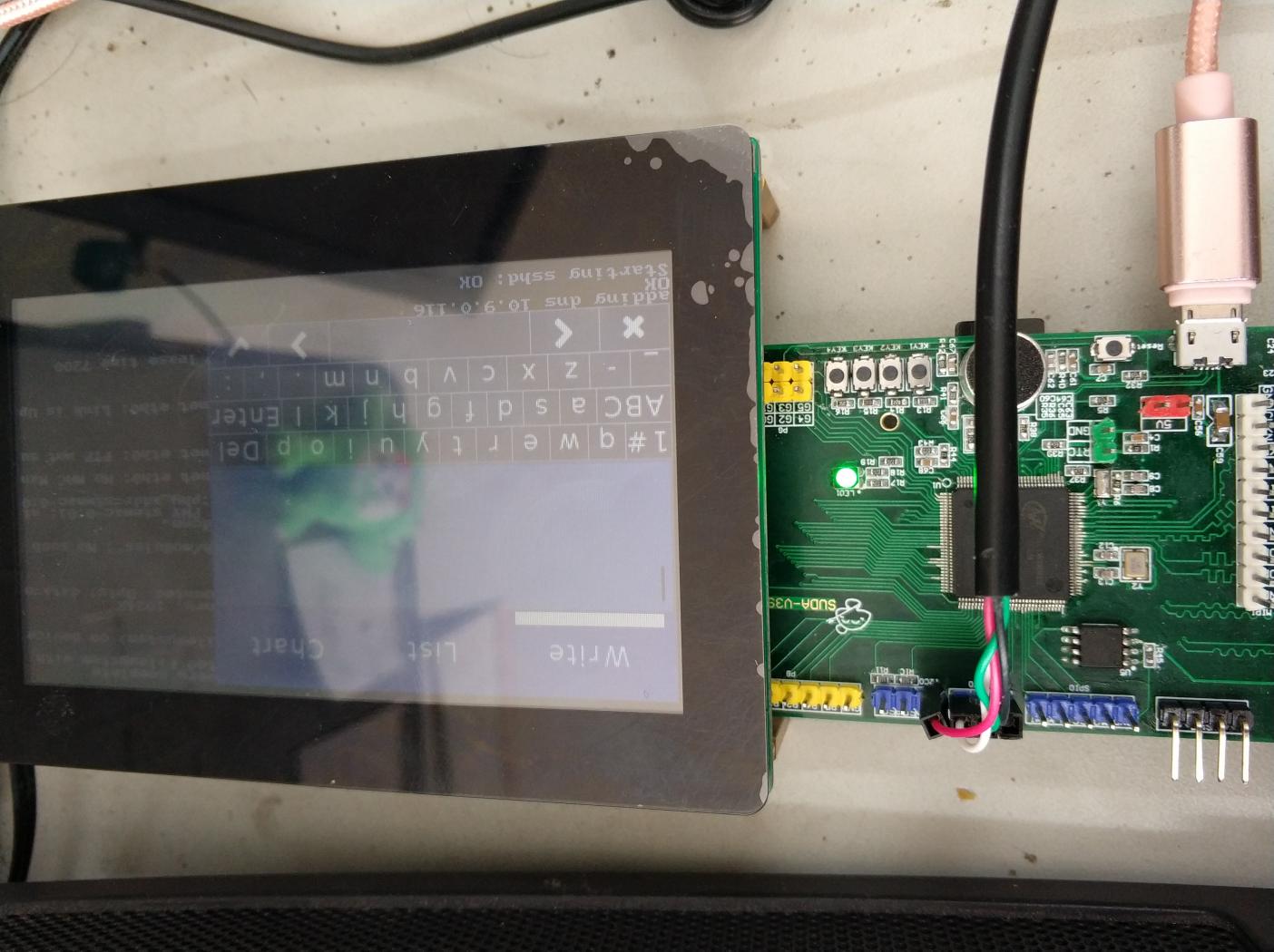

问题终于解决了,焊接的时候PCLK和旁边的GND短在了一起,我的天,折腾了我这么多天
放张效果图,紧跟晕哥的脚步,移植了lvgl
#172 Re: 全志 SOC » 如何讲uboot和内核的启动过程输出到液晶屏上?具体需要哪些操作? » 2018-01-21 23:22:39

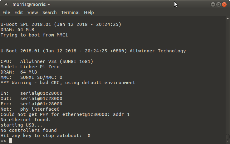

以下是uboot和kernel启动后的输出信息,能看出什么端倪吗?
U-Boot 2017.01-rc2 suda-morris (Jan 21 2018 - 20:17:47 +0800) Allwinner Technology
Model: Lichee Pi Zero
DRAM:  64 MiB
dotclock: 10000kHz = 10000kHz: (1 * 3MHz * 20) / 6
In:    serial@01c28000
Out:   serial@01c28000
Err:   serial@01c28000
Net:   phy interface0
eth0: ethernet@1c30000
starting USB...
switch to partitions #0, OK
mmc0 is current device
Scanning mmc 0:1...
Found U-Boot script /boot.scr
reading /boot.scr
305 bytes read in 14 ms (20.5 KiB/s)
reading zImage
3948464 bytes read in 220 ms (17.1 MiB/s)
reading sun8i-v3s-suda.dtb
11393 bytes read in 26 ms (427.7 KiB/s)
   Loading Device Tree to 42dfa000, end 42dffc80 ... OK
[    0.000000] Linux version 4.13.0-licheepi-zero (morris@morris) (gcc version 6.4.1 20171012 (Linaro GCC 6.4-2017.11)) #1 SMP Sat Jan 13 18
[    0.000000] percpu: Embedded 16 pages/cpu @c3edf000 s33868 r8192 d23476 u65536
[    0.000000] Built 1 zonelists in Zone order, mobility grouping on.  Total pages: 16129
[    0.000000] Kernel command line: console=ttyS0,115200 panic=5 console=tty0 rootwait root=/dev/mmcblk0p2 earlyprintk rw vt.global_cursor_0
[    0.000000] Memory: 54576K/65024K available (6144K kernel code, 217K rwdata, 1436K rodata, 1024K init, 262K bss, 10448K reserved, 0K cma)

1. 首先确认的液晶是否是好的,有没有别的板子可以测试?
2. 检查排线是否插好,液晶的背光有没有亮?金属边框侧边仔细看,如果背光点亮会有漏光的。
背光是亮的。
晕哥,你能给我一份你编译过的二进制程序吗,我烧一下看一下能不能显示界面
#176 Re: 全志 SOC » 如何讲uboot和内核的启动过程输出到液晶屏上?具体需要哪些操作? » 2018-01-21 18:53:48
现在有什么问题?
480x272是支持的, 修改CONFIG_VIDEO_LCD_MODE就可以了,
这个参数会传给内核设备树dtb.
现在的问题就是,液晶没反应。。。
这个是我编译出来的uboot==》https://whycan.cn/files/members/421/uboot.zip
在我这里液晶屏幕没有反应,手上也没有别的液晶了,想确认一下是否是我的液晶屏幕有问题
#177 全志 SOC » 如何讲uboot和内核的启动过程输出到液晶屏上?具体需要哪些操作? » 2018-01-21 15:34:35
msr06rr
回复: 20
我手头有一块4.3存液晶屏,480x272分辨率,v3s应该是支持的。
就目前我在uboot的menuconfig中配置了
CONFIG_VIDEO_LCD_MODE="x:480,y:272,depth:18,pclk_khz:100000,le:40,ri:5,up:8,lo:8,hs:1,vs:1,sync:3,vmode:0"
然后,在boot.cmd中使能了tty0了,
setenv bootargs console=ttyS0,115200 panic=5 console=tty0 rootwait root=/dev/mmcblk0p2 earlyprintk rw
光是这样,好像还是不够,uboot和kernel的设备树中是否还需要额外的操作?怎么搞,大神们能传授一下经验吗?不甚感激啊
#178 Re: 全志 SOC » uboot官网上最新的uboot代码支持V3S,但是按照教程开启以太网的功能,uboot检测不到以太网 » 2018-01-12 22:05:07
至少要修改dts
恩恩,dts照着教程修改的,同样修改的dts在LicheePi提供的uboot上能够正常工作
#179 全志 SOC » uboot官网上最新的uboot代码支持V3S,但是按照教程开启以太网的功能,uboot检测不到以太网 » 2018-01-12 20:32:26
msr06rr
回复: 4
软件环境:Ubuntu 16.04 64bit
交叉编译器:gcc-linaro-6.4.1-2017.11-x86_64_arm-linux-gnueabihf
目前情况:编译从 https://github.com/Lichee-Pi/u-boot.git 上下载的代码能够通过,开启以太网的功能后也能ping网关。
但是,,我下载最新版的uboot(u-boot-2018.01),照着相同的流程操作下来,发现u-boot无法识别以太网。
我是照着 https://www.kancloud.cn/lichee/lpi0/327886 这个教程来做的,新版的uboot还需要做什么额外的操作或者配置吗?或者说代码哪里需要修改一下?
