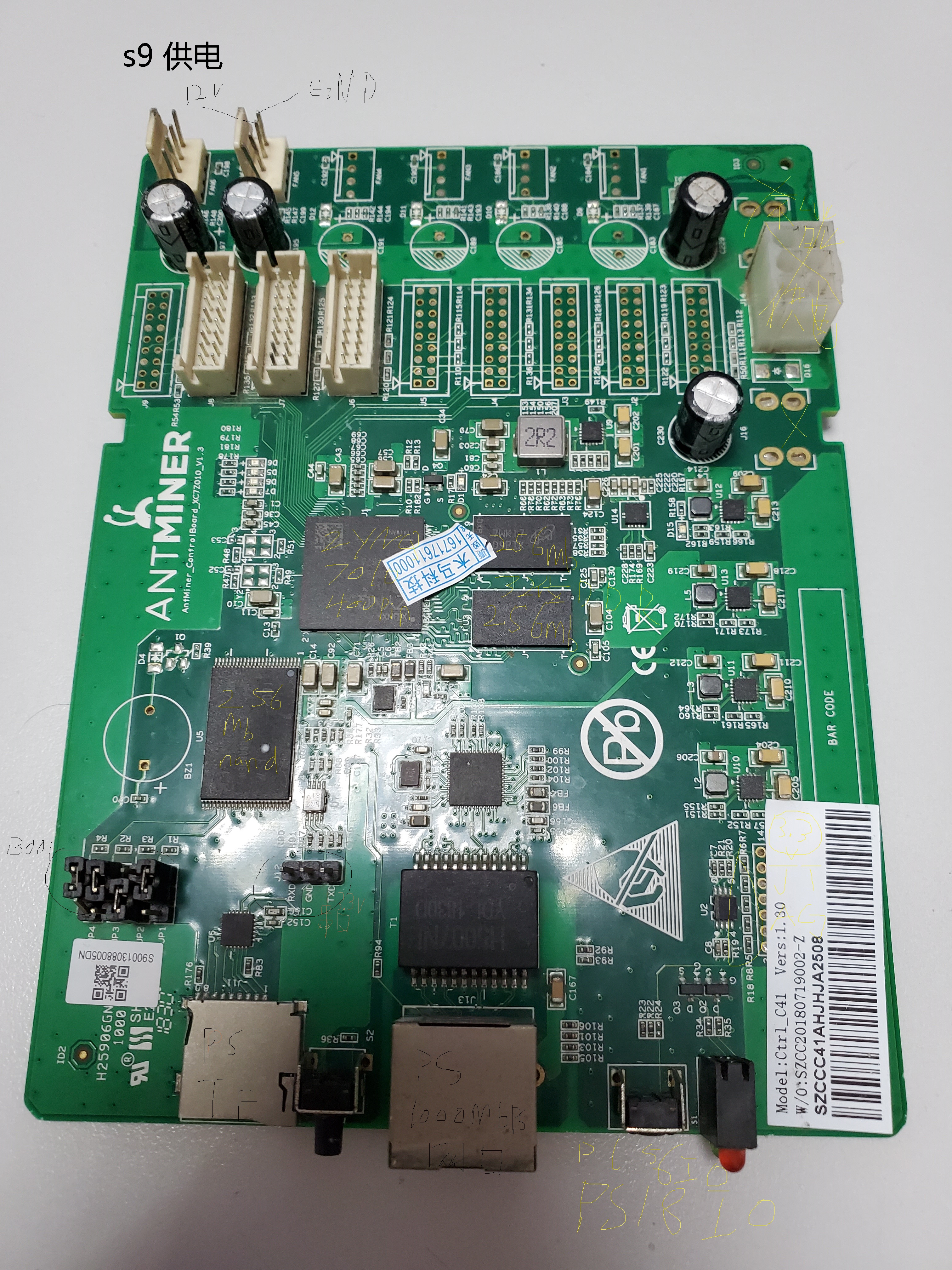

Re: 捡了个便宜的高级ZYNQ XC7Z010 开发板玩玩

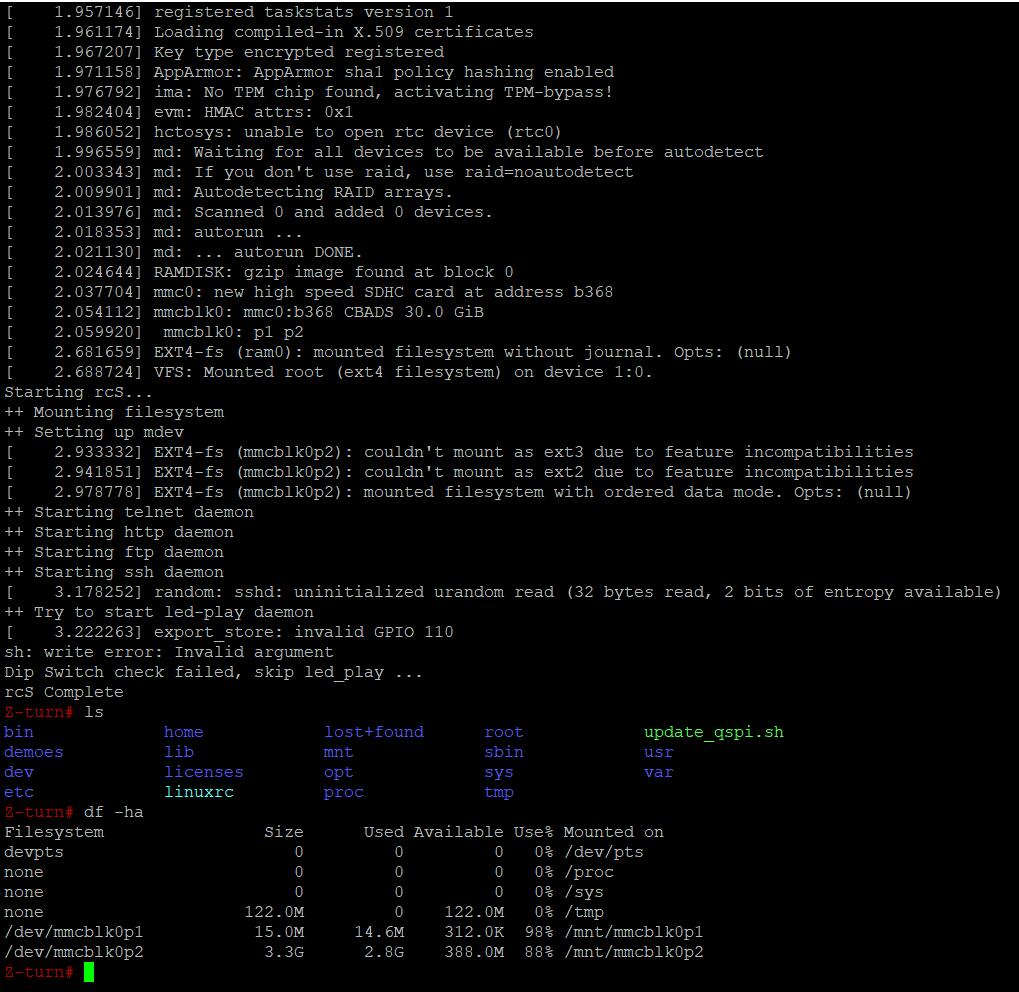

<br/>Xilinx First Stage Boot Loader <br/>Release 2015.4	Mar 29 2018-17:25:31<br/>Devcfg driver initialized <br/>Silicon Version 3.1<br/>Boot mode is NAND<br/>InitNand: Geometry = 0x8<br/>Nand driver initialized <br/>NAND Init Done <br/>Flash Base Address: 0xE1000000<br/>Reboot status register: 0x60400000<br/>Multiboot Register: 0x0000C000<br/>Image Start Address: 0x00000000<br/>Partition Header Offset:0x00000C80<br/>Partition Count: 3<br/>Partition Number: 1<br/>Header Dump<br/>Image Word Len: 0x0007F2E8<br/>Data Word Len: 0x0007F2E8<br/>Partition Word Len:0x0007F2E8<br/>Load Addr: 0x00000000<br/>Exec Addr: 0x00000000<br/>Partition Start: 0x000075D0<br/>Partition Attr: 0x00000020<br/>Partition Checksum Offset: 0x00000000<br/>Section Count: 0x00000001<br/>Checksum: 0xFFE7AF06<br/>Bitstream<br/>In FsblHookBeforeBitstreamDload function <br/>PCAP:StatusReg = 0x40000A30<br/>PCAP:device ready<br/>PCAP:Clear done<br/>Level Shifter Value = 0xA <br/>Devcfg Status register = 0x40000A30 <br/>PCAP:Fabric is Initialized done<br/>PCAP register dump:<br/>PCAP CTRL 0xF8007000: 0x4C00E07F<br/>PCAP LOCK 0xF8007004: 0x0000001A<br/>PCAP CONFIG 0xF8007008: 0x00000508<br/>PCAP ISR 0xF800700C: 0x0802000B<br/>PCAP IMR 0xF8007010: 0xFFFFFFFF<br/>PCAP STATUS 0xF8007014: 0x50000F30<br/>PCAP DMA SRC ADDR 0xF8007018: 0x00100001<br/>PCAP DMA DEST ADDR 0xF800701C: 0xFFFFFFFF<br/>PCAP DMA SRC LEN 0xF8007020: 0x0007F2E8<br/>PCAP DMA DEST LEN 0xF8007024: 0x0007F2E8<br/>PCAP ROM SHADOW CTRL 0xF8007028: 0xFFFFFFFF<br/>PCAP MBOOT 0xF800702C: 0x0000C000<br/>PCAP SW ID 0xF8007030: 0x00000000<br/>PCAP UNLOCK 0xF8007034: 0x757BDF0D<br/>PCAP MCTRL 0xF8007080: 0x30800100<br/><br/>DMA Done ! <br/>FPGA Done ! <br/>In FsblHookAfterBitstreamDload function <br/>Partition Number: 2<br/>Header Dump<br/>Image Word Len: 0x00015B20<br/>Data Word Len: 0x00015B20<br/>Partition Word Len:0x00015B20<br/>Load Addr: 0x04000000<br/>Exec Addr: 0x04000000<br/>Partition Start: 0x000868C0<br/>Partition Attr: 0x00000010<br/>Partition Checksum Offset: 0x00000000<br/>Section Count: 0x00000001<br/>Checksum: 0xF7F3836E<br/>Application<br/>fffff7<br/>Read: cnt = 0x00000010, addr = 0x00000040, val = 0xffffffef<br/>Read: cnt = 0x00000020, addr = 0x00000080, val = 0xffffffdf<br/>Read: cnt = 0x00000040, addr = 0x00000100, val = 0xffffffbf<br/>Read: cnt = 0x00000080, addr = 0x00000200, val = 0xffffff7f<br/>Read: cnt = 0x00000100, addr = 0x00000400, val = 0xfffffeff<br/>Read: cnt = 0x00000200, addr = 0x00000800, val = 0xfffffdff<br/>Read: cnt = 0x00000400, addr = 0x00001000, val = 0xfffffbff<br/>Read: cnt = 0x00000800, addr = 0x00002000, val = 0xfffff7ff<br/>Read: cnt = 0x00001000, addr = 0x00004000, val = 0xffffefff<br/>Read: cnt = 0x00002000, addr = 0x00008000, val = 0xffffdfff<br/>Read: cnt = 0x00004000, addr = 0x00010000, val = 0xffffbfff<br/>Read: cnt = 0x00008000, addr = 0x00020000, val = 0xffff7fff<br/>Read: cnt = 0x00010000, addr = 0x00040000, val = 0xfffeffff<br/>Read: cnt = 0x00020000, addr = 0x00080000, val = 0xfffdffff<br/>Read: cnt = 0x00040000, addr = 0x00100000, val = 0xfffbffff<br/>Read: cnt = 0x00080000, addr = 0x00200000, val = 0xfff7ffff<br/>Read: cnt = 0x00100000, addr = 0x00400000, val = 0xffefffff<br/>Read: cnt = 0x00200000, addr = 0x00800000, val = 0xffdfffff<br/>Read: cnt = 0x00400000, addr = 0x01000000, val = 0xffbfffff<br/>Read: cnt = 0x00800000, addr = 0x02000000, val = 0xff7fffff<br/>Read: cnt = 0x01000000, addr = 0x04000000, val = 0xfeffffff<br/>Read: cnt = 0x02000000, addr = 0x08000000, val = 0xfdffffff<br/>Read: cnt = 0x04000000, addr = 0x10000000, val = 0xfbffffff<br/>Read: cnt = 0x08000000, addr = 0x20000000, val = 0x00000000<br/>size = 0x20000000<br/>---1 sys_sdram_size = 0x20000000<br/>--- dram_init: sys_sdram_size = 512 MB<br/>---3 gd->ram_size = 0x1f000000<br/>Memory: ECC disabled<br/>DRAM:  496 MiB<br/>NAND:  256 MiB<br/>MMC:   zynq_sdhci: 0<br/>*** Warning - bad CRC, using default environment<br/>In:    serial<br/>Out:   serial<br/>Err:   serial<br/>~~~1 gd->ram_size = 0x1f000000<br/>~~~ board_late_init: ddr_size_type = 1<br/>--- gpio value = 0x000cc0ff<br/>--- mount angstrom file system<br/>bootargs: noinitrd mem=496M console=ttyPS0,115200 root=ubi0:rootfs ubi.mtd=1 rootfstype=ubifs rw rootwait<br/>--- upgrade marker upgrade_buf[0] = 0xff ---<br/>--- upgrade marker upgrade_buf[1] = 0xff ---<br/>--- upgrade marker upgrade_buf[2] = 0xff ---<br/>--- upgrade marker upgrade_buf[3] = 0xff ---<br/>--- upgrade marker upgrade_buf[4] = 0xff ---<br/>--- upgrade marker upgrade_buf[5] = 0xff ---<br/>--- upgrade marker upgrade_buf[6] = 0xff ---<br/>--- upgrade marker upgrade_buf[7] = 0xff ---<br/>--- upgrade marker upgrade_buf[8] = 0xff ---<br/>--- upgrade marker upgrade_buf[9] = 0xff ---<br/>--- upgrade marker upgrade_buf[10] = 0xff ---<br/>--- upgrade marker upgrade_buf[11] = 0xff ---<br/>--- upgrade marker upgrade_buf[12] = 0xff ---<br/>--- upgrade marker upgrade_buf[13] = 0xff ---<br/>--- upgrade marker upgrade_buf[14] = 0xff ---<br/>--- upgrade marker upgrade_buf[15] = 0xff ---<br/>bootargs: noinitrd mem=496M console=ttyPS0,115200 root=ubi0:rootfs ubi.mtd=1 rootfstype=ubifs rw rootwait<br/>Net:   Gem.e000b000<br/>Hit any key to stop autoboot:  3  2  1  0 <br/>Copying Linux from NAND flash to RAM...<br/>NAND read: device 0 offset 0x1100000, size 0x800000<br/> 8388608 bytes read: OK<br/>NAND read: device 0 offset 0x1020000, size 0x20000<br/> 131072 bytes read: OK<br/>## Booting kernel from Legacy Image at 02000000 ...<br/>   Image Name:   Linux-3.14.0-xilinx-ga36f3af-dir<br/>   Image Type:   ARM Linux Kernel Image (uncompressed)<br/>   Data Size:    3831240 Bytes = 3.7 MiB<br/>   Load Address: 00008000<br/>   Entry Point:  00008000<br/>   Verifying Checksum ... OK<br/>## Flattened Device Tree blob at 03000000<br/>   Booting using the fdt blob at 0x3000000<br/>   Loading Kernel Image ... OK<br/>   Loading Device Tree to 1eb39000, end 1eb3ddce ... OK<br/>Starting kernel ...<br/>Uncompressing Linux... done, booting the kernel.<br/>Hat, Inc.<br/>[    0.294452] msgmni has been set to 967<br/>[    0.295230] io scheduler noop registered<br/>[    0.295243] io scheduler deadline registered<br/>[    0.295285] io scheduler cfq registered (default)<br/>[    0.307083] dma-pl330 f8003000.ps7-dma: Loaded driver for PL330 DMAC-2364208<br/>[    0.307102] dma-pl330 f8003000.ps7-dma: 	DBUFF-128x8bytes Num_Chans-8 Num_Peri-4 Num_Events-16<br/>[    0.432430] e0001000.serial: ttyPS0 at MMIO 0xe0001000 (irq = 82, base_baud = 3124999) is a xuartps<br/>[    0.999998] console [ttyPS0] enabled<br/>[    1.004242] xdevcfg f8007000.ps7-dev-cfg: ioremap 0xf8007000 to df866000<br/>[    1.011865] [drm] Initialized drm 1.1.0 20060810<br/>[    1.028897] brd: module loaded<br/>[    1.038311] loop: module loaded<br/>[    1.048024] e1000e: Intel(R) PRO/1000 Network Driver - 2.3.2-k<br/>[    1.053771] e1000e: Copyright(c) 1999 - 2013 Intel Corporation.<br/>[    1.061673] libphy: XEMACPS mii bus: probed<br/>[    1.066046] ------------- phy_id = 0x3625e62<br/>[    1.070907] xemacps e000b000.ps7-ethernet: pdev->id -1, baseaddr 0xe000b000, irq 54<br/>[    1.079493] ehci_hcd: USB 2.0 'Enhanced' Host Controller (EHCI) Driver<br/>[    1.086136] ehci-pci: EHCI PCI platform driver<br/>[    1.093377] zynq-dr e0002000.ps7-usb: Unable to init USB phy, missing?<br/>[    1.100211] usbcore: registered new interface driver usb-storage<br/>[    1.107053] mousedev: PS/2 mouse device common for all mice<br/>[    1.113203] i2c /dev entries driver<br/>[    1.120173] zynq-edac f8006000.ps7-ddrc: ecc not enabled<br/>[    1.125650] cpufreq_cpu0: failed to get cpu0 regulator: -19<br/>[    1.131555] Xilinx Zynq CpuIdle Driver started<br/>[    1.136394] sdhci: Secure Digital Host Controller Interface driver<br/>[    1.142560] sdhci: Copyright(c) Pierre Ossman<br/>[    1.146830] sdhci-pltfm: SDHCI platform and OF driver helper<br/>[    1.153685] mmc0: no vqmmc regulator found<br/>[    1.157730] mmc0: no vmmc regulator found<br/>[    1.197423] mmc0: SDHCI controller on e0100000.ps7-sdio [e0100000.ps7-sdio] using ADMA<br/>[    1.206133] usbcore: registered new interface driver usbhid<br/>[    1.211642] usbhid: USB HID core driver<br/>[    1.216343] nand: device found, Manufacturer ID: 0x2c, Chip ID: 0xda<br/>[    1.222650] nand: Micron MT29F2G08ABAEAWP<br/>[    1.226611] nand: 256MiB, SLC, page size: 2048, OOB size: 64<br/>[    1.232554] Bad block table found at page 131008, version 0x01<br/>[    1.238782] Bad block table found at page 130944, version 0x01<br/>[    1.244838] 3 ofpart partitions found on MTD device pl353-nand<br/>[    1.250619] Creating 3 MTD partitions on "pl353-nand":<br/>[    1.255714] 0x000000000000-0x000002000000 : "BOOT.bin-env-dts-kernel"<br/>[    1.263756] 0x000002000000-0x00000b000000 : "angstram-rootfs"<br/>[    1.271066] 0x00000b000000-0x000010000000 : "upgrade-rootfs"<br/>[    1.279789] nf_conntrack version 0.5.0 (7739 buckets, 30956 max)<br/>[    1.286320] ip_tables: (C) 2000-2006 Netfilter Core Team<br/>[    1.291639] TCP: cubic registered<br/>[    1.294870] NET: Registered protocol family 17<br/>[    1.299598] Registering SWP/SWPB emulation handler<br/>[    1.305486] regulator-dummy: disabling<br/>[    1.309881] UBI: attaching mtd1 to ubi0<br/>[    1.838280] UBI: scanning is finished<br/>[    1.849919] UBI: attached mtd1 (name "angstram-rootfs", size 144 MiB) to ubi0<br/>[    1.856969] UBI: PEB size: 131072 bytes (128 KiB), LEB size: 126976 bytes<br/>[    1.863765] UBI: min./max. I/O unit sizes: 2048/2048, sub-page size 2048<br/>[    1.870441] UBI: VID header offset: 2048 (aligned 2048), data offset: 4096<br/>[    1.877279] UBI: good PEBs: 1152, bad PEBs: 0, corrupted PEBs: 0<br/>[    1.883289] UBI: user volume: 1, internal volumes: 1, max. volumes count: 128<br/>[    1.890400] UBI: max/mean erase counter: 2/1, WL threshold: 4096, image sequence number: 1810974339<br/>[    1.899430] UBI: available PEBs: 0, total reserved PEBs: 1152, PEBs reserved for bad PEB handling: 40<br/>[    1.908646] UBI: background thread "ubi_bgt0d" started, PID 1085<br/>[    1.908652] drivers/rtc/hctosys.c: unable to open rtc device (rtc0)<br/>[    1.912658] ALSA device list:<br/>[    1.912661]   No soundcards found.<br/>[    1.928977] UBIFS: background thread "ubifs_bgt0_0" started, PID 1087<br/>[    1.958036] UBIFS: recovery needed<br/>[    2.032519] UBIFS: recovery completed<br/>[    2.036182] UBIFS: mounted UBI device 0, volume 0, name "rootfs"<br/>[    2.042127] UBIFS: LEB size: 126976 bytes (124 KiB), min./max. I/O unit sizes: 2048 bytes/2048 bytes<br/>[    2.051233] UBIFS: FS size: 128626688 bytes (122 MiB, 1013 LEBs), journal size 9023488 bytes (8 MiB, 72 LEBs)<br/>[    2.061129] UBIFS: reserved for root: 0 bytes (0 KiB)<br/>[    2.066152] UBIFS: media format: w4/r0 (latest is w4/r0), UUID CD72815F-9A94-46DF-B863-9F8D20C2D637, small LPT model<br/>[    2.077479] VFS: Mounted root (ubifs filesystem) on device 0:11.<br/>[    2.084441] devtmpfs: mounted<br/>[    2.087574] Freeing unused kernel memory: 208K (c06e9000 - c071d000)<br/>INIT: version 2.88 booting<br/><br/>Starting Bootlog daemon: bootlogd.<br/><br/>Starting Monitor-ipsig daemon: monitor-ipsig.<br/><br/>[    2.923069] random: dd urandom read with 0 bits of entropy available<br/>Starting initc<br/><br/>dropbear<br/><br/>cp: can't stat '/etc/minermonitor.conf.factory': No such file or directory<br/><br/>cp: can't stat '/etc/dataformatconfig': No such file or directory<br/><br/>[    3.347428] <br/>[    3.347428] bcm54xx_config_init<br/>2: eth0: <BROADCAST,MULTICAST,UP,LOWER_UP> mtu 1500 qdisc pfifo_fast qlen 1000<br/><br/>    link/ether 00:0a:35:00:01:22 brd ff:ff:ff:ff:ff:ff<br/><br/>ECC failed: 0<br/><br/>ECC corrected: 0<br/><br/>Number of bad blocks: 0<br/><br/>Number of bbt blocks: 0<br/><br/>Block size 131072, page size 2048, OOB size 64<br/><br/>Dumping data starting at 0x01080000 and ending at 0x01080020...<br/><br/>ECC failed: 0<br/><br/>ECC corrected: 0<br/><br/>Number of bad blocks: 0<br/><br/>Number of bbt blocks: 0<br/><br/>Block size 131072, page size 2048, OOB size 64<br/><br/>Dumping data starting at 0x01080000 and ending at 0x01080020...<br/><br/>ECC failed: 0<br/><br/>ECC corrected: 0<br/><br/>Number of bad blocks: 0<br/><br/>Number of bbt blocks: 0<br/><br/>Block size 131072, page size 2048, OOB size 64<br/><br/>Dumping data starting at 0x01080000 and ending at 0x01080001...<br/><br/>ECC failed: 0<br/><br/>ECC corrected: 0<br/><br/>Number of bad blocks: 0<br/><br/>Number of bbt blocks: 0<br/><br/>Block size 131072, page size 2048, OOB size 64<br/><br/>Dumping data starting at 0x01060000 and ending at 0x01060020...<br/><br/>ECC failed: 0<br/><br/>ECC corrected: 0<br/><br/>Number of bad blocks: 0<br/><br/>Number of bbt blocks: 0<br/><br/>Block size 131072, page size 2048, OOB size 64<br/><br/>Dumping data starting at 0x01060000 and ending at 0x01060020...<br/><br/>ECC failed: 0<br/><br/>ECC corrected: 0<br/><br/>Number of bad blocks: 0<br/><br/>Number of bbt blocks: 0<br/><br/>Block size 131072, page size 2048, OOB size 64<br/><br/>Dumping data starting at 0x01060000 and ending at 0x01060001...<br/><br/>02:30:6f:af:c4:88<br/><br/>[    4.417461] <br/>[    4.417461] bcm54xx_config_init<br/>udhcpc (v1.21.1) started<br/><br/>Sending discover...<br/><br/>Sending discover...<br/><br/>Sending discover...<br/><br/>Sending discover...<br/><br/>Sending discover...<br/><br/>Sending discover...<br/><br/>Sending discover...<br/><br/>Sending discover...<br/><br/>Sending discover...<br/><br/>Sending discover...<br/><br/>No lease, forking to background<br/><br/>Error resolving pool.ntp.org: No address associated with hostname (-5)<br/><br/> 1 Jan 00:00:35 ntpdate[1463]: Can't find host pool.ntp.org: No address associated with hostname (-5)<br/><br/> 1 Jan 00:00:35 ntpdate[1463]: no servers can be used, exiting<br/><br/>Starting ntpd: done<br/><br/>Starting Avahi Daemon: Daemon already running on PID 1474<br/><br/>avahi-daemon.<br/><br/>Starting Lighttpd Web Server: lighttpd.<br/><br/>Starting bmminer daemon: ping: sendto: Network is unreachable<br/><br/>192.168.1.1 is reachable<br/><br/>No bitmain_axi.ko<br/><br/>[   40.515123] In axi fpga driver!<br/>[   40.518232] request_mem_region OK!<br/>[   40.521586] AXI fpga dev virtual address is 0xdf9fc000<br/>[   40.526692] *base_vir_addr = 0xc51e<br/>memory_size = 495532<br/><br/>fpga_mem_offset_addr=0x1F000000<br/><br/>[   40.541698] In fpga mem driver!<br/>[   40.544764] request_mem_region OK!<br/>[   40.548385] fpga mem virtual address is 0xe2000000<br/>killall: bmminer: no process killed<br/><br/>killall: single-board-test: no process killed<br/><br/>bmminer.<br/><br/>Starting Monitor-recobtn daemon: monitor-recobtn.<br/><br/>INIT: Entering runlevel: 5<br/><br/><br/>Stopping Bootlog daemon: workdataPathPrefix:/etc/config/minertest64/minertest64_<br/>Read Config.ini<br/>Name:S9 HASH board<br/>DataCount:912<br/>PassCount1:912<br/>PassCount2:912<br/>PassCount3:912<br/>Freq:600<br/>Timeout:0<br/>OpenCoreGap:50000<br/>CheckTemp:0<br/>freq_e:0<br/>AsicNum:63<br/>TestMode:0<br/>CheckChain:1<br/>CommandMode:0<br/>ValidNonce1:57456<br/>ValidNonce2:57456<br/>ValidNonce3:57456<br/>Pic:1d<br/>IICPic:1d<br/>dac = 1d<br/>Voltage1:840d<br/>Voltage2:840d<br/>Voltage3:840d<br/>OpenCoreNum1 = 4294967295d = 0xffffffff<br/>OpenCoreNum2 = 4294967295d = 0xffffffff<br/>OpenCoreNum3 = 4294967295d = 0xffffffff<br/>OpenCoreNum4 = 262143d = 0x3ffff<br/>GetTempFrom:1<br/>TempSel:0<br/>TempSensor1:62<br/>TempSensor2:0<br/>TempSensor3:0<br/>TempSensor4:0<br/>DefaultTempOffset:-70<br/>StartTemp:0<br/>year:2016<br/>month:05<br/>date:18<br/>hour:10<br/>minute:36<br/>second:12<br/>parameter processed after Reading Config.ini<br/>DataCount:912<br/>PassCount1:912<br/>PassCount2:912<br/>PassCount3:912<br/>Freq:600<br/>Timeout:829<br/>OpenCoreGap:50000<br/>CheckTemp:0<br/>TestMode:0<br/>CommandMode:0<br/>ValidNonce1:57456<br/>ValidNonce2:57456<br/>ValidNonce3:57456<br/>Pic:1d<br/>IICPic:1d<br/>dac:1d<br/>Voltage1:840d<br/>Voltage2:840d<br/>Voltage3:840d<br/>OpenCoreNum1 = 4294967295d = 0xffffffff<br/>OpenCoreNum2 = 4294967295d = 0xffffffff<br/>OpenCoreNum3 = 4294967295d = 0xffffffff<br/>OpenCoreNum4 = 262143d = 0x3ffff<br/>GetTempFrom:1<br/>TempSel:0<br/>TempSensor1:62<br/>TempSensor2:0<br/>TempSensor3:0<br/>TempSensor4:0<br/>DefaultTempOffset:-70<br/>StartTemp:0<br/>year:2016<br/>month:05<br/>date:18<br/>hour:10<br/>minute:36<br/>second:12<br/>bootlogd.<br/>rm: can't remove '/config/temp_sensor': No such file or directory<br/><br/>.---O---.                                           <br/>|       |                  .-.           o o        <br/>|   |   |-----.-----.-----.| |   .----..-----.-----.<br/>|       |     | __  |  ---'| '--.|  .-'|     |     |<br/>|   |   |  |  |     |---  ||  --'|  |  |  '  | | | |<br/>'---'---'--'--'--.  |-----''----''--'  '-----'-'-'-'<br/>                -'  |<br/>                '---'<br/><br/>The Angstrom Distribution antMiner /dev/ttyPS0<br/><br/>Angstrom v2013.12 - Kernel 3.14.0-xilinx-ga36f3af-dirty<br/><br/>antMiner login: single board test start<br/>httpListenThread start ret=0<br/>clement2 init_fpga<br/>clement check_chain<br/>killall: bmminer: no process killed<br/> [1970-01-01 00:00:56.378] Miner compile time: Tue Jul 30 20:56:46 CST 2019 type: Antminer S9i rate: unknown                    <br/> [1970-01-01 00:00:56.379] Started bmminer 2.0.0                    <br/> [1970-01-01 00:00:56.379] Loaded configuration file /config/bmminer.conf                    <br/> [1970-01-01 00:00:56.402] Probing for an alive pool                    <br/> [1970-01-01 00:00:56.405] No Stratum, GBT or Solo support in pool 0  unable to use                    <br/> [1970-01-01 00:00:56.405] No Stratum, GBT or Solo support in pool 1  unable to use                    <br/> [1970-01-01 00:00:56.405] No Stratum, GBT or Solo support in pool 2  unable to use                    <br/>(5s):0.000 (1m):0.000 (5m):0.000 (15m):0.000 (avg):0.000h/s          <br/>(5s):0.000 (1m):0.000 (5m):0.000 (15m):0.000 (avg):0.000h/s          <br/>(5s):0.000 (1m):0.000 (5m):0.000 (15m):0.000 (avg):0.000h/s          <br/>     <br/>start listen on 6060 ...<br/>(5s):0.000 (1m):0.000 (5m):0.000 (15m):0.000 (avg):0.000h/s          <br/>(5s):0.000 (1m):0.000 (5m):0.000 (15m):0.000 (avg):0.000h/s          <br/>                <br/> [1970-01-01 00:01:26.406] No Stratum, GBT or Solo support in pool 2  unable to use                    <br/>(5s):0.000 (1m):0.000 (5m):0.000 (15m):0.000 (avg):0.000h/s          <br/>(5s):0.000 (1m):0.000 (5m):0.000 (15m):0.000 (avg):0.000h/s          <br/>(5s):0.000 (1m):0.000 (5m):0.000 (15m):0.000 (avg):0.000h/s          <br/>(5s):0.000 (1m):0.000 (5m):0.000 (15m):0.000 (avg):0.000h/s          <br/>(5s):0.000 (1m):0.000 (5m):0.000 (15m):0.000 (avg):0.000h/s          <br/>(5s):0.000 (1m):0.000 (5m):0.000 (15m):0.000 (avg):0.000h/s          <br/> [1970-01-01 00:01:56.406] No Stratum, GBT or Solo support in pool 1  unable to use                    <br/> [1970-01-01 00:01:56.406] No Stratum, GBT or Solo support in pool 2  unable to use                    <br/> [1970-01-01 00:01:56.406] No Stratum, GBT or Solo support in pool 0  unable to use                    <br/>(5s):0.000 (1m):0.000 (5m):0.000 (15m):0.000 (avg):0.000h/s          <br/>(5s):0.000 (1m):0.000 (5m):0.000 (15m):0.000 (avg):0.000h/s          <br/>(5s):0.000 (1m):0.000 (5m):0.000 (15m):0.000 (avg):0.000h/s          <br/>(5s):0.000 (1m):0.000 (5m):0.000 (15m):0.000 (avg):0.000h/s          <br/>
#202 2020-08-04 19:52:16
rick lou
所在地: 中国北京海淀
注册时间: 2019-09-12
已发帖子: 230
积分: 219.5
上面是s9的打印信息,下面是上手

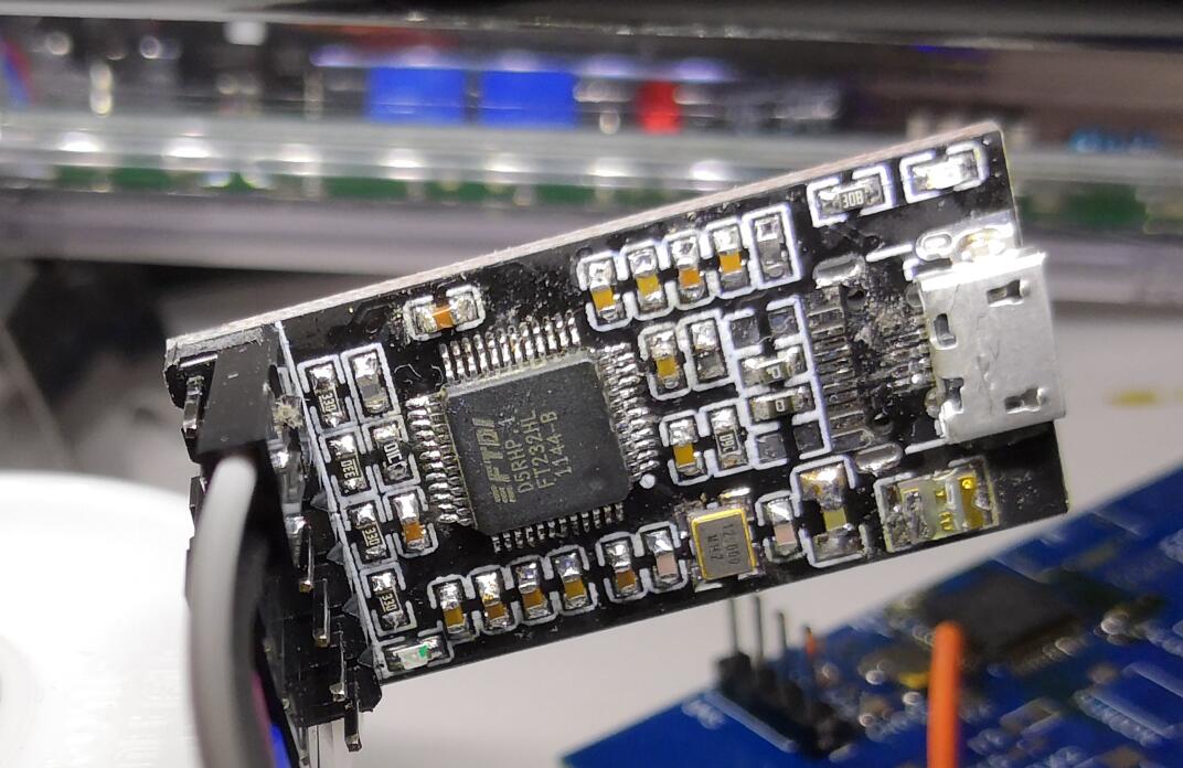

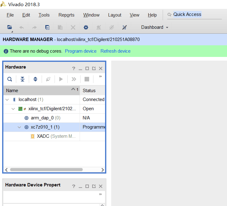

#203 2020-08-08 10:43:43
孙凌星
注册时间: 2020-08-02

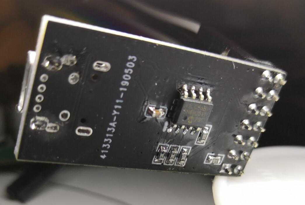

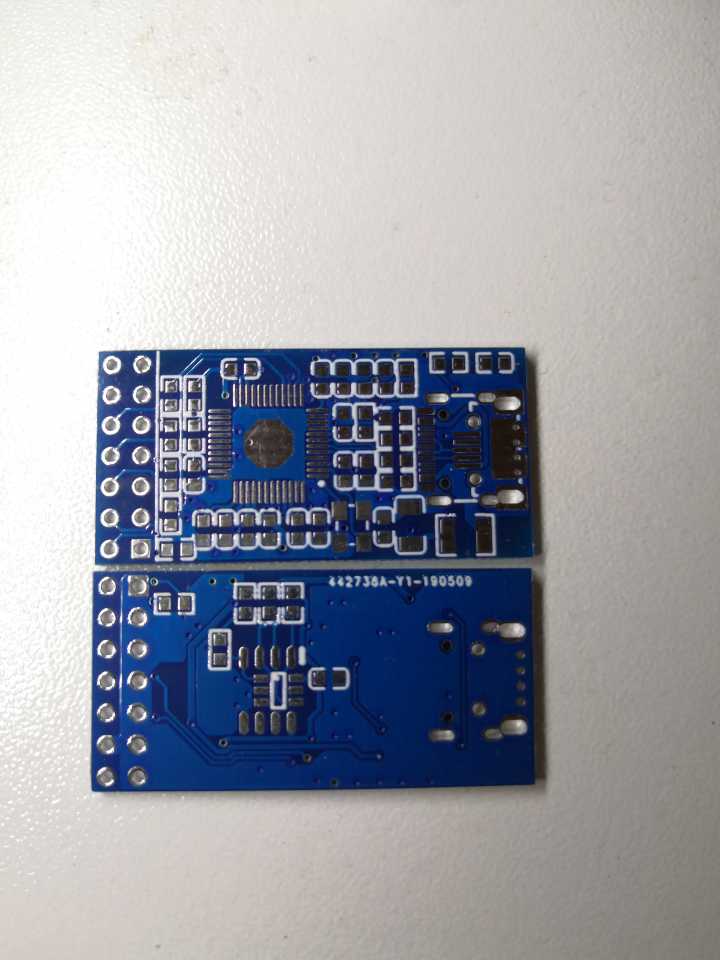

posystorage wrote:
搞了个FT232H的JTAG调试线
这是原作者的pcb/固件烧录等资料
/files/members/884/Xilinx_JTAG-SMT2.rar
这是我改小的SCH/PCB/BOM文件,用AD可以打开
/files/members/884/FT232H.7z
在vivado中成功识别
/files/members/884/TIM20190513110450.png
实物图 盗用群里大佬的图了
/files/members/884/TIM20190513110330.jpg
/files/members/884/TIM20190513110413.jpg
/files/members/884/TIM20190513110430.jpg
支持micro或者typec
232h封装支持lqfp或者qfn
配置芯片封装支持sop8或者sto23-6
大佬,请问可以说一下那些工具怎么用呢,EEPROM的还有CDM的,不知道用什么打开使用
#204 2020-08-09 11:25:48
rick lou
所在地: 中国北京海淀
注册时间: 2019-09-12
已发帖子: 230
积分: 219.5
工具用我发的,硬件买ft232模块,淘宝搜30左右

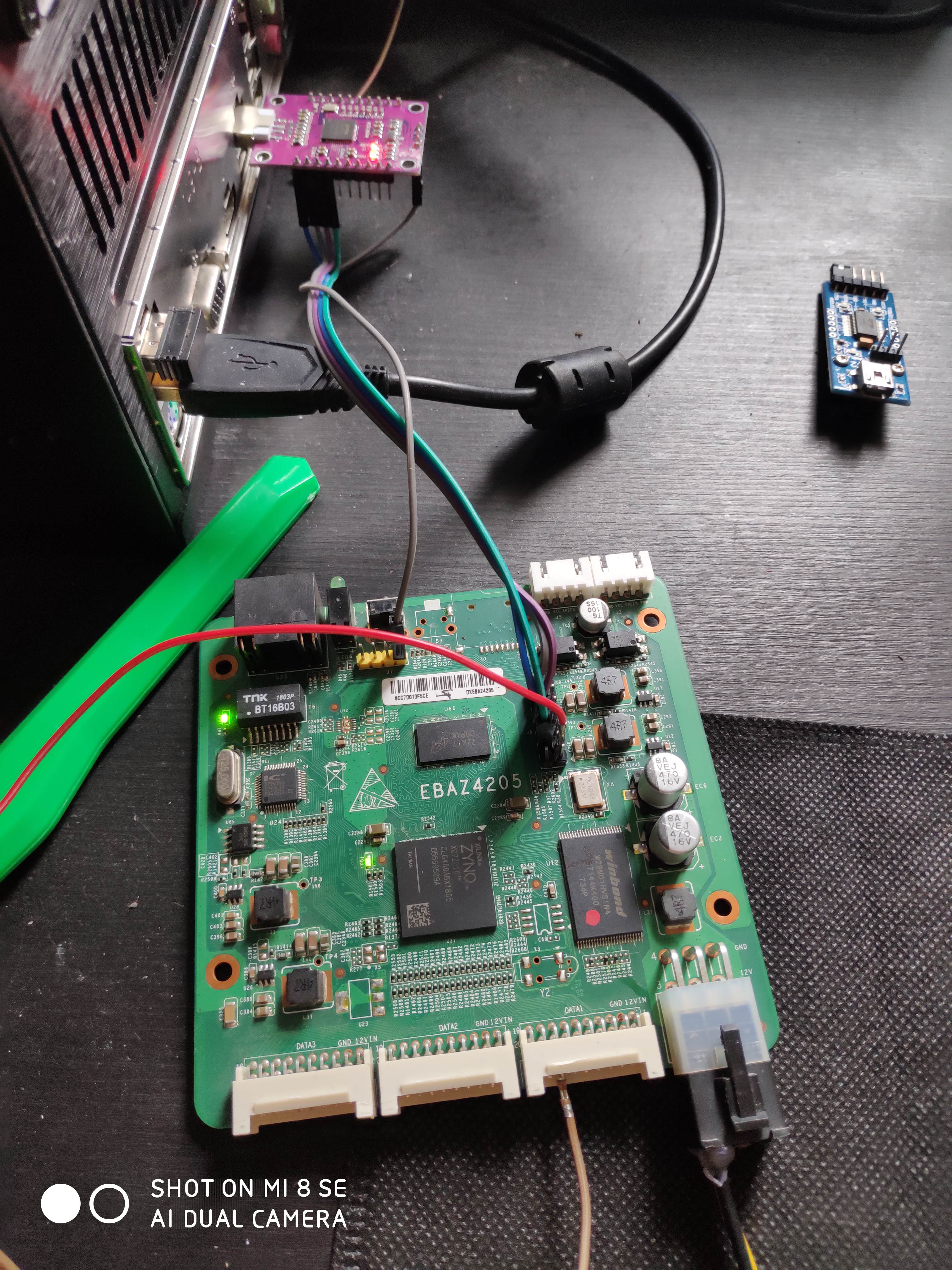

#205 2020-08-09 18:23:48
afsim
注册时间: 2020-08-09
积分: 11
这里有个方法重置root密码,很方便
https://github.com/xjtuecho/EBAZ4205
#206 2020-08-12 20:09:46
afsim
注册时间: 2020-08-09
积分: 11

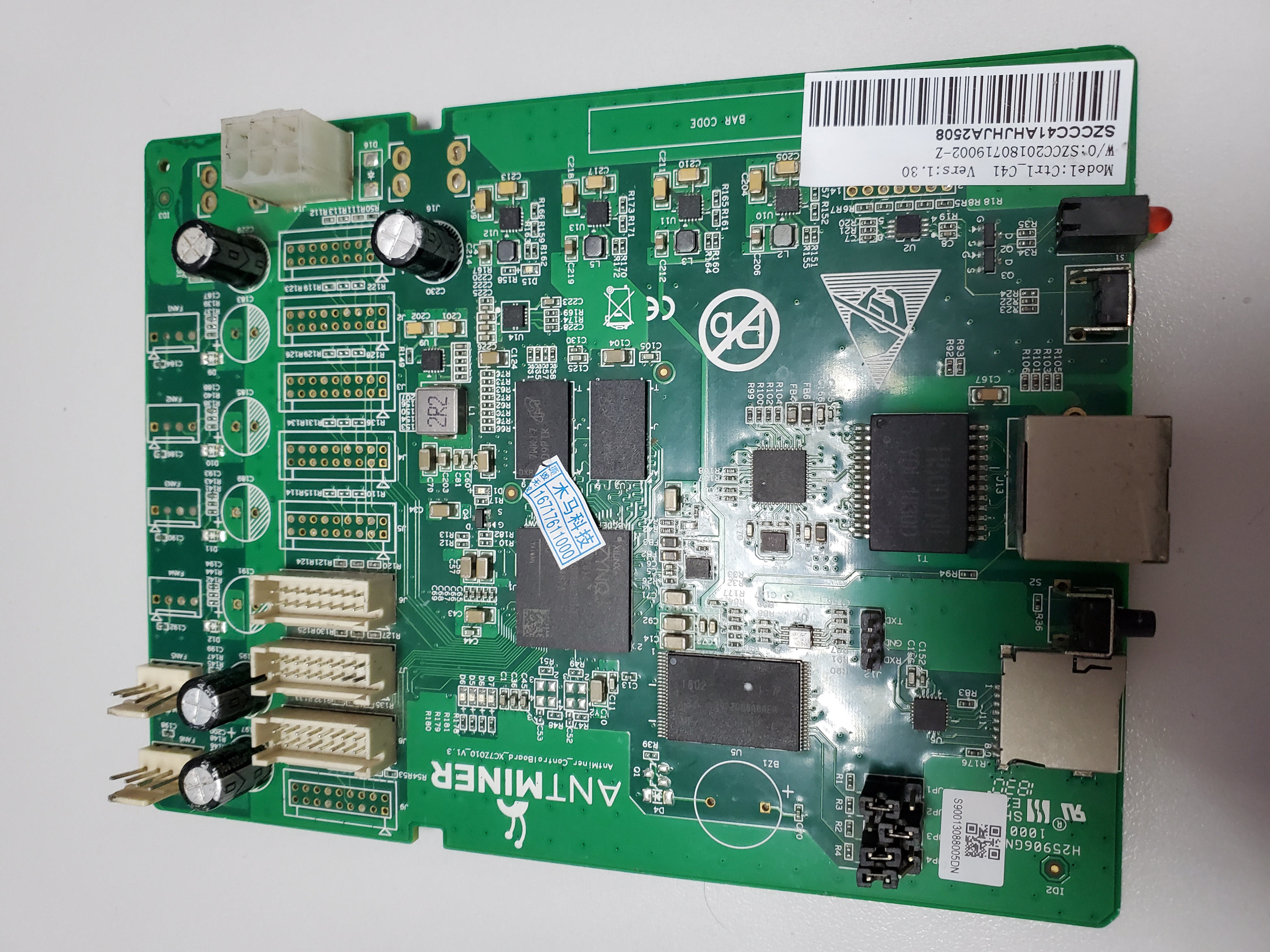

收了一块S9,哈哈!进uboot后执行下面3条,就可以去清楚root密码了
nand read 0x100000 0x1100000 0x800000 && nand read 0x900000 0x1020000 0x20000
setenv bootargs 'noinitrd mem=496M console=ttyPS0,115200 root=ubi0:rootfs ubi.mtd=1 rootfstype=ubifs rw rootwait reboot=cold,hard emergency init=/bin/sh'
bootm 0x100000 - 0x900000 init=/bin/sh
发现没有SSH server,能不能把EBAZ4205的拷贝过来?
最近编辑记录 afsim (2020-08-12 20:11:49)

s9如何进入uboot按什么也没用,附上完整启动信息s9.txt
#208 2020-08-13 18:52:32
afsim
注册时间: 2020-08-09
积分: 11
可能串口有故障,试试用串口助手16进制发送“41 0D”
我有块EBAZ4205就是串口只能发送,收不到电脑的数据
观察下面计数变化时,收到数据没有
Hit any key to stop autoboot: 3 - 2-1-0
最近编辑记录 afsim (2020-08-13 19:11:17)

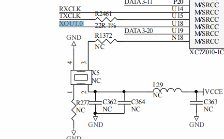

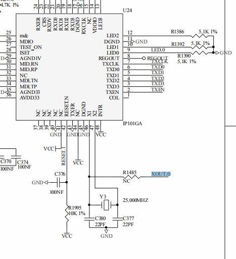

#212 2020-08-29 14:24:37
jcfcaonima
注册时间: 2019-12-17
已发帖子: 69
积分: 69

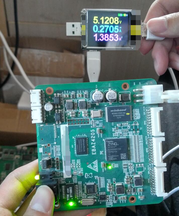

刚发现EZBA4205的PL部分是有板载晶振的,时钟通过U18引脚接入。中间隔了一个R1485,R1485并没有焊接,补一个33欧姆的电阻上去。
2020082901
2020082901
最近编辑记录 jcfcaonima (2020-08-29 14:25:58)

按照这里面的方法改成JTAG启动模式,https://blog.csdn.net/Markus_xu/article/details/107752300
根据正点原子的指南,新建一个纯PL点灯工程。

纯PL部分点灯成功

接下来,就可以用它来学习FPGA了。成本最低的FPGA开发板(20块钱)+成本最低的xilinx调试器(30.9块钱)。

拿到两块板,电路有些变化。主要是去掉了网口晶振以及C377/C380,但是连接了R1485。另外风扇口的optocoupler也去掉了,接上了相应的标NC的电阻。

posystorage wrote:
开机电流 5V下供电 约300ma 虽然是要12V 但是似乎5V也能愉快的跑。

楼主 #256 2021-12-10 10:19:14
posystorage
注册时间: 2018-05-06
已发帖子: 173
billcheung1983 wrote:
楼主这个电源检测模块很漂亮!请问有没有相关资料?或者购买链接?
/files/members/884/TIM20190331230816.jpg
搜索维简u2
