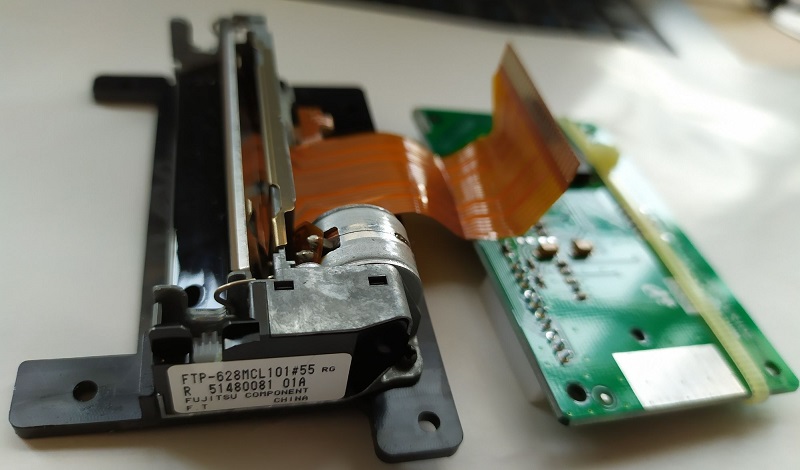

#4 Re: DIY/综合/Arduino/写字机/3D打印机/智能小车/平衡车/四轴飞行/MQTT/物联网 » 复刻一个喵喵机玩玩 » 2026-05-31 10:48:04
新买的热敏打印纸来了,重新打印一张,效果非常好,另外,经过多次测试,偶尔会出现数据丢包的情况
#5 Re: DIY/综合/Arduino/写字机/3D打印机/智能小车/平衡车/四轴飞行/MQTT/物联网 » 复刻一个喵喵机玩玩 » 2026-05-29 23:37:18
@陆苹果
大佬说的很专业啊,这个玩意现在烂大街了,开源的资料也很多,我只是感兴趣复刻一个玩玩,后面看下能有啥创新应用。

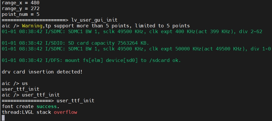

#17 Re: 工业芯 匠芯创 » 请教如何定位D133程序崩溃的位置 » 2024-10-16 16:44:10
我把矢量字体的weight改为72,出现tshell stack overflow,然后我把tshell的任务堆栈给大一点,现在又出现LVGL stack overflow,一环扣一环,头大
#18 Re: 工业芯 匠芯创 » 请教如何定位D133程序崩溃的位置 » 2024-10-14 17:47:16

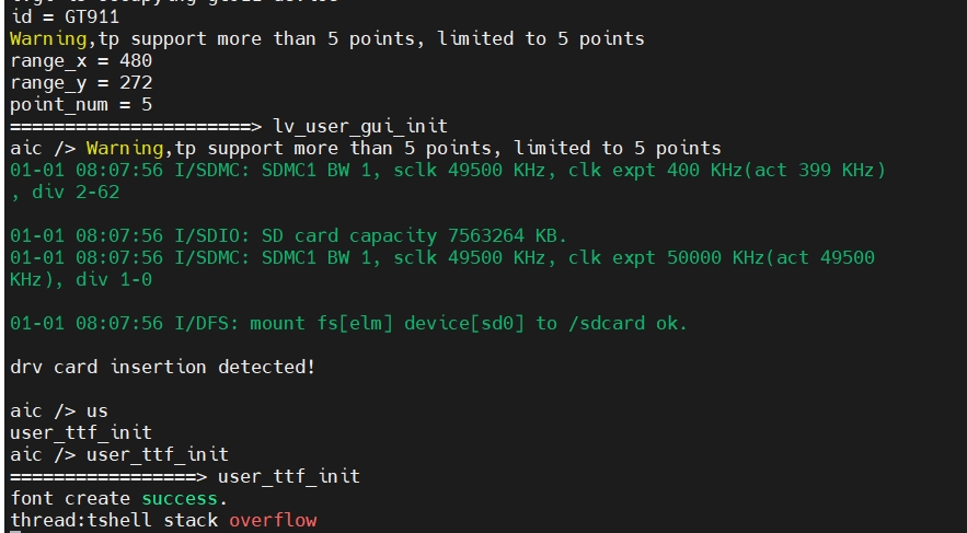

我使用SD卡存放ttf字库,写了一个非常简单的测试demo,代码如下:
void user_ttf_init(void)
    static lv_ft_info_t info;
    rt_kprintf("=================> user_ttf_init\n");
    //rt_thread_mdelay(5000);
    /*FreeType uses C standard file system, so no driver letter is required.*/
    //info.name = "/rodata/font.ttf";
    info.name = "/sdcard/font/font.ttf";
    info.weight = 64;
    info.style = FT_FONT_STYLE_NORMAL;
    info.mem = NULL;
    if (!lv_ft_font_init(&info))
        rt_kprintf("font create failed.\n");
        return;
    else
        rt_kprintf("font create success.\n");
    /*Create style with the new font*/
    static lv_style_t style;
    lv_style_init(&style);
    lv_style_set_text_font(&style, info.font);
    lv_style_set_text_align(&style, LV_TEXT_ALIGN_CENTER);
    /*Create a label with the new style*/
    lv_obj_t *label = lv_label_create(lv_scr_act());
    lv_obj_add_style(label, &style, 0);
    lv_label_set_text(label, "你好啊");
    lv_obj_center(label);
// INIT_APP_EXPORT(user_ttf_init);
MSH_CMD_EXPORT(user_ttf_init, test free type);
使用串口命令运行user_ttf_init,结果打印如下日志:
[Error] (16.537, +16039)         get_glyph_dsc_cb_cache: ImageCache_Lookup error        (in lv_freetype.c line #307)
[Error] (16.588, +51)    _lv_inv_area: detected modifying dirty areas in render         (in lv_refr.c line #217)
[Error] (16.598, +10)    _lv_inv_area: detected modifying dirty areas in render         (in lv_refr.c line #217)
[Error] (16.607, +9)     _lv_inv_area: detected modifying dirty areas in render         (in lv_refr.c line #217)
[Error] (16.634, +27)    get_glyph_dsc_cb_cache: ImageCache_Lookup error        (in lv_freetype.c line [Error]  (16.658, in lv_freetype.c line #307)
CPU Exception: NO.4
x1: 400c553a    x2: 3004e6c0    x3: 300423bc    x4: deadbeef
x5: 400024b8    x6: 0000003b    x7: 300900a0    x8: 3004e760
x9: 00004f60    x10: 00000032   x11: 3004e708   x12: 3004e6f4
x13: 0000597d   x14: 00000003   x15: 00000001   x16: 00000080
x17: 0000003b   x18: 3004f8a4   x19: 3004f8b8   x20: 0000597d
x21: 3004f8b8   x22: 00000000   x23: 00000000   x24: 00000001
x25: 00000023   x26: 00004f60   x27: 00000020   x28: 00000039
x29: 000032a8   x30: 00000000   x31: 30079f10
mcause : 38000004
mtval  : 000000be
mepc   : 400564fe
mstatus: 80007880
重要的是要掌握解决此类问题的方法,如果能有一个类似《ESP8266重启原因以及常见Fatal Exceptionܻ原因》的文档,那就非常棒了,麻烦大佬帮忙指点一下,谢谢!
