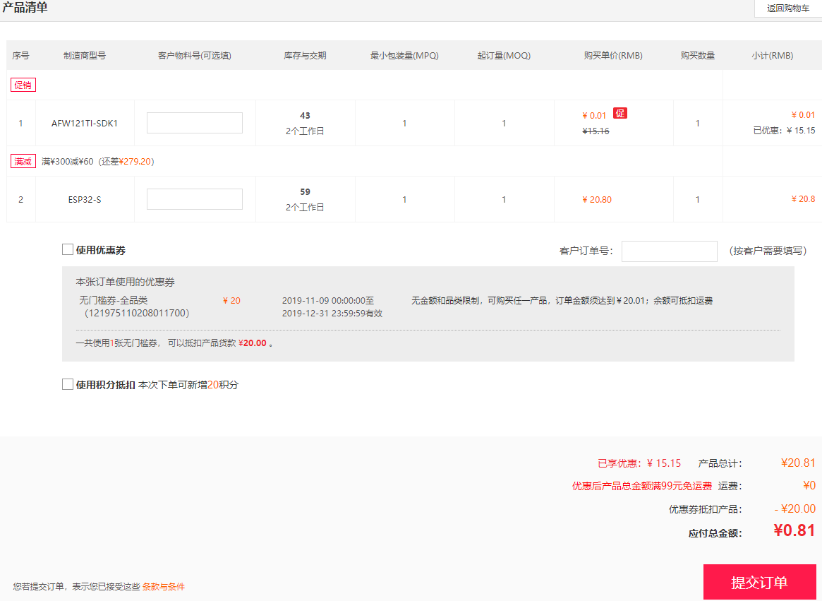

#66 ESP32/ESP8266 » 羊毛党机会来了, 免费拿 ESP32/ESP8266 开发板 » 2019-11-14 21:06:42
xgui
回复: 11
http://www.iceasy.com/5627/1003583476.shtml
http://www.iceasy.com/subject/201911/s11.shtml
把 0.01 的添加到购物车
点右上角注册送20元, 然后两个加到购物车一起付款可以免邮, 这样几毛钱就可以撸到一块 ESP32 开发板

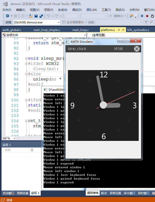

#110 Re: 计算机图形/GUI/RTOS/FileSystem/OpenGL/DirectX/SDL2 » Q群看到的单色GUI, 相当不错,值得学习! » 2019-11-07 18:44:18
lixianjing 说:
AWTK也支持单色屏,虽然体积大点,不过可以让单色屏和彩色屏公用同一套代码。
AWTK + TOS 在STM32F103上的demo1大小:
Program Size: Code=183778 RO-data=229094 RW-data=1120 ZI-data=55056
有兴趣的朋友可以试试。
请问是哪个仓库呢? 有没有现成的工程?
https://github.com/zlgopen?utf8=%E2%9C%93&q=stm32

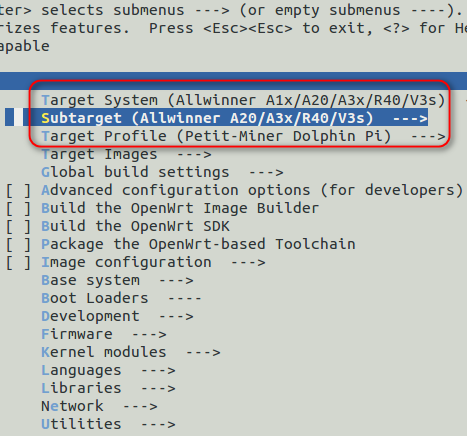

克隆源码:
git clone https://github.com/bhorn/openwrt
cd openwrt
git checkout dolphinpi-spinand
然后 make menuconfig 选中:
> Base System > mtd
> Kernel modules > SPI Support > kmod-spi-dev
如果你用root登录的, 请用这个命令编译:
FORCE_UNSAFE_CONFIGURE=1 make V=s
#127 Re: 全志 SOC » V3s SPI NAND u-boot @openwrt » 2019-11-07 06:42:03

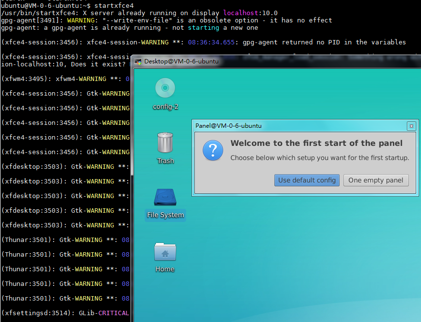

root@test5:~# startxfce4
/usr/bin/startxfce4: Starting X server
X.Org X Server 1.19.2
Release Date: 2017-03-02
X Protocol Version 11, Revision 0
Build Operating System: Linux 4.9.0-8-armmp-lpae armv7l Debian
Current Operating System: Linux test5 4.15.0-licheepi-nano+ #2 Tue Aug 27 15:20:21 CST 2019 armv5tejl
Kernel command line: console=ttyS0,115200 panic=5 rootwait root=/dev/mmcblk0p2 rw vt.global_cursor_default=0
Build Date: 03 November 2018  04:54:31AM
xorg-server 2:1.19.2-1+deb9u5 (https://www.debian.org/support)
Current version of pixman: 0.34.0
	Before reporting problems, check http://wiki.x.org
	to make sure that you have the latest version.
Markers: (--) probed, (**) from config file, (==) default setting,
	(++) from command line, (!!) notice, (II) informational,
	(WW) warning, (EE) error, (NI) not implemented, (??) unknown.
(==) Log file: "/var/log/Xorg.0.log", Time: Thu Nov  3 17:28:43 2016
(==) Using system config directory "/usr/share/X11/xorg.conf.d"

本来想跑个桌面, 装一个 xfce4 的, 结果提示要 578M, 好吓人的体积啊, Linux下面有没有好用的精简桌面呢?

#136 Re: VMWare/Linux/Ubuntu/Fedora/CentOS/U-BOOT » Ubuntu Linux下跑下各种精简桌面看看效果 » 2019-11-06 11:47:54
320x480界面xfce4
vncserver :1 -geometry 320x480 -depth 32 -pixelformat rgb8888
480x320界面xfce4
vncserver :1 -geometry 480x320 -depth 32 -pixelformat rgb8888
xfce4 清除配置文件:
mv ~/.config/xfce4/ ~/.config/xfce4.bak/
https://askubuntu.com/questions/224006/resetting-xfce-panels-to-default-settings
#137 Re: VMWare/Linux/Ubuntu/Fedora/CentOS/U-BOOT » Ubuntu Linux下跑下各种精简桌面看看效果 » 2019-11-05 16:01:31

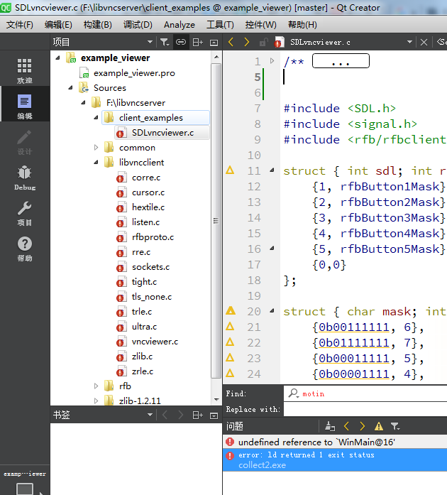

#146 计算机图形/GUI/RTOS/FileSystem/OpenGL/DirectX/SDL2 » Windows 编译 libvncclient 的demo程序出问题了, 使用的是 SDL2 库 » 2019-11-02 17:39:05
xgui
回复: 3
17:37:26: 为项目example_viewer执行步骤 ...
17:37:26: 配置没有改变, 跳过 qmake 步骤。
17:37:26: 正在启动 "D:\Qt\Qt5.12.3\Tools\mingw730_32\bin\mingw32-make.exe" -j2
D:/Qt/Qt5.12.3/Tools/mingw730_32/bin/mingw32-make -f Makefile.Debug
mingw32-make[1]: Entering directory 'F:/libvncserver/build-example_viewer-Desktop_Qt_5_12_3_MinGW_32_bit-Debug'
gcc -c -fno-keep-inline-dllexport -g -Wall -W -Wextra -DUNICODE -D_UNICODE -DWIN32 -DMINGW_HAS_SECURE_API=1 -DQT_QML_DEBUG -DQT_GUI_LIB -DQT_CORE_LIB -I../example -I. -I../../libvncserver -I../common -I../libvncserver -I../zlib-1.2.11 -I../sdl/include/SDL2 -ID:/Qt/Qt5.12.3/5.12.3/mingw73_32/include -ID:/Qt/Qt5.12.3/5.12.3/mingw73_32/include/QtGui -ID:/Qt/Qt5.12.3/5.12.3/mingw73_32/include/QtANGLE -ID:/Qt/Qt5.12.3/5.12.3/mingw73_32/include/QtCore -Idebug -ID:/Qt/Qt5.12.3/5.12.3/mingw73_32/mkspecs/win32-g++  -o debug/SDLvncviewer.o ../client_examples/SDLvncviewer.c
../client_examples/SDLvncviewer.c: In function 'kbd_leds':
../client_examples/SDLvncviewer.c:214:33: warning: unused parameter 'cl' [-Wunused-parameter]
 static void kbd_leds(rfbClient* cl, int value, int pad) {
../client_examples/SDLvncviewer.c:214:52: warning: unused parameter 'pad' [-Wunused-parameter]
../client_examples/SDLvncviewer.c: In function 'got_selection':
../client_examples/SDLvncviewer.c:421:38: warning: unused parameter 'cl' [-Wunused-parameter]
 static void got_selection(rfbClient *cl, const char *text, int len)
../client_examples/SDLvncviewer.c:421:64: warning: unused parameter 'len' [-Wunused-parameter]
../client_examples/SDLvncviewer.c: In function 'get_credential':
../client_examples/SDLvncviewer.c:429:49: warning: unused parameter 'cl' [-Wunused-parameter]
 static rfbCredential* get_credential(rfbClient* cl, int credentialType){
g++ -static -Wl,-subsystem,windows -mthreads -o debug/example_viewer.exe @object_script.example_viewer.Debug  -lws2_32 -L../sdl/lib -lSDL2 -LD:/Qt/Qt5.12.3/5.12.3/mingw73_32/lib D:/Qt/Qt5.12.3/5.12.3/mingw73_32/lib/libQt5Guid.a D:/Qt/Qt5.12.3/5.12.3/mingw73_32/lib/libQt5Cored.a
d:/Qt/Qt5.12.3/Tools/mingw730_32/bin/../lib/gcc/i686-w64-mingw32/7.3.0/../../../../i686-w64-mingw32/lib/../lib\libmingw32.a(lib32_libmingw32_a-crt0_c.o):crt0_c.c:(.text.startup+0x39): undefined reference to `WinMain@16'
collect2.exe: error: ld returned 1 exit status
mingw32-make[1]: *** [Makefile.Debug:137: debug/example_viewer.exe] Error 1
mingw32-make[1]: Leaving directory 'F:/libvncserver/build-example_viewer-Desktop_Qt_5_12_3_MinGW_32_bit-Debug'
mingw32-make: *** [Makefile:38: debug] Error 2
17:37:37: 进程"D:\Qt\Qt5.12.3\Tools\mingw730_32\bin\mingw32-make.exe"退出,退出代码 2 。
Error while building/deploying project example_viewer (kit: Desktop Qt 5.12.3 MinGW 32-bit)
When executing step "Make"
17:37:38: Elapsed time: 00:11.
