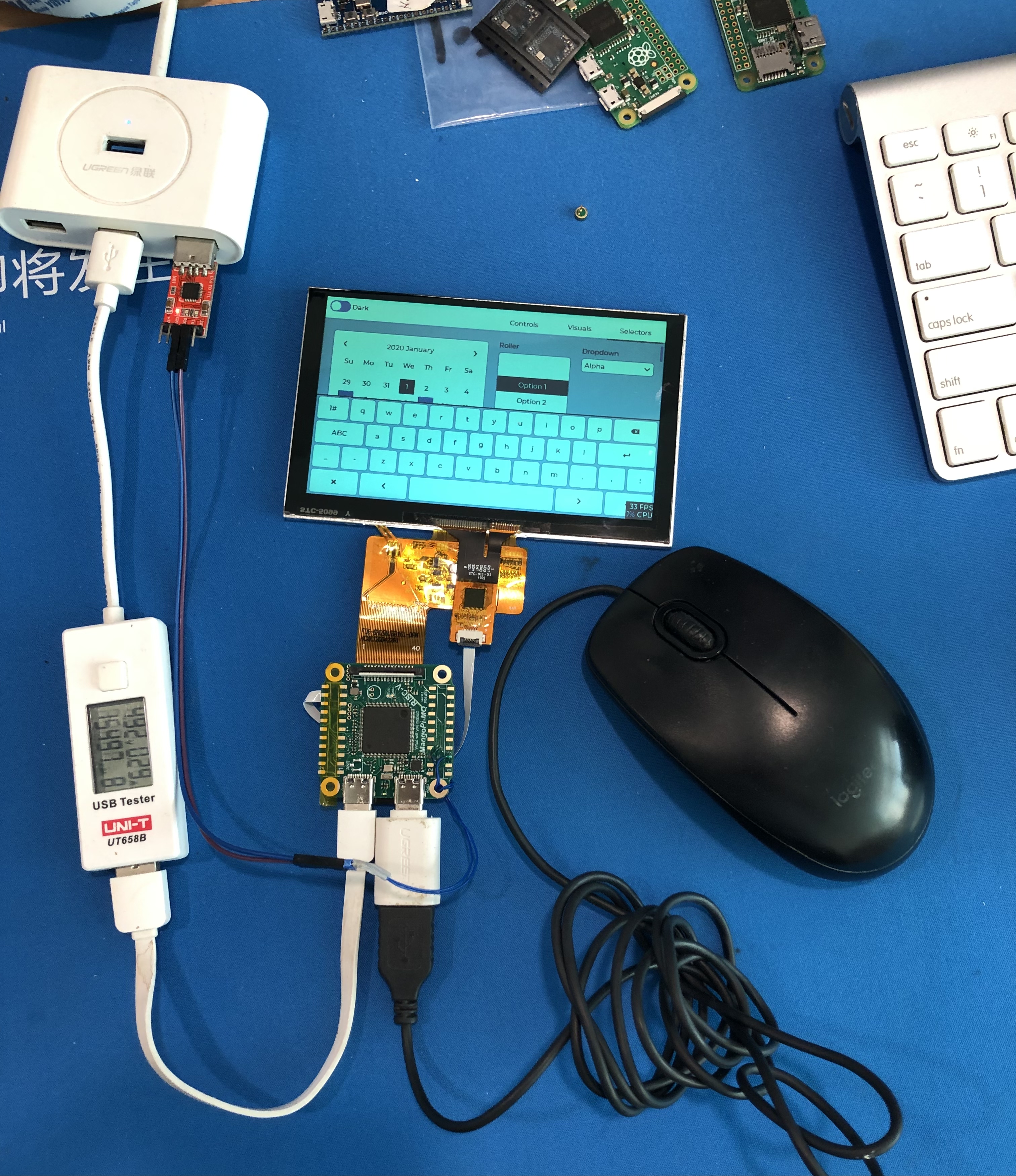

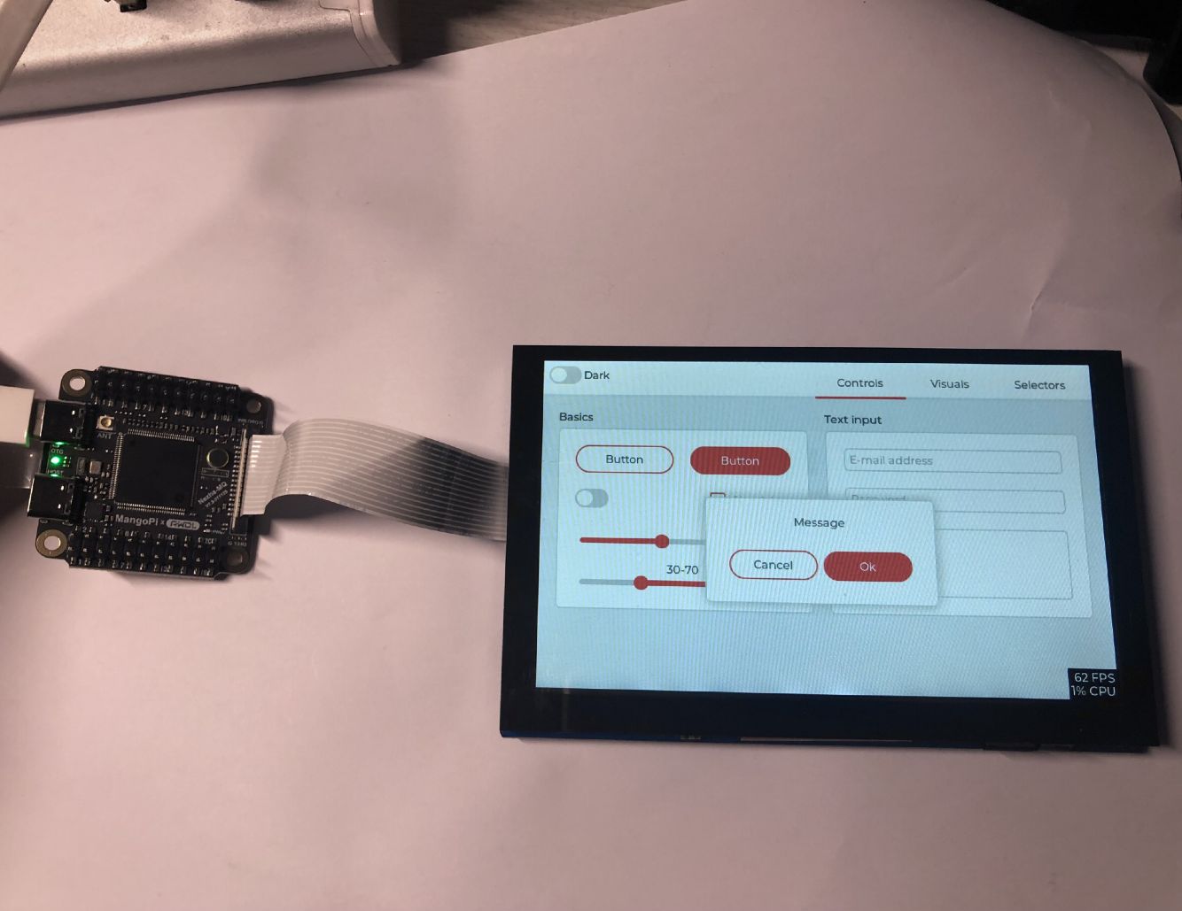

#59 全志 SOC » 使用小麻雀直接驱动树莓派的DSI屏 » 2021-12-17 21:20:49
回复: 3
续前贴: https://bbs.aw-ol.com/topic/311/
当时使用D1开发板驱动了,因D1的mipi是30pin,需要转接才能接树莓DSI屏。
麻雀设计的时候考虑到这点,直接板载的15Pin,所以直接接上就好。
效果:
固件:
tina_d1s_mipi_rpi_uart0.img
代码:只涉及board.dts和uboot-board.dts
&lcd0 {
	lcd_used            = <1>;
	lcd_driver_name     = "tft08006";
	lcd_backlight       = <100>;
	lcd_if              = <4>;
	lcd_x               = <800>;
	lcd_y               = <480>;
	lcd_width           = <52>;
	lcd_height          = <52>;
	lcd_dclk_freq       = <33>;
	lcd_pwm_used        = <1>;
	lcd_pwm_ch          = <2>;
	lcd_pwm_freq        = <1000>;
	lcd_pwm_pol         = <0>;
	lcd_pwm_max_limit   = <255>;
	lcd_hbp             = <32>;
	lcd_ht              = <868>;
	lcd_hspw            = <4>;
	lcd_vbp             = <12>;
	lcd_vt              = <500>;
	lcd_vspw            = <4>;
        lcd_hbp             = <32>;
        lcd_ht              = <868>;
        lcd_hspw            = <4>;
        lcd_vbp             = <10>;
        lcd_vt              = <520>;
        lcd_vspw            = <4>;
	lcd_dsi_if          = <0>;
	lcd_dsi_lane        = <1>;

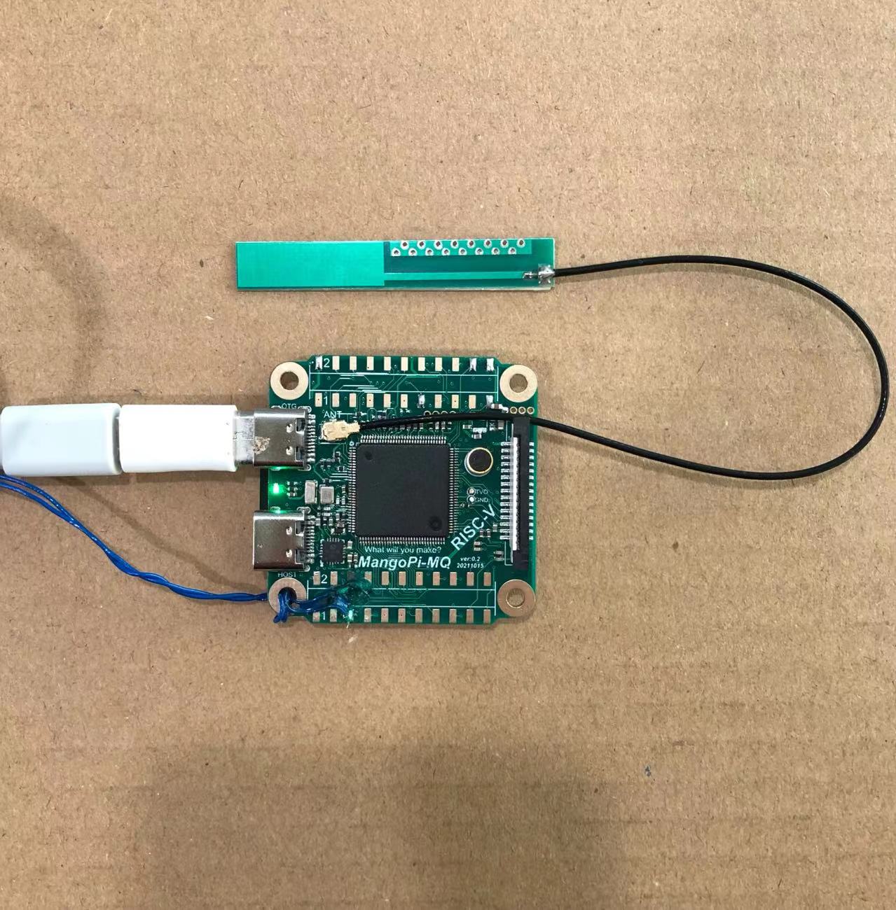

回复: 40
基础版本不带WiFi,但wifi周围器件/ipex等都是齐的,自行焊接8723,8189等。
WiFi版本到手可上网,带一条wifi天线。
资料下周上传。
#69 Re: 计算机图形/GUI/RTOS/FileSystem/OpenGL/DirectX/SDL2 » RTT的柿饼UI演示 » 2021-12-09 16:32:32

回复: 0
遇到点小插曲,由于厂家那边给GT911固化错了配置(把800480分辨率搞成了1024600),所以找厂家要了一份正确配置,需要ctp驱动中开启自动更新配置。
另外,tina linux驱动文件夹gt9xxnew中,分析gtp_init_panel初始化函数。因为手头这个屏幕与文件的都不同,并且看到源文件注释掉了从屏幕读取id。所以可确定sensor_id恒为0,那么就很简单了,自己的配置直接写到gt9xx.h的GOURP1即可。
#if GTP_COMPATIBLE_MODE
		msleep(50);
//       ret = gtp_i2c_read_dbl_check(ts->client, GTP_REG_SENSOR_ID, &sensor_id, 1);
		dprintk(DEBUG_INIT, "CTP name : %s\n", config_info.name);
		if (!strcmp(config_info.name, "gt9271_mb976a9")) {
			sensor_id = 0;
			dprintk(DEBUG_INIT, "gt9xx:sensor_id = %d\n", sensor_id);
		} else if (!strcmp(config_info.name, "gt9110_wt097")) {
			sensor_id = 1;
		} else if (!strcmp(config_info.name, "gt9271_wt097")) {
			sensor_id = 2;
		} else if (!strcmp(config_info.name, "gt9110_g200")) {
			sensor_id = 3;
		} else if (!strcmp(config_info.name, "gt9271_noah")) {
			sensor_id = 4;
		} else if (!strcmp(config_info.name, "gt9271_p2")) {
			sensor_id = 5;
		} else if (!strcmp(config_info.name, "gt911_1060")) {
			sensor_id = 6;
		} else if (!strcmp(config_info.name, "gt911_784")) {
			sensor_id = 7;
		} else {
			sensor_id = 0;
		ret = SUCCESS;
		if (SUCCESS == ret) {
			if (sensor_id >= 0x08) {
				printk("Invalid sensor_id(0x%02X), No Config Sent!\n", sensor_id);
				ts->pnl_init_error = 1;
				return -1;
		} else {
			printk("Failed to get sensor_id, No config sent!\n");
			return -1;
	ts->gtp_cfg_len = cfg_info_len[sensor_id];
	GTP_INFO( "CTP_CONFIG_GROUP%d used, config length: %d\n", sensor_id + 1, ts->gtp_cfg_len);
gt9xx.h中需增加配置:
#define CTP_CFG_GROUP1 {\
	0x42,0x20,0x03,0xE0,0x01,0x0A,0x3D,0x00,0x01,0x08,0x28,0x08,\
	0x5A,0x46,0x03,0x05,0x00,0x00,0x00,0x00,0x00,0x00,0x00,0x18,\
	0x1A,0x1E,0x14,0x89,0x2A,0x09,0x57,0x5C,0xB5,0x06,0x00,0x00,\
	0x00,0x02,0x01,0x1D,0x00,0x01,0x00,0x00,0x00,0x00,0x00,0x00,\
	0x00,0x00,0x00,0x46,0x82,0x94,0xC5,0x02,0x07,0x00,0x00,0x04,\
	0x96,0x4A,0x00,0x85,0x54,0x00,0x77,0x5F,0x00,0x6A,0x6C,0x00,\
	0x5F,0x7A,0x00,0x5F,0x00,0x00,0x00,0x00,0x00,0x00,0x00,0x00,\
	0x00,0x00,0x00,0x00,0x00,0x00,0x00,0x00,0x00,0x00,0x00,0x00,\
	0x00,0x00,0x00,0x00,0x02,0x04,0x06,0x08,0x0A,0x0C,0x10,0x12,\
	0x14,0xFF,0xFF,0xFF,0xFF,0xFF,0x00,0x00,0x00,0x00,0x00,0x00,\
	0x00,0x00,0x00,0x00,0x00,0x00,0x00,0x00,0x00,0x00,0x00,0x02,\
	0x04,0x06,0x08,0x0A,0x0F,0x10,0x12,0x16,0x18,0x1C,0x1D,0x1E,\
	0x1F,0x20,0x21,0x22,0x24,0xFF,0xFF,0xFF,0xFF,0xFF,0xFF,0xFF,\
	0x00,0x00,0x00,0x00,0x4B,0x01}
效果:
TODO:以后再尝试把group配置放到dts中,会不会更优雅些?

#90 全志 SOC » 试试用哪吒MQ板运行lvgl demo(鼠标) » 2021-11-17 13:09:59
回复: 6
系统:Tina for D1 (参考: https://bbs.aw-ol.com/topic/384 修改成适配D1s的)
硬件:MangoPi-Nezha MQ (芒果派-哪吒MQ),主控D1s,屏幕800*480 RGB接口
TN屏由于拍摄角度原因,颜色捉急。。

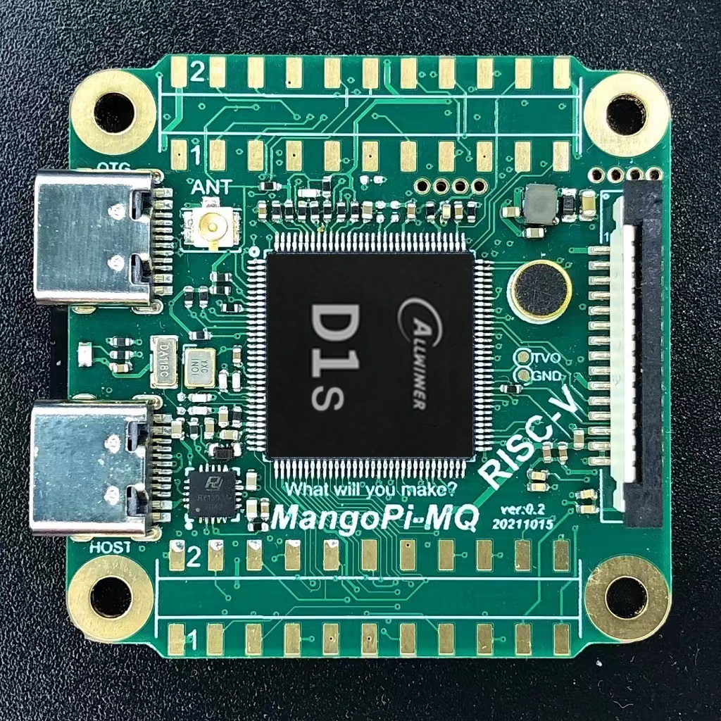

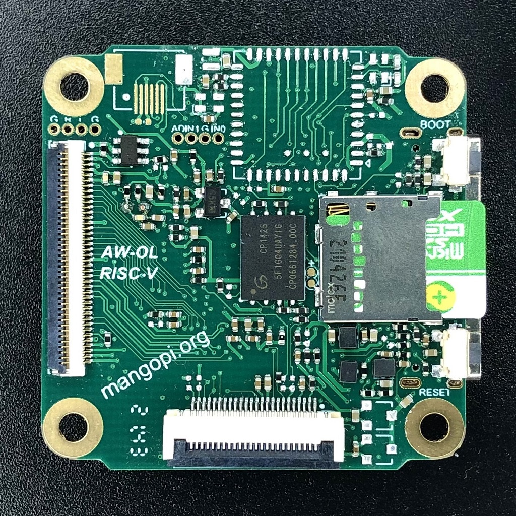

回复: 178
芒果派 哪吒MQ MangoPi Nezha MQ 麻雀 哪吒mini 全志D1s 开发板:
https://item.taobao.com/item.htm?id=638644511420
五寸电阻屏/电容屏: https://item.taobao.com/item.htm?id=587925184119
MQ_SCH_v1.5_量产版.pdf
MQ_V1.5_bom.html
以上由 @哇酷小管家 2021-12-08 更新
TINY200(MangoPi-R3)很多槽点,所以,麻雀来了。
麻雀小板同样作为全开源作品,面向点屏神器,在R3迷你尺寸的基础上更进一步。
1、得益于D1s芯片加持,多了DSI接口
2、板载WiFi(AP6212/RTL8723DS/XR829)
3、时髦Type-C接口
4、主控忘了打磨嘎嘎
当然,优秀设计仍得以保留:
A、独立BOOT按键
B、超高集成度
C、......
进度: 刚焊接完,热乎,等待测试。初步已进入fel。
计划: 调试完毕后筹备批产以及资料全开源上传。
小板资源:
主控D1s(内置64MB运存版本)
USB-OTG Type-C形式(fel方式刷机、接U盘、键盘、摄像头、usb网卡等)
USB-HOST Type-C形式(接U盘、键盘、摄像头、usb网卡等)
22Pin扩展排针 x2(全Pin引出)
Nand/Nor FLASH
TF卡槽
板载基于AP6212/RTL8723的WiFi/BT
15P通用树莓派DSI FPC排座
40P通用RGB FPC排座(内含4线电阻触摸接口)
6P通用电容触摸FPC排座
板载MIC*1
24Pin DVP接口(only R2 R3)
BOOT按键、复位按键
4x4cm超级迷你尺寸,4个固定装配脚
#108 Re: 全志 SOC » 全志D1芯片之终极探索 » 2021-05-24 11:37:40

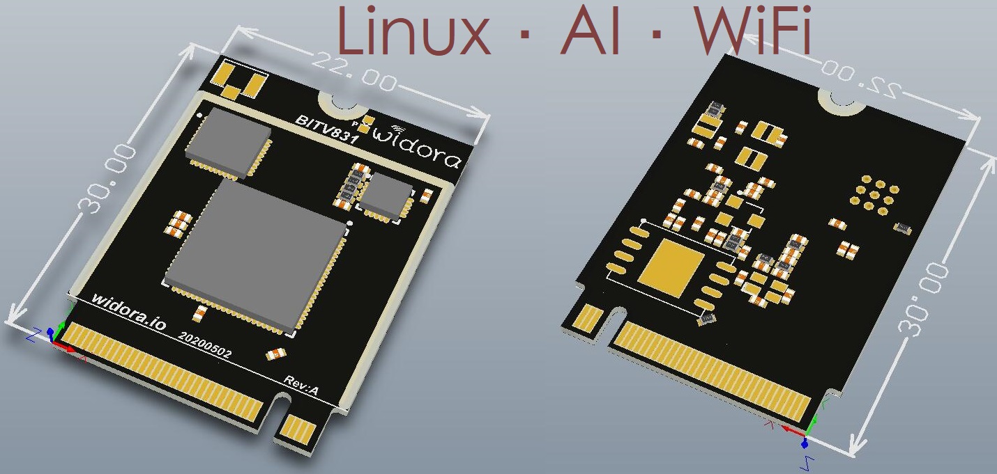

软件: TinaLinux SDK
连接器:ngff m.2 key A H3.2 同BITK210
当然得配一个小底板啦。有什么需求大家聊聊
#191 Re: 全志 SOC » 请教f1c100s的引脚怎么接csi摄像头 » 2020-05-01 23:56:21
