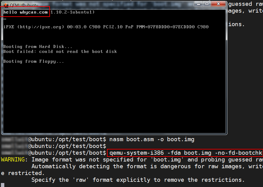

#19 DIY/综合/Arduino/写字机/3D打印机/智能小车/平衡车/四轴飞行/MQTT/物联网 » 闲来无事参考网络资料,用qemu调试i386软盘启动扇区代码 » 2020-12-21 09:34:25
路人甲
回复: 1
参考: https://shellcodes.org/ASM/为什么非0xAA55结尾的软盘镜像QEMU无法启动.html
boot.asm 代码:
        ;; filename: boot.asm
org 07c00h
        mov ax, cs
        mov ds, ax
        mov es, ax
hello_entry:
        mov bp, msg
        mov cx, 18              ; 显示字符长度
        mov ah, 13h            ; 在 Teletype 模式下显示字符串
        mov al, 01h            ; 光标位置不变
        mov bh, 0              ; 显示页,图形模式下 BH 必须为 0
        mov bl, 0fh            ; 文字颜色,0F 为白色
        mov dh, 0              ; 显示行
        mov dl, 0               ; 显示列
        int 10h
        ret
msg: db "hello whycan.com",0dh,0ah,0
jmp $

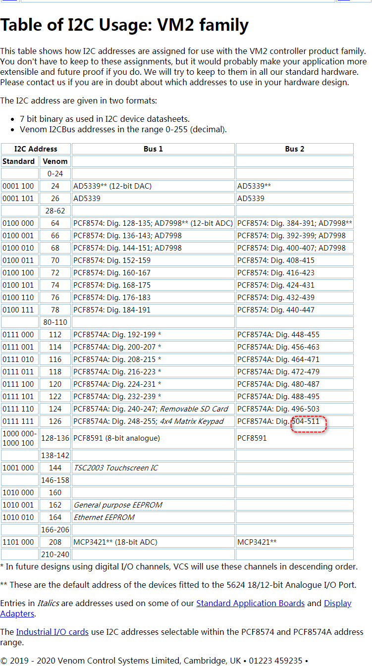

#23 8051/STC8/AT89C51/N76E003 » 请问用N76E003作为i2c从机,能占多个i2c地址吗?比如一个i2c地址做键盘, 另外一个i2c做加密通讯 » 2020-11-16 08:57:09
路人甲
回复: 3

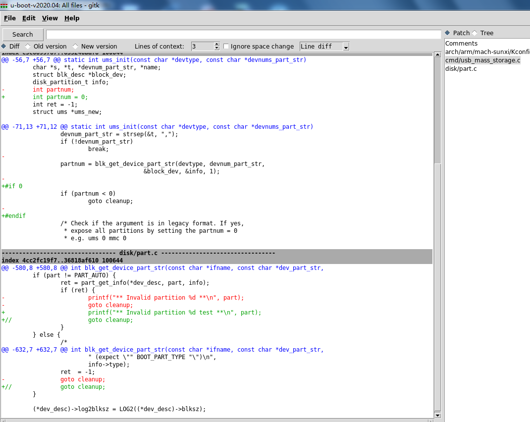

#28 Re: 全志 SOC » Allwinner S3 u-boot 2020.04 (DisplayEngine2 + Fastboot线刷) » 2020-10-17 17:06:13
路人甲 说:
请问楼主如果TF有两个分区,执行ums命令:
=> ums 0 mmc 0
** Invalid partition 1 **
会出现这个错误, 应该怎么破?
把这个判断强行屏蔽起来就好了
diff --git a/arch/arm/mach-sunxi/Kconfig b/arch/arm/mach-sunxi/Kconfig
index b7cb87a98f..3a46b14b05 100644
--- a/arch/arm/mach-sunxi/Kconfig
+++ b/arch/arm/mach-sunxi/Kconfig
@@ -262,6 +262,7 @@ config MACH_SUN8I_V3S
        select SUNXI_DRAM_DW
        select SUNXI_DRAM_DW_16BIT
        select SUPPORT_SPL
+       select SUNXI_DE2
 config MACH_SUN8I_S3
        bool "sun8i (Allwinner S3)"
diff --git a/cmd/usb_mass_storage.c b/cmd/usb_mass_storage.c
index c5c6899787..635246baf8 100644
--- a/cmd/usb_mass_storage.c
+++ b/cmd/usb_mass_storage.c
@@ -56,7 +56,7 @@ static int ums_init(const char *devtype, const char *devnums_part_str)
        char *s, *t, *devnum_part_str, *name;
        struct blk_desc *block_dev;
        disk_partition_t info;
-       int partnum;
+       int partnum = 0;
        int ret = -1;
        struct ums *ums_new;
@@ -71,13 +71,12 @@ static int ums_init(const char *devtype, const char *devnums_part_str)
                devnum_part_str = strsep(&t, ",");
                if (!devnum_part_str)
                        break;
                partnum = blk_get_device_part_str(devtype, devnum_part_str,
                                        &block_dev, &info, 1);
+#if 0
                if (partnum < 0)
                        goto cleanup;
+#endif
                /* Check if the argument is in legacy format. If yes,
                 * expose all partitions by setting the partnum = 0
                 * e.g. ums 0 mmc 0
diff --git a/disk/part.c b/disk/part.c
index 4cc2fc19f7..36818af610 100644
--- a/disk/part.c
+++ b/disk/part.c
@@ -580,8 +580,8 @@ int blk_get_device_part_str(const char *ifname, const char *dev_part_str,
        if (part != PART_AUTO) {
                ret = part_get_info(*dev_desc, part, info);
                if (ret) {
-                       printf("** Invalid partition %d **\n", part);
-                       goto cleanup;
+                       printf("** Invalid partition %d test **\n", part);
+//                     goto cleanup;
        } else {
@@ -632,7 +632,7 @@ int blk_get_device_part_str(const char *ifname, const char *dev_part_str,
                        " (expect \"" BOOT_PART_TYPE "\")\n",
                        info->type);
                ret  = -1;
-               goto cleanup;
+//             goto cleanup;
        (*dev_desc)->log2blksz = LOG2((*dev_desc)->blksz);

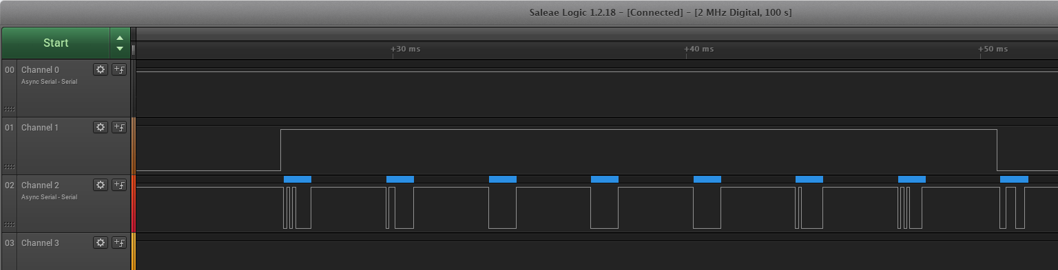

P4 也写入低电平, 时序图:
#64 全志 SOC » A33 + PCF8574 IO扩展芯片 调试记录 » 2020-07-06 17:02:28
路人甲
回复: 8
modprobe gpio-pcf857x
echo 409 > /sys/class/gpio/export
echo out > /sys/class/gpio/gpio409/direction
#P1写高电平
echo 1 > /sys/class/gpio/gpio409/value
#P1写低电平
echo 0 > /sys/class/gpio/gpio409/value
P1 写高电平时序:
P1 写低电平时序:

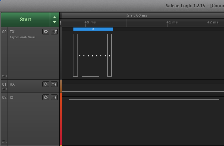

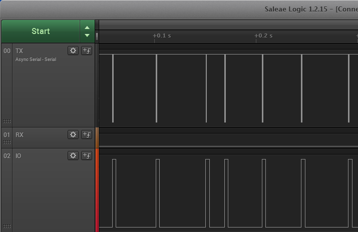

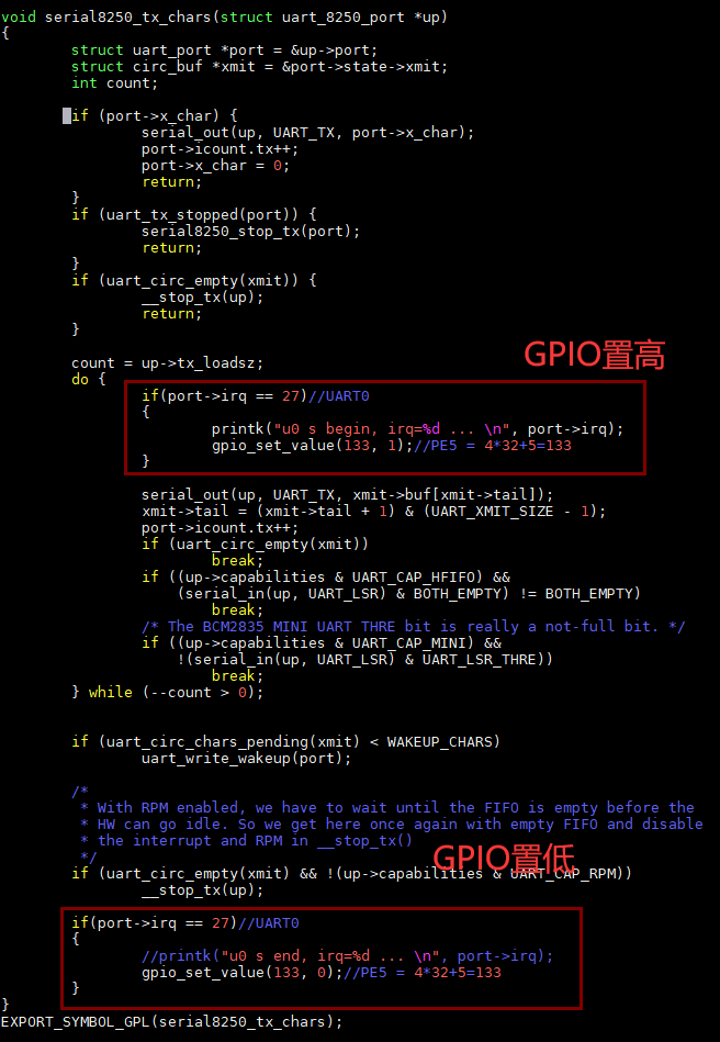

#112 Re: 全志 SOC » 请教大家一个问题,全志linux主线uart驱动里面控制一个io脚实现rs485功能,应该如何修改? » 2020-04-20 08:11:57
根据楼上这篇文章彻底解决了驱动中gpio控制RS485方向控制问题:
serial8250_tx_chars() 函数中执行 __stop_tx(up) 之后:
                //等待发送完成
                while (port->ops->tx_empty(port) != TIOCSER_TEMT)
                gpio_set_value(133, 0);//拉低PE5, 进入接收状态
#113 Re: DIY/综合/Arduino/写字机/3D打印机/智能小车/平衡车/四轴飞行/MQTT/物联网 » PCB台历 » 2020-04-11 08:27:35

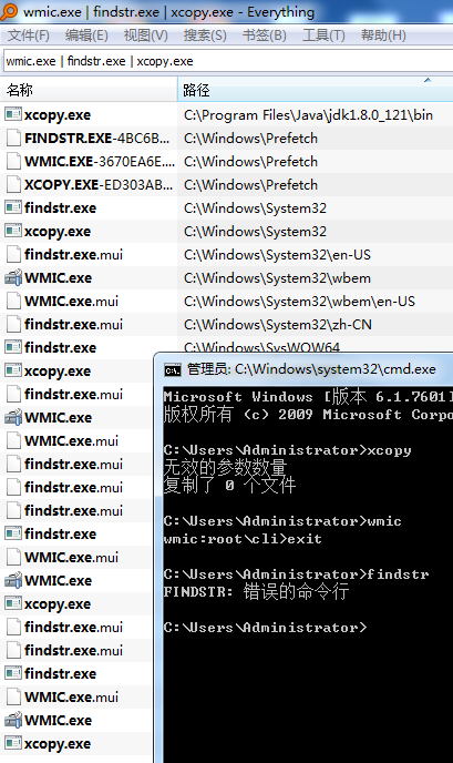

这些是 Windows 内置命令
#117 Re: 全志 SOC » 新手求助 rootfs.tar生成 » 2020-04-09 15:54:22
这是符号链接文件(symbolic links files), 都指向 busybox(传说中的瑞士军刀)

询问了以前用f1c100s控制 da14585 蓝牙芯片的朋友, 他说:
改 8250_port.c 里面的 serial8250_tx_chars()
这里发送数据前控制电平(高),
发完送数据前控制电平(低)
因为我的f1c100s io 口检测 da14585 的 cts 引脚电平,
如果为高电平就等待,
如果为低电平就启动发送。
我的这个流控逻辑和你的RS485逻辑基本一样。
差不多搞定了, 就是按上面晕哥的建议修改, 逻辑分析仪显示时序正常了.

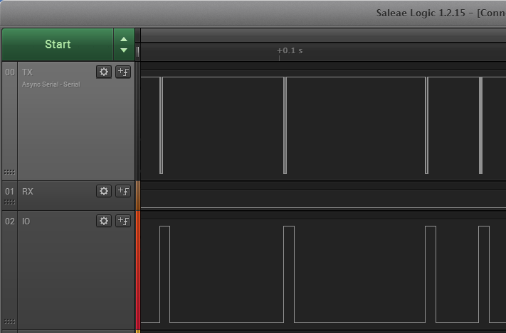

#131 Re: 全志 SOC » 请教大家一个问题,全志linux主线uart驱动里面控制一个io脚实现rs485功能,应该如何修改? » 2020-04-03 17:11:21
感谢大家, 参考上面的代码, 逻辑分析仪发现时序控制脚时序还是不对。

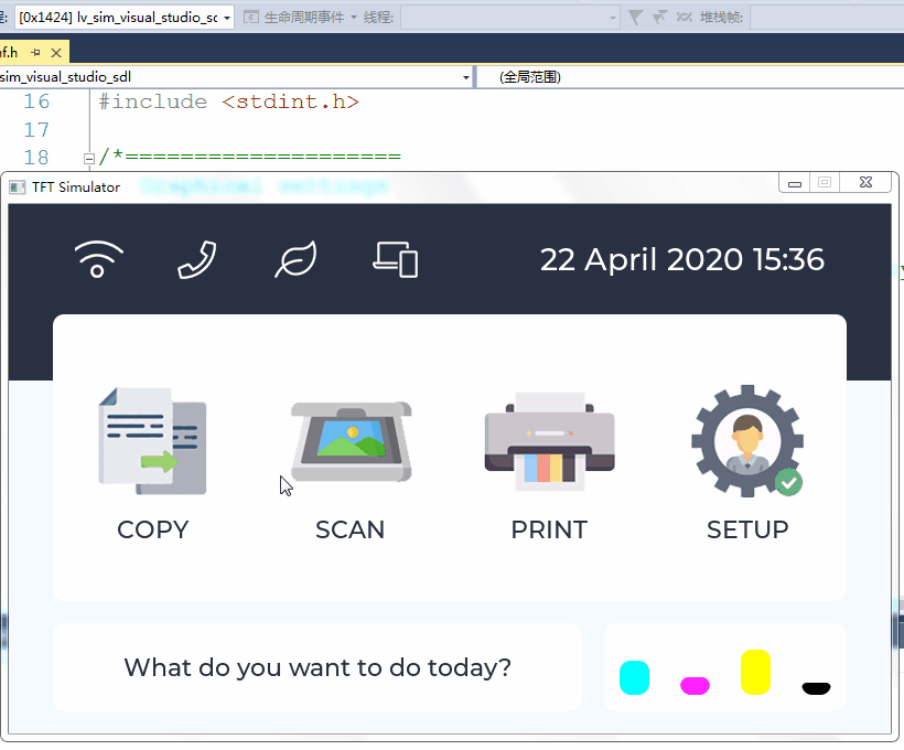

#148 Re: 计算机图形/GUI/RTOS/FileSystem/OpenGL/DirectX/SDL2 » @熊掌 开源的 littlevgl 读取并显示TTF字体的程序,使用 freetype ttf字体库 » 2019-05-27 10:53:42
谢谢作者分享。
我试了一下, 模拟器有点bug, 退出窗口(进程)的时候没有先通知 线程退出,
导致出现错误提示:
QThread: Destroyed while thread is still running
Invalid parameter passed to C runtime function.
然后我改了一点点:
MainWindow::~MainWindow()
    gui_thread.exit(0);
    Sleep(50);
    delete ui;
然而还是一样的问题, 跟踪了一下
gui_thread.exit(0);
根本不能这样结束线程.
看来得想别的线程通讯方法才行。
