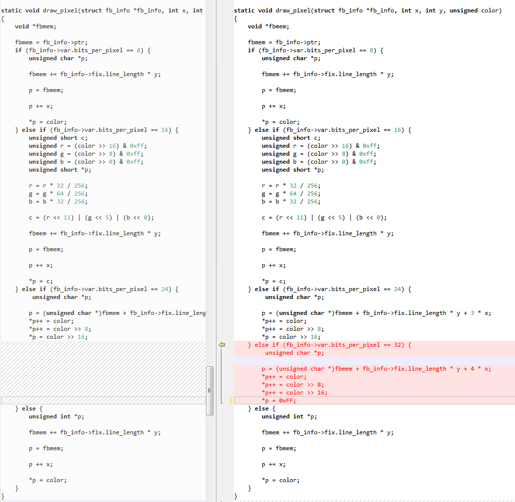

#2 Re: 全志 SOC » 索智S3-EVB上QT5 GUI LCD无显示 » 2023-02-18 06:39:04
memory 说:
https://whycan.com/files/members/7106/2021-12-12_123528.png
是因为 全志SDK默认Framebuffer格式是 RGBA,有Alpha通道,这个通道要赋值才行。
修改 output/build/fb-test-app-rosetta-1.1.0/fb-test.c
        }else if (fb_info->var.bits_per_pixel== 32){
                unsigned char *p;
                p = (unsigned char *)fbmem + fb_info->fix.line_length *y + 4*x;
                *p++ = color;
                *p++ = color >> 8;
                *p++ = color >> 16;
                *p = 0xFF;
output/build/fbv-1.0b/fb_display.c
void* convertRGB2FB(int fh, unsigned char *rgbbuff, unsigned long count, int bpp, int *cpp)
加上:  0xFF000000
        case 32:
            *cpp = 4;
            i_fbbuff = (unsigned int *) malloc(count * sizeof(unsigned int));
            for(i = 0; i < count ; i++)
                i_fbbuff[i] = ((rgbbuff[i*3] << 16) & 0xFF0000) |
                            ((rgbbuff[i*3+1] << 8) & 0xFF00) |
                            (rgbbuff[i*3+2] & 0xFF) |
                            0xFF000000;
            fbbuff = (void *) i_fbbuff;
            break;

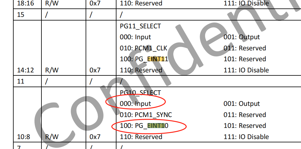

#8 Re: 全志 SOC » 加深认识V3s的GIC中断 » 2022-10-26 08:40:26
我的V3s tina3.x linux4.9  PB口可以中断,PG不能中断,请问是什么问题?

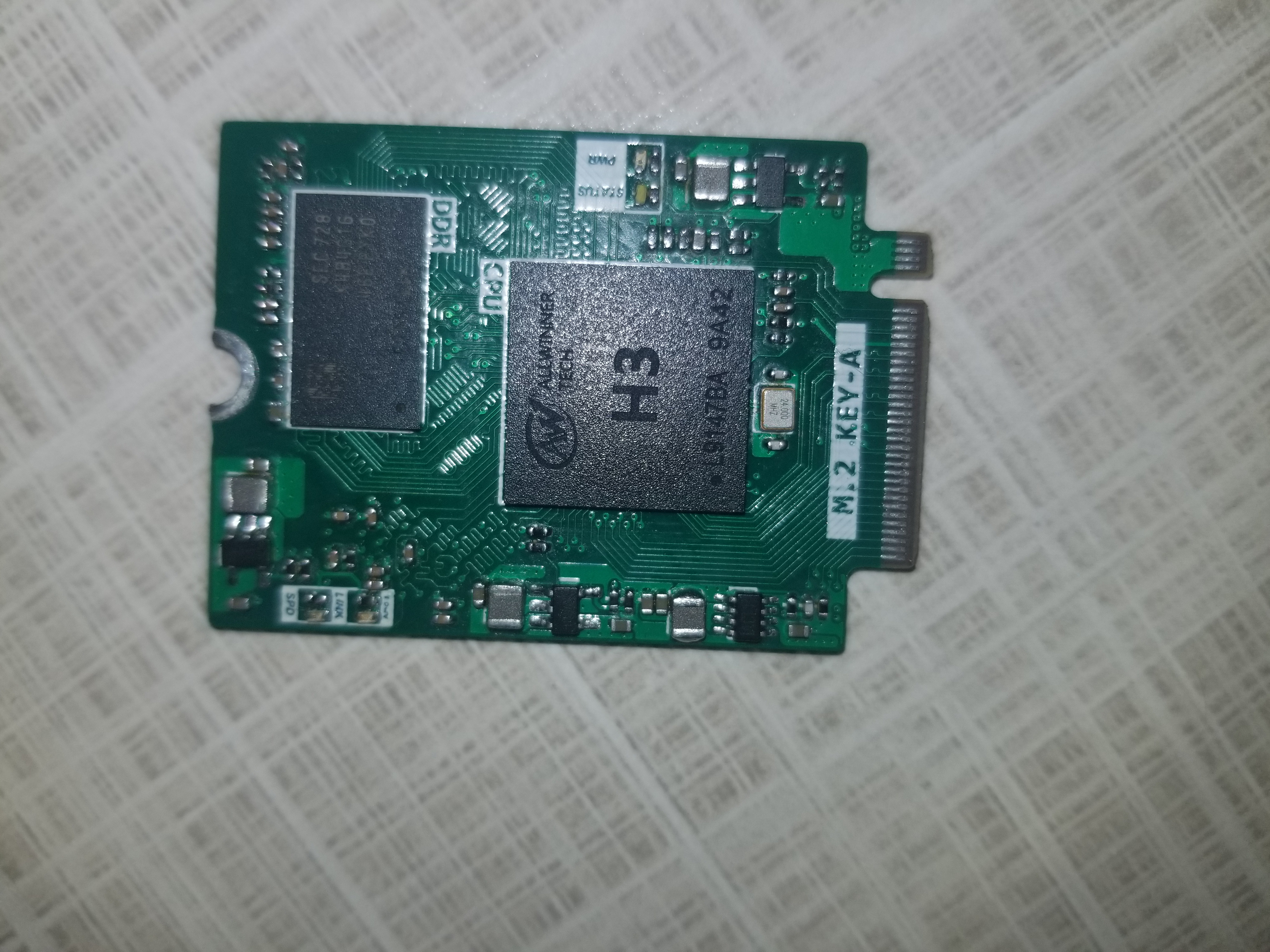

#85 Re: 全志 SOC » 自制全志H3核心板 » 2022-02-09 21:48:01
xiaolibo 说:
cube 说:
xiaolibo 说:
嗯嗯,我的TF卡,是直接飞线的,还没有画底板
sunxi-fel 有一个uboot子命令,可以直接通过内存运行uboot,无需刷卡,你试一试。
嗯嗯,好的,我先看看
uboot里面把tf卡clk调低试一试。
#86 Re: 全志 SOC » 自制全志H3核心板 » 2022-02-09 21:07:58
xiaolibo 说:

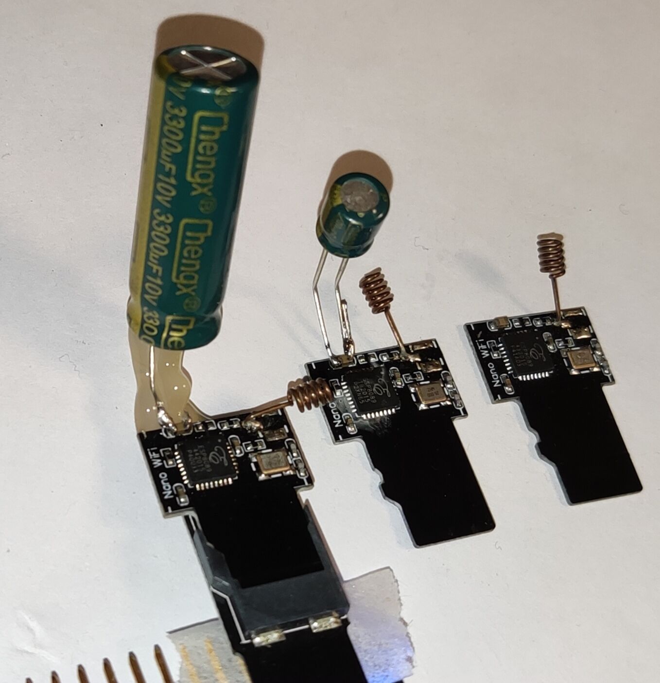

#135 Re: 全志 SOC » SDIO ESP8089开源Linux驱动现在可以直接编译通过了, 有没有朋友一起试一试 » 2021-11-01 23:49:36
# [ 7372.646195] esp_sdio_remove enter
[ 7372.651835] sif_disable_irq release irq failed
[ 7372.656546] ------------[ cut here ]------------
[ 7372.661218] WARNING: CPU: 0 PID: 231 at kernel/workqueue.c:3042 __flush_work+0x1f0/0x200
[ 7372.669388] Modules linked in: esp8089(O) rtc_hym8563 tsc2007
[ 7372.675162] CPU: 0 PID: 231 Comm: kworker/0:1 Tainted: G           O      5.4.70-smallwitpi #3
[ 7372.683759] Hardware name: Allwinner sun8i Family
[ 7372.688489] Workqueue: events_freezable mmc_rescan
[ 7372.693319] [<c010ec5c>] (unwind_backtrace) from [<c010b57c>] (show_stack+0x10/0x14)
[ 7372.701071] [<c010b57c>] (show_stack) from [<c0713f3c>] (dump_stack+0x94/0xa8)
[ 7372.708304] [<c0713f3c>] (dump_stack) from [<c011dba0>] (__warn+0xbc/0xd4)
[ 7372.715181] [<c011dba0>] (__warn) from [<c011dc68>] (warn_slowpath_fmt+0xb0/0xb8)
[ 7372.722665] [<c011dc68>] (warn_slowpath_fmt) from [<c0137e04>] (__flush_work+0x1f0/0x200)
[ 7372.730841] [<c0137e04>] (__flush_work) from [<c0138060>] (__cancel_work_timer+0x110/0x1f4)
[ 7372.739243] [<c0138060>] (__cancel_work_timer) from [<bf0126a4>] (sip_detach+0x88/0x1b4 [esp8089])
[ 7372.748239] [<bf0126a4>] (sip_detach [esp8089]) from [<bf00e058>] (esp_sdio_remove+0x64/0x1a4 [esp8089])
[ 7372.757743] [<bf00e058>] (esp_sdio_remove [esp8089]) from [<c0583880>] (sdio_bus_remove+0x30/0x11c)
[ 7372.766800] [<c0583880>] (sdio_bus_remove) from [<c047c644>] (device_release_driver_internal+0xe8/0x1b8)
[ 7372.776281] [<c047c644>] (device_release_driver_internal) from [<c047b0f4>] (bus_remove_device+0xcc/0xf8)
[ 7372.785847] [<c047b0f4>] (bus_remove_device) from [<c047766c>] (device_del+0x140/0x36c)
[ 7372.793851] [<c047766c>] (device_del) from [<c0583a94>] (sdio_remove_func+0x1c/0x28)
[ 7372.801594] [<c0583a94>] (sdio_remove_func) from [<c058180c>] (mmc_sdio_remove+0x38/0x64)
[ 7372.809769] [<c058180c>] (mmc_sdio_remove) from [<c0582aa8>] (mmc_sdio_detect+0x6c/0xf8)
[ 7372.817862] [<c0582aa8>] (mmc_sdio_detect) from [<c0579c58>] (mmc_rescan+0xc0/0x3f4)
[ 7372.825606] [<c0579c58>] (mmc_rescan) from [<c013674c>] (process_one_work+0x218/0x474)
[ 7372.833521] [<c013674c>] (process_one_work) from [<c01369ec>] (worker_thread+0x44/0x5d8)
[ 7372.841614] [<c01369ec>] (worker_thread) from [<c013cc54>] (kthread+0x14c/0x150)
[ 7372.849012] [<c013cc54>] (kthread) from [<c01010e8>] (ret_from_fork+0x14/0x2c)
[ 7372.856226] Exception stack(0xc68b3fb0 to 0xc68b3ff8)
[ 7372.861280] 3fa0:                                     00000000 00000000 00000000 00000000
[ 7372.869450] 3fc0: 00000000 00000000 00000000 00000000 00000000 00000000 00000000 00000000
[ 7372.877619] 3fe0: 00000000 00000000 00000000 00000000 00000013 00000000
[ 7372.884377] ---[ end trace 463d889c65379c21 ]---
[ 7372.889119] wlan0: deauthenticating from e4:26:8b:89:a9:f8 by local choice (Reason: 3=DEAUTH_LEAVING)
[ 7372.996701] mmc0: card 0001 removed
[ 7373.065437] mmc0: queuing unknown CIS tuple 0x01 (3 bytes)
[ 7373.084469] mmc0: queuing unknown CIS tuple 0x1a (5 bytes)
[ 7373.099565] mmc0: queuing unknown CIS tuple 0x1b (8 bytes)
[ 7373.118088] mmc0: queuing unknown CIS tuple 0x80 (1 bytes)
[ 7373.130367] mmc0: queuing unknown CIS tuple 0x81 (1 bytes)
[ 7373.146175] mmc0: queuing unknown CIS tuple 0x82 (1 bytes)
[ 7373.156157] mmc0: new high speed SDIO card at address 0001
[ 7373.176074] 8<--- cut here ---
[ 7373.179186] Unable to handle kernel NULL pointer dereference at virtual address 00000004
[ 7373.187445] pgd = e14de9ca
[ 7373.190147] [00000004] *pgd=00000000
[ 7373.193740] Internal error: Oops: 17 [#1] SMP ARM
[ 7373.198440] Modules linked in: esp8089(O) rtc_hym8563 tsc2007
[ 7373.204205] CPU: 0 PID: 231 Comm: kworker/0:1 Tainted: G        W  O      5.4.70-smallwitpi #3
[ 7373.212803] Hardware name: Allwinner sun8i Family
[ 7373.217543] Workqueue: events_freezable mmc_rescan
[ 7373.222388] PC is at esp_sdio_probe+0x48/0x3e0 [esp8089]
[ 7373.227711] LR is at sdio_bus_probe+0xbc/0x17c
[ 7373.232151] pc : [<bf00e1e0>]    lr : [<c0583790>]    psr: 200e0013
[ 7373.238409] sp : c68b3d90  ip : 3bc71000  fp : 00000396
[ 7373.243628] r10: 00000000  r9 : bf017190  r8 : bf017190
[ 7373.248846] r7 : c621ca00  r6 : bf01a080  r5 : bf0467c4  r4 : 00000000
[ 7373.255366] r3 : c621ca08  r2 : 00000003  r1 : 00000000  r0 : c621ca00
[ 7373.261889] Flags: nzCv  IRQs on  FIQs on  Mode SVC_32  ISA ARM  Segment none
[ 7373.269016] Control: 10c5387d  Table: 4624406a  DAC: 00000051
[ 7373.274755] Process kworker/0:1 (pid: 231, stack limit = 0x71c92228)
[ 7373.281105] Stack: (0xc68b3d90 to 0xc68b4000)
[ 7373.285463] 3d80:                                     0000000d 00000000 00000396 c621ca08
[ 7373.293636] 3da0: c621ca00 00000000 bf01a0ec bf017190 0000000d c0583790 c0ba2188 c621ca08
[ 7373.301808] 3dc0: c0ba218c 00000000 bf01a0ec c047bf44 c621ca08 bf01a0ec c047c3a0 c0b04e48
[ 7373.309980] 3de0: 00000001 00000000 c0b04e48 c047c1ec bf01a0ec c68b3e4c c621ca08 00000000
[ 7373.318151] 3e00: c68b3e4c c047c3a0 c0b04e48 00000001 00000000 c0b04e48 00000396 c047a344
[ 7373.326321] 3e20: 00000000 c693a26c c6225538 8daf25ec c0b04e48 c0b04e48 c621ca08 c621ca4c
[ 7373.334494] 3e40: c0b04e48 c047bcb8 c0b60f5c c621ca08 00000001 8daf25ec c621ca08 c621ca08
[ 7373.342665] 3e60: c0b58e98 c0b04e48 00000000 c047b020 c621ca08 c62cc808 00000000 c0477f74
[ 7373.350838] 3e80: c6002000 c0578fc0 c0b04e48 c621ca08 c6002000 8daf25ec c68b3eb0 c621ca00
[ 7373.359008] 3ea0: c621ca08 c6002000 c62cc800 c62cc800 00000001 c0583a64 00000000 00000001
[ 7373.367179] 3ec0: c6002000 c0582db4 00000000 c68b3edf 00000000 00000000 00000000 00000000
[ 7373.375350] 3ee0: 10ffff00 8daf25ec ffffff92 c6002294 00061a80 c6002000 c088c868 c088c874
[ 7373.383522] 3f00: 00000000 00000000 c7fdd900 c0579ed8 c6002294 c6225480 c7fdd900 c7fe0d00
[ 7373.391693] 3f20: 00000000 c013674c c0b03d00 c7fdd918 c6225480 c7fdd900 c6225494 c0b03d00
[ 7373.399865] 3f40: c7fdd918 ffffe000 00000008 c01369ec ffffe000 c0b61c29 c0916048 c6225480
[ 7373.408037] 3f60: c01369a8 c61a14c0 c61a1340 00000000 c68b2000 c6225480 c01369a8 c600fea4
[ 7373.416209] 3f80: c61a14dc c013cc54 000000b2 c61a1340 c013cb08 00000000 00000000 00000000
[ 7373.424380] 3fa0: 00000000 00000000 00000000 c01010e8 00000000 00000000 00000000 00000000
[ 7373.432552] 3fc0: 00000000 00000000 00000000 00000000 00000000 00000000 00000000 00000000
[ 7373.440723] 3fe0: 00000000 00000000 00000000 00000000 00000013 00000000 00000000 00000000
[ 7373.448942] [<bf00e1e0>] (esp_sdio_probe [esp8089]) from [<c0583790>] (sdio_bus_probe+0xbc/0x17c)
[ 7373.457831] [<c0583790>] (sdio_bus_probe) from [<c047bf44>] (really_probe+0x218/0x348)
[ 7373.465752] [<c047bf44>] (really_probe) from [<c047c1ec>] (driver_probe_device+0x60/0x164)
[ 7373.474017] [<c047c1ec>] (driver_probe_device) from [<c047a344>] (bus_for_each_drv+0x58/0xb8)
[ 7373.482540] [<c047a344>] (bus_for_each_drv) from [<c047bcb8>] (__device_attach+0xe0/0x14c)
[ 7373.490801] [<c047bcb8>] (__device_attach) from [<c047b020>] (bus_probe_device+0x84/0x8c)
[ 7373.498976] [<c047b020>] (bus_probe_device) from [<c0477f74>] (device_add+0x3b8/0x604)
[ 7373.506890] [<c0477f74>] (device_add) from [<c0583a64>] (sdio_add_func+0x5c/0x70)
[ 7373.514372] [<c0583a64>] (sdio_add_func) from [<c0582db4>] (mmc_attach_sdio+0x280/0x358)
[ 7373.522464] [<c0582db4>] (mmc_attach_sdio) from [<c0579ed8>] (mmc_rescan+0x340/0x3f4)
[ 7373.530302] [<c0579ed8>] (mmc_rescan) from [<c013674c>] (process_one_work+0x218/0x474)
[ 7373.538222] [<c013674c>] (process_one_work) from [<c01369ec>] (worker_thread+0x44/0x5d8)
[ 7373.546315] [<c01369ec>] (worker_thread) from [<c013cc54>] (kthread+0x14c/0x150)
[ 7373.553715] [<c013cc54>] (kthread) from [<c01010e8>] (ret_from_fork+0x14/0x2c)
[ 7373.560929] Exception stack(0xc68b3fb0 to 0xc68b3ff8)
[ 7373.565978] 3fa0:                                     00000000 00000000 00000000 00000000
[ 7373.574149] 3fc0: 00000000 00000000 00000000 00000000 00000000 00000000 00000000 00000000
[ 7373.582317] 3fe0: 00000000 00000000 00000000 00000000 00000013 00000000
[ 7373.588936] Code: e5954018 e3a01000 e5851018 e2873008 (e5948004)
[ 7373.595199] ---[ end trace 463d889c65379c22 ]---
诡异,放这里什么都没干,也挂了。

#137 Re: 全志 SOC » SDIO ESP8089开源Linux驱动现在可以直接编译通过了, 有没有朋友一起试一试 » 2021-11-01 09:36:14
@司徒
感谢司徒大佬回复,
# lsmod
Module                  Size  Used by    Tainted: G
esp8089               249856  0
tsc2007                16384  0
rtc_hym8563            16384  0
# rmmod esp8089
[ 1301.744604] esp_sdio_exit
[ 1301.747950] esp_sdio_remove enter
[ 1301.754145] ------------[ cut here ]------------
[ 1301.758986] WARNING: CPU: 0 PID: 184 at kernel/workqueue.c:3042 __flush_work+0x1f0/0x200
[ 1301.767119] Modules linked in: esp8089(O-) tsc2007 rtc_hym8563
[ 1301.772981] CPU: 0 PID: 184 Comm: rmmod Tainted: G           O      5.4.70-smallwitpi #3
[ 1301.781059] Hardware name: Allwinner sun8i Family
[ 1301.785810] [<c010ec5c>] (unwind_backtrace) from [<c010b57c>] (show_stack+0x10/0x14)
[ 1301.793564] [<c010b57c>] (show_stack) from [<c0713f3c>] (dump_stack+0x94/0xa8)
[ 1301.800797] [<c0713f3c>] (dump_stack) from [<c011dba0>] (__warn+0xbc/0xd4)
[ 1301.807671] [<c011dba0>] (__warn) from [<c011dc68>] (warn_slowpath_fmt+0xb0/0xb8)
[ 1301.815153] [<c011dc68>] (warn_slowpath_fmt) from [<c0137e04>] (__flush_work+0x1f0/0x200)
[ 1301.823330] [<c0137e04>] (__flush_work) from [<c0138060>] (__cancel_work_timer+0x110/0x1f4)
[ 1301.831739] [<c0138060>] (__cancel_work_timer) from [<bf0126a4>] (sip_detach+0x88/0x1b4 [esp8089])
[ 1301.840735] [<bf0126a4>] (sip_detach [esp8089]) from [<bf00e058>] (esp_sdio_remove+0x64/0x1a4 [esp8089])
[ 1301.850238] [<bf00e058>] (esp_sdio_remove [esp8089]) from [<c0583880>] (sdio_bus_remove+0x30/0x11c)
[ 1301.859295] [<c0583880>] (sdio_bus_remove) from [<c047c644>] (device_release_driver_internal+0xe8/0x1b8)
[ 1301.868780] [<c047c644>] (device_release_driver_internal) from [<c047c780>] (driver_detach+0x54/0xa0)
[ 1301.877998] [<c047c780>] (driver_detach) from [<c047b350>] (bus_remove_driver+0x4c/0xa4)
[ 1301.886104] [<c047b350>] (bus_remove_driver) from [<bf00e850>] (esp_sdio_exit+0x28/0x50 [esp8089])
[ 1301.895081] [<bf00e850>] (esp_sdio_exit [esp8089]) from [<c0197340>] (sys_delete_module+0x128/0x1f0)
[ 1301.904214] [<c0197340>] (sys_delete_module) from [<c0101000>] (ret_fast_syscall+0x0/0x54)
[ 1301.912471] Exception stack(0xc61c5fa8 to 0xc61c5ff0)
[ 1301.917526] 5fa0:                   b6e8e364 38707365 beee4bc8 00000880 00000000 beee4e28
[ 1301.925698] 5fc0: b6e8e364 38707365 00393830 00000081 00000000 00000000 b6f65000 00000000
[ 1301.933865] 5fe0: beee4bc0 beee4bb0 b6e8e22c b6e0b0e2
[ 1301.939038] ---[ end trace 76a1858765e054ce ]---
[ 1301.943743] wlan0: deauthenticating from e4:26:8b:89:a9:f8 by local choice (Reason: 3=DEAUTH_LEAVING)
[ 1302.047595] ESP8089 reset via GPIO 0
# insmod /lib/esp8089.ko
[ 1345.884022]
[ 1345.884022] ***** EAGLE DRIVER VER:bdf5087c3deb*****
[ 1345.884022]
[ 1345.892366] ESP8089 reset via GPIO 0
[ 1346.116240] esp_sdio_dummy_probe enter
[ 1346.335511] esp_sdio_init power up OK
[ 1346.375818] Set sdio block size 512 failed: -110)
[ 1346.380871] first error exit
[ 1346.383816] eagle_sdio: probe of mmc0:0001:1 failed with error -110
这个 insmod/rmmod 问题是因为 TF卡模块没有接RST 引起吗?
#138 Re: 全志 SOC » 小白自制Linux开发板(F1C200s)整理系列,持续更新中 » 2021-11-01 09:22:10
@twzy
https://whycan.com/t_4326.html#p69705
和我这情况一样了, 有人说是电源问题,一脸懵x。
#139 Re: 全志 SOC » SDIO ESP8089开源Linux驱动现在可以直接编译通过了, 有没有朋友一起试一试 » 2021-11-01 08:12:48
4104 bytes from 183.232.112.93: seq=35917 ttl=55 time=20.928 ms
4104 bytes from 183.232.112.93: seq=35918 ttl=55 time=21.404 ms
4104 bytes from 183.232.112.93: seq=35919 ttl=55 time=26.296 ms
4104 bytes from 183.232.112.93: seq=35920 ttl=55 time=22.180 ms
4104 bytes from 183.232.112.93: seq=35921 ttl=55 time=23.201 ms
4104 bytes from 183.232.112.93: seq=35922 ttl=55 time=23.273 ms
4104 bytes from 183.232.112.93: seq=35923 ttl=55 time=24.312 ms
4104 bytes from 183.232.112.93: seq=35924 ttl=55 time=21.870 ms
4104 bytes from 183.232.112.93: seq=35925 ttl=55 time=22.400 ms
4104 bytes from 183.232.112.93: seq=35926 ttl=55 time=28.128 ms
[36024.858388] wlan0: authenticate with e4:26:8b:89:a9:f8
[36024.863840] wlan0: send auth to e4:26:8b:89:a9:f8 (try 1/3)
[36025.075400] wlan0: send auth to e4:26:8b:89:a9:f8 (try 2/3)
[36025.285360] wlan0: send auth to e4:26:8b:89:a9:f8 (try 3/3)
[36025.495337] wlan0: authentication with e4:26:8b:89:a9:f8 timed out
[36973.133610] esp_sdio_remove enter
[36973.139131] sif_disable_irq release irq failed
[36973.143668] ------------[ cut here ]------------
[36973.148535] WARNING: CPU: 0 PID: 302 at kernel/workqueue.c:3042 __flush_work+0x1f0/0x200
[36973.156667] Modules linked in: esp8089(O) tsc2007 rtc_hym8563
[36973.162441] CPU: 0 PID: 302 Comm: kworker/0:1 Tainted: G           O      5.4.70-smallwitpi #3
[36973.171040] Hardware name: Allwinner sun8i Family
[36973.175768] Workqueue: events_freezable mmc_rescan
[36973.180602] [<c010ec5c>] (unwind_backtrace) from [<c010b57c>] (show_stack+0x10/0x14)
[36973.188355] [<c010b57c>] (show_stack) from [<c0713f3c>] (dump_stack+0x94/0xa8)
[36973.195587] [<c0713f3c>] (dump_stack) from [<c011dba0>] (__warn+0xbc/0xd4)
[36973.202462] [<c011dba0>] (__warn) from [<c011dc68>] (warn_slowpath_fmt+0xb0/0xb8)
[36973.209945] [<c011dc68>] (warn_slowpath_fmt) from [<c0137e04>] (__flush_work+0x1f0/0x200)
[36973.218122] [<c0137e04>] (__flush_work) from [<c0138060>] (__cancel_work_timer+0x110/0x1f4)
[36973.226527] [<c0138060>] (__cancel_work_timer) from [<bf0126a4>] (sip_detach+0x88/0x1b4 [esp8089])
[36973.235527] [<bf0126a4>] (sip_detach [esp8089]) from [<bf00e058>] (esp_sdio_remove+0x64/0x1a4 [esp8089])
[36973.245028] [<bf00e058>] (esp_sdio_remove [esp8089]) from [<c0583880>] (sdio_bus_remove+0x30/0x11c)
[36973.254085] [<c0583880>] (sdio_bus_remove) from [<c047c644>] (device_release_driver_internal+0xe8/0x1b8)
[36973.263567] [<c047c644>] (device_release_driver_internal) from [<c047b0f4>] (bus_remove_device+0xcc/0xf8)
[36973.273133] [<c047b0f4>] (bus_remove_device) from [<c047766c>] (device_del+0x140/0x36c)
[36973.281135] [<c047766c>] (device_del) from [<c0583a94>] (sdio_remove_func+0x1c/0x28)
[36973.288877] [<c0583a94>] (sdio_remove_func) from [<c058180c>] (mmc_sdio_remove+0x38/0x64)
[36973.297052] [<c058180c>] (mmc_sdio_remove) from [<c0582aa8>] (mmc_sdio_detect+0x6c/0xf8)
[36973.305142] [<c0582aa8>] (mmc_sdio_detect) from [<c0579c58>] (mmc_rescan+0xc0/0x3f4)
[36973.312887] [<c0579c58>] (mmc_rescan) from [<c013674c>] (process_one_work+0x218/0x474)
[36973.320803] [<c013674c>] (process_one_work) from [<c01369ec>] (worker_thread+0x44/0x5d8)
[36973.328896] [<c01369ec>] (worker_thread) from [<c013cc54>] (kthread+0x14c/0x150)
[36973.336295] [<c013cc54>] (kthread) from [<c01010e8>] (ret_from_fork+0x14/0x2c)
[36973.343510] Exception stack(0xc616bfb0 to 0xc616bff8)
[36973.348560] bfa0:                                     00000000 00000000 00000000 00000000
[36973.356731] bfc0: 00000000 00000000 00000000 00000000 00000000 00000000 00000000 00000000
[36973.364900] bfe0: 00000000 00000000 00000000 00000000 00000013 00000000
[36973.371676] ---[ end trace 47c0350e194c98ef ]---
[36973.389204] func sip_write_pkts err!!!!!!!!!: -123
[36973.417439] mmc0: card 0001 removed
[36973.490332] mmc0: queuing unknown CIS tuple 0x01 (3 bytes)
[36973.503468] mmc0: queuing unknown CIS tuple 0x1a (5 bytes)
[36973.512152] mmc0: queuing unknown CIS tuple 0x1b (8 bytes)
[36973.519781] mmc0: queuing unknown CIS tuple 0x80 (1 bytes)
[36973.525385] mmc0: queuing unknown CIS tuple 0x81 (1 bytes)
[36973.530925] mmc0: queuing unknown CIS tuple 0x82 (1 bytes)
[36973.536512] mmc0: new high speed SDIO card at address 0001
[36973.550474] 8<--- cut here ---
[36973.553575] Unable to handle kernel NULL pointer dereference at virtual address 00000004
[36973.561864] pgd = 13fb3490
[36973.564577] [00000004] *pgd=00000000
[36973.568222] Internal error: Oops: 17 [#1] SMP ARM
[36973.572927] Modules linked in: esp8089(O) tsc2007 rtc_hym8563
[36973.578694] CPU: 0 PID: 302 Comm: kworker/0:1 Tainted: G        W  O      5.4.70-smallwitpi #3
[36973.587292] Hardware name: Allwinner sun8i Family
[36973.592029] Workqueue: events_freezable mmc_rescan
[36973.596886] PC is at esp_sdio_probe+0x48/0x3e0 [esp8089]
[36973.602208] LR is at sdio_bus_probe+0xbc/0x17c
[36973.606646] pc : [<bf00e1e0>]    lr : [<c0583790>]    psr: 20000013
[36973.612905] sp : c616bd90  ip : de557a80  fp : 00000396
[36973.618123] r10: 00000000  r9 : bf017190  r8 : bf017190
[36973.623342] r7 : c6be5a00  r6 : bf01a080  r5 : bf0467c4  r4 : 00000000
[36973.629860] r3 : c6be5a08  r2 : 00000003  r1 : 00000000  r0 : c6be5a00
[36973.636384] Flags: nzCv  IRQs on  FIQs on  Mode SVC_32  ISA ARM  Segment none
[36973.643510] Control: 10c5387d  Table: 462d006a  DAC: 00000051
[36973.649252] Process kworker/0:1 (pid: 302, stack limit = 0xe2391612)
[36973.655601] Stack: (0xc616bd90 to 0xc616c000)
[36973.659957] bd80:                                     0000000d 00000000 00000396 c6be5a08
[36973.668129] bda0: c6be5a00 00000000 bf01a0ec bf017190 0000000d c0583790 c0ba2188 c6be5a08
[36973.676301] bdc0: c0ba218c 00000000 bf01a0ec c047bf44 c6be5a08 bf01a0ec c047c3a0 c0b04e48
[36973.684472] bde0: 00000001 00000000 c0b04e48 c047c1ec bf01a0ec c616be4c c6be5a08 00000000
[36973.692644] be00: c616be4c c047c3a0 c0b04e48 00000001 00000000 c0b04e48 00000396 c047a344
[36973.700816] be20: 00000000 c693a26c c6268738 8daf25ec c0b04e48 c0b04e48 c6be5a08 c6be5a4c
[36973.708988] be40: c0b04e48 c047bcb8 c0b60f5c c6be5a08 00000001 8daf25ec c6be5a08 c6be5a08
[36973.717160] be60: c0b58e98 c0b04e48 00000000 c047b020 c6be5a08 c62d8808 00000000 c0477f74
[36973.725331] be80: c6002000 c0578fc0 c0b04e48 c6be5a08 c6002000 8daf25ec c616beb0 c6be5a00
[36973.733503] bea0: c6be5a08 c6002000 c62d8800 c62d8800 00000001 c0583a64 00000000 00000001
[36973.741675] bec0: c6002000 c0582db4 00000000 c616bedf 00000000 00000000 00000000 00000000
[36973.749846] bee0: 10ffff00 8daf25ec ffffff92 c6002294 00061a80 c6002000 c088c868 c088c874
[36973.758018] bf00: 00000000 00000000 c7fdd900 c0579ed8 c6002294 c6268b80 c7fdd900 c7fe0d00
[36973.766191] bf20: 00000000 c013674c c0b03d00 c7fdd918 c6268b80 c7fdd900 c6268b94 c0b03d00
[36973.774362] bf40: c7fdd918 ffffe000 00000008 c01369ec ffffe000 c0b61c29 c0916048 c6268b80
[36973.782534] bf60: c01369a8 c615a100 c615a140 00000000 c616a000 c6268b80 c01369a8 c600fea4
[36973.790705] bf80: c615a11c c013cc54 00000007 c615a140 c013cb08 00000000 00000000 00000000
[36973.798876] bfa0: 00000000 00000000 00000000 c01010e8 00000000 00000000 00000000 00000000
[36973.807047] bfc0: 00000000 00000000 00000000 00000000 00000000 00000000 00000000 00000000
[36973.815218] bfe0: 00000000 00000000 00000000 00000000 00000013 00000000 00000000 00000000
[36973.823431] [<bf00e1e0>] (esp_sdio_probe [esp8089]) from [<c0583790>] (sdio_bus_probe+0xbc/0x17c)
[36973.832318] [<c0583790>] (sdio_bus_probe) from [<c047bf44>] (really_probe+0x218/0x348)
[36973.840240] [<c047bf44>] (really_probe) from [<c047c1ec>] (driver_probe_device+0x60/0x164)
[36973.848503] [<c047c1ec>] (driver_probe_device) from [<c047a344>] (bus_for_each_drv+0x58/0xb8)
[36973.857025] [<c047a344>] (bus_for_each_drv) from [<c047bcb8>] (__device_attach+0xe0/0x14c)
[36973.865287] [<c047bcb8>] (__device_attach) from [<c047b020>] (bus_probe_device+0x84/0x8c)
[36973.873462] [<c047b020>] (bus_probe_device) from [<c0477f74>] (device_add+0x3b8/0x604)
[36973.881376] [<c0477f74>] (device_add) from [<c0583a64>] (sdio_add_func+0x5c/0x70)
[36973.888857] [<c0583a64>] (sdio_add_func) from [<c0582db4>] (mmc_attach_sdio+0x280/0x358)
[36973.896949] [<c0582db4>] (mmc_attach_sdio) from [<c0579ed8>] (mmc_rescan+0x340/0x3f4)
[36973.904788] [<c0579ed8>] (mmc_rescan) from [<c013674c>] (process_one_work+0x218/0x474)
[36973.912706] [<c013674c>] (process_one_work) from [<c01369ec>] (worker_thread+0x44/0x5d8)
[36973.920798] [<c01369ec>] (worker_thread) from [<c013cc54>] (kthread+0x14c/0x150)
[36973.928200] [<c013cc54>] (kthread) from [<c01010e8>] (ret_from_fork+0x14/0x2c)
[36973.935416] Exception stack(0xc616bfb0 to 0xc616bff8)
[36973.940464] bfa0:                                     00000000 00000000 00000000 00000000
[36973.948634] bfc0: 00000000 00000000 00000000 00000000 00000000 00000000 00000000 00000000
[36973.956803] bfe0: 00000000 00000000 00000000 00000000 00000013 00000000
[36973.963422] Code: e5954018 e3a01000 e5851018 e2873008 (e5948004)
[36973.969669] ---[ end trace 47c0350e194c98f0 ]---
ping: sendto: Network is unreachable

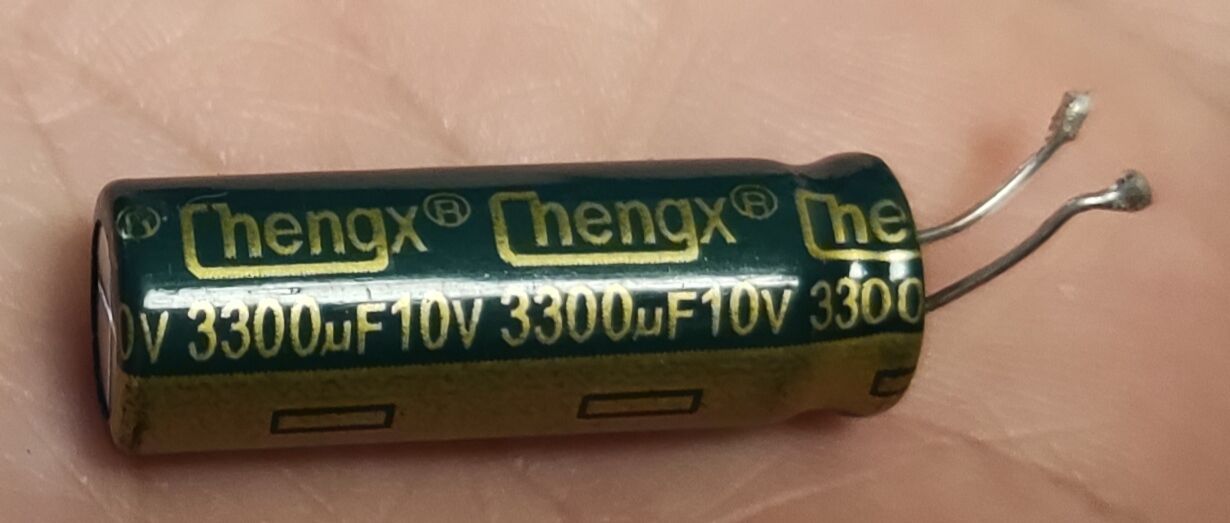

奇怪,加了一个 3300uF 的大电容也会挂,只是现在没那么容易挂了。
发了 35926 个 4096 字节包之后挂。

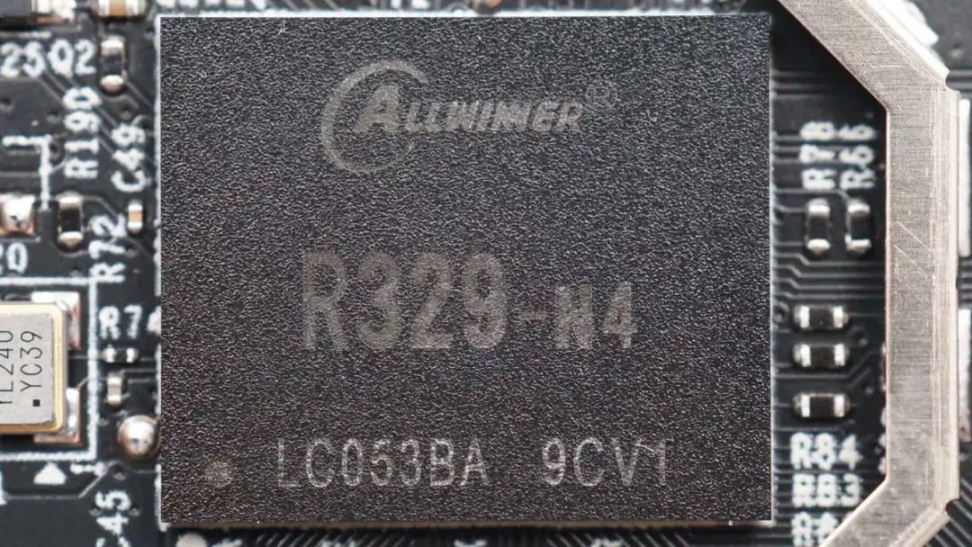

#161 全志 SOC » 使用R329方案的小米xiaomi Sound高保真智能音箱拆解(转) » 2021-08-26 22:34:43
cube
回复: 1
转自: https://bbs.aw-ol.com/topic/351
#162 Re: 全志 SOC » 哪吒D1使用gstreamer硬解码 » 2021-08-26 09:37:08

#168 Re: 全志 SOC » TSC2007 I2C触摸驱动有个地方没搞明白, 为什么IRQ引脚和GPIO检测PEN引脚状态可以是同一个 » 2021-08-15 22:24:16
从手册看,gpio输入和外部中断属于不同的复用。
只能这么认为了,中断复用的时候也能读?

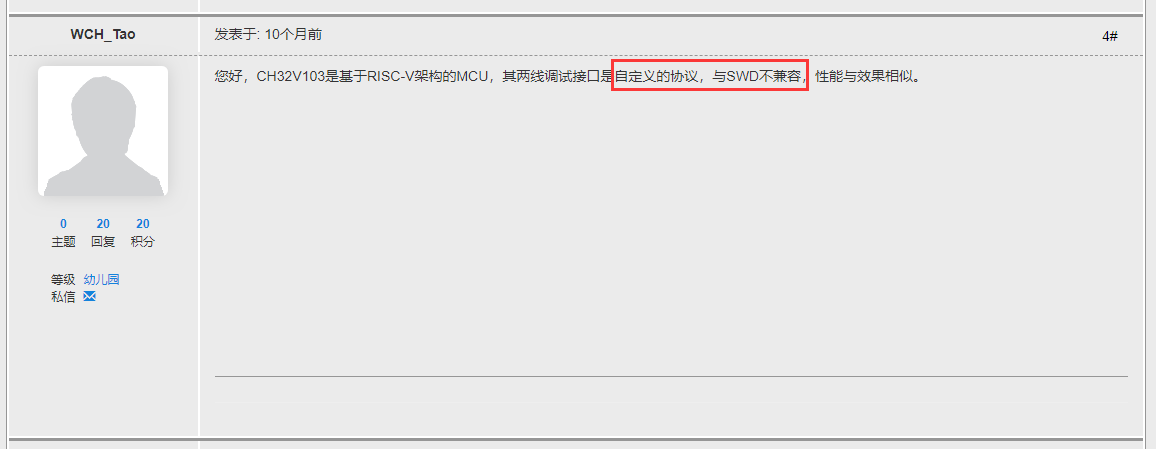

#182 Re: RISC-V » 看到沁恒的riscv单片机支持swd调试。 » 2021-08-04 19:14:07
metro 说:
这个帖子是我开的,当时二楼的回复是兼容ARM的SWD,后面他们自己删了😅
实际上真兼容吗?

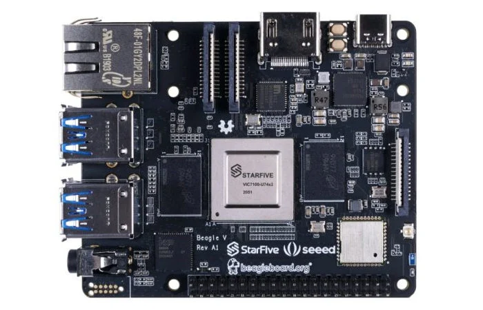

#185 全志 SOC » 这个开发板要取消了吗? BeagleV Starlight RISC-V single board computer cancelled » 2021-08-03 14:55:38
cube
回复: 3
BeagleV Starlight RISC-V single board computer cancelled :
https://www.geeky-gadgets.com/beaglev-02-08-2021/
Unfortunately the development team behind the BeagleV Starlight RISC-V single board computer first unveiled back in January 2021 has now been cancelled. But all is not last as the team at BeagleBoard is now working with Seeed Studio to design and manufacture a new RISC-V board which could be ready to ship as early as Q1 2022.
这个开发板要取消了吗?

#189 Re: 全志 SOC » 全志V3S的网口与全志H3的网口问题(硬件类) » 2021-07-30 23:25:36
1. 产品建议加49.9,不加可能也通
2. 一种座子集成隔离变压器,另一种不集成。

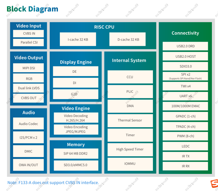

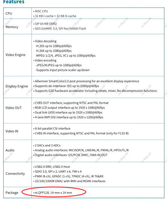

#198 Re: 全志 SOC » QQ群看到的外设齐全,封装友好,内置64M ddr的RV64芯片全志F133,有没有哪位用过? » 2021-07-15 10:51:37
QQ群看到的外设齐全,封装友好,内置64M ddr的RV64芯片F133,有没有哪位用过?
转自: https://bbs.aw-ol.com/topic/202
#199 全志 SOC » QQ群看到的外设齐全,封装友好,内置64M ddr的RV64芯片全志F133,有没有哪位用过? » 2021-07-15 10:50:44
cube
回复: 14
